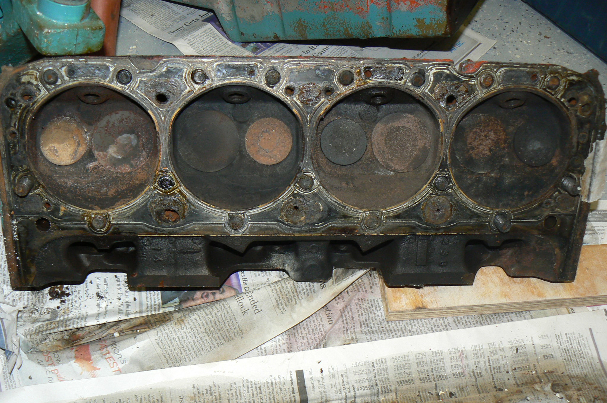

Ok, I'm semi awake and one cup os coffee, so here are more pics again
Time to strip the inside and pull the engine with my buddy Bob to help me.
Hmmm what's wrong with this picture?
Engine on rack and power washed.
Now to investigate the problems. There's a twist in the hull.
Well that's enough for now, have to get back at it.

Weather was crappy after the flip, lots of rain, so I worked on the motor.
not too dirty under the valve covers.
Some interesting things in the manifolds.
I'm thinking cylinders 1 and 4 are probably in rough shape inside.
Re:'53 18' Century Resorter finally 12 years 6 months ago #91874
The oil galleys look pretty decent Bob. The lack of "sludge" tells that someone took good care of the motor, right? Those manifolds and risers are another story altogether! I've seen them almost plugged with rust and scale, but that looks like a rat's nest was ingested and pumped through the motor. (Might have come in from the exhaust side, but you know what I mean?) May want to take those to a machine shop to get them vatted out, checked for cracks, etc.?
Re:'53 18' Century Resorter finally 12 years 6 months ago #91905
  • Waterwings
  • Waterwings's Avatar Topic Author
  • Posts: 4902
  • Karma: 107
  • Thank you received: 100
Yeah I'm thinking of taking the manifolds, heads and block, once it's all stripped, to a shop and have it cleaned and checked.
Re:'53 18' Century Resorter finally 12 years 6 months ago #91908
  • frog
  • frog's Avatar
  • Posts: 1431
  • Karma: 59
  • Thank you received: 3
bob, wish I were closer to you, I have been a gm auto mech for 42 years, I think I could help you out. frog
Re:'53 18' Century Resorter finally 12 years 6 months ago #91936
  • Waterwings
  • Posts: 4902
  • Karma: 107
Thanks Greg appreciate that. I may hit you up for some advice here and there if you don't mind. ;)
Re:'53 18' Century Resorter finally 12 years 6 months ago #91937
  • frog
  • frog's Avatar
  • Posts: 1431
  • Karma: 59
bob, anytime. frog
Re:'53 18' Century Resorter finally 12 years 6 months ago #91941
  • Waterwings
  • Posts: 4902
  • Karma: 107
Thanks buddy. I'll post what I found under the heads tomorrow.
Re:'53 18' Century Resorter finally 12 years 6 months ago #91980
  • frog
  • frog's Avatar
  • Posts: 1431
  • Karma: 59
bob, I sent you an e-mail. let me know if you got it. yours came thru as spam on my end. frog
Re:'53 18' Century Resorter finally 12 years 6 months ago #92064
  • Waterwings
  • Posts: 4902
  • Karma: 107
Greg it didn't come through, even as spam, not sure why.
Worked on the boat all weekend but not much to show for it. I didn't take any pics will take some tomorrow. I got two full rows of planks on the port side and did manage to get all the bungs/plus off all the screws but I still have to grind out the epoxy in all the slots. The person who did the bottom last epoxied them in!!!!!!!!! I've used up two Dremel diamond bits trying to grind out the slots. Got the whole port side doe but need to finish the starboard side before I can remove all the screws. Planks are coming out but it's ugly. They're splitting by the battens since that's where they were epoxied but there's still enough on the top part to make patterns from them. Very slow going. Also looks like the bottom ties are all split where the screws went in. :( I think I paid too much for what now appears to be a pattern boat! ARGH.
Here are the pics of the heads I promised. Carboned up as I figured but the cylinders look pretty good so..........
