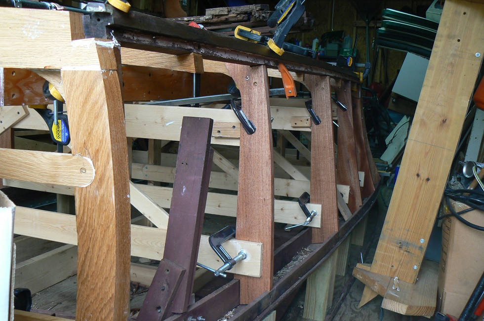

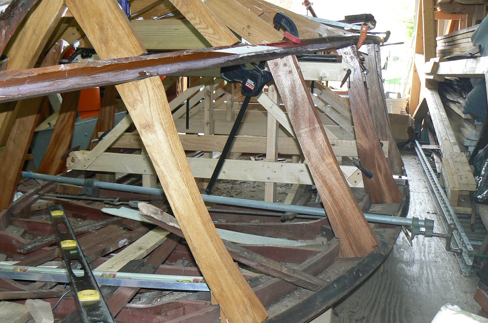

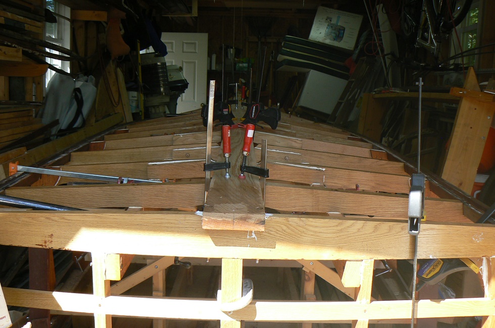

Well the transom is finally in as well as the last bottom frame. Now on to the upper frames, cutting the keel notches in the bottom frames etc...

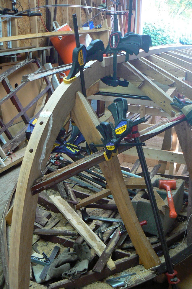

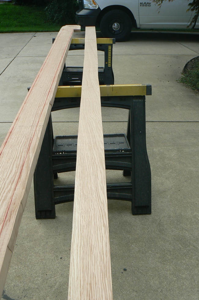

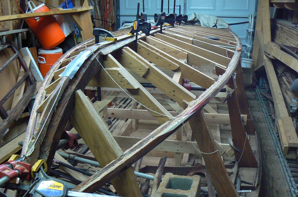

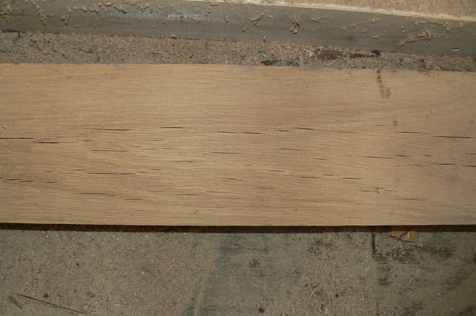

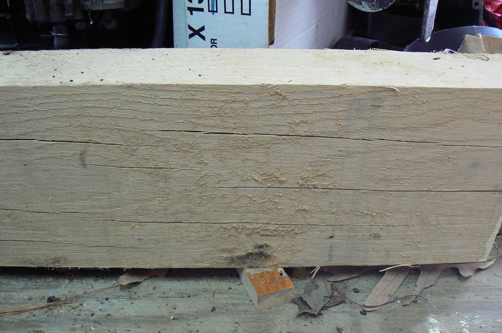

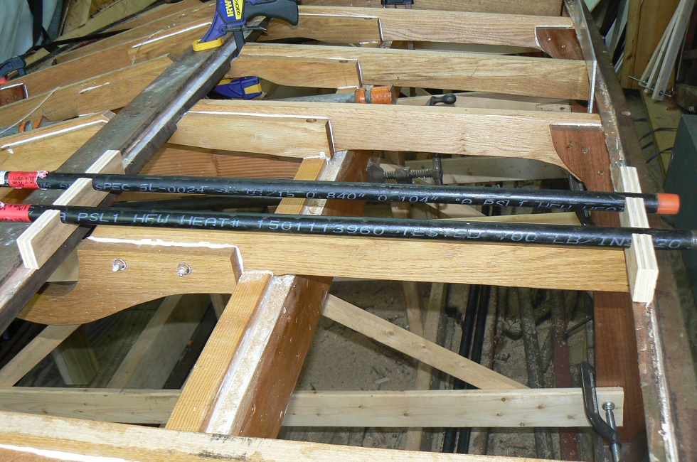

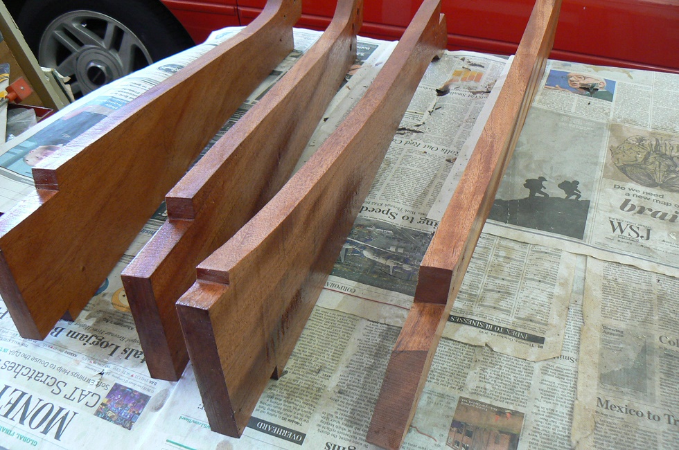

Well two more sets of upper frames done. They are installed I just didn't get a pic yet. Would have been done sooner but daughters wedding shower back in Michigan had to be attended. ;)

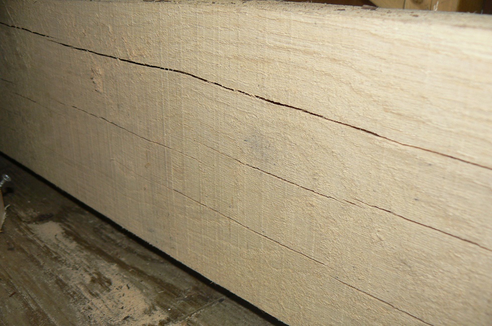

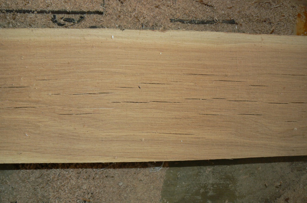

Unfortunately I have to get another chine blank. This on isn't usable. Apparently it was much drier than usual here this winter even though it was inside the shed with all the doors closed the whole time. :( Good thing I got it from the Amish and it only cost $20 .
Time to go back and get another one and coat the ends and use some thinned out Linseed oil to coat the rest of it and hope for the best. I only did the ends on the first one.

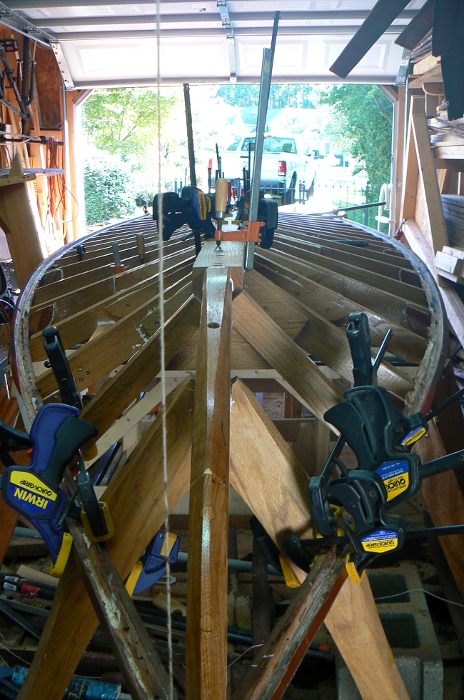

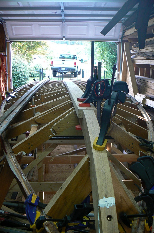

Well the upper frames are finally done Woo Hoo!

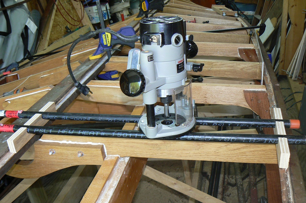

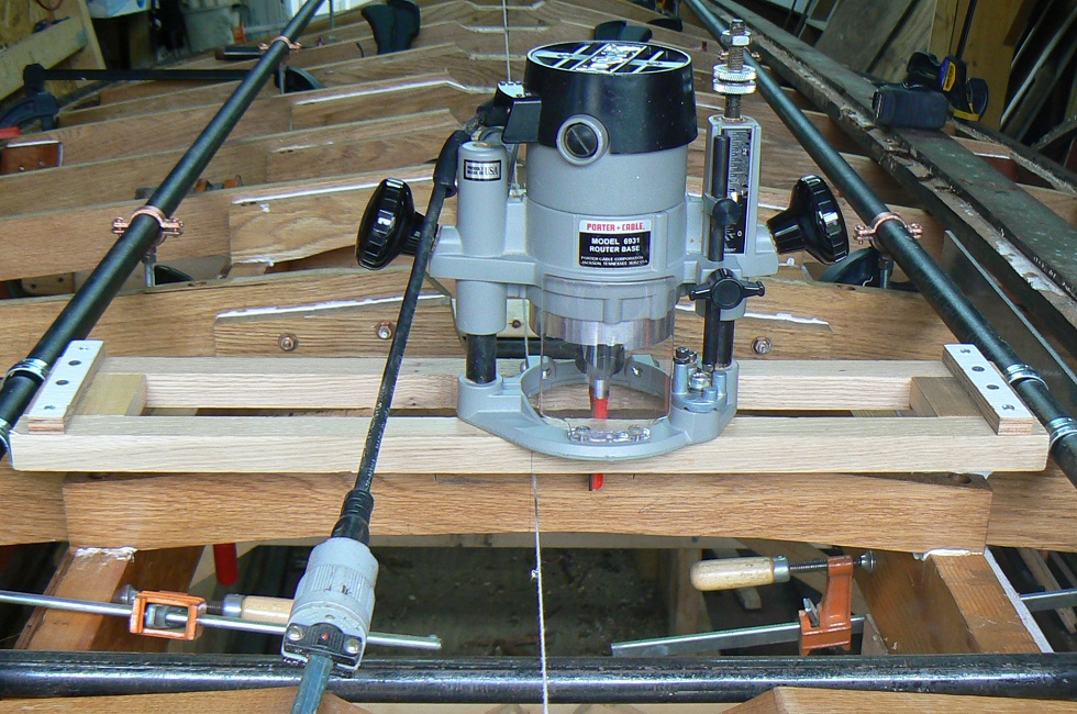

Now on to routing the keel bed. Here's the router jig I used.
Routed flat up to frame 4 1/2 not to figure out how to do the frames from 4 to the stem. Lol

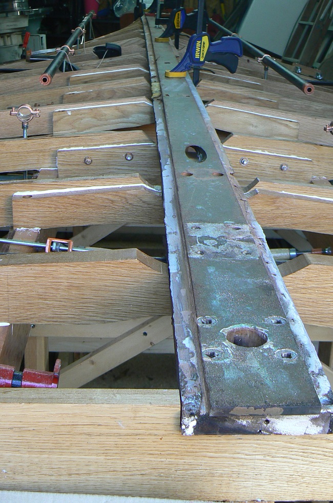

Well the old keel is now routed in and ready to start routing the bottom frames. Have to put the jig together tomorrow, got side tracked on honey do project.
Re:'53 18' Century Resorter finally 11 years 5 months ago #109076
Maaahvelous, simply Maaahvelous. Are you using the keel as a pattern or is it in good condition to install?
Can't help but think how much a new boat like that would have cost if Century had used all that effort and precision. :)

Thanks guys. Cal no the old one is bad I'm just using it to rout down the lower frames. New one will be put in soon.

Ok, so it's time for frame routing. here's the jig with the router.

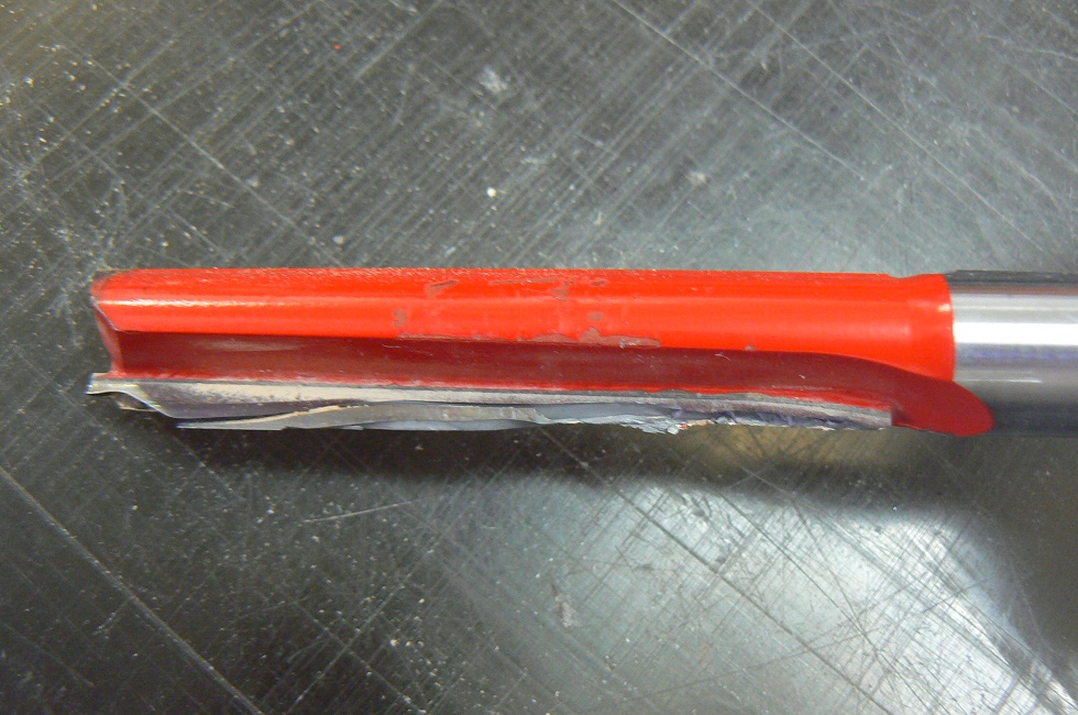

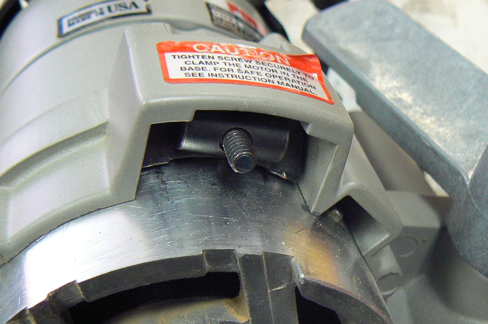

I got half way through the frames when this little bugger let lose and went down into the spinning blade!
And did this damage!
Luckily I wasn't hit by any flying carbide. Project is on hold again until I an get another bit. :(

bummer, but glad you were not hurt, still the progress looks good. greg
Re:'53 18' Century Resorter finally 11 years 5 months ago #109397
Bob. The stars were in alignment. Ditto, glad you weren't hurt. Gets the old ticker pumpin' and a reminder to keep those safety glasses and any other protection on.
Progress is coming along good.

Thanks guys, could have gotten real ugly! To top the day off I got a 1/2" long 1/16" wide sliver down into the side of my thumb, almost made it all the way through!!!! Yeah hurt like hell and couldn't get it out so went by the doc's today to get it dug out. Should have taken a pic it was a beaut! LOL
New router bit is in the mail, hopefully I'll get it by the weekend.

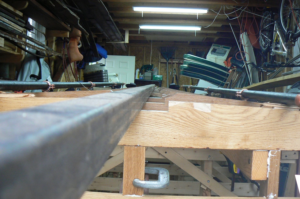

I finished all the bottom frame routing to match the old keel.

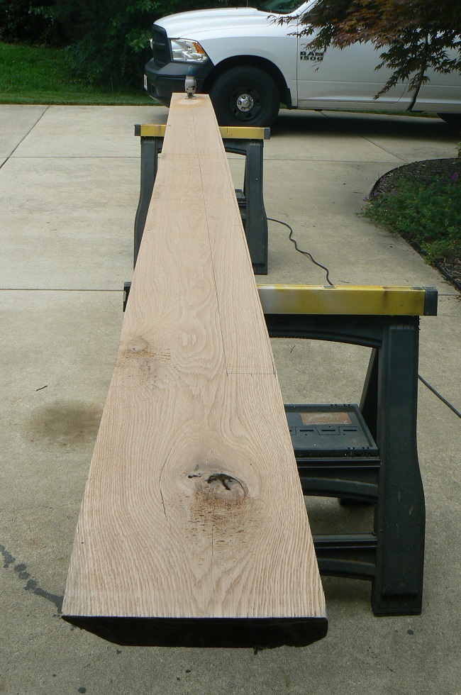

Now if it would just stop raining enough to get the new keel blank plained so I can cut it to match the old one. I also need to cut the new stem and foot.

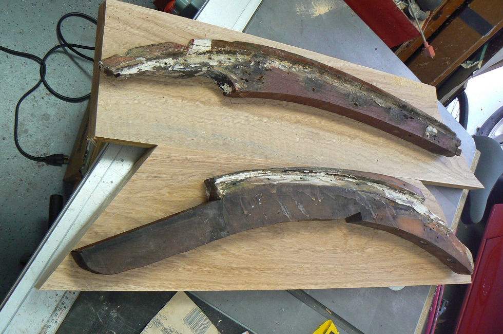

Here's the keel blank being cut.
Here are the stem and foot blanks.
Now I just have to sand the keel sides smooth, cut out the stem and foot, sand them and fit them then fit to the keel, CPES it all then 5200 the stem, foot and keel together and install.

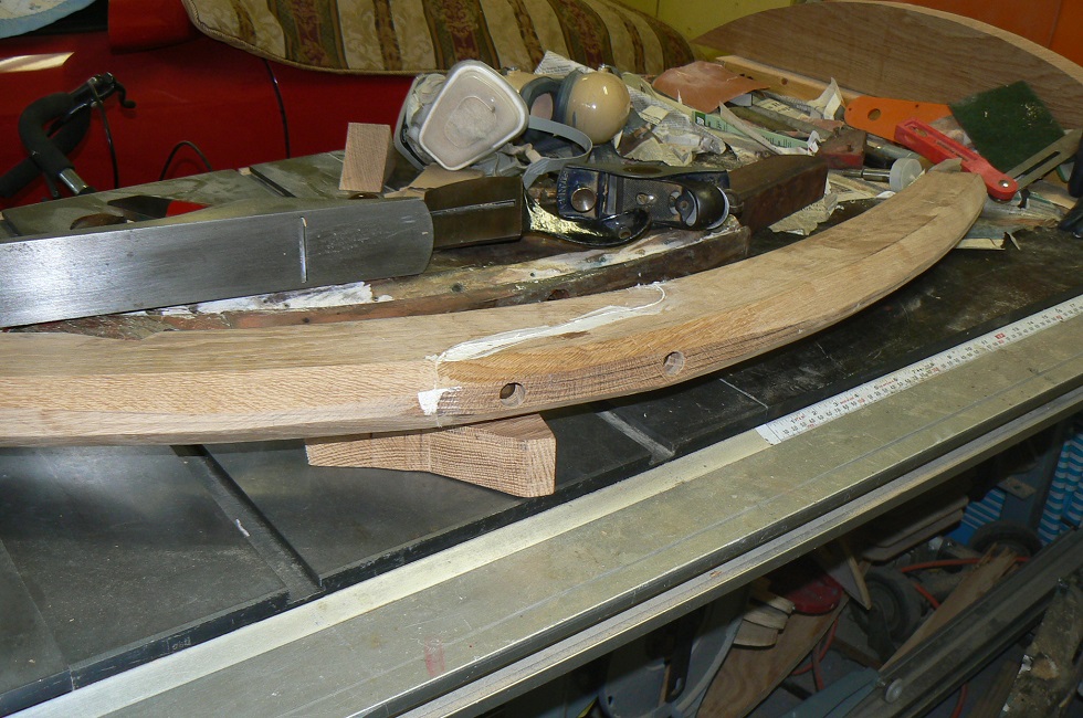

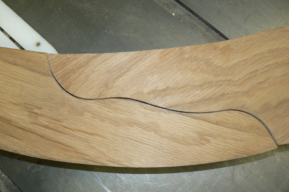

So I got the keel blank cut out and ready to attach to the stem and foot.
I got the stem and forefoot blanks cut out also.

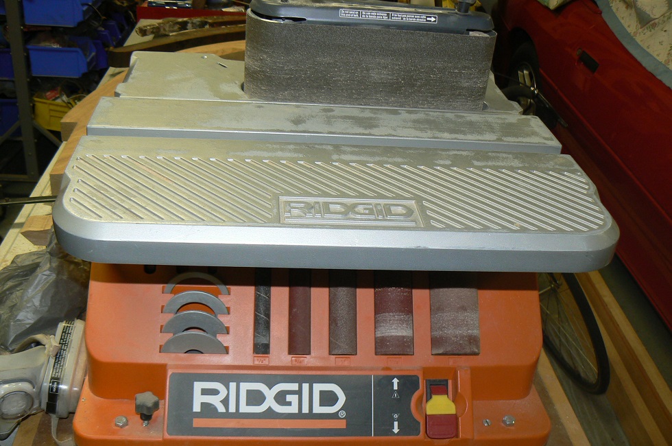

Also got the stem and forefoot cut out with the joint finished. I don't think I can get it too much closer than this.
The old Rigid oscillating spindle sander with the belt attachment made quick work of it.
Now to attach them and start getting it shaped.

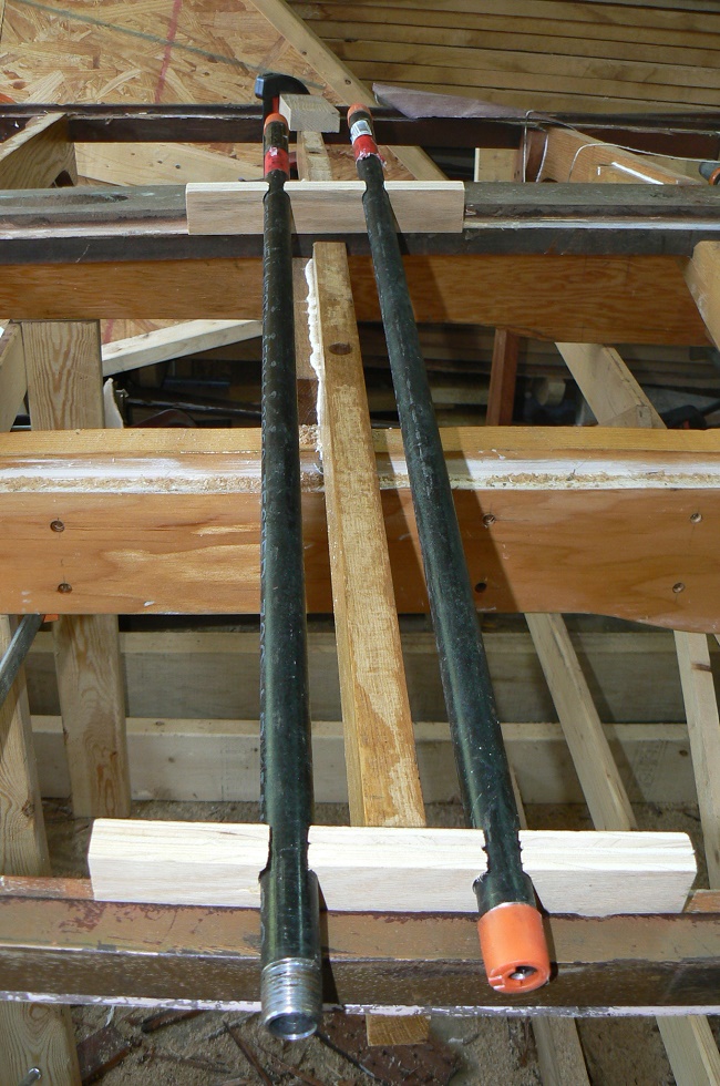

well ran out of the regular 5200 and my local Lowes doesn't carry the 10oz tubes of regular anymore, just the quickset 5200. So I got a tube of that, but have been told that it's not as strong as the regular and don't use it on the stem! Thoughts?
I was told this after I had already assembled it. I've gotten the keel carriage bolt holes drilled and fitted.
Unfortunately the chine blank is not drying like I had hoped. I coted all sides with a 50/50 mix of tung oil and paint thinner and it's still cracking. It's actually 10/4 x 8" x 19' so I don't know how deep the cracks are and if they'll continue before I can get to it.
Well we'll have to see what happens with the chine blank.

Well I finally got the 80hp working again so I was able to get back to the Resorter. I had to remake frame 1 1/2 since I did like the way it was fitting. I was able to get the stem/forefoot attached to the keel with the 5200. I was also able to bed down the keel and stem/forefoot into position in the 5200.
I'll rout the garboard plank beds into the keel once it dries, then on to the chines and battens.
