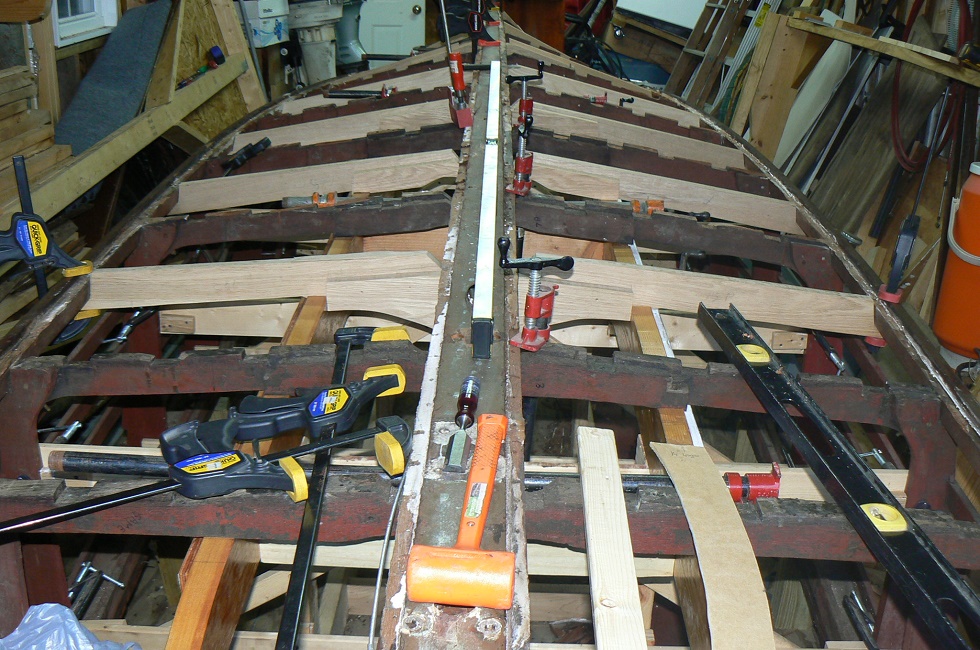

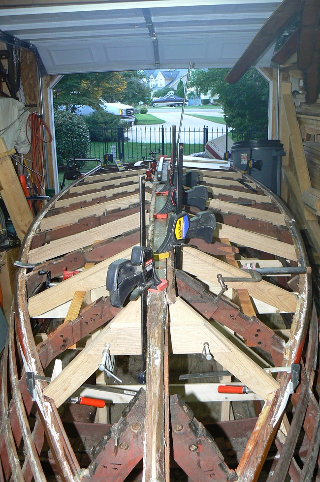

Well got some more work done. I got the intermediate frames out and the blanks cut. The old frames look like bananas, as well as the keel. I had to pipe clamp the keel/frame down to the frame supports to get it flat from the transom to almost frame number 5. It should be to about frame 4 1/2 so the keel will have to come off while I do all the frames and use a flat 2" square pipe I have to flatten it from transom to frame 4 1/2.
Now to get those bad boys cut out of the blanks.

Great progress Bob. Almost can smell the wood from here. Doesn't look like much room to move around in the work area. Tight quarters.

Thanks Cal. Yeah it's a little tight, but there's more room when i pull the cradle out. I plan on putting her on the cradle once flipped so I can mover her in and out easily.

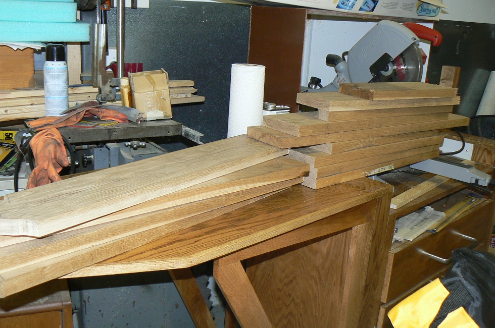

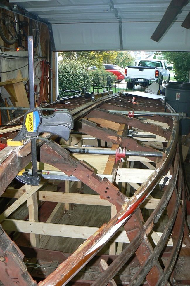

Well finally got the 80 hp running so I was able to get back to the Century. I got all the intermediate frames cut and fitted. Now I just have to predrill them for the 5200 assembly and CPES. I'll drill and CPES tomorrow.
Only had to remake two and one support. LOL Good thing I had some extra White Oak laying around. ;)

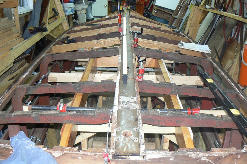

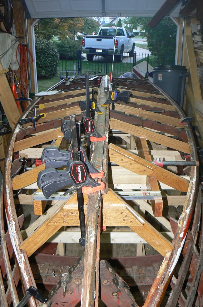

Well I haven't been sitting on my butt, I've actually been working on the boat. The intermediate frames are 5200'd in. Main frames 2 and 3 have their 2nd coat of CPES drying and I should be able to 5200 them in tomorrow. Then on to frames 4 and 5. Slow and steady wins the race. lol

Nice progress. Just getting the frames cut to fit is an accomplishment. Dontcha just love the smell of CPES. That stuff will kill ya if you don't ventilate outside.

Thanks guys, I got frames 2 and 3 5200'd in today. Now on to frames 4 and 5 tomorrow hopefully.

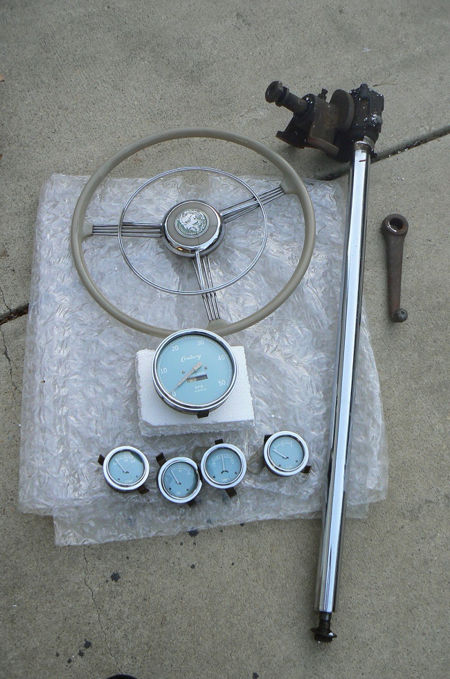

Frames 4 and 5 are in and it turned out to be an early Christmas:
All the stuff I needed for a good deal compliments of two fine Century Boat Club folks. Now unfortunately everything is on hold for a few days because apparently thumbs and 4tpi bandsaw blades don't get along!

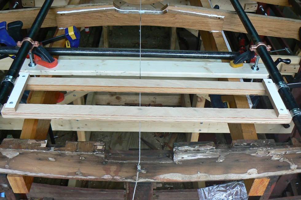

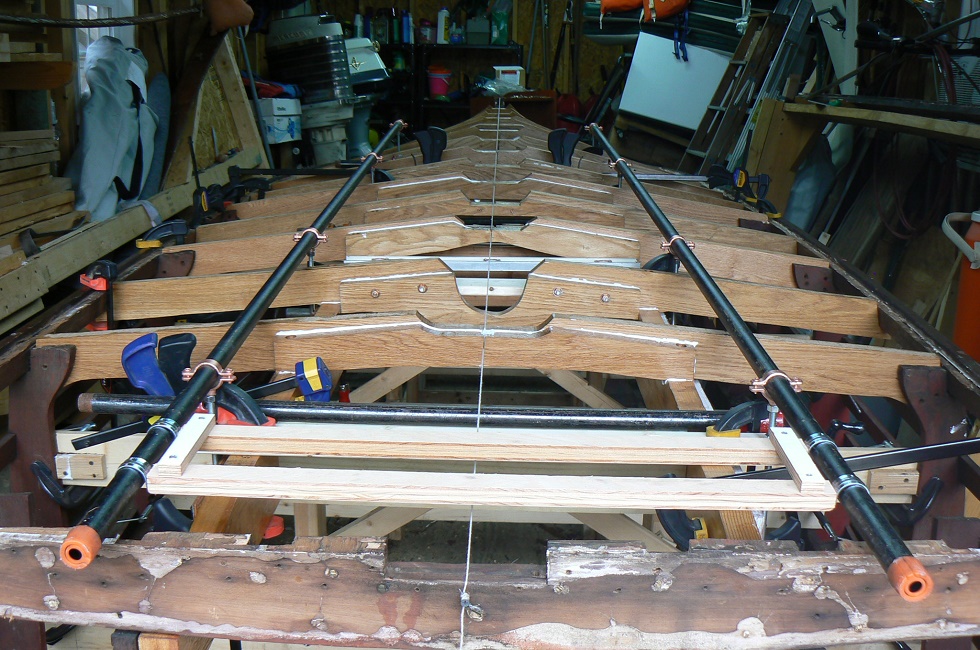

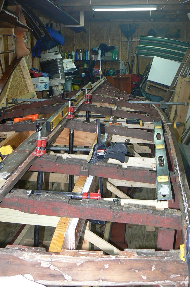

well it's been a little tough with the bad thumb but all the frames are in but number 8 1/2. I need to get a bigger board than the one I bought.
The keel bed routing jig is in and ready to go.

Lookin' better every day. Nice job. Have you figured how you're going to cut the battens in or are you going with a CC bottom? For my battens I clamped a board to the frame and used my router set to the right depth, 5200 and brass screws. Went pretty smooth.

Thanks Cal. Yeah planned on the board and router method. Still have quite a ways to go though. Once I rout the keel bed I can set in the old one, route the frames to correct height then drop in the new keel. Then of course route the new keel, then to the chines. Probably won't do all that until I get the upper frames done.
