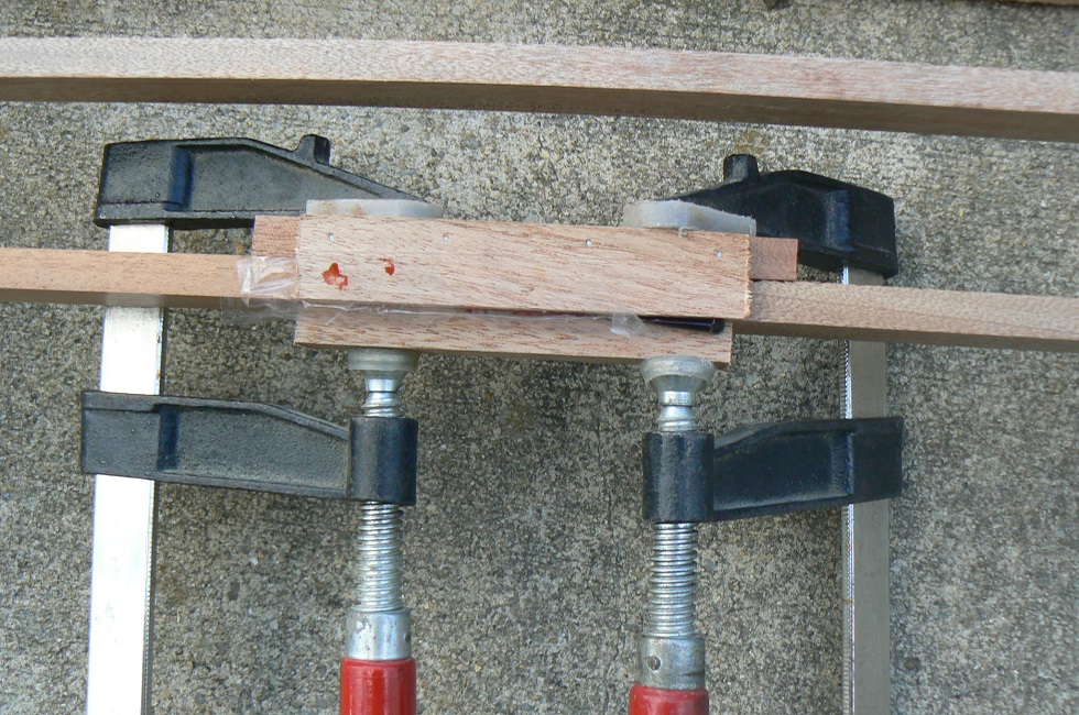

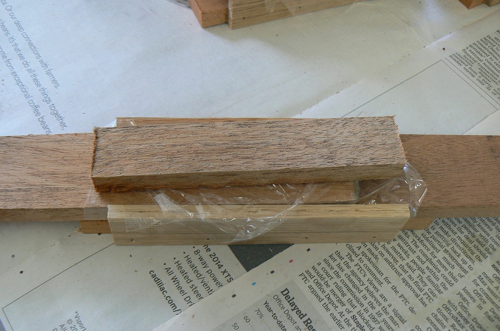

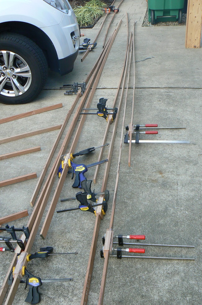

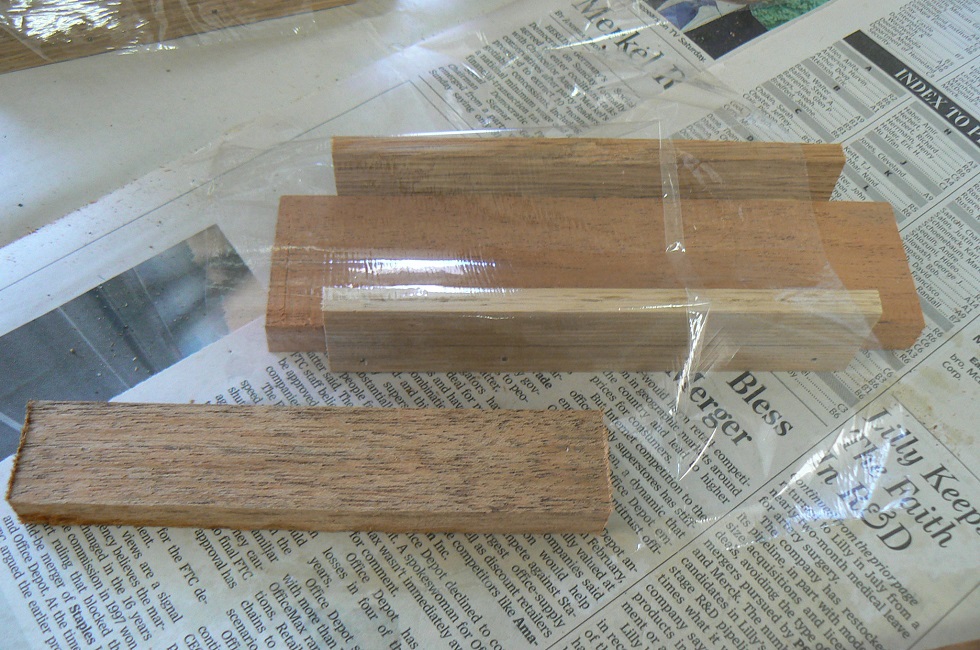

On another note what do you do with the left over battens pieces? Make glue jigs of course!
Gluing a scarf joint can be tricky since it's going to want to slide. i used the Resorcinol I had left. It's very slippery and I wanted to make sure the pieces stayed aligned and didn't slip.Make the clamping block longer than the scarf and clamp it at the ends and wala no movement.

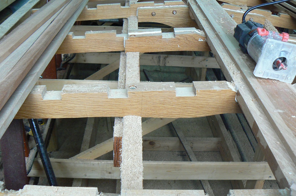

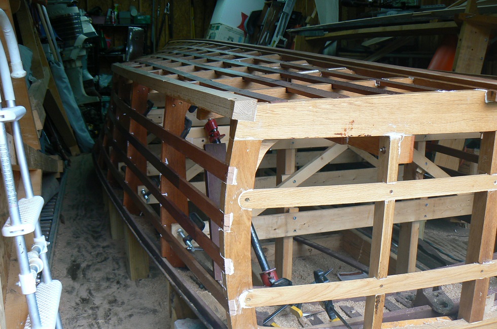

Well snow melted enough to get to the shed and the weather was 58 degrees today, Woo Hoo! So got the jig fence nailed to the planks for routing and got most if the routing done. Just have to clean up the port side now.
Just have to route the chine rabbets and then cut the batten notches.

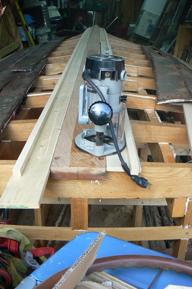

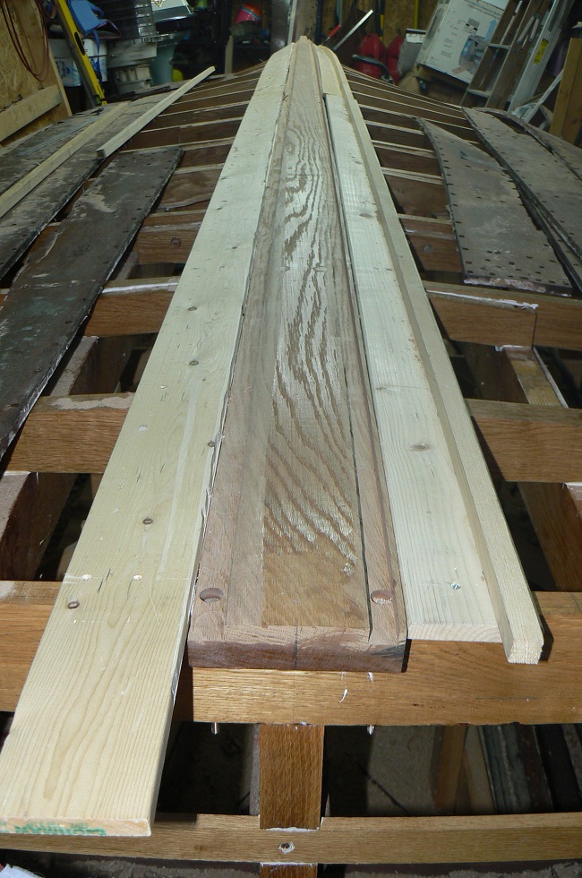

Well finally got most of the house prep done so I could get back to the Resorter. I got most of the batten rabbets routed out today, hope to finish the routing in the next day or so, so I can CPES the batten rabbets, the keel and the battens, then 5200 them into place.
Yes that's the Harbor Freight $20 trim router, works great.

Great work Bob. I can almost smell the oak. CPES, 5200, Brass screw combo, those babies will never have to be replaced again. The shaft strut with a centered sleeve sounds like a working solution.

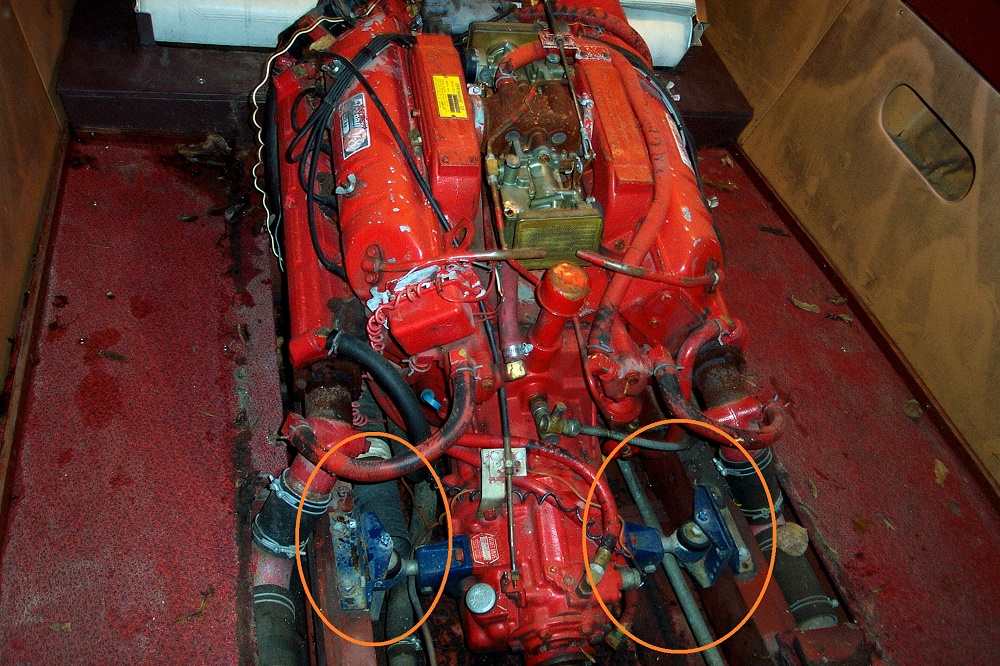

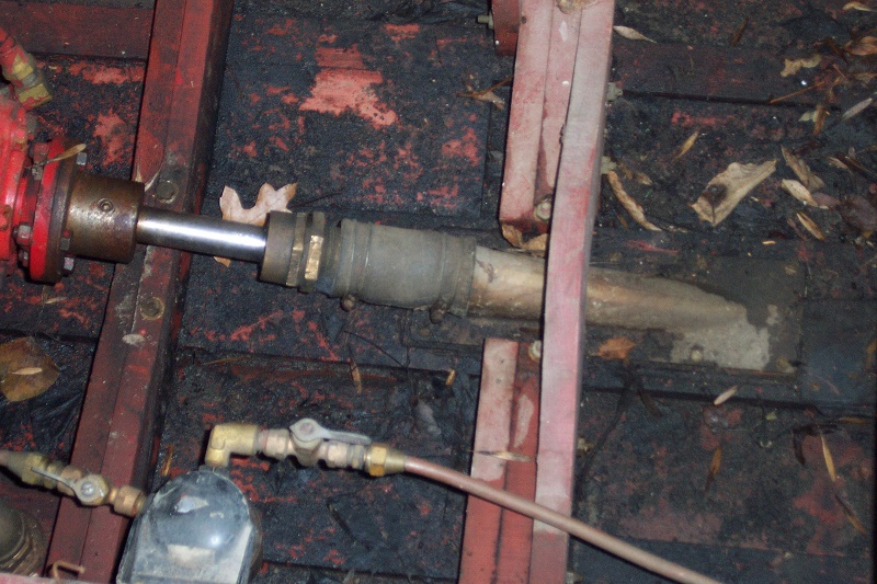

Hey Cal, I' assuming attach the strut long enough to drill the shaft hole then remove it so the hull can be flipped?
Re:'53 18' Century Resorter finally 10 years 7 months ago #120939
Bob, I've been thinking about that and yes remove the strut after the hole is drilled. Put the strut away in some hiding place that you will forget, you know the safe place where you will find it?? As you advance to the point of engine and transmission installation this is what I would do to make sure everything is lined up correctly. First bolt/screw the bilge (inside) stuff box so it's lined up with the hole. then set the engine trans combo connected to the prop shaft in place but not bolted down. I would then adjust the engine/trans position (makes it sound simple right?}actually rassle the thing around until the shaft lines up straight in the hole and has plenty of clearance and then shim or whatever you need to do. The sabre 327 rubber mounts were lagged into the heavy white oak. Make sure you have the packing nut in place also when you adjust the motor position. If it's off a fraction the shaft will rub on the packing nut and get hot...don't ask how I know that. (gradually wears the brass nut)
After those are fixed permanent then lay on your sore back and line up the shaft strut, drill the holes and seal every thing up with 5200, run the brass bolts. Temporarily install the prop to get the distance away for your rudder, make sure you have room to remove your prop without removing the rudder. The sabre was god awful - could not remove the prop without disconnecting the rudder :angry:. And finally don't forget to install the protective brass plate/sheet above the prop to prevent turbulence from eating away all you new fresh mahogany. I've got pictures if you need some reference.
These pics were before I started the tear down many years ago. There was no adjustment on the front motor mount some limited up/down and sideways on the tranny end.

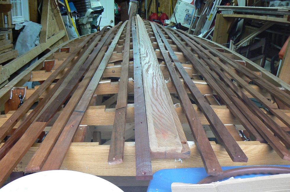

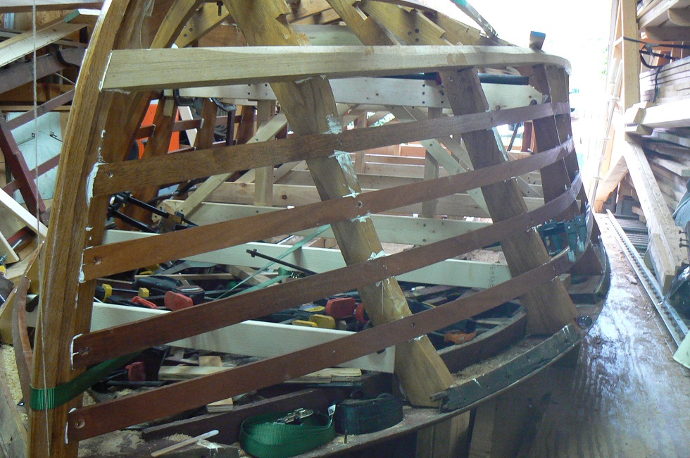

Ok so I haven't been totally sitting on my a$$. I got the battens cut and laid in for steaming. I steamed in the ones that needed it and they're drying. As soon as they're dry I can CPES them and 5200 them in.
I still have to redo the chines but the Amish guys haven't cut my blank yet. Could be another week or two. I have a felling they don't want to do it but won't tell me no. I hope not cuz I'm nut sure where the hell else I can get a 3"x6"x19' white oak blank from.

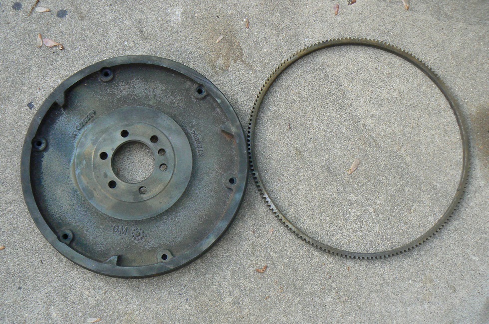

Also I've been removing rust from some engine parts using the ole Dollar Store "The Works" toilet bowl cleaner bath. Darn stuff works great! Let it soak over night and removes it real nice, only problem is you have to get it out, rinse it well and coat right away or it will start rusting almost immediately. Anyway, I put the flywheel in the bath yesterday and removed it today to go through the clean up process and got this when I took it out of the bath.
I hasn't been dropped so apparently there was a crack there that wasn't obvious and the rust holding it on is gone so....... I guess it's a good thing this happened instead of it flying off while the engine was running. It's Flagship flywheel forward and could have gotten ugly coming out around the housing mount and into the front seat or through it!
The crack was not where it was originally welded when made. So do I get this welded and fit back on or just buy a new one? The crank and pistons have been balanced.

Check this out for your ring gear Bob. They are replaceable. Don't know if I would want to have it welded, the teeth could bet misaligned.

Great stuff thanks Cal. I talked to the guy who did my engine block and stuff and he said he can order me a new ring gear and help put it on. He has an oven he uses to straighten heads so I don't have to use the Admiral's oven. ;)

Hey I actually was able to CPES the battens with one coat today, Woo Hoo!!!!!! Hopefully I'll be able to bed them in next weekend.

Ok all the battens that aren't touching the Chines are bedded in the 5200. Now I have to wait until I can get the chine blank to make the new chines. It's been so rainy and wet here I don't think the Amish mills are cutting.

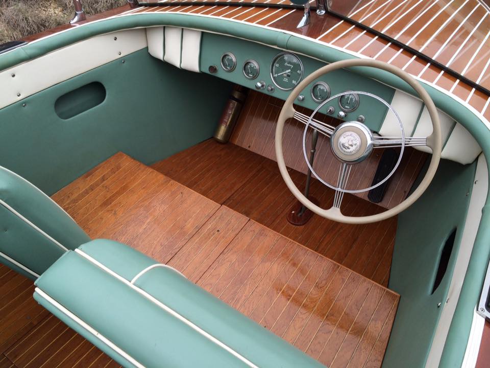

I'm thinking of making my interior the Seafoam Green and white vice the red and white that it probably came with. When I removed parts from the interior I saw a small piece of old red vinyl. I'm not a big red and white so..........
So those who know Centuries know that isn't the correct floor but pretty darn nice. I'll be sticking with the original rubber/vinyl ribbed matting, but after chatting Wednesday Jan (Nautilus)inspired me. Since I can't seem to find the original Flagship green color for the motor and don't want to lift the velvet drive into the truck, I thought why not use the sea foam green and white on the engine to match?!?!?!
Thoughts?

I like it! Shows you're not standing in the same long line of red/white. A couple of removable seat cushions same color.
Re:'53 18' Century Resorter finally 10 years 5 months ago #122403
Well Bob,
Here is my take on it ? If you are looking for trophies at judged shows ? you are stuck with red and white. But at the cost of you not be being totally satisfied with your boat ?
This means you’d be more likely to sell it rather than keep it ?
Also you have to think of show goers . They walk down the dock at a show, and say in their mind, as they walk past each boat, red and white century, red and white century. red and white century.
OOOOOOO Sea foam green century, that’s nice ! I think the only people that would ever call you on the color are obsessed purists or judges ?
I can tell you’re not the kind of guy that is going to radically change the style of the boat, with an over powered engine with side pipes and stacks, with fart can mufflers, a wooden wing with monster speakers hanging off it,
A set of hi intensity LED digital gauges, Or a spinner hubcap for a steering wheel ?
You just want to put a little flare on YOUR boat, and for the fact that this boat is not the last of it’s breed, and does not have the historical legacy of wiping out the entire enemy fleet during the war.
I say make your boat with the subtle flare upgrades that you want ! I highly doubt you’d have any resale value loss because of your choice of color that makes you happier ?
Lastly, your entire family will know that is your boat, no matter where it ends up, not, "My relative had one that looks just like that"
Just my opinion ?

Thanks guys. Sorry should have been more clear, actually the Seafoam Green and white were one of the color combo choices that that year so it would still be fine just not what was probably ordered on this particular boat.
That seat is actually wrong it should have a full cushioned bench bottom, I just used that pick because it was the color I'm thinking of.
The big question is what do you think about painting the engine the Seafoam green and White to match the interior. I'm already going to take a hit for the engine since it's not one of the original 4 cyl or 6 cyl, it's the Owens Flagship V-8 with 350 block. Sorry Chuck, just a little more power than original. ;) The boat already had that motor when I bought it.
I can't match the original Flagship Blue without draggin the velvet drive to the paint shop to get it matched so I thought why not go with a Nautilus inspired engine color combo? Ideas?
Re:'53 18' Century Resorter finally 10 years 5 months ago #122432
Well then, that seals the deal !
not the original size engine, you get dinged by judge for that.
So color doesn't matter now ?
right ?
I'd match it to the interior color. It'll look sweet !
