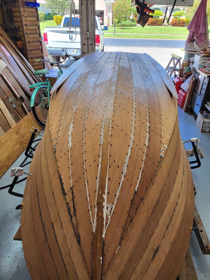

That's why you leave a little over a nickels thickness of 5200 between the planks and not butt them up. It's all encapselated in CPES which should also help minimize wood movement.

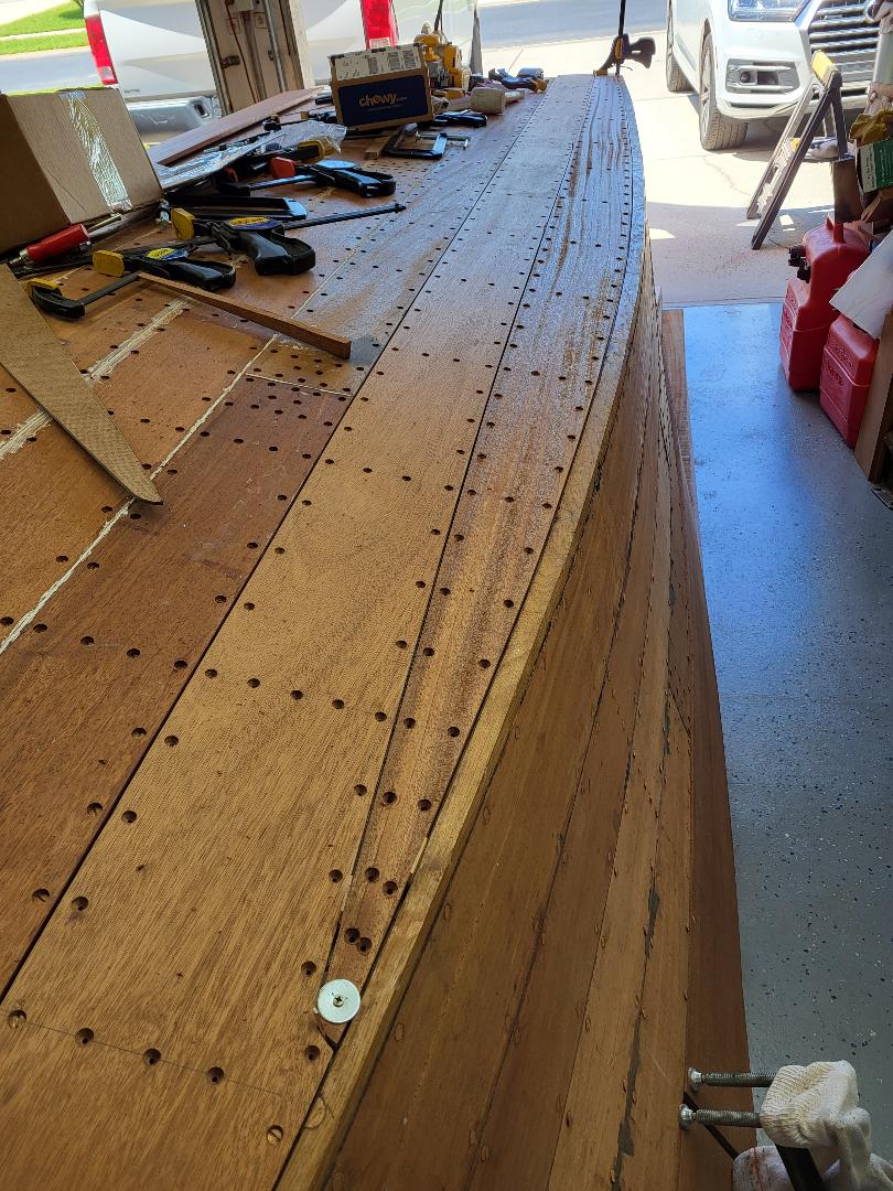

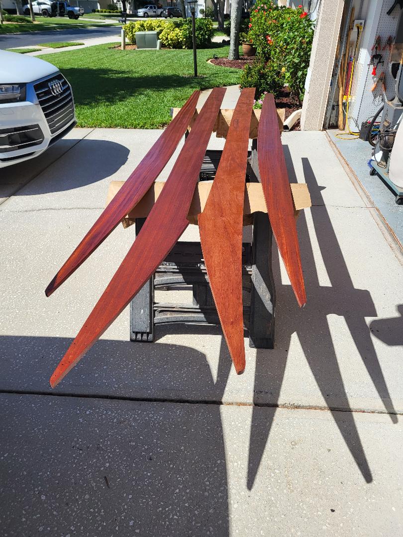

Ok so bottom just about completed finally. The one is of the 4 planks with 2 coats of CPES on them after fitting and drilling the screw holes. Once those are dry I can bed them in 5200 and begin the fairing once the 5200 is dry.

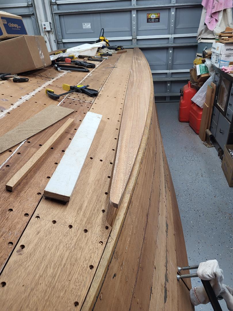

Woo Hoo, the last planks have been bedded down and now for the sanding......................well next weekend after the 5200 dries.

Thanks Cal! Yeah I'm thinking I'm going to use the 6" random orbit sander with 60 grit to bring it all close to fair, switch to 80 with it, then go to long board with 80 and 100 and see how it looks. I was debating on going original racing bronze but may be leaning to a a good 2 part poly matched to the bronze so it won't change over time. Jim West does it to all of his Restorations.

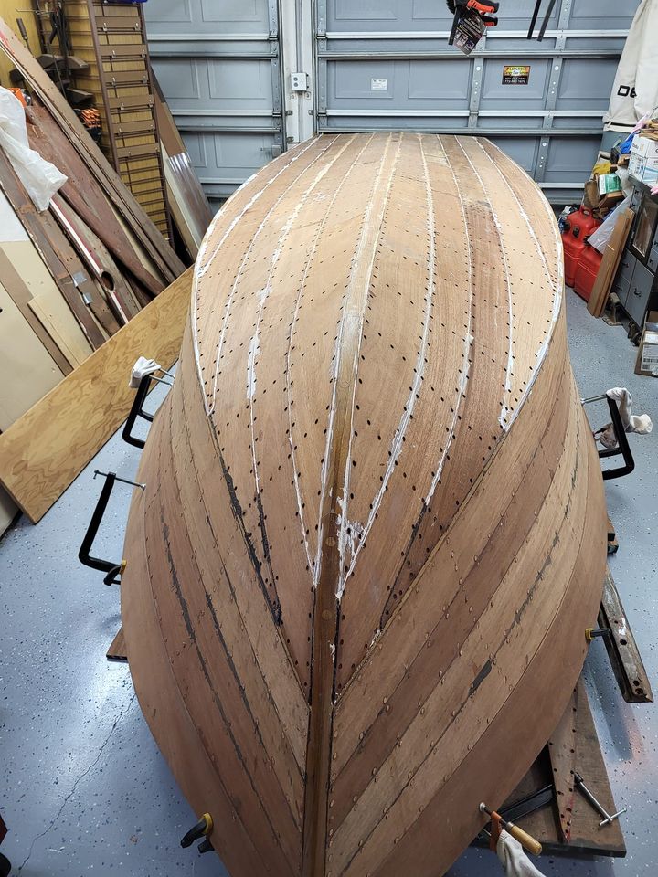

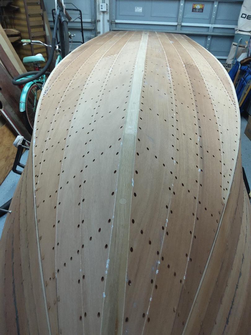

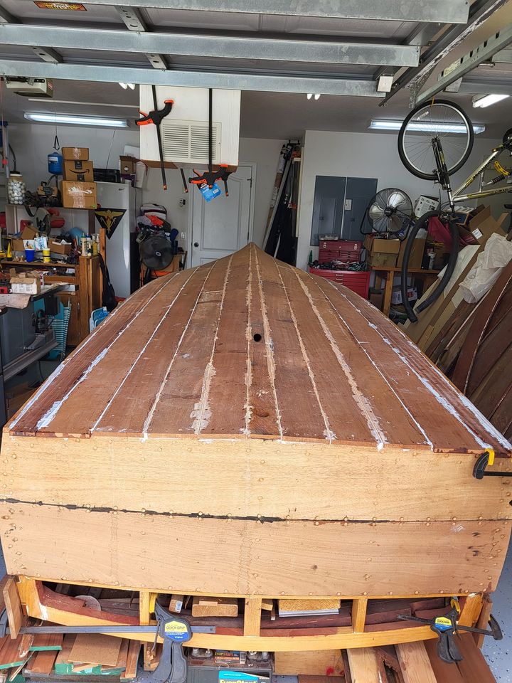

Well the bottom is faried and started filling the 1,500ish bottom screw holes with Famowood, woo hoo!
'53 18' Century Resorter finally 4 years 2 months ago #146881

Yeah, that's what most of the club guys are using. Thin it some and it fills fine. It will be under 3 coats of 2000e and 3 coats of bottom paint.

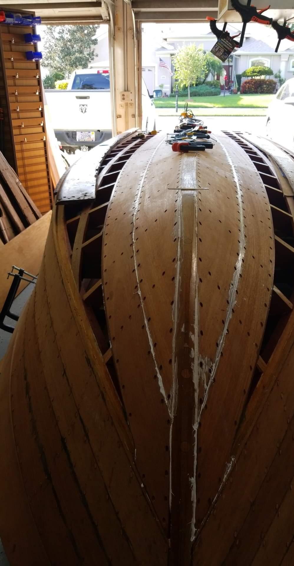

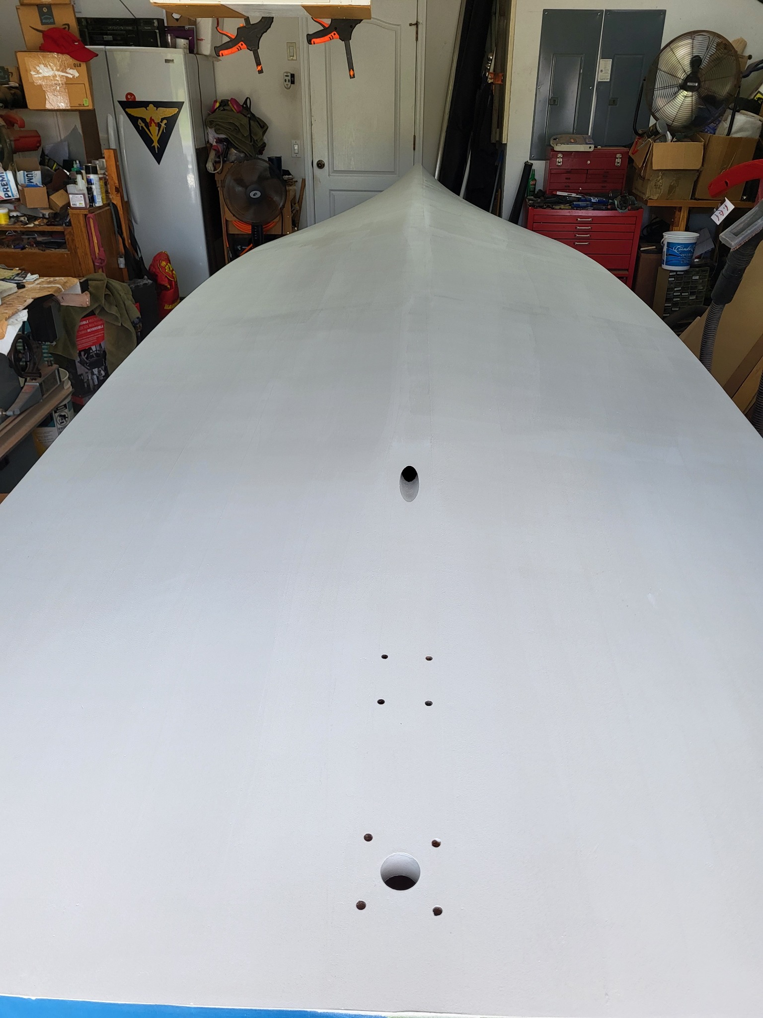

Bottom on, screw holes filled and 4 coats of primer. Now to sand and paint

Just curious....what does the hull weigh at this point? How are you carefully moving it? Turning it over? ...... always interested in others methods of work
'53 18' Century Resorter finally 4 years 2 weeks ago #147203
  • Waterwings
  • Waterwings's Avatar Topic Author
  • Posts: 4902
  • Karma: 107
  • Thank you received: 100
Good question, I'm guessing probably around 700lbs maybe. She's probably going to be over 2000lbd once done with the engine in. Since I can not put the shear planks on I'm going to have to flip her a little differently.
I can't put the shear planks on because I need access to the inner batten that the upper deck frames will attach. Normally the upper frames would have been done already if built from scratch but I flipped first because I thought I only had to replace a couple of bottom planks. LOL
Anyway my plan is to basically build a "crate" around her and roll it on its side then top which will be the bottom down when done. I'll take lots of pics. I only have one gantry and by the time i make another, get the long pipe etc, to raise and roll it in slings, it will just be easier to crate and roll.

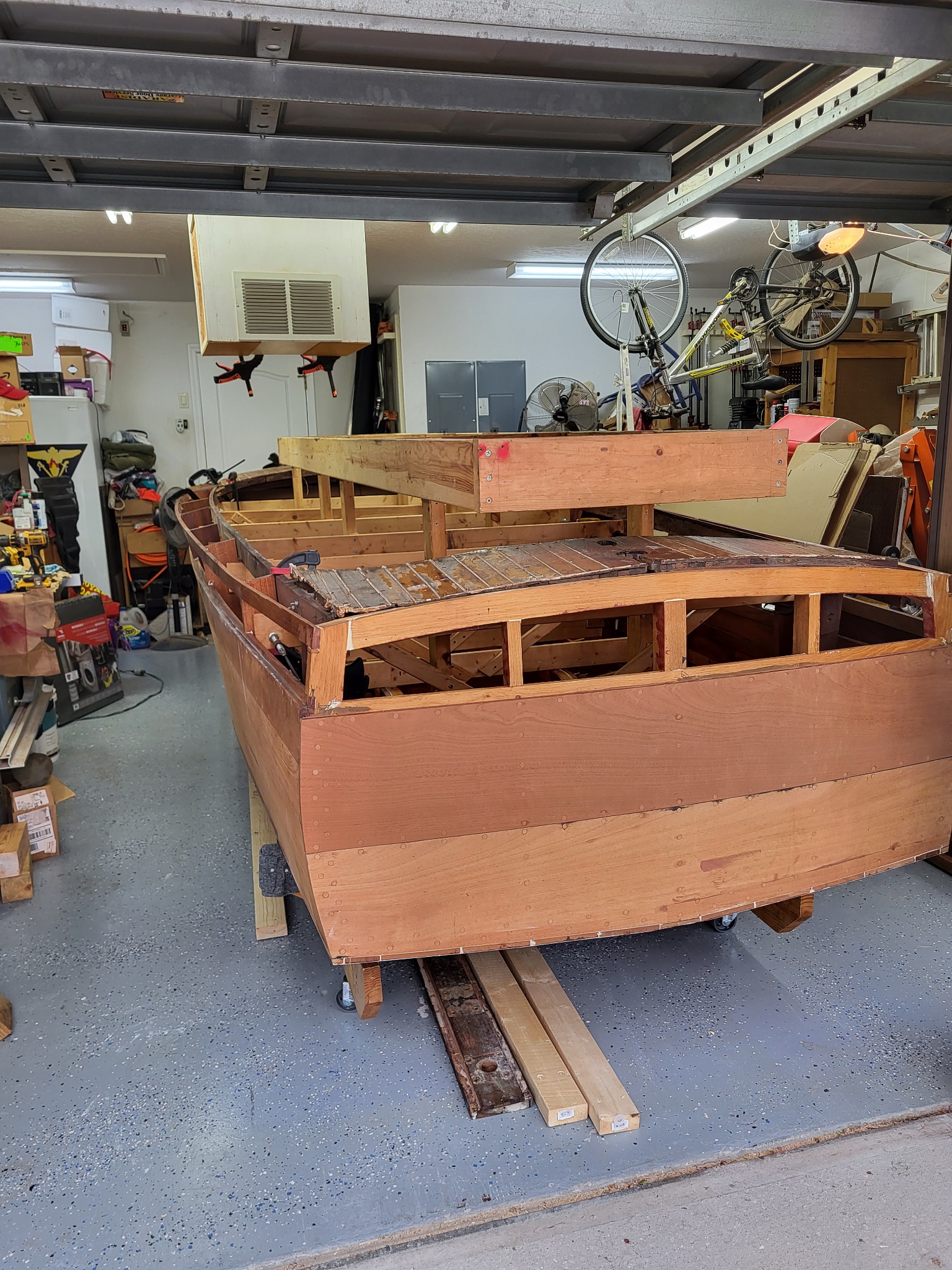

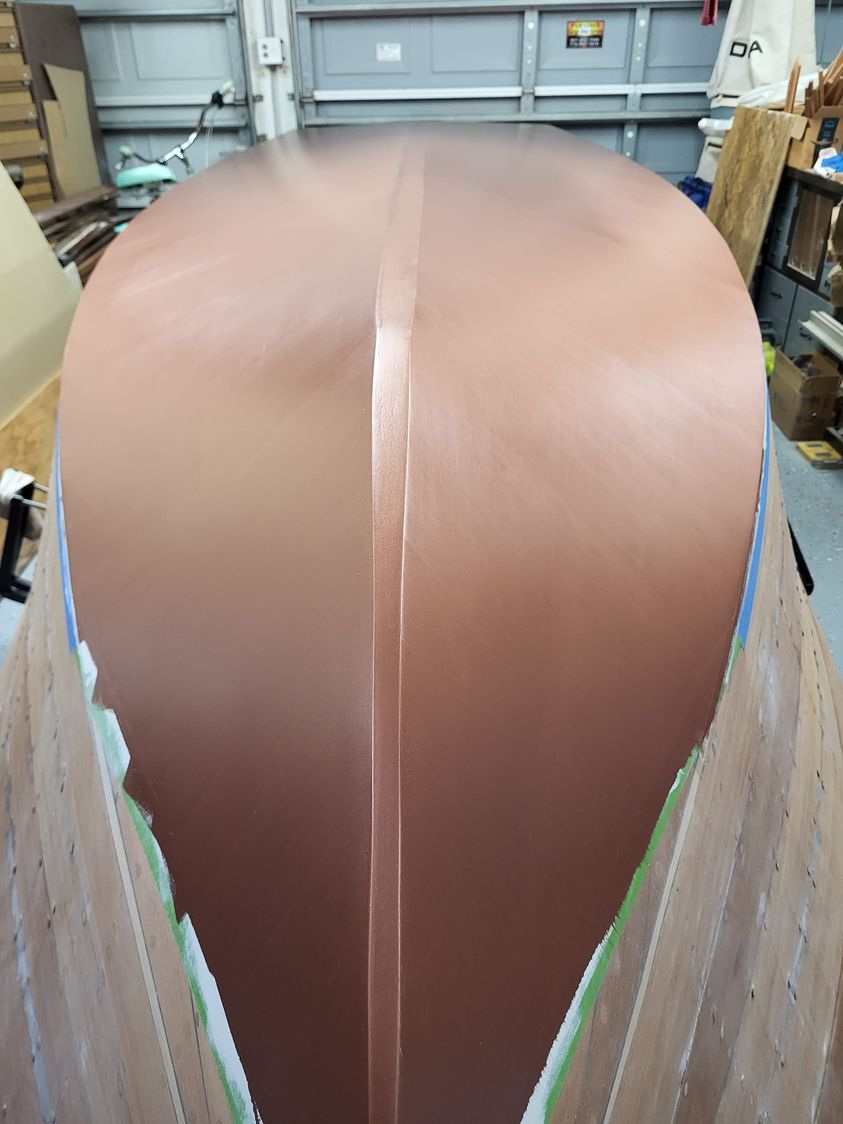

Got the first coat of bottom paint on the Resorter....hey there's a boat in my garage!
'53 18' Century Resorter finally 3 years 11 months ago #147295
Who wudda thunk it would ever get this far. Great to see you back in the game. Fantastic job Bob. Flipping is a job best left to neighbors and beer, old tires and old mattresses. Just make sure you have the inside cross braced "X" with 2x4s. At this stage you sure don't want it to twist. I used sky hooks, pulleys, lawn chair cushions and ropes, sweat and prayers.

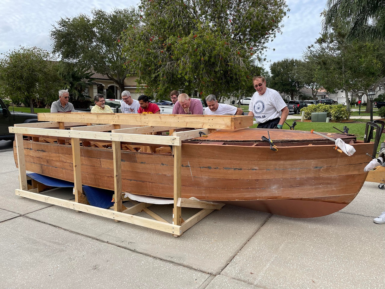

Yeah nine and counting. LOL. I'm actually going to build a "crate" around it to flip it. The inside bracing is actually all 2x4's, when they were cheap, so I'm going to fasten 2x4's across thd 2x4 uprights, then tie them fire and aft. Use 2x4's angled against the bottom to hold in place. I'll take a bunch of pics. I can't just roll it with the sheer planks not being on.

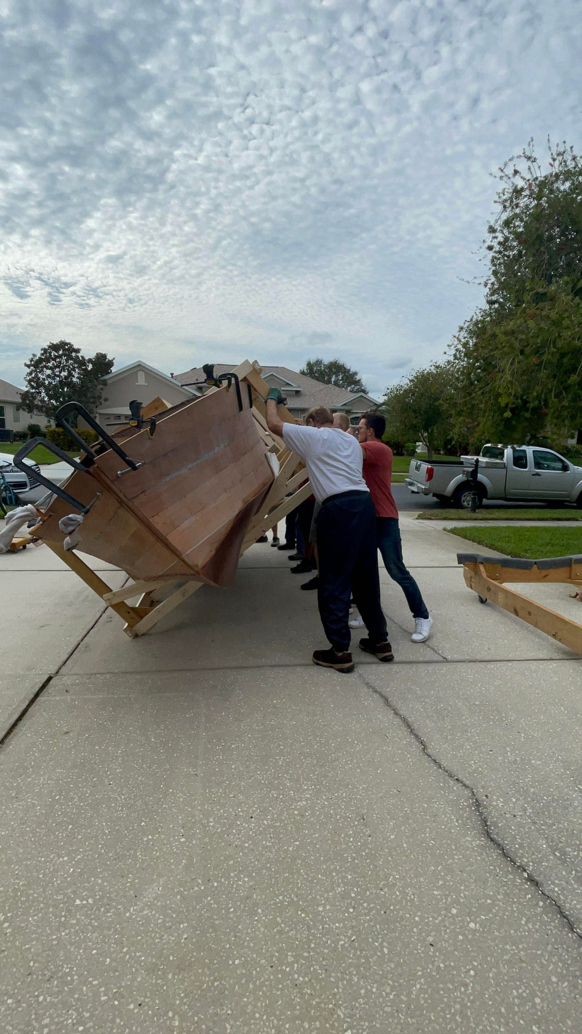

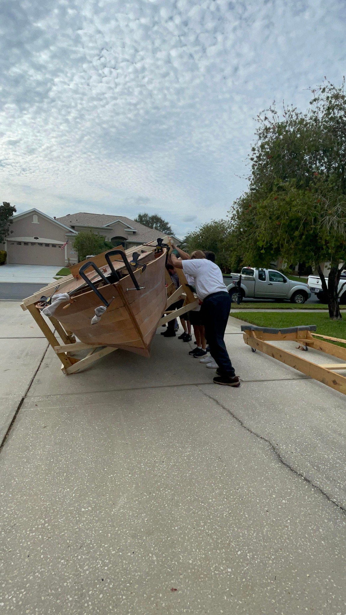

Well it was finally resorter flipping day, Woo Hoo! The flipping crate worked great and it was cheaper than building anpother gantry and getting anothe chain fall!
'53 18' Century Resorter finally 3 years 10 months ago #147378
Gotta love it when a plan comes together!!! B)
CC-John
1973 Century Resorter 16, 225HP Chrysler LM318
1978 Chris Craft 251 Catalina Express, 330HP Pleasurecraft 350 (383 Stroker)
'53 18' Century Resorter finally 3 years 10 months ago #147379
Terrific! Now you can put an upside-down pail in it and pretend driving :-)
Lotta beer involved there with all the help. Looks great Bob.
'53 18' Century Resorter finally 3 years 10 months ago #147381

Thanks guys, yeah beer and pizza afterwards. :) Still a loy of work to do but she's getting closer. Now there's enough work to do inside so I can keep working even if it's raining outside. Still too packed into the 3 car to be able to cut frames and planks without using the driveway. :(
'53 18' Century Resorter finally 3 years 10 months ago #147382
Great job! Truly appreciate a clever, simpler solution that gets the job done without drama.

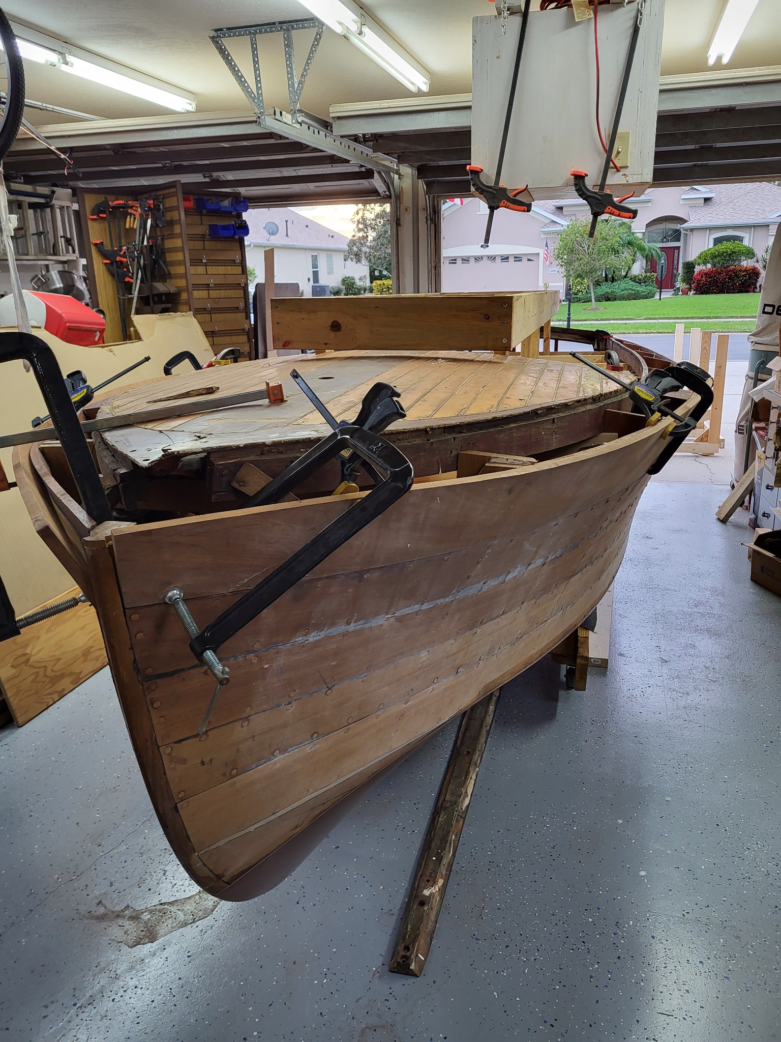

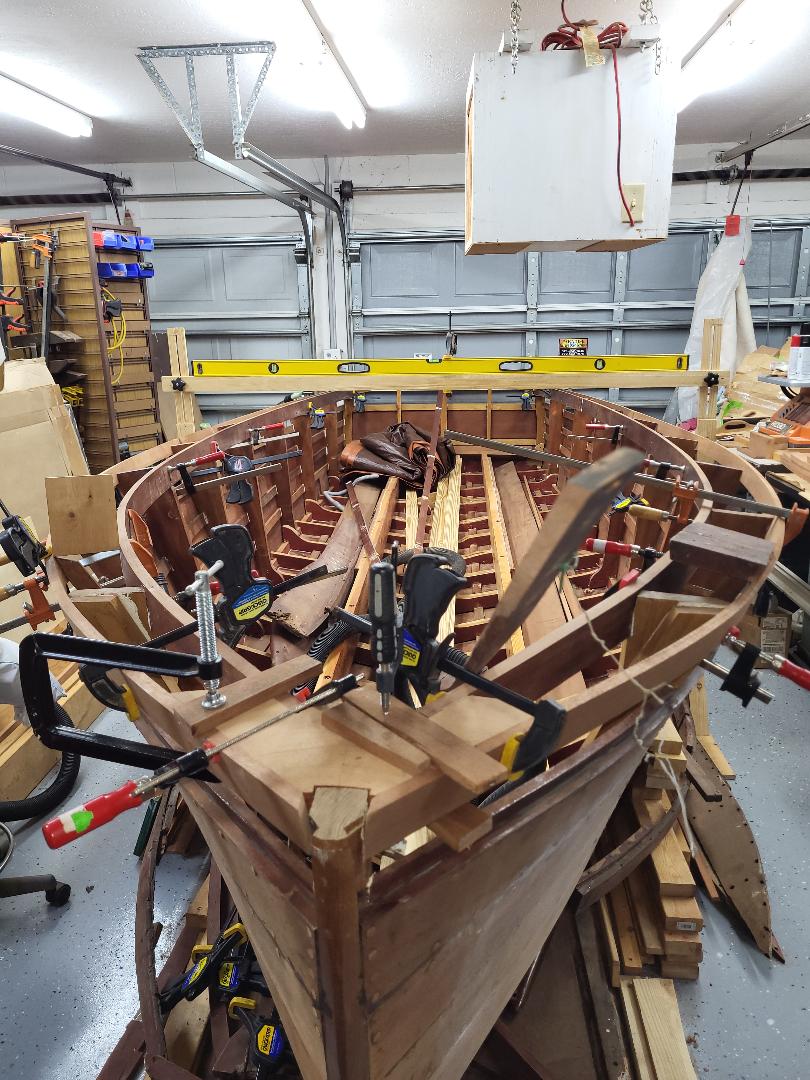

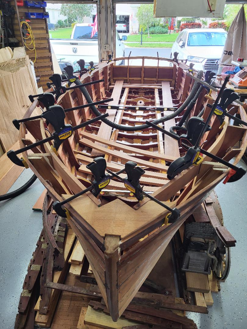

So I got the deck frames roughed out and the hooks steamed, clamped and drying. Once they're dry I'll CPES them and get them attached.
'53 18' Century Resorter finally 3 years 7 months ago #147680
OMG do I see ice forming around the edges of hell?
Looks really great and thorough. Almost taking the same amount of time as the 85hp rude project :)

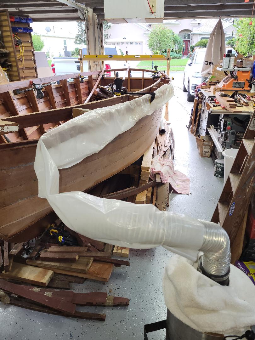

wow has it been that long since I put an update!?!?! Ok so I have been working on her just a lot of life evnts have been stalling progress. Anyway I got the hooks in but i had plane the port one a little too far and had to repalce it. then discovered I really should ahve made the sheer battens 1 3/4" vie 1 1/2" so now sheer battens it was. They're cut and resorcinoled to make 18 footers. Steamed and clamped them today.
You know it sat too long when the other boat cover ended up in there! LOL
