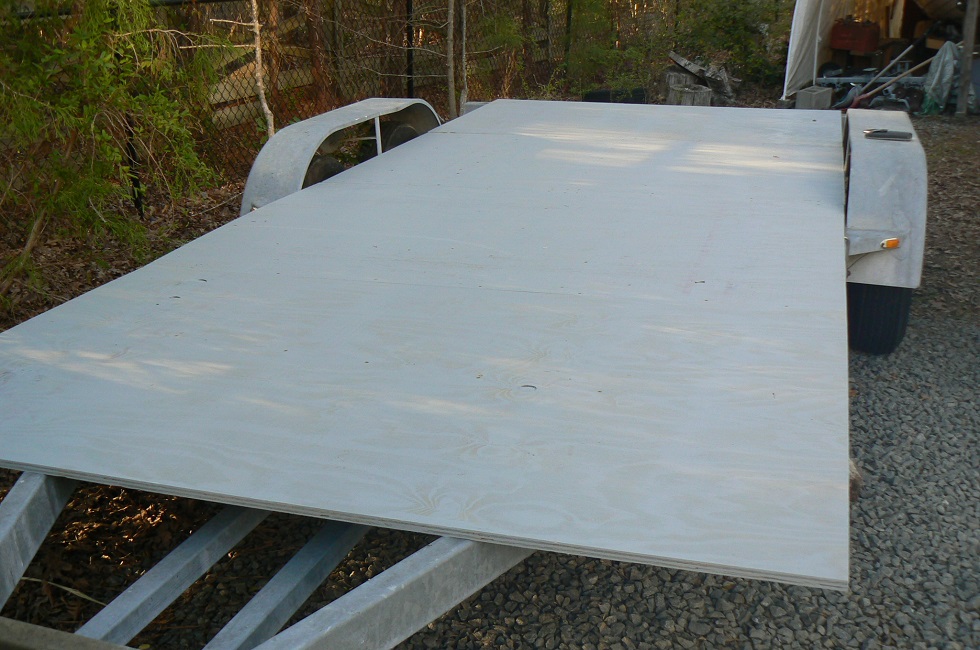

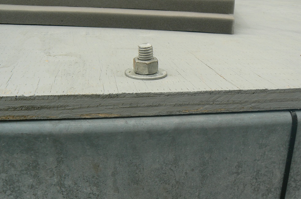

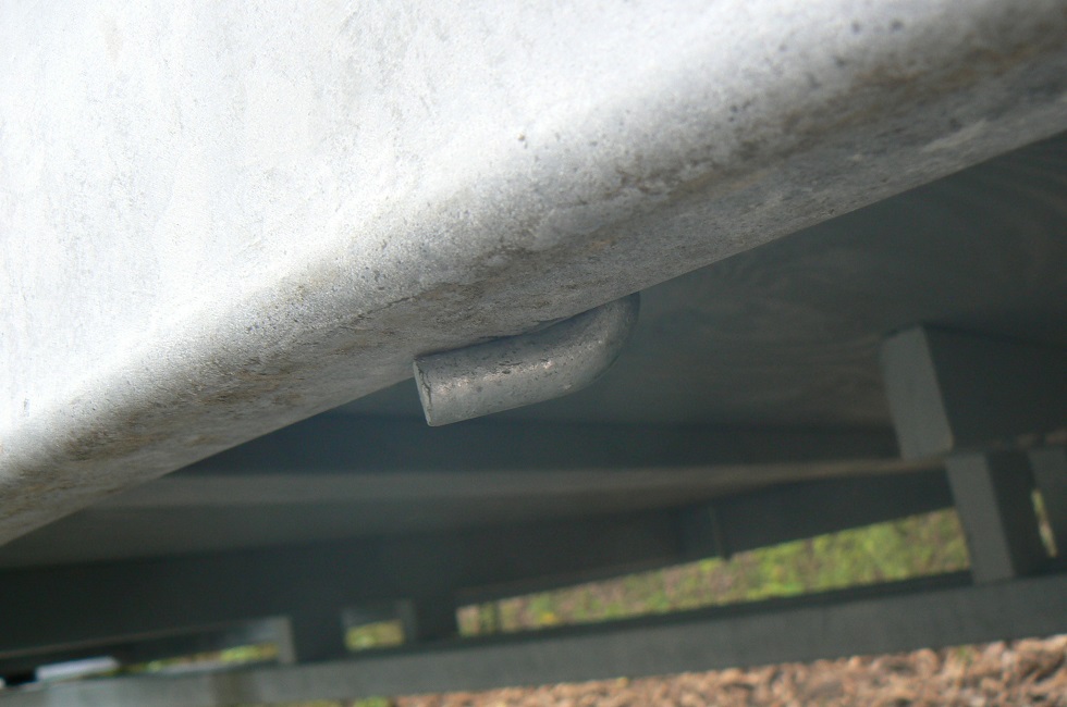

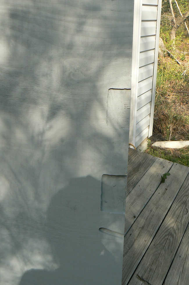

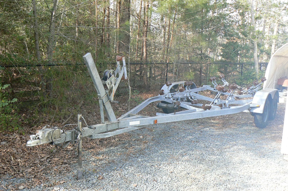

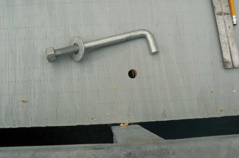

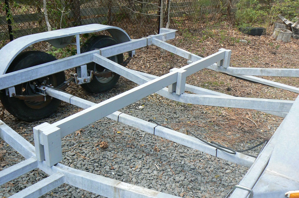

Sorry haven't posted in a while but haven't been sitting on my a$$. Here's how you convert your trailer to a flat bed. Here's the before pics'
Here's the progress.
Notches for the supports that are bolted on the trailer.
Now the rest.
I forgot to take one with the hold downs bolted on but I think you get the idea. The decked shot is before the hold downs I just left it for last since I didn't have the other pic.

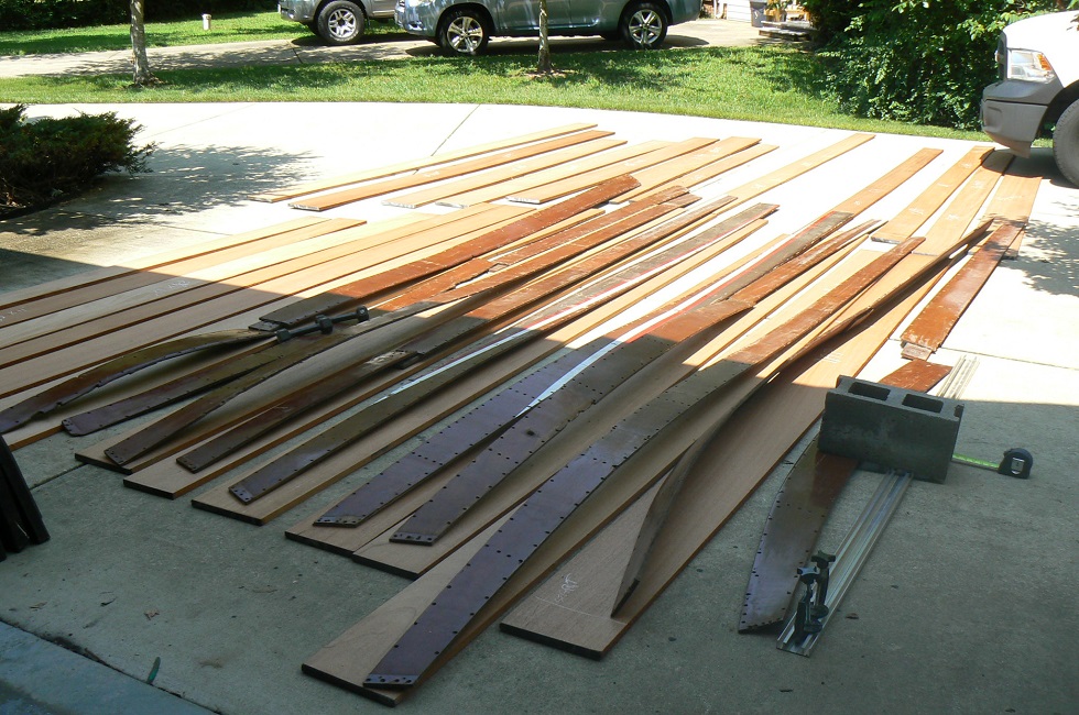

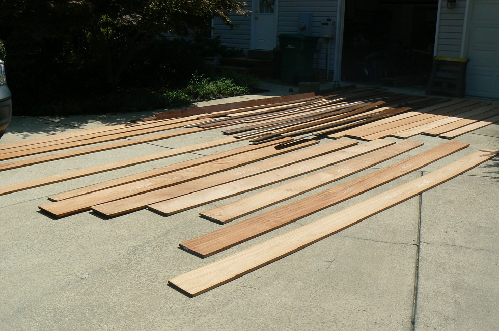

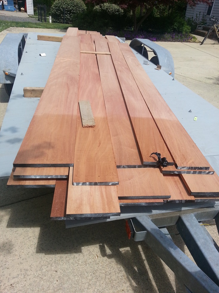

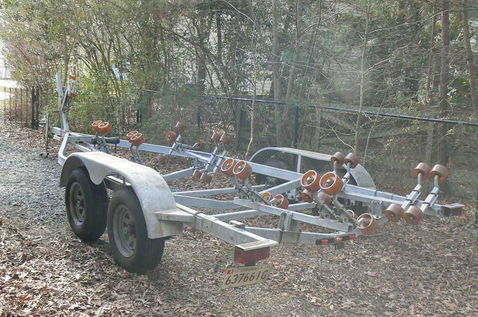

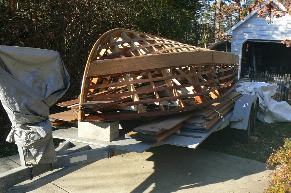

Here's what it looks like when you pic up your Mahogany and it's on the trailer.
Yeah I know most of the weight is on the front axle but I was only driving two hours so I wasn't that worried about it.
This is what it looks like unwrapped.
Problem is it wasn't all there! They forgot to give me the 5/4 covering board blanks because they were not by the milled stack. I didn't think to ask , just figured it was all under the wrap. No biggie, one call and it's being delivered on Monday! These guys were great would use them again in a heart beat.
'53 18' Century Resorter finally 9 years 6 months ago #131469
Glad to see that "new" trailer earning it's keep!! :laugh:
That last pic is some serious wood porn right there!! :whistle:

Beautimous. Are they all resawn? When I picked up my mahogany the planks were 2" thick and then I had to have them all resawn. Getting closer to the glue and screw.
'53 18' Century Resorter finally 9 years 6 months ago #131478
  • Waterwings
  • Waterwings's Avatar Topic Author
  • Posts: 4902
  • Karma: 107
  • Thank you received: 100
Well funny story. I decided to not go with the 6/4 since it would be a pain in the a$$ to resaw a 7'-10' wide 16' board on my 14" bandsaw so I went with 4/4, however they didn't have enough 4/4. I had to buy 5/4 but he milled it down to 3/4 at no charge! He said he would take it down to 5/8" but I was afraid if any of it had tear out it would end up less than 1/2" so we decided 3/4" and I could walk it down form there on my planer. Love that place great to work with

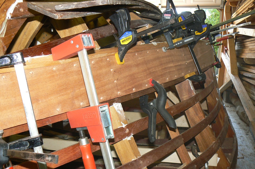

Ok did some more to the boat mover but also got at the Resorter again finally. The Chine planks are finally fitted and drilled but I only have cold weather CPES formula so I had to order the warm weather formula before I can CPES them and 5200 them into place. Ill eb out of town most of the week so that will be next weekend.
'53 18' Century Resorter finally 9 years 1 month ago #134107
Lookin' good. Lots of clamps around those compound curves.

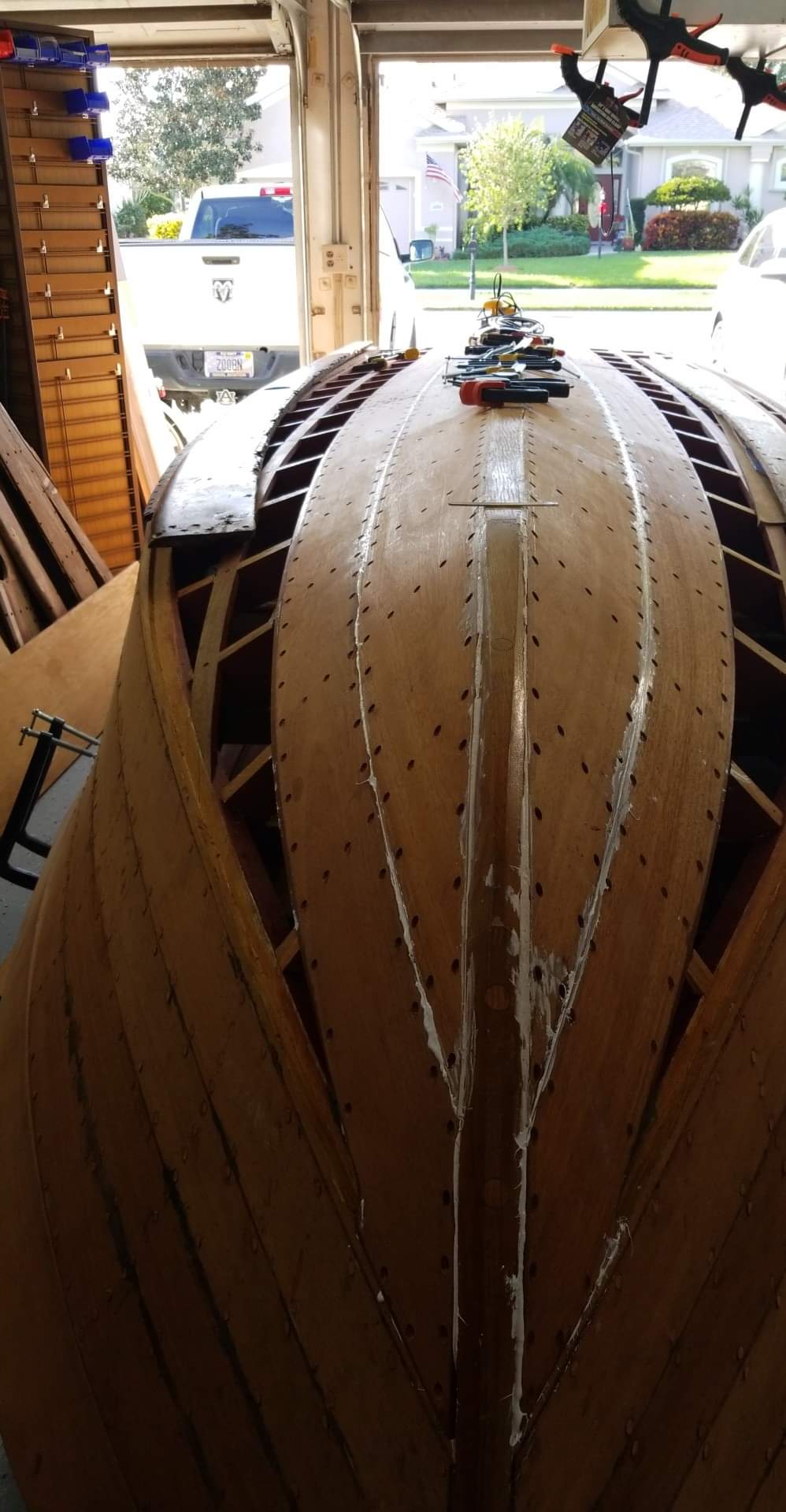

Holy crap has it been a year since I've posted!!!?!?? Sheesh, so I have been busy just haven't been posting so sorry! I know it probably doesn't look like much but the planks are coming along. Just steamed these two bow ones in since it's a multiple bend area, if I want them flat against the batten's, needed to get steamed. I'm hoping to get the full uppers done by January 22nd, have to have rotator cuff surgery on the right shoulder so won't get to do anything for 6 weeks. I'm not sure it's going to happen though, at least up to the second to the last row done anyway.
She's getting there slowly but surely. Still have to bed the planks down in 5200 then install all the screws and plugs.

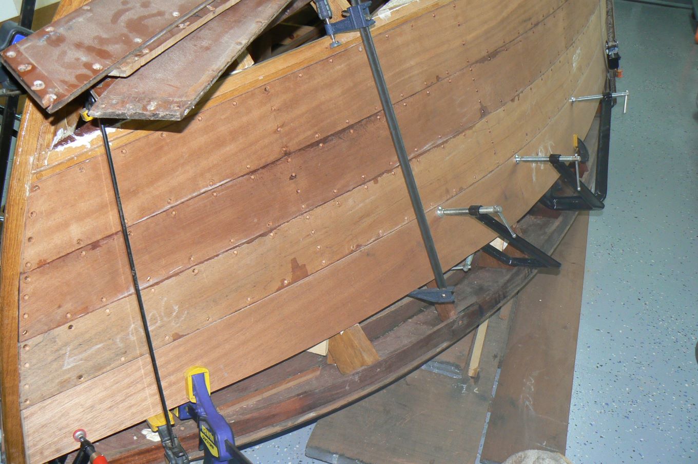

So I've bee busy, well trying to be busy. I graduated from official physical therapy yesterday now just home stuff till I see/hear from the Doc on the 28th to see if I can full blown back to normal. So to celebrate I bedded the first row of planks on. Took a lot longer than I thought but the new Astro pneumatic caulk gun is a huge help and was only $18 on Amazon. :) I actually destroyed my old Red Devil caulking gun trying to use the 5200, so I got the pneumatic and heated the tubes in boiling water for about 5 minutes, worked like a champ. On to row two tomorrow.

Glad the shoulder is back! Also a clever idea warming the 5200. I might use that idea one day. Looking good. No pressure, but if you finish by next March and take it to Lake Dora to show off in Florida, then maybe I could use that for an excuse to go next year. I haven’t been down there for 25 years, so that would be a treat. Keep the progress and pictures coming.

So the second row is on, not much different looking than the first. lol I do wish that 5200 went a little further, it's taking about 1 tube per plank more or less and that ain't cheap! lol
Thanks Cal slow and steady wins the race right? lol
Thanks Mark, I'd like to say I'll have it done by next March but with still only working on it mostly weekends, there's a crap load to still get done so I doubt I'll make it but hey it's something to shoot for. ;)

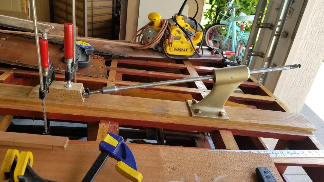

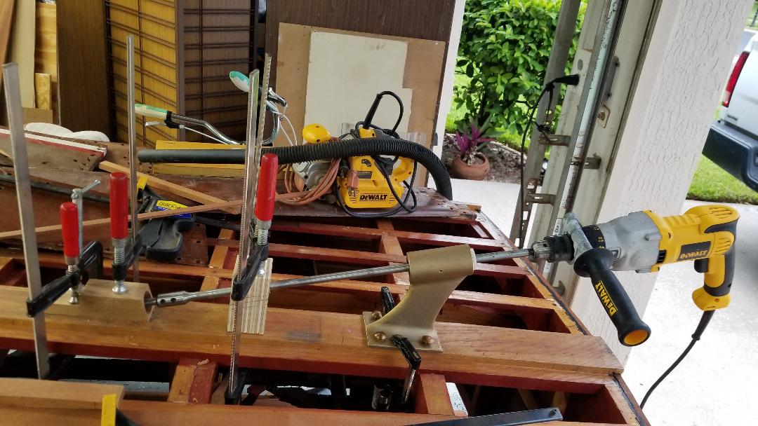

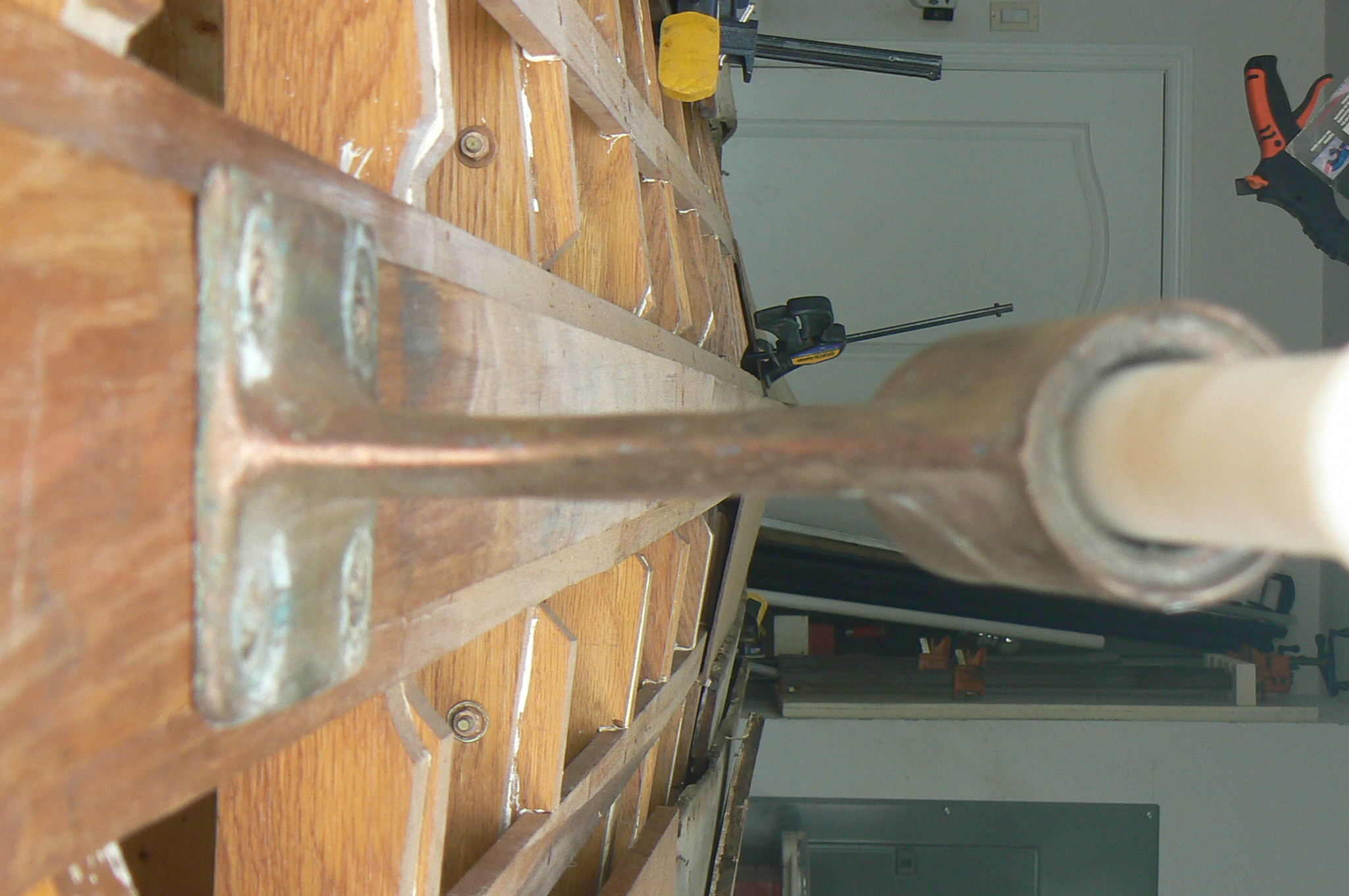

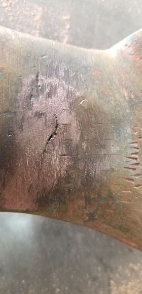

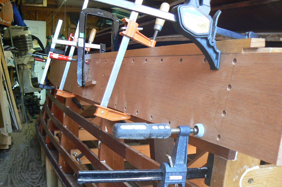

Ok it's been a while and I apologize for not posting. I really thought that once I moved to Florida I would have more time to work on the boat but new job has me working 10 hours a day so it's weekends only, mostly.
I actually have the sheer planks clamped in place but didn't take a pic yet.
I also made a bushing so I can use the new 24" forstner bit extenion so I can drill the shaft hole. But also founf out my strut is a shallow S and has a crack! Time for a new one which won't be cheap I'm sure.
'53 18' Century Resorter finally 5 years 11 months ago #143536
Lookin' really good so far. Sounds like your plate is full, the Resorter is desert.
Can that strut be repaired? Thinking maybe you could go to a local weld shop and have a second opinion. Could be
ground out and braised. ? Even maybe a local prop shop that can do brass prop repairs. Just a thought.

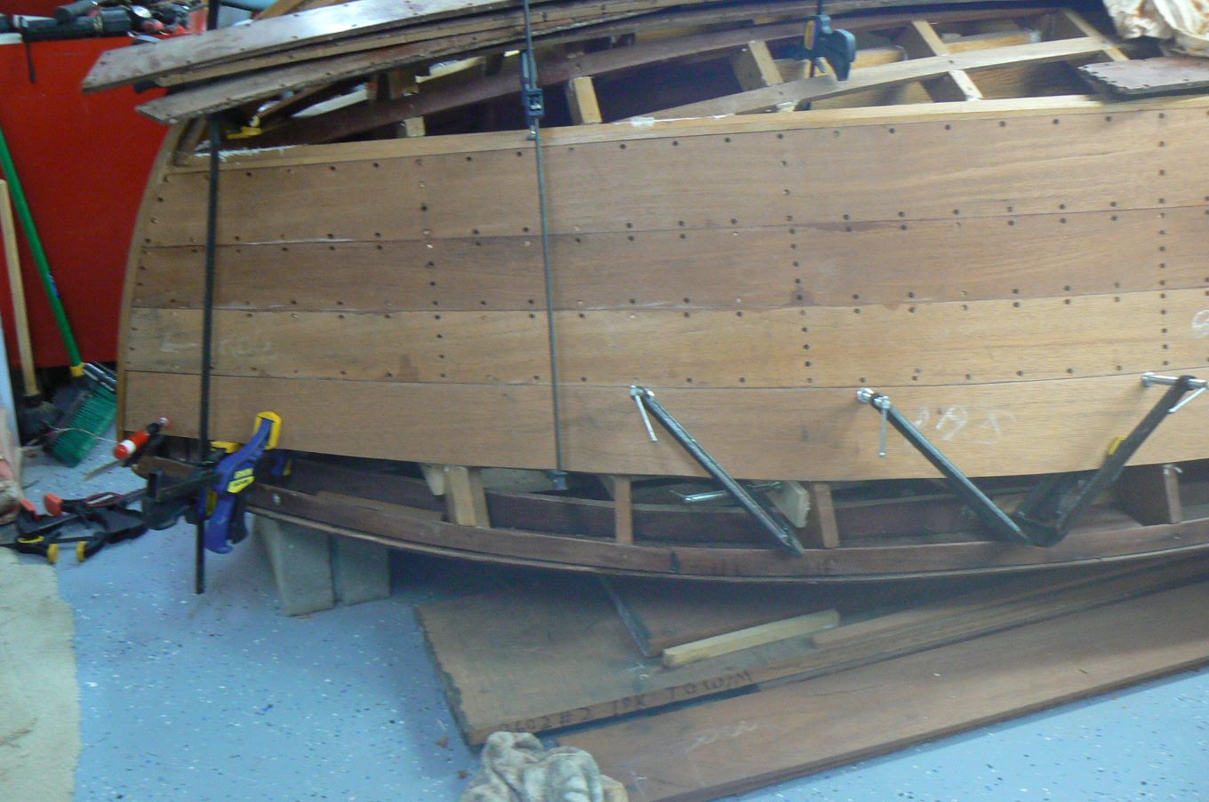

Holy crap has it really been 8 months since I last posted?!!!?!? Ok so I had been busy on the Mini Me wagon in the wood boat secttion. I got the porp shaft hole drilled and I got the bottom two transom boards bedded. I need to take pics of the transom yet. I also was able to get the first bottom plank next tot he keel down on the starboard side. Have to CPES them and bed the butt board the the two pieces and bed it to the hull.
'53 18' Century Resorter finally 4 years 11 months ago #145833
  • Waterwings
  • Posts: 4902
  • Karma: 107

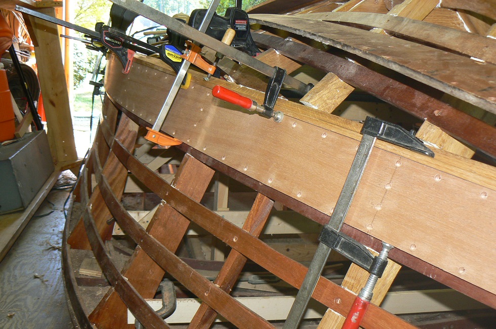

Sorry it's been a while since i posted but i have been busy. I finally have two rows of bottom planks on now, getting there slowly but surely. Frog Im sorry this is taking so long I promised you a ride!

No 5200 bottom, Bob? I'm surprised. What are you using between the planks?
Mentor to the unenlightened!
"Success makes...
'53 18' Century Resorter finally 4 years 10 months ago #145959
  • Waterwings
  • Posts: 4902
  • Karma: 107
Thanks John!
Jan, yes I am using 5200. White for the bottom and black for the sides and covering boards. I'm doing a no soak bottom with 5200 and the battens, no inner plywood layer. There are different thoughts on this but the Miklos brothers have been doing it this way for over 40+ years with no issues so I figured I go this route. It keeps the weight down too since no ply, yeah I know it's not much but hey weight is weight. LOL
