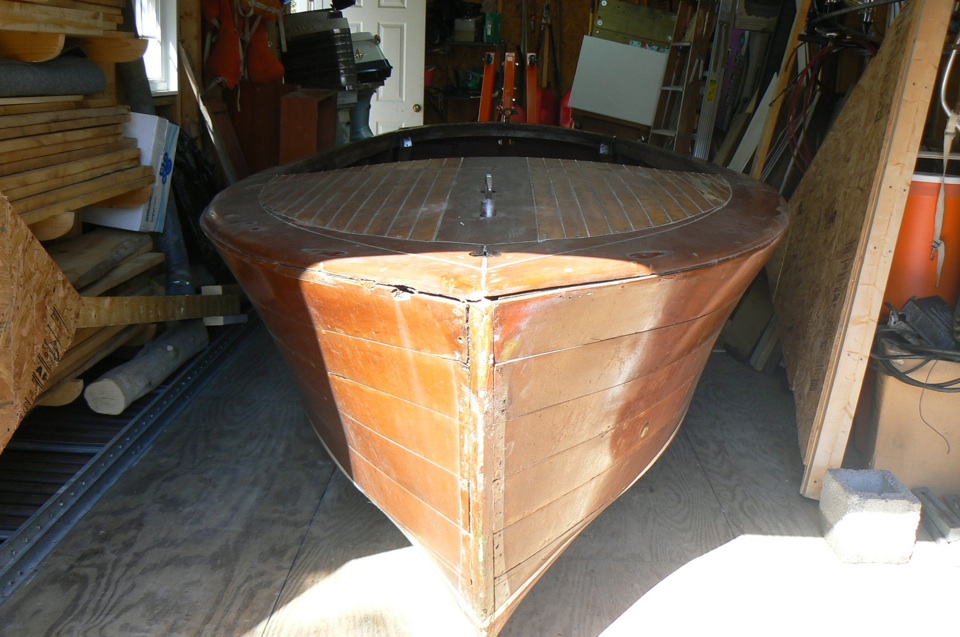

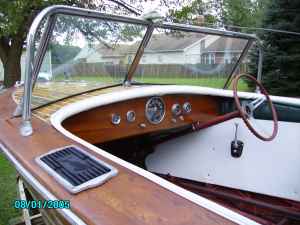

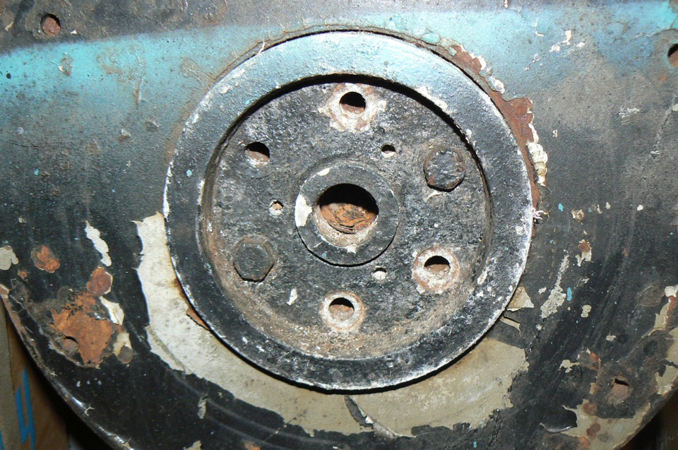

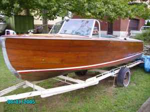

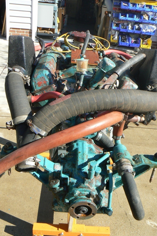

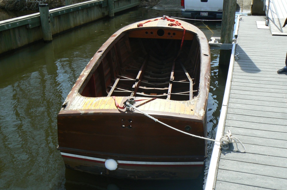

Ok, so i've told a few of you I had started on the Century finally. Here are some pics that I finally re-sized.

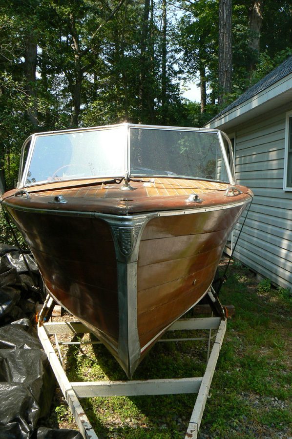

Here it is before:

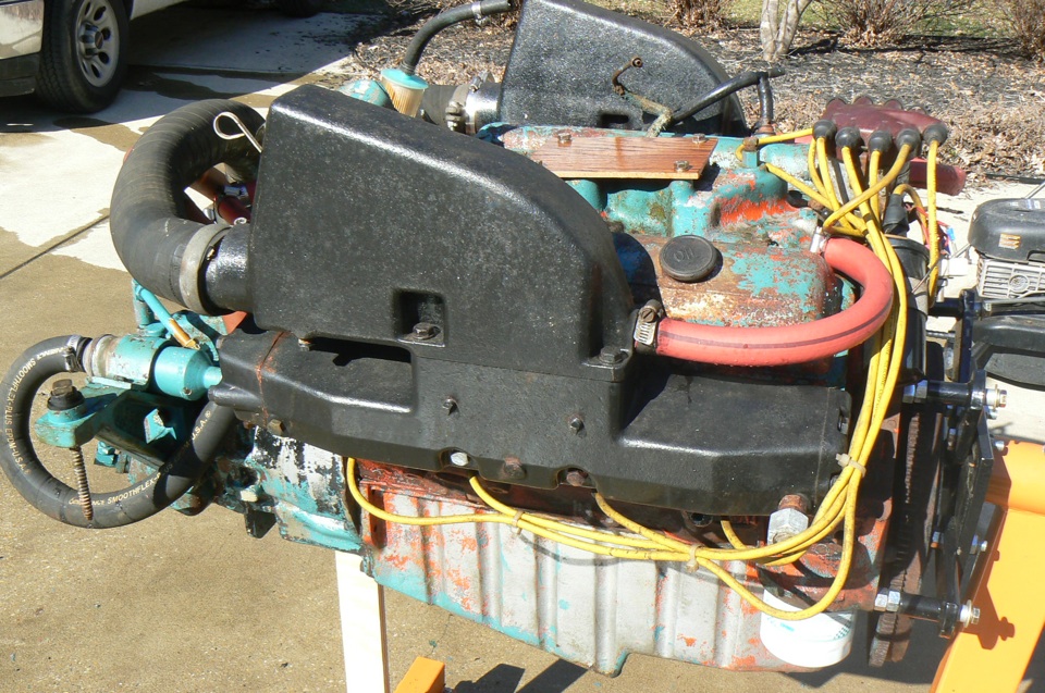

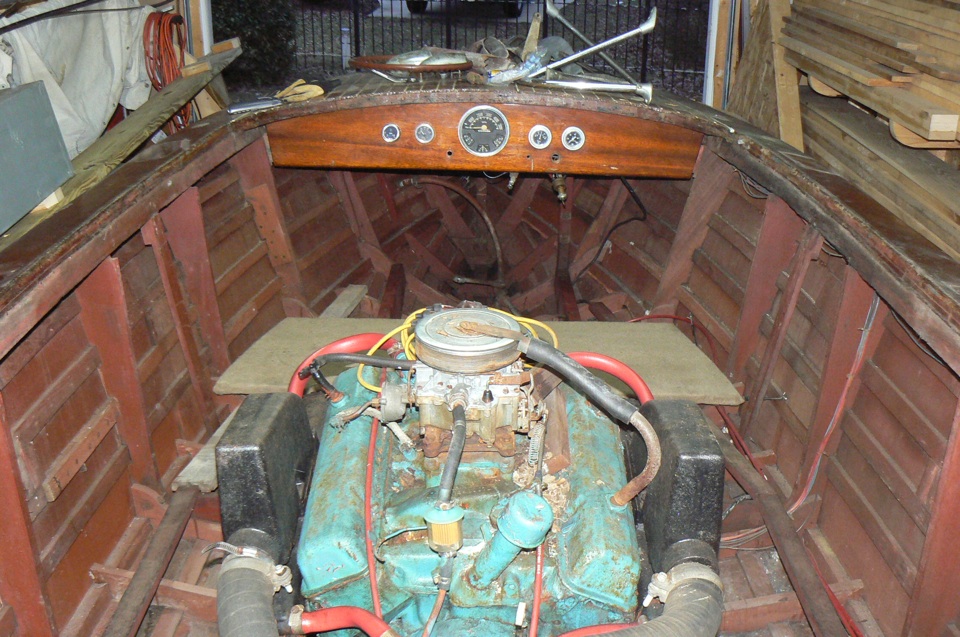

It's a Frankensorter. Wrong Engine, wrong steering wheel, wrong front seat, wrong cushions and color of cushions, wrong guages. It's missing the back step pads and the rear rope chocks.

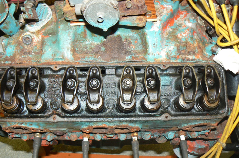

I was told by the PO that the engine is a 283. it is an Owens Flagship engine but after some investigating on teh block numbers I have discovered that it is in fact a 350! Whoo Hoo!!!! 72/73/74 block 165 2 bbl, 175/185 4bbl. I have the four barrel but I'll be boosting that HP as 185 isn't going to cut it for A 350. ;)
I have a lot more pics but that's enough for tonight.

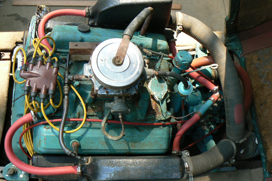

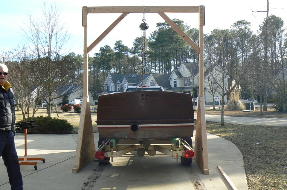

Ok, I'm semi awake and one cup os coffee, so here are more pics again

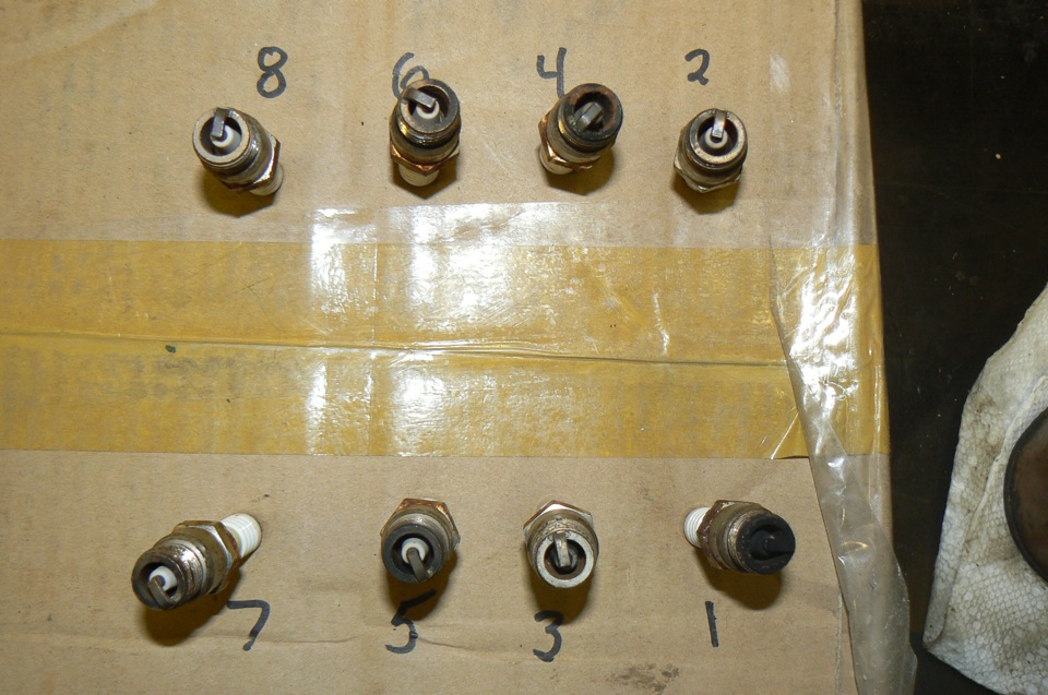

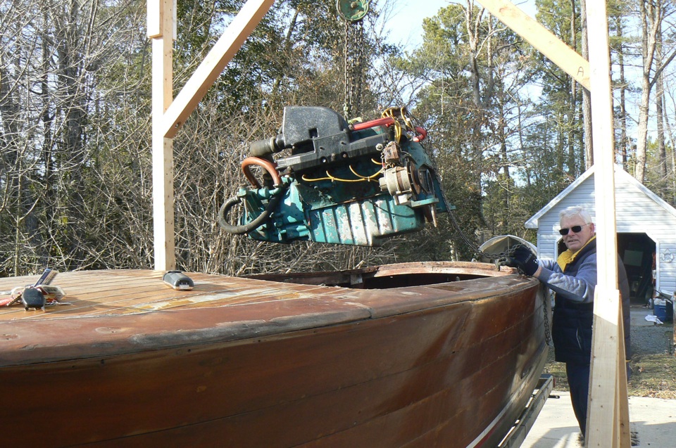

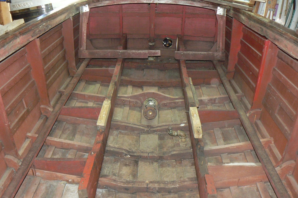

Time to strip the inside and pull the engine with my buddy Bob to help me.

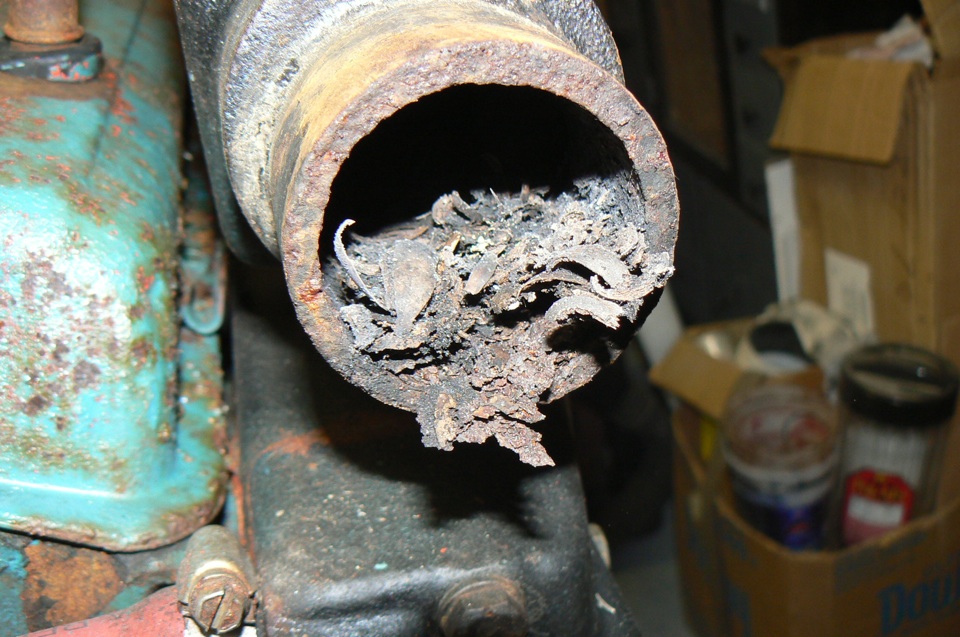

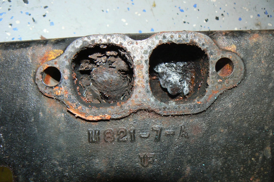

Hmmm what's wrong with this picture?

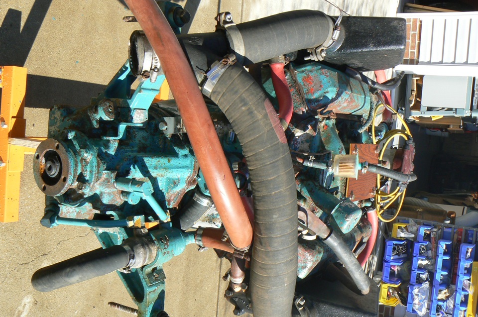

Engine on rack and power washed.

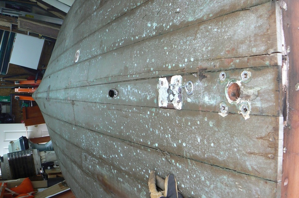

Now to investigate the problems. There's a twist in the hull.
Well that's enough for now, have to get back at it.

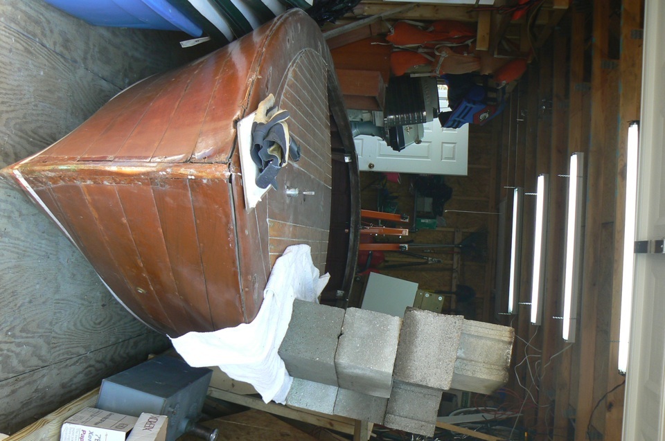

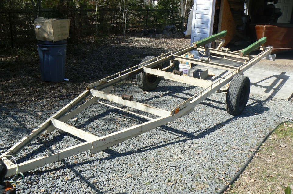

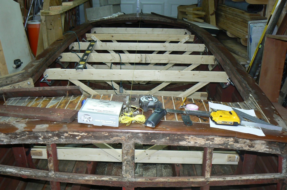

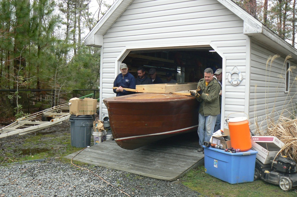

I'm finally back from Huntsville so here are some more pics.
This is the trailer it came off of and won't be used again. I think it's an old Gator but the build plaque is gone so not sure. The springs need to be replaced, the bearings, the front tongue is bent and would need to be cut and re-welded. It has the original non locking tongue. I'm probably going to take it to the scrap yard and see what I can get. I'll take off the new trailer lights.

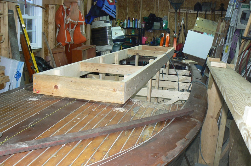

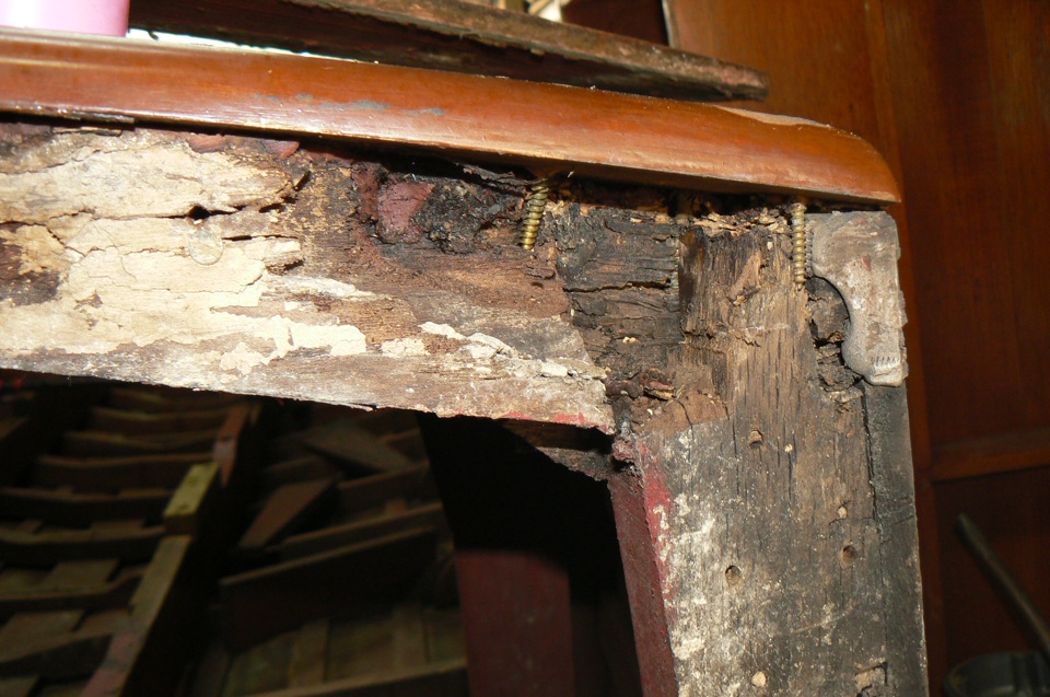

The boat is now down on the shed floor with a cinder block and 5/4 board on top of the block. The stern is on the blocks and the keel is on the floor, three points and very stable. The floor is completely level this way I can figure out the twist problem.
So once it was on the floor I measured from the floor to the top of the chines on port and starboard at the second frames and found the starboard side was 1 1/2" higher. This took care of that.
Ok I give up this is the fifth try at rotating this the right way, none of the usual ways are working, I give up.

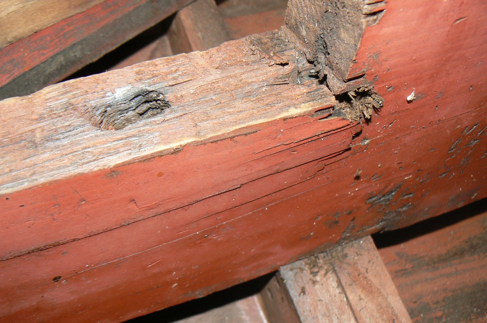

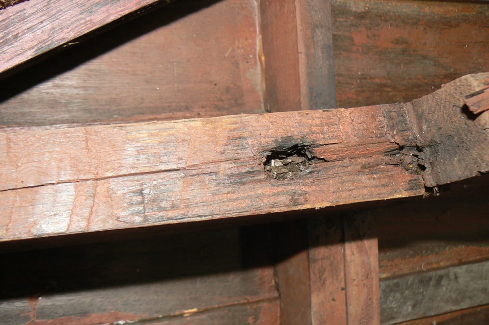

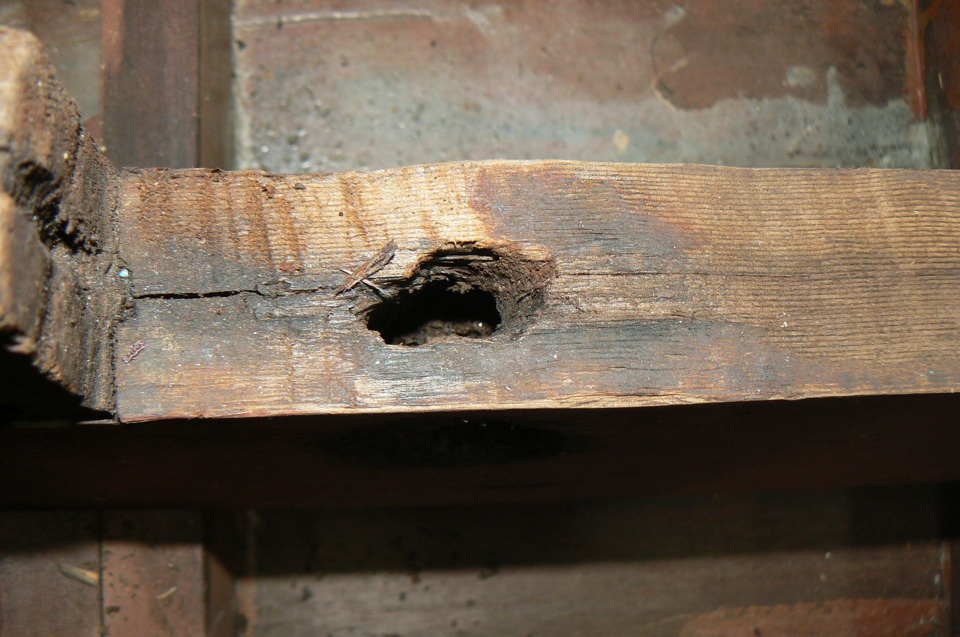

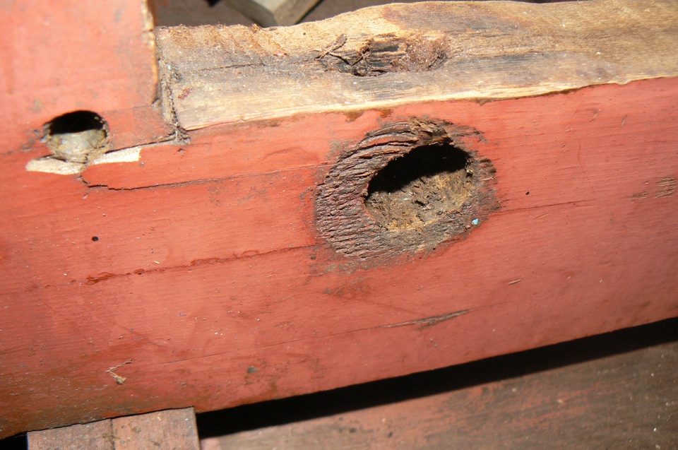

It needs new stringers, the forward engine mount areas are questionable. When you run a V-8 in these boats the factory would bolster the stringers with 3/4" marine ply on the outside faces. I have the marine play ready to go, just need the douglas fir for the stringers.
Well that's enough for now. Time to get out to the shed and back to work.

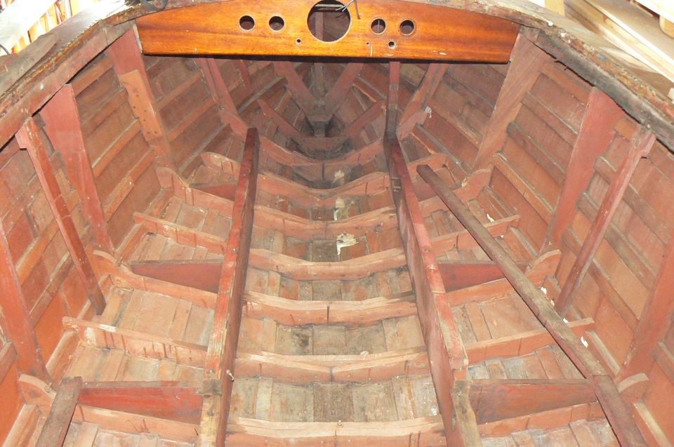

Re:'53 18' Century Resorter finally 12 years 8 months ago #91424
  • Waterwings
  • Waterwings's Avatar Topic Author
  • Posts: 4902
  • Karma: 107
  • Thank you received: 100

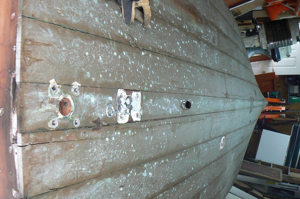

Here are some more pics of the progress so far.

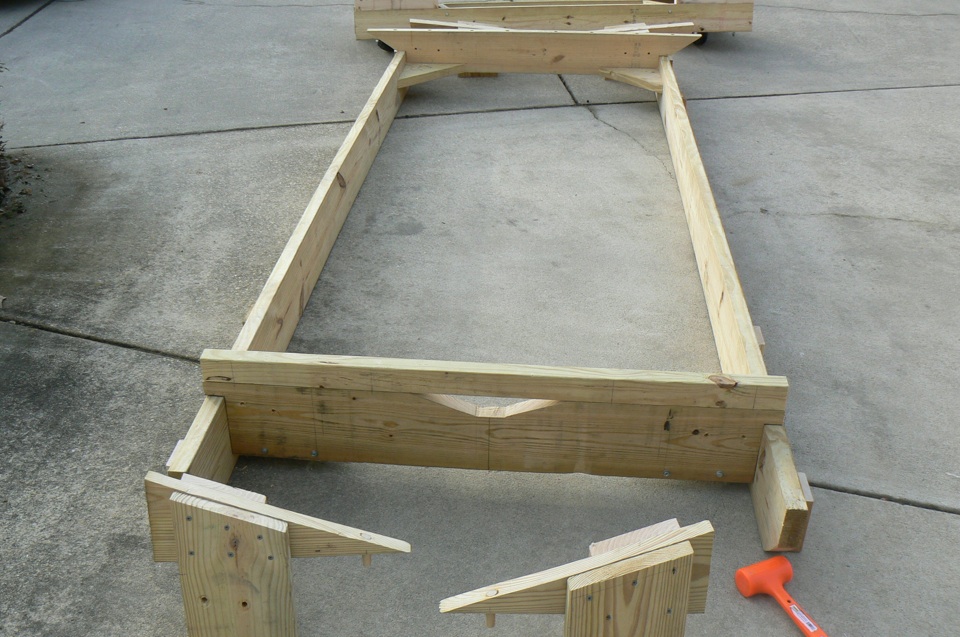

Cradle is built and mobile.

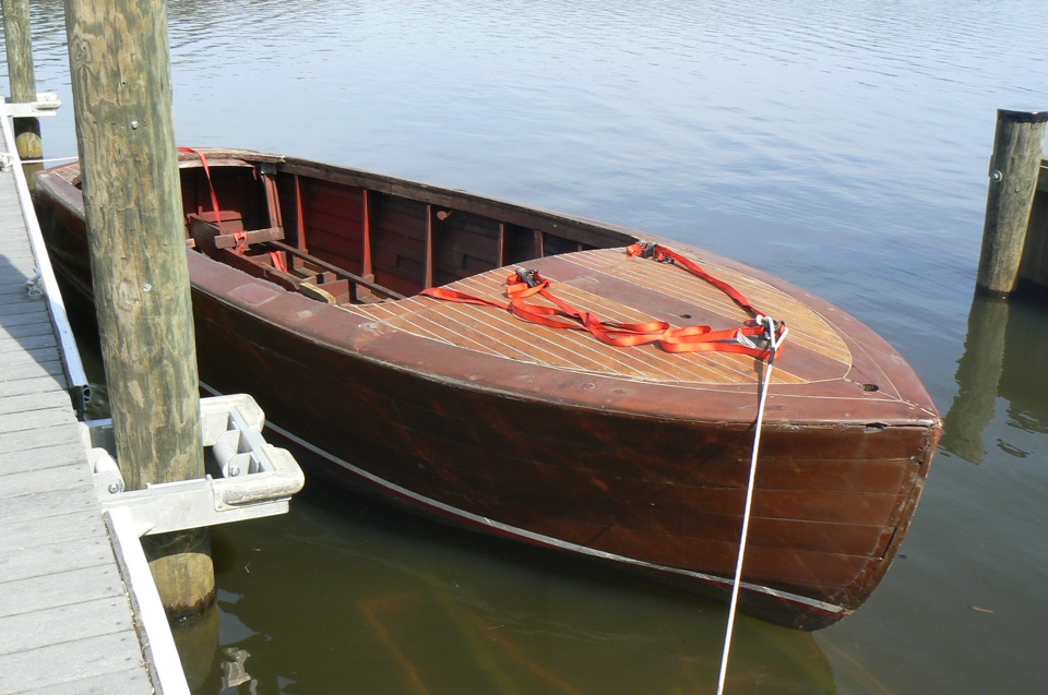

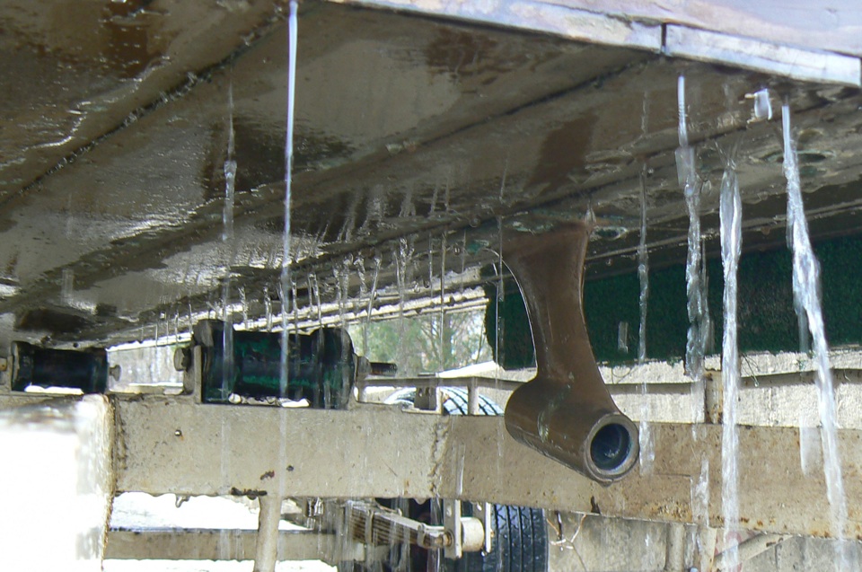

Needed to float her to see how bad the bottom really was. Didn't want to just fill the inside with water since the trailer is completely wrong to support that much weight, so it was easier to take her to the little lake close by.
A few leaks, two I expected a couple more I didn't.
After going through the interior more I found a few more cracked bottom planks so it looks like a while new bottom. Worst part is the bottom wasn't put on with 5200 like I thought, it was put on with I believe the West System epoxy. I'm going to have to be very careful so I can at least use the bow ends for patterns, the rest is pretty much straight.
That's all for today.

Great boat, Bob. Bettie Page was a century Ski Dart, very similar to your boat in design, although a little newer. She was a fun ride. (The boat, not Bettie.)
A couple suggestions:
The original Gray Marine engine was an AMC-based V8. Unless you really like pain and frustration, stay away from them. For one thing, they require a Leece-Neville alternator and voltage regulator. Both are impossible to find. It cost me $125 to have my regulator rebuilt and it still needed an unobtainable diode. I paid $165 for a voltage regulator, after a three month search. The L-N alternator is the only one that will fit on that engine unless you build some Rube Goldberg contraption to hold a GM alternator way out in free space. There are also about zero performance mods available. The Jeep guys have monopolized all the four barrel intake manifolds. I'd definitely stick with the small block Chevy.
Your prop looks to be too big but maybe it just looks big to me. With a 350 in your boat, you should most likely be running a 13X13 prop. WOT should be right around 5,000-5,200 RPM.
Lastly, assuming that your bottom planks are solid, those "little" leaks can be addressed by thoroughly filling the cracks with 5200 from the bottom. The next day, dunk the boat in the lake and allow it to stay there for 3-4 days. 5200 sets up well under water and the swelling wood will squeeze out all the excess. The "squoze" can then be easily removed with a sharp chisel or a multi-master prior to bottom painting. It may be the "poor man's 5200 bottom" but it works well and if you're thinking about removing the bottom anyway, you've got nothing to lose by trying. I've used this system on several boats...works like a charm.
Hint: 5200 likes to "drool." Putting it in the cracks upside down is a real mess and it seems to drool out almost as fast as you can stuff it in there. Do the job when the hull is dry and you're wearing the worst clothes you own. Wear a hat! As you apply the 5200, go back about every three feet and cover the cracks with 2" wide duct tape to hold the 5200 in place. Dunk the boat the next day, tape and all, and when you eventually pull the boat out of the water, the tape will be easily removed.
Note: Free advice is worth twice what you pay for it. If any/all of these suggestions don't work, I'll deny everything and provide the best air-tight alibi money can buy.
Note #2: The word "squoze" is a proprietary word, invented by me, for the exclusive use of persons using 3M 5200. Miriam Webster, who just happens to be a close personal friend of mine, will soon be adding it to his latest lexicon. Anyone found to be using "squoze" outside the confines of 3M 5200 discussions will have their classic boat confiscated and be forced to own a pontoon boat...a pink one.

Waterwings, when you start to take your bottom planks off, it will become very clear on what you will need to do to make the boat above all safe and seaworthy. Remember that these boats wehn built were never meant to last over 10-15 years, let alone 60! There is no magic potion, IE, 5200, epoxy, new screws etc. The oil soaked bottom, dried out wood, loose framing, aged fasteners and years of movement now make your boat not only unsafe but not seaworthy! Make sure that you find a copy of the Dannenberg book on Runabout Restoration and you will learn about all of these forces and hot they have contributed to your boats current condition. The 5200, Epoxy and crews are merely bandaids that can wreak poor results when they are not properly used per there original design.
You are now getting your boat properly supported to begin addressing the issues that will no doubt included rot, severely degraded fasteners, oil soaked weakend wood and broken frames. Remember, rot is a living organism and will grow like a cancer within your boat...
Please note that I am not trying to sound like a Debbie Downer, but rather someone who is being brutally honest about the realities of wooden boat ownership.

Replacing a planked bottom is a major job. Five years ago, the "going rate" was $1,000 per foot. There's a reason for that...it's worth it. The labor and material required is substantial. Yes, read Dannenberg. (I taught him everything he knows!) Seriously though, there's a real trick to doing the bottom, that is, doing it right. If you have never done it before, try to get some who has to help you...at least get you started. The installation of steam bent planks is a two man job. Don't begin until you are sure you can work on it until complete. It's not the kind of thing you can do half way and then return to finish a few months later. Best of luck.

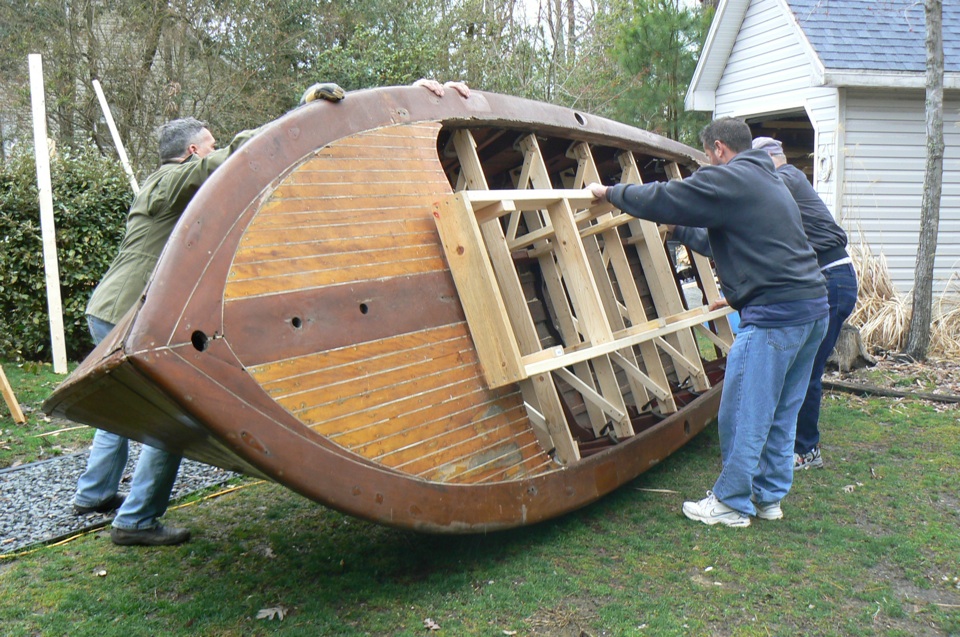

Re:'53 18' Century Resorter finally 12 years 7 months ago #91702
  • Waterwings
  • Posts: 4902
  • Karma: 107

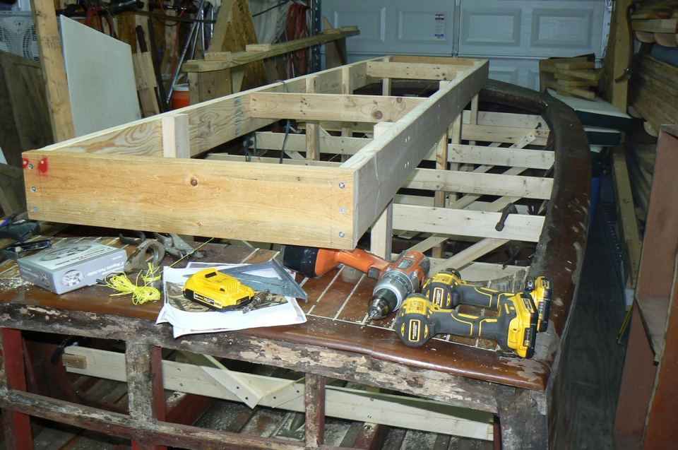

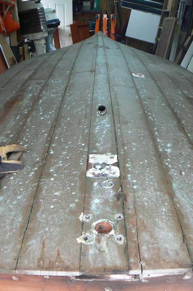

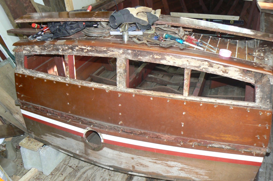

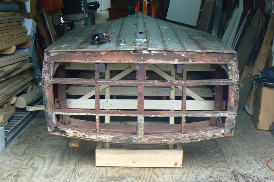

Time for more pics.

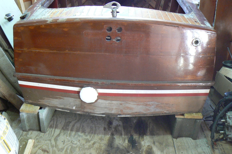

Got the transom off. It took 4 hours to get the bottom plank off because they used epoxy to glue in the bungs/plugs so I had to removed the bung/plug the scrape out the slot on the screw so I could get it out. Needed to keep the planks in tact for patterns. Could probably reuse two of them but I think I'll just put all new ones on. It isn't pretty under neath there.
I should be able to still make patterns out if it.
With the transom off I was able to get hull pretty level and even to brace it up.
Flipping party tomorrow, if it stops raining.

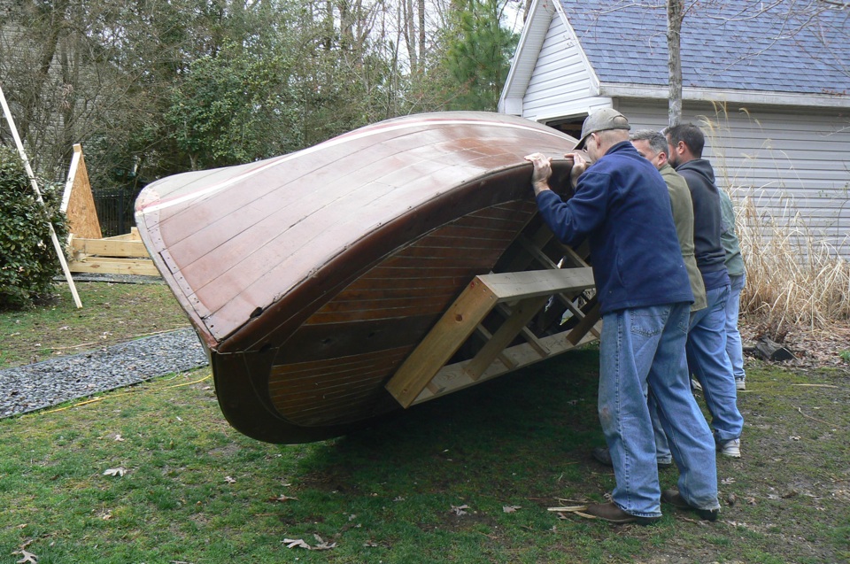

Re:'53 18' Century Resorter finally 12 years 7 months ago #91777
  • Waterwings
  • Posts: 4902
  • Karma: 107

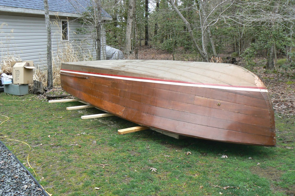

Well she's flipped over and back in the shed.
Yep there's just a few cracks. Time for a whole new bottom.
That's all for now.

Good job on the flip buddy, proud to see you pressing on with the project my friend. BTW, J.D. has 5200 on sale right now for $11.99 a tube. (The big 13oz?) I've always found the wood boats truly beautiful and engineering marvels, but can't imagine tackling a project of this magnitude. I guess the good part is wood dust doesn't itch and smells a lot better, right!? :P
Re:'53 18' Century Resorter finally 12 years 7 months ago #91828
  • Waterwings
  • Posts: 4902
  • Karma: 107
Thanks Mark. Lowes has it for the same price I believe and I won't have to wait for shipping. Yeah there will be a lot of sanding with a respirator of course. I've ben a woodworker for a very long time and this was just a natural progression I guess. ;)

Weather was crappy after the flip, lots of rain, so I worked on the motor.
not too dirty under the valve covers.
Some interesting things in the manifolds.
I'm thinking cylinders 1 and 4 are probably in rough shape inside.
Re:'53 18' Century Resorter finally 12 years 7 months ago #91874
The oil galleys look pretty decent Bob. The lack of "sludge" tells that someone took good care of the motor, right? Those manifolds and risers are another story altogether! I've seen them almost plugged with rust and scale, but that looks like a rat's nest was ingested and pumped through the motor. (Might have come in from the exhaust side, but you know what I mean?) May want to take those to a machine shop to get them vatted out, checked for cracks, etc.?
Re:'53 18' Century Resorter finally 12 years 7 months ago #91905
  • Waterwings
  • Posts: 4902
  • Karma: 107
Yeah I'm thinking of taking the manifolds, heads and block, once it's all stripped, to a shop and have it cleaned and checked.
