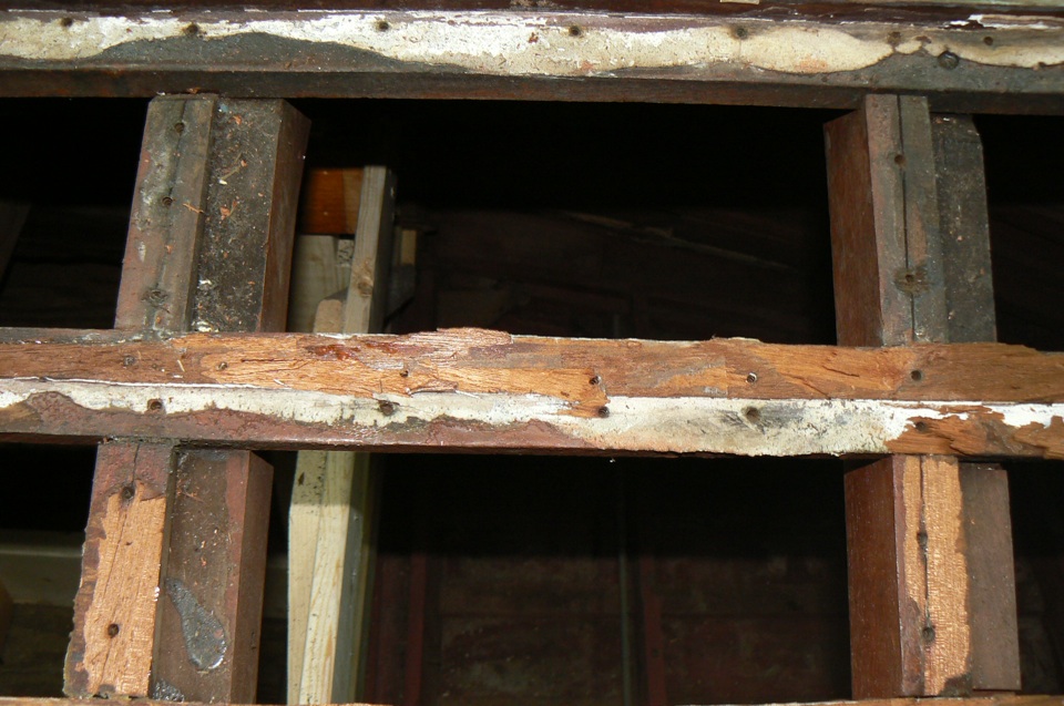

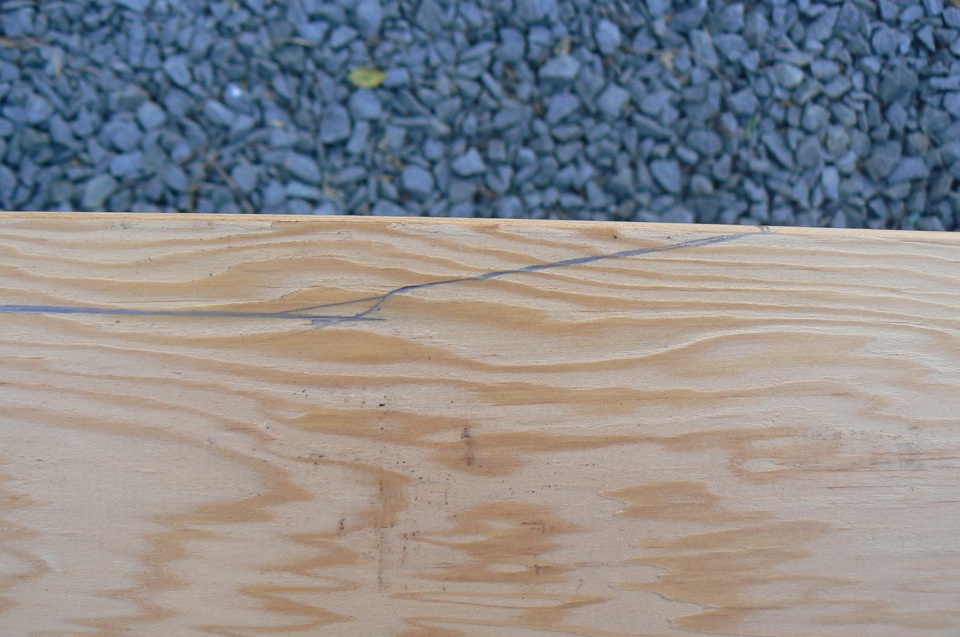

Ok finally got all the screw slots ground out so I can pull the screws. It's been slow going, that epoxy is a pain in the butt!!!!!! Did get two rows of planks off over the weekend. Unfortunately the majority of the bottom ties are cracked where the screws were put in. Obviously who ever did the bottom last didn't pre-drill like your supposed to, to prevent this.
Ok I give up on trying to fix that pic.
Yep they're cracked.
Re:'53 18' Century Resorter finally 12 years 7 months ago #92331
That's a shame Bob, gonna create a lot more work for you huh!
Re:'53 18' Century Resorter finally 12 years 7 months ago #92340
yep its more work,but im sure if anyone can handle it you can,john

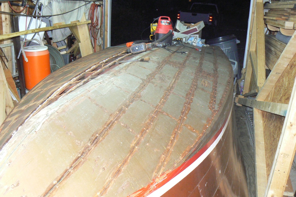

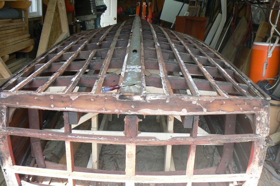

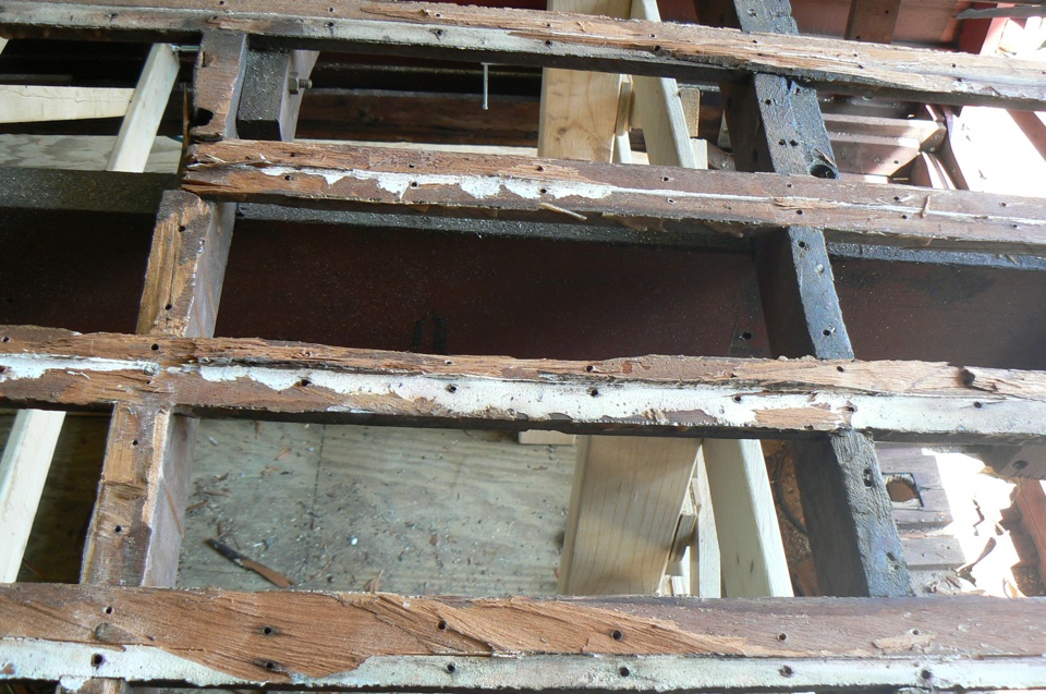

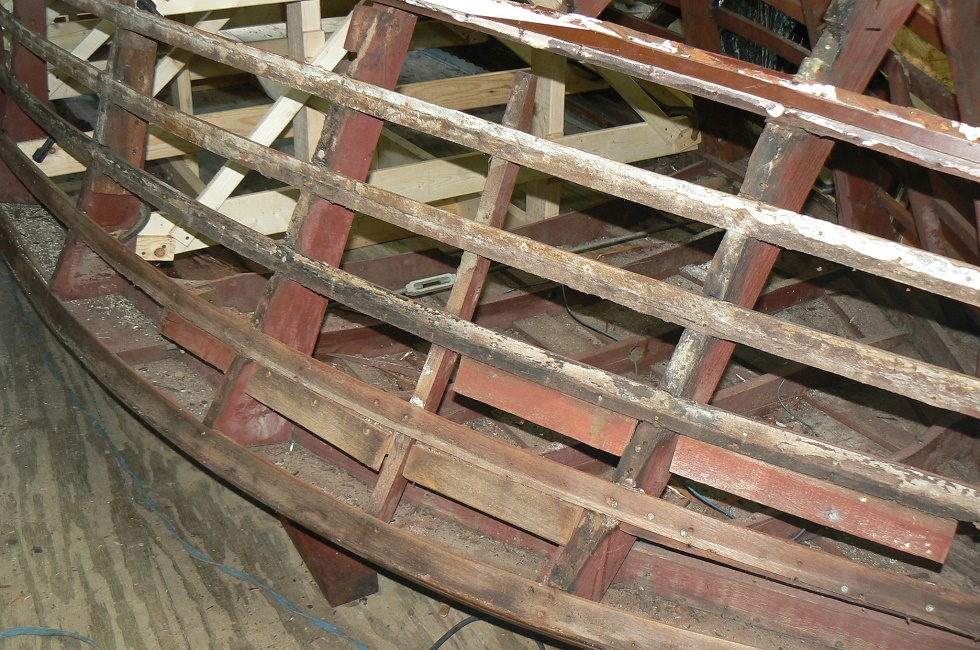

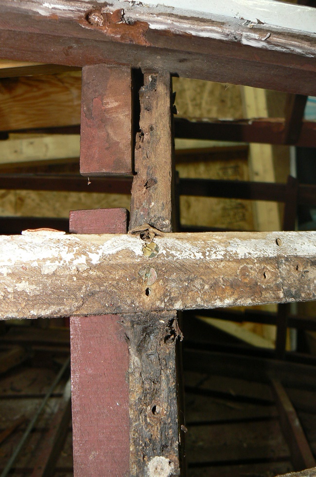

Well I finally got all the bottom planks off so he bottom is naked and it isn't pretty, she's going to need a plastic (well wood) surgeon. ;) Looks like the aft two frames are original and the others were replaced at some point, not recently though.
Re:'53 18' Century Resorter finally 12 years 6 months ago #92499

bob, looks like you got a big job ahead of you. it will be rebuilt better then new when your done, remember you promised me a ride, so do not give up. greg

Thanks Greg. Yeah a lot more than I originally thought when I bought it! LOL No worries not ready to give up yet.

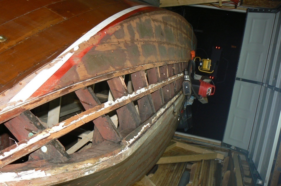

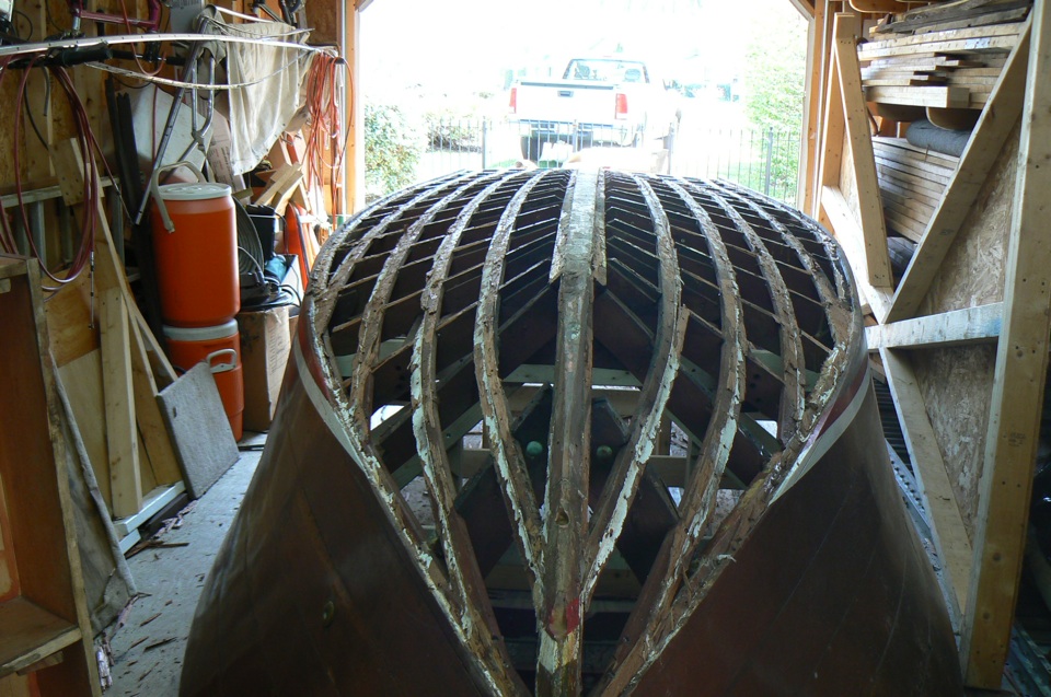

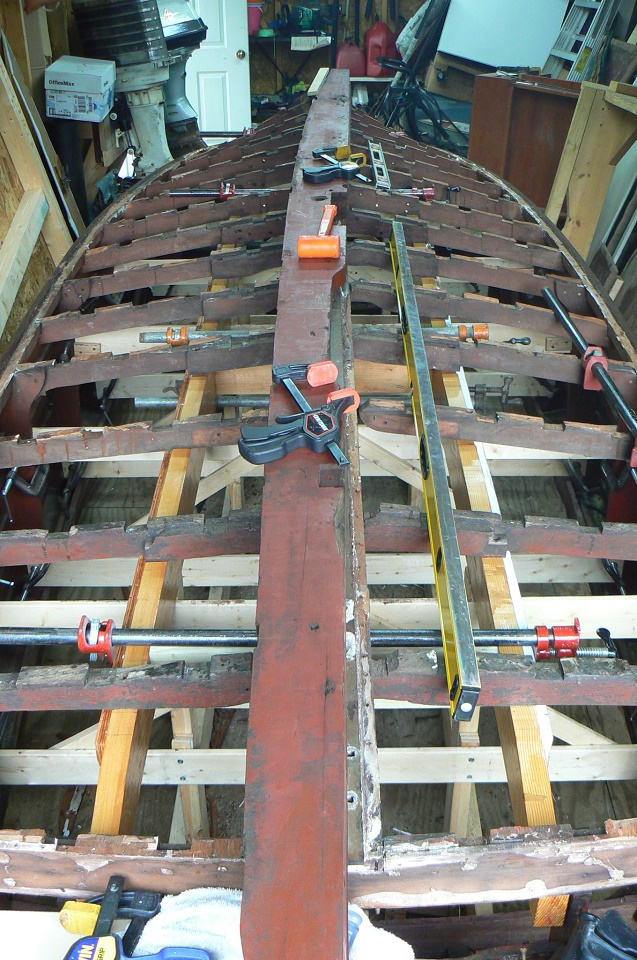

More progress tonight. Got the battens off. Will try and replace the stringers one at a a time next, I hope.
Re:'53 18' Century Resorter finally 12 years 6 months ago #92643
  • morris
  • morris's Avatar
  • Posts: 393
  • Karma: 38
Stay the course Bob. You'll do just fine. and I want a ride too.
www.g3owners.com
Re:'53 18' Century Resorter finally 12 years 6 months ago #92645
OK, Bob. I've stayed out of this fray for awhile now 'cuz it brings back some memories of years gone by. The "63 Sabre" title comes from my Century. I can match your pictures identically. Took over 1200 of them when I did my rebuild. Over the course of three years on and off. I can give you inside info if needed, also with the engine rebuild. I dropped my Century Club membership this spring 'cuz I sold the boat to a lady in Ill. but I still follow the facebook posts and on occasion answer some of the postings on their site. If you need pictures for some comparisons I can probably provide them.
Looks like you have a great start and progressing. I found that a few weeks away from the project once in awhile does some good. I used African mahogany for my replacements. Honduran seems to be harder and more brittle, splits easily. Once you use the 5200 it's permanent but you will have some days to move around if needed before it sets up.
Cal

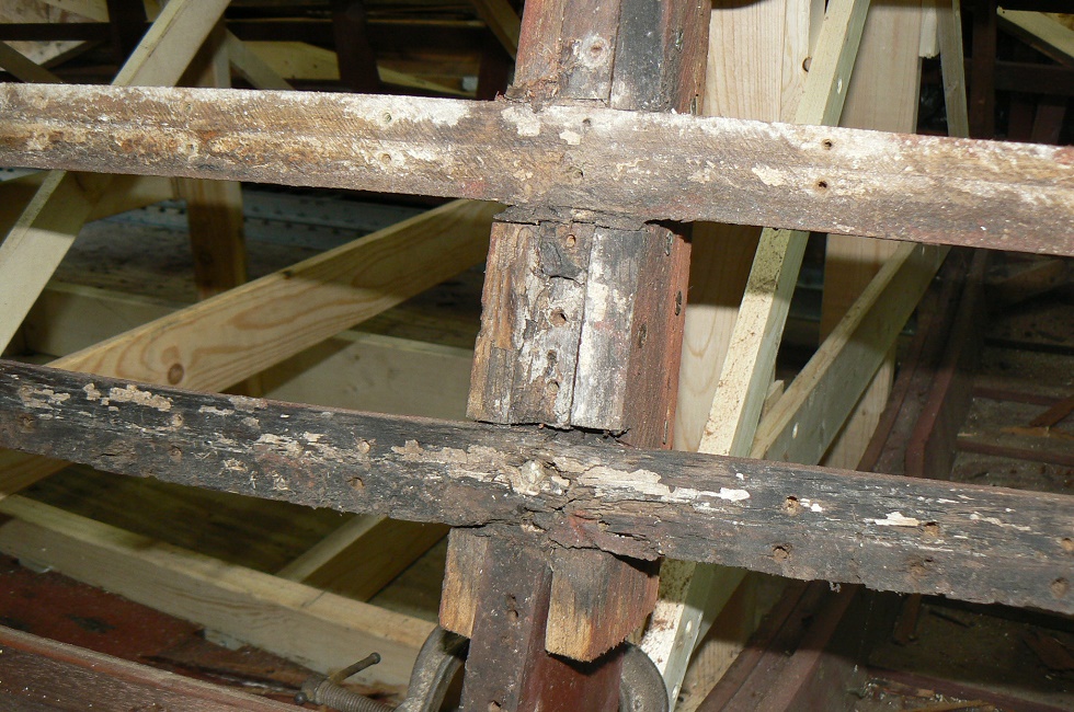

Bob,
Having attended many boat workshops in Buffalo. I don’t remember seeing any boat with the bottom off that didn’t have split frames from fasteners.
So don’t feel bad, if you think you got a bum deal ? That was the first thing I thought when you said you had split bottom planks…. He’ll probably have to replace the frames too ?
In fact, I priced out a bottom replace in the mid 80’s, and was told right up front. That most likely the frames will need replaced also.
Think of it this way… the bottom will be much stronger when you’re done, and your twisted hull will be fixed too ?
It sure will be a stunner when you're done !!!!

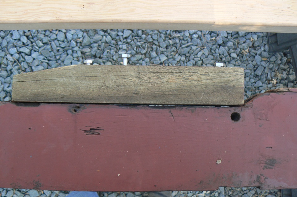

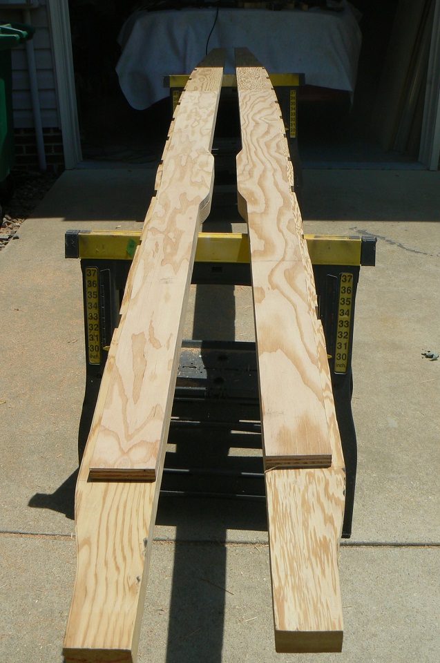

Fret not, still working on her. I started on the stringers today.
Ok again I['m done trying to rotate it.
The original had blocks when the V-8 was added but I'm thinking I should make the new one all one piece since it will fit in the boards I bought.
Ok really screwy tonight, not sure why the pic won't post but it gives a link. Never had that happen before.

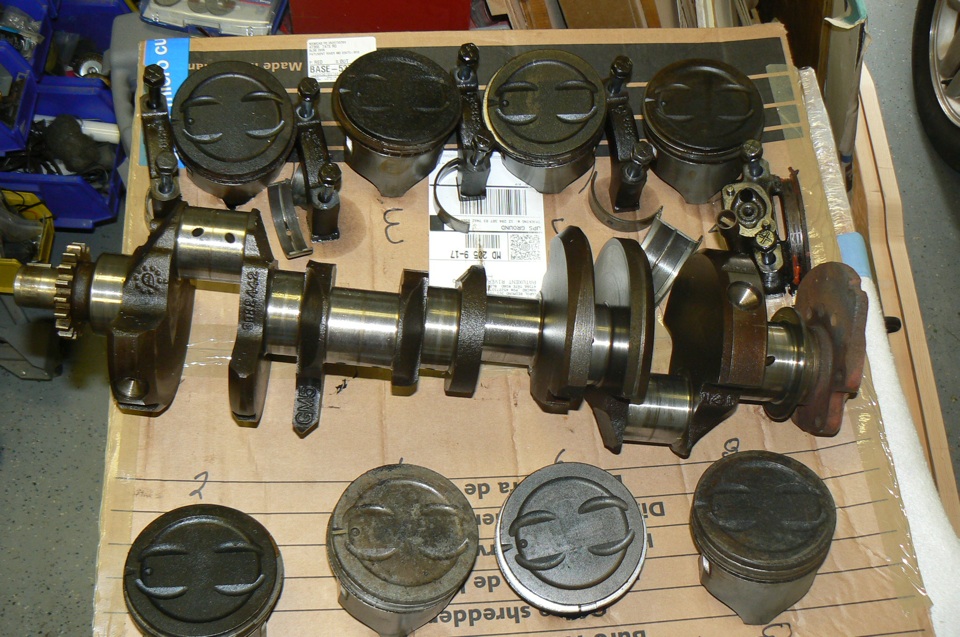

Well after getting quite a but done on te honey do list I was able to get back to the resorter. Well the engine anyway, weather was iffy so opted to work in ht engine. It's completely stripped and ready to go to the machine shop for a quote on the block and heads.

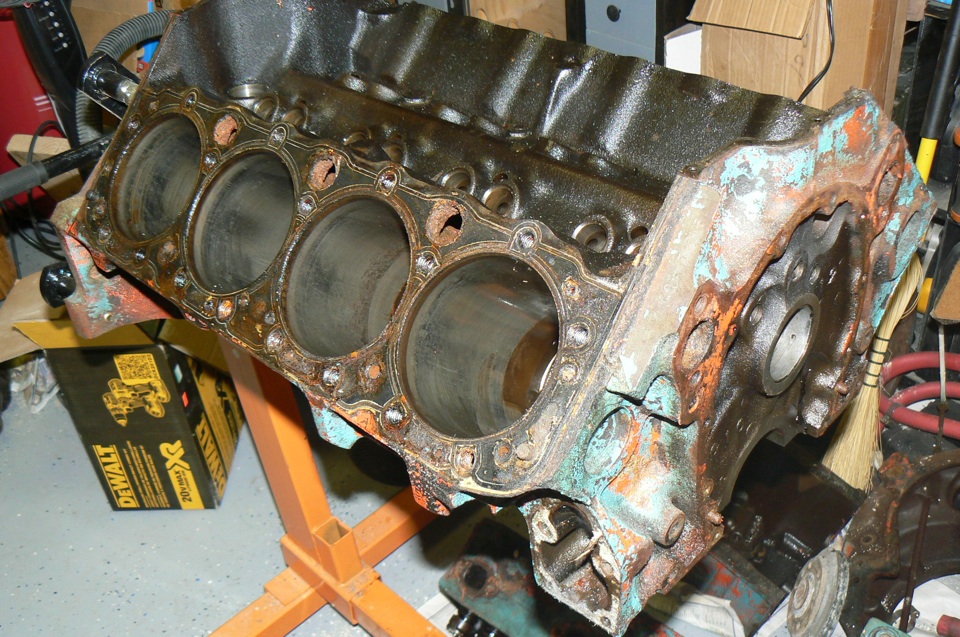

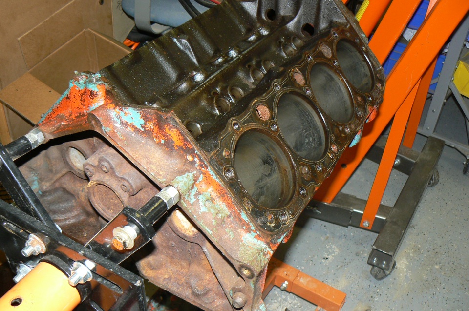

Thanks Andrew, yes it a '71-'73 350 with '76 76cc smogger heads. Just dropped off the whole shabang at the machine shop for cleaning, tweaking and prep for paint. He's going to look at it all and give me shout in a few days with recommendations. Looks like I'll need a new cam as one of the lobes is worn at an angle, slightly. He said it actually didn't look that bad so we'll have to wait and see.

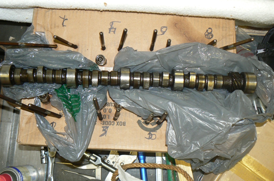

bob, if you have a lobe worn you should replace the cam, as they are only surface hardened, I seen them worn round once they wear thru. also replace al the lifters. you may have known this. good luck. greg
Re:'53 18' Century Resorter finally 12 years 5 months ago #94726
  • Waterwings
  • Waterwings's Avatar Topic Author
  • Posts: 4902
  • Karma: 107
  • Thank you received: 100
Thanks Greg, yep planned on getting a new cam shaft and lifters.

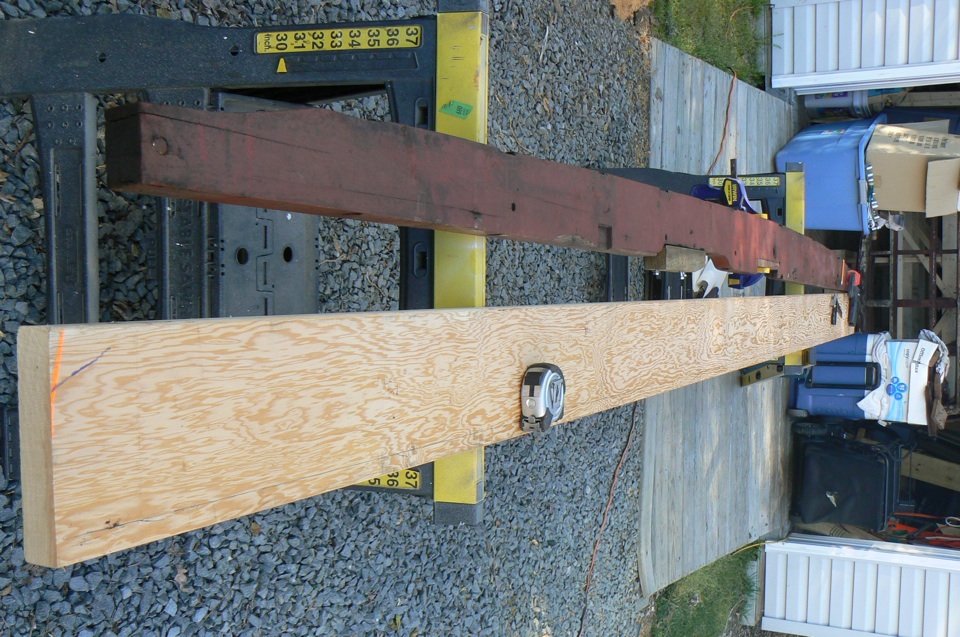

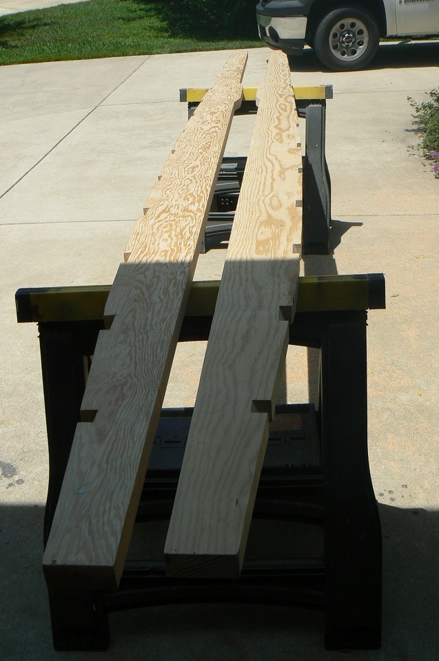

Very cool Andrew thanks. Well it's been a while and life has been in the way but I have gotten back to the stringers and they are now in and ready to go. I had to take a bunch of measurements so I could figure out how much White Oak to get. Used a woodworking optimizer software and I think I know how much. Now I just need to go get it and get started on the frames.
[img] two coats of CPES http://www.fiberglassics.com/media/kunena/attachments/legacy/images/Stringers_CPESd.jpg
Dry and installed
Now to buy some lumber.

Ok it's been a while sorry. Lots of life stuff going on so I did get back to her though.

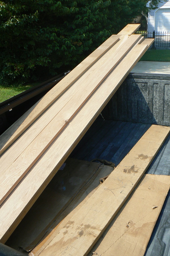

Hi Ho, Hi ho, a framing we will go!
Got the white oak for the frames.
Got the first plank above the Chines off.
Frames 1 1/2, 2 and 2 1/2 are out but going to put frame 2 back in and only do every other one first then go back and do the others. A great suggestion from the Century club guys.
Unfortunately I have to get back on the Clipper as we took our friends out Sunday and she died 5 minutes after changing over tanks. Switched to another one but now joy. Had to be towed from Port Kinsale Virginia back to St. George's Island launch ramp. Thanks God for Boat US towing!!!!!!!!!

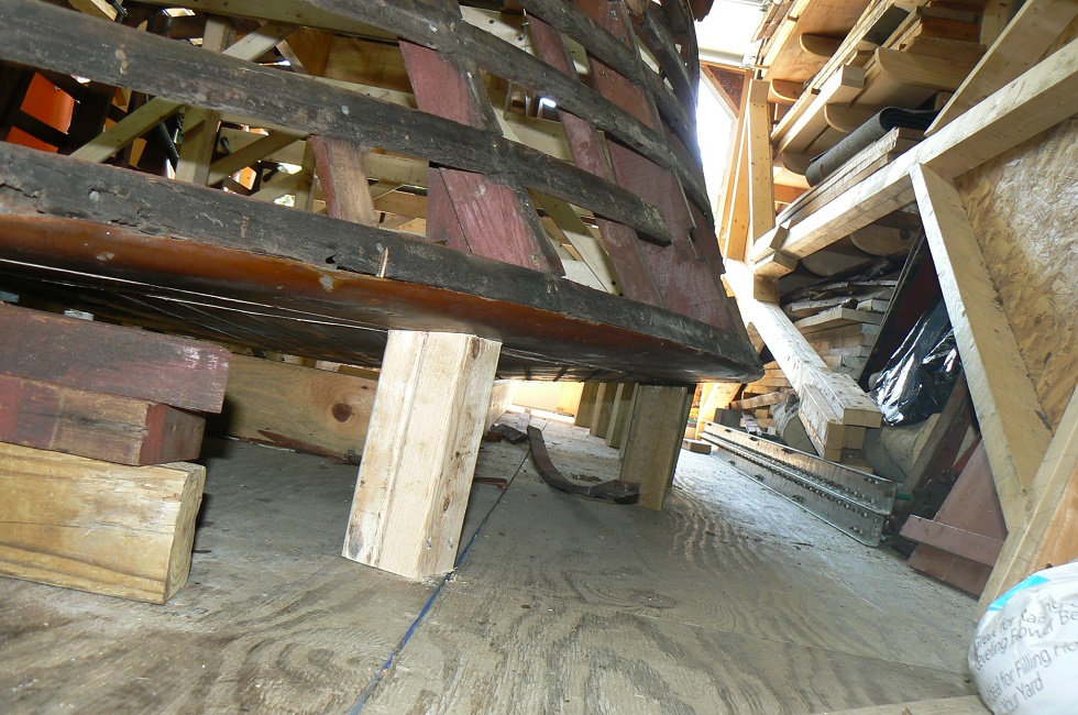

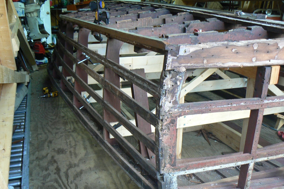

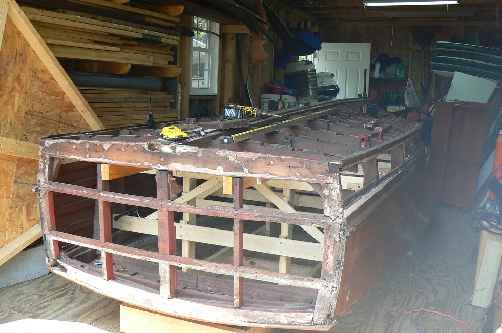

Ok so slight change of plans. Put the frames back in and opted to remove all the side planking in order to brace up the whole boat and make sure everything is level and straight. That the frames should be level and straight. This boat was very lose and I found a lot of backyard fixes under the planks. More rot that I didn't expect also. Looks like I'll be replacing upper frames also, boooooo!
Now to tweak her and begin reframing the bottom.

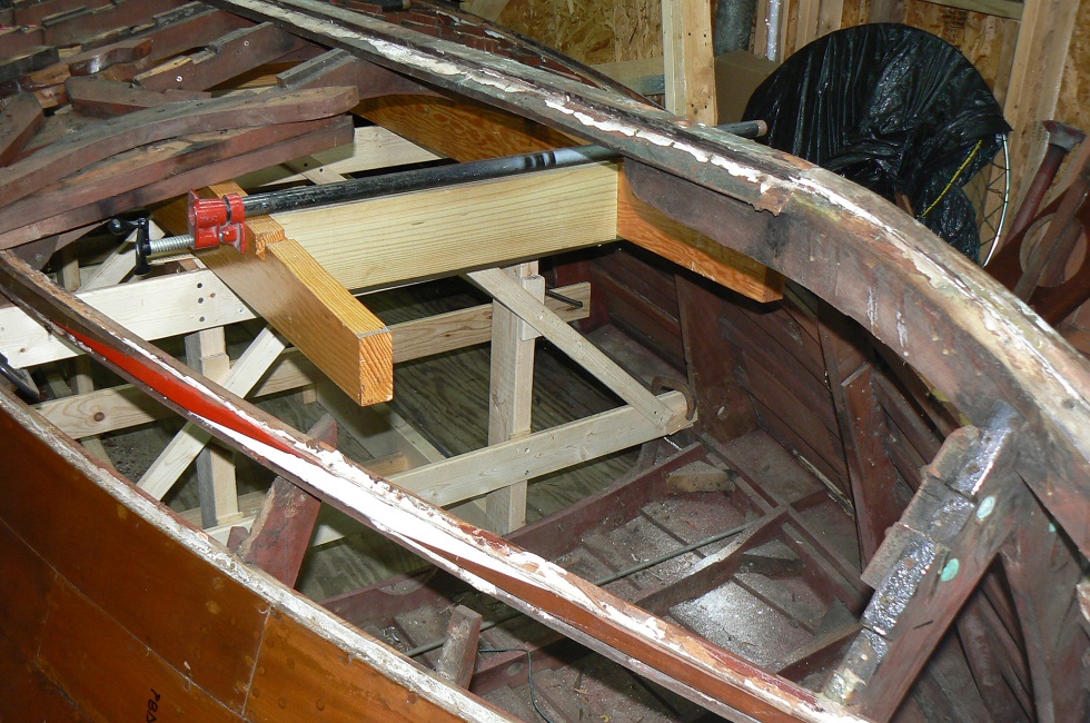

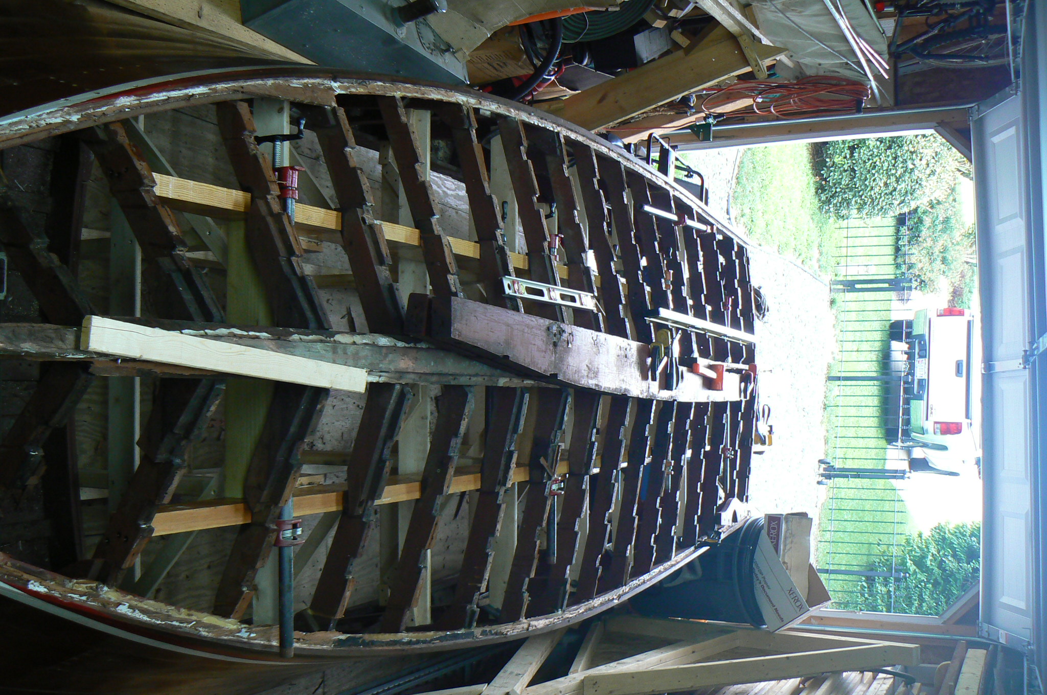

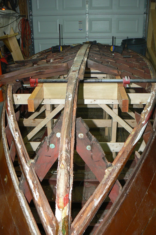

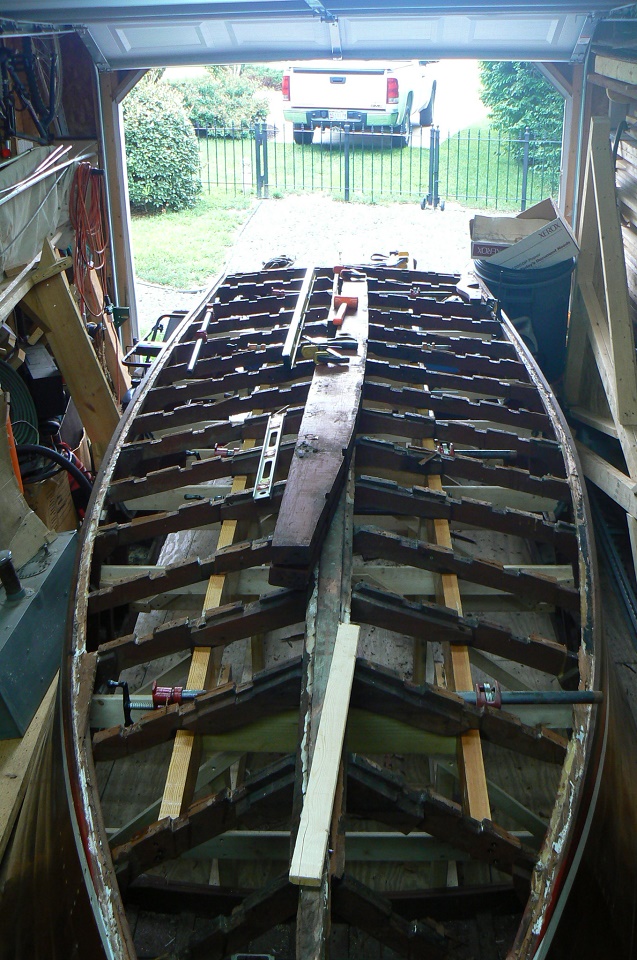

Well the hull is tweaked and the blocks have been screwed down to the floor with two long drywall screws, predrilled so it wouldn't crack.
NOW it's time to start reframing.

Re:'53 18' Century Resorter finally 12 years 2 months ago #99554
Making good progress there Bob, good thing you like woodworking huh!? :laugh:
