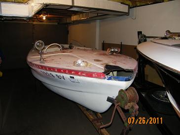

Try with the pictures. hold on.

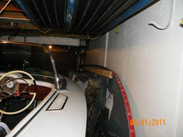

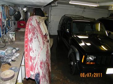

As you can see I'm pressed for space so I have the topside leaning against my basement wall. That's my Sabre along side.

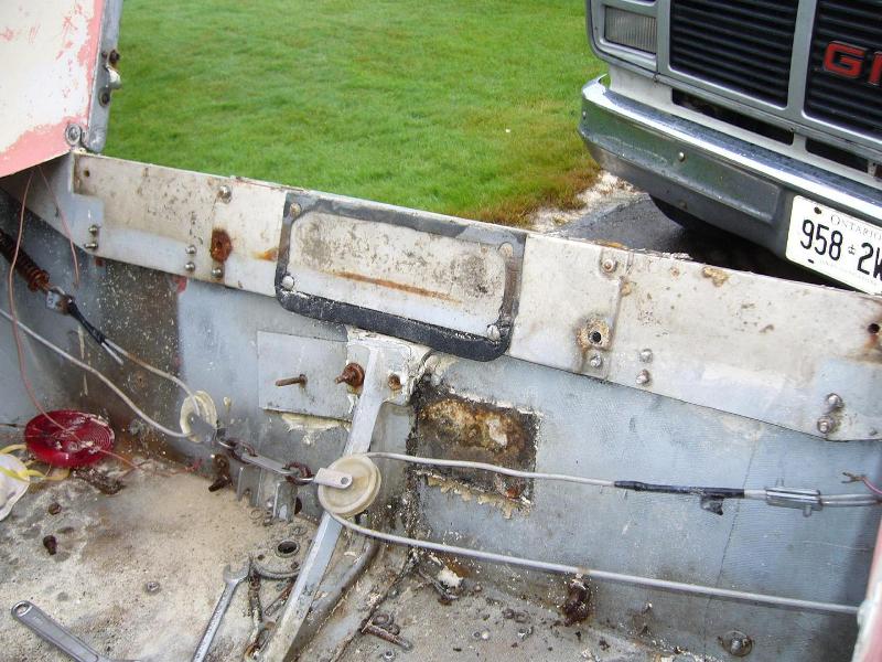

One of the reasons your transom may have broken is because the 1959 and later models did not have a transom brace installed like the previous models.
I have two 59's and both had cracked transoms. They can be repaired by using a milling machine to remove portions of the webbing and installing an internal stiffner making sure to place it where any motor securing bolts would go through it.
Then a transom brace can be fabricated and installed or you may be lucky enough to find an original Herters brace as they were used on many Herters boats besides the Flying Fish and Mark III models as well as sold as a stand alone part. Your 1959 should still have the tab on the transom to bolt the brace to.
Another contributing factor is what size transom the boat was ordered with. Three sizes were available, 15, 16.5, and 20 inch. The 15 inch transom has the least strength.
If you do go with a wood transom make sure you make provisions to mount the steering eyelets and tailcaps to something substantial as the aluminium transom does. The tail caps and fins get their support from the transom.

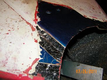

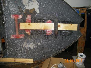

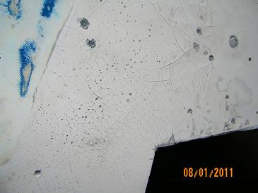

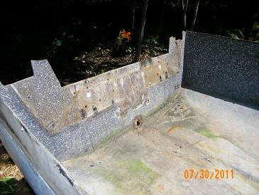

Thanks for the advice but I have no intention of reinstalling the aluminum transom plate. I'm not "restoring" the boat, I'm rebuilding it with some custom touches. I have more pictures from today. Worked on the transom.
Sanded the outside with a 40 grit belt sander to rough it up and expose all the hidden cracks.
Filled and rough sanded with 240 grit. Ready for prime.
New transom from inside. Not pretty painted yet. Matt on the outside shell, 3/4" marine, matt sandwhich, 3/4" marine, matt on outside and fiber filling small voids on all edges and then cloth for the finish topping.

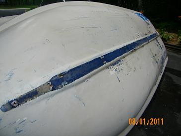

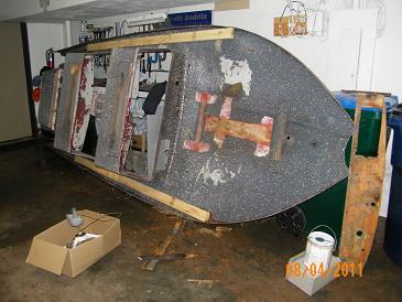

Removed keel. All bolts were rusted to nothing.
All tools needed to do the job properly.

The steering cable setup by the po was straight forward. All others I've seen were like you have pictured with the spring tension and pully. The one I have was a straight setup from the steering wheel to the motor. I'm thinking of a straight single. What gets me is a few years ago I sold two used setups and now I need one :S

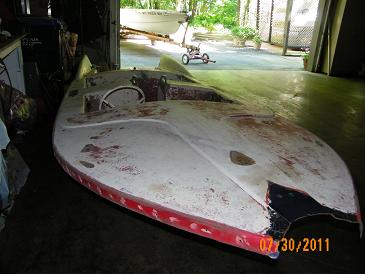

I'm looking at a doner boat that has both a windshield and steering that can be used.
Did some sanding today on the hull. I think the po used an epoxy with a brush. While sanding I'm going through several layers of paint but they do a perfect job of finishing the spider cracks. All I have to do is fill up some dock and trailer scrapes. The transom is finished and ready for finish coat.

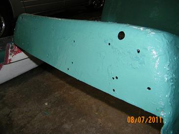

Finished Transom
Good start on the sanding until rain put the keebosh on it.
Re:1959 Herters rebuild 15 years 2 months ago #39769
Finished the prep sanding and did spot fills on the dock scrapes. Purchased high build primer/activator and some Imron white. The paint tech went for the whitest/brightest possible. Going to be an interesting weekend.

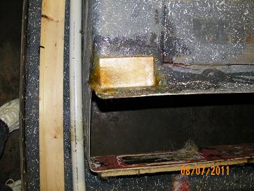

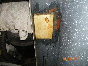

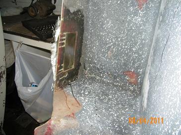

Re:1959 Herters rebuild 15 years 2 months ago #39833

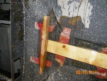

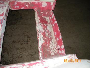

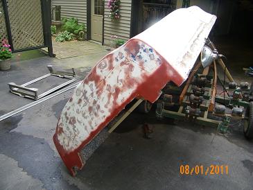

Started the underside of the topside..does that make sense?

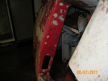

Removed all the garbage from behind the dash, finally got the steeering wheel off, had to take it apart from behind.Took out two bees nests, ground off all rusted nuts and screws so they could be removed, put glass backing on the holes so they can be filled from the top with matt and mud. Started replacing backing boards. Tomorrow's another day. [img] [img]http://www.fiberglassics.com/media/kunena/attachments/legacy/images/100_0050.JPG
Don't know what this cutout was for, radio? glove box, anyway it's getting filled in.
Start of the new backing boards glassed in.
Re:1959 Herters rebuild 15 years 2 months ago #39966

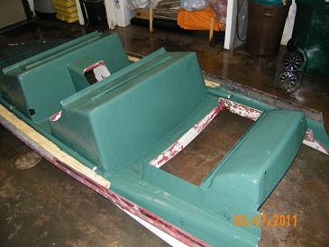

More progress on the underside of the topside.

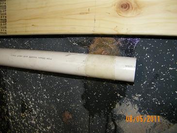

Finished replacing the wood bracing, and installed the 1 1/2" pvc for the wire run. Put on a heavy coat of high build primer on the hull. Learned a few lessons on that. I hadn't used my spray gun in a few years .... like 10 or so, got it all cleaned up, ran laquer thinner through it ready to shoot. Mixed the high build according to directions with the activator and thinner. The darn gun would not for the life of me suck up the high build!!! Now there is a pot life of about three hours on the stuff once mixed, gun full, and not working, dang! Ugly time. I brushed the high build on the entire hull and it really did a good job. Heavy heavy build up so I'll have lots of sanding to do but the good side of the story is that I will not have to do any minor filling cuz the primer is so thick there is not a pinhole in site
Wood bracing glassed in for the stern light
Heavy wood bracing under the foredeck
1 1/2" PVC glassed in on the starboard side for wire run
Heavy high build in my non osha aproved spray booth

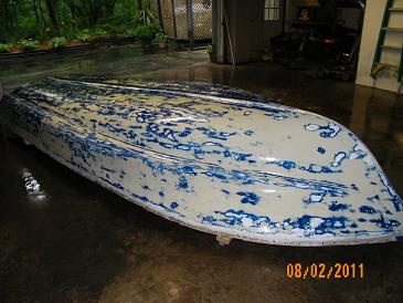

Re:1959 Herters rebuild 15 years 2 months ago #40064
Did some more finishing on the hull today, sanded the high build primer to a baby bottom finish, just needs the wet sanding now before I do the color coat. Installed the 1 1/2" pvc on the port side for another wire run, put back up glass on the final three monster holes on the deck and glassed in a new backing board behind the dash. Put glass matt on the back of the panel, clamped the new backer to the wet matt, hope it holds. No pictures today, too tired from sanding.

cal, if your pvc is level, you might want a drain hole or two. it will probly get some condensation/water in it, even if the wires are insulated, wouldnt be good for them to lay in dampness. just a thought.

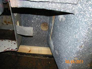

Had a small crack in the corner of the front seat, reenforced it with maple, glass mat and cloth.
Here are the drilled holes in the pvc wire runs. Anyone curious about the 2x4's they are strictly for support while the deck is off the hull, they'll come off later.

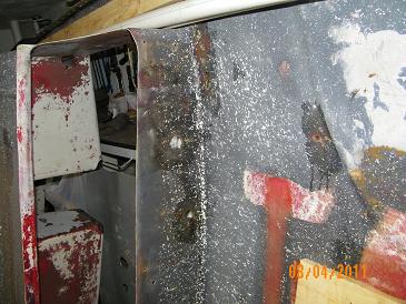

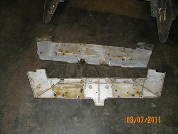

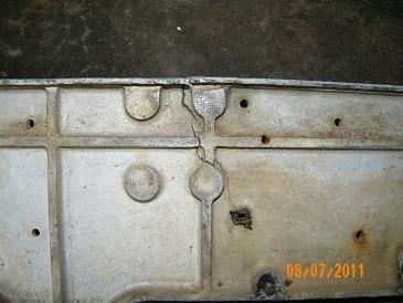

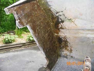

Here is the old transom aluminum brace. Notice the crack, there wer two of them. Now I will be using these peices for patterns...maybe.

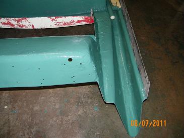

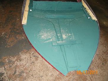

Underside of topside basework is finished,
Underside painted, ready to flip for the top hole filling and repairs.
Inside look of the fin, without these it would be just a boat.

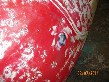

Notice all the holes that need filling in the motor well. Gives you an idea what the rest of the topside is like.

Flexing, well I guess! The transom was about 2 inches out past the rest of the stern. There are acutally two of those cracks on each side pretty much where the motor mounts were. There was a 1959 Mark 58AE hanging on the back, I strapped it down pretty tight the day I brought the boat home. Had visions of the motor dragging down the highway hanging on by the cables and sparks flying.

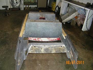

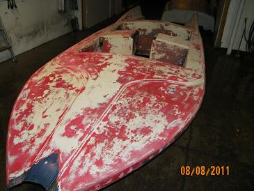

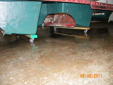

Think I did enough for a day.
Started filling holes in the deck.
Fresh start for a clean dash.
Some perspective on the lack of work area. Tomorrow I'm getting some 2x4's and castors and mount the top deck for easier moving like I did with the hull. The tipping and tugging is taking a toll on my old bones.
Soon the bullwork will be done and the fun part of putting it together begins. Haven't thought about a deck color yet but the bottom hull will be snow white. Maybe I should have a suggestion box open up on this thread. Dark emerald gree, Candy red, Deep blue, Pink was nice but there already is a fish out there with that color. Black - naah.

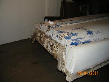

Did some more hole filling and rough sanding today. Took a tally and counted 258 different holes in the topside all different sizes and shapes. Finally got some wheels under the topside to ease the work.
Paraphrase Scotty: {Admiral, we got wheels}
Motor well holes filled and rough sanded, ready for high build prime and more finishing.
