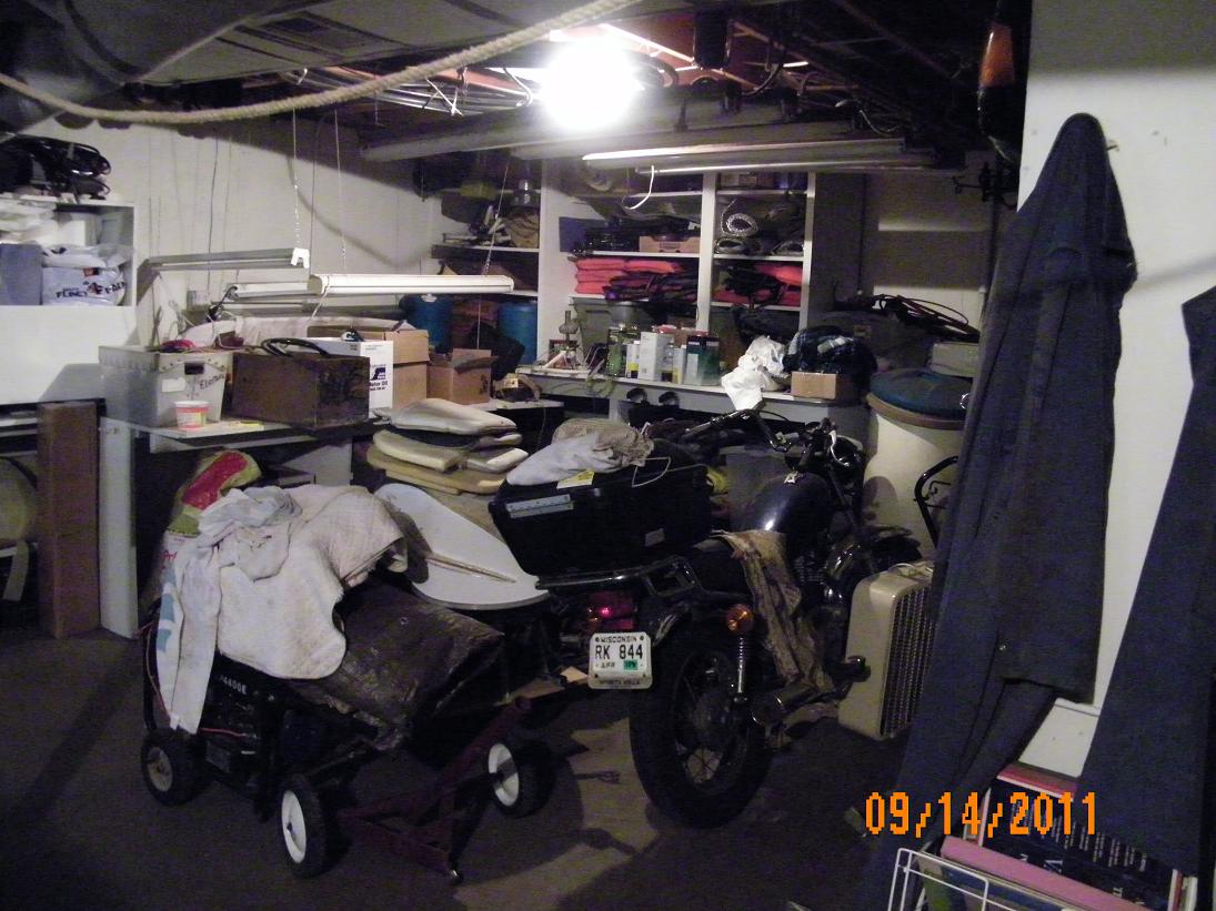

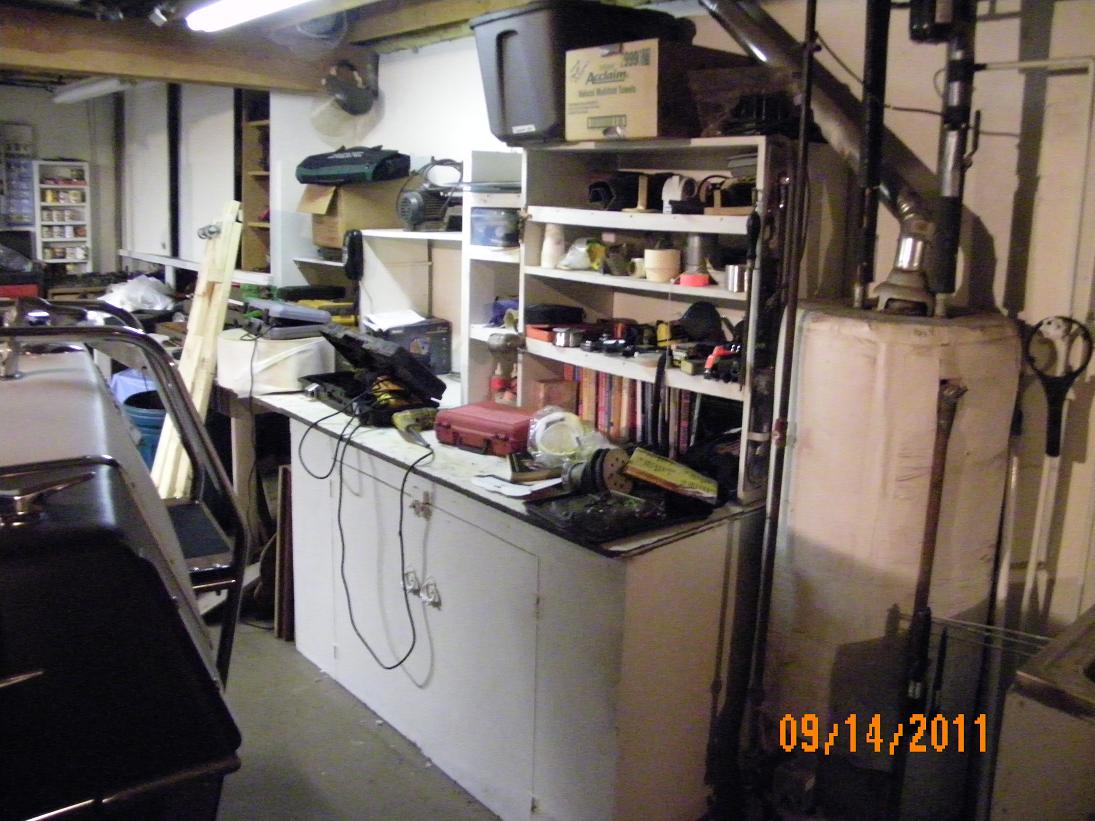

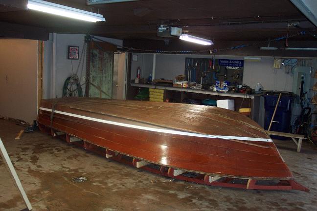

Re:1959 Herters rebuild 15 years 1 month ago #44239

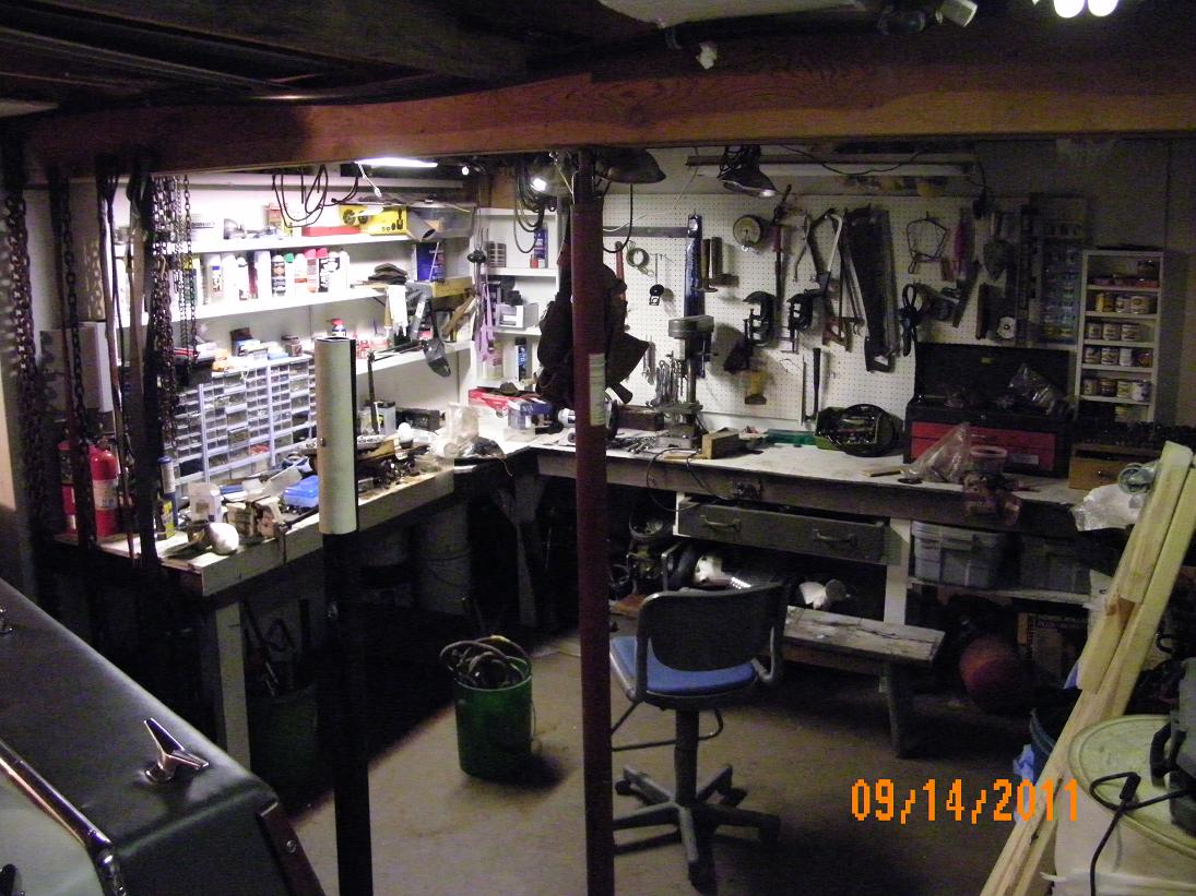

Ok, here's the answers to some questions. First proof that I flipped a woodie alone. and second the dirty underbelly of my work area. Some places are hard to walk through. The garage part is where I do the pictures.
And now...the ugly side.
If you look close you can see the Merc Mark 58AE jammed under the workbench.
That's the tour. It's crowded.

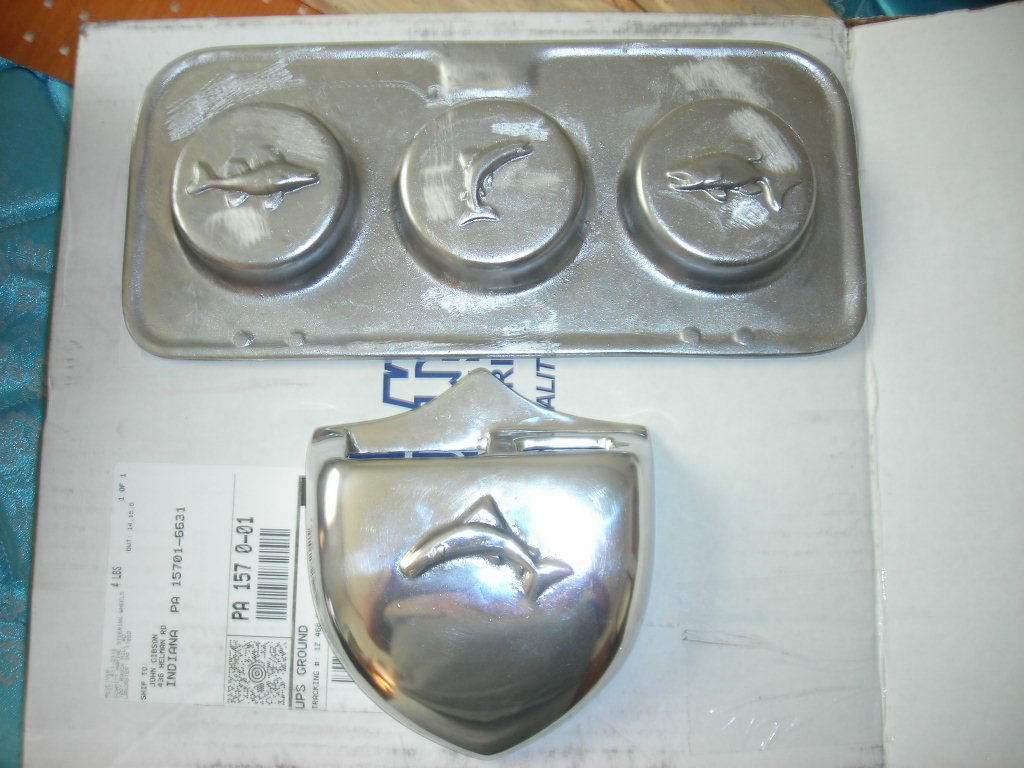

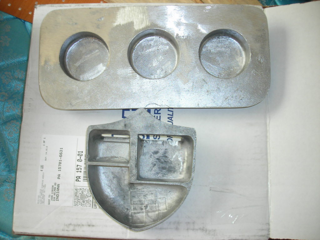

cal i bought these for my 59 flying fish,they are repops,but pretty cool,one is the glove box that when open works as a 3 space cupholder,and yep they were an option in 59.
the smaller one is a ciggerette box and lighter holder,also an option,at $3.85 installed,lol.i actually got them awhile ago but i was just able to come up for the money for them,now i can post them.

I have the glove box cover but not the cig holder, I don't think it was ever on the boat. Smart move with the beams, think of the massive bbq you can put on the deck.

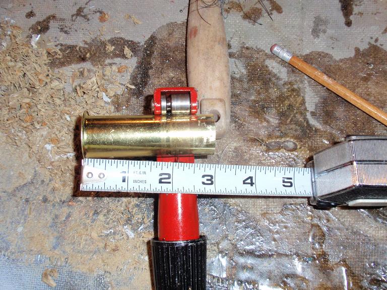

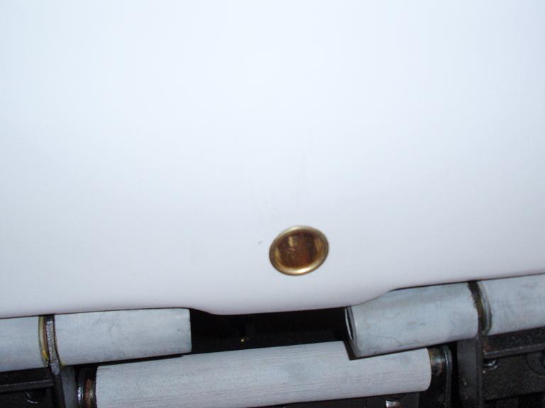

Hey Mark, I see your posts. I also put mine in tonight. Didn't take many pics but here is what I have. I used the fast cure 4200. Black because it is also what I am going to use to marry my top to the bottom along with fasteners, couldn't see buying a whole tube of white for just a smidgeon. I cut the tube too long and didn't find the screw up until I already had it pushed in. Wound up making short splits on the inside end and then flaired it with the peening hamer end.
Hole drilled.
Coated the entire inside of the hole with 4200 using my fingers and the put a bead around the tube.
The expensive flairing tools
After the cut.
Finished.
Next is to start dressing up the inside of the hull.
Didn't want to use 5200 and wait 7 days for it to cure, I've had plenty of experiance with that stuff, used about two cases when I did the bottome of the Sabre.

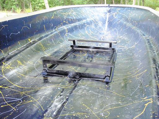

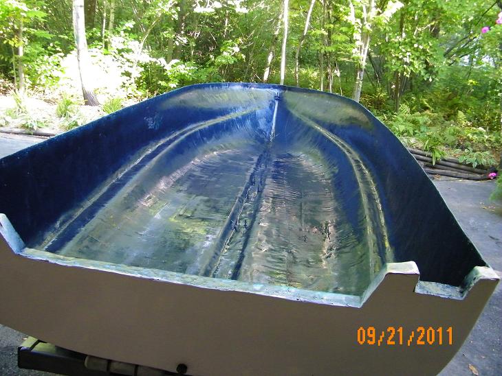

Painted the inside of the hull this morning before the wind picked up. Have to admit back in the 50's fiberglass laying was a by gosh - by golly experiment. With the dark paint on the inside all the glass cloth, hand layered drips, runs, hits and misses all show up big time. Had to come up with a way to camo the mess so I spatter painted over the dark base with the colors that are being used on the hull and topside. It sure fools the eye.
The inside was painted with some old acrylic enamel many years old, dark blue. I poured two or three times the amount of hardner in it that is called for so it should toughen up to stand some foot traffic.
This picture was taken inside so the blue looks almost black but you can see how the spatter paint of white and yellow trick the eye and you do not notice the glass layovers.
Re:1959 Herters rebuild 15 years 1 month ago #45060
Cal,
Great job. That's what I did with mine. The original was white with black spatters so I did the same thing. Wagemaker did basically the same thing with certain models f their boats. You can see the weave on mine but you have to get real close now since the spatter masks it.

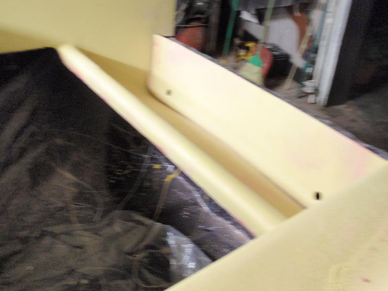

Re:1959 Herters rebuild 15 years 1 month ago #45291

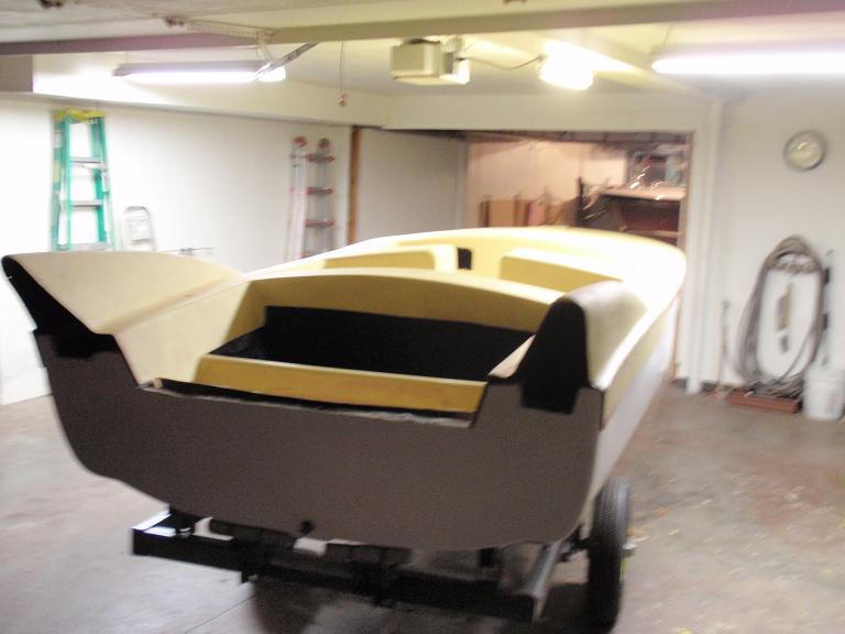

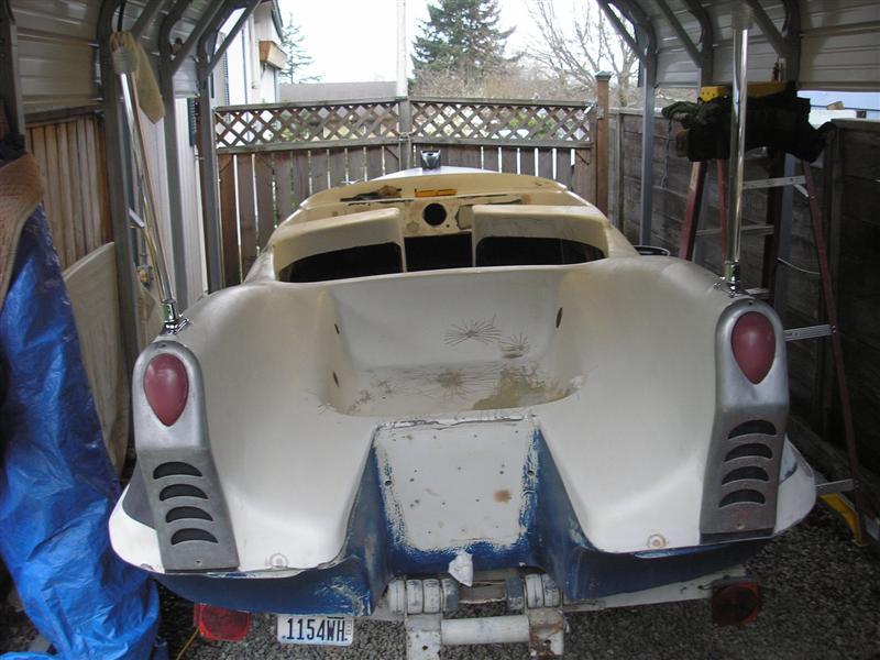

Major step done today. Put humpty dumpty back together. Again using the chainfall and a few straps. One problem I didn't figure on was the width of the new transom vs the aluminum plate that was in there. When I set the top back on I had to cut out about an inch of motor well to make up for the thickness of the transom. A little glasswork will fix the problem. All glued on with the 4200. Glad I put t he 1/2" wood backer strips on the shell because the two halves went out of shape while apart. After the top was in place I used drywall screws to pull the two back together into shape. Will leave those screws in until I put the trim back on with the through bolts.
Setting up for the lift.
Getting it balanced on center so it wouldn't tip to one side.
Raised position.
After the install.
From the stern, used the fin edges to make the final lineup even.
Where I had to cut out the motor well to make up for the heavier transom.
The piece that will be worked back into place.
Sheet plastic layed inside the shell before I lowered the top to keep the bottom clean when I paint the top.
The next few weeks will be fine tuning the topside, filling nooks, crannies, pit holes etc for paint, and of course the motorwell repair.

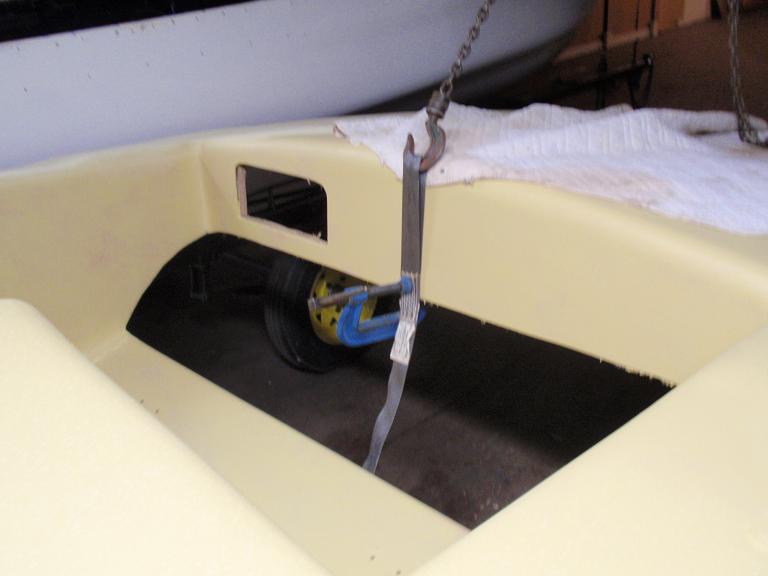

Re:1959 Herters rebuild 15 years 1 month ago #45769

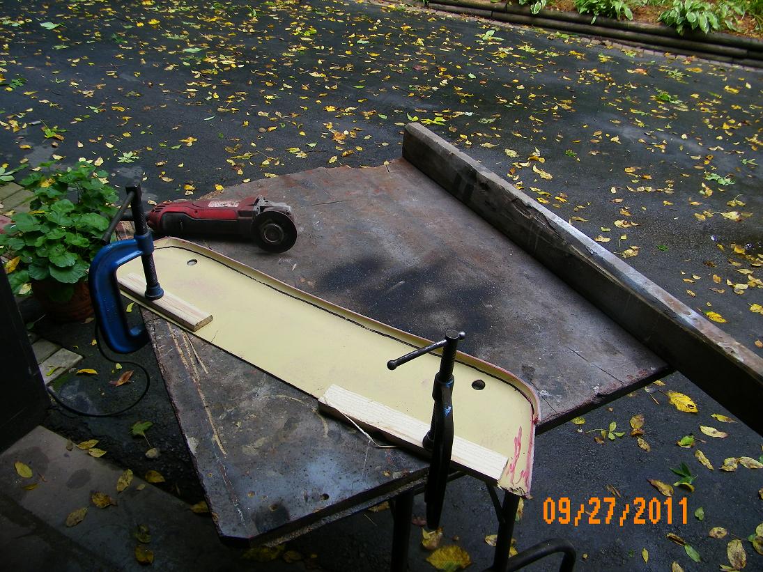

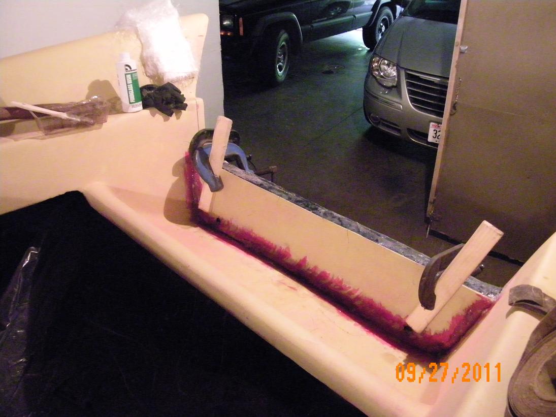

Did some fixin' on the motor well today. The part I had to cut out to make up for the heavier transom.
Dry fitted the cut out piece and marked it where it needed trimming.
Easy fast cut with a metal cutoff blade.
Used glass mat to install the piece.
The red color comes through from where I ground down to the old glass and gel.
This evening I did the sanding and cosmetic filling. I have to pick up some primer tomorrow and the install will be done then I have to drill the holes and put in two drain tubes.

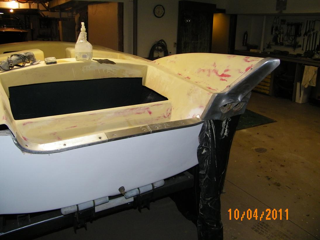

Re:1959 Herters rebuild 15 years 1 month ago #46478

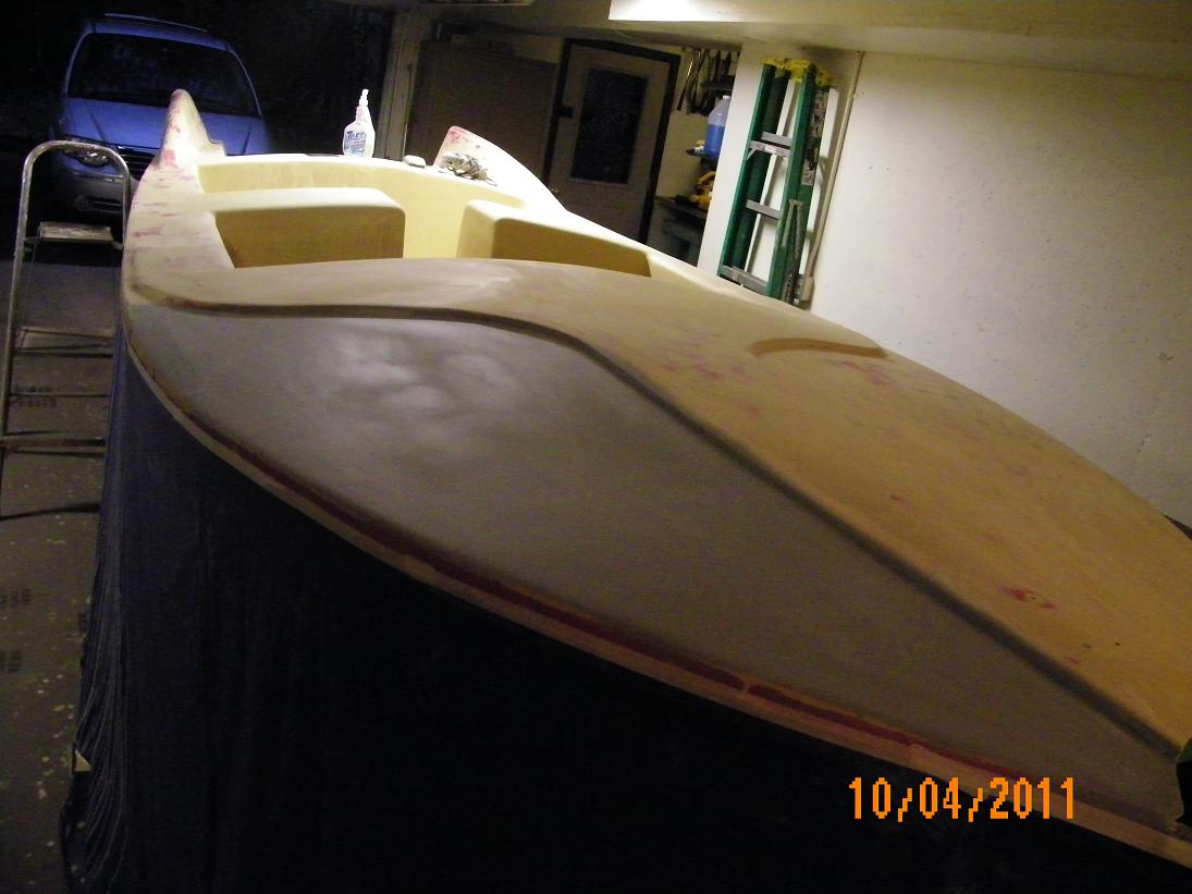

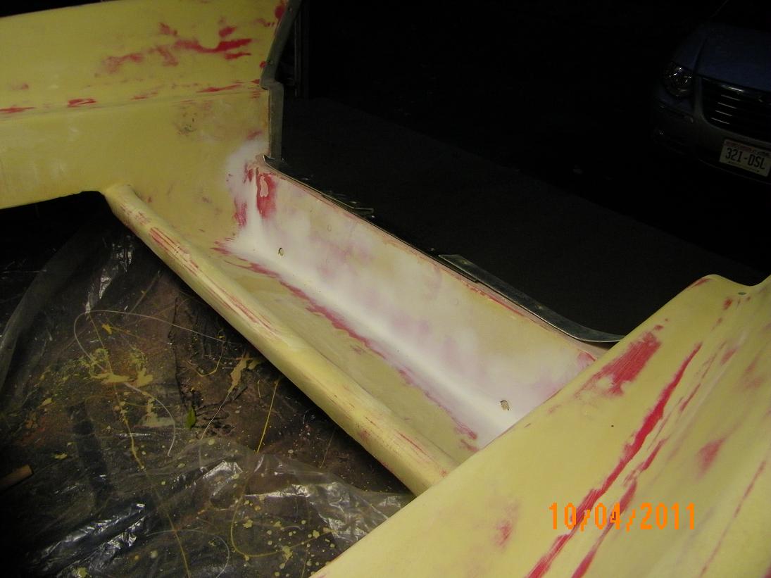

Been a few day since I updated, really busy week. Started wetsanding the topside for the final coat and am finding lots of pinholes, more than I found the first time around. So.... the past few days I'm doing the tedius(?) job of filling, sanding, filling, sanding, on and on. Got the transom rebuild finished all except the motor well drains. Three different colors of primer on that baby now but getting close to the final goal. I envy you guys who just have to rough up a surface and squirt on a new coat of rustoleum.
Tried dry fitting the fin ends back on along with the transom caps that I took from my Dorset donar. The cap pieces will need some "custom" fitting but shouldn't take much to fit in.
1/3 of the bow actually finished (gray primer)
View from the starboard side after the wetsanding.
Dry fitted fin end and transom cap.
Inside of shortened motor well ready for gray primer.
