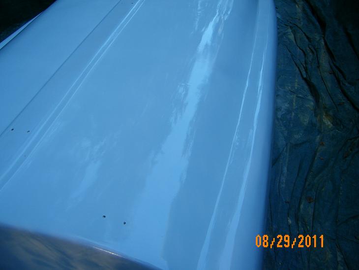

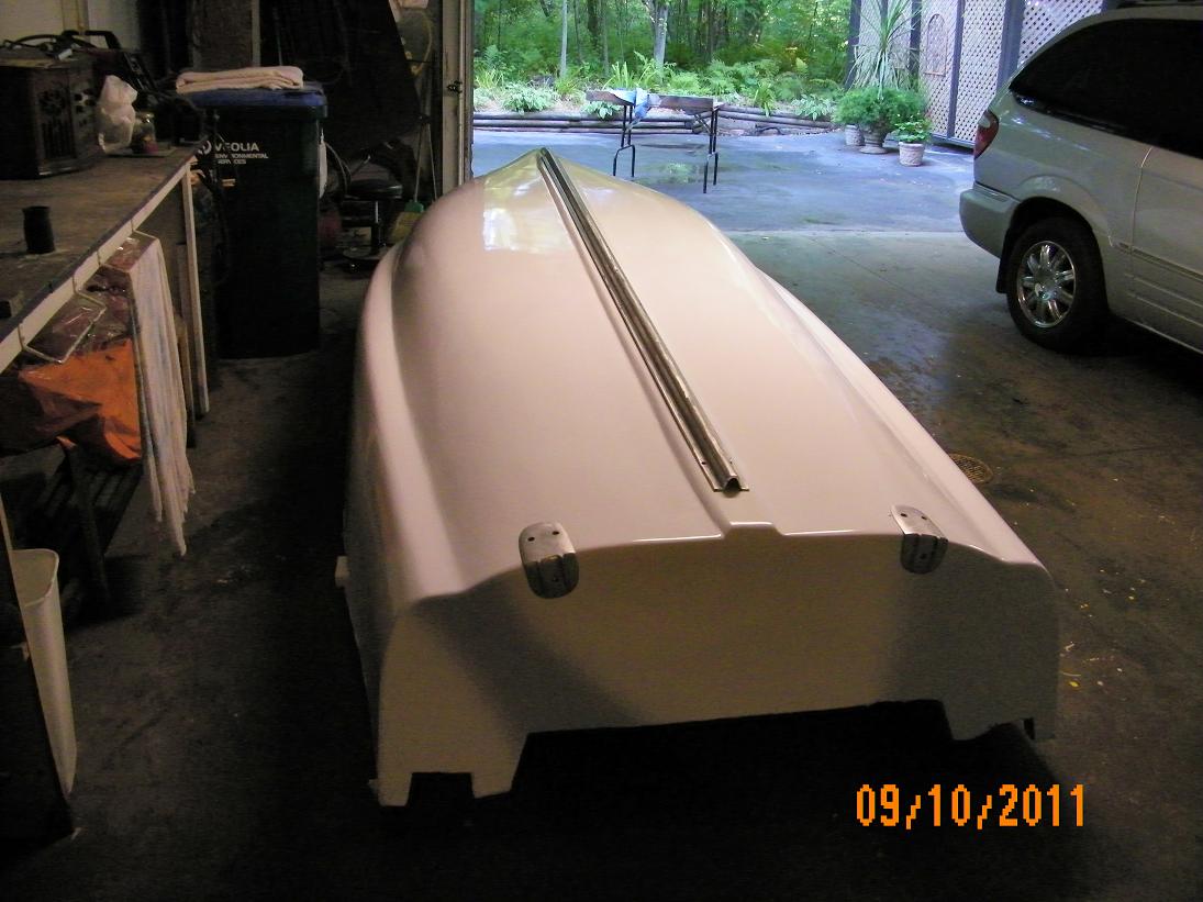

Did the Imron today. After wet sanding and finding a few more spots to fill I finally got to shoot some Imron this evening. Weather was perfect. Problem, I ran out of paint!! I knew that qt was not going to be enough and another pint would not have been enough either. I got a good first coat on the hull though and it came out well. The Imron seems very forgiving if squirted on following the mix directions, 3:1. Tomorrow I will pick up another qt and finish the job.$$$. Very high gloss but there are some spots where I shot too thin and it didn't flow like it should that's why I need a second coat.
Here in the non osha approved brush/roll/spray booth formerly occupied by my motor home.
As you can see the sun was going down, the reflection on the transom.
The high gloss of a single coat with the Imron activator.
Another view, the Imron has already set and is touchable, looks like it's still wet....but nooooo

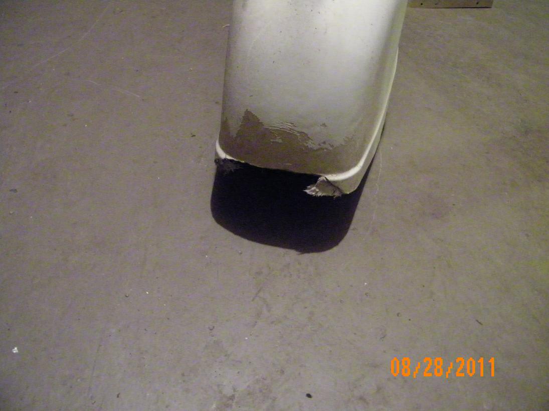

Other than that I rebuilt the back of the Gator fender that had a piece missing, and did some more straightening on the fender grills.
Before the fender repair.
After the repair.

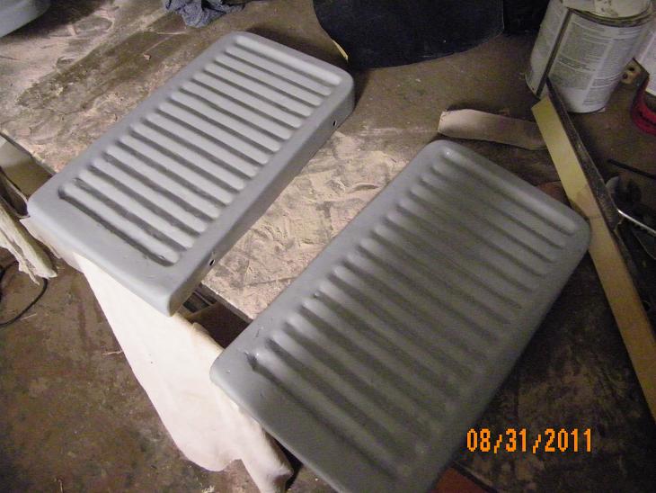

Working on the bent up aluminum fender grills. These are a work in progress!
Sorta hit the brick wall today.

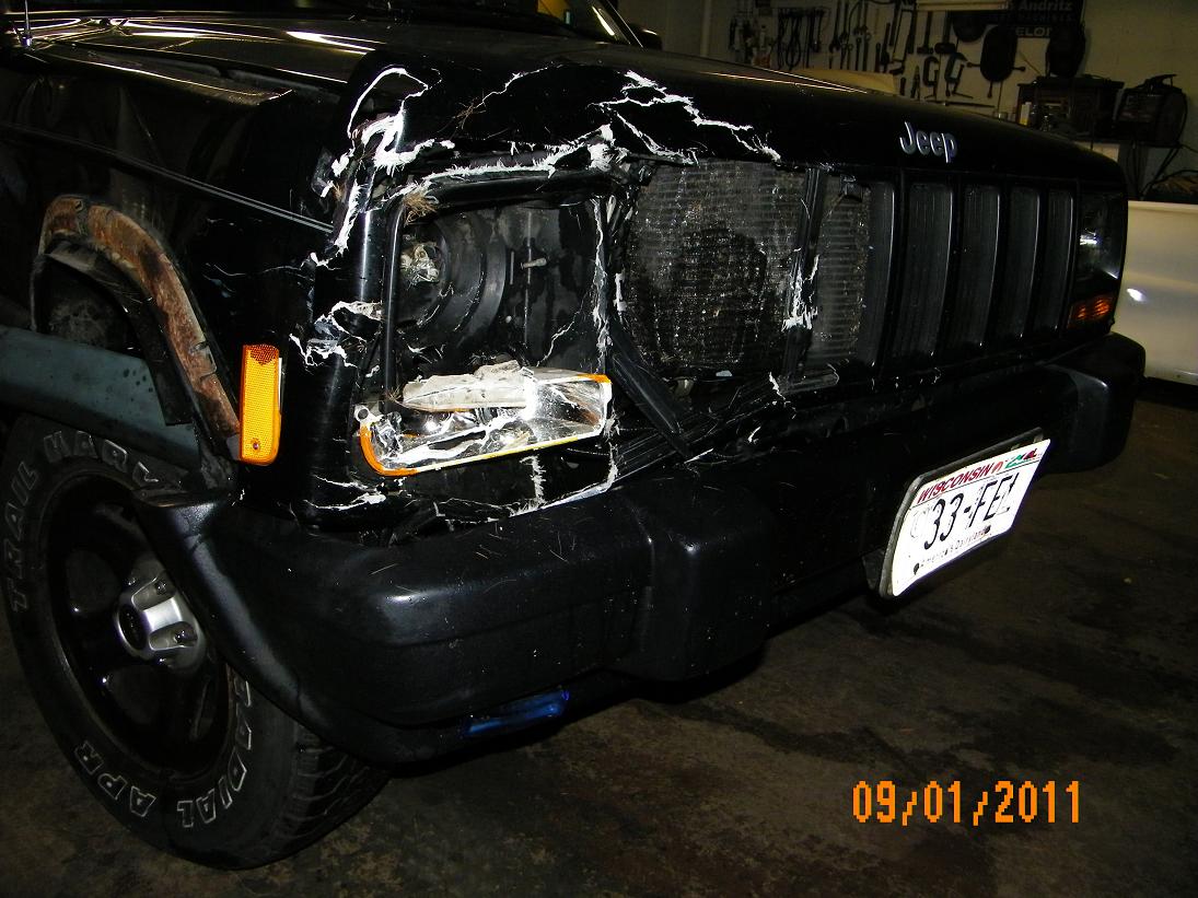

I wish I did hit a brick wall yesterday. Instead 200# of venison decided to duel with my jeep at 65 mph on the interstate. He lost, My baby was seriously wounded to the point of non runner. The boat will sit on the shelf for who knows how long until my sweety is back on her wheels again. Now I have to go through all the agonizing crap with motor clubs and insurance companies.
I will do all the repairs myself once the insurance settles up.
This happened at exactly midnight Wednesday. The two sheriff officers that helped me out found the buck stone cold about 10 feet from the side of the road. No match at all, didn't get far after his poor decision.
If you look closely in the background you can see the Herters laying in wait.
Re:1959 Herters rebuild 15 years 2 months ago #42924
Very sorry to hear about your unfortunate encounter Cal! Glad you're okay, the Jeep looks a mess. :laugh: :(

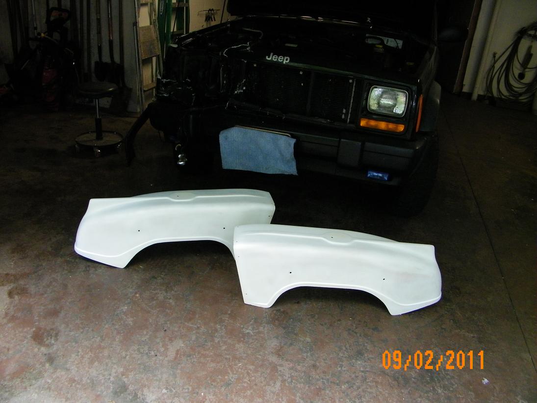

Finished the Gator fenders this afternoon, all in primer.
The rest of the afternoon I got sidelined.

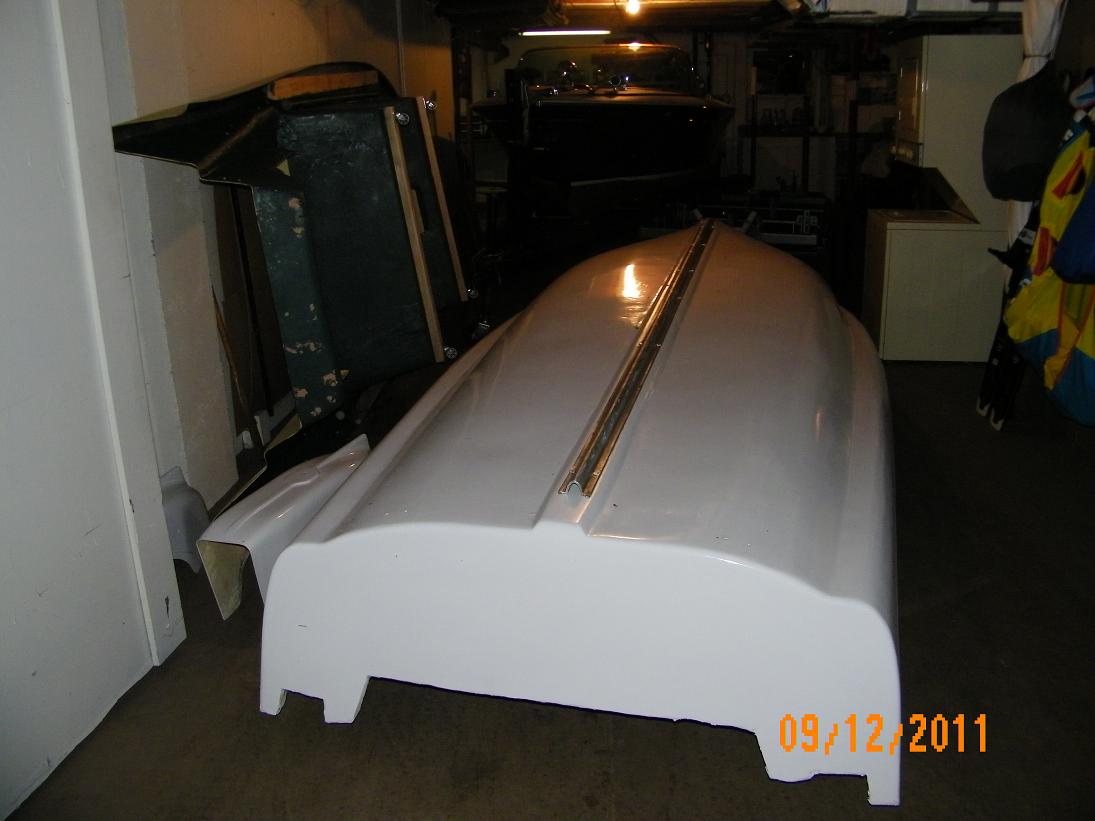

Back to the Herters again, finally. Working oh getting the aluminum keel cleaned up so I can put it back on, get the hull back on the trailer. Finished up the repairs on my tow vehicle all but the paint which I will do today. Not bad for what the insurance company called total. I did it all with a buffer.
Re:1959 Herters rebuild 15 years 2 months ago #43569

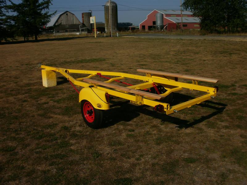

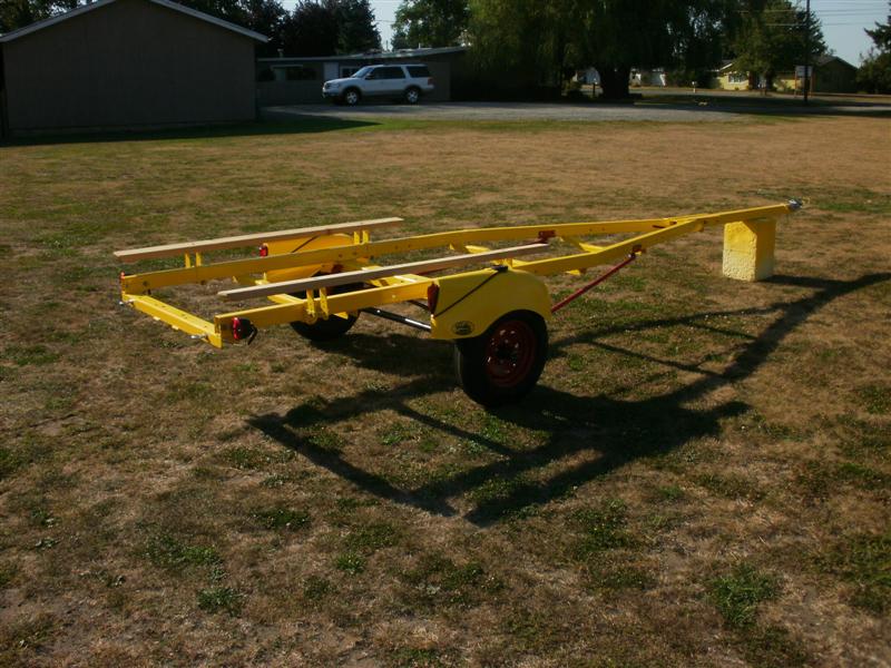

Got my trailer about 90% done today - lights all work and just small details to ad . Here's what Sunburst Yellow looks like. I'm going to have my boat Red & White so I added some red highlights to the trailer. Nice job on your tow rig. Can't believe how fast you work and what you get done !!
Re:1959 Herters rebuild 15 years 2 months ago #43866
Cal, are you hiding a crew of workers over there that help with your projects? Man, I'm envious of your production rate & quality of your work. Make the neighbors wait until after the boat is on the trailer for the libations, we don't want them getting tipsy and dropping it! :P
The TeeNee looks great Rick, nice work. ;)
Re:1959 Herters rebuild 15 years 2 months ago #43878
Rick, WOW! Fantastic job, are those fender tailights for real? Right down to the decals. Red wheels set it off. Can't wait to see a boat sitting on top.

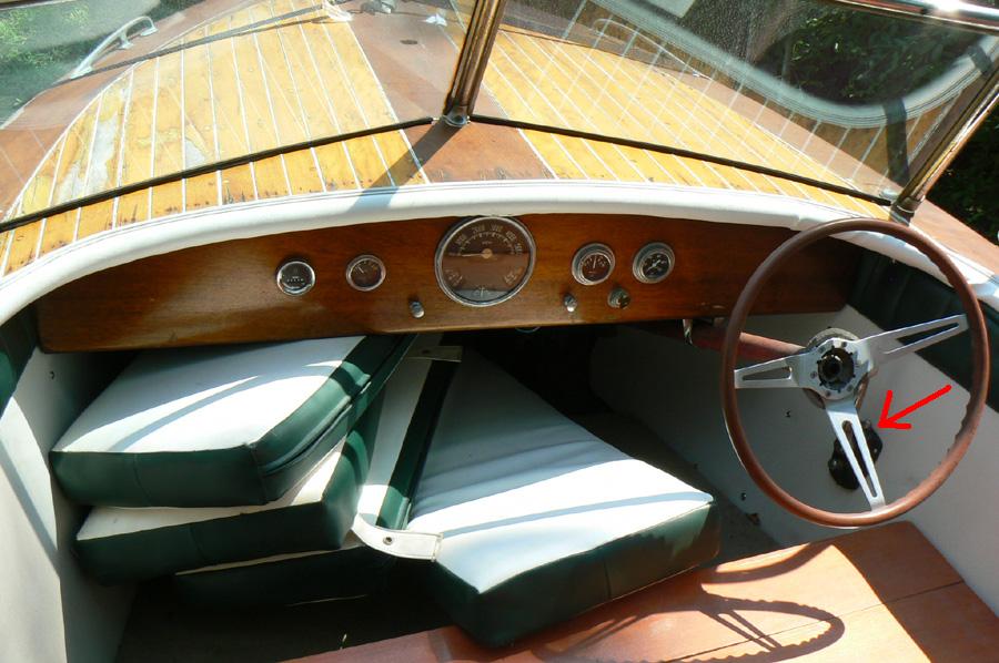

No movement on my resorter yet. Just researching first. Fortunately/unfortunately, depending how you look at it, mine is not so pure. The 283 Flagship is not original or period correct. So I already have a custom resorter. I'm not real familiar with the transmissions but mine must be hydraulic because of the throttle/gear shift handle isn't right.
Should have a gas peddle and the long handled floor shifter. Cushions and seat are wrong too.

We could start another thread on the woody side. Can't really see the shifter but if it's a single lever it's possible someone upgraded to a velvet drive which is controled with a single cable. Thomas might know if any changes were made in production.
To keep this thread straight, I just finished bolting down the aluminum keel and will start on the trailer roller and bunk alignment.

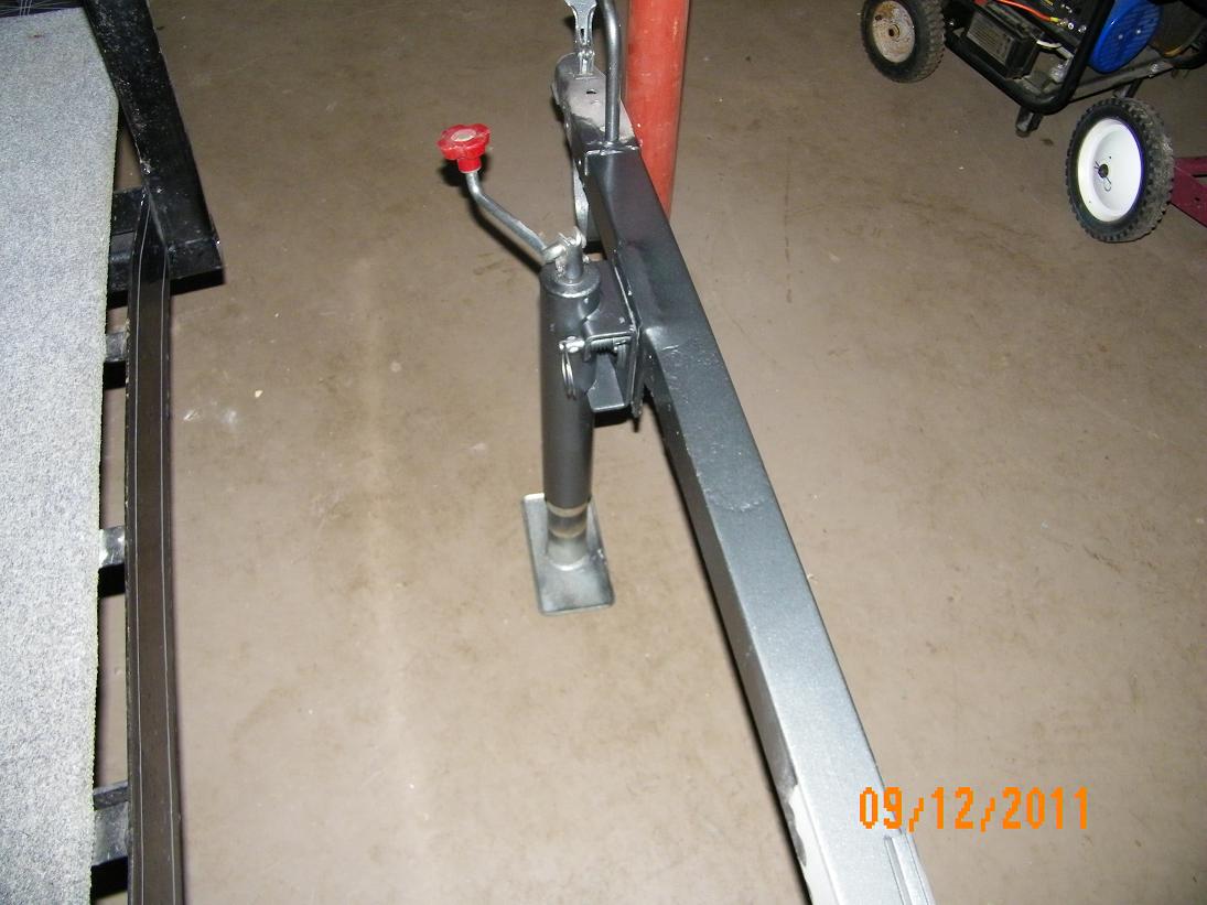

Painting the aluminum would be a very last resort. I had given some thought to wire brushing it or putting some type of swirl on it and then a few heavy coats of high gloss laquer, time to experiment I guess.
As I mentioned today I bolted the aluminum keel down using 5200 as a sealer after that I welded a foot type tongue jack on the trailer, tomorrow I have to pick up a treated 2X4 for the bunks, already have the carpet.
The tongue jack.

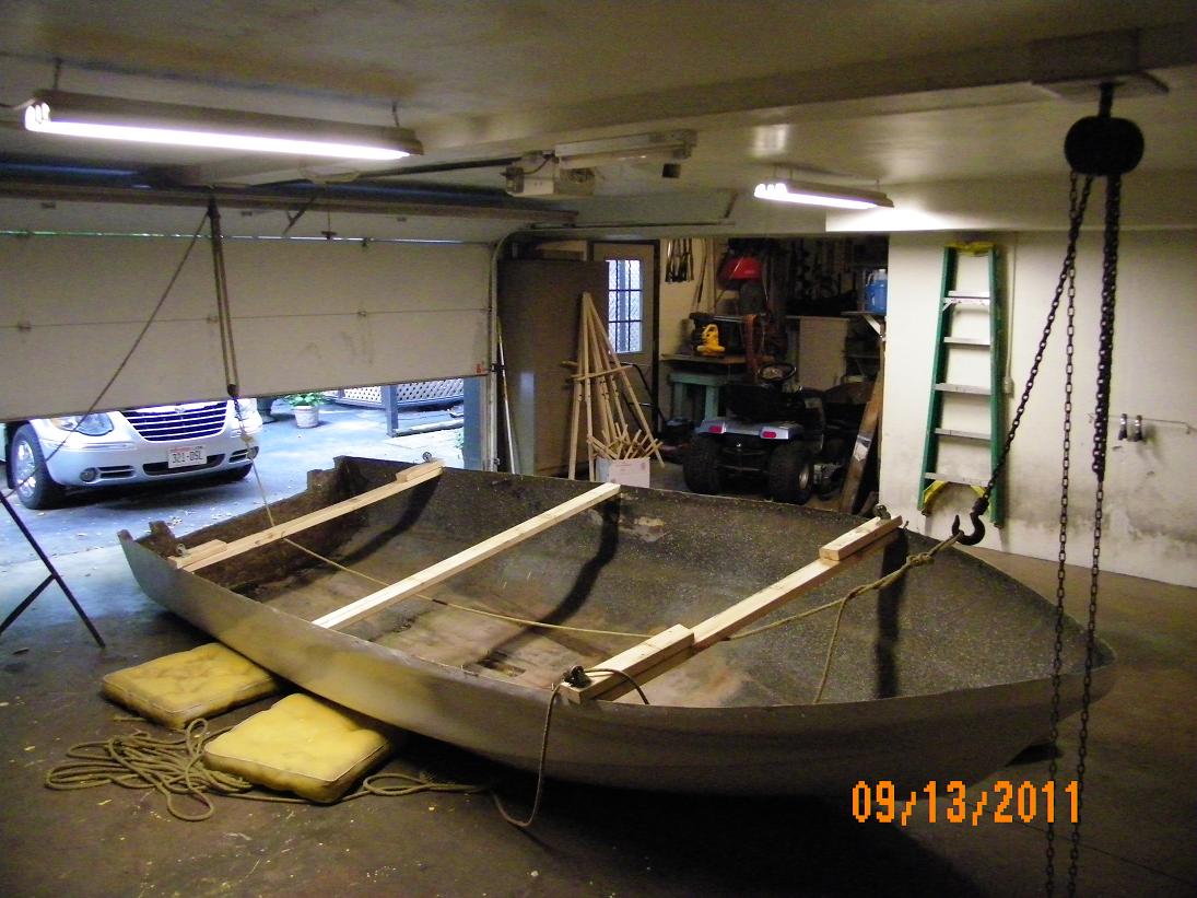

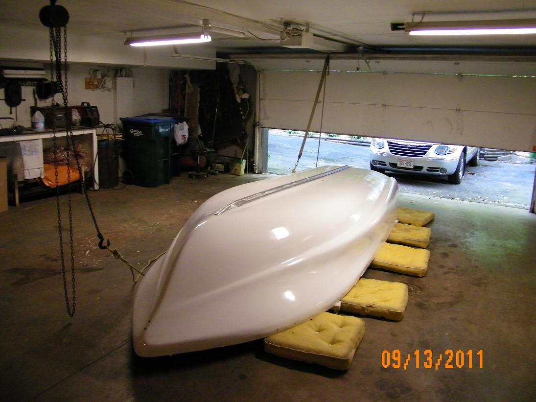

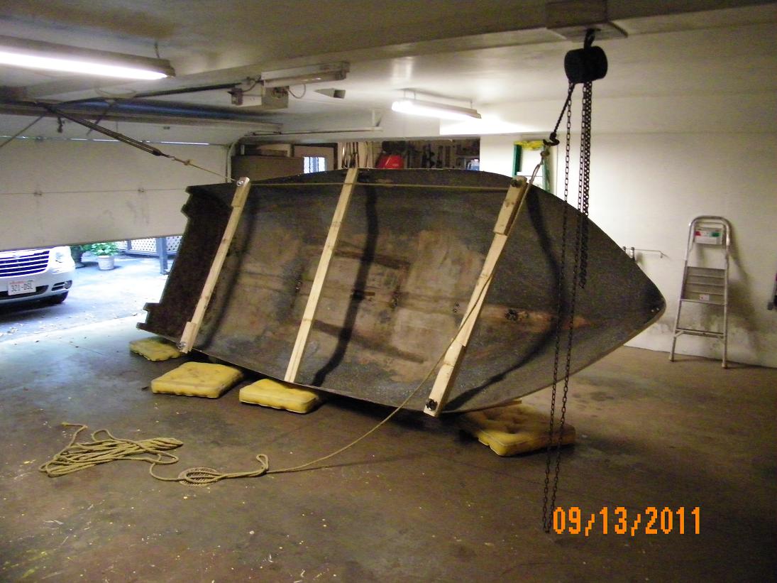

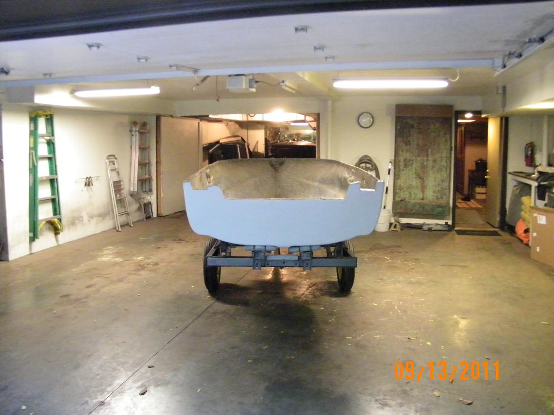

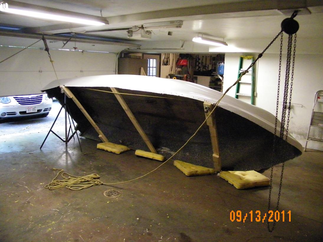

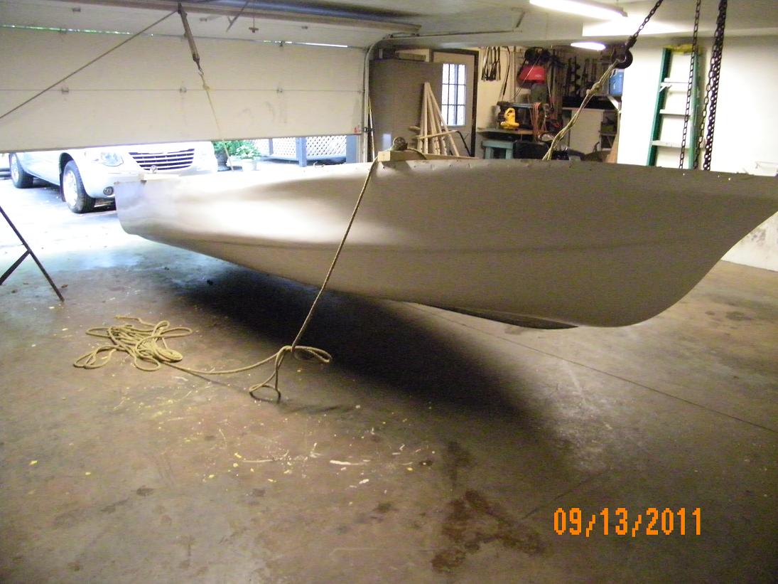

Saw your post John, time to wait for some feedback. I COULDN'T WAIT ANY LONGER.
After putting the bunks on the trailer I went for broke. Same way I flipped my Woodie so what the heck.
Lots of pictures. Getting ready
Heere we goooooo
And finally......
I used a small block and tackle on the stern and went for overkill with a three ton chainfall on the bow, ya never know...
Re:1959 Herters rebuild 15 years 2 months ago #44187
You're a brave man, Cal! :ohmy: (The steel beam in the ceiling is a nice touch, comes in handy I'll bet.) Nice work as usual, thanks for sharing the procedure pics.
Re:1959 Herters rebuild 15 years 2 months ago #44199
