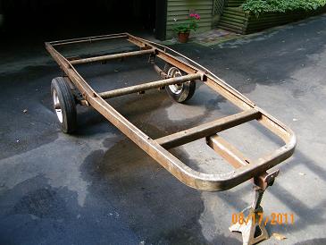

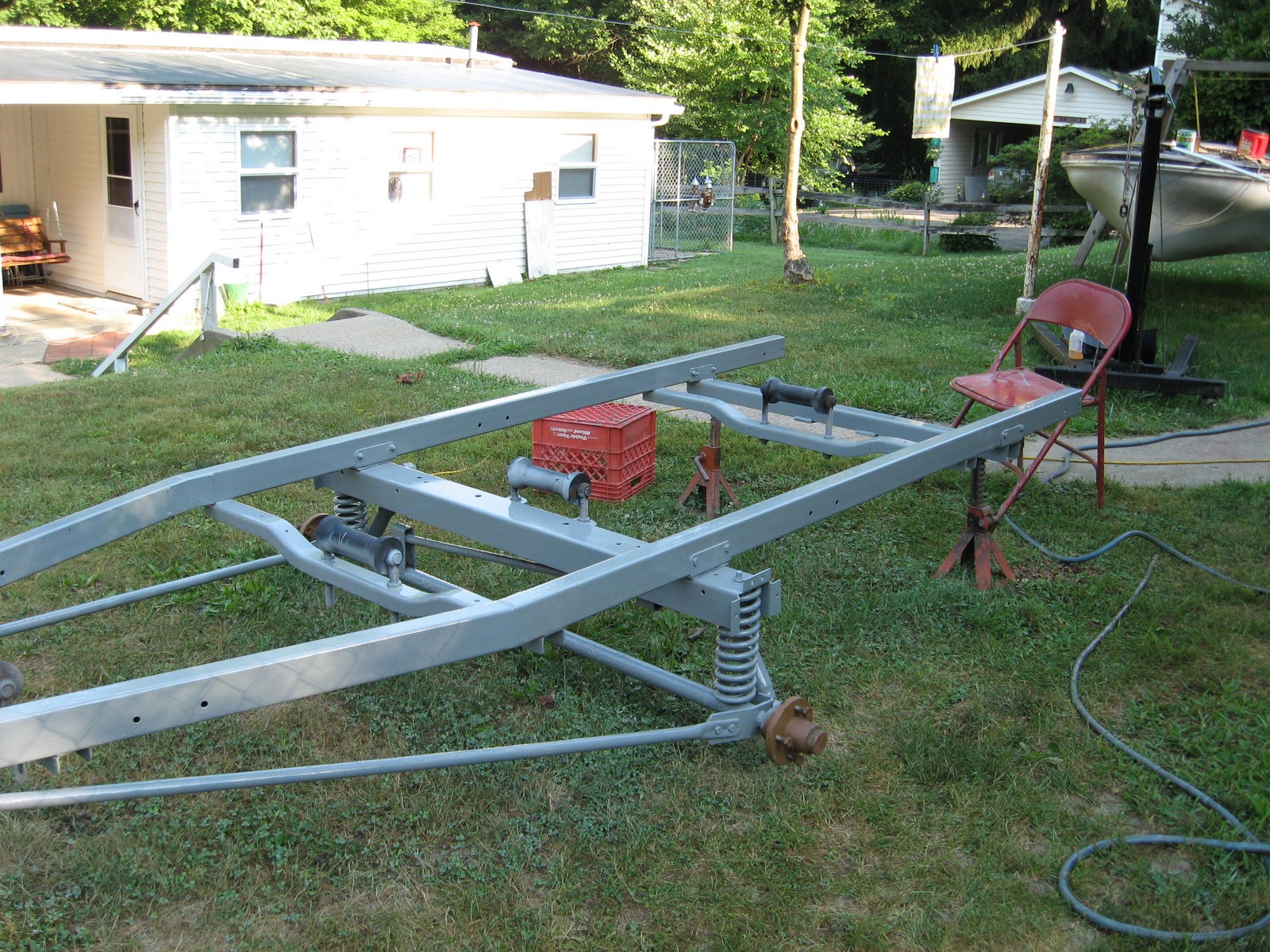

Did some more grinding and wire wheeling on the trailer this evening. Disconnected the drivetrain. The bolts on the leaf springs are almost rusted out. Have to dissasemble the leaf springs to clean them up and then replace all the bolts with grade 8's. The other bolts on the trailer were all galvanized and are in really good condition considering how rusty the rest of the trailer was.
With the drivetrain still on.
Drivetrain off.
Ready for primer. and then to the springs/axle.

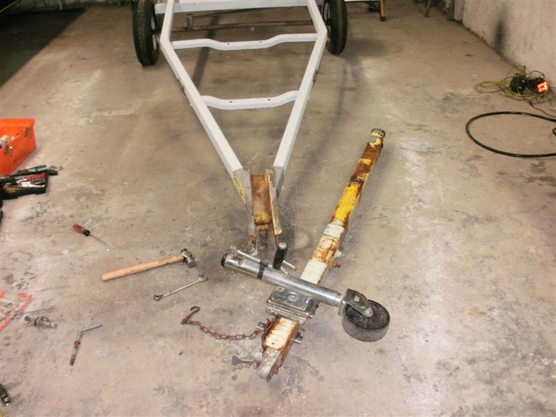

A few more hours on the trailer today, got the underside primed and the solid axle separated from the springs and the hubs and wheels off. The lug nuts are rusted so bad I'm soaking them in kerosene for a few days. Need to get this bad boy back together so I can get the hull painted and placed on the bunks. Maybe squirt the Imron on the bottom this weekend if the weather permits since THE football game is a Friday nighter. Next week the grandson starts his high school ball so that'll take my Fridays away.

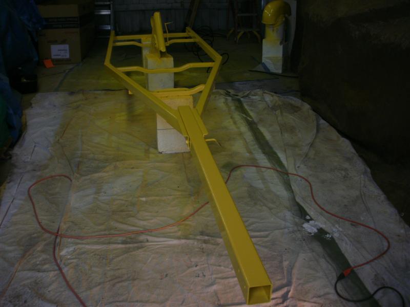

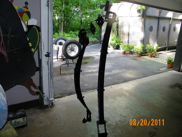

Today was productive. Worked on the trailer for the Herters, got the frame in primer, dissasembled and reassembled the springs and shackles, got them allcleaned and painted, pulled the hubs apart and cleaned the bearings, regreased, put in new seals and cotter pins on the castle nuts. Got the wheels in primer also. Whew!
Da Frame in primer.
Springs and shackles.
Cleaned up hubs and primed wheels. [img] Assembled (loosley) [img]http://www.fiberglassics.com/media/kunena/attachments/legacy/images/100_0165.JPG

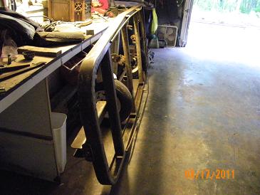

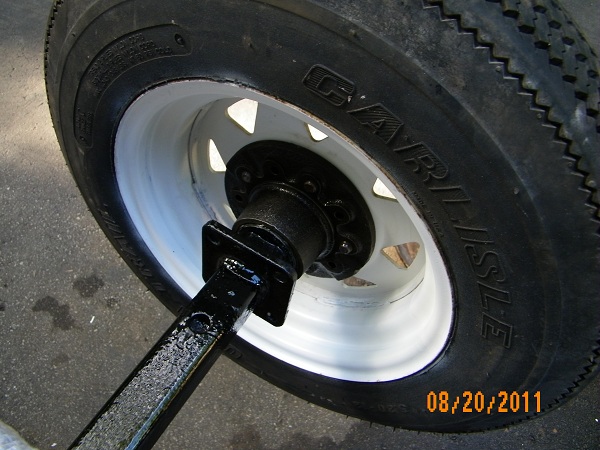

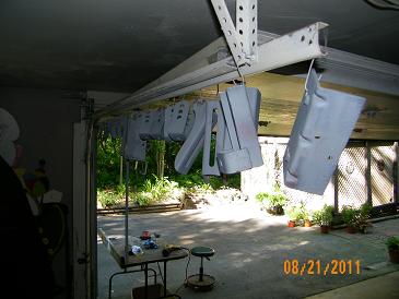

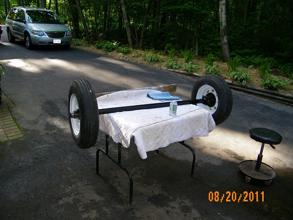

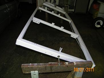

Thanks guys for the encouragement. It does get to be a little much after awhile. I finished cleaning and priming the rest of the hardware for the trailer, roller brackets, bunk holders, et at. Also figured out a way to paint the trailer frame all at one time in one day. I put it on a swivel...put two long 5/8" threaded rods on each end of the frame and rest them on the old horses. Only problem now is hoping the old horses don't break down while I paint.
Hardware primed and drying.
Frame set up on homeade swivels.
Re:1959 Herters rebuild 15 years 2 months ago #41835
Cool idea on the trailer "rotisserie" Cal, I like it! It's always such a pain doing one side then having to wait on it to dry completely before starting on the other side.

Just painted the mainframe today (little computer lingo). Sure makes it easier and faster with the rotisserie. Maybe Tuesday evening I can get the suspension and axle back on. makes me nervous on those shaky horses.

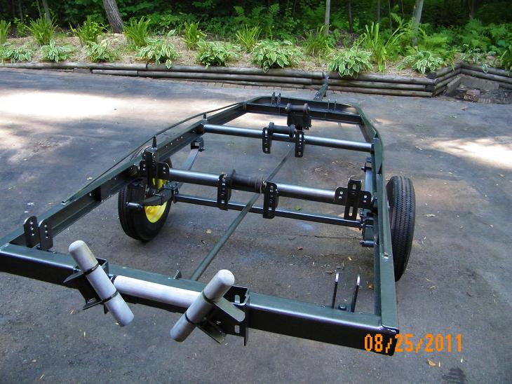

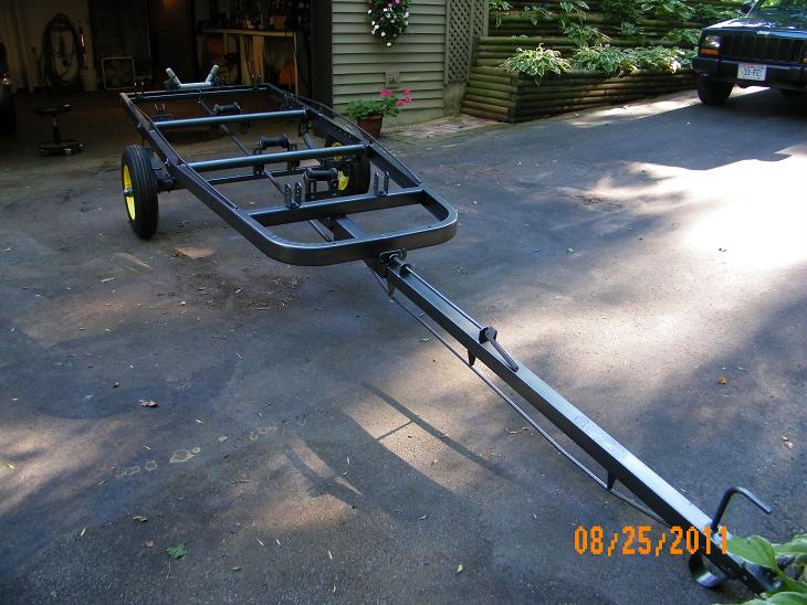

No time for the trailer yesterday, too busy making a living. Today I got 95% finished, all the hardware back on, rollers in place but not lined up (will do that when I set the hull on), tongue is back on. Only things left are the bunks and the winch stand but those will also be when I gently set the boat hull on it with the help of neighbors, family and Bud Light. Big change had to be made........ C-O-L-O-R! I thought the yellow would be good but after staring(?) at if for a few days it really shouted YUK! Thing is when I took the frame down to bare metal it wasn't smooth like one would really like because of the rust and I was not going to high build and sand the whole thing. The previous pictures showed it first in white metal primer and then I put on a coat of yellow oil enam. Those two coats helped the appearance somewhat but it just didn't do the trick. Since the frame had a pock marked finish I picked up a few cans of Krylon Fusion hammered metal, tried it on a few spots and it turned out perfect. The hammered metal finish worked hand in hand with the finish of the frame. Now I have to let the complete trailer sit for a week or so to harden up. In the meantime it's back to the hull, get that all set up for the final finish.
Still up in the air about the final color for the topside.
Different color.
Those cool looking Gator fiberglass finned fenders will be painted to match the boat whenever I decide on color.

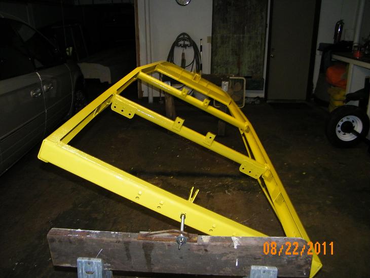

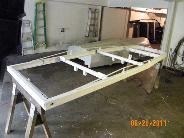

Hey John I got another picture, worth a thousand words so I won't take so long to write. While the trailer sits and hardens up I did the final spot checks on the hull this evening and put on another coat of primer, love that stuff. The guy at the paint shop that sold me the Imron for the bottom said I would only need 1 qt for the hull, should stretch out after the reducer and hardner are added. Sounds like not enough to me, what's your experiance. The Imron is a pure white and it will be going over the yellow high build. I personally don't think it's enough. I opened up the Imron can today and it seems like there's only about 3/4 qt. If I add the reducer it will probably be a full qt and then the hardner. Takes about a qt and a half of primer to shoot the hull. With a white bottom I leave myself wide open for the topside color, and fenders. Just for drill I put a dab of Imron on a board and added a dab of oil based enam, mixed em up and it set up hard and glossy. They do mix. I just might pick up another pint of the white. Been a long time since I've squirted the stuff. One of the posts on the forum mentioned using an industrial single stage paint. I'm wondering what would be harder, industrial enam with a hardner or an auto acrylic enam. opins?????
Final spot fill and prime.

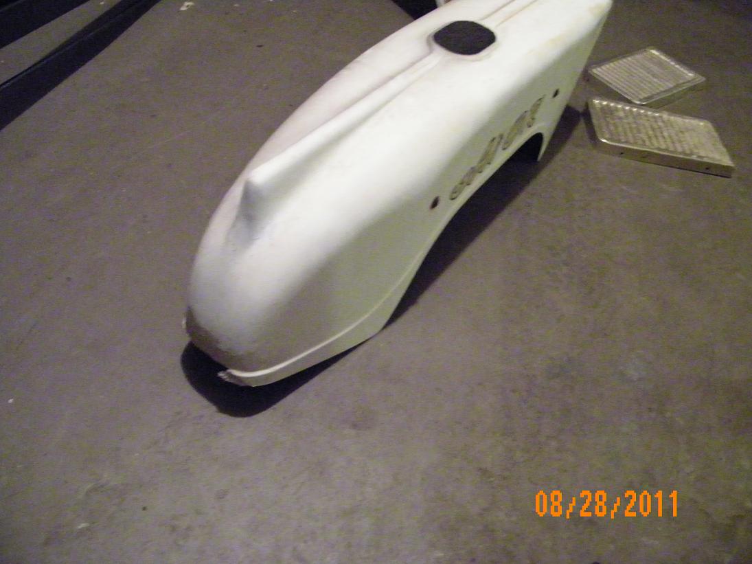

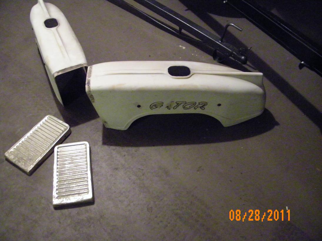

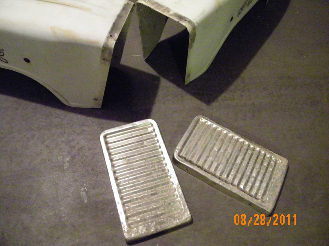

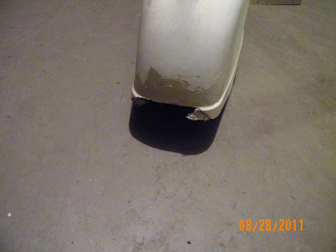

Saturday was quality time with grandkids. Today I worked on the Gator fenders somewhat. The anadized aluminum grills that are on the front of the fenders are in bad shape, corroded and bent. I straightened them as much as possible by hammering and rolling. They will never be original again but I think I can make them look pretty good. There is some broken glass on the bottom of one of the fenders but that is easily repairable.
The aluminum grills and the busted out back.
Thought I was done with the glass, forgot the dang fender. Won't be as itchy as the two boat halves.
