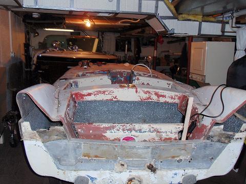

The past week I've been ripping on a '59 Herter's Flying Fish. I have it stripped and separated. A whole new 2" wood transom was installed yesterday with glass matt. The aluminum original was broken in two places and my personal opinion is that the setup was poorly designed. The hull is flipped and on the trailer so I can grind off the rusty bolts holding the keel on. When I repaint the hull can I reinstall the keel with stainless carriage bolts and 3m5200? Most of the bolts are either rusted or aged aluminum. Got to say one thing about this boat is is a quality build. All fittings and halves are rivited and through bolted, not like the screw into plywood that you usually see.
The transom had over 47 holes in it, wonder what held the Merc on at all.

I believe you made a good compromise on the transom. I agree that the originals were a joke. As if Herters had forgotten that they were making a spped boat - not one of their row boats.

One of the reasons your transom may have broken is because the 1959 and later models did not have a transom brace installed like the previous models.
I have two 59's and both had cracked transoms. They can be repaired by using a milling machine to remove portions of the webbing and installing an internal stiffner making sure to place it where any motor securing bolts would go through it.
Then a transom brace can be fabricated and installed or you may be lucky enough to find an original Herters brace as they were used on many Herters boats besides the Flying Fish and Mark III models as well as sold as a stand alone part. Your 1959 should still have the tab on the transom to bolt the brace to.
Another contributing factor is what size transom the boat was ordered with. Three sizes were available, 15, 16.5, and 20 inch. The 15 inch transom has the least strength.
If you do go with a wood transom make sure you make provisions to mount the steering eyelets and tailcaps to something substantial as the aluminium transom does. The tail caps and fins get their support from the transom.

Thanks for the advice but I have no intention of reinstalling the aluminum transom plate. I'm not "restoring" the boat, I'm rebuilding it with some custom touches. I have more pictures from today. Worked on the transom.
Sanded the outside with a 40 grit belt sander to rough it up and expose all the hidden cracks.
Filled and rough sanded with 240 grit. Ready for prime.
New transom from inside. Not pretty painted yet. Matt on the outside shell, 3/4" marine, matt sandwhich, 3/4" marine, matt on outside and fiber filling small voids on all edges and then cloth for the finish topping.

After seeing you picture your transom is longer than mine. I have a Merc Mark 58AE short shaft that is going on it so I need the strength. Here is an article that came from our local paper yesterday, thought it would be interesting to all members that are doing transom work. Do it properly and don't skimp. I keep in mind that my grandkids will be in this boat.

Flexing, well I guess! The transom was about 2 inches out past the rest of the stern. There are acutally two of those cracks on each side pretty much where the motor mounts were. There was a 1959 Mark 58AE hanging on the back, I strapped it down pretty tight the day I brought the boat home. Had visions of the motor dragging down the highway hanging on by the cables and sparks flying.

your transom looked like mine...from what i've read the transom is one of the most abused parts of a boat and yet, everyone likes to weeken them by drilling a bunch of holes in it.
