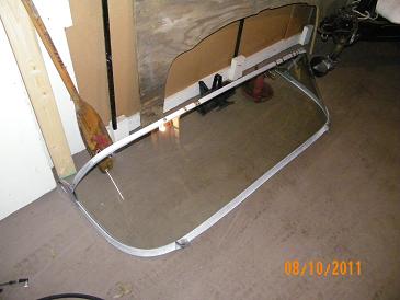

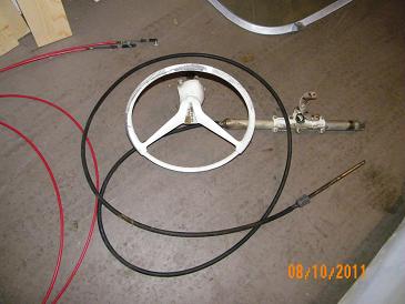

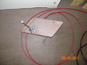

"Parts is Parts" I guess. Got a beautiful unblemished tilting windshied, a Morse chrome single lever control, a push pull steering setup with a solid metal steering wheel and a 14 gallon fuel tank 3/4 full. All fit my project.

that low cut swept back windshield is a great score....the tall windshields on herters don't look good..

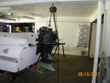

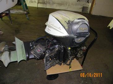

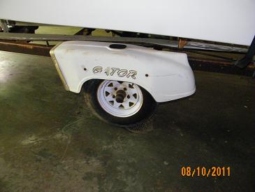

Didn't do anything on the fish today, spent all day stripping the Dorsett for parts, tomorrow the skeleton goes to the dump so I have room to work on the Herters again. The trailer is a Gator and has the neatest fenders with little fins and a grill type front.
Re:1959 Herters rebuild 15 years 2 months ago #40548
The cool Gator fenders.
Pulling the Evenrude Starflight II and ready to sit on the shelf. Might part it out if I get some takers.
Ready for storage.

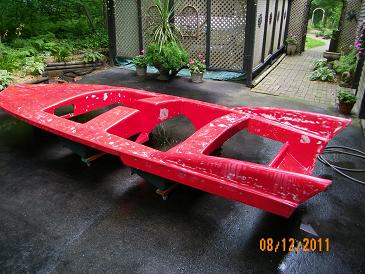

Not much to show for the day. Took the Dorsett shell to the boneyard cost $13 to dump it along side three other hulls. Did some more rough sanding and hole filling on the fish topside this afternoon. Should be able to finish up the sanding and filling tomorrow sometime and roll on a coat of high build then I will have some more pictures.

You know what's really perplexing is that back in the 50's the TeeNee trailers were considered cheap junk where I came from. At a boat auction a few years back one fella bid on a junker rotted glass boat with popler trees growing out of it and a rusty trailer under, got it for $5 just to haul it away but it had the rounded fenders on it. Now they are hard to find collectors...go figure! Like they said to Indy Jones, take a cheap watch, bury it for a thousand years and it will be priceless.
The Gator fenders just happened to be under the Dorsett, they will need some tlc but are in very good condition. Looking at the trailer it is one complicated so... Going to be really hard to clean up with so many curves, angles, braces, levers, and rollers but it looks like it could hold a battleship. Me thinks the September deadline for the project is a wee bit ambitious for one person.

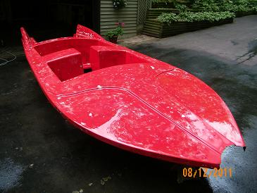

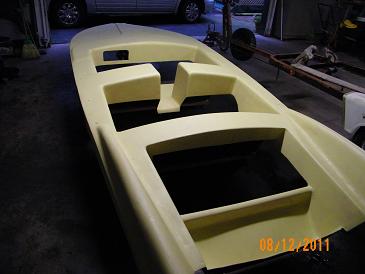

Finally finished with the hole filling and sanding. Good to be done with that itchy twitchy feeling. Washed the whole thing with soap and water and then a good rinse, not too bad if I do say so myself. Seems the 50's gelcoat and glass tech needed a lot to be desires. Lots of air bubbles and pinholes in the gelcoat. Had to sand off three coats of paint, one off white, one dark blue and one red primer and then finally got to the red gelcoat. Rolled on the highbuild primer with a 3" roller to get good coverage. I'll light sand with 220 give another washjob and start with the spot filler.
I can now call this my clean slate.
The shiney is just the water from the rinse.
And then the primer.

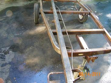

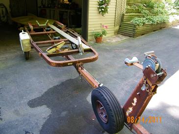

Sold the old trailer that the Herters was resting on today. Guy needed a trailer for his duck skiff. I put the two fish halves in storage for a short time while I start on the trailer. I need that finished so I can paint the hull and flip it on the trailer without having to take it off again. Lots of rust but the trailer is sound.
Taking it down to bare metal piece by piece.
Before the strip job.
After: The trailer is completely stripped down so individual pieces can be cleaned and painted. Started with the tongue which is down to bare metal ready for wash and prime.

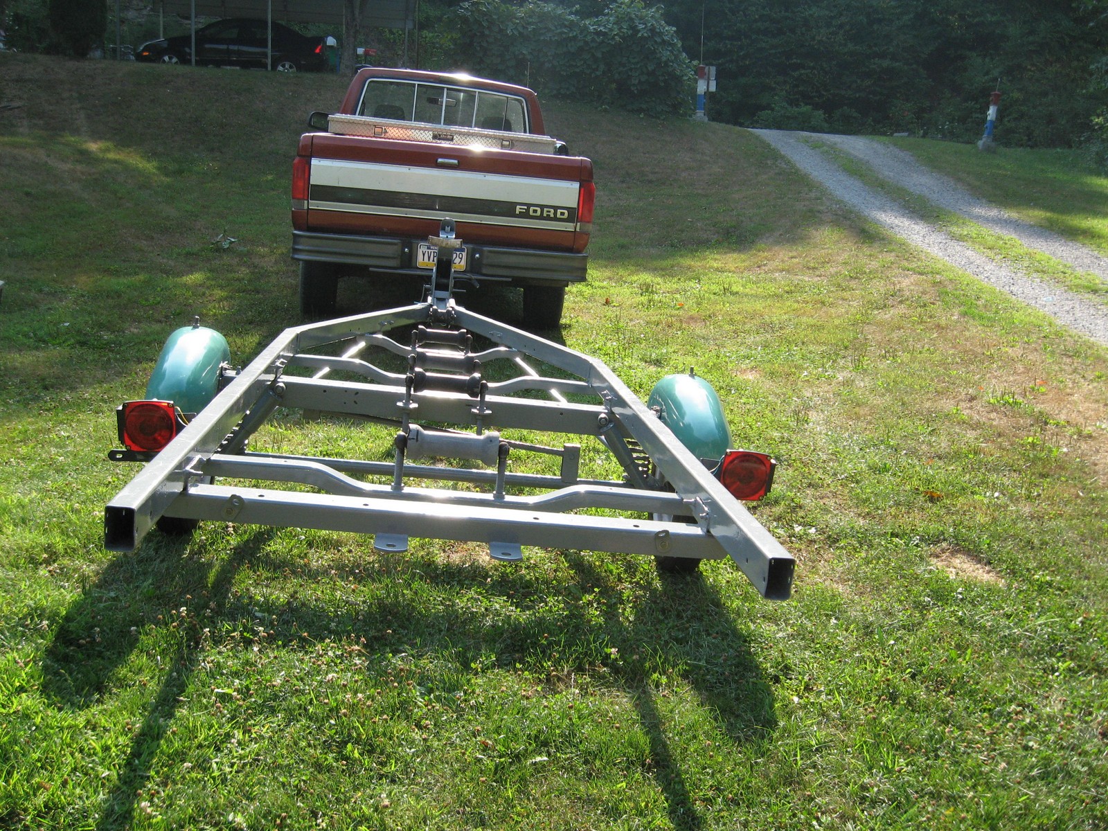

Looking nice. I just did my TeeNee trailer. It's re-do is in the trailer section. I used grey. Since I will have no real trailer queen I wanted something that looks OK dirty. :P I have a lot of time into that trailer. But you what, I like the looks of it. I need a roller for the back.
