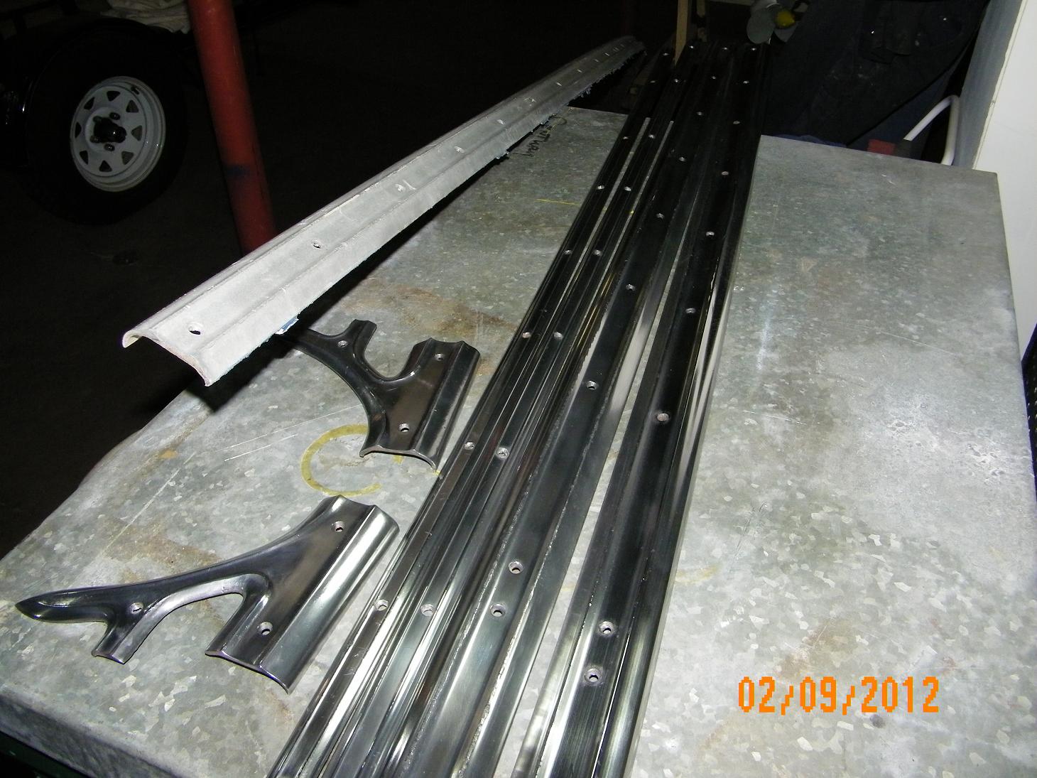

Past week have been slow. Polished up some more aluminum trim pieces, only four more to go but they are the BIG ones.
You can see a before and after difference.

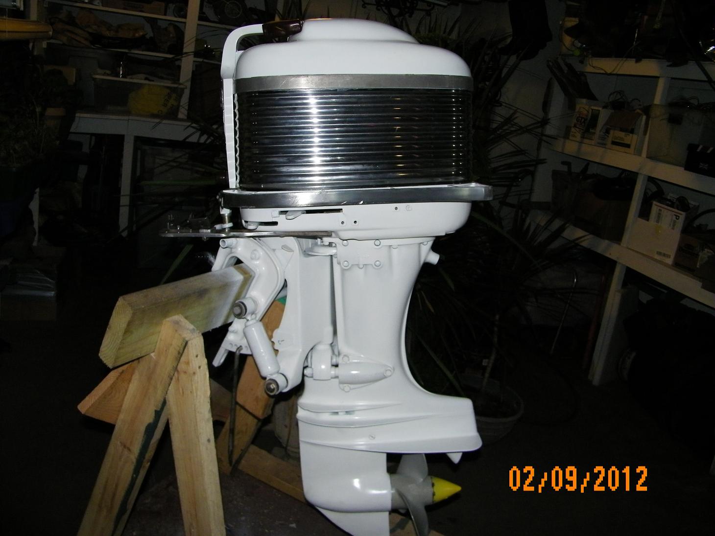

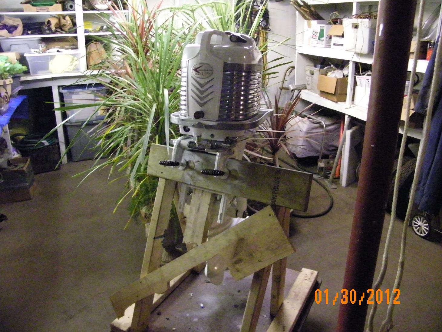

Put the finishing touches on the motor, It is DONE. Filled the lower unit with corn head grease yesterday.

The Merc looks great, and the progress you're making on the project is pretty awesome IMO, Cal!

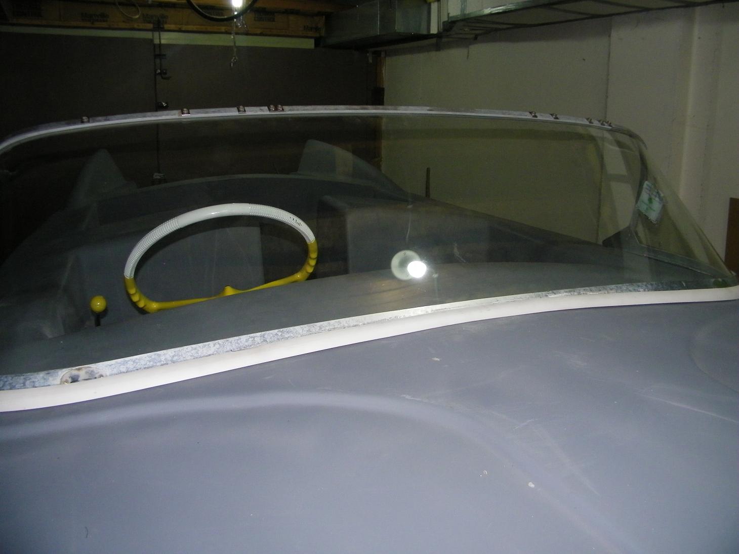

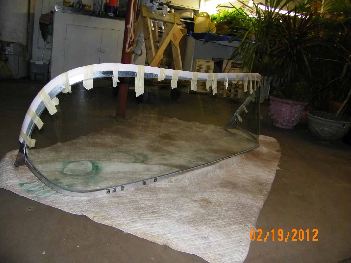

Windshield gasket glued with 5200 held in place with masking tape for a week.

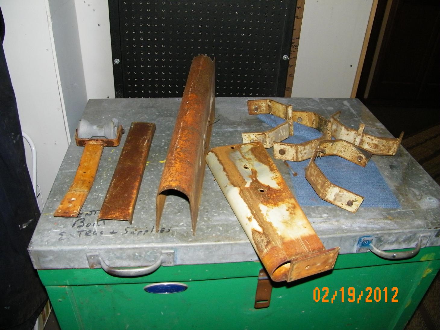

The rusty winch pole components are next.
Re:1959 Herters rebuild 14 years 8 months ago #56311
Sweet, she's coming along nicely. Should be ready for water in no time.
Re:1959 Herters rebuild 14 years 8 months ago #56963
Ground down all the winch parts and primed, installed on the trailer ready for paint. Put the final touches on the fin end caps, had to remake some chrome rings to hold the tailights in place over the rubber gromets. Installed the spedometer but still have to run a tube and install the pitot pickup. Drilled the hole for the fuel gauge that was needed since the tank is now permanent. Fitted the new gasket on the windshield. Pretty much running out of small things to finish up, waiting for warm weather now so I can get it back outside and finish up the sanding and squirt some paint.

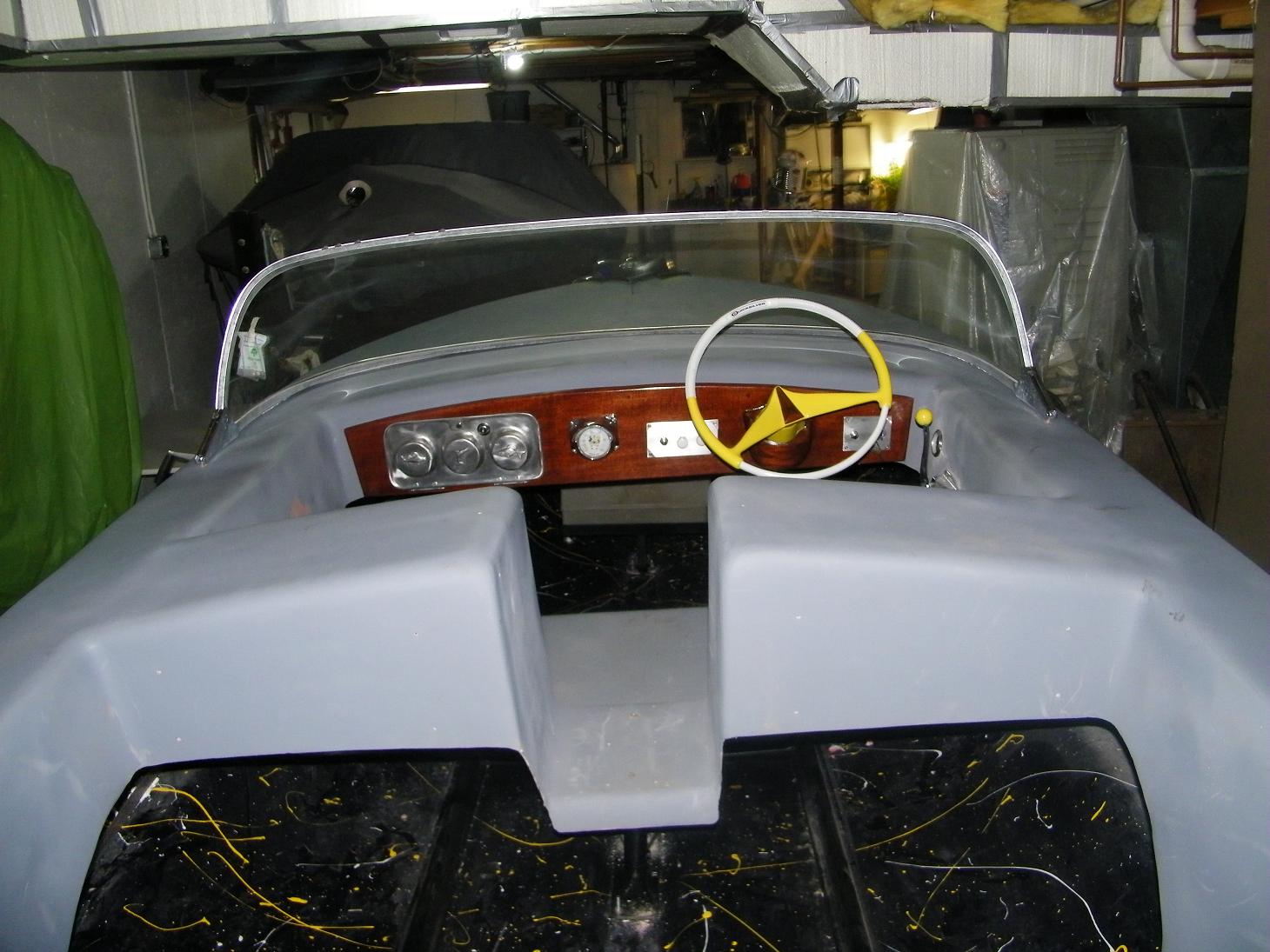

The original Herters speedometer installed sans tubing.

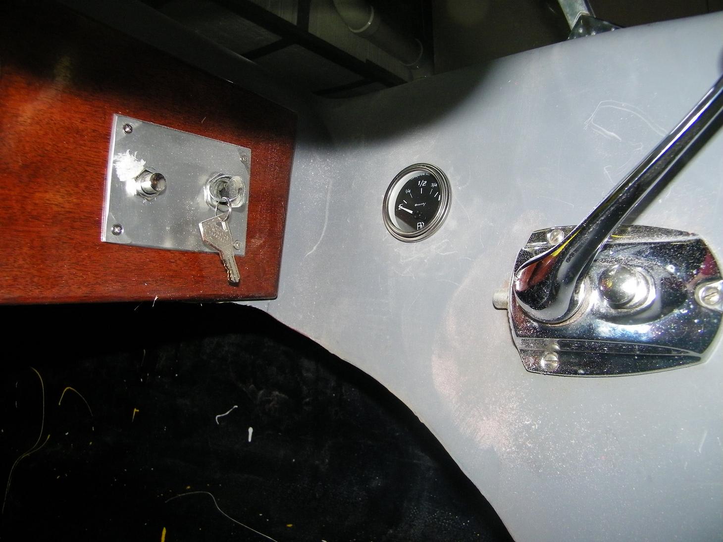

Fuel gauge placed on the starboard side, purely functional, nothing fancy.
Re:1959 Herters rebuild 14 years 8 months ago #56968
Excellent Cal, I really do love that dash! Fuel guage looks fine where it is.

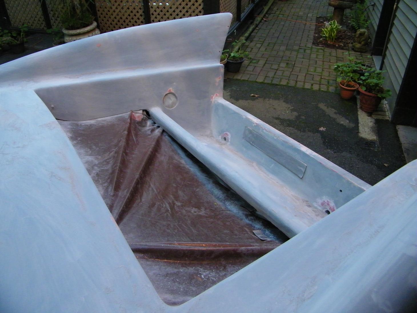

A few more days slip by and a couple more items taken care of. Installed a holder for the battery box, an aluminum plate for the motor mounts, put the inside braces in the Gator fenders.
The weather has been teasing us here by the frozen tundra. Yesterday was in the 60's today in the 30's next week in the 50's.

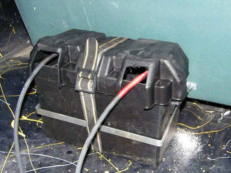

Really don't see much discussion on these threads about batteries and their hold downs and what you fellas do. The Herters is a different animal since there is no "floor" to mount or screw anything to I had to run an aluminum strap around the box and bolt it to the back of the seat. Actually solved some other problems. Had to balance the weight so I mounted it on the port side. More forward than the transom since these boats run low in the back anyway. Have to run another aluminum strap vertacally over the top of the box to keep the battery from bouncing around.
This is just a tempory box I used to get the proper size.

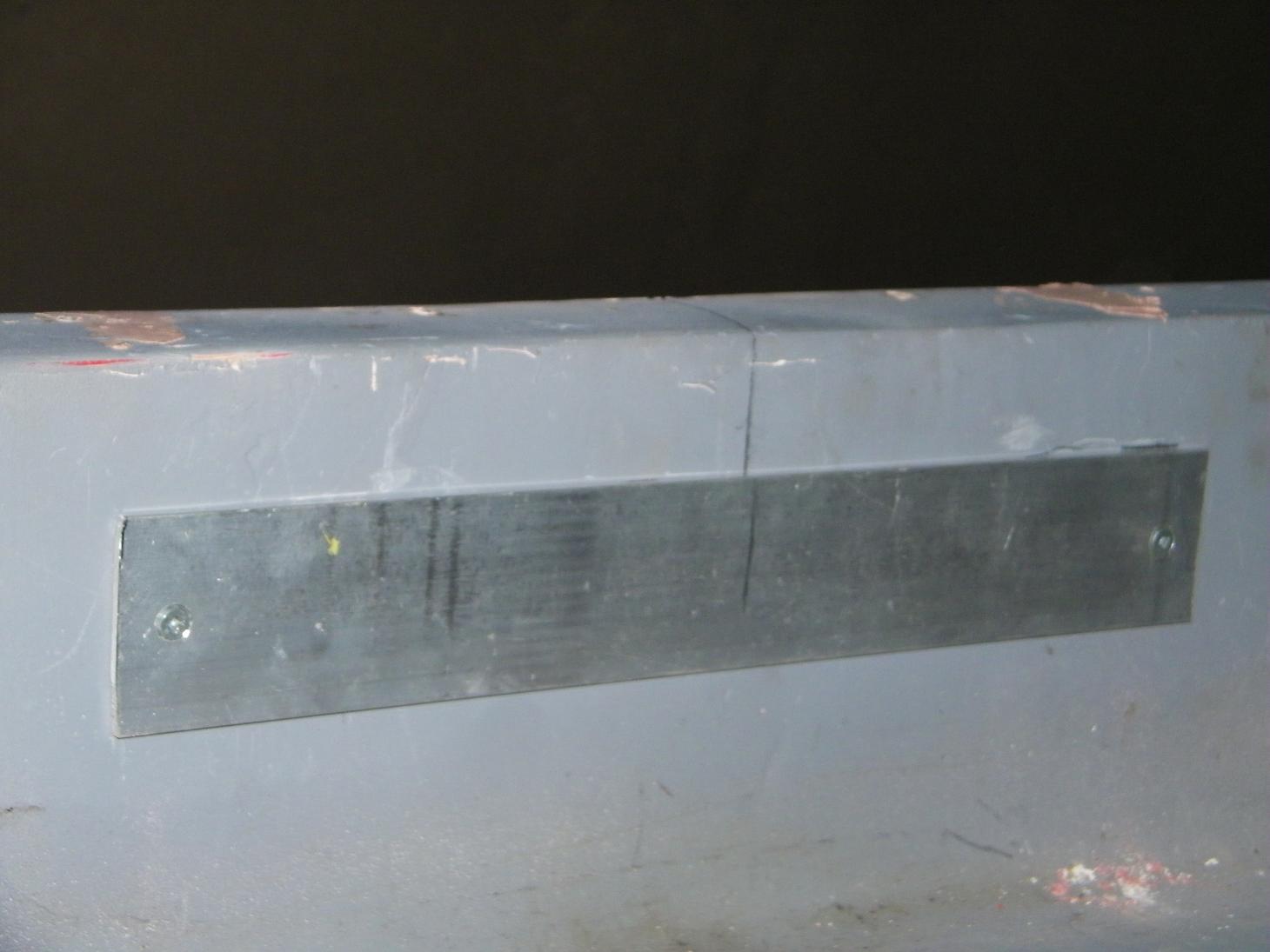

The aluminum plate for the motor mounts also temporary until the topside is painted and then it will be sealed with 5200 around the screws.

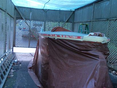

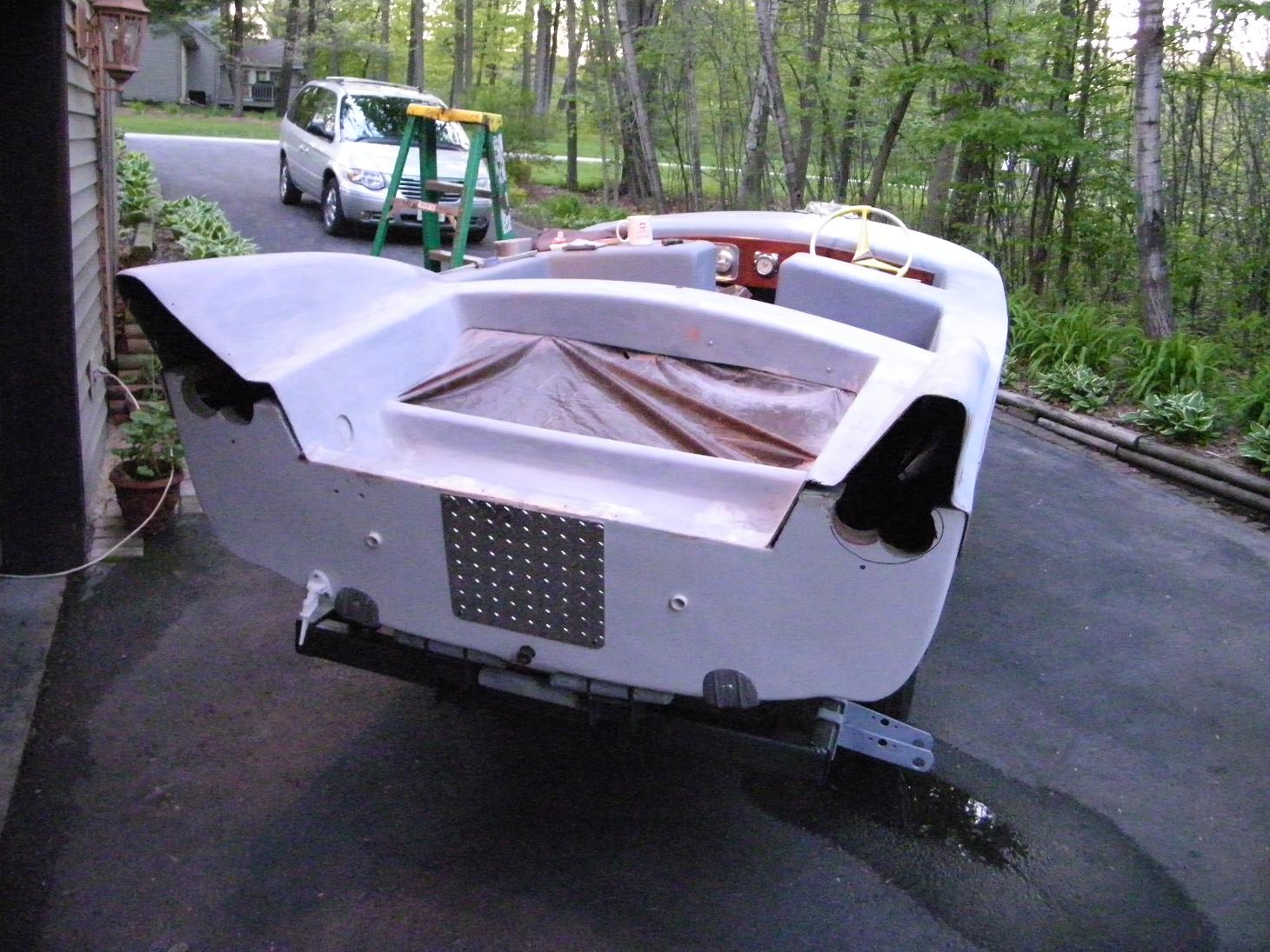

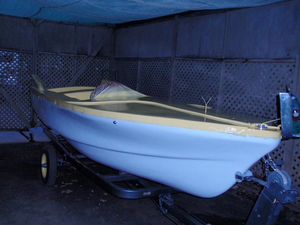

Mother nature is a cruel broad. Took the day off to paint and she decided today would be a good day to drop every @$#%&*##$@ maple seed in the neighborhood on my driveway.
These babys do not make for a pleasant painting experiance. Rigged up a roof on my "paint booth" and proceeded to get down to business.
Did some final sanding and wipe down, got out the compressor and went at it.
Seem like no matter how hard the search for pinholes there are always some that slip by. Also there are three bugs that sacrificed themselves for some reason. Have enough paint left over to use in my Prevel for touch up if needed. Now let it harden a few days and start adding the bling.

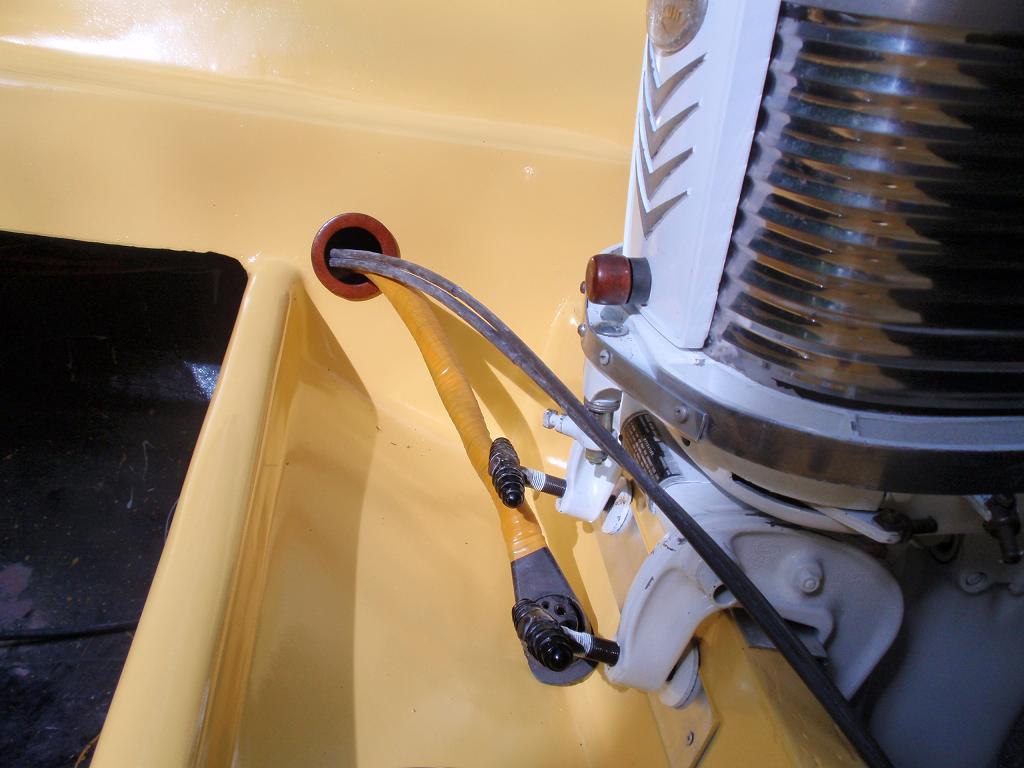

Let the fun begin. Hung the Mark 58 today, started adding the mahogany trim pieces and edging.
Mahogany trim around the steering and fuel line port and beginning installing the chrome edging on the raw glass edges.
Shift and electrical port.
From the top and single lever shift/fuel gauge.
