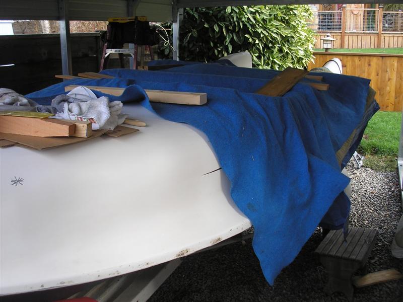

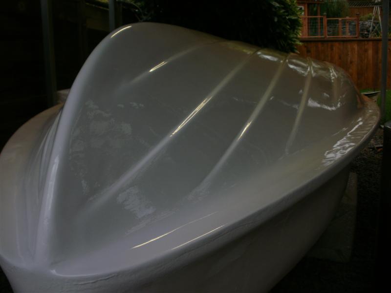

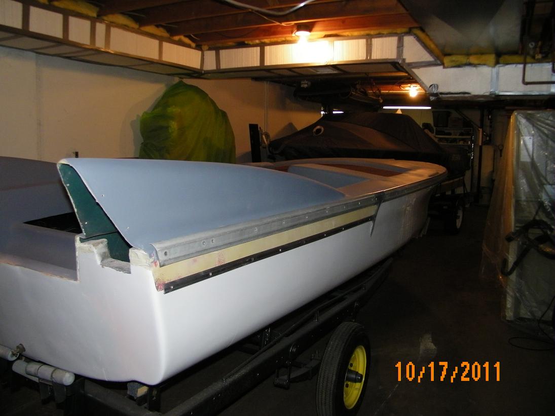

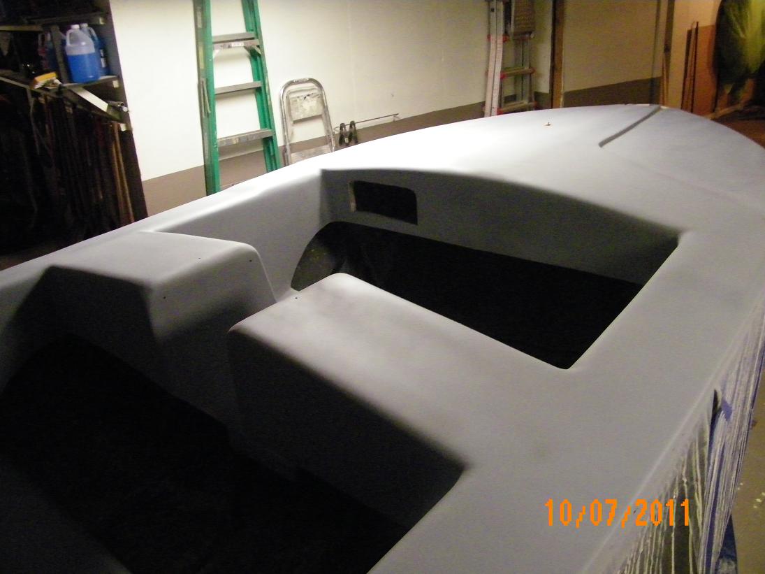

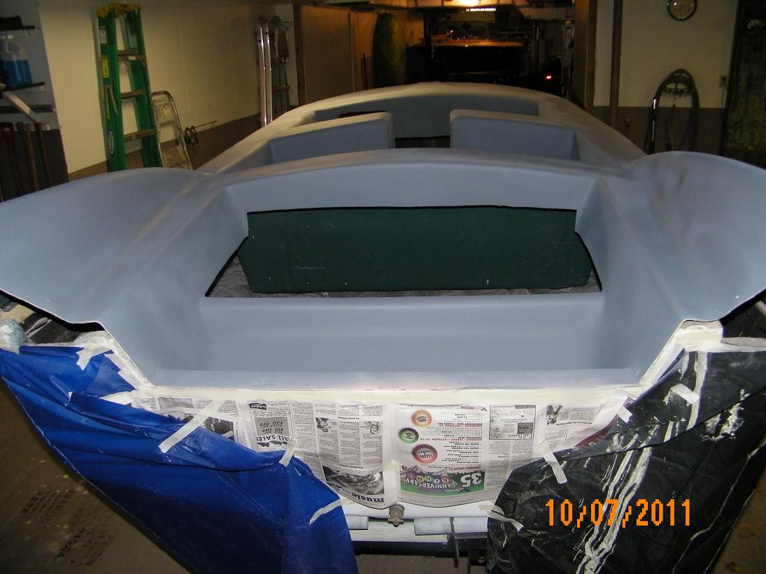

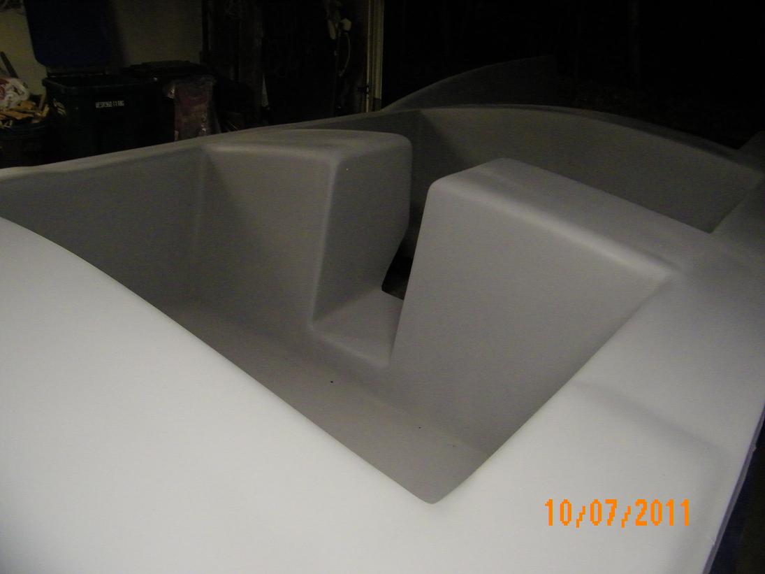

More fish tales. Last evening I glazed, sanded, glazed, sanded, sanded, sanded. Filled some more blemishes, pit holes and sanded some more. This evening I finally got to shoot about 6 coats of primer to fill some more pit holes. With the weather as warm as it is for this time of year I think every winged insect decided to hold a national convention in my driveway. Good thing it was only quick drying high build primer. If the weather permits and I get leaves raked I can try to shoot the final coat. Have to see how the primer looks in the daylight since it was dark out the last go round.
Here's my clean slate to begin assembly
Don't know if it would be wise to do the top coat before I begin to dry fit all the hardware. I have to install the steering system from scratch, throttle controls, drill holes. Maybe I should just forget the final coat until next spring. That way I can assemble the dry fit pieces over the winter and work on the Mark 58, get my ducks in a row and when everything fits remove them and then paint. Any opinions??

Awesome progress Cal, IMHO! Quite the transformation. You've done more in a few months than many of us get done in a year. :ohmy:
A couple thoughts on the paint or hardware first (?) quandary;
1 - Test fitting hardware first ensures that if you have a mishap with the drill or saw, or end up having to relocate something you thought you had where you wanted it, it would be much less work to repair before painting. Plus you don't have to worry about something scratching the fresh paint all winter while in storage.
2 - If you go ahead and shoot it now, and are very careful with the installation of hardware, you have all winter to wire and rig the accessories and controls, etc.. Plus come springtime, you'll be a giant step closer to launch! I have a hunch you're super careful with your work, and you obviously have previous experience keeping a beautiful boat protected during the off season. It's your call, but I'm thinking "go for it" if the weather holds. :P

Mark and Frank, I'm made the decision to leave the final paint until next spring. The cans will just have to sit on the shelf and haunt me all winter. Thinking about the rigging and laying on my back under the dash, feet wondering around on new paint? belt buckle? as Mark said mishap with a drill or screwdriver and I would be kicking myself all winter. Besides, I'll probably find more pit holes.
As far as the leaves go the wife would take care of me if I let them take care of themselves.
Thanks for the input, helps with decision making.

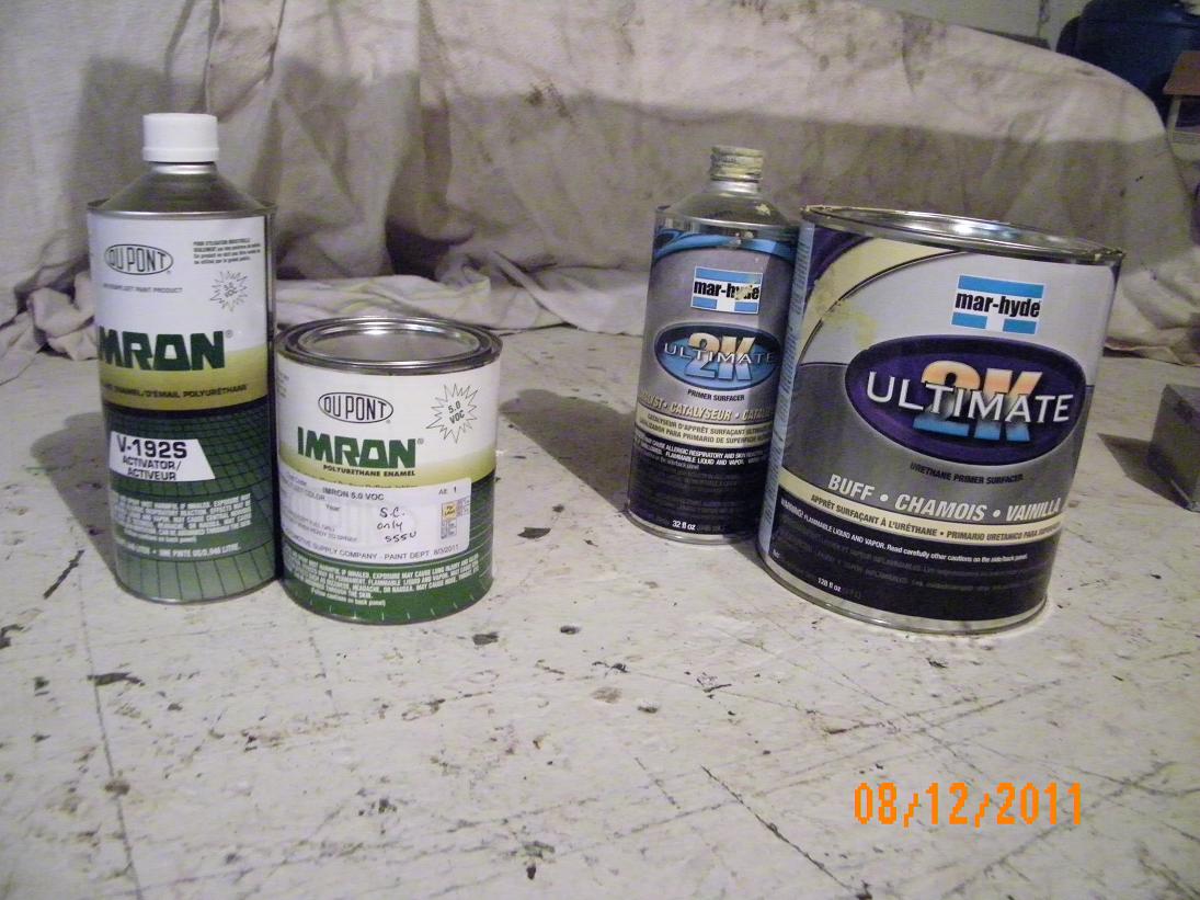

The primer I'm using is called MarHyde got it at one of our local auto parts store (Federated). A two parter. I'm on my second gallon if you would believe, so many pit holes and blemishes. Probably sanded 3/4 of the gallon away. The first was a yellow color but the second gallon was gray. I Ran out of the primer activator so I used what I had left from the Imron, worked like a dream. My next step is working on the steering system that I salvaged from the (gulp) Dorset. Problem I'm running into is that the steering cable is from an 18 footer and the Herters is a 16.

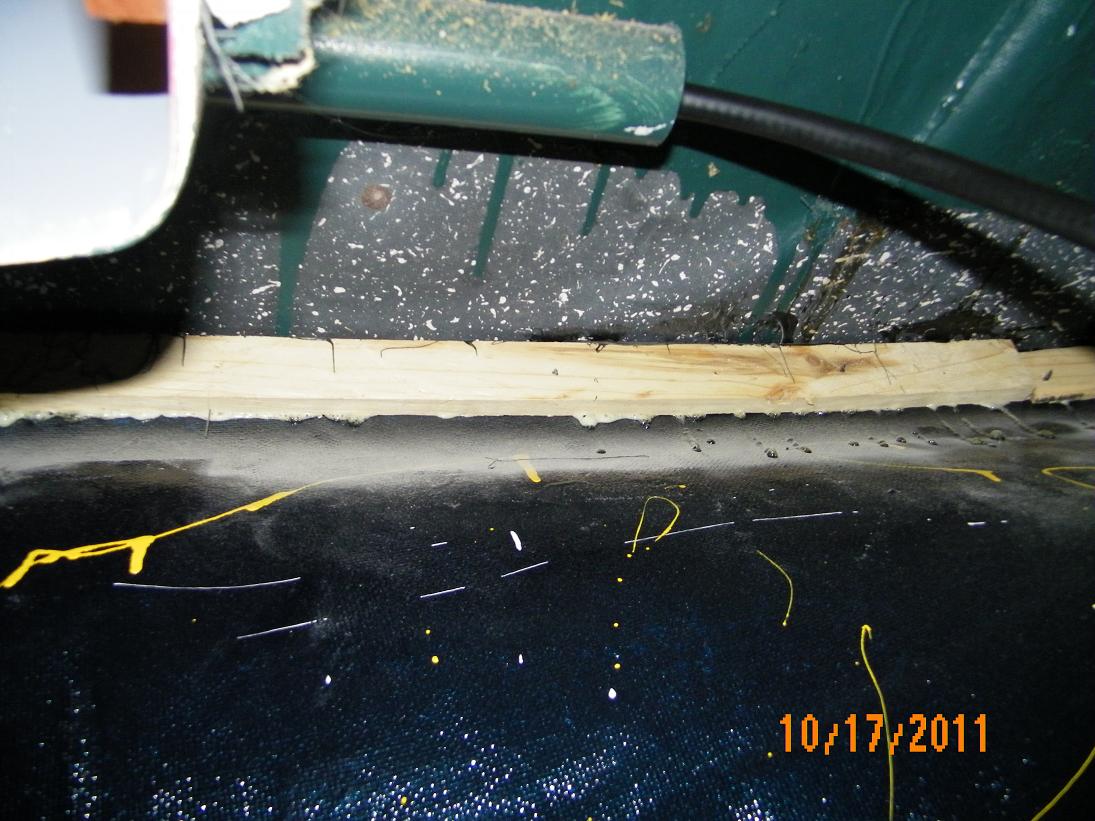

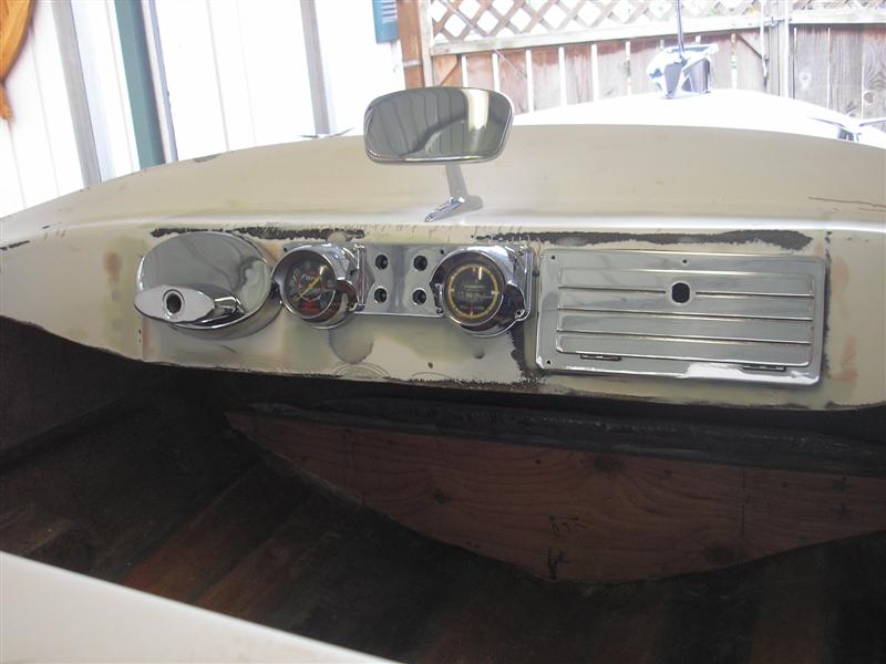

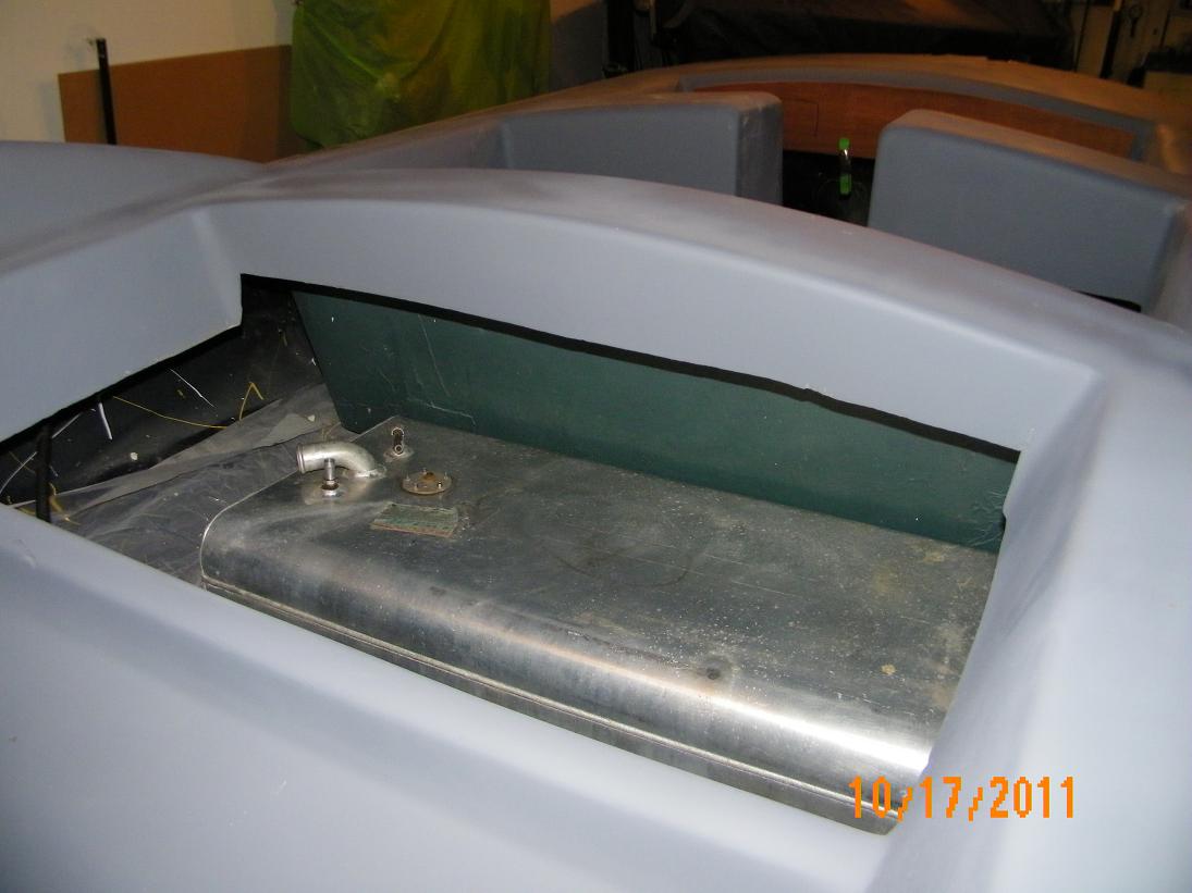

Been a few days since I worked on the Herters. Dry fitting parts and working on the steering system. Got the hole drilled for the wheel and now fitting a mahogany dash into place. Polished the Herters signature bow piece.

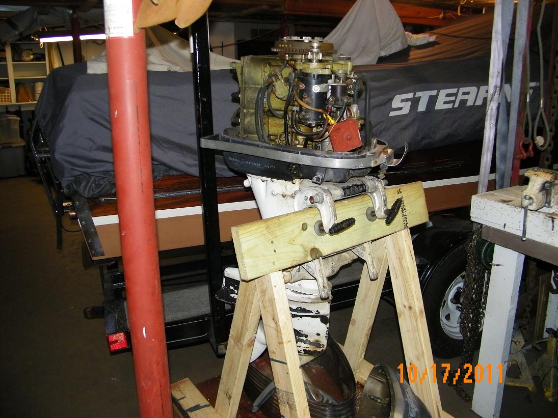

Good news is that I phoned the previous owner today and asked about the Mark 58AE that was hanging on the back. He said it ran perfect the last time it was in the water but that was a long time ago. Where have we heard that before. He has extra parts for the motor, starter, et al that he was going to throw out. I told him to hang on and I will pick them up when I go to the Milwaukee/Madison area in WI.
The polished aluminum bow piece.
Dry fit of the starboard side trim.
Where the 18 gallon onboard fuel tank will be placed.
Running the steering cable through the PVC tube from the stern.
Steering cable entering thte PVC from front.
The "perfect running back when" Mark 58 AE.

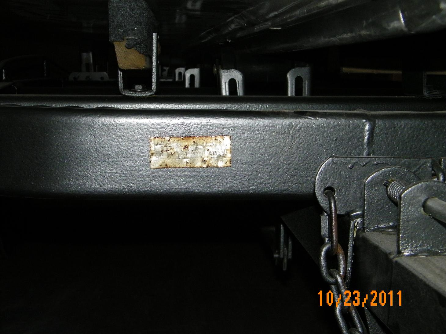

Got the trailer ID tag glued on, used locktite 2 part epoxy that was suggested on the trailer thread.
The two evil monsters and glove box cover.
Trailer tag.
Notice the little prank?

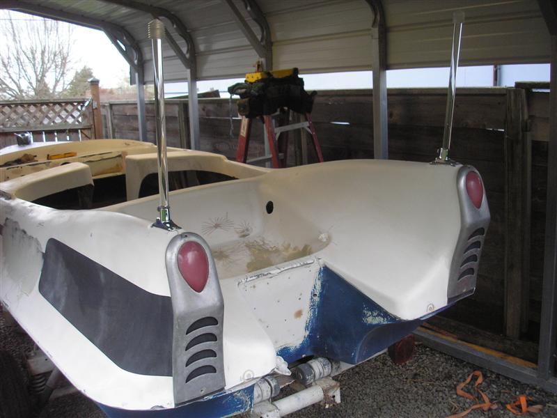

Did some Christmas shopping today. The tail lights that were mounted to the cast aluminum fin ends were completely shot, rusted and missing except for the glass lenses. I paid a visit to one of our local truck dealers, semi/heavy haulers. If you ever saw one of the big rigs go toolin' down the highway at night you know there is a varity of lights these guys mount on their units. Anyway I went shopping and came up with some new red tailights that fit perfect in the Herters fin caps, just have to enlarge the insert hole to accept the rubber mounting gromet. Four lights, four mounting gromets and four wiring harness connectors all for bargain price.
Another view. You can see where the mounts have to be fitted to the cast but they are a perfect fit.
Still working on grinding,filing,sanding and polishing the aluminum accessories.
John, The red and clear glass lenses that were original to the boat are yours if you want them for your fish. The mounting rings and other parts are toast but you might be able to salvage something. Let me know.
Cal
Re:1959 Herters rebuild 15 years 2 weeks ago #48406
The sticker got put on upside down!? Kind reminds me of a Custom Craft HID number stamped into the transom shield, upside down. Guess you're supposed to stand on the other side, bend over and read it Cal! :laugh:
The new tail lights look great, BTW.
Re:1959 Herters rebuild 15 years 2 weeks ago #48415
Hey Mark, you noticed huh? I was in a hurry to get it stuck on before the quick set epoxy set up I just put it on and held it in place for five minutes. Later when taking the picture the Faux Pas exposed itself. Too late now. At least it's registerable.
Re:1959 Herters rebuild 15 years 2 weeks ago #48416
thanks cal,its much appreciated ,thank you,i think i have a set that will work,if not then im going to put 59 caddy lens in it,the way i figure it we found it in a junkyard ,its life was over,so i can customize it up,i like doing that,lol,its fun for me to come up with ways to be different,lol,my wife says im different!,lol,lol,john
Re:1959 Herters rebuild 15 years 2 weeks ago #48418

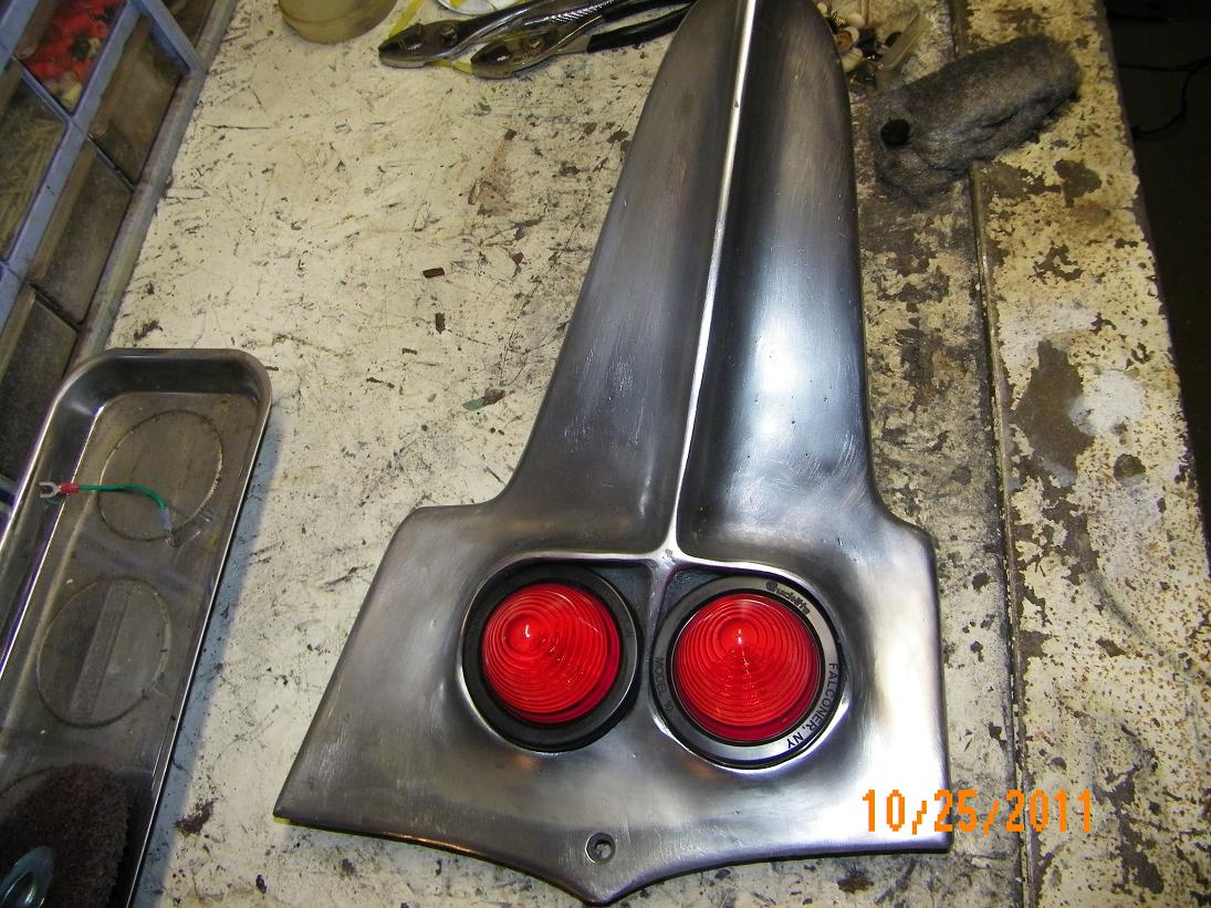

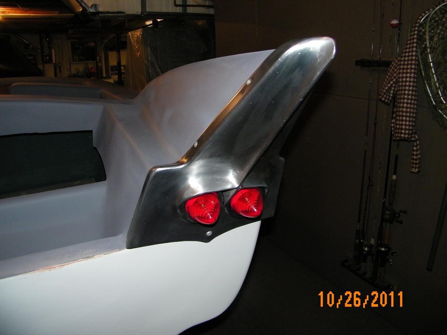

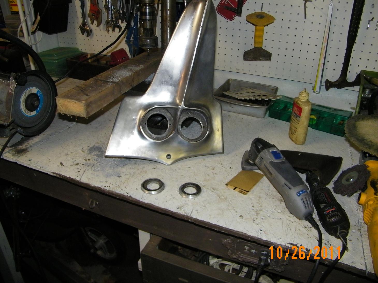

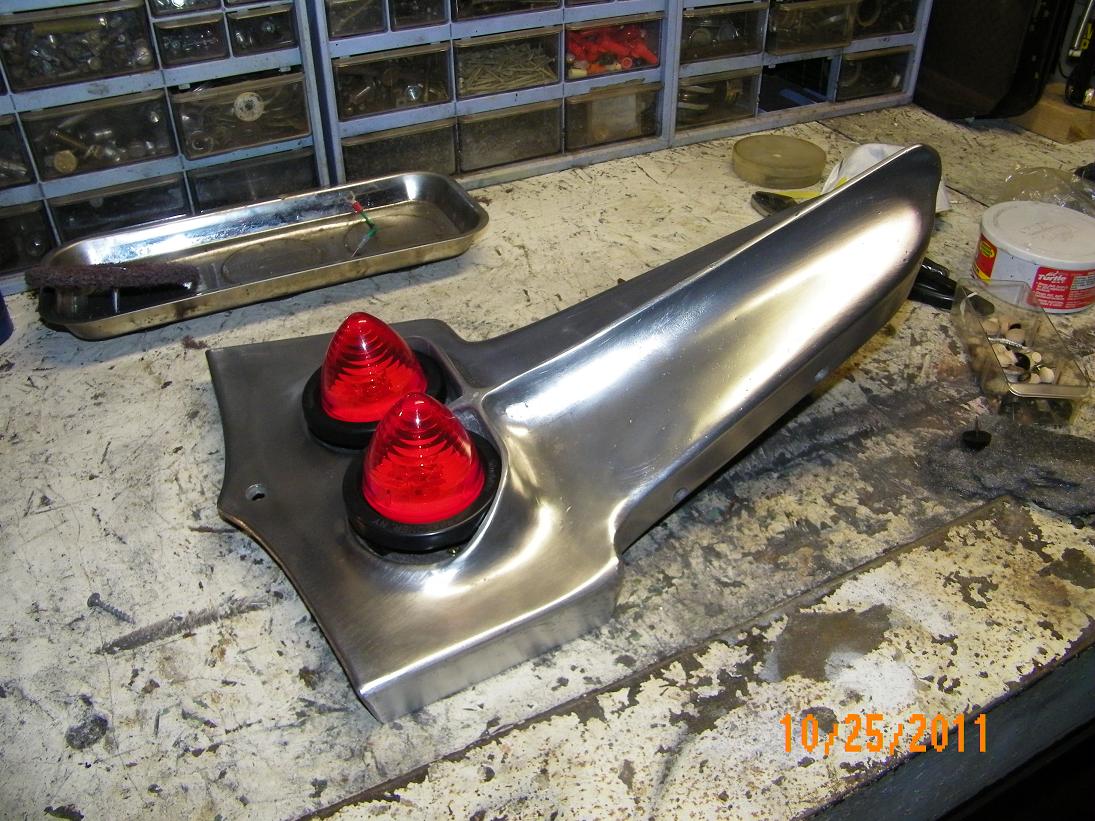

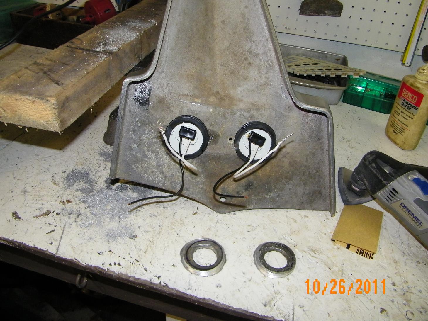

Got two of the holes cut out today on one of the fin caps. Drilling/cutting through 1/4" of cast aluminum is not an easy task for someone that does not have a machine shop handy. I used a hole saw in my "made in China" drill press. Holes came out somewhat sloppy but worked out ok.
Some pics of the holes made to fit the new tail lights. The rubber mountings fit tight in the holes and seal out any water, I hope.
The new holes.
From the back with the lights installed.
Fitted on the fin.
Re:1959 Herters rebuild 15 years 2 weeks ago #48551
Nicely done Cal, those look GREAT!

That is going to be one seriously cool looking stern! Just make sure those lights are OFF at night on the water- Looks like a ticket in the making :)

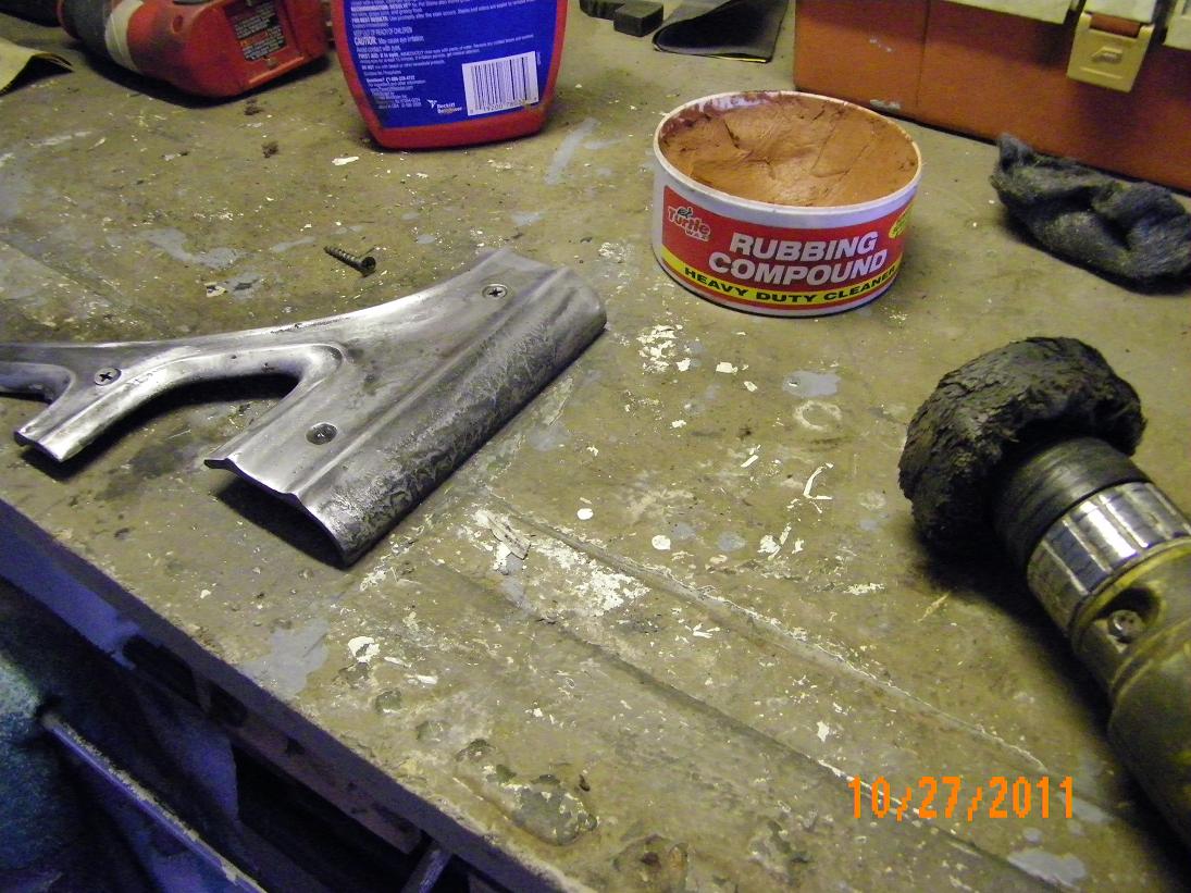

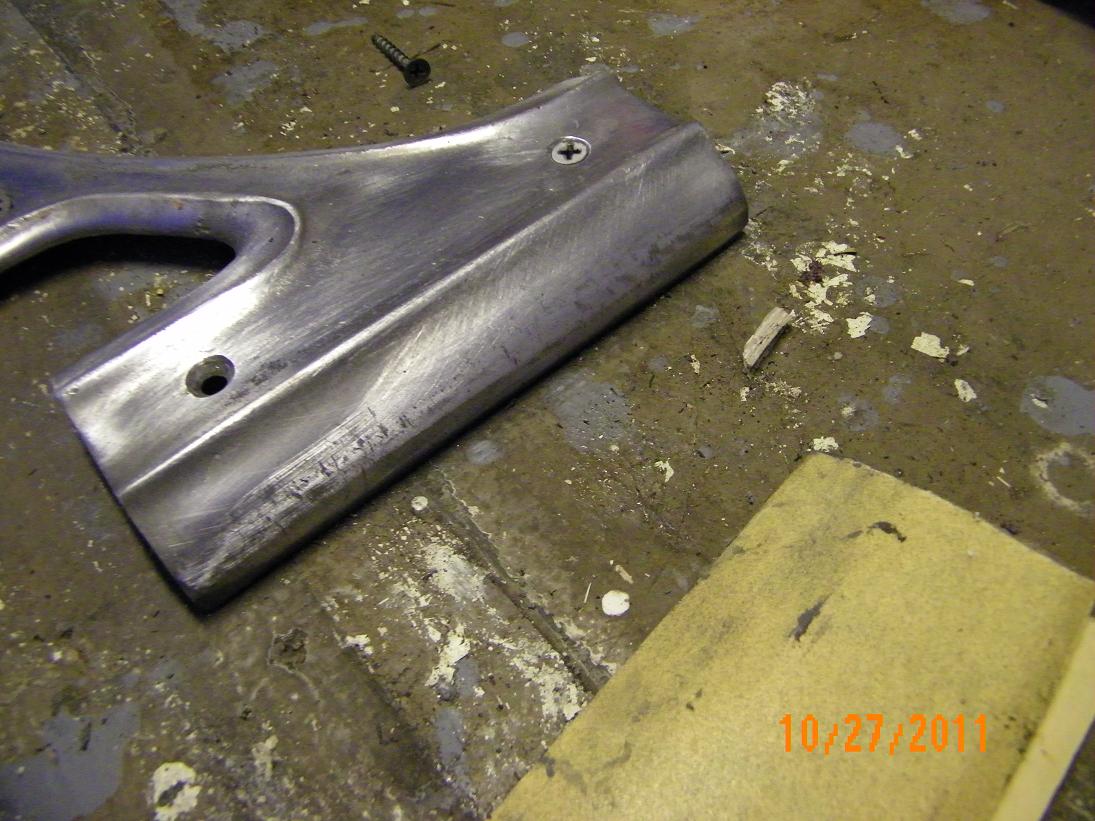

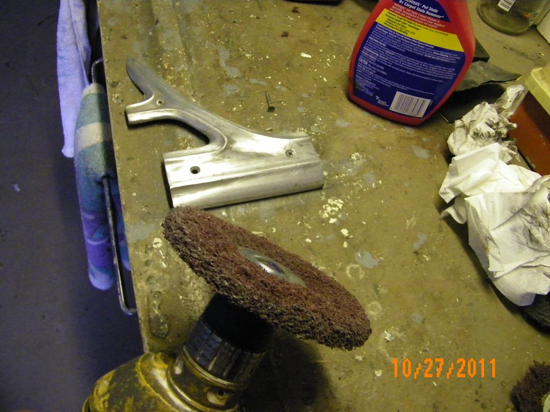

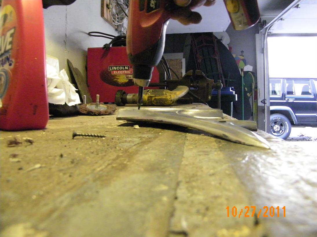

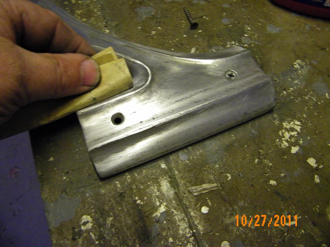

Been busy this afternoon and took a string of pictures of how I polish the crappy aluminum pieces for the build. The Herters has all aluminum trim which gets old real fast, discolors, bangs, scrapes, scratches and generally looks bad. Here is one of the side pieces, a step by step to get it better than it was.
LOTS OF PICTURES for all of us first graders.
Started out with this:
Screwed it down to the workbench to make it easier to work on.

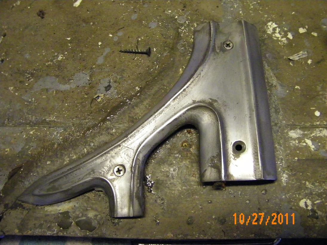

Used dry 220 grit to "buff" out the heavy gouges.
What the rough piece looked like.
Sanding out the gouges and corners.

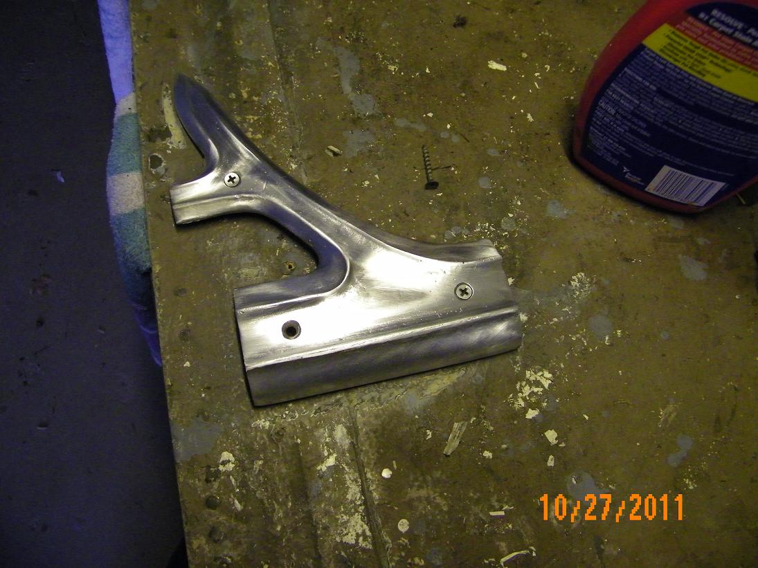

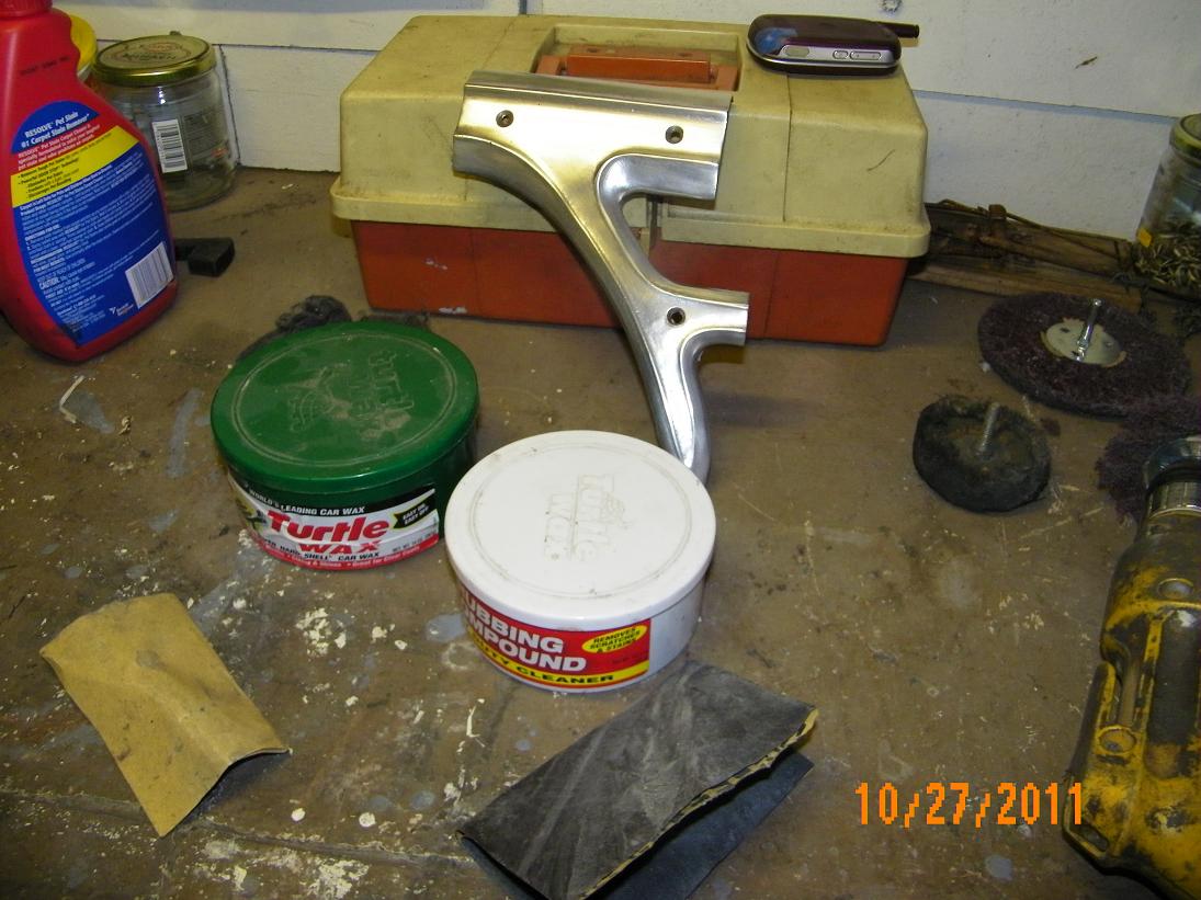

Using a Scotchbright pad to work on deep scratches.
After the Scotchbright buffing.

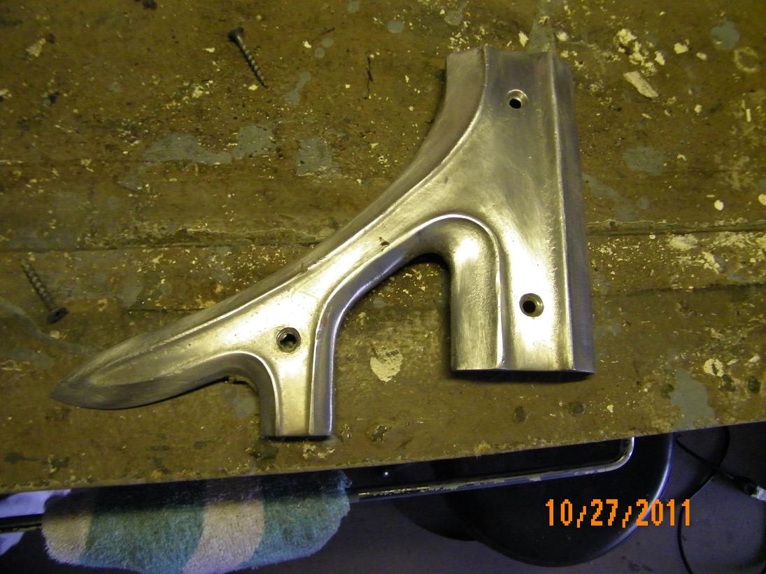

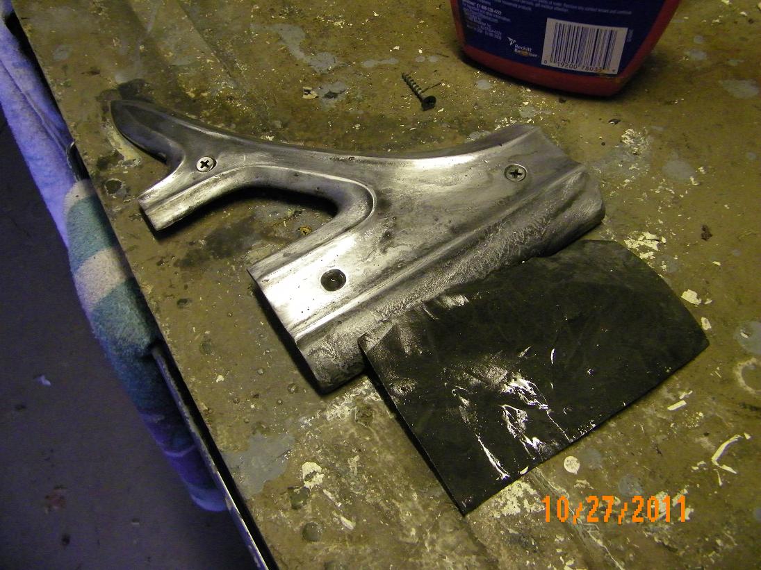

Wet sanding with 600 grit w/d.
Power rubbing with rubbing compound. That polishing wheel is over 55 years old and just about seen its' better days, but it works.
After the rubbing, looks like an oyster but the pearl is underneath.
After washing and drying. Voila!
