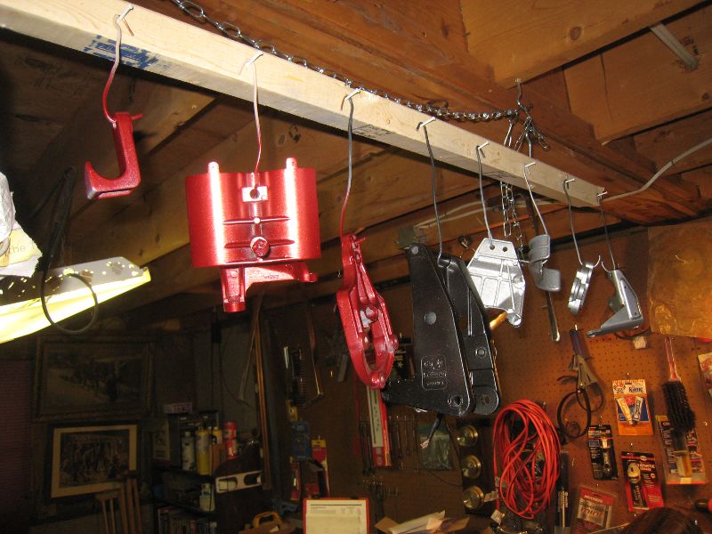

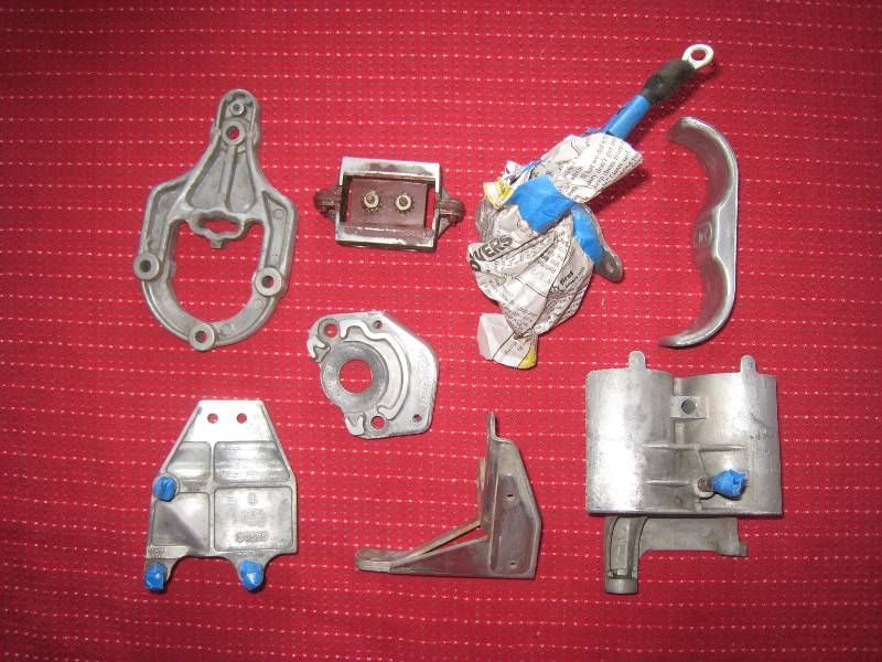

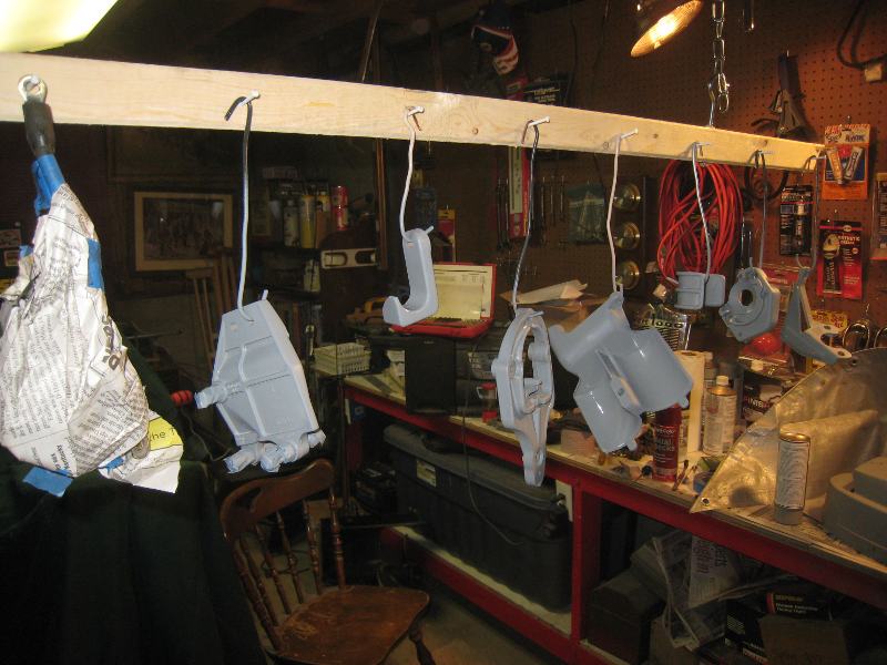

Compulsive behavior 16 years 8 months ago #1476
'63 Merc 1000 motor brackets (coils, rectifier, starter, etc.) Cleaned, sanded, cleaned again, and now primed. Hours of work, now it's just a few light coats of self etching primer, than mostly silver metallic and one or two red metallic.
Getting this done pretty much finishes paint I'm going to do "under cover." This frees me up to keep working below the middle cowl cleaning and sanding before primer. I may be done for the day, but I doubt it. Paint in the morning before we leave for work so vapors dissipate during the day.

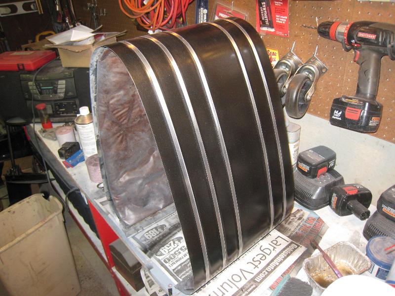

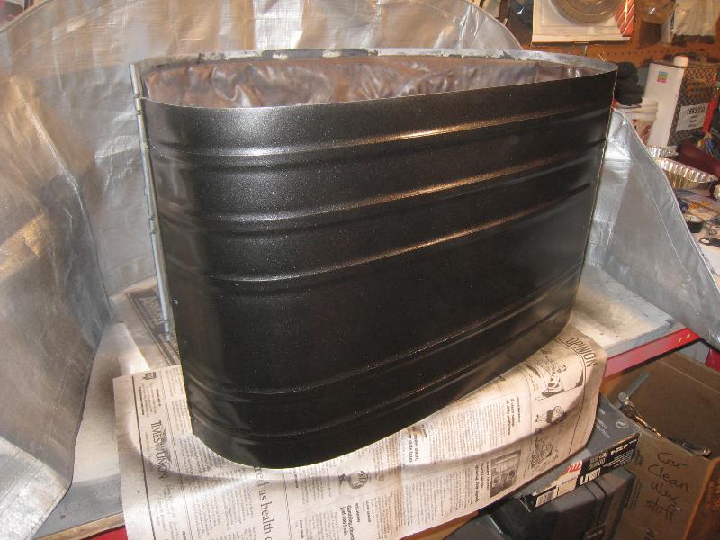

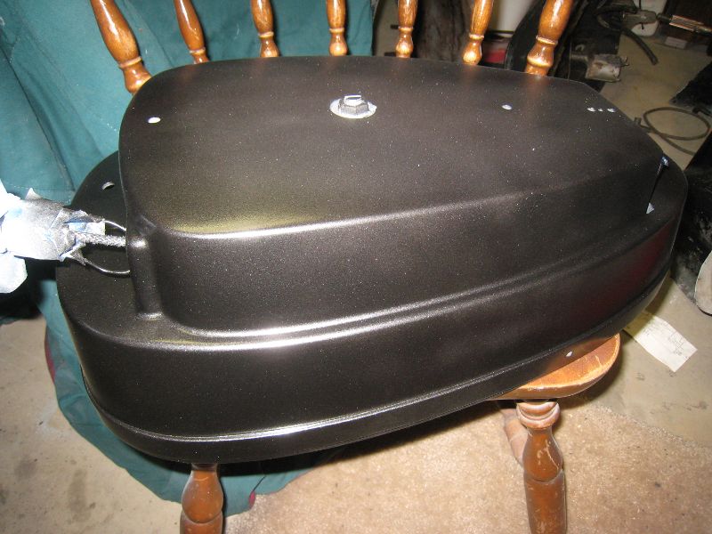

First finish coat wrap-around cowl 16 years 8 months ago #1502
Doesn't look as black with this flash pic as I think it should. First coat anyways.
Frank

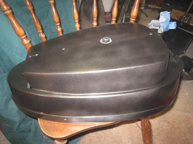

2nd finish coat on cowl, 1st on bonnet 16 years 8 months ago #1550
She's coming together. Also did 2nd coat of primer on brackets this a.m. Pics don't do this stuff justice.
Once the final finish coat is on the cowl, I'll pull the striping tape and see how she looks. Should be there by the weekend.
Frank
Re:Progress on my 14T 16 years 8 months ago #1551
Morning Frank, lookin' good buddy. I can't wait to see this Merc when it's finished. I was about to ask about the stripes, but you mentioned the tape so that explains that. Have you got the decals for the motor yet? I remember seeing a thread somewhere that somebody has them available...
Hope you have plenty of fresh air coming into the basement, don't want you breathing in too many paint fumes and going goofey on us. :)
Re:Progress on my 14T 16 years 8 months ago #1552
Thanks Mark. I'm not sure if I'm going to put decals on. We'll see. I do believe they are still available.
I don't have a lot of fresh air coming into the basement, but I wear a mask when painting and often even when hand sanding. I'm goofy enough without paint fumes to add to it...
Here's a pic of the tape box. Neat stuff. It's 1" wide. Has a 1/4" strip on one side, a 3/16 strip on the other side, and 1/16 pull-outs in-between. The raised stuff on the cowl is 5/16, so I use one side with the 1/4" and one 1/16 pull out, then use the other 3/16 side and two 1/16 pull outs.
Enjoy your day!
Frank

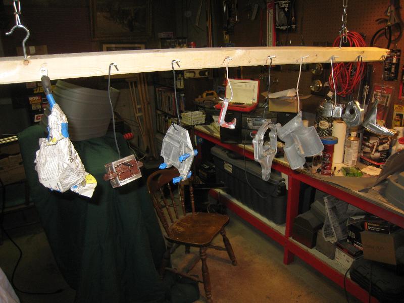

More color 16 years 8 months ago #1611
Color this a.m for the brackets, some red metallic some silver metallic. 2nd coat for bonnet, 3rd (final) coat for big cowl.
Fixed my micro switch for the trim (I think!), still working on the motor LU, getting her ready.
Frank

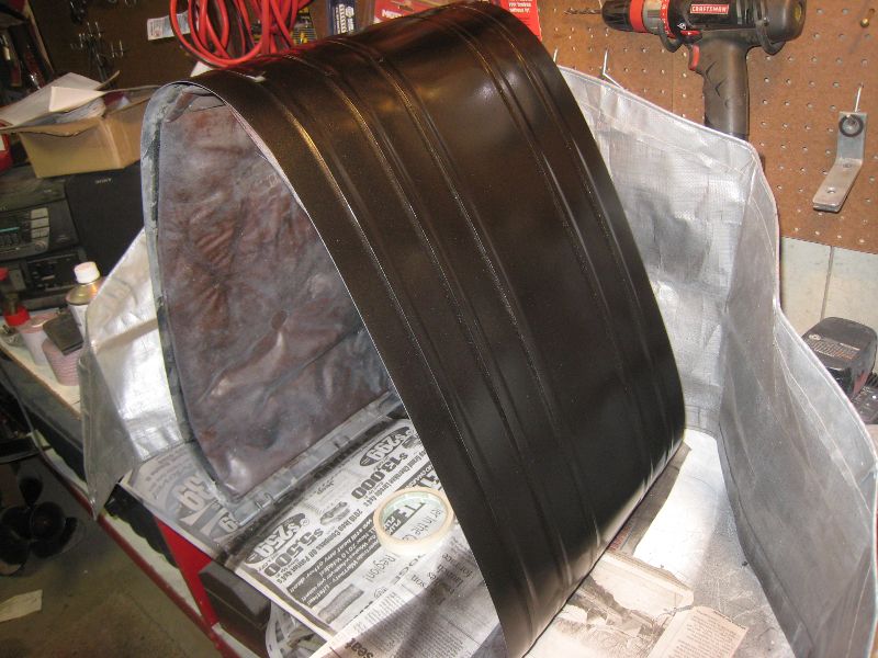

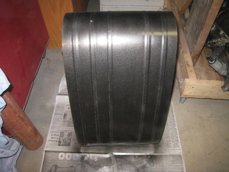

Cowl done 16 years 8 months ago #1640
Need to put on latches & trim.
LU almost ready for 1st coat of primer. Spent many hours on it today.
Re: Cowl done 16 years 8 months ago #1642
Frank,
So you paint the cowl and then how did you get the metallic stripes on it?
Ken
Hello, World!!
Re:Progress on my 14T 16 years 8 months ago #1647
Ken, see posts #1551 & 1552 above.
Any questions?
Frank
Re:Progress on my 14T 16 years 8 months ago #1648
The tape is metallic? I just didn't see that on the box.
Hello, World!!
Re:Progress on my 14T 16 years 8 months ago #1651
I'm pretty sure the striping tape Frank used is for painting. You lay it down, pull out the sections you want to paint and then spray your color, in this case silver metallic.
Re:Progress on my 14T 16 years 8 months ago #1669
First I prepped the cowl. Cleaned it, wiped it down, sanded with 180 all the black. Did the raised stuff with 220, it was in bad shape, but cleaned up good. Once that was done, cleaned and wiped the whole thing down again, then using striping tape, taped off the raised strips. Three coats of self etching primer and three coats of finish (black metallic), pulled the tape off last night. Voila! Nice clean edged raised strips.
3rd coat of the bonnet this a.m., almost done. Tonight I need to finish prepping the LU for 1st coat of primer, then do that tomorrow a.m. before work. Spring's coming, or so they say...
Frank
Re:Progress on my 14T 16 years 8 months ago #1670
ok Frank.. now I'm confused. What are the silver stripes? Paint, tape? I thought you had sprayed the black, then taped off and sprayed the silver. Now I'm guessing you sprayed the silver first and then applied the fineline tape before spraying the black.. :unsure:
Re:Progress on my 14T 16 years 8 months ago #1673
Don't worry about being confused. That is my general state of mind...
I believe the cowl is stainless, but I may be wrong. Those so-called stripes are integral to the metal, i.e., they are metal, and I assume just raised stainless. They are on all these Mercs of similar vintage. Not paint, not tape, metal. They were badly corroded, but cleaned up very nice. Once I had the entire cowl sanded (black stuff as well as those raised metal stripes), I used that pull-out section tape and taped the stripes off. (The stripes are 5/16" wide.) Then once the painting was done, I pulled the tape. Worked great.
I will now shoot a couple of coats of clear over everything on the exterior of the motor, i.e. bonnet, cowls, and LU. For that, I wanted the stripes tape off.
Make sense? Please feel free to ask any questions. Questions help, as I've never done anything like this before.
Frank
Re:Progress on my 14T 16 years 8 months ago #1694
Gotcha Frank! Thanks!

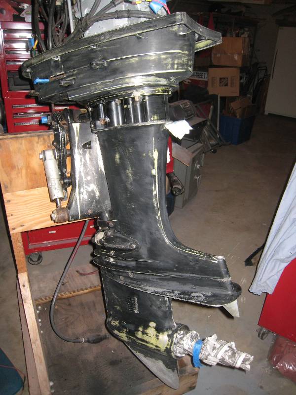

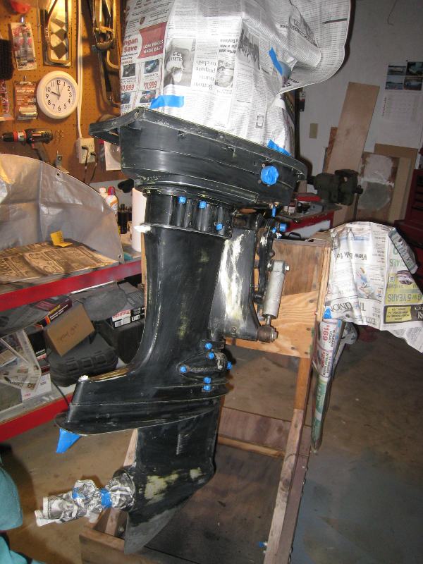

All dressed up for primer 16 years 8 months ago #1704
Finally got the prep done for the LU. With luck, prime in a.m. No luck, prime Saturday a.m.
Have decided to do at least a couple coats of clear on all exterior stuff, so it will be a while before assembly.
Frank
Re:Progress on my 14T 16 years 8 months ago #1899
Frank, that joker is going to be BEAUTIFUL. Whatcha gonna do with the shocks? (Pardon my ignorance, possibly the PT&T cylinders replace those eventually?) Too much pain meds, maybe I should go to bed. :P
Re:Progress on my 14T 16 years 8 months ago #1902
Thank you Mark. Lotsa hours, but I'm fortunate to be able to do this while winter rages outside.
Yes, the trim cylinders replace the shocks. Originally they're black, but I re-did them in silver metallic.
I'm up early to go give that LU another coat of black metallic before work. Follow along here: www.fiberglassics.com/glassic-forums/mercury-outpost/progress-on-my-63-1000
Since they integrated the Merc forum over here, I've just been putting updates for the motor there.
Take care of yourself. I bet in another week you'll be able to lift 5#s, another couple more weeks and you'll be right back at it.
Frank

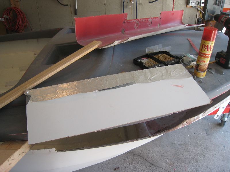

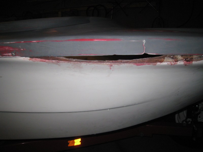

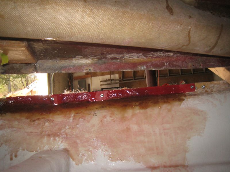

Got my work cut out for me! 16 years 7 months ago #3648
No pun intended. You can see in the "repair" pic where I had to cut out part of the hull lip because it fit the deck too tight. That's on for tomorrow, and maybe a bit more work, like dealing with places that got wet over the winter and the primer blistered. Finally, the space between the two metal poles and the other wall is going to be my temporary paint booth in a few weeks.
I'll have some full dress shots of the merc probably Sunday I'll share with you folks. Taking care of a little detail work.
Frank

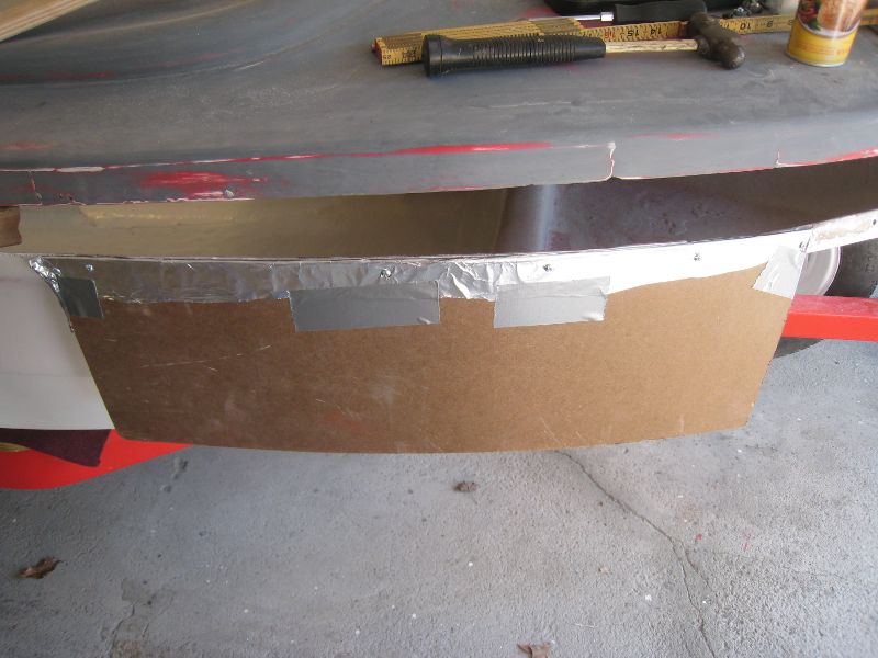

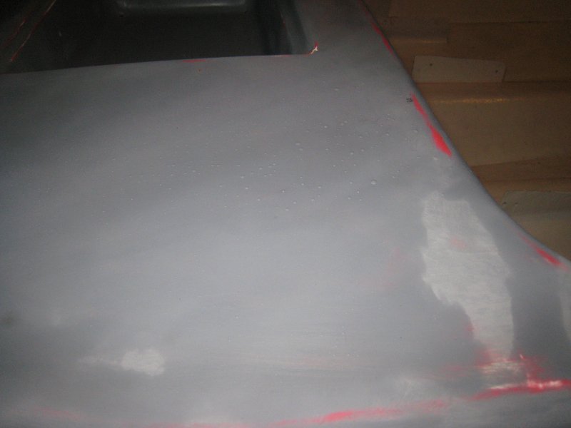

Rebuilding hull lip 16 years 7 months ago #3677
Maybe this will work. Hull lip was too far "out" for the rub rail to fit the deck lip. So I cut a piece of glass out of my old splash pan, fitted it to the cut out hull lip area, held it in place with a piece of 1/8" hardboard covered in foil sprayed with PAM for my mold release, screwed everything together to hold it in place, and just now glassed it in. Maybe it will work, maybe not. If not, need another brilliant idea.
My problem with fitment here was that the boat had been smashed at this location and very poorly repaired. When I removed the deck, I fixed the smashed area in the hull separate from the deck, not thinking that maybe when they got put back together they would be too tight (or too loose). Well, they were too tight over that entire repaired area. I been at this pretty much all morning!
I'll let y'all know if this works.
Frank
Re:Progress on my Power Cat 14T 16 years 7 months ago #3684
Well, after spending nearly all morning trying to figure out the best way to fix the boat, looks as though I was not successful. I've run out of ideas I guess. Wish I could get it right, but nope. Plus the whole deck needs to be sanded again (moisture got under the primer), and I don't know if I have it in me. Bah.
Frank
Re:Progress on my Power Cat 14T 16 years 7 months ago #3687
Frank, you're on the right track, but instead of trying to patch in an old piece, you need to built it up with new material.
The idea you had for a "form" is the part that is on the right track.
You need to build the form and screw it to the outside of the hull. The best material to use is thin melamine paneling like they use for the cheap wall paneling. This material needs hardly any release agent which is why all the fabricators use it. You will want to wax it anyway, and or use PVA release agent. When you wax it just make sure you let the wax dry before you start coating. I sometimes spray some PVA on it as well, but this is probably overkill.
You will need to taper the inside of the adjoining hull material and step your build up material as for any other repair.
You can then start your layup with gel coat if desired, (it will make a nice smooth waterproof outer layer even though you are painting over it). After the gel has started to kick, a thin layer of mat will be next followed by alternating layers of cloth and mat. Build up no more than four layers at a time so as not to cook the resin. You may want to end up with some heavy roving for one of the inner layers, followed by mat for the last layer to keep it all water tight.
edit: You know, looking at it again, you could just do this after the lid is on and save yourself the trouble of making the form. You're planning on glassing it together anyway right?
Dave in sunny Buffalo
Re:Progress on my Power Cat 14T 16 years 7 months ago #3695
Dave, that is melamine. The piece I fit in to where I had cut the hull lip out was screwed to the melamine and the melamine was screwed on both ends to good hull lip forming a curve that matched right up with the curve of the hull. Maybe it's not the hull lip I need to rebuild, maybe it's the deck lip. I have no clue. Plus the deck lip hardly fits down over the hull lip on the starboard side. I think maybe I can force it when the time comes to get the rub rail on IF I can get the rub rail on. And yes, I fully plan to glass the interior seam with probably 2-3 layers of mat, each successive one being a bit wider than the previous.
Guess I need to sleep on it, as I'm not happy, and feel like saying heck with it. All the time I've spent on this boat, all the work and effort, and come so close to the end, and I'm just at a loss. It was more of a project than I ever should have taken on. The optimism of ignorance...
I just got back from a 2 hour cruise in my hot rod. I built that from scratch and been driving it since '01. Least I got one summer toy that works!
Thanks for the ideas. We'll see what happens.
Frank

Re:Progress on my Power Cat 14T 16 years 7 months ago #3732
On top of fitment problems Mark, all the primer is screwed up, needs to be completely sanded down, maybe worse (i.e., more fill). Guess I'll go out and see how long my shoulders can take sanding this a.m.
