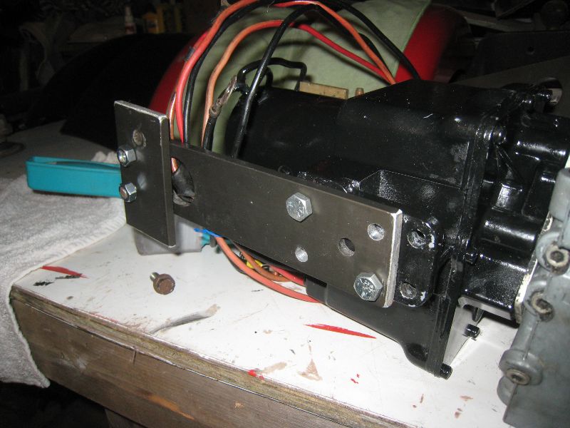

I need 4 5/16 X 1 cap screws for this John. I don't think 1 1/4 or 3/4 would do it. I'll pick them up. I have an astonishing variety of stainless hardware in the shop, just never what I need at the moment.

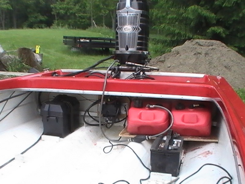

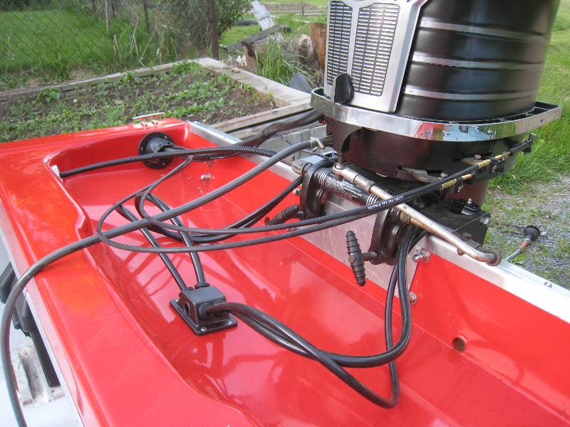

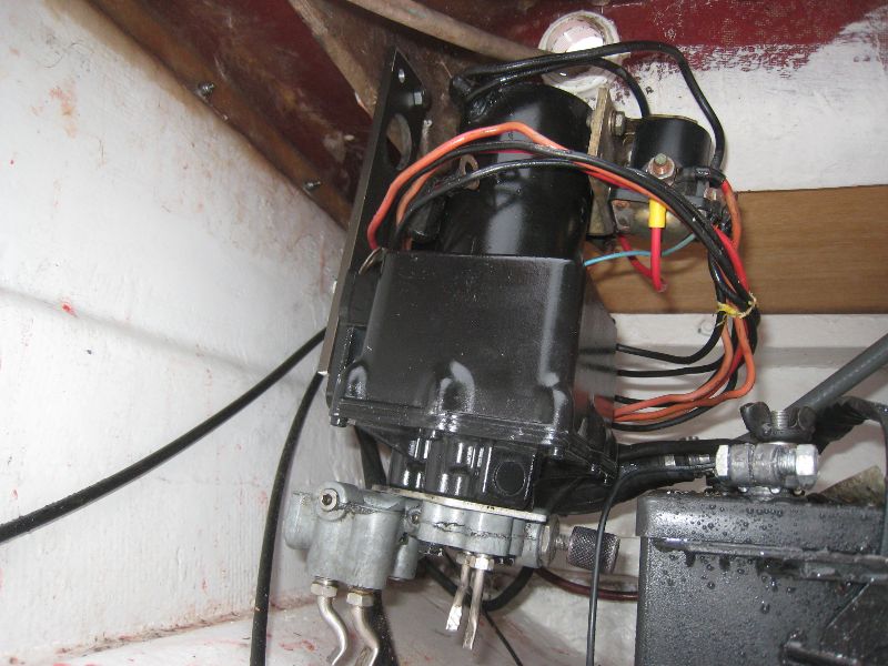

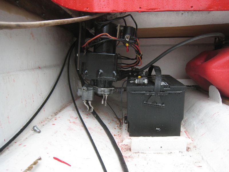

Trim pump install this a.m., or at least a mock-up. Nothing's tight, so it leans a bit, but I think it will work. Now if I could find my splashpan oil tube grommet thing, I'd be all set... (grrrrrrr!)
Don't mind my cut off hose-end - keeps the pump from leaking oil all over my boat!
Frank

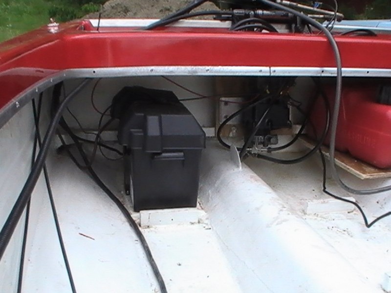

Re:Progress on my Power Cat 14T 16 years 4 months ago #6991

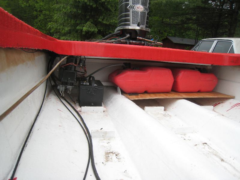

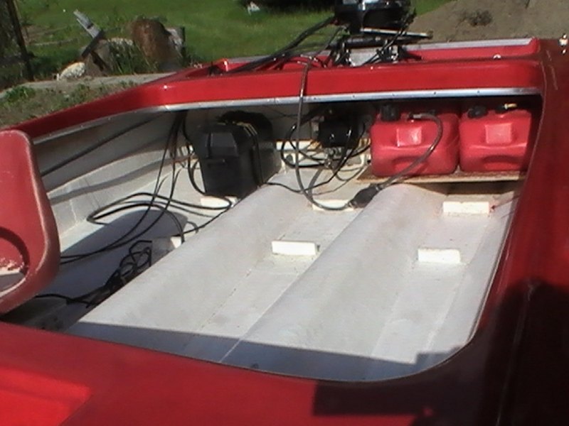

Wow Frank, raising the transom and splashwell really gave you a lot of room back there. My fuel tanks are on the bottom of the boat in the original risers and don't have as much headroom as yours. You gonna glass in the plywood platform or is that a temporary solution?
Bernie
Re:Progress on my Power Cat 14T 16 years 4 months ago #6992
Gee Bernie, never really thought about space I would get from installing a 20" transom and building a new splashpan. I've never known anything different, because when I got this boat it was a bare hull and deck, I separated them and never looked back. Huh!
I guess that platform for the tanks is temporary now because I only glassed one side of it, and it has since warped in the rain. Maybe I'll bake it in the sun this weekend and encapsulate it with mat and resin. I will not be glassing it into the boat, I'd rather have it be removable. It's a tight fit, believe me!
Thought you were gonna shoot me a pic of your control box mount? Actually I'd love to see a shot of where and how your seats mount too. I can't figure out what sort of slider/swivel to get I guess until I get the seats. Hopefully order them within the next few days, then figure it out. Gonna order a new prop tonight.

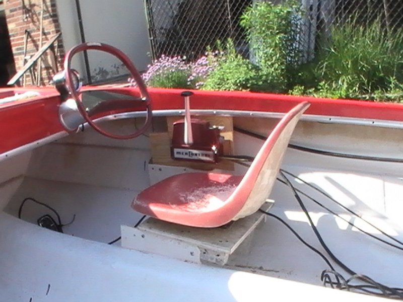

Does the wood mount go over the top of those glassed in seat bases such that it sort of rests on the glass Bernie? What kind of seats do you have? Buckets? Fishing (fold-over and snap)? Home made?
I'm in no rush, this is stuff I'll be doing once the trim is installed and that is a job in and of itself.

Here we go.
Ignore the dirt.

Re:Progress on my Power Cat 14T 16 years 4 months ago #7008
Pretty slick Bernie.
Did you add the floor over the middle hull? I was thinkin about doin that too.
Did you build the console under the middle of the dash?

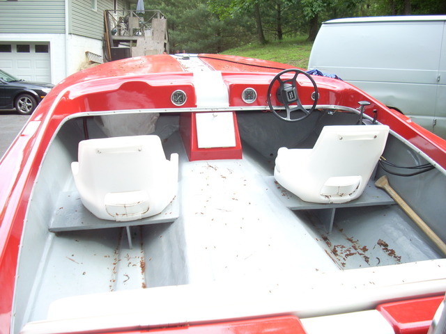

Re:Progress on my Power Cat 14T 16 years 4 months ago #7018
Who wha? Whoever fixed them, THANKS!
My center sponson was covered from the factory and full of wet foam that I dug out with a garden shovel. I recovered it and left out the foam.
The console was an idea I got from pictures on the Powercat site of Lynn Grahams boat. Mine doesn't have the 'map pockets' on the sides of the hull so it comes in handy for putting wallets keys etc. in there.
Seat bases were built and seats selected with weight and cash savings in mind.

Re:Progress on my Power Cat 14T 16 years 4 months ago #7019
I like both the idea of covering the center hull and the console, but I don't want to get waylaid right now.
I am gonna do some glass work maybe tonight right after I order a new prop. I've decided to glass a piece of plywood where I have that aluminum bracket for the trim pump that will go from the plywood I have the bracket attached to, to the floor. It will provide a much more solid and inflexible mount for the pump, and will probably in the final analysis be less work! Maybe I'll deal with that control box location at the same time...

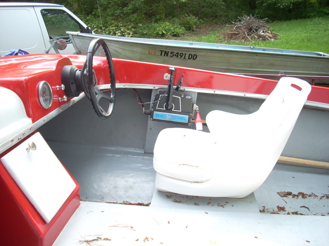

The seats are outstanding! Enjoy your time off.

Re:Progress on my Power Cat 14T 16 years 4 months ago #7045
I didn't get those seats shipped overnight Bernie - 300 bucks for overnight delivery. Usually I get ground stuff in 3-4 days. Long as i get them by a week from tomorrow I'll be happy. I need to build some seat bases anyways. Lots of little details, but she's comin together.

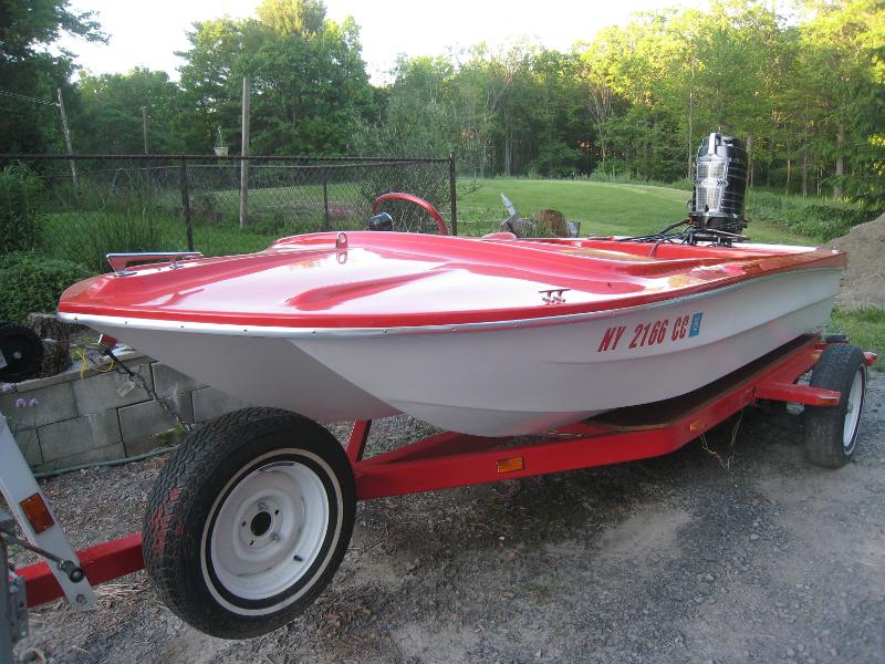

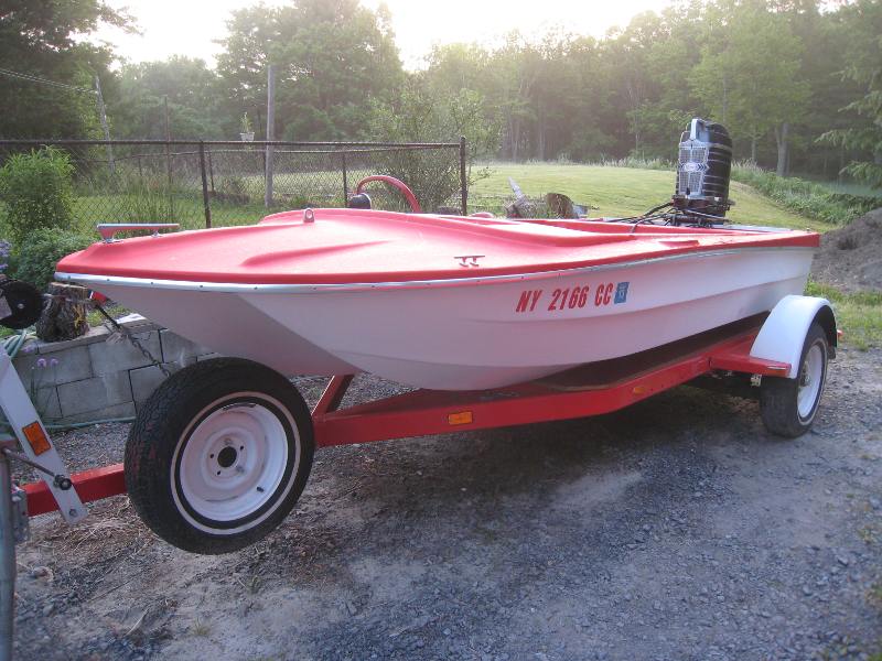

Morning mist shot 16 years 4 months ago #7455
Got the fenders on this morning and the trailer wires hid. Trailer is almost ready to roll.
Re:Progress on my Power Cat 14T 16 years 4 months ago #7456
She's lookin' good, my friend!

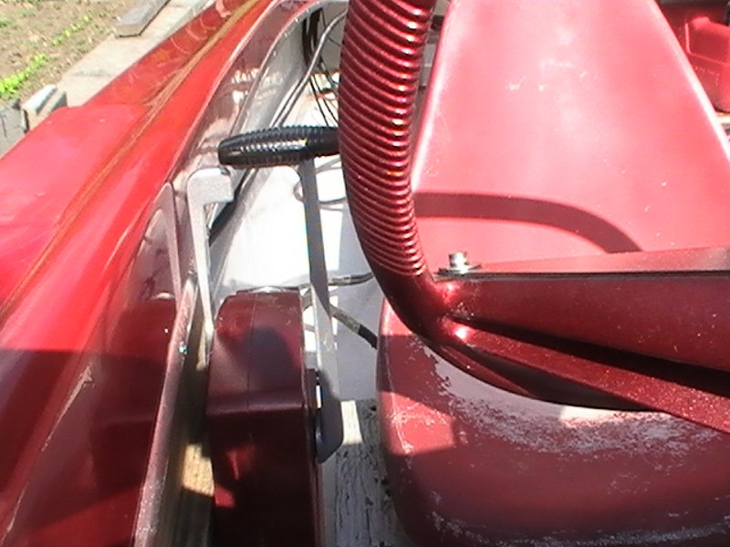

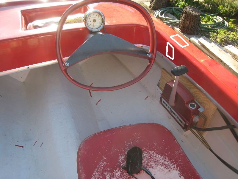

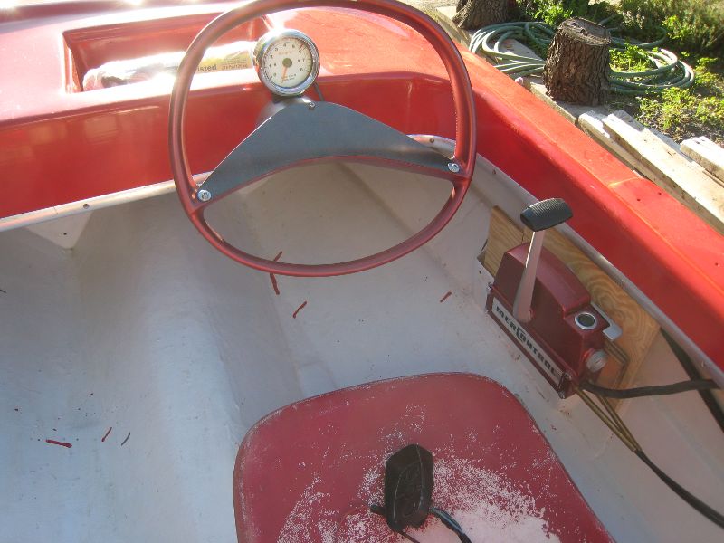

Trying to figure out where the best place is to mount the power trim controls. Right of the steering wheel, left, some other place? Ideas welcome as long as they don't entail spending $!
Can you post a pic of your control switch? Think you're going to want to stay on the starboard side, near the throttle. That way you can keep one hand on the wheel adjusting trim while underway to stay safe. Hope your prop shows up today, what did you order?
Re:Progress on my Power Cat 14T 16 years 4 months ago #7457
Looks great Frank!
Given the size of your steering wheel, making it difficult to reach the dash underway, I'd probably choose to mount that large trim unit on the gunwhale just forward of the controls. Shown in white in the attached image, the locations which would make the most sense to me. For the reasons Mark said, I think that is the best spot.
I'd more likely choose a trim model that is mounted to the steering wheel itself (finger tip controls using left hand while still holding the wheel), but you asked for options without more dollar investment.
Can't wait to see your float test. Good luck!
Re:Progress on my Power Cat 14T 16 years 4 months ago #7461
Thanks Mark. The control switch is sitting in the seat in the next picture up from the one I took this a.m. It's about 2" X 4" or so. and needs a big hole cut out to mount it. I think it's going to go right behind the idle lever.
I ordered a 3 blade 21 pitch aluminum blade to start. Once I get a working tach, I'll be in good shape. By the way, I found the tach instructions (actually cut the wires with tape still on them :) ), and the tach is hooked up correctly.
Went to caulk the bow seam last night and discovered my new tube of caulk was already cured. :angry:
Frank

Boy Chris, I hate to cut a big hole in the original glass of the boat to mount this switch if I'm going to get something better (steering wheel or throttle handle) later. I can't afford an alternative right now, so am going to have to figure a better way to mount this baby, then maybe next year get something to mount on the wheel.
Float test soon. Thanks!

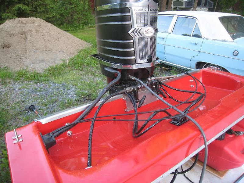

Re:Progress on my Power Cat 14T 16 years 4 months ago #7468
frank, where did you find that black rubber gromett the control wires are running thru. i need one..no three. one for control wires and 2 for the steering cables.
Re:Progress on my Power Cat 14T 16 years 4 months ago #7473
Ron, Brian Lawson brought it over. He needed a couple for his big Power Cat and got one for me. I think he got it from Jamestown Distributors, but after searching through their website for 5 minutes, I can't figure out what it would be called, and as such can't seem to find it. Maybe it wasn't JD too, I just don't know.

Re:Progress on my Power Cat 14T 16 years 4 months ago #7475
Got it: www.jamestowndistributors.com/userportal/show_product.do?pid=9141&familyName=TH+Marine+Cable+Boot
Make sure you get the cable boot and the ring. I think they are two different things.
Look up control cable boots, Ron. They're available in 3" or 4" diameter in various styles from a couple different places. The better ones come with the ring, the cheaper ones without. The ring helps hold the boot down and looks better. You can see why in this link:
www.fiberglassics.com/glassic-forums/the-70-s-disco-fiber/1973-glastron-v178-starflite-project#7508
(The one on the port side looks fine, but the starboard side is needing the ring to keep it flat on the flange.)

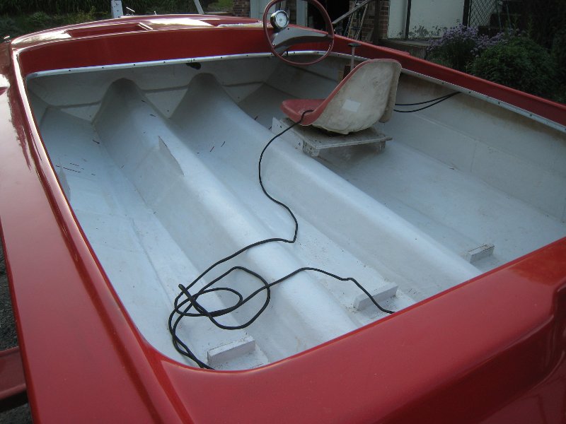

Really all I need to do is make some seat bases. Got started tonight, then the sun went down and I wanted to wash my pollen-laden truck and put it in the garage. Got a few things to sand and mount. Need to attach the fire extinguisher someplace. Need to make up my anchor rode. Need to torque a few things on the rams.
It's tough keeping going when you get up at 4:30, work an hour or so on the boat before getting ready for the office job, come home, change, work in 85 degree heat on the boat outside till I about drop. Of course, this weekend, when we 1st hope to get the boat out, it's gonna maybe be 70. Whatever!
