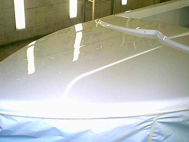

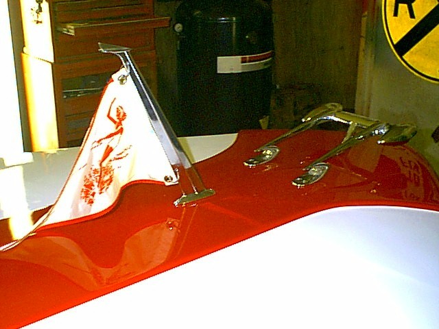

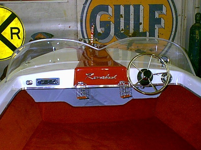

That boat is commin out great. I too like the shine. Glad to see its glassed back together Frank. Keep the update's rollon in, Mike

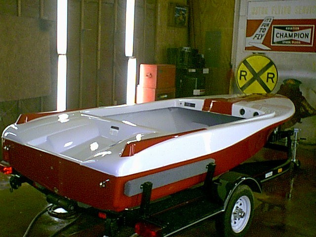

Re:Rub rail on my Power Cat 14T done 16 years 5 months ago #5839
classicfins wrote:
Really looks greta Frank! It's amazing what difference a rubrail will make. You're almost there now! :)
Thanks Doug. Yeah, rub rail makes it look done, just get 'er rigged!
Thanks for the compliment Mike, but ya gotta know the paint is shiny only because it hasn't been sanded. It needs to be sanded, but there are still areas not covered well. Plus if I sand it, it will lose it's shine. For this season, I think other than a bit of touch-up and efforts to cover a few places the gray still appears, it's done!
Next project is finishing the trim, and mounting the steering mechanism correctly!
Frank

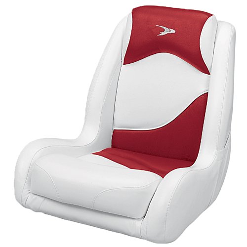

These are the front buckets we're planning on getting for it...

Re:Progress on my Power Cat 14T 16 years 5 months ago #5857
Nice looking seats Frank.
Re:Progress on my Power Cat 14T 16 years 5 months ago #5859
Thanks guys. They're a bit pricey, but we're old, and it's a small boat...

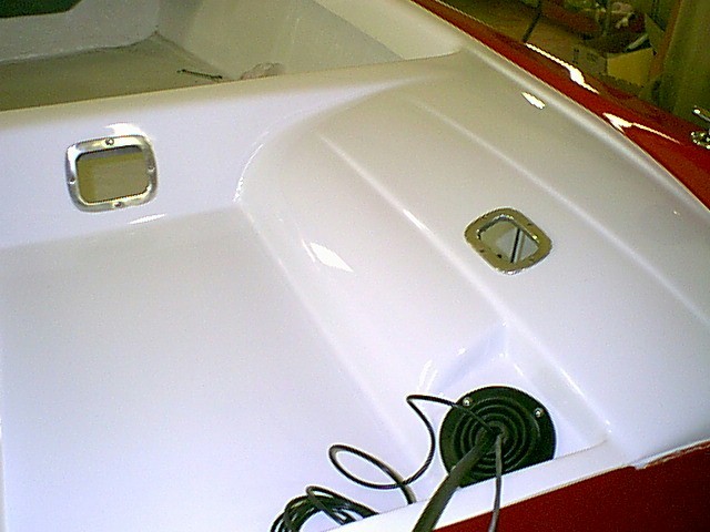

Where do you get those big grommets that go in the side of the splash pan for the steering cable to come through? I know I've seen them somewhere, but West Marine doesn't appear to have them, NAPA doesn't. I was looking at other grommets that might work too.

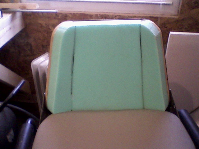

great frank,and wow those are beautiful seats,do you have pics of the back seat you made,i love pics of homemade stuff,its raining here so im finaly going to go out and work on the sunray,ill work on the porch tommorrow.it will be great to see you all again at silver lake,by the way your boat looks fantastic,keep up the good work buddy.
Re:Progress on my Power Cat 14T 16 years 5 months ago #5870
Thanks John. Had some pics of the back seat but hard drive failed. I'll find the pieces and get her mocked up sometime maybe this week and take some shots. No upholstery, just plywood right now.
Frank

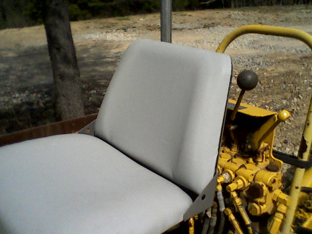

if its flat and rectangular ,you and gale can do it,heres a tractor seat i just did a little while ago,it has angles ,round corners and its 3 peices biscut jointed and glued together,for yours if theres no sewing involved ,just cut your plywood backing,then glue foam to it with a good spray adhesive,then cut the foam all the way around with an electric carving knife,then start stapleing your vinyl all the way around ,1st staple one side in just a couple of places then go to the oppisite side and pull your vinyl until it is smooth and tight,then do the same to the other 2 sides,.
leave enough vinyl so you dont come short,you can cut the excess later,then if you have some small wrinkles ,use a heat gun on the low setting,but make sure you hold it far enough away that you dont burn it,hold it just close enough and long enough to shrink it some and the wrinkle should dissapear.
if you dont want to do it yourself,take the seat and vinyl to silver lake and ill take it home and do it for you if theres no sewing.at no charge frank,take a pic and ill let you know if i can do it,john

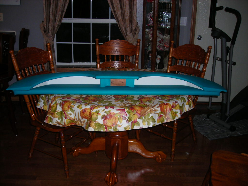

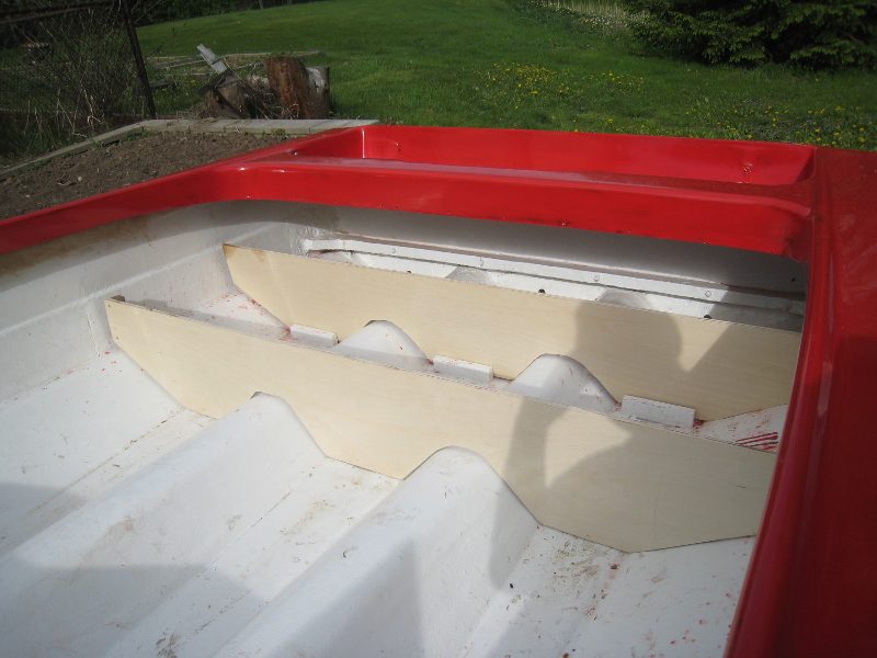

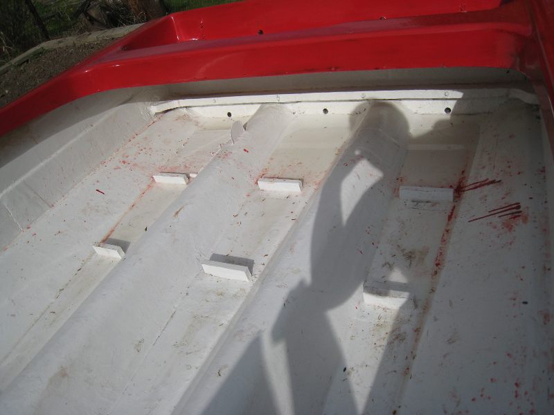

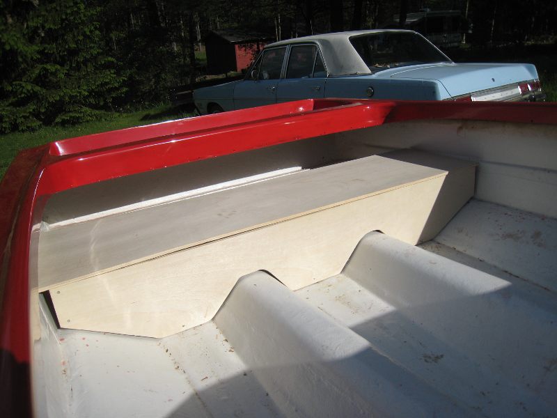

Rear bench seat on my Power Cat 14T 16 years 5 months ago #5891
This is as far as I got John. You can see in the 1st pic the little mahogany blocks I glassed to the hull/floor, then the pieces I made to fit over the tunnels/hulls (they get screwed to the blocks or maybe thru bolted), then the top piece. Not sure I like it, but it is a low level priority right now. Heck, at least I could find most of the stuff. Not sure if I made a back or not.
Not sure whether to just paint it, glass it (cloth) on the outsides, totally encapsulate it with glass, or what. I just want to make sure it can be taken out.
Frank

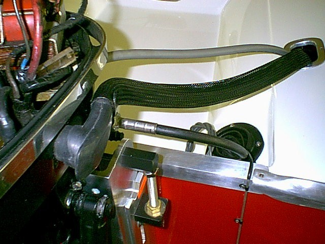

Frank, Check out this link and see if it helps.
www.iboats.com/Boat-Cable-Boots/dm/cart_id.807229670--session_id.750935802--view_id.217153
If you're talkling about just the trim ring that would cover the edge of the hole, I've been looking for those myself. I used to pick them up at one of the local marine dealers, who has since gone out of business. I think the boots look a little nicer anyway.
Re:Progress on my Power Cat 14T 16 years 5 months ago #5906
I'm gonna check out Home Depot in the a.m. Mark, see what they might have in electrical grommets, flanges, fittings, stuff like that. They carry the black corrugated hose I'll be using for both sides of the motor, and I want to buy a roll of that. Still figuring this out, but I think I got it, with help from a buddy out in Arizona who does this with his hot rod boats (Dick Davis).
I'd really like something that would seal better than the old rubber ring for my steering cable. Got a lot of stuff to do to get that boat of mine done!

Re:Progress on my Power Cat 14T 16 years 5 months ago #5907
Frank,
I got mine at my local boat dealer here in town. Sometimes I use the ones that had the rubber boot on them that tie wrap around the cable or wiring harness so that water that happens to come in over the transom in certain conditions doesn't pass through the opening and into the boat.
Re:Progress on my Power Cat 14T 16 years 5 months ago #5908
Yeah Doug, that's what I want, sumpin like dat. I want to keep as much water out of the boat as I can. I really have no clue how this old boat is gonna do with a taller transom even with the gunnels of the boat, and the motor sitting up like that. More water in the splash pan? Less water?

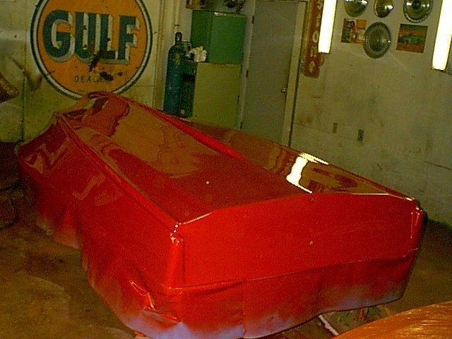

Boy, that's a real pretty boat from what I can see of it Doug. Which one is that?
Frank

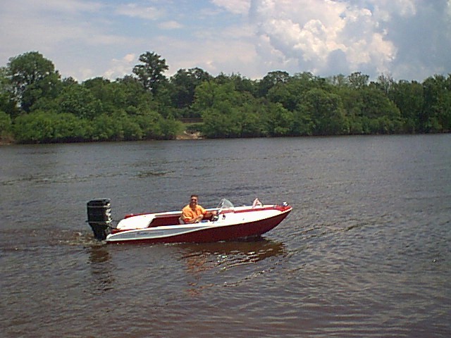

Re:Progress on my Power Cat 14T 16 years 5 months ago #5915
I think you'll have no problems with water over the transom Frank. The pic was my Razorback Fury.

F, I see what you're looking for now, I'll keep my eyes open. Let me know if you find something acceptable in the meantime. I have a hunch you could run a taller prop, but the 19P will be a good starting point. You're getting soo close, the anticipation gets bigger every step you get done. We're all cheering for you bud!
Get Your Boots Here 16 years 5 months ago #5926
www.jamestowndistributors.com/userportal/show_product.do?pid=9141&familyName=TH+Marine+Cable+Boot
F - I need 3 for the Power Cat. Let me know how many and what size and color you want...my gift to you. Sort of a pre-launch present. Actually, on re-checking, for 4.5", your choice is black or black. So I guess black it is! About $11 ea for the boot plus ring. B
Re:Progress on my Power Cat 14T 16 years 5 months ago #5927
Really B? I guess the smaller one. My old ring has a 2 1/8 i.d., but I think it's very similar to the 3". I just need it for the steering. The gas, battery cables and motor plug cables will run through 1 1/2" irrigation hose like Dick Davis uses. Gotta buy it in 20' rolls. Need a few feet?
By the way, with my motor now raised 5", I wonder if I want the steering still to come out of the side of the splash pan or from the gunnel? Won't be tough to figure out, but just a thought. You might notice some of the Power Cat hot rod boats have them coming out of the gunnel because they have their motors raised so high.
I need to figure out what to use on my glove compartment covers for weatherstripping or something that just goes around the inside bottom so they don't rest directly on the paint. Maybe I'll ask Danny.
Thanks.
Frank
Re:Progress on my Power Cat 14T 16 years 5 months ago #5930
Already ran my through new conduit. 6' section, $2.99 as I recall. I'll order you a 3" in black. I need 3 4.5 inch. B
Re:Progress on my Power Cat 14T 16 years 5 months ago #5932
That's split wire loom isn't B? I'm running mine through hose, no split in it. I'll use some small wire loom like that and tie wraps to clean up the end of the steering cable that pokes out. F

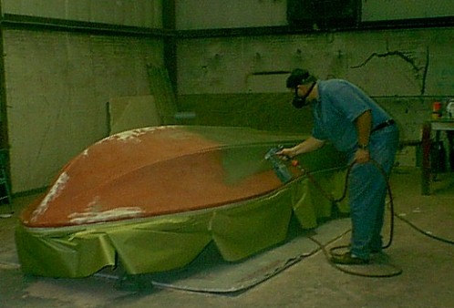

Yep, she's gone. I sold it about 4 years ago. I have a 2nd one that I will finish one of these days. The Fury was the first boat I did when I got back into boats after a 10 year vacation.
Re:Progress on my Power Cat 14T 16 years 5 months ago #5947
doug, the shine on that is awesome. what product did you use.? ron
Re:Progress on my Power Cat 14T 16 years 5 months ago #5950
Thanks Ron,
It's single stage PPG automotive acrylic urethane. Did all the body work, sealed everything with DP40 sealer, and then primed the hull with PPG K200 urethane primer, wet sanded with 600 & 1000 before spraying the paint. The deck was done the same except I used PPG K36 urethane primer since I had some on hand.
Doug
I like to use a mesh nose that our local dealer sells. Seems like all the new boats on the lot use these mesh stuff that is kinda small in diameter, but you hold one end and push on the hose and it opens up wide. Then you can slide your hoses and harness through and then stretch it back out and it shrinks back down to a snug fit around everything. Not sure what it's called but it's pretty neat.
Doug
