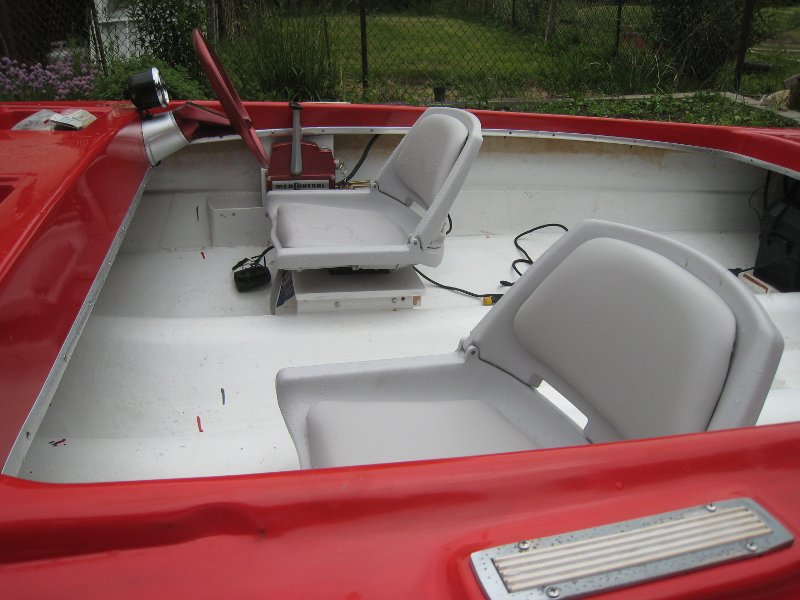

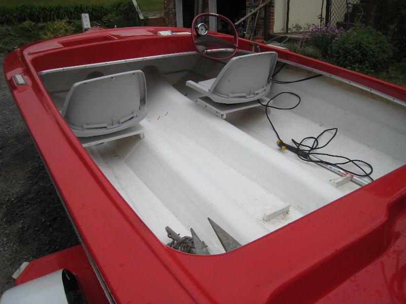

New prop, seat bases, control box mount, cheap sea 16 years 4 months ago #7657

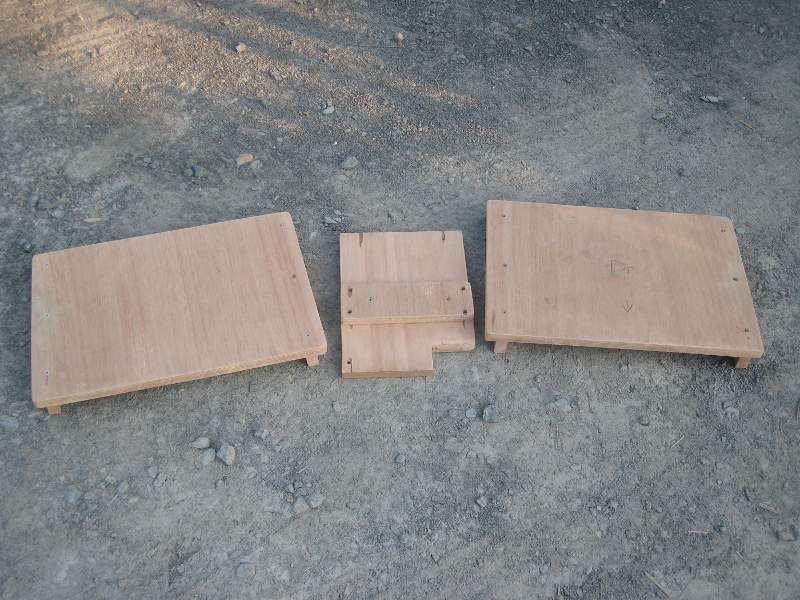

Finished the wood stuff this a.m., will coat white 2 part white epoxy tonight. Pics tell the story. Gotta run!
Frank
Prop, seat bases, control box mount, cheap seats 16 years 4 months ago #7658
Pics have to tell the story, gotta run! Inside boat pic shows how I cut the seat mounts to all be level. Other than the red oak 1 X 2 stuff for the seat bases, this is all 3/4" mahogany marine plywood (11 ply).
Frank

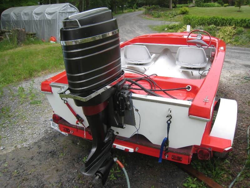

Power Cat 14T in motion transom shot 16 years 4 months ago #9061
Had the boat out Friday morning for a fairly calm day test run, second day (including last Saturday) she's been out. Man o man, talk about a fun boat! Only got up to 38, but that was goin upstream on the Hudson bumpin 5200 rpm. Wanna get a 19 pitch prop on, see how she works. Old merc is runnin great!

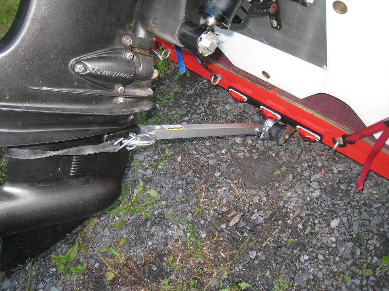

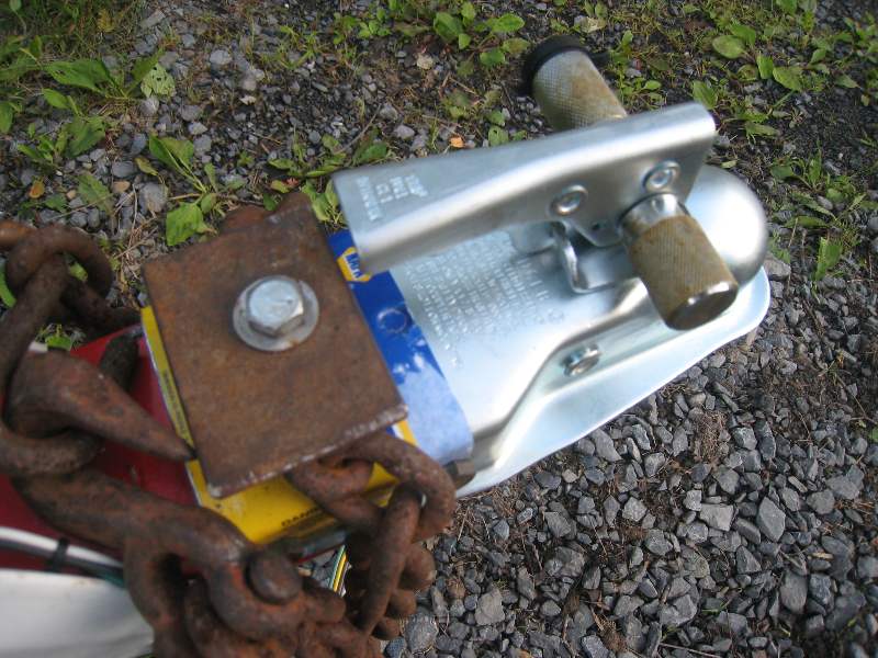

A couple upgrades 16 years 3 months ago #9428
First trip with the trailer (Silver Lake) rear three light bar (white plastic) broke off at the mounting bolts somehow, no clue. Put an aluminum one on tonight, installed a roller for a transom saver to mount on, got the transom saver one. Also replaced a pain in the rear coupler and added a big flat washer for the chain bolt.
Tuesday night before we left for our ride, I put a big aluminum flat washer on the inside of the bow eye and tightened her down. Boy, did that make a difference!
