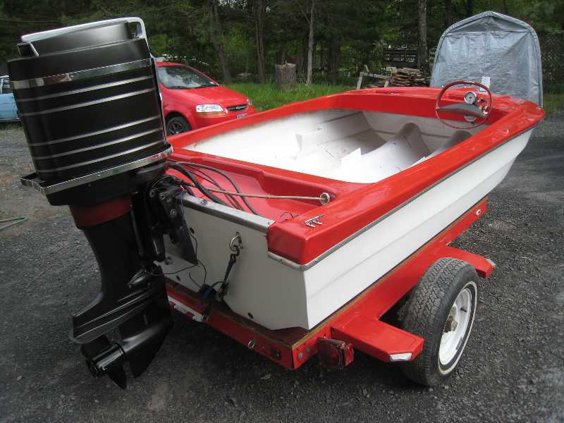

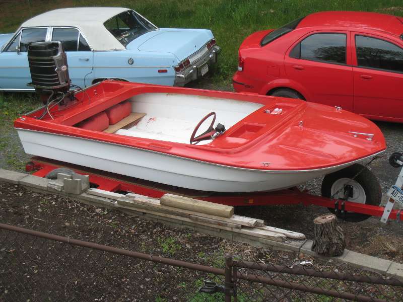

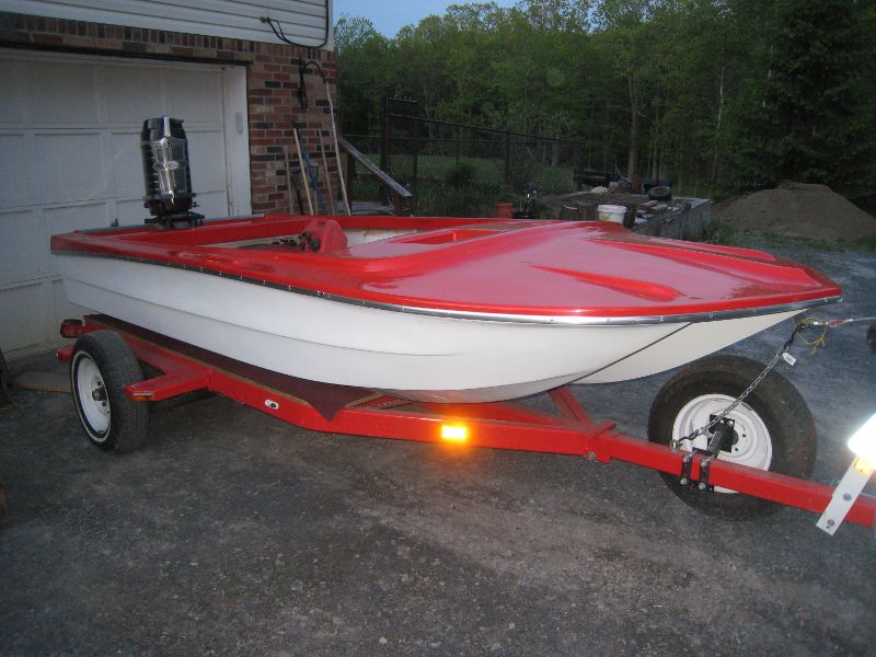

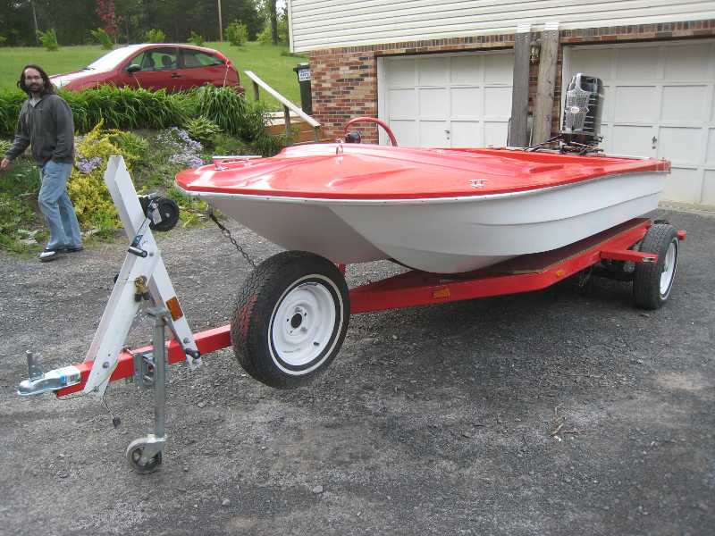

A story in pictures. 16 years 5 months ago #6208

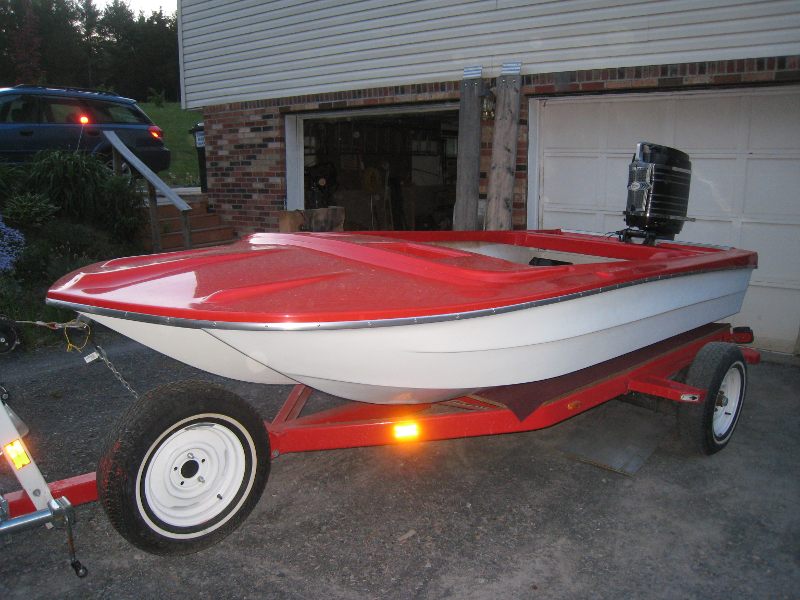

Re:Progress on my Power Cat 14T 16 years 5 months ago #6209
Now she's starting to look like a real boat again Frank, congratulations!

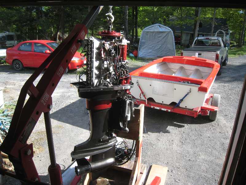

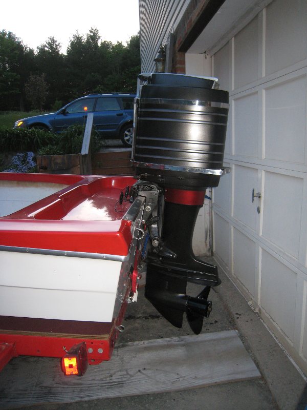

Re:Progress on my Power Cat 14T 16 years 5 months ago #6220

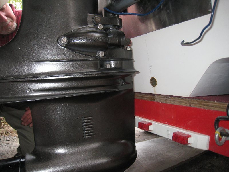

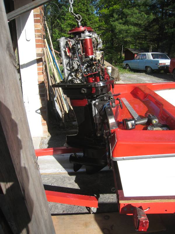

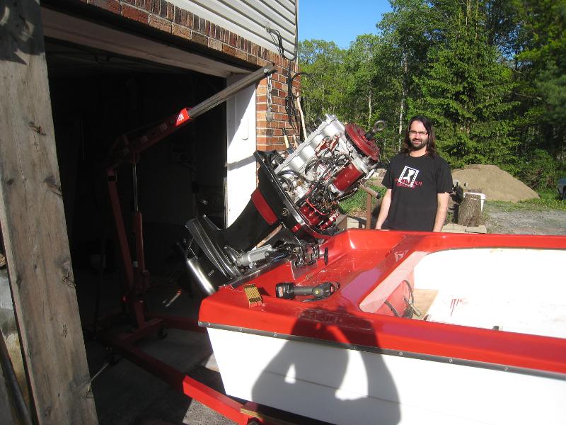

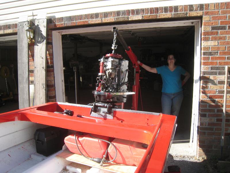

Thanks guys! I'm just glad the big merc went on okay, and all my efforts building that custom transom paid off. Got the motor right where I want it.
I centered the motor by triangulation, thanks to a suggestion from Dave Bernard. I got it on such that I could just move it back and forth, then took measurements from the center of the bolt holes for the transom bracket to the inner edge of each outside sponson. I believe I got this baby to within 1/64" of center.

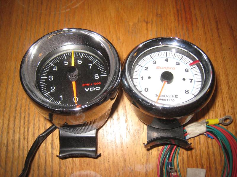

Morning Frank. What tach are you going to be using? (Got pic?) If it's one of the old Airguides you don't have to cut a hole, just drill a one inch hole just below center for the one little bump out in the back (where the needle mounts in the gauge), and can also run the wires thru there. Then the three mounting screw holes and you're done without a big cutout!
Re:Progress on my Power Cat 14T 16 years 5 months ago #6223
Top of the mornin to you sir!
I have two tachs Mike, a VDO and a Sunpro. Both are made to either mount on a steering column or in a dash. I'm going to put steering in 1st today, then take a look at where I want to mount one of these. Both are universal tachs, with switches for four stroke 4,6 or 8 cylinder. Even though the merc is two cycle, it's dual ignition, so setting these babies to 6 cylinder and hooking to only one side of the ignition (one of the two coils) gives you accurate rpm. I got both of them for nothing from a buddy who scraps cars and trucks, so no investment, and they both work fine.

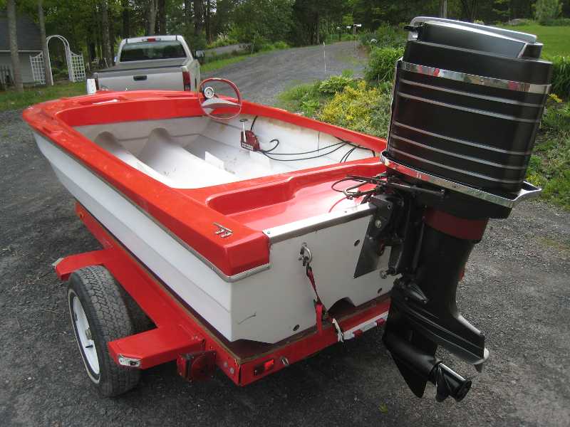

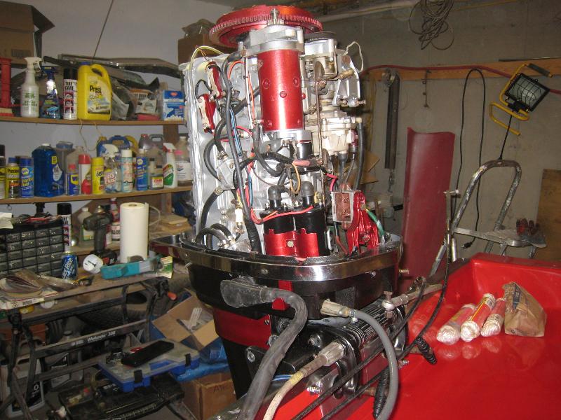

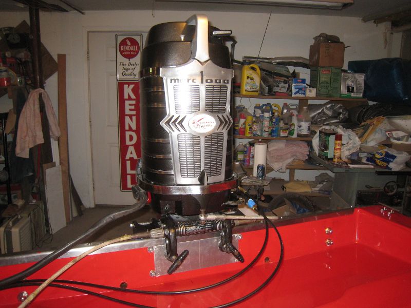

I really hustled last night after dinner to get the motor hood on and take some pics. Go to move my new truck and it won't even turn over. Somehow the security system turned itself on and wouldn't let me go. Long story short, ten minutes later it started, but too late to pull the boat away from the garage for better pics, got dark quick. I was so glad to be done, I came in, had a few drinks, fell asleep. Left the truck windows open all the way, and last night it poured of course. Oh well, needed to clean the interior anyways.

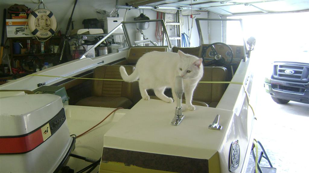

Sweet rev meters buddy, either one will look great! Sorry to hear about the trouble with the Jimmy, dang new-fangled equipment anyway. I've got to call around to the junk yards today and find a passenger side mirror for my F150. I was looking at a boat along side the road yesterday morning on the way to work, got too close to somebody's mail box, and WHAM! (Just keep the Bonehead stunts coming.) I wanted to take the Starflite to the lake today, but think I better get the mirror fixed first. :blush:
PS - Just noticed someone whacked my karma down again, guess I'd better be less "opinionated" on here - Sorry Y'all, I'll try to do better!
I think Precious (the cat) wants to go for a boat ride!

My cat doesn't even go out of the house, doubt she wants a boat ride. :)

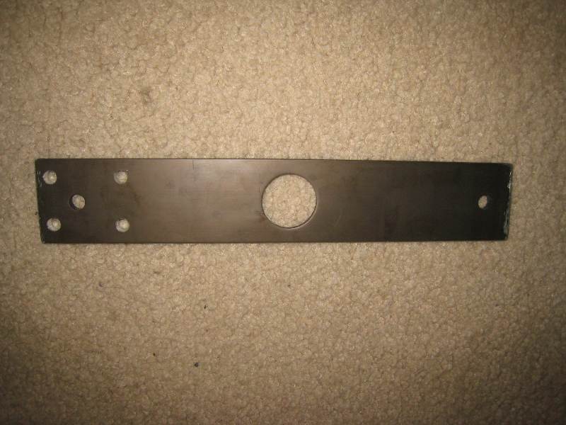

Thanks Kerry. Working on getting steering in right now. Have made three templates for hub mount holes, next one should peg it.
Now's not a good time to discuss toy stuff. Wife works for the state and the gov has proposed furloughs of a day/week until the legislature adopts a budget. That could be a while, and we would be looking at a substantial hit. Think I'll make do for now!

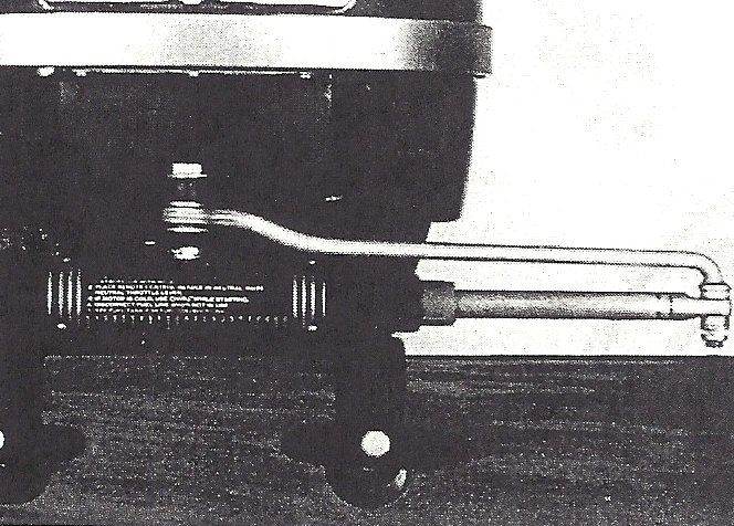

Re:Progress on my Power Cat 14T 16 years 5 months ago #6243

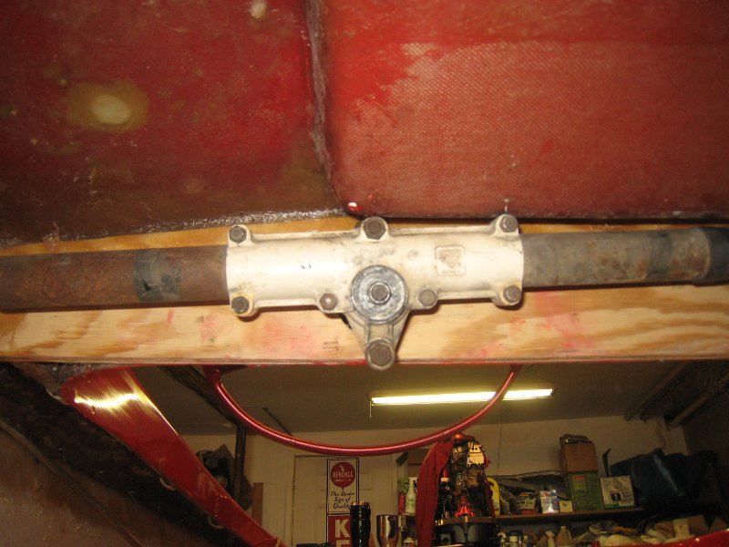

Steering is in the dash, but I can't find the connector for the steering cable to the motor. Grrrrr!
Oh well, controls next.
Frank

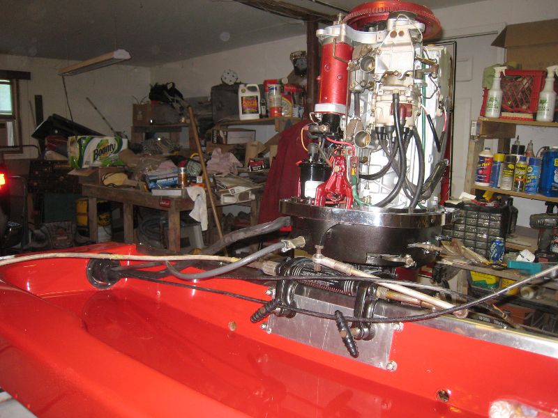

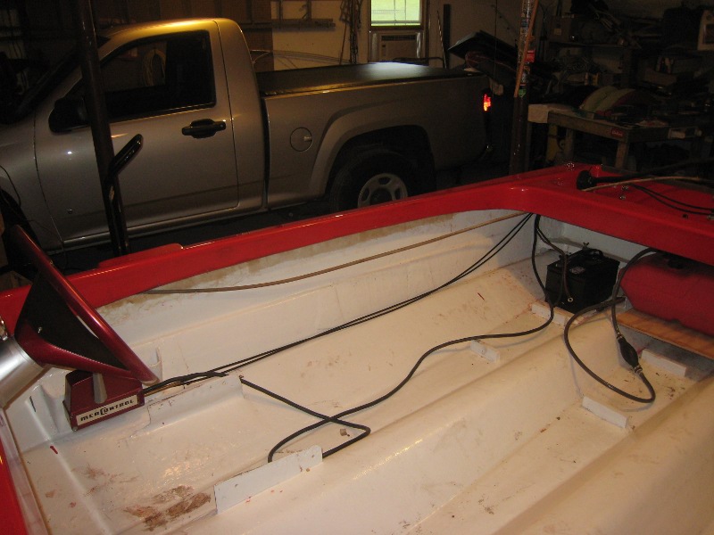

Re:Progress on my Power Cat 14T 16 years 5 months ago #6264

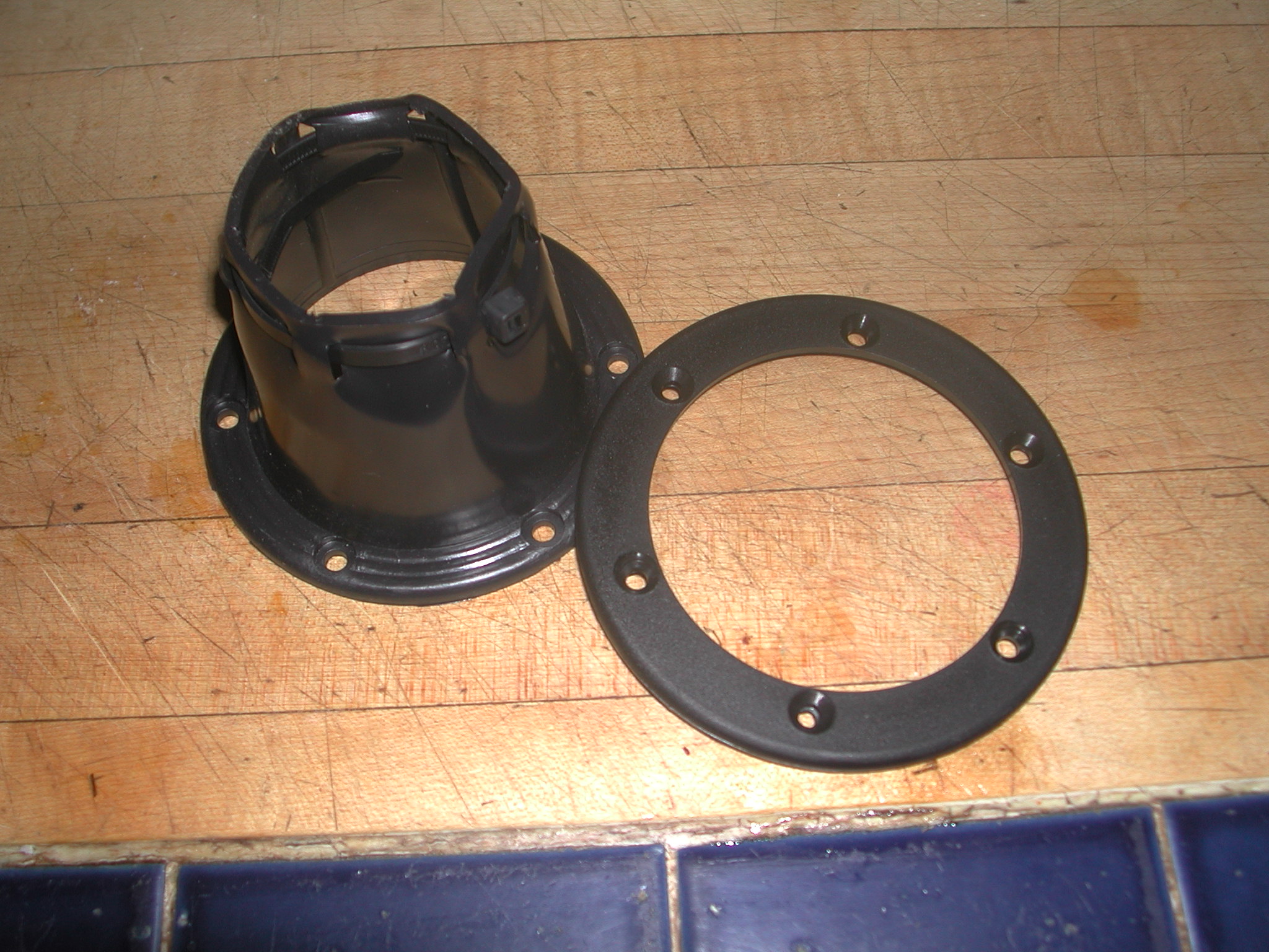

Got a hole in the splashpan, power, cables and gas coming through a grommet, steering hooked up. Need to make another hole for the steering, connect the control cables, adjust the steering wheel, lot of little details around the rest of the boat. Got a lot done today.

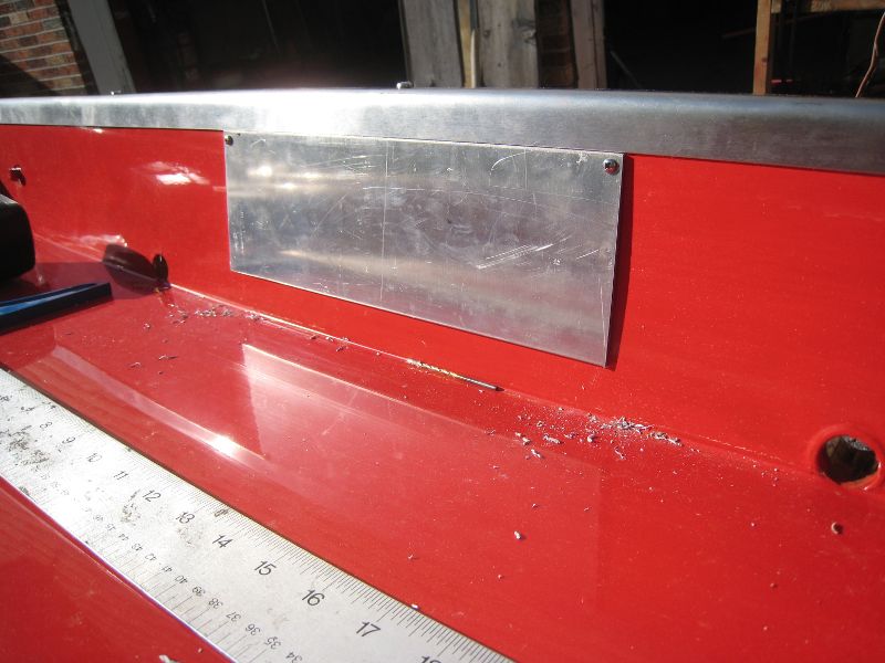

Thanks Doug. It was a virtual whirlwind of activity from 5 Friday night to 5 Sunday night. It took me the better part of an hour last night just to gather tools, put them away, and clean up a bit. I intended to start the motor on the boat last night, but I'd had enough, plus it was ear muff cold here. Was even thinking about dropping it in the Hudson just for a few pics, but too cold and windy, and me with no fenders and brand new shiny rub rail.
Speaking of rub rail, one of the things I haven't done yet is clean up the rub rail that goes around the inside. I have a few other things to sand - the badly pitted metal that surrounds the step plates, and my Power Cat logos. More stuff to bolt on!
Going to be gone next weekend, but I think I can have her done by June. Really the last big job is installing the PT&T.
