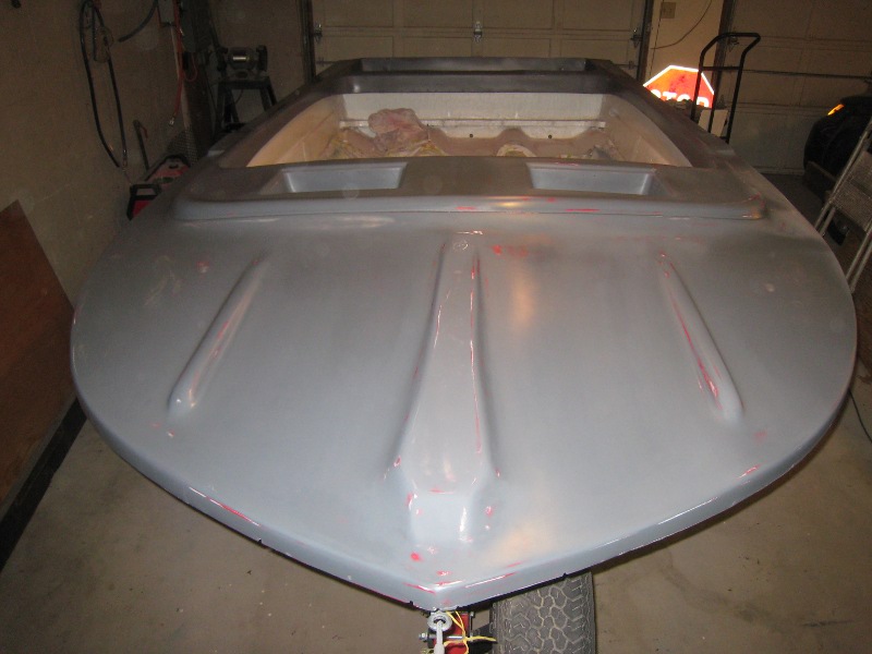

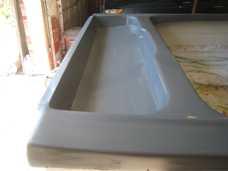

On top of fitment problems Mark, all the primer is screwed up, needs to be completely sanded down, maybe worse (i.e., more fill). Guess I'll go out and see how long my shoulders can take sanding this a.m.
Just got the pt&t back together, new "down" solenoid, everything works the way it's supposed to now. Just need a boat to hang it on.

What kind of primer did you use on the deck Frank?
It's possible that if you used a sanding type sealer,(more porous) that you will not need to sand it all off. Try leaving it out in the sun for a while and see if it dries out. I believe there may be a way to test if is still adhered properly. Maybe a tape test?
Would like to hear from a paint expert on this.
Of course if it is a sealing type primer and water got under it then it has to come off.
Dave in sunny Buffalo
Re:Progress on my Power Cat 14T 16 years 6 months ago #3744
Interlux Pre-kote, grey, single stage. That's about all I can tell ya Dave.
I set it out yesterday to dry, but left it out overnight. It dried quickly this morning, so I lightly sanded it with 120 all over, but where it bubbled left spots of depression under the bubbles. I wanted to do a bit more fill anyway, so sanded those areas to 80 grit, then discovered the only fill I had was no good. So I'm on my way to get a quart.
If I can get this think done today, maybe I'll brush another coat of primer on it later today, then maybe a finish coat or two tomorrow. Problem is I can't have it taking up my garage anymore, so it needs some sort of topcoat so it can sit outside. Only problem is I have to get Gail or Gregg to do the painting - I can't. This of course means I won't be spray painting it, which was my desire. Not enough time.

Sorry to hear about the bubbles.
Off the top of my head I'd be suspecting one of two culprits.
Temps or humidity were off when you applied it or impurities on the deck.
If the latter you might have problems down the road with the rest of it bubbling off.

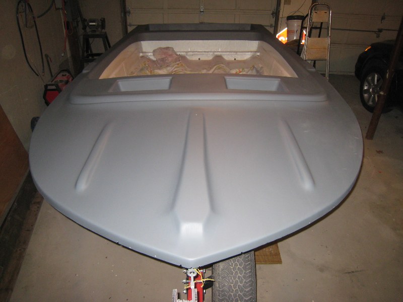

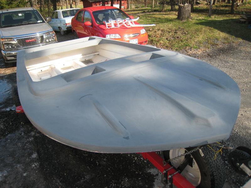

Primed the deck 16 years 6 months ago #3803
Came out okay. I'll take a look at her when she dries, see if I can sand off the runs and drips, then maybe do another coat.

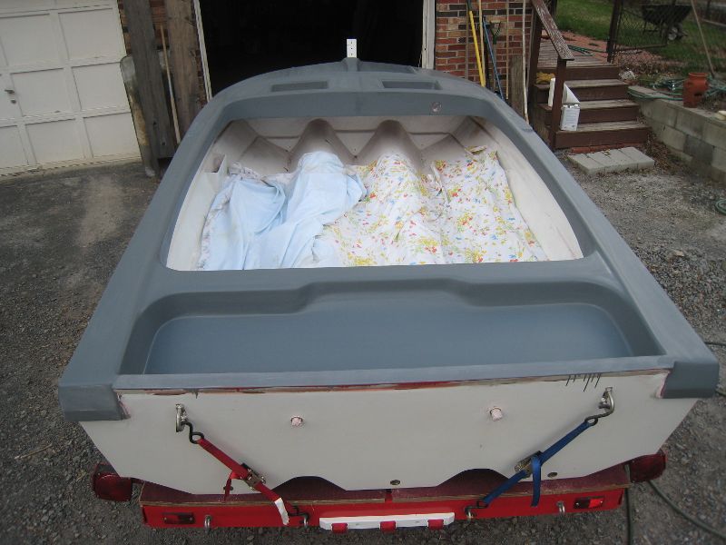

Re:Progress on my Power Cat 14T 16 years 6 months ago #3816
No Heather, this is NOT gonna be easy. Realize I have never done anything like this before, and as a result, made two bad rub rail errors.
First, I rebuilt the damaged starboard bow on the hull, then the deck, and when I put them together, they hardly fit. Too tight, and the deck does not seem to want to come down enough. I think I can force it, but I can't get the "j" part of the rub rail up and attached to the deck lip because the deck and hull are so tight over about 20".
Second, I repaired a number of cracks on the deck lip (mostly where the rub rail have rivet holes) by glassing the back, then filling the front. All those repairs are now too thick for the "j" part of the rub rail to fit under.
I decided to go ahead and get the deck painted anyways, hoping solutions to these problems will present themselves before I start trying to put new rub rail on.

Another coat of primer 16 years 6 months ago #3868
Did it outside this afternoon with a drip & run checker (my oldest son). Lot easier to do this stuff in the daylight then in my garage! She's coming along, but I still don't know how I'm going to get the rub rail on her.

Re:Progress on my Power Cat 14T 16 years 6 months ago #4108
After a crazy week of not being able to get at the deck, I got it sanded baby cheek smooth over the last couple of days, cleaned real well this a.m., and ready for another coat of primer once I get home today.

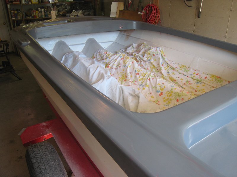

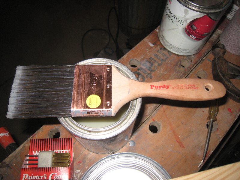

Two more coats of primer 16 years 6 months ago #4226
These pics are all going to look the same as the other ones, but suffice it to say she's coming out good. I'm hoping after wet sanding later today that this is it for primer. If I sand into through the primer in any spots, I will just touch them up and be done with it. I need to move on!
I had small bubbles all over the second coat. I don't know if it's because I didn't wait long enough after the earlier coat (28 hours) or if it was too cold (50-55 degrees), but they seem to be just in the surface coat. You can see in the first pic on the port side of the bow where I played with a few of them with my fingernail.
I used a different technique here for these two coats. First I wiped the deck down with Interlux Brushing Liquid (333) hours before priming. Then I mixed my primer with 10% 333 to thin it out. I used a high quality Purdy brush to prime it.
Mixing the 333 into the primer is simply easier that wiping 333 with your left hand, then priming over it with your right (or vice versa depending on what hand you are). Some of it for me is just physical - I'm having problems with my left shoulder.
I found the bristle type brush to handle inside and outside corners better than the foam brushes I had been using. Much less fooling around with catching an edge of paint on the inside and outside corners, which seemed to be a major problem with foam brushing.
I'd like to thank those of you who have offered specific suggestions and assistance. I really appreciate it.

Wet sanded 16 years 6 months ago #4241
Spent about 3 hours wet sanding with 320. Need to touch up a few spots with primer, lightly wet sand them, then lightly wet sand everything to 400. Need to move ahead to top coat.

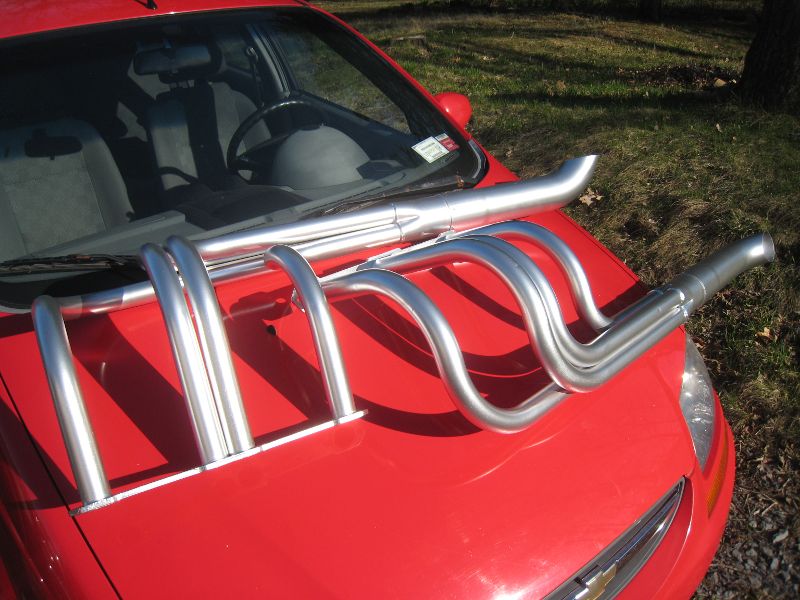

I don't mean to be critical, but those headers on the hood of your wife's car are supposed to go UNDER the hood buddy! LOL Just kidding, I know you've gotta be beat down tired and sore. Hope you have a great evening. ;)

Those headers came of my hot rod this morning Mark, got sanded, cleaned and 3 coats of high heat silver, same stuff that's on the powerhead of my '63 Merc 1000. And that is NOT my wife's car, that is my old dead Aveo. Long story.
I had a full day, and Mark is correct - I AM beat down and sore. Primer touch up is waiting for tomorrow. No way I could do it tonight.

I figured the headers went on the hot rod, they look good bud! We used to use VHT, and for the first fire up just run the motor until you smell paint, then shut her off and let 'em cool. The heat cycle seemed to help "cure" the paint so it would last longer. I'm sure you already knew that.

I'm curing the headers for 7 days (per the can's instructions) before I install them Mark. If I had time yesterday I would have put them back on and done what you suggested, but there just wasn't time, plus I don't have my new gaskets yet.

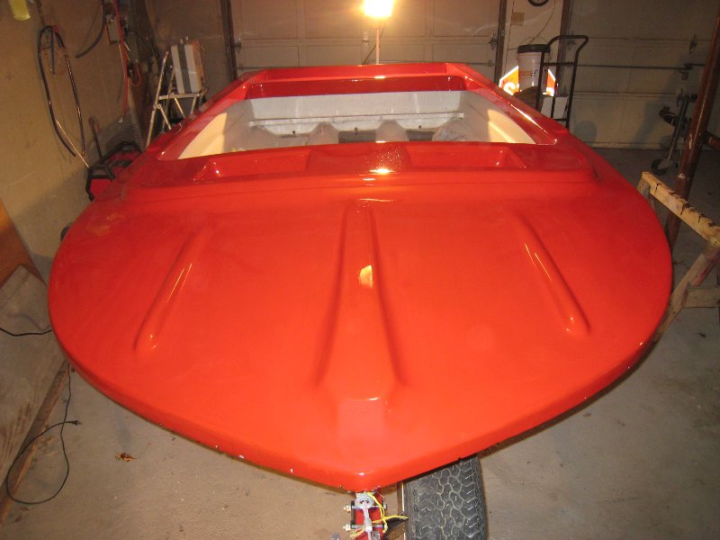

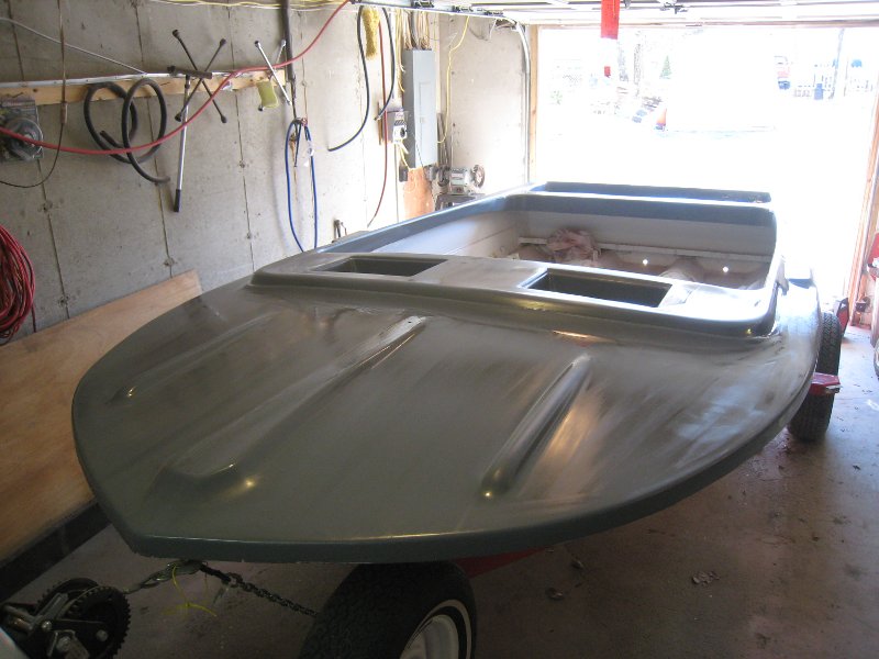

1st coat of topcoat 16 years 6 months ago #4511
For what it's worth. It's maybe 55 in my garage. Hope I can wet sand it with 320 tomorrow afternoon and do a 2nd coat. Took just under 200ml of paint, thinned 5%.

Re:1st coat of topcoat 16 years 6 months ago #4533
Great Frank! The principle is the same brush or spray, don't over criticize. Sand LIGHTLY just to scuff, not to remove flaws like brushmarks. After you have the paint thick enough to 'color sand', then work on brushmarks and flaws. DON'T SAND THROUGH! Better a small flaw than more coats more sanding more coats more sanding....
If you use 320 go real easy, I'd prolly use 400 and I'd still be nervous....

Bernie, I got 400 and finer sandpaper, so I'll do that. I was going to sand to remove brush marks, and will not do that now. Thanks for the tips.

My theory is you only want to create micro scratches for the next coat to 'bite' in to. Kinda like 'breaking the glaze' when honing cylinders. Build it up thick enough with subsequent coats that you can sand the LAST coat smooth without sanding through.

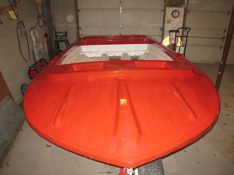

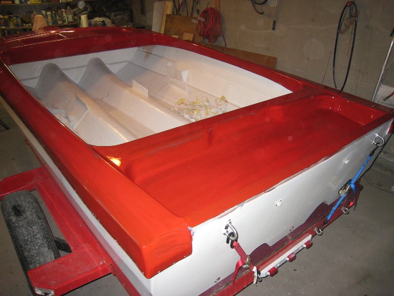

2nd coat topcoat 16 years 5 months ago #4607
All I can say is I wish I would have stayed with the Rustoleum marine enamel. It went on much better than this Interlux stuff does, no matter what I do. Plus I think I will continue to have compatibility problems from switching paint types. No turning back now. I just hope it works out.

Re:2nd coat topcoat 16 years 5 months ago #4608
F - It looks great from here. Let the marine paint guys paint your boat, not the metal paint guys. I sure wish you didn't stress so much about something you've done a really nice job on. The only person you need to please is you. Although Rustoleum was half the price of Interlux, you get what you pay for. I am, always will be, an Interlux fan. B
Re:Progress on my Power Cat 14T 16 years 5 months ago #4609
Well Brian, if I got what I paid for, the Interlux would be 1/2 the price of the Rustoleum. Both the Interlux primer and topcoat have produced lots of air bubbles all over that I did not have with the Rustoleum marine enamel. I tried everything I could to get rid of the bubbles (wiping 333 on, using foam brushes, then using good bristle brushes, mixing 333 with the paint, etc.), but no luck. If it's from a compatibility problem, more reason I never should have used it. By the way, the Rustoleum marine enamel is for fiberglass boats.
I understand you're a big fan of Interlux, but my only error with the Rustoleum marine enamel was not sanding between coats. If I ever "do" another boat, you can bet it will not be with Interlux (at least the Brightsides stuff), and you can bet I will NOT change paint systems in the middle of a job. The stress at this point is doing something over that may or may not work out. We'll see.
Frank
Re:Progress on my Power Cat 14T 16 years 5 months ago #4610
Well F, sorry for all the problems you're having. I suspect you're right about the switching horses in mid-stream. I can't even remember why you changed paints it's been so long. Why did you change from Rustoleum to Brightsides? Every one of us that works on these things likes what we like. Sort of like Ford or Chevy. Again, I hope it works out for you. B
