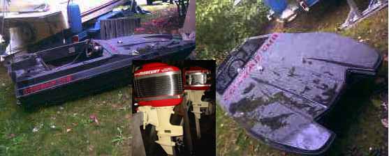

BUGS , jeesh Frank again I feel your pain I just looked the the racer I painted and there is one of my hairs in the paint unfortunately its 2 ft long :S , so I had to wet sand it out and break out the heaters again to clear it
I didnt get that cat I was hoping to replace the smaller hydro I sold but did make arrangements to buy this 105ft Cougar Cub...just waiting on the seller to get me some papers together to pickup
I have a MK30H or a MK58H to push this little thing fast enough till its scares me
as of now Im going to sell the racer before I screwup the new paint to buy something else, but I will wait till the deal materializes before I say anything, funny how things can change in a day
I like red boats Frank , looks good

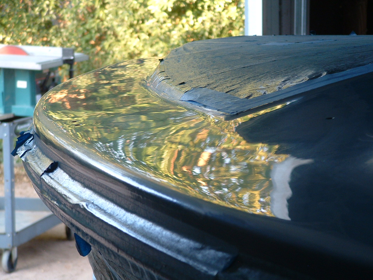

Little bit of wet sanding this morning, just the bow. (Unfortunately, I got to get to work.) Not too bad, still got a few areas to smooth out, and of course inside and outside edges fade to gray first. That center peak down the middle of the bow is a bit lower in the middle than the sides. Soon as I realized what I was doing, I changed technique and just sanded the middle.
Probably won't get back at it till tomorrow a.m., then hopefully finish tomorrow night and get ready for coat #4.

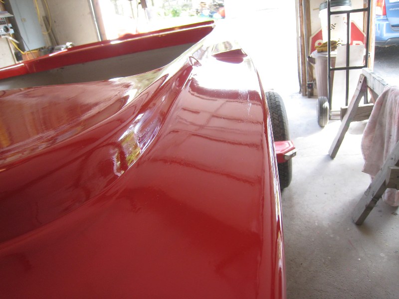

Wet sand, then 4th coat 16 years 6 months ago #5179
Maybe get this done by the end of the month? Doesn't look good from my perspective, but who knows? It is what it is.
Frank

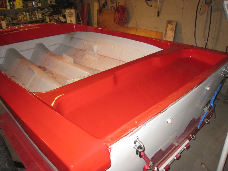

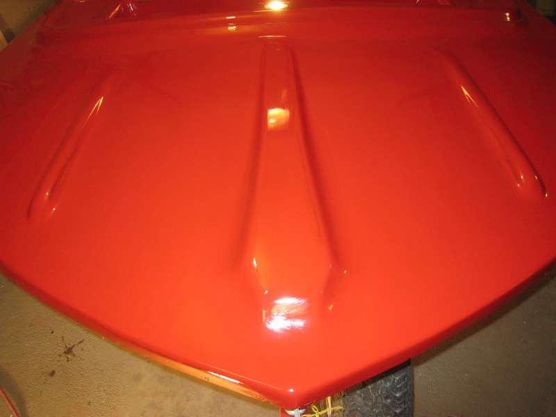

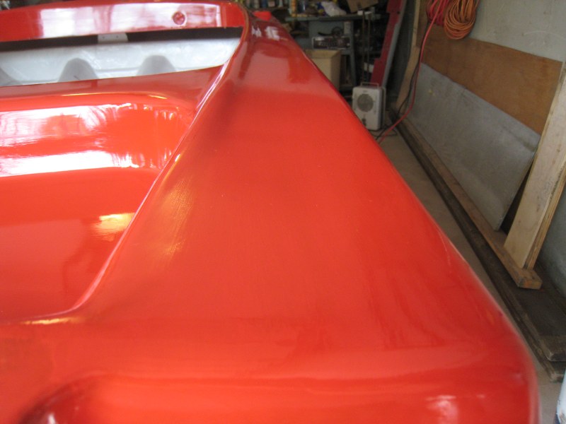

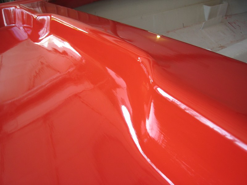

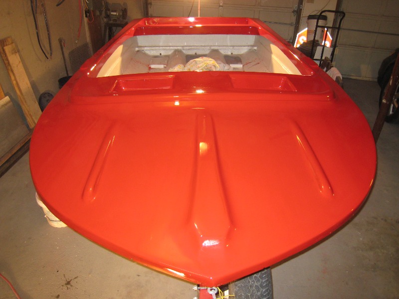

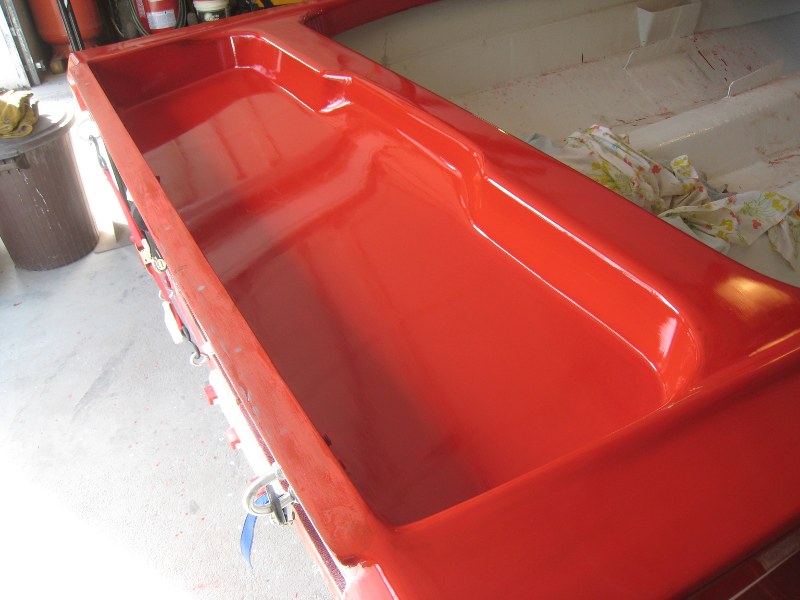

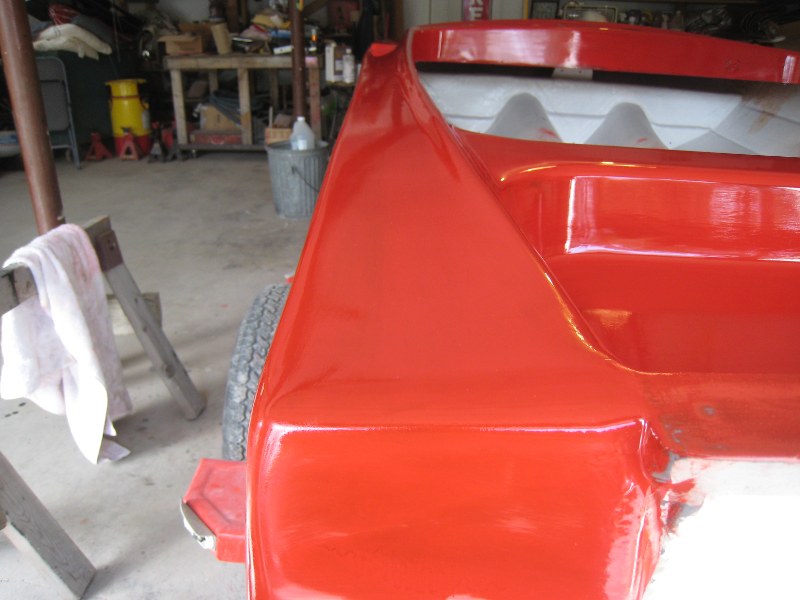

More pics from today 16 years 6 months ago #5184
Re:More pics from today 16 years 6 months ago #5185
  • g3jim
  • g3jim's Avatar
  • Posts: 1009
  • Karma: -27
we are all are own worse critics Frank. I think the boat looks great. Looked great when I seen it up close...looks great now. The beauty is it is yours. each year when you pull it out you can primp her up as much as you like. Get it done and go for a ride.
My father in law is back in the hospital. Been interesting the last couple days. At least foe being in the past 7 months he got to come home for a day.
I have a set of trim rams coming to you.
Finish the boat and work the details over time. You have earned the buzz of going for a rip in the Cat. Put that M1K on her and go!!
Re:Progress on my Power Cat 14T 16 years 6 months ago #5186
  • Bigfoot

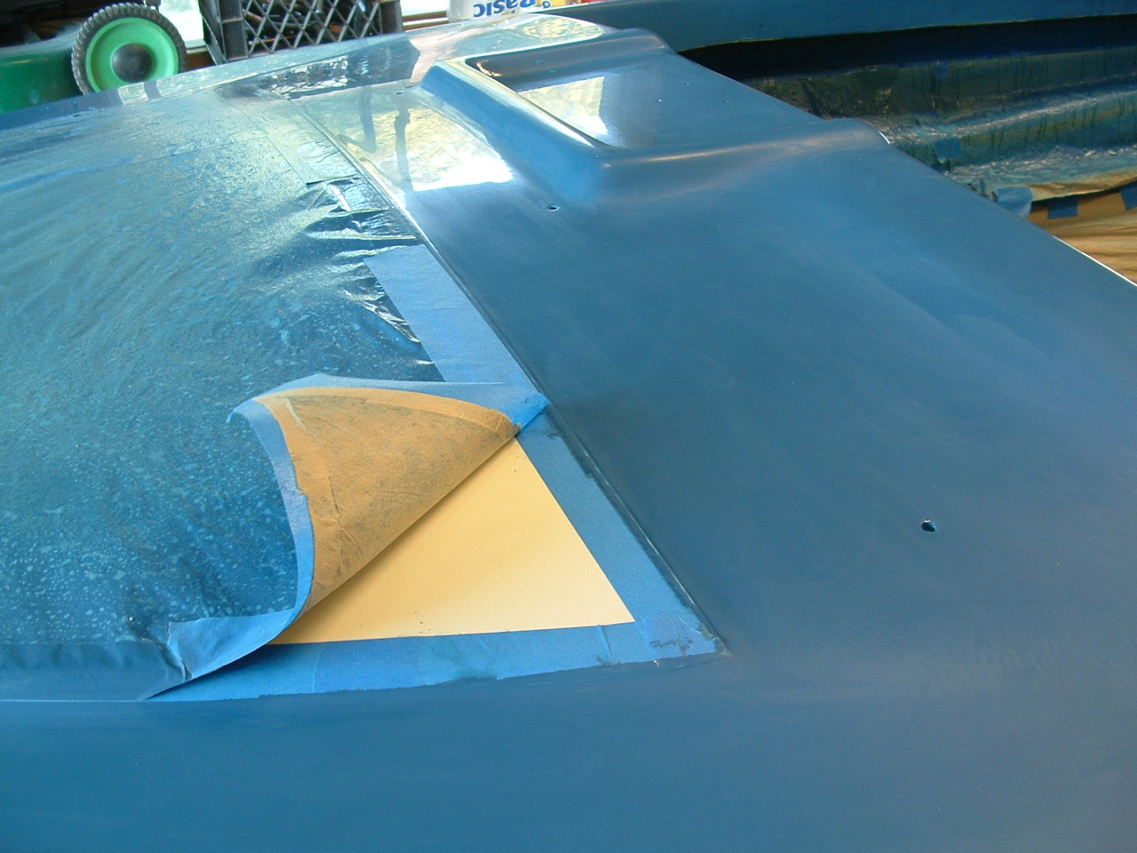

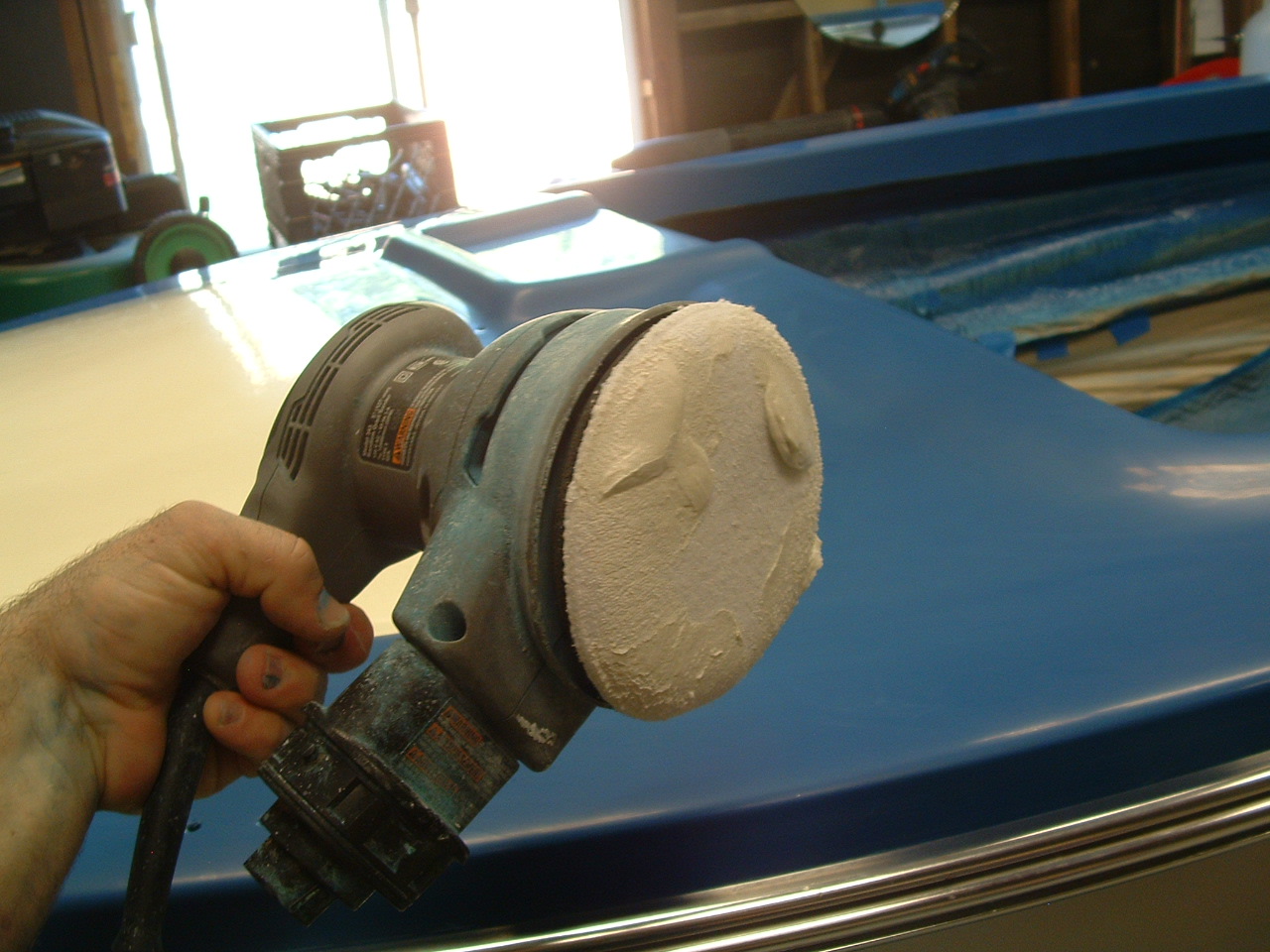

Looks great Frank. Check out this paint job I did last summer on my sea swirl p14 using rustoleum oil based paint,I did a full resto, my first, Mike
Re:Progress on my Power Cat 14T 16 years 6 months ago #5188

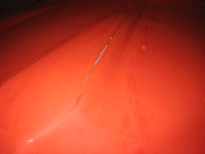

In the words of Mozart..."There it is!" Have been at it all day. It's all good, and as noted, we are our own worst critics. For me, I'm moving on. I have two approaching the finish line after almost 2 years. But, I ran the Missile today, and the Earth shook.
Re:Progress on my Power Cat 14T 16 years 6 months ago #5189
Shoot Frank.. I think it looks good. the more you use it, the more you polish it, the better it'll look. You'll also be amazed at how much better it will look once you get everything bolted on it. 9 times out of 10 anything you see that sticks out like a sore thumb to you is NEVER noticed by onlookers.
Re:Progress on my Power Cat 14T 16 years 6 months ago #5190
I was thinking eggsackly that ("Get it done and go for a ride.") when I was taking those detail pics after she was dry to the touch Jim. I could live with this boat looking like it is right now. Trouble is I don't have complete coverage yet, but it's coming. I'll wet sand her in the a.m. with 400 grit, wipe her down and do another coat. I may start glassing the inside deck/hull seam tomorrow once she's painted too. I've decided to glass the seam 1st, then install the rub rail. Takes me a while, but sooner or later I figure things out. Once the paint is done and that seam sealed, I'm mounting the M1k and PT&T. I'm still pretty much on schedule. I am glad I took the time earlier this year to do a bit more body work. I wouldn't have been happy if I didn't.
Thanks for shooting those rams over. It is MUCH appreciated. Sorry to hear about your father-in-law Jim. Tough deal. Good luck!
Boy Mike that Sea Swirl look fabulous! I wish I had never switched systems, as that was the first stuff I used, but dummy I am, I did not sand between coats, and then I switched systems, and am not sure even now that this is going to work out (compatibility issues - enamel vs. polyurethane). It looks like it will, but it ain't over till the fat lady sings.
I still need coverage Doug. It's almost there, but not quite. I have a number of small areas that just aren't red yet. Gotta get 'r dun.
Thanks guys!
Frank
Re:Progress on my Power Cat 14T 16 years 6 months ago #5194
  • Bigfoot
  • Bigfoot's Avatar
  • Posts: 282
  • Karma: 22
After 2 thin coats wet sand with 400 then 2 more coats and wet sand 600. Now maybe youll have full coverage. 2 more coats then 1000 2 more coats then 1500 then polish with turtle wax polishing compound. Place tape on edges as not to burn the not fully cured paint and be on your way, Wax after a few weeks.
You can paint in the morning wetsand in the evening then paint after its dried. Place 2 nd coat in the eairley morning and wet sand in the evening
Auto zone has the best wet sand paper, Mike
Re:Progress on my Power Cat 14T 16 years 6 months ago #5195
Thnaks for the tips Mike.
This Interlux polyurethane paint I'm using says sand after 16 hours at 75 degrees. I've got my garage close to 75, usually above 70, but drop some when its cold. I've painted and sanded this deck so many times it's not funny! As a result I don't want to screw anything up worse than I've already done. This has NOT been fun, no matter how good it looks.
I did the hull in a similar way, but used the same product from beginning to end. I wet sanded that to 1200 and polished it with 3M compound. Came out real shiny. Right now it's filthy.
Maybe I'll give your method a try tomorrow.
Frank

Alright Frank, you've had a 10 hour break, let's get that final coat of red paint on and get this show (boat) on the road (river)! ;)
Re:Progress on my Power Cat 14T 16 years 6 months ago #5214
I'm wet sanding Mark, since 6:30 I've got the bow done. Of course, in between I had breakfast and spent 15 minutes or so reading the Sunday paper.
I don't think I can follow Mike's suggestion. Takes me seemingly forever to wet sand. Can't wait to get another coat on sometime today, then I can start wet sanding tomorrow morning before work, then after work, and maybe get another coat on late Monday night, maybe Tuesday night.
