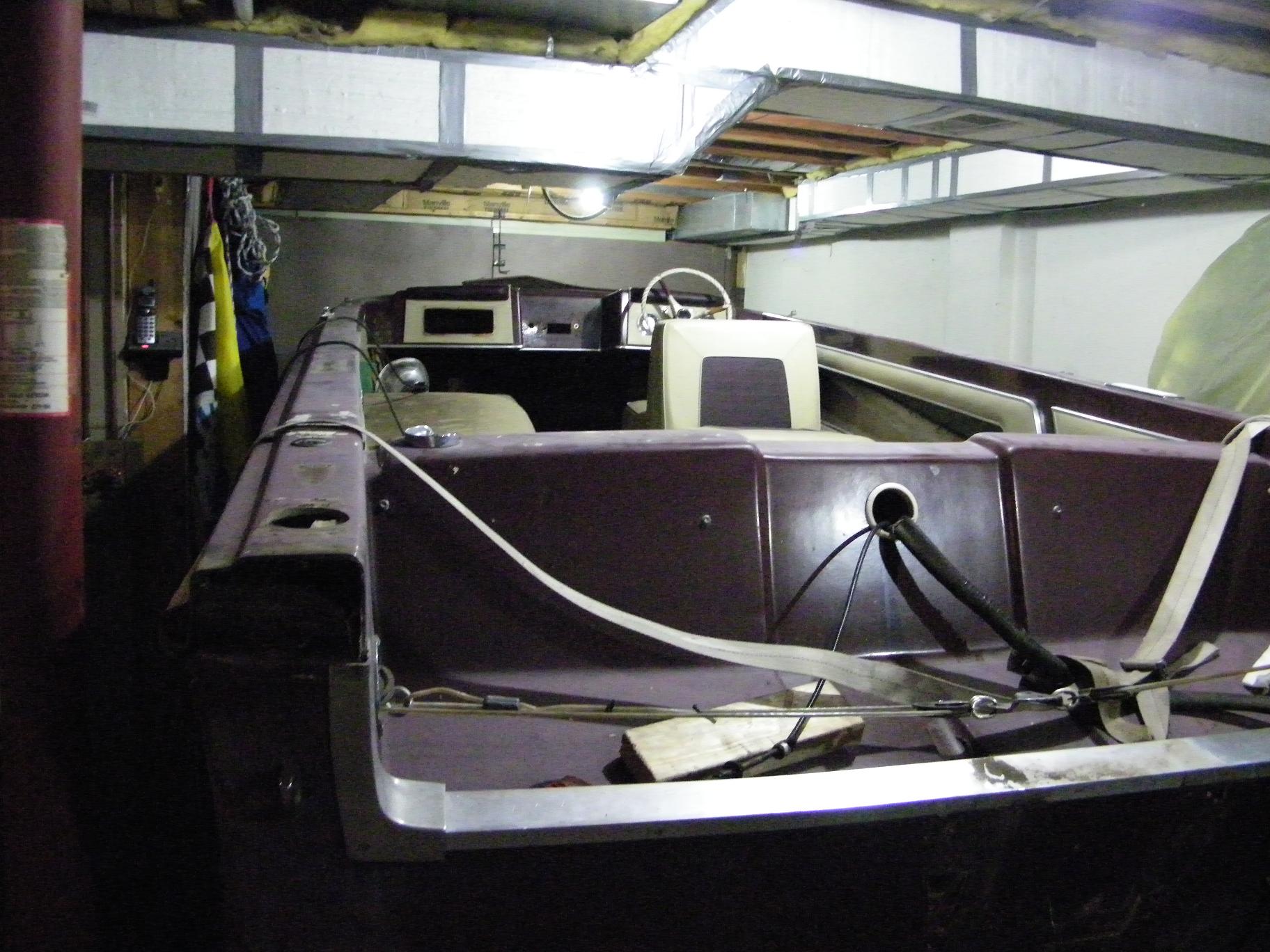

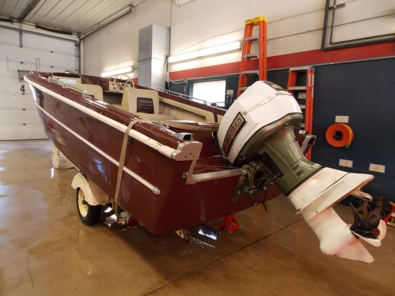

A new project is about to begin.
I think it is a 1966? 17 footer. Shell Lake Sunliner, the numbers stamped on an aluminum tag on the inside transom are 1766 db 1037.

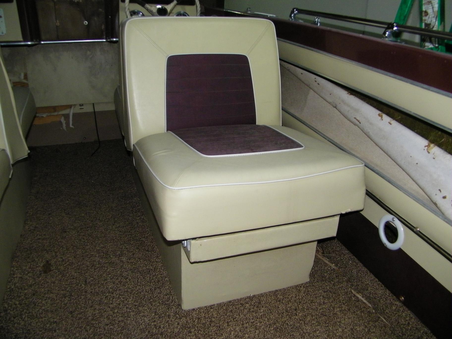

The interior is original with good looking seats but the material is stiff and easily cracked so it will be trashed.
It has been stored inside and last registered I believe in 1978 but layed up in '98.
The brightwork is in exceptional good condition, no pitting and really heavy chrome plated stuff, nothing broken so it will all be re-used.
Hanging on the back is a Johnson Golden Meteor 100 hp.
The hull is heavy gauge glass and really deeeeeep V.
The floor is rock solid but I have not had time to check the transom yet.
The plan is to transform it into a "woodie" using African mahogany for all topsides, deck, seats, dash. I was inspired by Valero's picture.
This will take a long time and play it by ear as I go. Should be interesting.

You're right, it is a big deep water boat. The pictures are deceiving. those seats are about the size of a small living room chairs and cushy(?) and to stand up in it the gunwales are almost waist high.

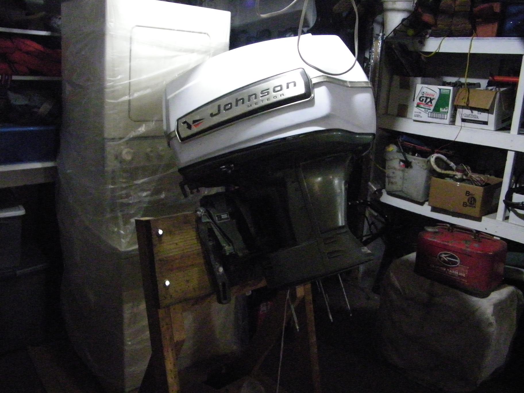

Before I start on the boat I want to make sure the motor is running before I pull it off the transom. Today I dropped the lower unit and removed the water impeller, had a pretty good set to it. Tomorrow I'll jam a water hose up the inlet pipe to flush the water lines and install the new water pump. Fire up the motor and run some seafoam in it to clean up the carbs and cyls.
Might be able to unload the motor sometime this week if all goes as planned.

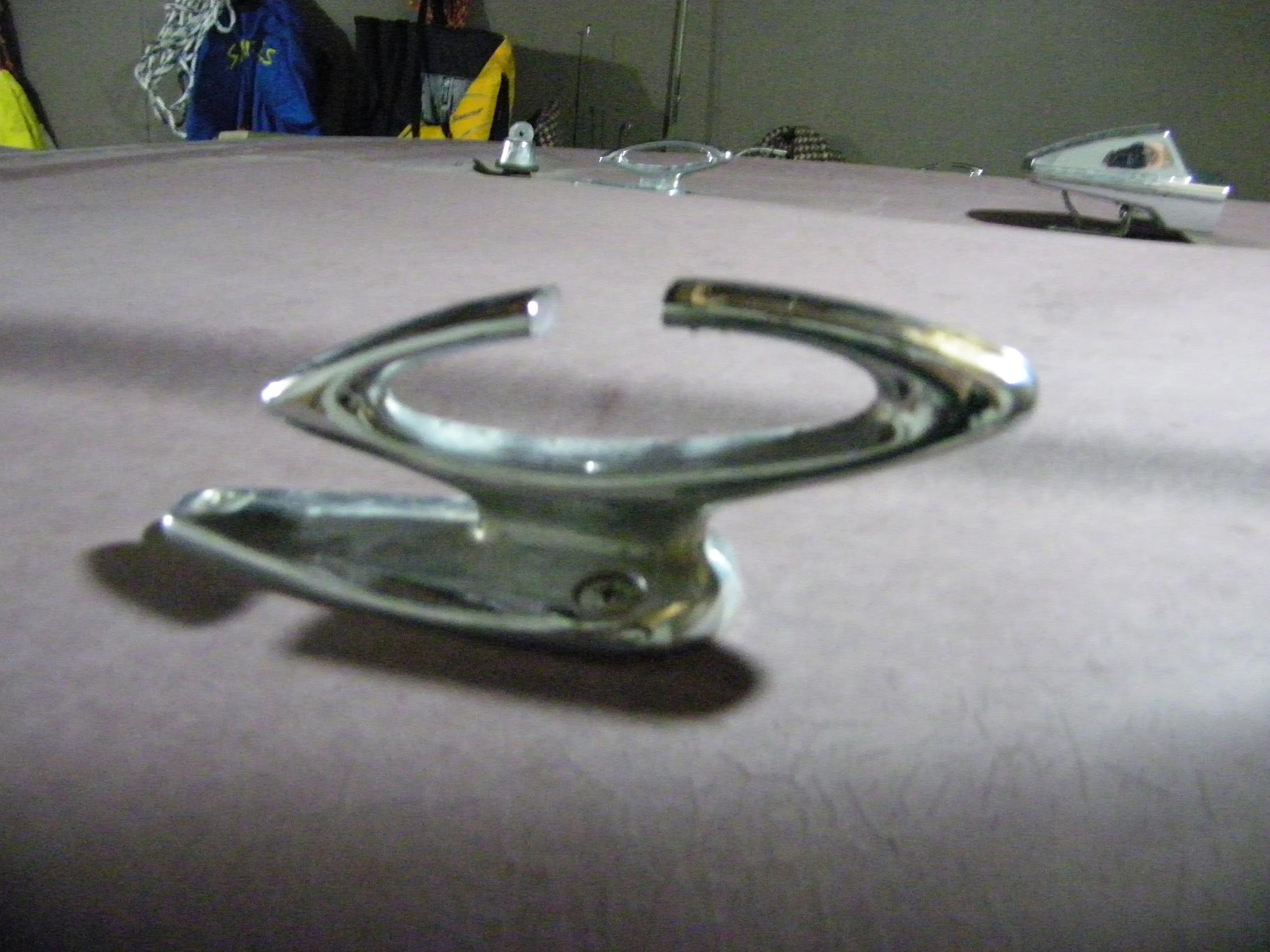

Took some time last night to strip 99% of the brightwork off and box it. Removed the motor (I'm guessing it weighs close to 3 ton)
I also found out where some racoons were holed up. Ask me how I know it was coons? The size of the .....

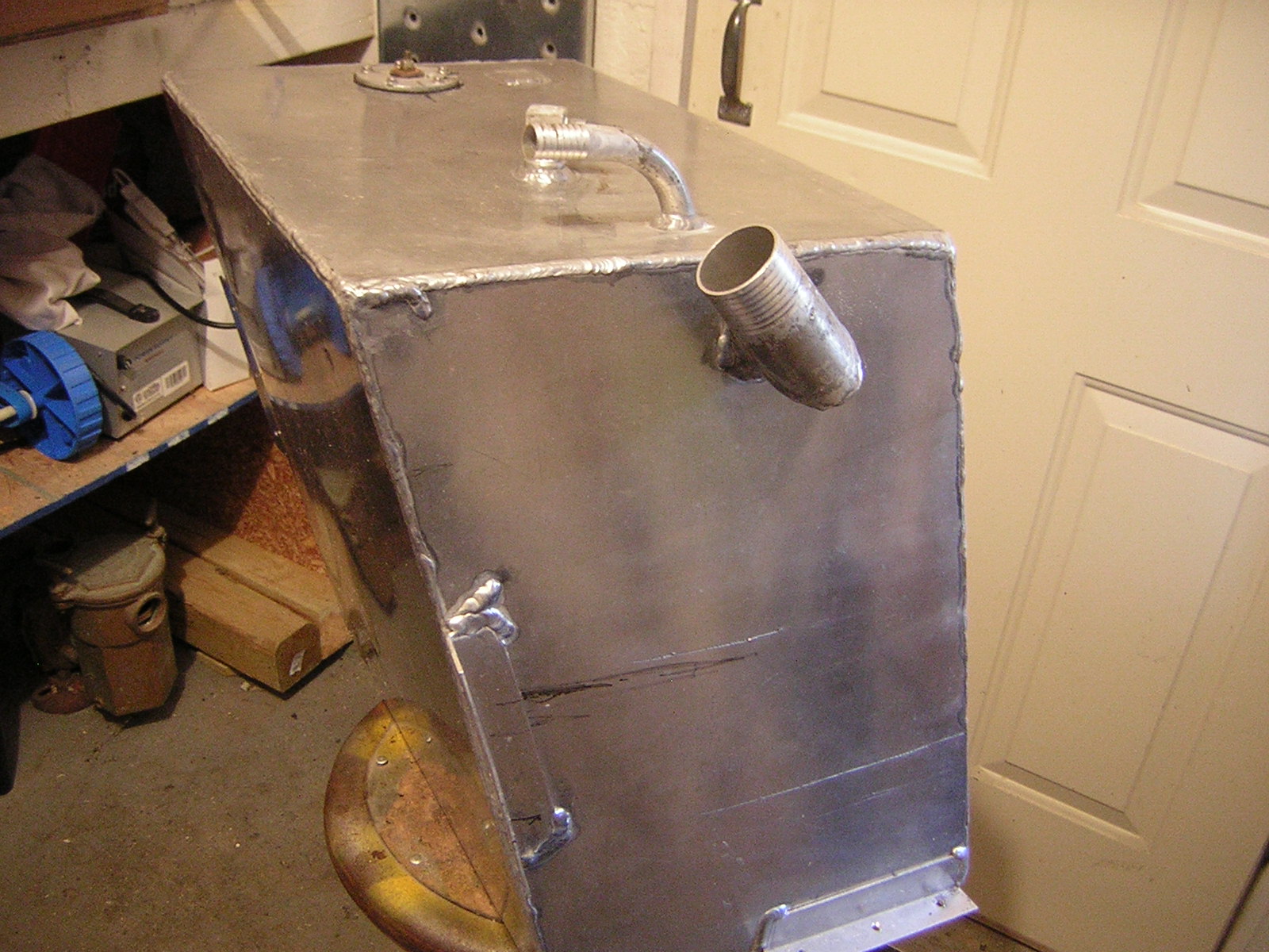

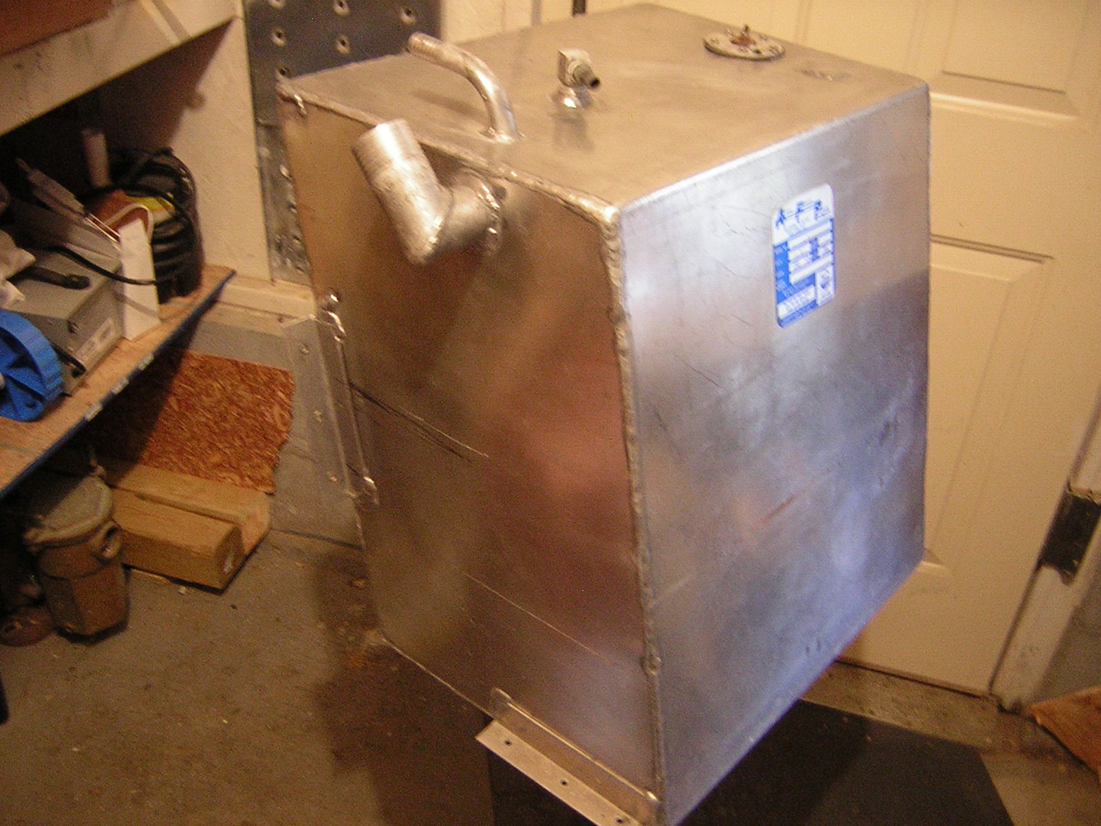

Removed the 18 gallon inboard fuel tank last night, it is steel and rusted quite alot, don't know if it's worth saving or not, smells like a can of varnish.

Skip, I kick myself again, I had an 18 gal aluminum tank this spring that sat around for three years, put it on craigs list and sold it for $85 to a fella that was lake fishing and needed an extra tank. It's a long winter, I'm sure the drive shaft comes out somewhere/somehow, I'll work on it.

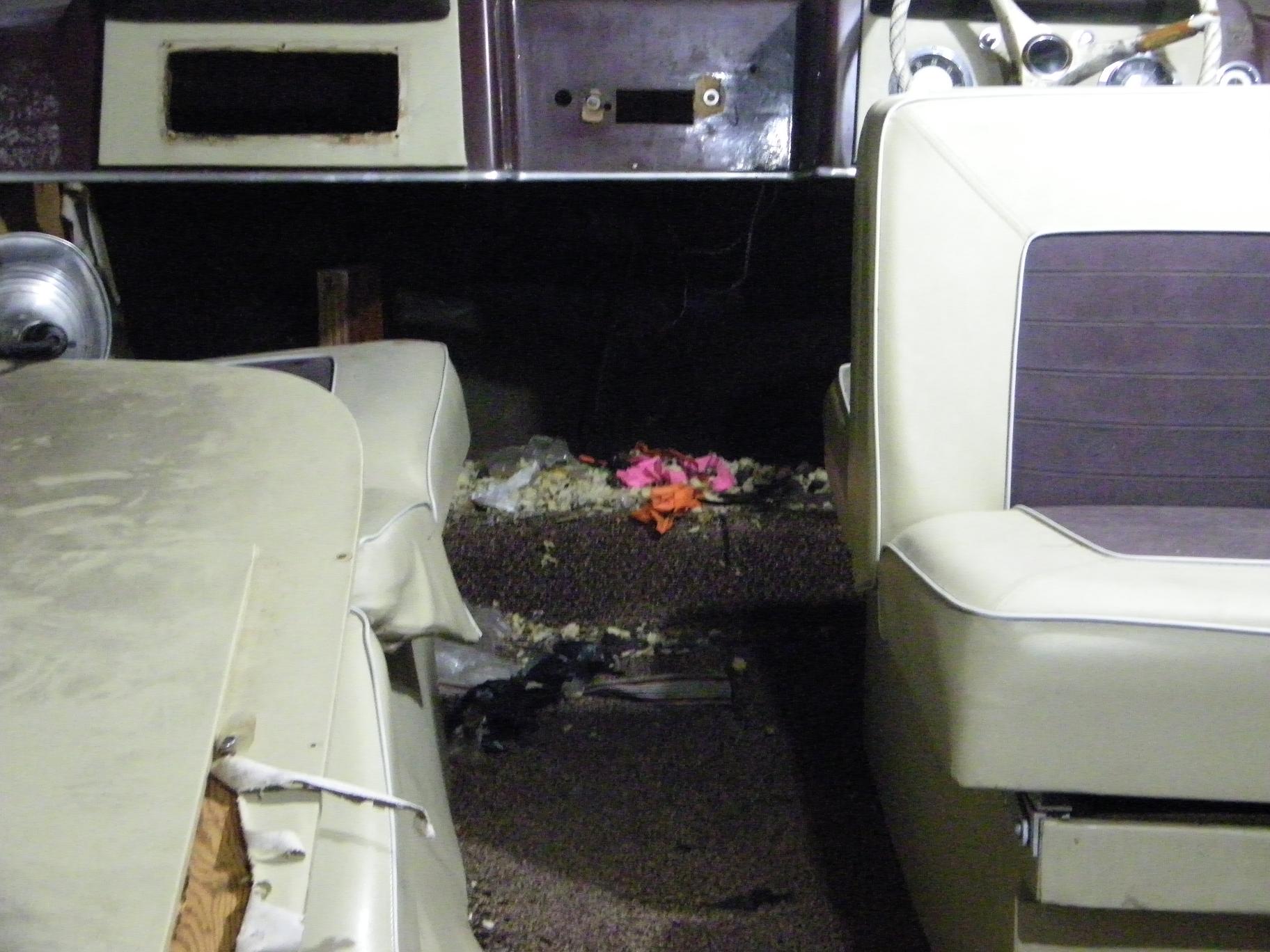

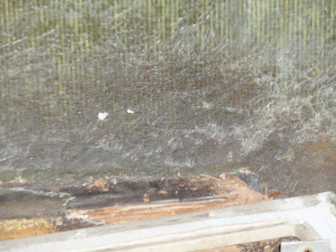

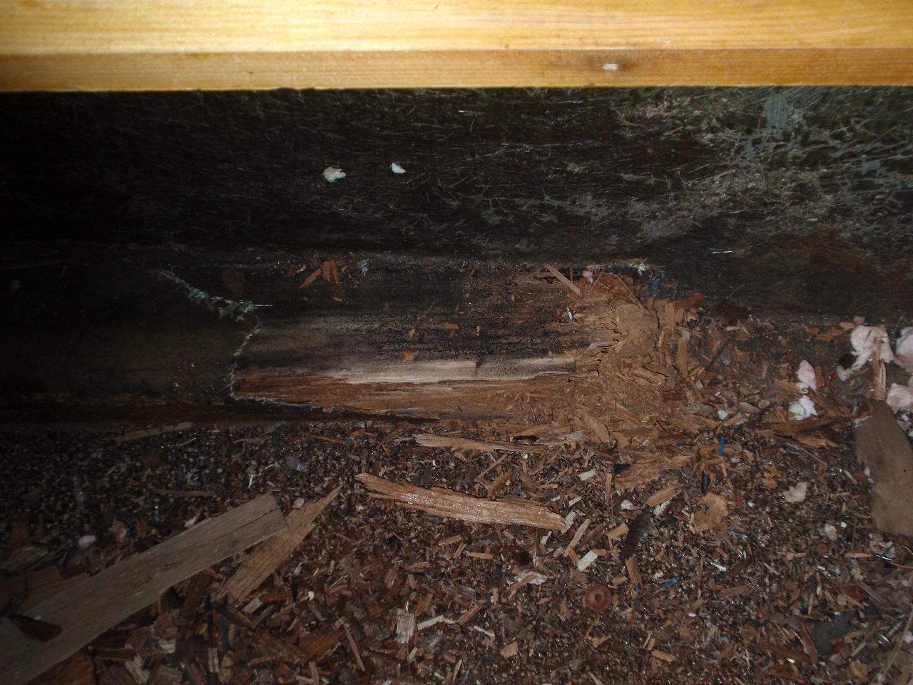

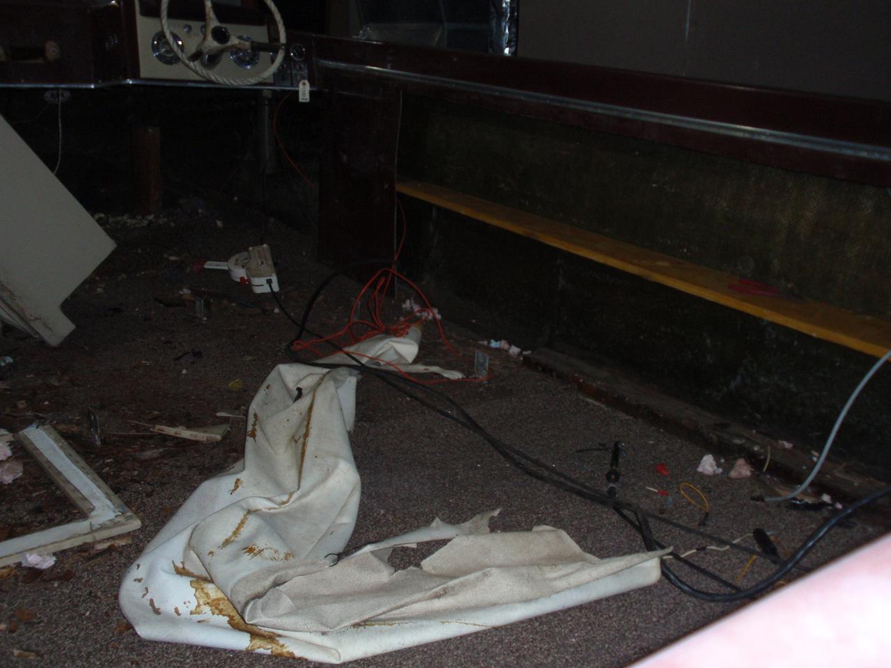

Did some demo on the boat this morning. Pulled out the rotted seats and removed the side panels. Here are some pics, one is a good example of why not to encapsulate wood with glass.
The light colored board is original where the side storage shelf is. The bottom darker part near the floor is a 2x that was glass encapsulated and then the bottom of the side panels were screwed into them which compromised the glass covering,...totaly rotted out.

Next step will be to pull up the carpeting, using the multi tool to cut out the rotten wood and then drill some 3" inspection holes in the deck to see if the rot migrated. The floor seems really tight and solid but we all know how deceiving that can be.

My .02 worth on the fuel tank is to pitch it. I have repleced all of mine due to the same issues that you describe. (Don't ask me how I know! LOL) You never seem to get them clean. Do yourself a favor and have a new one made or buy a portable.

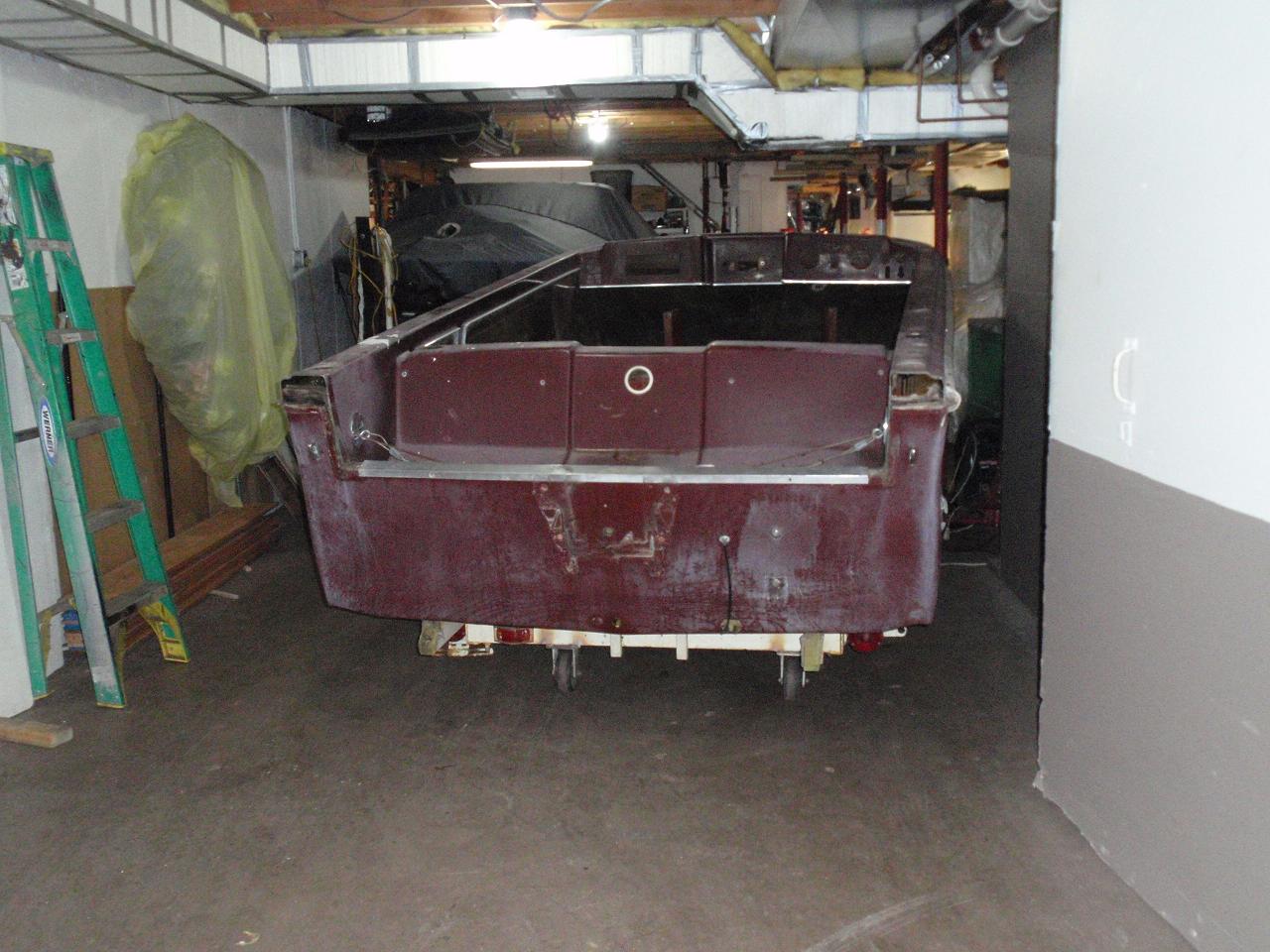

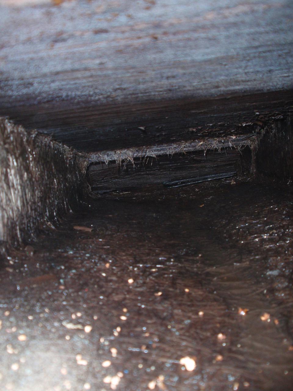

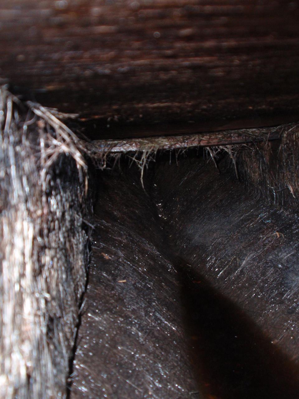

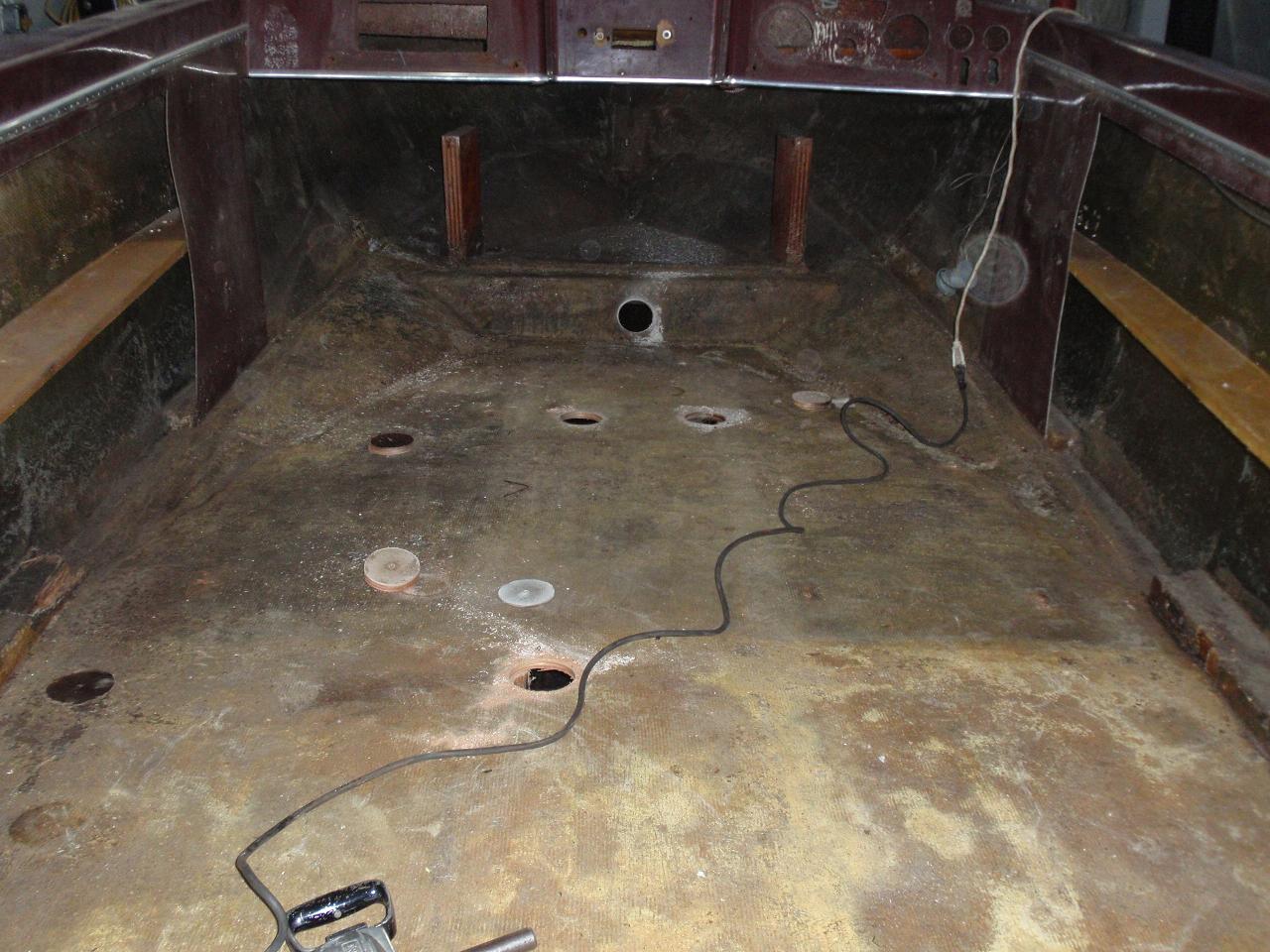

Finally got around to drilling some "exploritory" holes in the floor and was pleasantly surprised. There is no floatation, only sealed voids. One section has maybe about an inch of water sloshing around, the rest of the spaces are dry. I'll shop-vac the water out of the one and dry it out. The stringers are rock solid.
I drilled the holes and put my digital camera in them and clicked away, same way I check my furnace ducts.
This is the poop deck area, the top of the picture is actually the underside of the floor.
Re:Shell Lake Rebuild 14 years 2 weeks ago #70954
Finally got around to drilling some inspection holes in the floor, amazing results. All the stringers are rock solid. There is no floatation foam anywhere only sealed voids. Only one of those areas had about 2 inches of water which I will suck out with the shop vac. I drilled the holes and stuck my digital camera down there and snapped away.
Keep in mind that the top of the picture is actually the underside of the floor.
Here is the underside of the poop deck.
The port mid section leading to the bow where the water was, I suspect from small screw holes that were from seating.
I'm going to open up the aft section to check out the darker area in the far back side, have to use the multi tool saw blade because of the confined access under the motor well.
The camera in the hole is the same way I check my furnace ducts in the fall.

The wood looks great Cal. Underside of the floor looks very good! I think you got a real winner there more time to focus on WHAT you want to do to/with it rather than what you HAVE to do to it. ;)

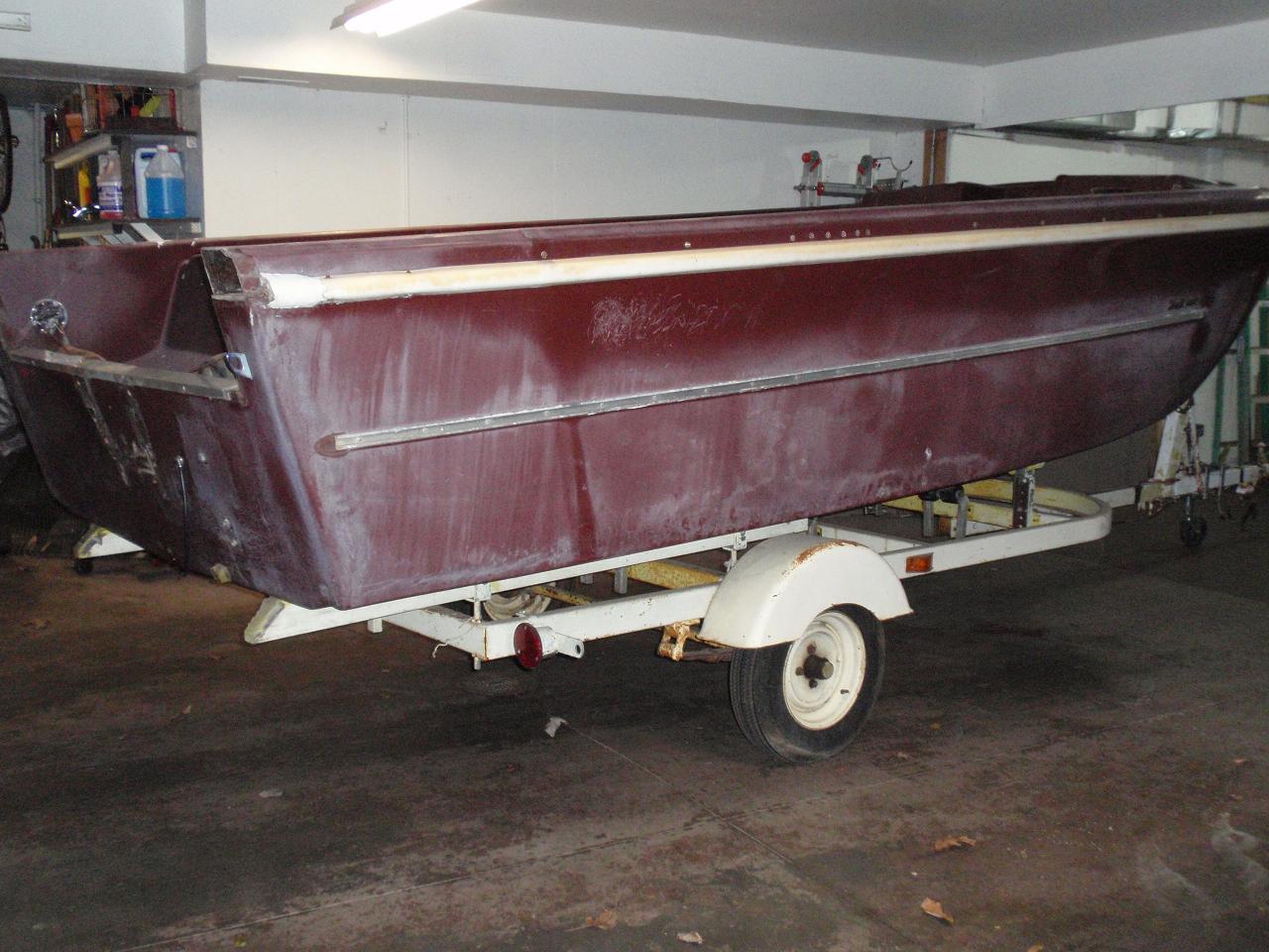

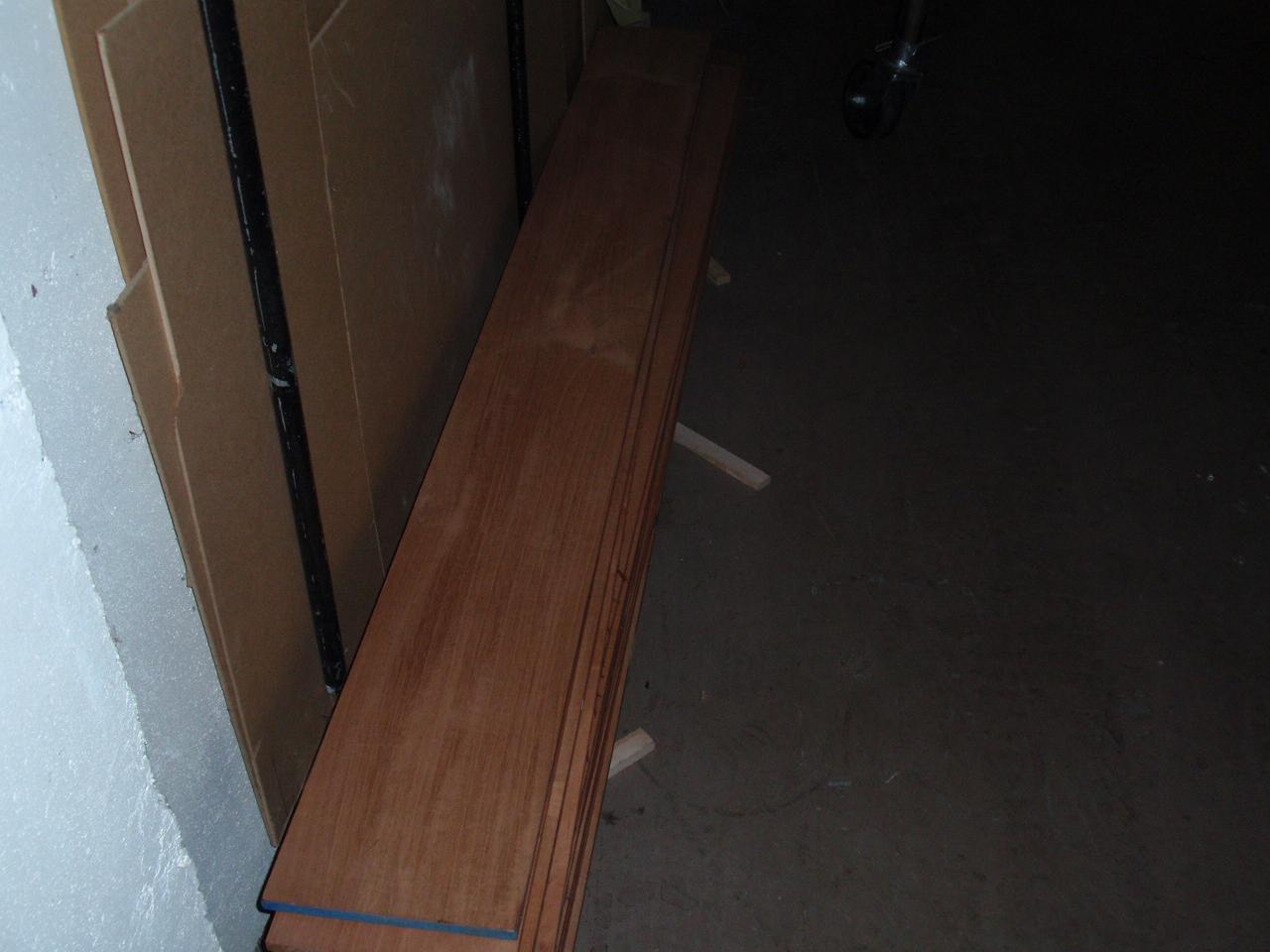

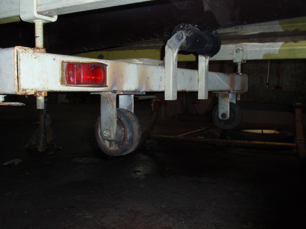

Picked up some of the mahogany boards from the cabinet shop today, all resawn and sanded, dang the kid sure does a good job, chip off the old block.

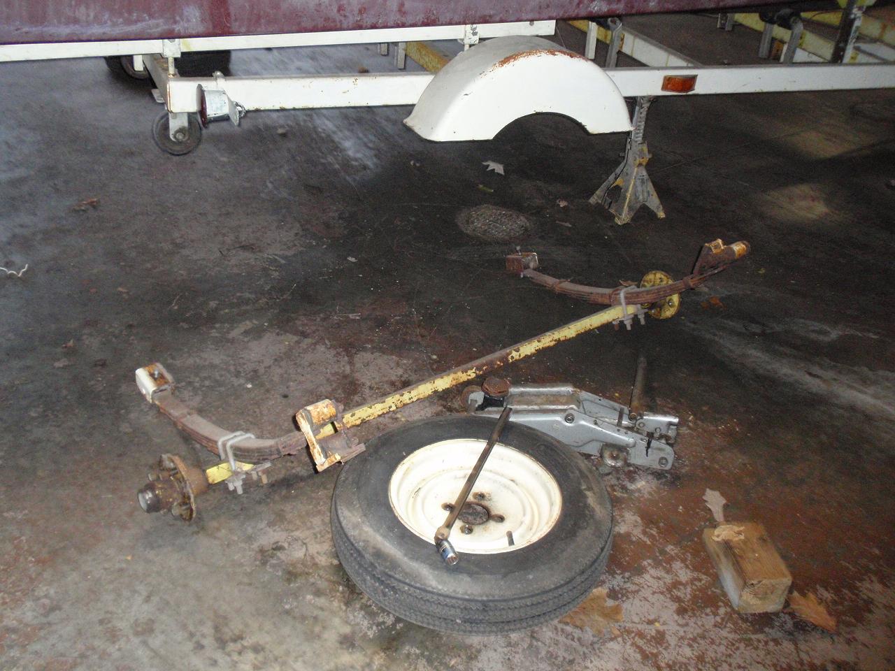

The boat stands tall on the trailer making it hard to work on with my limited headroom. I really have no way of setting it up on dollys so I'm thinking of tacking some rollers on the trailer frame and removing the axle and springs, should lower it to a workable level while keeping it in the trailer crib.
the Honduran mahogany
trailer standing too tall to work on.
wheel/rollers tacked in position on bottom of trailer frame.
removed undercarriage/axle and springs.
lowered to a reasonable working height and still mobile.
My woodie all tucked away in the background
