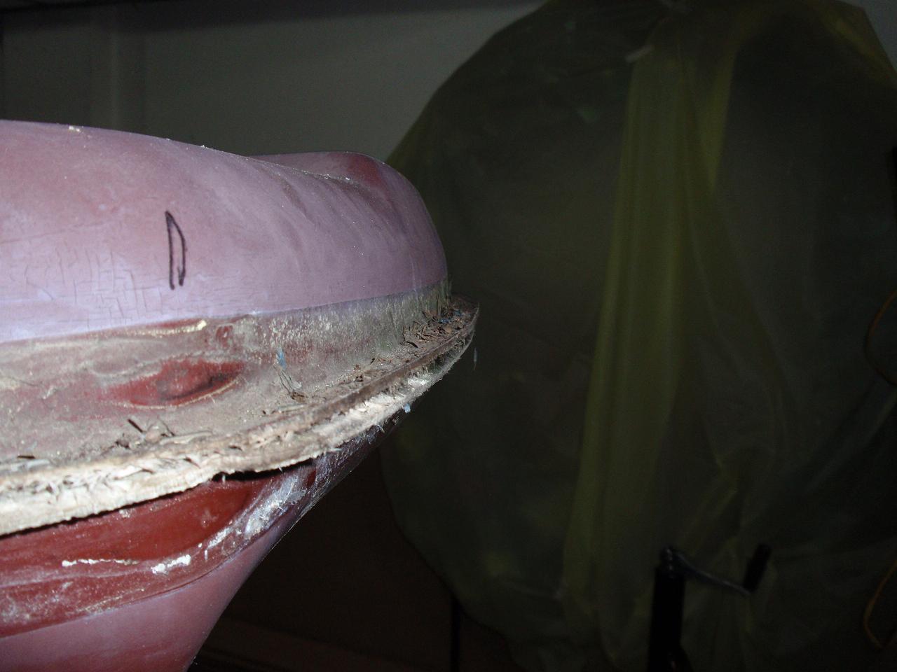

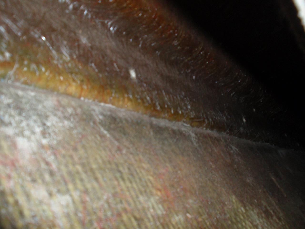

So far I've been pleased with what I have found on this project but today I confirmed what I expected. This particular model has the top and bottom stapled together using an outside lip and then a big ol fat rubber bumper covering the mess up. First time I've ever seen one put together like this. I removed the ugly bumper (went right in the garbage). Next step will be putting a bead of 5200 on the seam from the inside and then glassing the two halves together also on the inside and then cut off the outside lip to make a flush surface and one whole solid vessel. When the mahogany gunwales are installed they will also beef up the seam from the outside.
The outside stapled lip that sticks out about 3/4"
The seam from the inside.
Re:Shell Lake Rebuild 14 years 1 week ago #71343
Great plan Cal, that should look very smooth and be very durable.

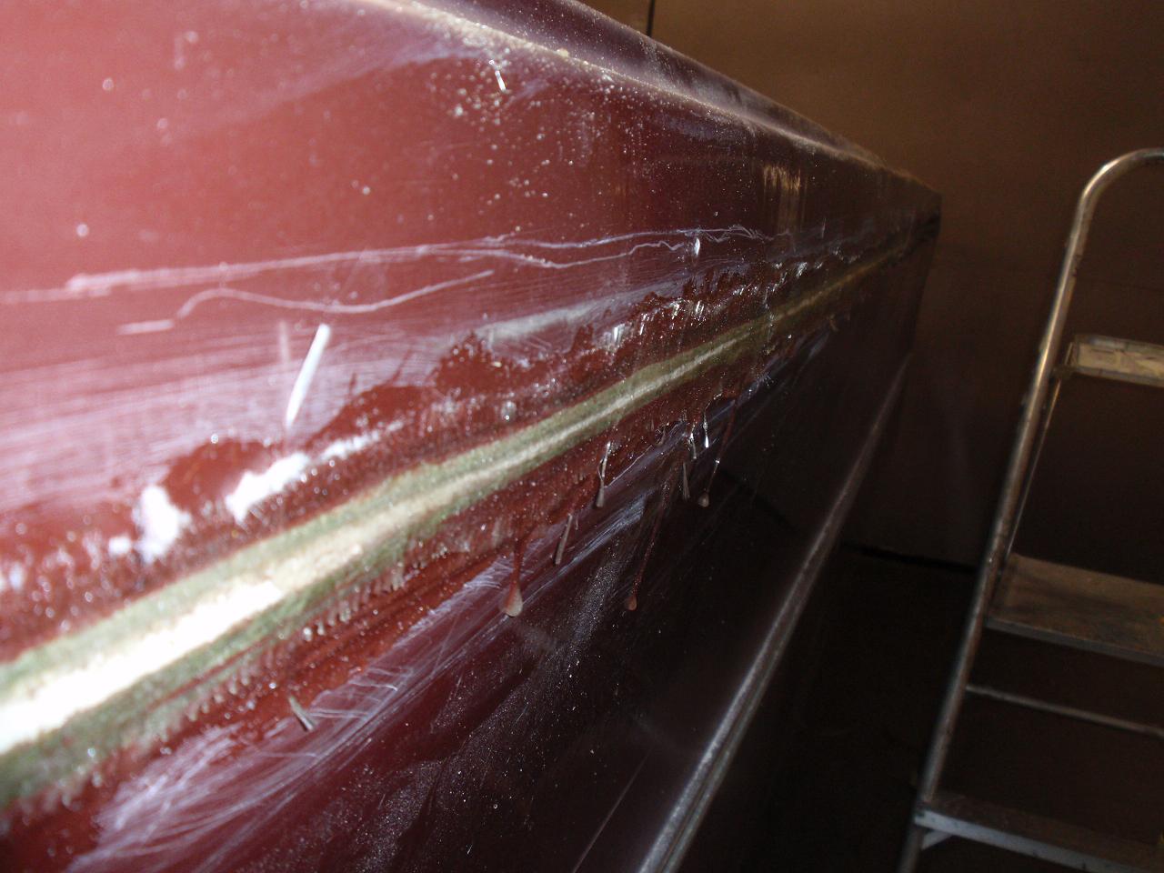

Re:Shell Lake Rebuild 13 years 11 months ago #71595

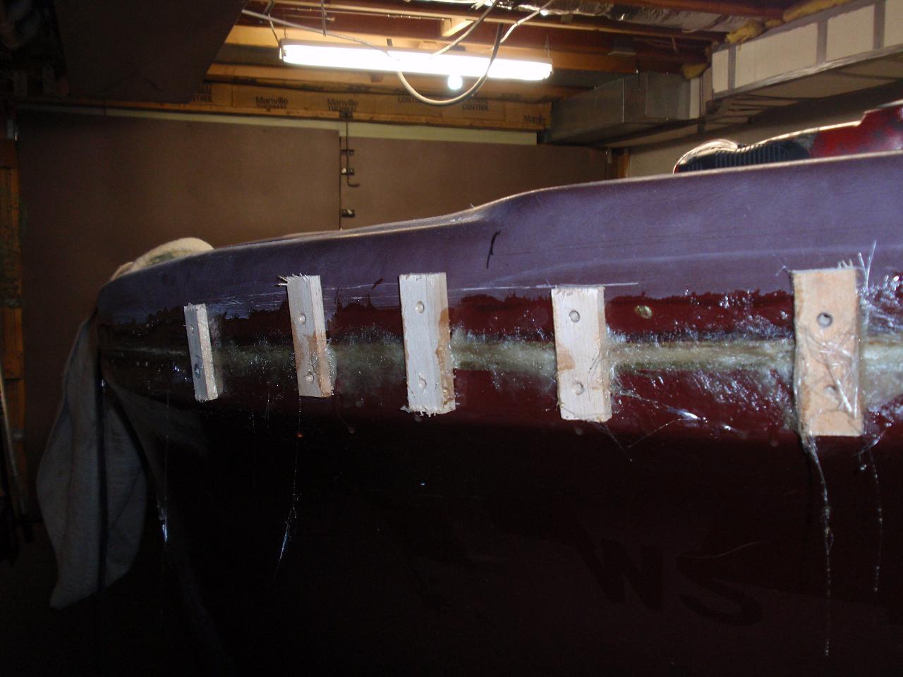

Did some small steps over the past weeks. Put 5200 on the inside of those seams and let that set for a week then trimmed off that ugly scar sandwhich on the outside. Had to pull the bow area back in shape where the two halves were about 1/4" mismatched. I used small strips of hardwood to pull the halves together and then glassed on both the inside and outside. Have to trim up and put on a second layer of cloth to make sure it's beefy. Filled the inspection holes back in on the deck and glassed them with matt.
Where the bow area was pulled back in shape and then glassed.
The port side seam glassed
The bow area glassed from the inside also. The floatation had to be cut away so I could get access to the bow, that is just as itchey as glass. The other area of floatation that is missing is where the coons scratched away for their bedding.
Re:Shell Lake Rebuild 13 years 11 months ago #71599
Outstanding, that's going to look like it should have if it was hand made! Much better than original.

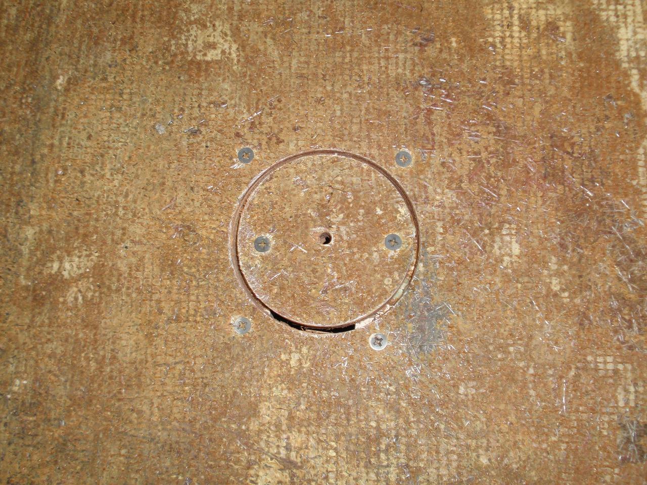

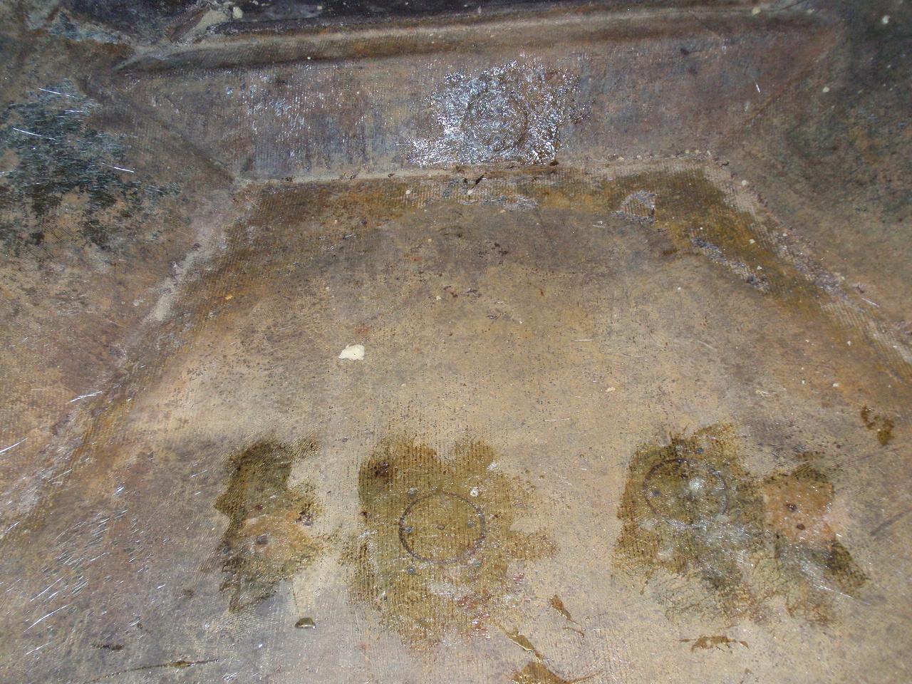

Re:Shell Lake Rebuild 13 years 11 months ago #71604
Filled in the inspection holes that I drilled the other week and matted them solid.

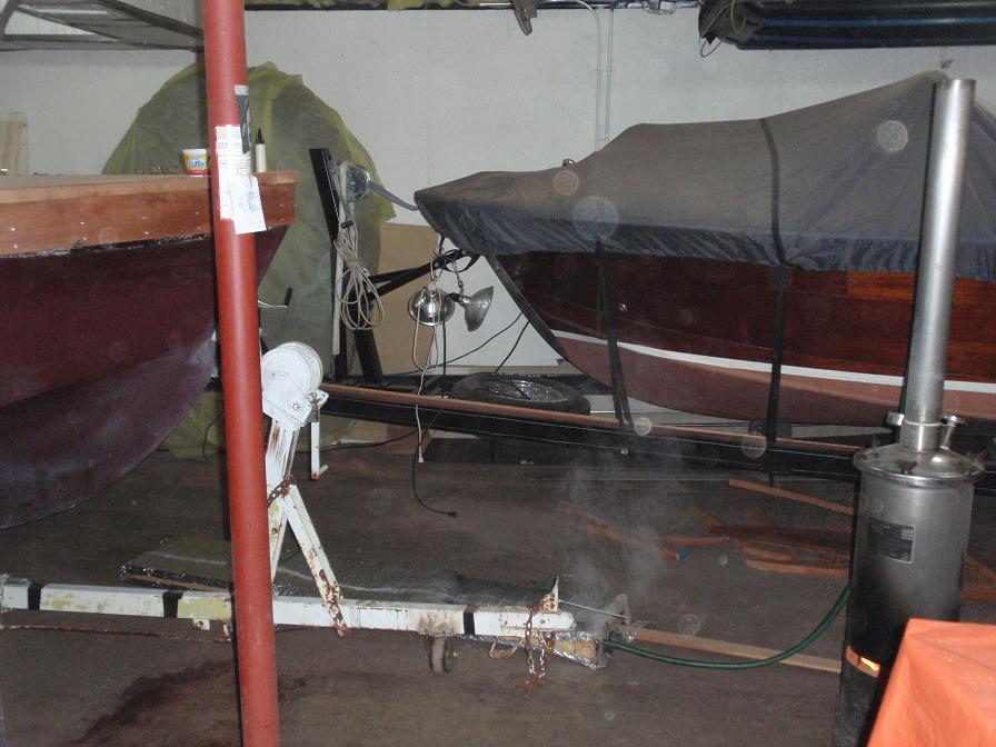

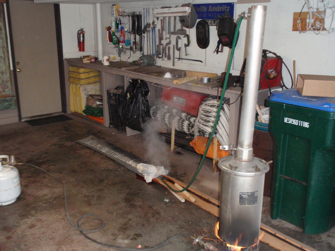

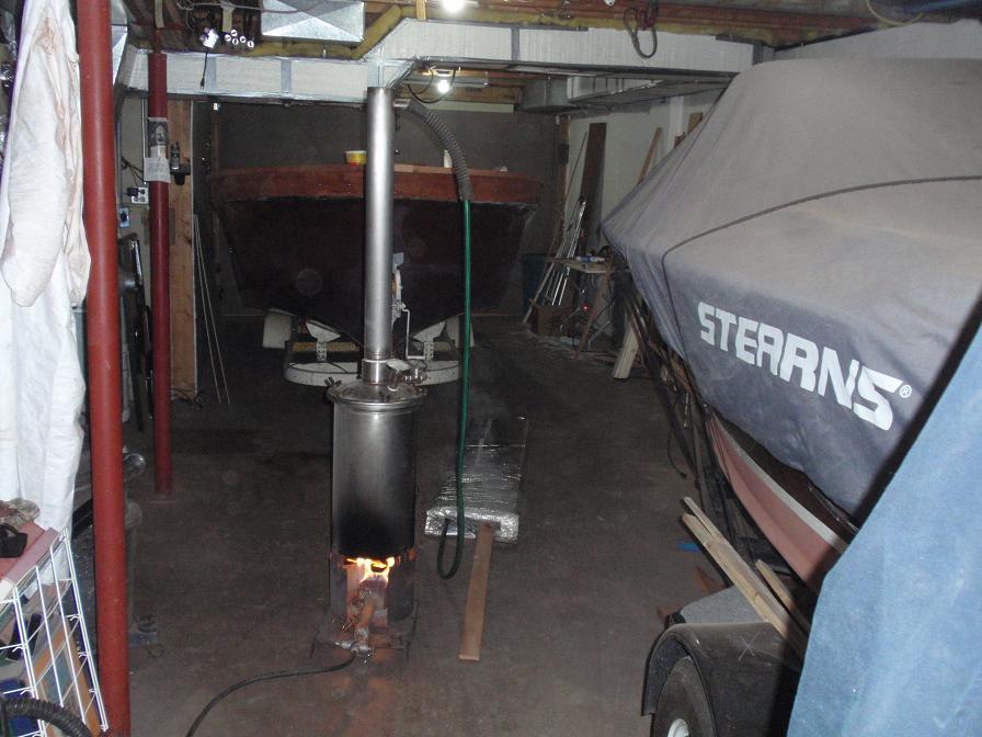

Did some steam bending yesterday for the bow curves.
Pay no attention to the design of my steam generator, purely coincidental to any other functioning device.
Re:Shell Lake Rebuild 13 years 11 months ago #71772
:) Think I saw one of those in the north GA mountains, but the guy ran me off with a rifle!
Re:Shell Lake Rebuild 13 years 11 months ago #71773
63 sabre,
My family made "a pretty good living" for decades with a device that looked just about the same.
(How many gallons of corn per hour will it distill?)
CHUCKLE.
Re:Shell Lake Rebuild 13 years 11 months ago #71779
Don't get the wrong idea here. I use that to cook down my maple syrup in spring.

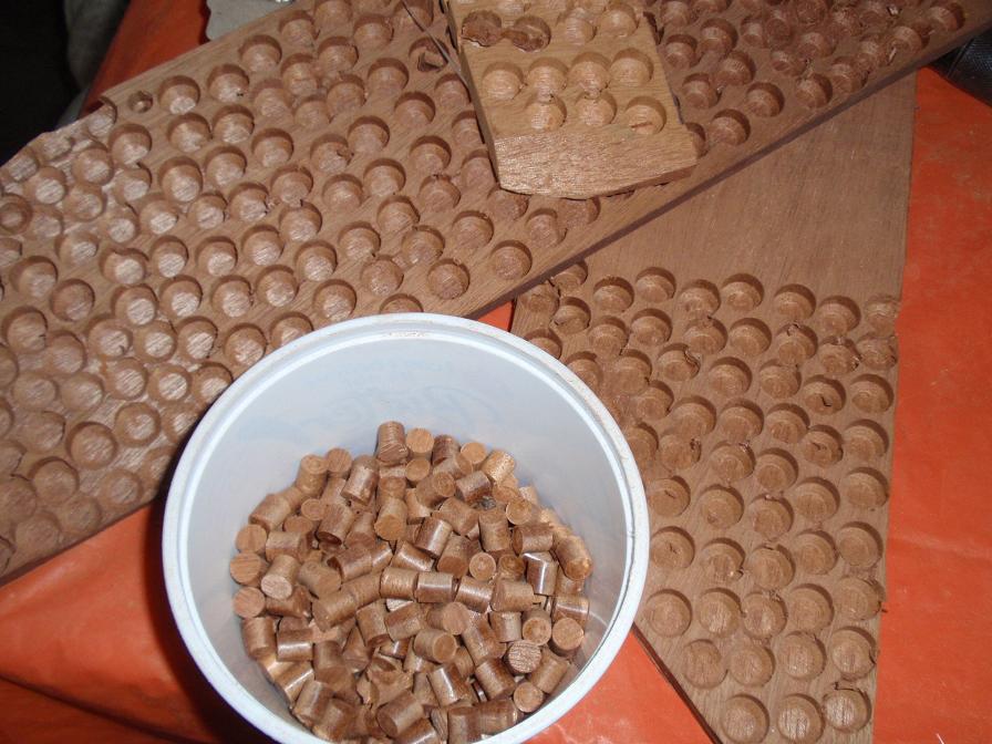

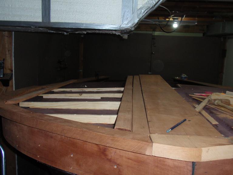

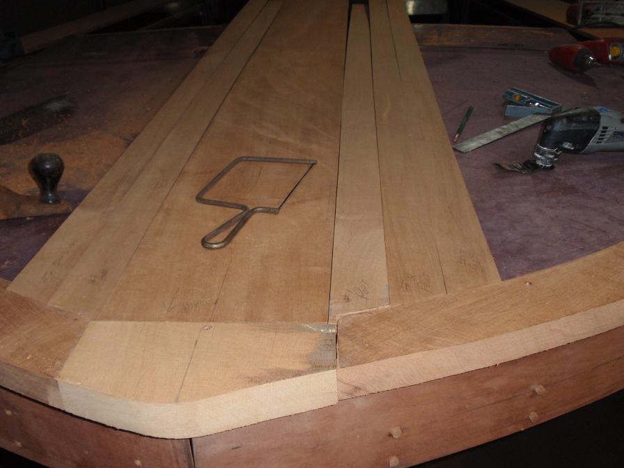

Re:Shell Lake Rebuild 13 years 10 months ago #73159
Finally getting some quality time on the project. Starting to fit the deck boards in place as a mock up. Still have to frame the underside. The top deck is so out of line and caved in there's going to be a lot of fine tuning to get it straightened out. Started cutting more plugs for covering up the screws/bolts.
Plugs
Starting to fit in the upper deck. This is taking a lot of time.
Re:Shell Lake Rebuild 13 years 10 months ago #73160
Looks like your moving right along there Cal.I know that it is alot of fun cutting plugs. That deck is gonna look really sharp when you get done with it. Keep up the great work. Skip.

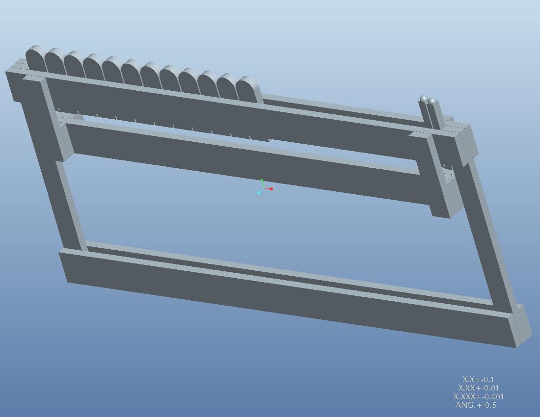

I have same type of problem with a deck that is cracked and sunken down along the crack. The question is: How do you get the deck back to shape ?
My solution is going to be the same principle as a contour gauge.
I'm still designing it, but here is the prototype
Mine will be called the RE-contour gauge. it will be a level frame supported by the hull at the bottom, under the deck.
The vertical stiles of the frame will be single bolted to the horizontal rails Horizontal Slotted hole at the top with a bolt
(bottom bolt to be used as pivots) when I pinch the contour pins together to keep them from dropping, with a ratchet strap near the top . (See picture)
I plan on wedging the contour pins under the deck to push it back to the desired shape, and maybe hold the pin in place with a speed screw (drywall screw)
I plan on making the thing out of free pallet slats to save some cash. I still don't know how wide to make the pins yet ? I'll figure that out when I make a few.
But like always "More are better". The tops of the pins will need to be domed for single point contact.
I'm sure I'll need more than 1 gauge too.
Take the idea for what it's worth ? It may work, it may not ? But this is how I'm going to try it on mine...

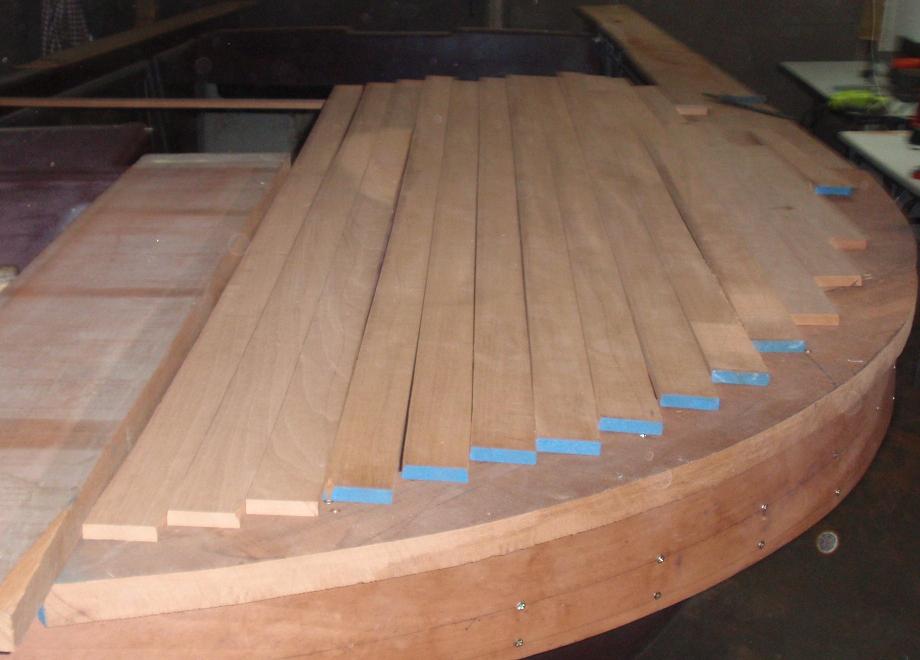

Re:Shell Lake Rebuild 13 years 9 months ago #73526

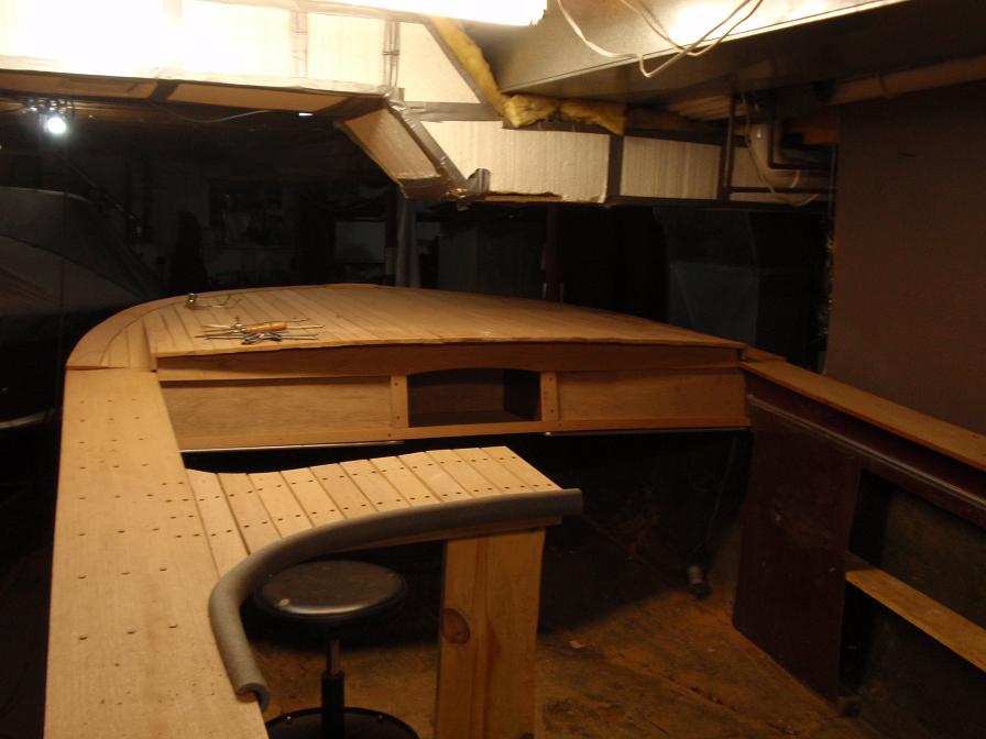

Chuck, looks like it would work. The deck on my project is so out of whak no bracing from underneath will come close to a fix. It is off be several inches, looks like the sun beat down on it so long it melted in :-)
I wound up making framing for under the slats, both port and starboard are completely different, off by inches.

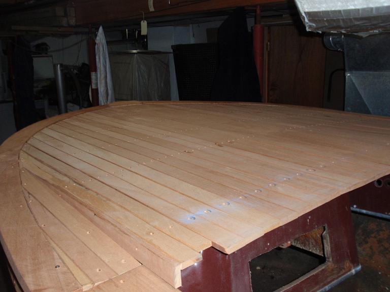

Did some work on it all today. Finished framing both sides and then started fitting the slats in. framing is 10" apart making it rock solid. More drilling, counter sinking, screwing, plugging yet to come and then have to fair the whole thing. Probably won't do that until I can get the whole boat outside where I can make lots of sanding dust.
Framing on starboard side.
After all the measuring, drilling and screwing.
From the cockpit.
Each individule slat is held in with 12 screws and bedded in with 3m 5200.

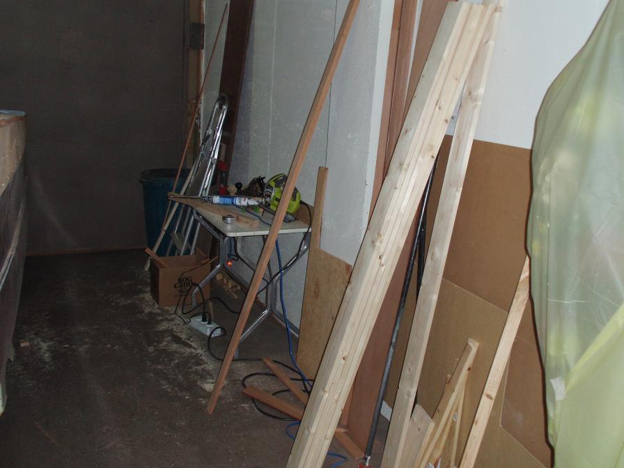

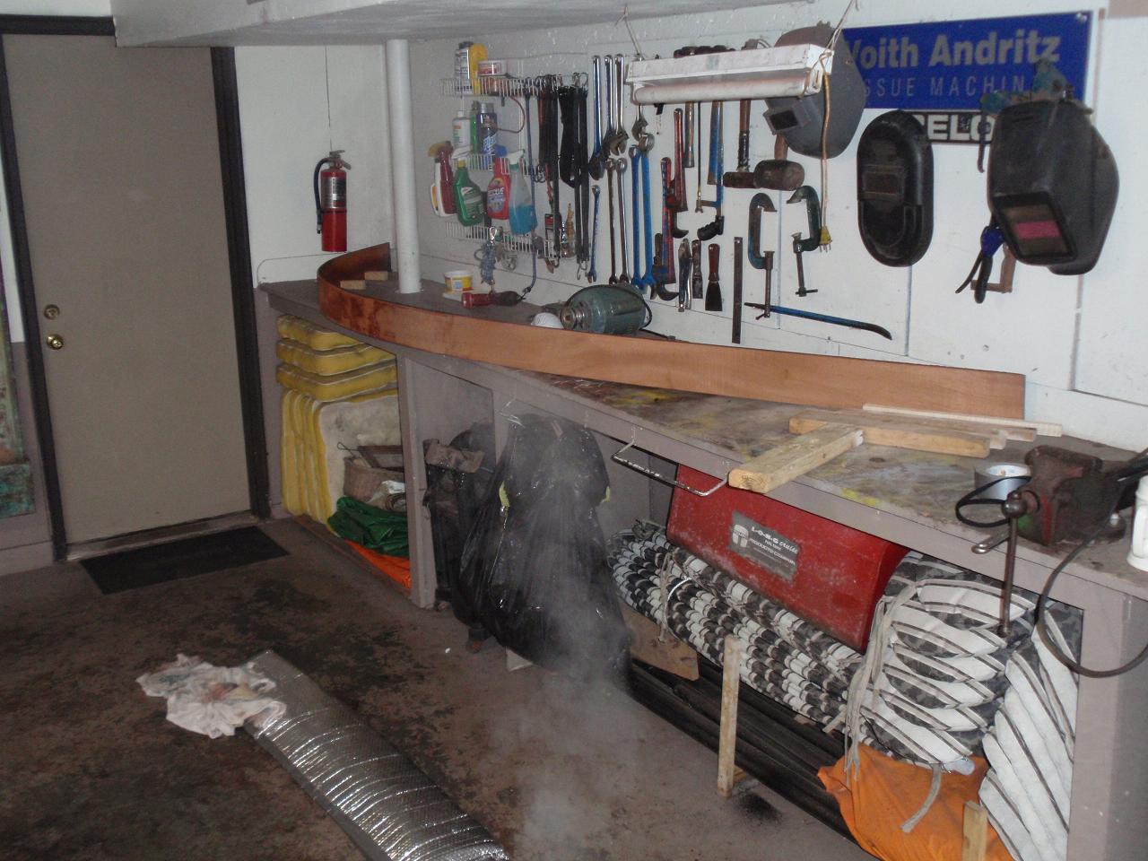

Forgot how tight the quarters are in my work area for the winter. Fired up the steamer this morning to bend some more wood. It is nice and warm though
Re:Shell Lake Rebuild 13 years 9 months ago #73832
Hey cal, forgot to mention your steamer looks much simpler than the Dannenberg model he built. how do you refill the water without taking it apart?
Re:Shell Lake Rebuild 13 years 9 months ago #73842
I just put a few gallons of water in there and fire her up. Never had to refill. I suppose I could put a threaded plug in the top somewhere.
Re:Shell Lake Rebuild 13 years 9 months ago #73847
I'm looking for the cheapest way to build one. Budgets going to be tight on the Century I think.
Re:Shell Lake Rebuild 13 years 9 months ago #73859
This one is made from an old swimming pool filter, used to hold 14 fiber cartridges. Now it holds about 10 gallosn of water. I just capped the bottom in/out holes with plumbing ends, got an old salamander from a contractor friend of mine. The condensing tower is optional. Some I've seen made from old small water heaters. I guess anything that you can boil water with will work. Check out some of the local restaurant suppliers, they might have old used cookers that can be converted. Just a thought.
Re:Shell Lake Rebuild 13 years 9 months ago #73873
Hey not a bad idea, I'll have to keep my eye out.
