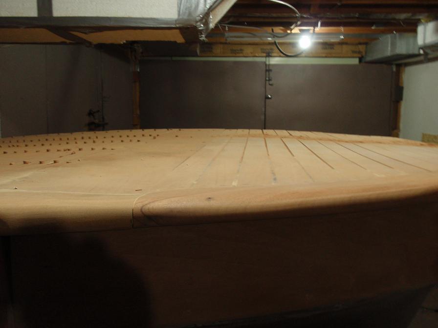

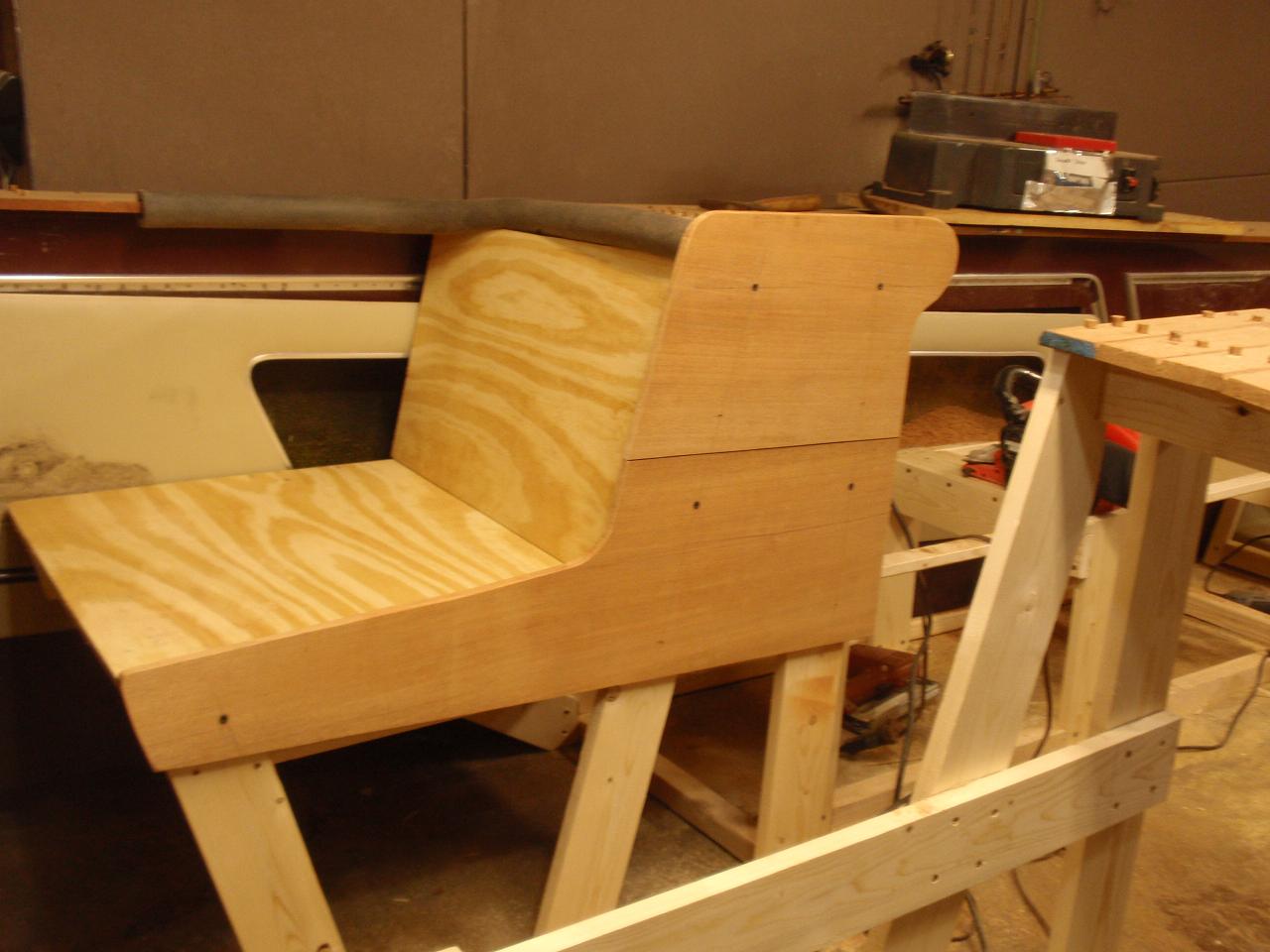

Hey John, not restorin' completely rebuilding. Too cold outside to do much of anything, so I got back on the project.
Been working on the seating arrangement, pegging screw holes and general woodworking.
Many hundreds of pegs to put in. Just about finished the deck areas except for the motor well area.
Setting up the captains chair, front and back.
Too dusty to sand inside so there's going to be one pile of dust on the driveway when the weather starts warming up.
So far everything is still in the rough stages, lots of fairing and edging to be done.

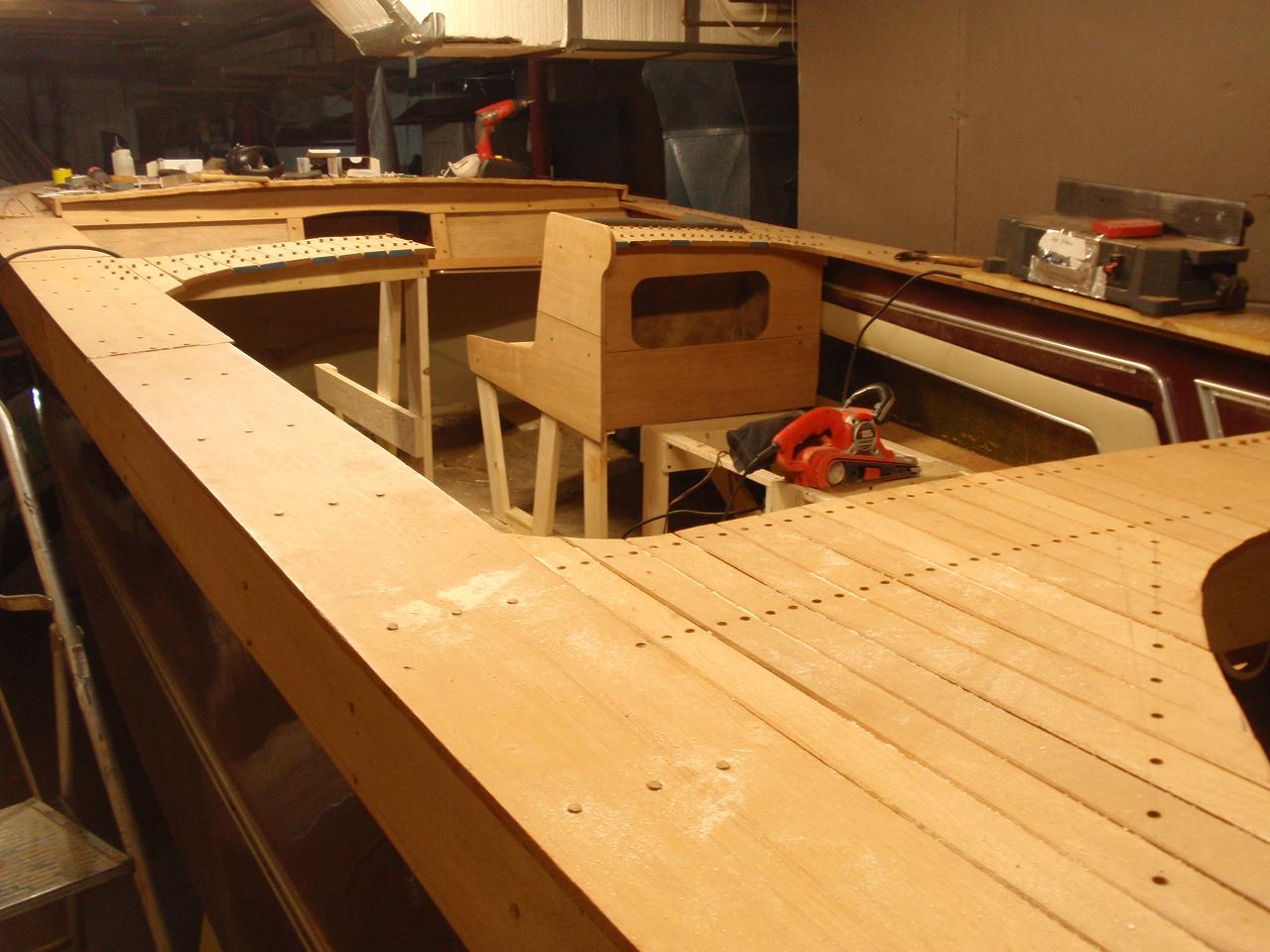

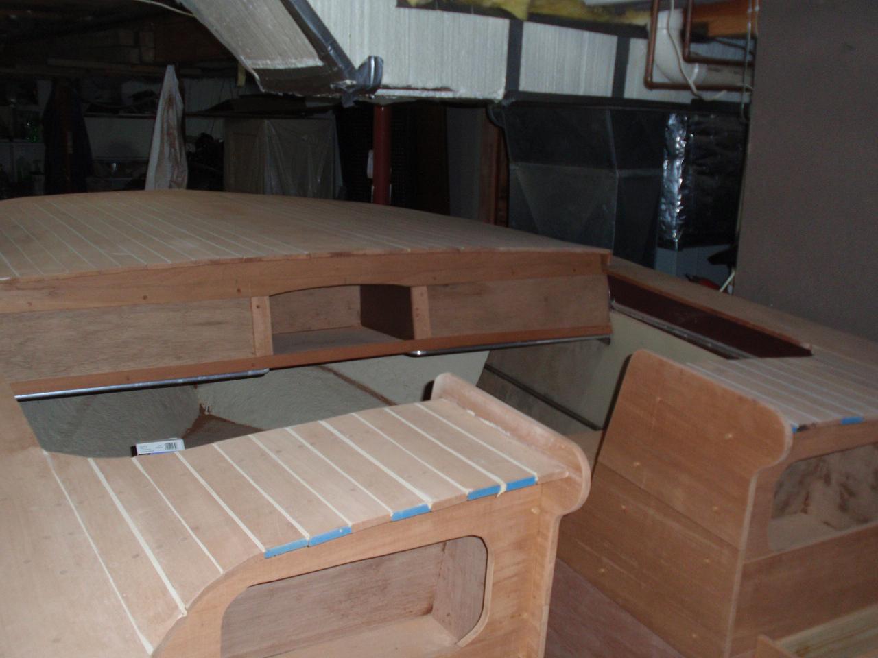

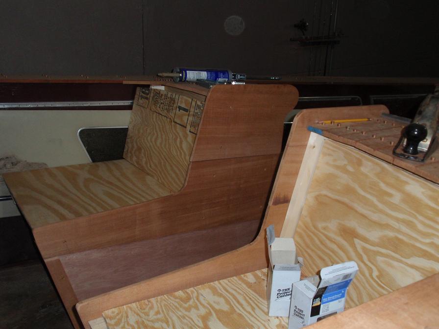

Gettin' dusty in the basement. Just for drill I did some fareing on the bow to see how it might turn out. 36 grit on a belt sander makes short work of mahogany edges and high spots, went down to 80 on the palm sander and then some 120.
The boss wasn't home so I had some cleaning up to do since I told her I wouldn't do any sanding until it was warm enough to move outside. Whoooops.
Finished the front seating and beginning the "U" shaped back seats. Many plugs to put in and finsih off. :angry:
Initial faring on port prow.
Front seats.
Framing up rear side and aft seating.
Hard to believe that 4 months ago this was 80 bd ft of rough sawn.

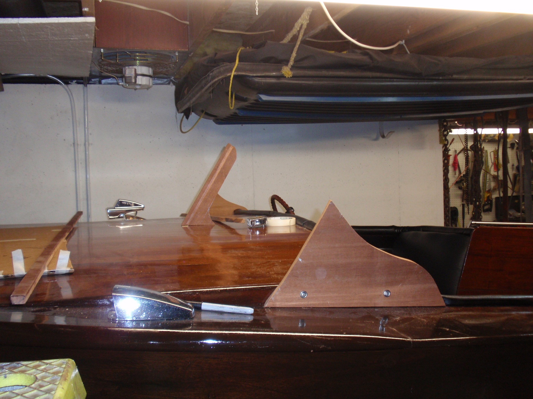

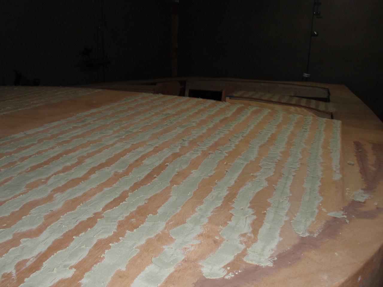

Re:Shell Lake Rebuild 13 years 7 months ago #75414

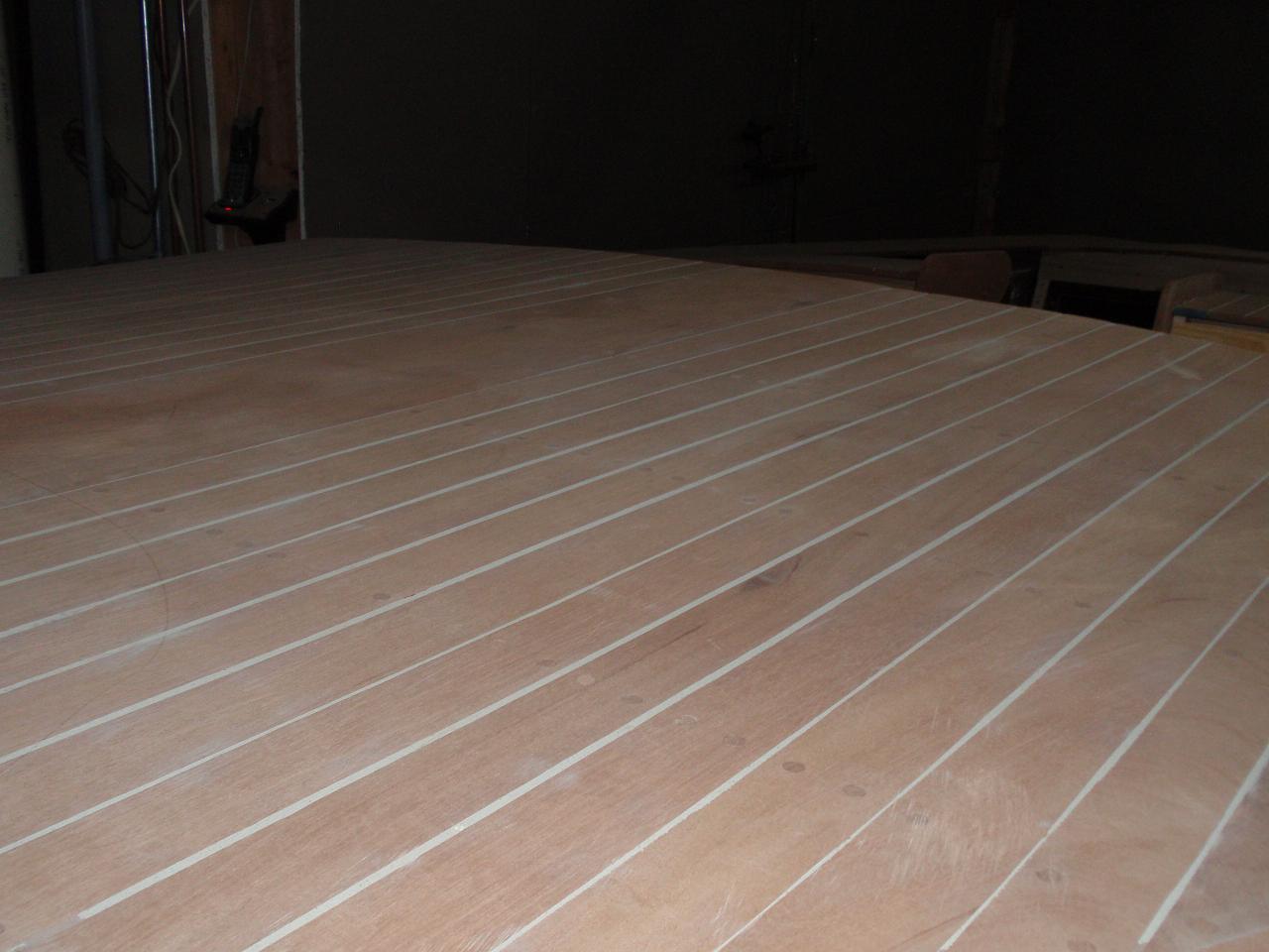

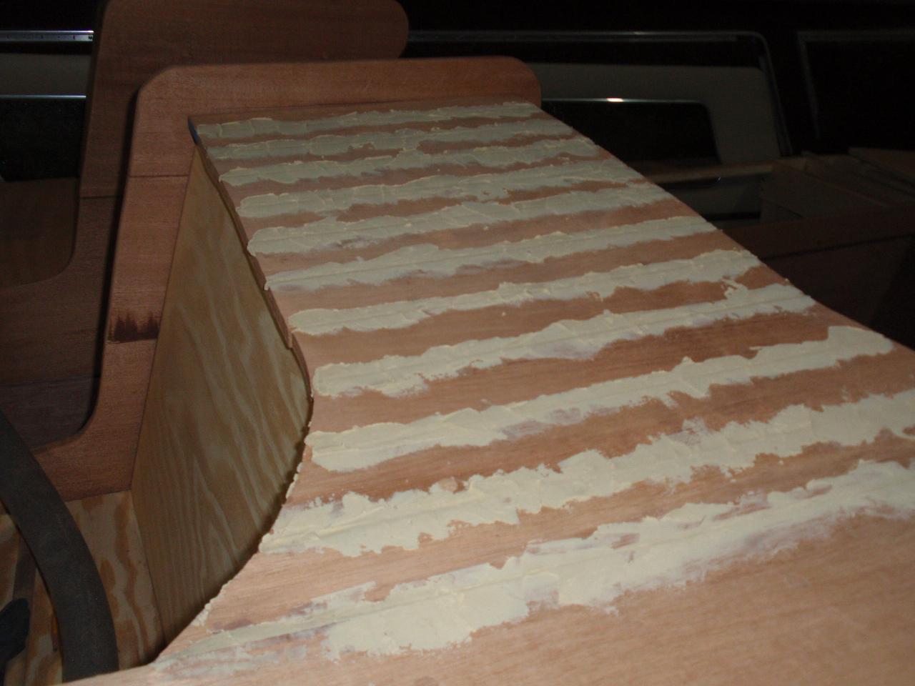

Got myself in trouble that last few days. Started some sanding in the basement and garage, big no no with Honduran mahogany, the sawdust turns a very deep red color when it gets wet and seems to stain everything in sight, Ma's not happy with me......at all.
Filled in the chamford bow strips, seat backs and motor well area. I vow not to do any more sanding until the weather warms and I can move outside.

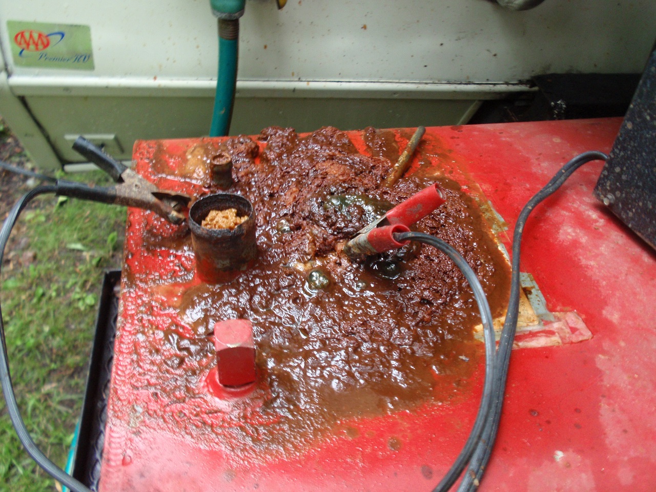

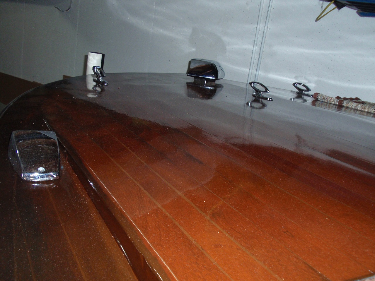

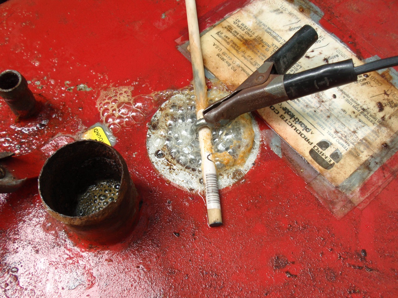

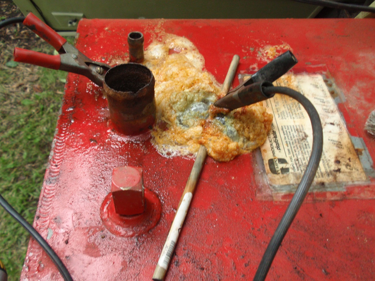

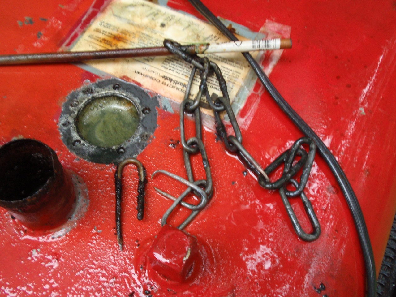

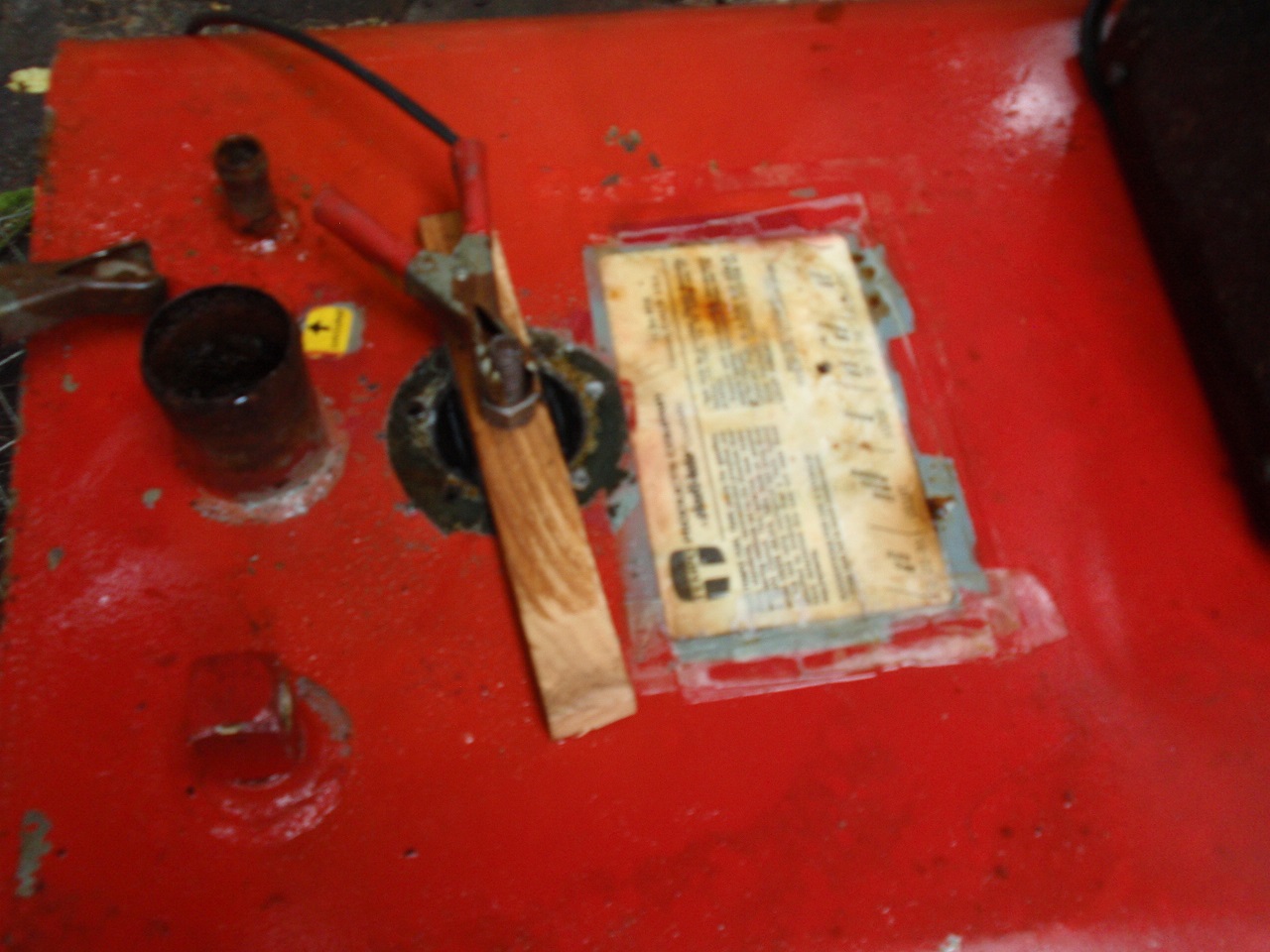

Been a long time on hold, spring, vacations, honey-do list etc. The rebuild is coming along. Got the final coat of varnish on the deck today, seats are made, side panels are installed, engine is finished and re-hung, wiring is just about complete, need to install the lights and horn to finish that up. Steering is installed. Today I took on the project of de-rusting the 18 gallon fuel tank. The tank is good, no leaks but loaded with rust. I went on the net to check out different options and decided to go with the electrolysis option. Flushed the tank with water to get chunks out, poured in a box of Morton salt, filled with 18 gallons of water, suspended an iron chain down the level hole, hooked up my battery charger and let her rip. + to ground, - to the chain. She started "boiling" right away. Really got to be careful with this method and do it outside because I hear it creates hydrogen gas, I could see it coming out of the filler hole, like a light misty smoke. It's going to take awhile but I think it beats pouring acid in and shaking it around or filling it with a sealer.
Here's the setup, charger.
Chain to suspend using a 1/4" dowel to not short out.
Started cooking the instant I plugged in the charger.
Really working, don't know how long it will take, supposed to stop the action if there are no more bubbles.

Wow Cal, hadn't heard of that method before. Iet us know how it comes out. I may use it for the Century tank. Not sure though it may be too far gone and need a new one.
Re:Shell Lake Rebuild 13 years 2 months ago #82746
Bob, I'll see if there is a way to snap a picture of the inside when it,s finished. I had to order a new sending unit though, the other was completely toasted with rust and gunk. Amazon has marine universal sending units from Moeller, five star rating so I feel pretty safe in ordering it. $25.
Re:Shell Lake Rebuild 13 years 2 months ago #82748
Hey Cal, I was starting to wonder if you had given up on your new project. No posts for awhile. I have done the same for cleaning tanks. Just be really careful with doing it that way. Watch that the bottom doesn't get too thin on you. I have a really good sending unit you can have if you want. It comes with a new gauge also. The unit can be made to fit any depth of tank up to 18". It is yours if you want it. Skip.

Re:Shell Lake Rebuild 13 years 2 months ago #82764

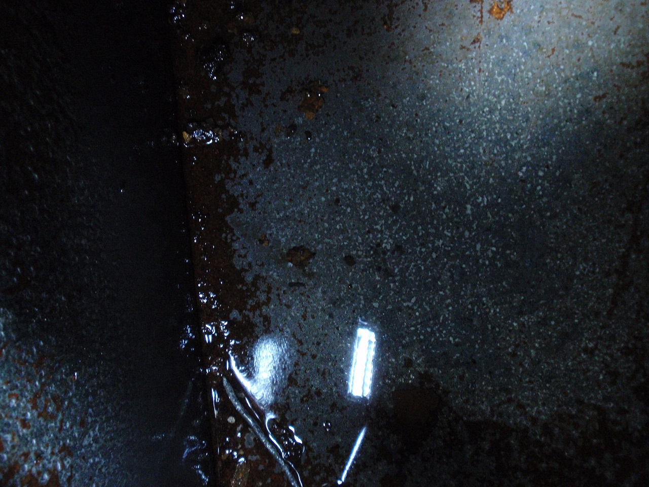

Left the tank sit overnight and this is what I woke up to this morning.
I dumped out the old solution, so much crud, green/gray slimy rusty gunk that smelled like old varnish so I know it's working. Now I know why it's called a "sacrificial" anode. The chain is over half gone and the steel rod disappeared.
Put in a new batch of salt water and found an old threaded rod that I will use. The bubbling has slowed down which according to the google search indicates that the rust is going away. I looked inside as best as I could, all the flakey stuff is gone and now the inside is smooth but still rusty colored. Another day should just about finish up the process.
Skip, thanks for the offer but the Amazon order is already being shipped.
Cal
Re:Shell Lake Rebuild 13 years 2 months ago #82765
Hi Cal,
i've used this method before. The finished part will turn black, and I used a wire brush to clean it.
One other thing. You sure you you have it hooked up properly ?
If I remember correctly ? The positive side gets eaten the negative side does not. You may be eating the tank instead of eating the chain ? The chain is the sacrifice part that should be eaten.
I've used a plastic barrel, with rebar pieces linked together around the inside circumference of the barrel. those rebar pieces are hooked to the positive and disolve. The part to be cleaned is hooked to the negative. So the positive charged side sucks the rust off the negative part side.
Sounds to me that you are eating the tank and cleaning the rust off the chain ???? Unless I'm thinking backwards ?
Phew !!!! I see you have updated pics. The first set was black to chain and red to tank. I see the red to bar and black to tank now.
Re:Shell Lake Rebuild 13 years 2 months ago #82766
Chuck, you are correct. According to the gurus on Google the reason for the reverse polarity was to loosen and suck the rust off the tank walls. If you look at the pictures I first posted you will notice the change/color of the clamp handles after a few hours, I did put the + on the chain and you can see the results. Thanks for bringing that to the attention of our faithful readers.

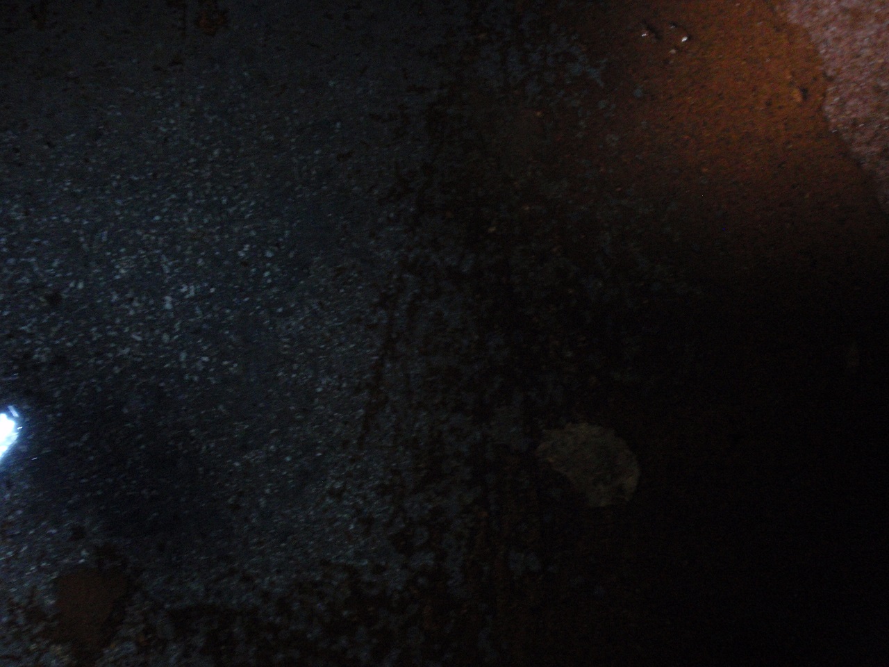

Re:Shell Lake Rebuild 13 years 2 months ago #82818
Here's today's update on the fuel tank cleanout. After putting in a new "solution" I was called in to work and the thing sat for 13 hours. The "anode" threaded rod was about half way gone and more gunk was bubbling out the tank. I dumped that out and took some pictures. I would say it's about 85 - 90% cleaned out you can see some rust on the edges and a patch on the bottom but otherwise it's cleaning up pretty good. After taking the pictures I refilled it again and started the process. Gotta remember that I was about ready to toss this tank but nothing ventured etc.....
The inside corners if you can make them out.
The section on the bottom.
As you can see the rest cleaned up really well. When it's finished they say to turn it upside down and let a hair dryer blow in there until it's dry and then coat it with WD-40, diesel fuel or tranny fluid otherwise it will rust really fast because of the raw metal.

Bob, I finished it up today, turned out really well. When the new sending unit arrives I can put the tank back in the boat. After draining the water out as best I could I dried the rest out with a rag attached to my little tweezer reacher thingie. Poured in an old quart of atf 4 and a half quart of older 90 weight oil, sloshed it around, taped up the holes with ----drum roll---- duct tape and turned the whole tank every which way but loose to coat the inside.

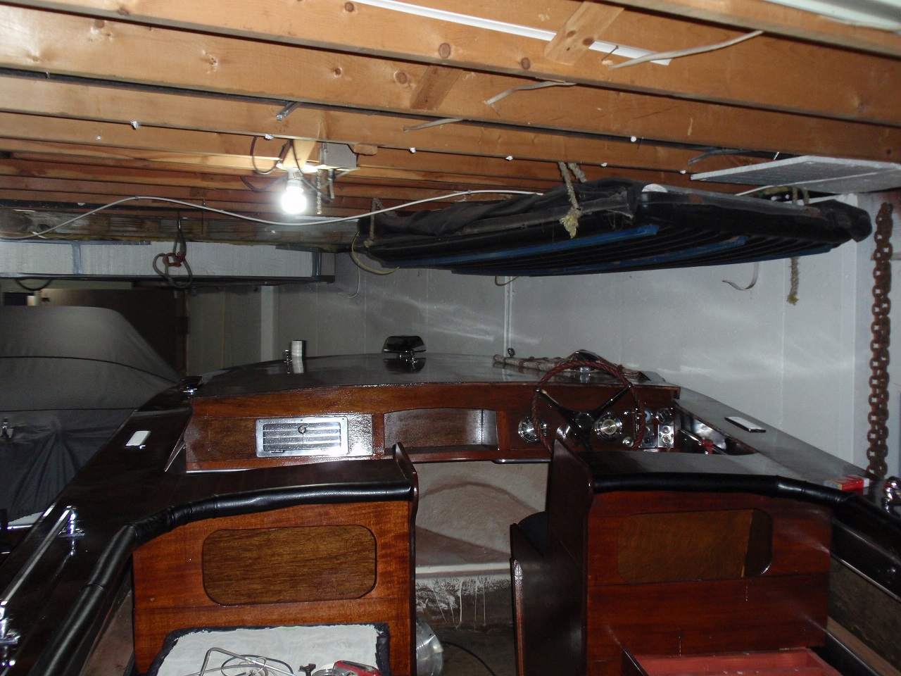

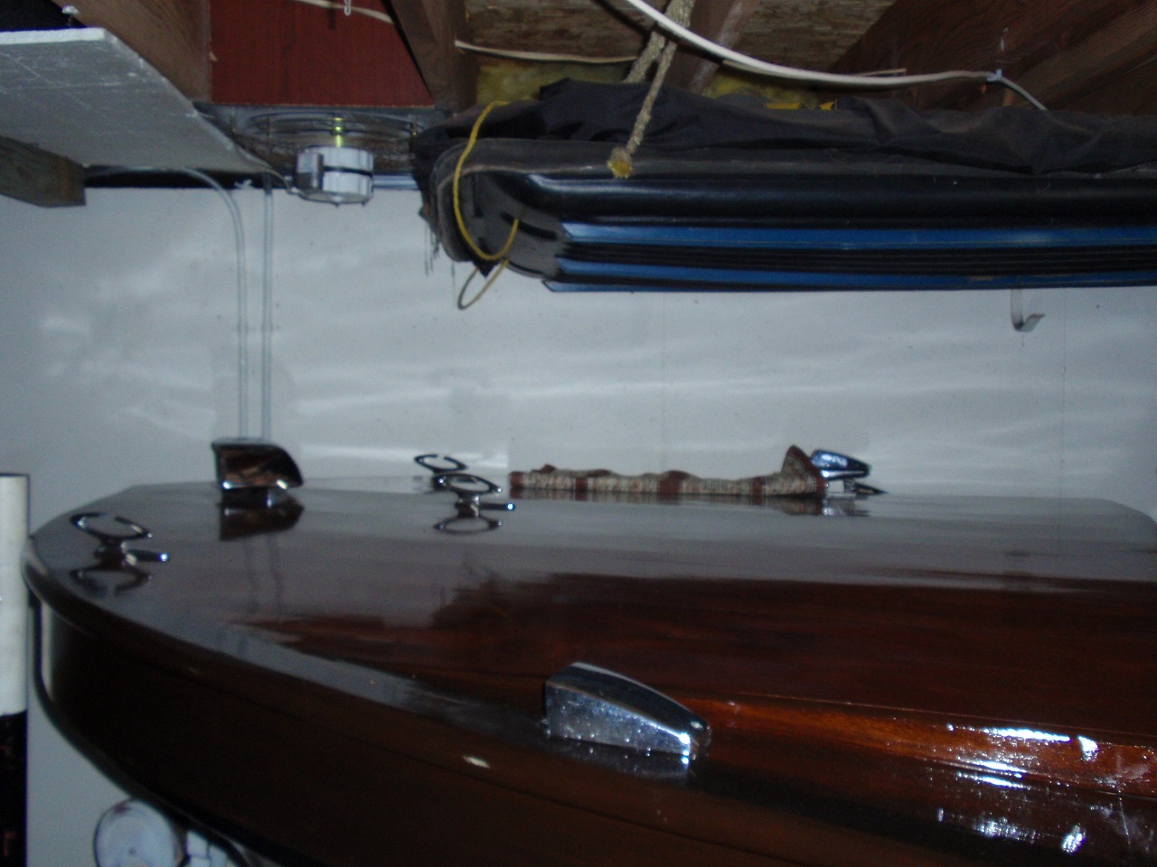

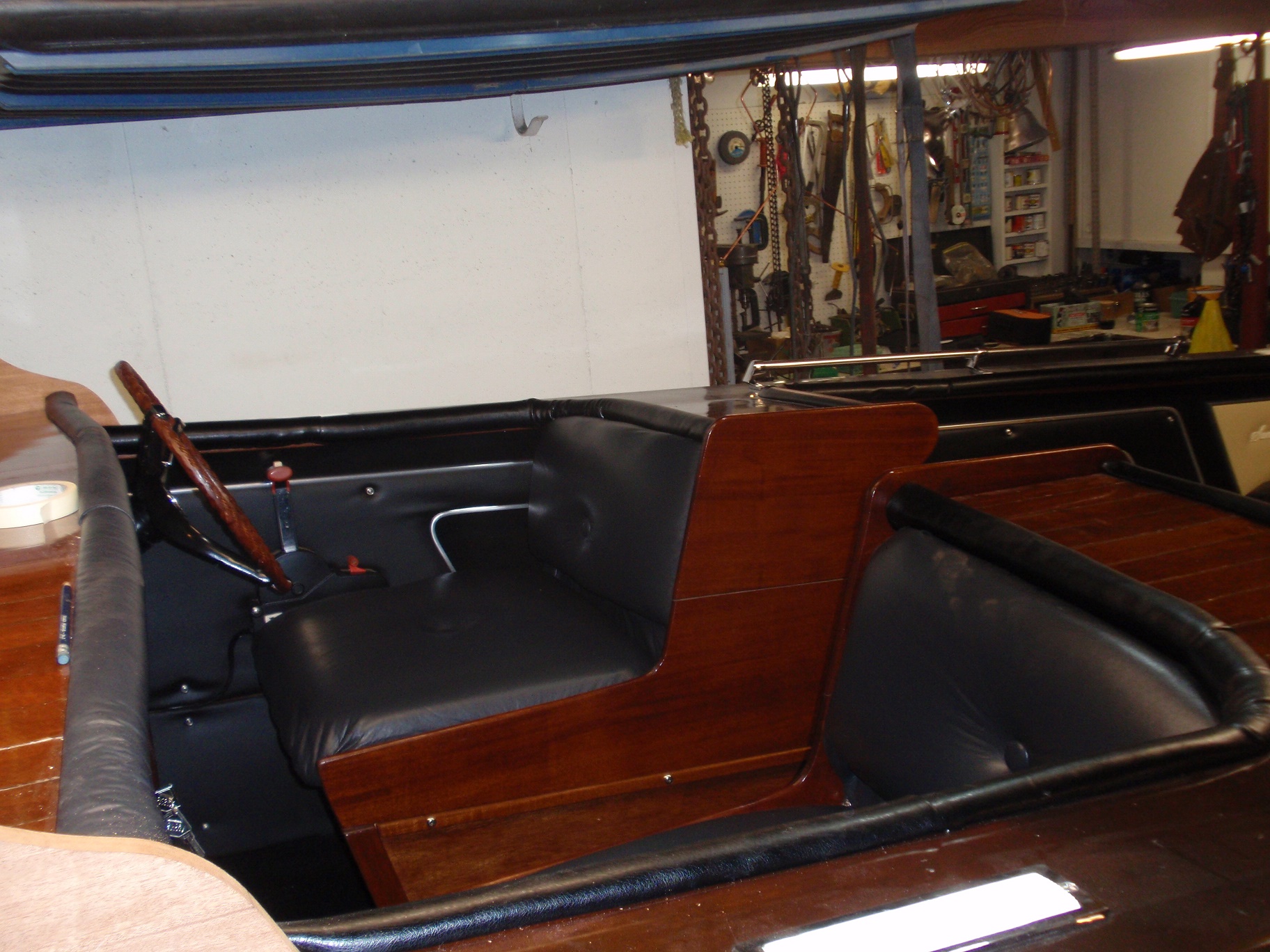

Finished installing all the bling this past week, got the new fuel sending unit and reinstalled the tank, working on finishing up the wiring of horn, lights, etc.
Re:Shell Lake Rebuild 13 years 1 month ago #83408

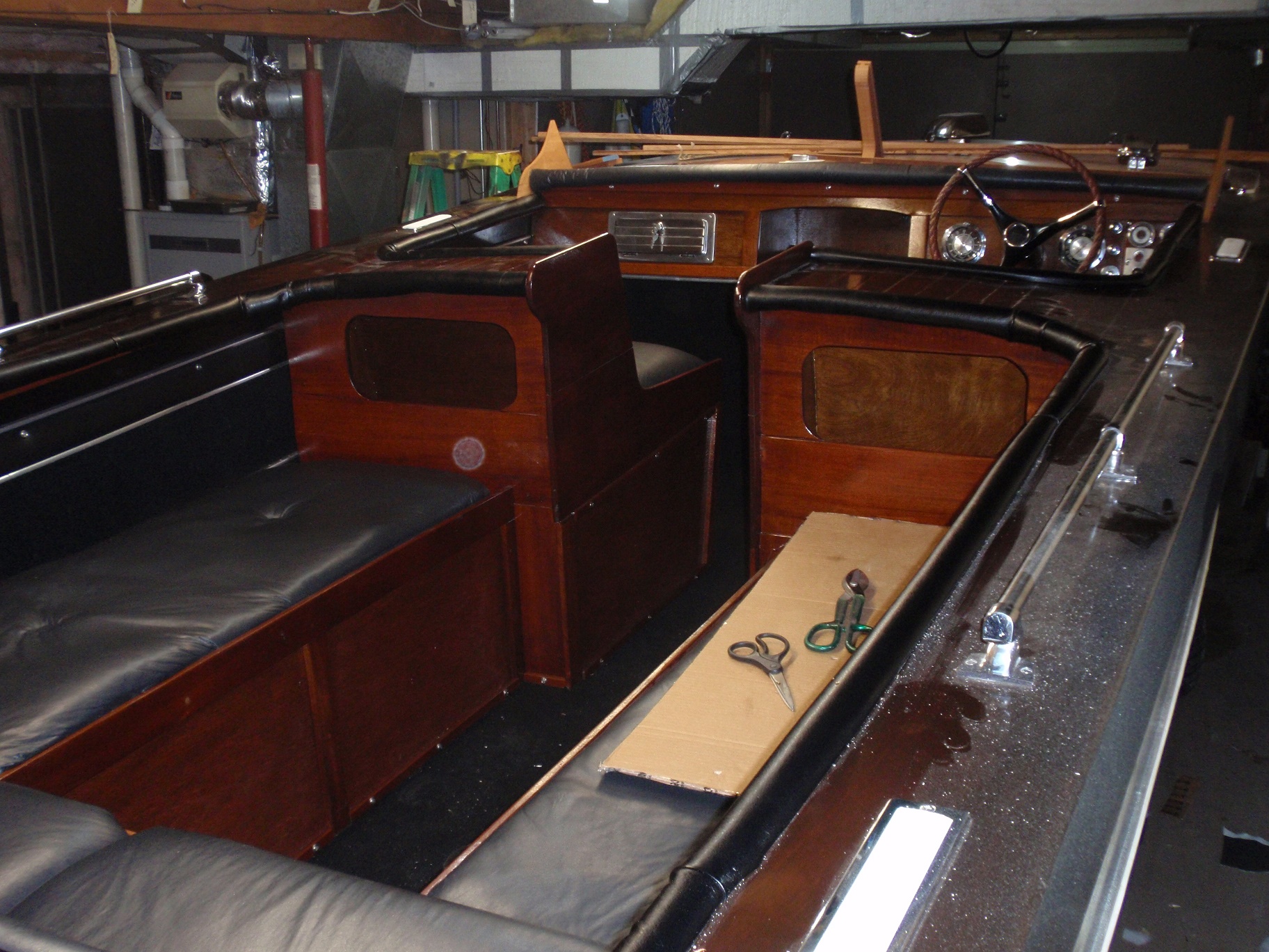

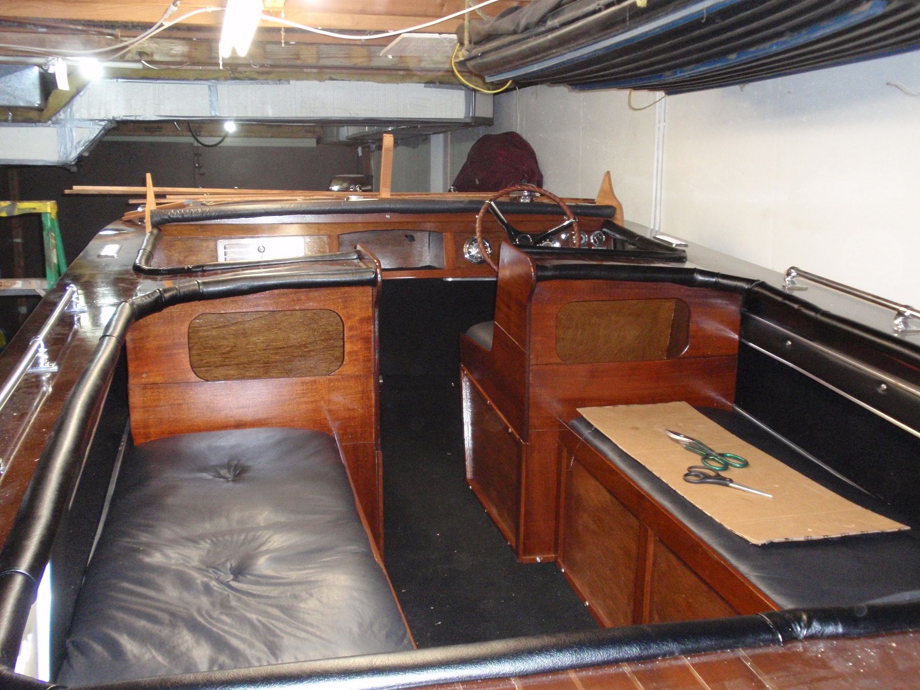

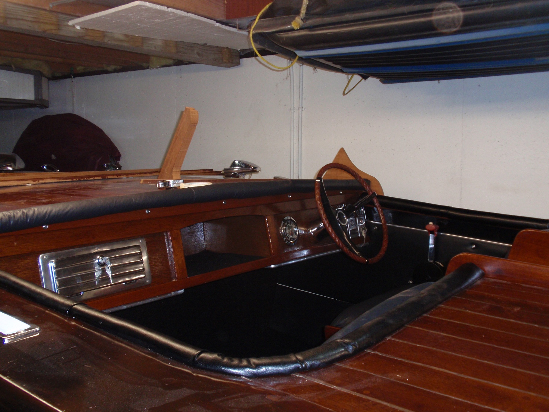

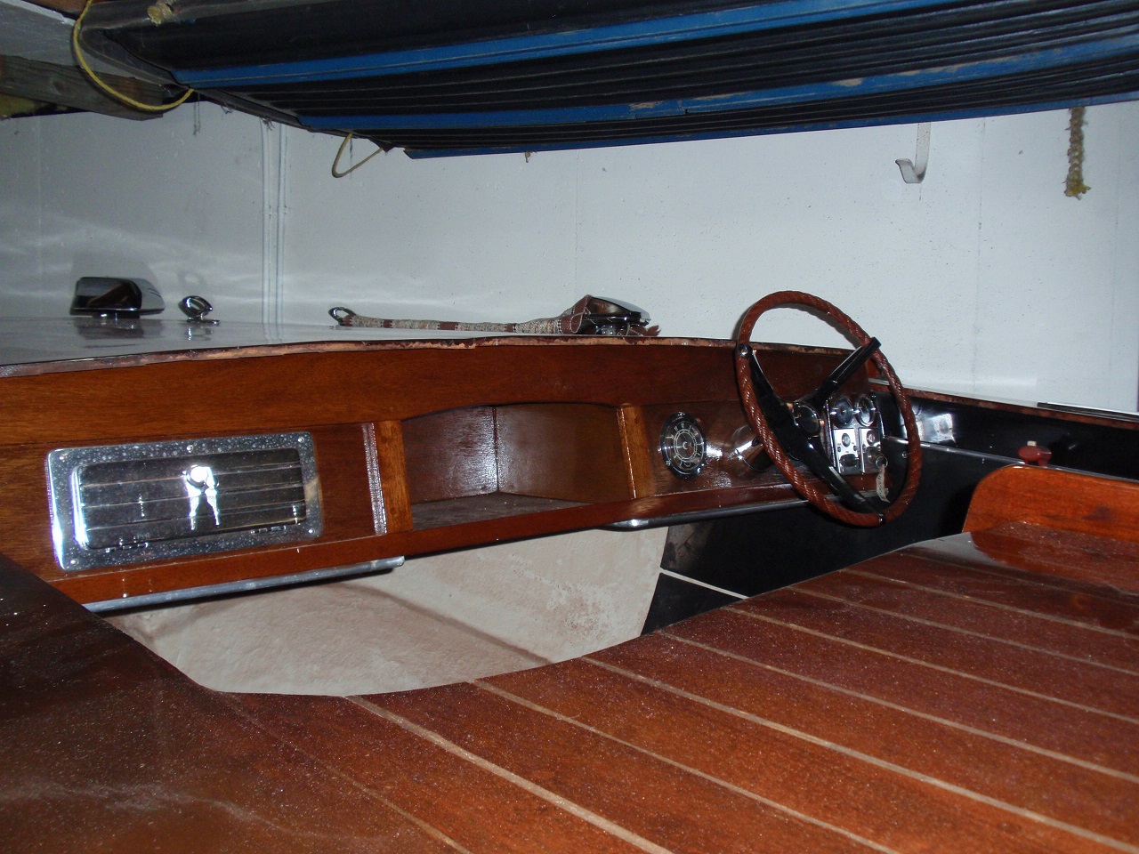

Finished all the wiring today and had time to snap a few progress pictures. Pretty far from splashdown yet.
Have to finish up the inner bumper rail, carpet, forward locker hatchway. Also had to ground the fuel filler inlet.
Small picture of the filler.
Other misc pictures.

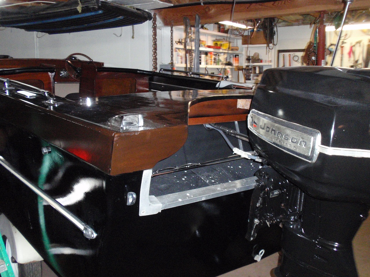

Boy, has it been a while since I posted. Holidays take their toll on all of us even waterwings. I really slowed down on the Shell Lake rebuild/mod/restore. Pretty much finished the interior and am now about to tackle fabricating some type of windshield that will match the '30's look that I am trying to achieve. Wanted the old mahogany look with coushy(?) pillow like seating with lots of storage. Still looking to give it a dunk this coming spring but the trailer will be on the back burner.
Gotta excuse the dust and dirt/tools laying around. [img] [img]http://www.fiberglassics.com/media/kunena/attachments/legacy/images/P1210141.JPG
