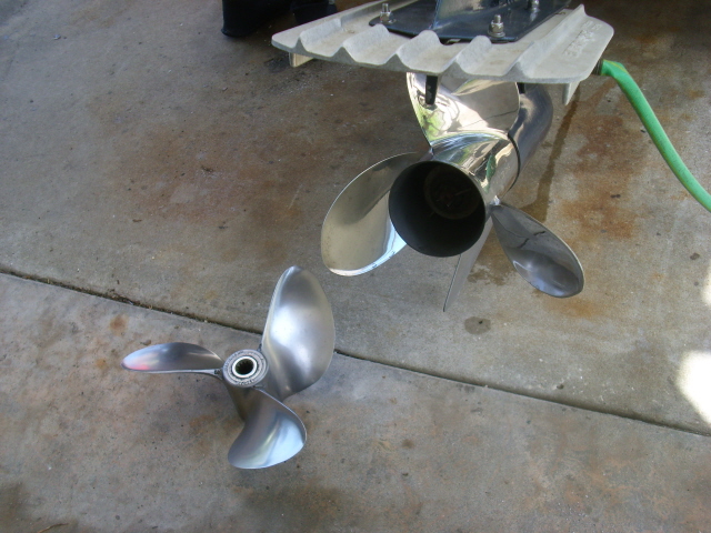

I have a ventilated 13 1/2 x 22 Lightspeed that's a very good prop. Recommend one to anyone. For some real fun getcha an overhub like the SRX?
The twins:
