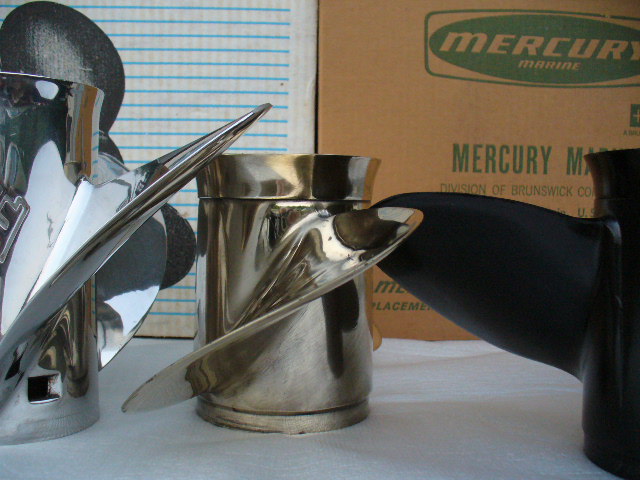

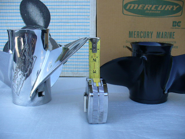

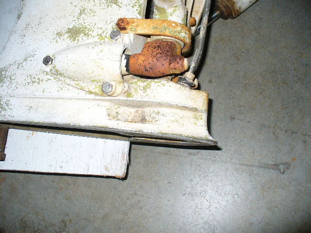

Hi All,
I had the camera out taking pictures to add additional items to our website, so I thought a few pictures would help me better explain what others and myself are trying to explain. The first two pictures show a 24" pitch Laser II on the left and a 23" pitch factory cupped aluminum 3-blade approximately 1972-76 vintage. Using a tape measure and eyeing it, there is a 1.5" difference in the blade length due to the greater rake and blade profile of the Laser II. This is what carries the bow.
Profile Picture:
Re:Nauticus Smart Tabs 16 years 4 months ago #10593
Well, that was the first time I remember adding a picture since the new site came on, so obviously I only posted one picture. For the next picture, I had a '60's 23" pitch Mercury bronze 2-blade propeller out to take pictures of anyways so I decide to compare it as well (this should the same as the 2-blades that you have Frank, and would very similar to the correct props for Ron's 1962 Merc 700 FGS). As hopefully can be seen, the bronze 23" has even less than the '70's vintage aluminum 3-blade. Jer's 3-blade bronze would similar to either the 2-blade or 3-blade depending on it's true vintage.

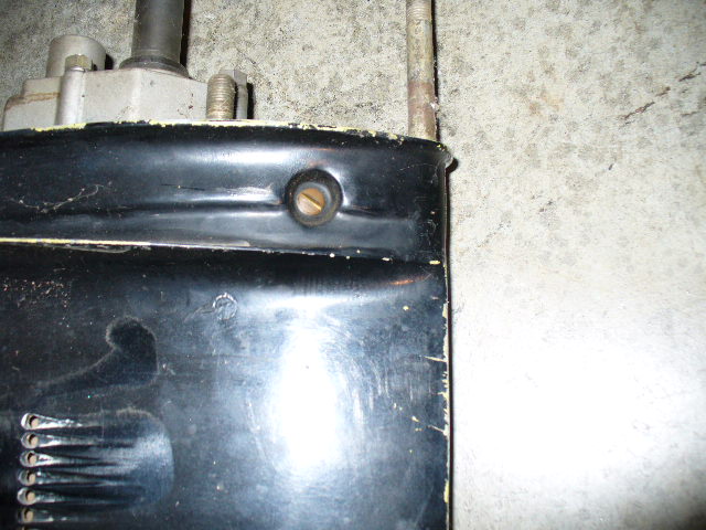

Re:Nauticus Smart Tabs 16 years 4 months ago #10594

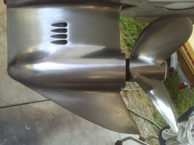

The next picture is of a 1962 Merc 700 FGS driveshaft housing (also referred to as the mid-section or tower) without the gear housing (also referred to as lower unit or foot) installed. This section would create a tremendous amount of drag if in the water stream exiting the boat's transom. This does make every planing hull boat with a motor thus mounted porpoise that I can remember. Frank's Merc 1000 would have the same part number driveshaft housing as the one pictured.
Profile Picture:

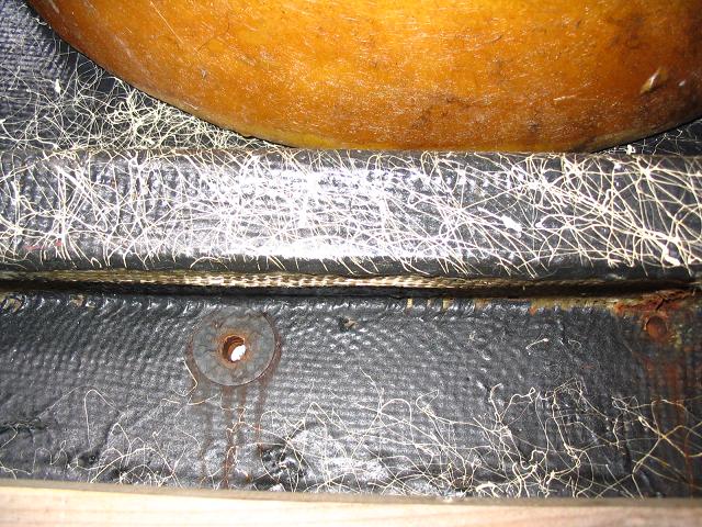

Re:Nauticus Smart Tabs 16 years 4 months ago #10597
For the final picture, I shot a picture of a 1963 Merc 1000 gear housing assembly (Ron's 1962 Merc 700 FGS gear housing is very similar if original). I wish to point out that there is a section of the gear housing case between the driveshaft housing mounting flange and the bottom of the ventilation plate which is less blunt, but often still causes porpoising if in the stream exiting the transom. Some believe that if the outboard is mounted such that the bottom of the ventilation plate is flush with the hull bottom that the described area is not in the stream. However, the water is trying to fill the hole made by the boat, and the water travels upwards at an angle, thus striking this area. I personally have rigged a performance boat (that we had previously sold others before of) with a new design motor recently introduced, mounting the motor elevated above this flush point by a noticeable amount (I do not remember exactly, but I will guess 1/2"), and when tested found a bad porpoise. On larger Mercury models starting in 1984 & '85, there are 5 sets of holes one can select from without redrilling new holes. These change the height by 3/4" per hole. By just raising this particular outboard one more hole up, the porpoise 100 percent completely disappeared.
Frank, I think that you need to try a high rake prop, but I am concerned that you may have to raise your motor, and possibly shift the weight to get to where you need to be. Going to saddle tanks would be ideal, but the engine height and propeller should be tested first, as moving the fuel tanks may prove unnecessary. Unfortunately, with the motor trimmed under and the smart tabs, it is impossible to know your motor's true RPMs to determine the pitch needed. Dave has offered the use of his 20" pitch, and it should be close enough at worst to determine what your true RPMs are after solving why the start tabs are needed.
Profile Picture:

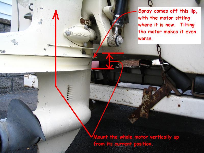

Here's a pic of my motor in a vertical position showing the cavitation plate above the bottom of the hull. That's Brian Lawson taking a look and from what I remember giving it his "stamp of approval."
How far up should I go Michael? An inch? Two? At some point I might run into the cross-brace that supports my custom splash pan. I'll have to take a look. I could take another pic later today maybe if this one isn't sufficient. Moving the motor up is at least affordable, but then I have two 3/8 bolt holes to fill! :(

Re:Nauticus Smart Tabs 16 years 4 months ago #10608

Re:Nauticus Smart Tabs 16 years 4 months ago #10616
Frank
when I ran into this issue I had to raise my motor 1 " above the sponsons, each hull is unique to dial it in
I use whats called rev sticks to find my optimum height
1/4 thick wood strips placed under the clamps, and I jack up the motor 1/4 inch at a time, till I start to loose water pressure then I drop it back down a 1/4
this may take care of the porpoising, you will gain speed, & then you can dial in a prop :lol:

Re:Nauticus Smart Tabs 16 years 4 months ago #10622
yes Frank watch the tell tale,
Now keep in mind this is a starting point you may find that due to a loaded boat ,water pressure loss from turning, triming etc you may need to drop it another 1/4 to maintain good water flow(if you have a water pressure gauge watch it closely when first testing), but this method will definitely get you up to optimum height

Re:Nauticus Smart Tabs 16 years 4 months ago #10644
  • Kerry
  • Posts: 675
  • Karma: 51
Frank- Looking at the pic above, you can raise up to 2" before beginning to "uncover" your water intakes- remember, water coming off the transom angles upward. You shouldn't need that much, but can rest assured you have a margin of safety for water pressure. I hate to mention anything that costs serious money, but if drilling more holes is taboo, what about a manual transom jack that uses a ratchet to raise/lower the motor in small increments? Lets you do a lot of testing without pulling the boat out of the water every time.
