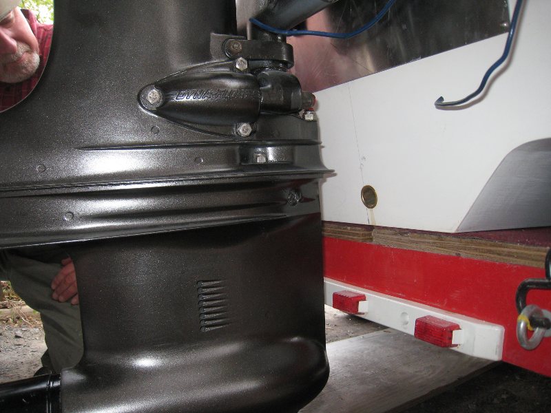

Here's the problem with raising my motor at all Michael. I drilled all the bolt holes to be at the bottom of the slots. In hindsight, very stupid, but I bet I did it to avoid the crossmember under my splashpan and the stainless transom cap (for the trim brackets). That hole in the trim pump mount you see is to access motor bolts. If I up 1/2 or 3/4" I'd probably have to fill the old holes with shredded mat and resin before I could drill new holes.
I got a 17 pitch 3 blade prop coming from a buddy down in TX, should be here Monday. Got a buddy here lending me a 15 pitch 2 blade brass race prop too. I think that 17 pitch might do the trick, but what do I know? I'm gonna try that first anyways. In the meantime I'll do some more research on how I could get that motor up without spending more than 10 or 20 bucks.
Frank

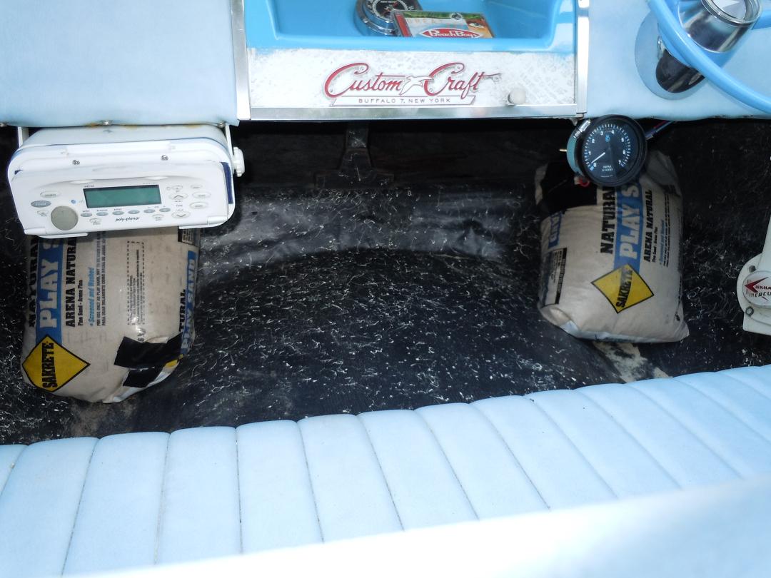

F - Man, you ask for help you're gonna get it here! Been checking in and seeing how it's going. Here's my thoughts on what I've read.
1.) Sand bags - bad idea. OEM didn't need ballast, and neither do we.

1. Sand bags are coming out, already made that decision. Danny had suggested weight in the back might help, so I figured it was worth a try.

Re:Nauticus Smart Tabs 16 years 4 months ago #10701
F. I think I suggested before, but you may have missed it:
When we were looking at the motor at Silver, Tim suggested that you get the correct diameter prop for clearance on you trim tab. A smaller diameter prop will work the same as a smaller pitch in upping your revs, which you need. I would try a 19P of the proper diameter.
I also noticed that you had the motor trimmed in too far in that video taken from the shore.
I know you may not like to hear this, but I think others are suggesting that you remove all the bandaids, (trim tabs, sand bags) and do the best at setting it up before you resort to these sorts of things.
For what you want, these may be the best solution, but you won't really know unless you try all the other options first, (without the tabs influencing the results). :)

I AM taking the sand bags out if you read my response to Brian just above here. Unhooking the trim tabs is easy. No need to remove all the hardware mounted on the transom, just pulling the tabs will do the trick.

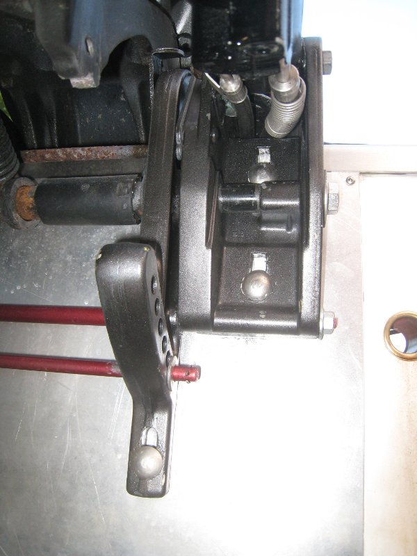

if you have a brace in the way of motor mounting bolts , get 4 pieces of aluminum "L" stock and make an adjustable jackplate, you can bolt the Jackplate where ever you need to and raise that motor to the desired height your hull will also benefit from the set back created by the Jackplate
the sand bags and trim tabs need to be removed or disconnected as stated above, to get true results
you wont be screwing around with raising the motor height...you will be screwing around if you dont address it
good luck
Re:Nauticus Smart Tabs 16 years 4 months ago #10708

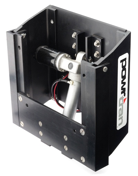

How would I run my PT&T if I did that Michael? Got any pics of one? I'm pretty handy with metal fab, but would need to know what sort of aluminum and thickness to buy. Actually I have an old Power Tran unit at home, but the tilt stuff doesn't work (needs a new ram, out of my price range). I think it has adjustment, but maybe not much.
Frank
This a pic of my unit from their web site: www.powrtran.com/ All the aluminum is in good shape.

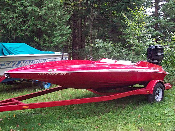

If I only had about 5 grand, this is what I would be driving:
HYDROSTREAM VECTOR 1979, 2.4, 200HP, foot throttle, Livorsi gauges, new paint & interior, 85+HP, $4800
Somebody has no doubt already figured this boat out. I could test drive it, buy it if I want. I could get a loan, but I decided a long time ago, no loan or credit cards for toys, cash only. Being an old Hydrostream though, it probably has its own problems.

Re:Nauticus Smart Tabs 16 years 4 months ago #10725
Frank:
As we discussed, your mounting height is perfect as it
is. The only reason to go higher would be if your goal
was top end max speed, and you would be sacrificing all
low end take-off, and driveability you are looking for
in your boat. All the guys that are jacking up the motors
are not looking for a boat that you can take your wife out
in for a nice boat ride, which from what you have said is
one of your primary uses for the boat.
Frank
