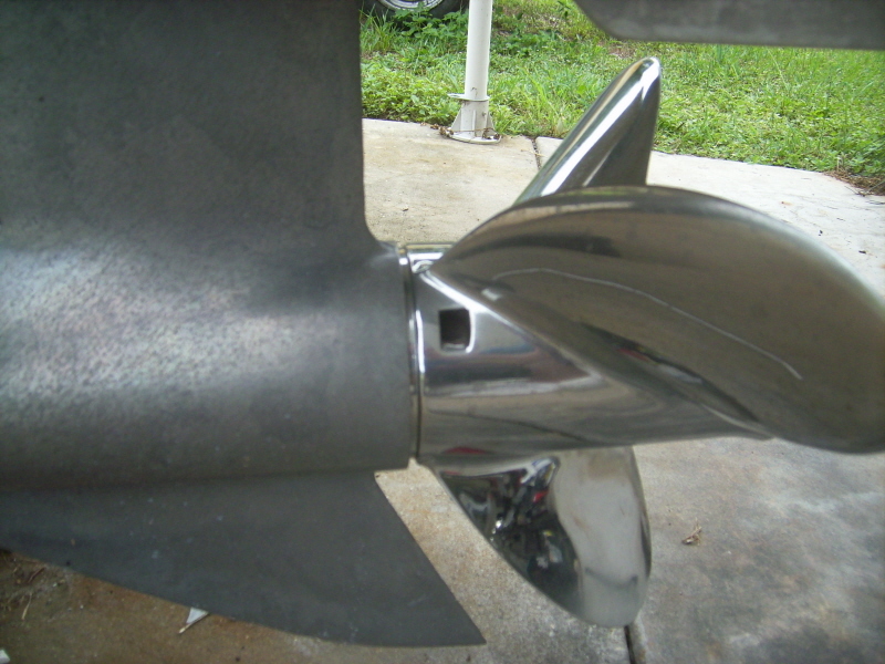

Frank, I found a pic of the "vented" props where you can see the vent holes in the last pic.
forum.cgoamn.com/index.php?topic=1444.msg15654;topicseen#new
(At least I THINK that's what we're lookin' at)

V153- can you take a side pic of that Lightspeed prop to show Frank what vent holes look like? Frank- Don't need to buy a new prop. Vents can be added to any prop using a drill. Proper size and location are very important, you can't just drill too big, or prop will become a blender- spin fast, but go nowhere. Get all other tinkering done, holeshot should be last issue when all else is running and working as it should. BTW, just a random thought, but when you hooked the motor controls up, did you look at the carb butterflies to verify fully open? Got bitten by that one once, drove me nuts until a mechanic asked about it and found a linkage wasn't properly adjusted. Just asking.

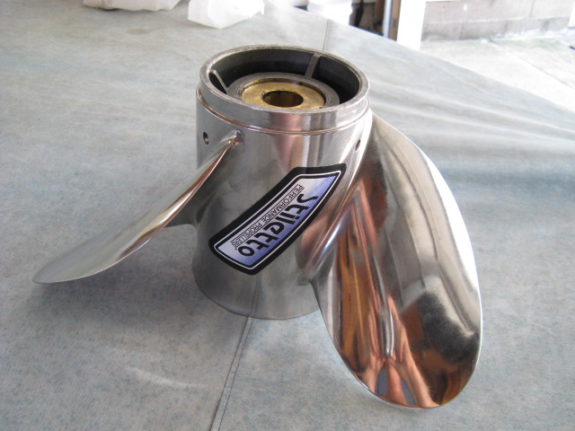

Kerry, I went back and posted a pic of that Stiletto, is that the vent holes you're talking about? (That one's for sale = $250 and it fits a Merc, I believe.)

Yes. The vent holes are the small holes just behind the top edge of the blades.

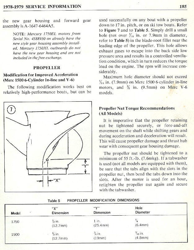

Here's a pic of the vents in my Lightspeed. I've seen round vents square vents large & small. Some manufacturers supply rubber plugs to "un" ventilate the prop as well.
Re:Nauticus Smart Tabs 16 years 4 months ago #10464
The theory behind ventilated props: When you come off idle exhaust is forced through the holes. Effectively aerating, 'cavitating' if you will, the prop. Thus allowing the revs to wind up quicker. Once you plane out & reach a certain speed the effect is negated & all exhaust exits through the hub.
I see no reason why someone shouldn't attempt drilling their own vents. That's all they are anyway, just holes in the hub. You can always plug em up? Mine are centered 1 1/8" behind the edge of the blade & 7/8 in from the front of the hub.
I feel your pain about pulling the trigger for the right prop. I monkeyed around for months trying to find a good match. Still looking for that "perfect" prop btw. Heh heh.
There are a myriad of props out there these days. But for good holeshot, awesome midrange acceleration, and respectable top end I highly recommend a Lightspeed. Plus ya can pull a killer wheelie ...?

Excellent explanation, Doug. Myself, and others, have vented props for some years now, generally found: 1/8" holes to 19" pitch, 3/16" for 20-23", 1/4 for 25+" to be effective. One older fella didn't like it, so epoxy filled the holes. BTW, ever consider one of those Torque Shift props sold by Land & Sea some years back? I remember an article in Powerboat Magazine with an 18' Hydrostream tunnel and 150hp Yamaha V-6 that had one set up for 26" max and 9" (!) minimum that would prop walk when they punched it!!!!
Re:Nauticus Smart Tabs 16 years 4 months ago #10470
I might try this with the 3 blade bronze 21P i have...like you said, worse case, it sucks...i can just epoxy the holes closed.
Ill probably start with some 1/8" holes and see how it responds and maybe open them up slightly more if it does well.
Out of curiosity, since you seem to be well versed in this...what RPM should i be shooting for from a dead stop when going to WOT? My 1350 seems to have a flat spot around 23-2500ish RPM that it really struggles to overcome till the boats fully on plane...then it MOVES!

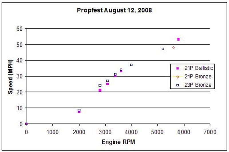

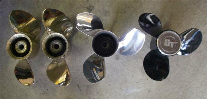

The two best props I had with my inlines were the Ballistic and the Laser II, in that order. The latter had vent holes such as the Lightspeed mentioned earlier.
Speaking of vent holes, here a document you might be interested in. This happens to be a vintage Mercury publication.

The vent holes WILL help with holeshot. Try 1/8 first, if happy, great. If not, add 1/16 at a time until grin happens. Having a prop shop beat more cup into your prop is cheaper than a new prop and will help lots! Especially with that transom height. Any venting and/or surfacing that introduces air to the prop (controlled cavitation) needs lots of cup to "grip" the mix. Picture the props above, and modify yours to come as close as possible, within limits of the bronze. With the vents and more cup, invest in extra toothpaste to get those stubborn bugs off your teeth. :lol:
