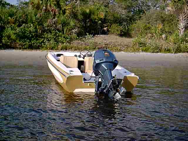

Ferguson_Poole wrote:
Hi Danny,
I do not believe we have ever met, but we did sell Bob Brown's The Avenger Boats for about 20 years. What a first class person to do business with!
I have studied Frank's picture several times, but in the end, I cannot tell what the true engine height is. I do agree that if it is at 1" above, that raising the motor should not help.
Best Regards,
Joe Poole, Jr.
