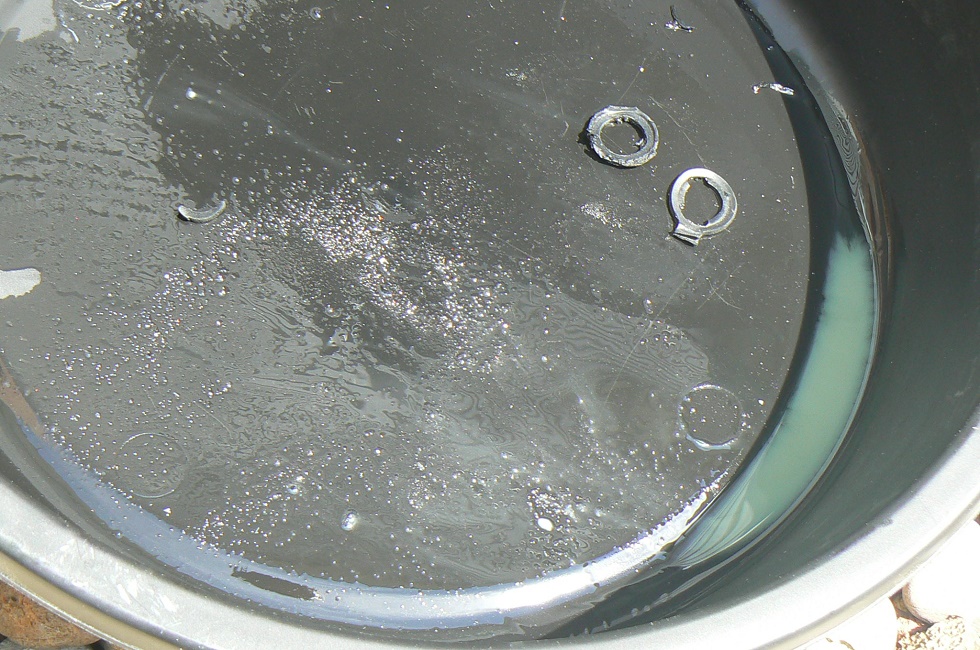

Well took friends out a couple weeks ago and had to be towed back by Boat US, thank god I had the towing! Had to be towed form Port Kinsale back to ST. George's Island ramp, probably $500 worth!
Anyway, switched fluke tanks and ran for 5 minutes then died. Had a boat tow me to the Port Kinsale dock. Tried everything and it wouldn't start. Would crank like crazy then die off when it tried to fire. Even back fired a few times but now joy, towed home.
Finally got to work on it today, checked starter and battery both good, checked points just to make sure, reset the gap. Carb looked good, clean lines, no joy. Fuel pump was rebuilt at the beginning of the season. Decided to take it off and look at it. This is what came out.
Yep that 's not good! LOL That is the figure 8 gasket from inside the fuel pump. Last one looked like that after only one season also.
So new figure 8 gasket and new intake manifold gasket on order since the other one didn't want to come out without tearing a little, gee go figure. Going to go to a direct line to fuel filter, to the fuel pump now. Also looks like I need to incorporate a water separator too.
Oh well good excuse to get back to work on the Century until the parts come in.
