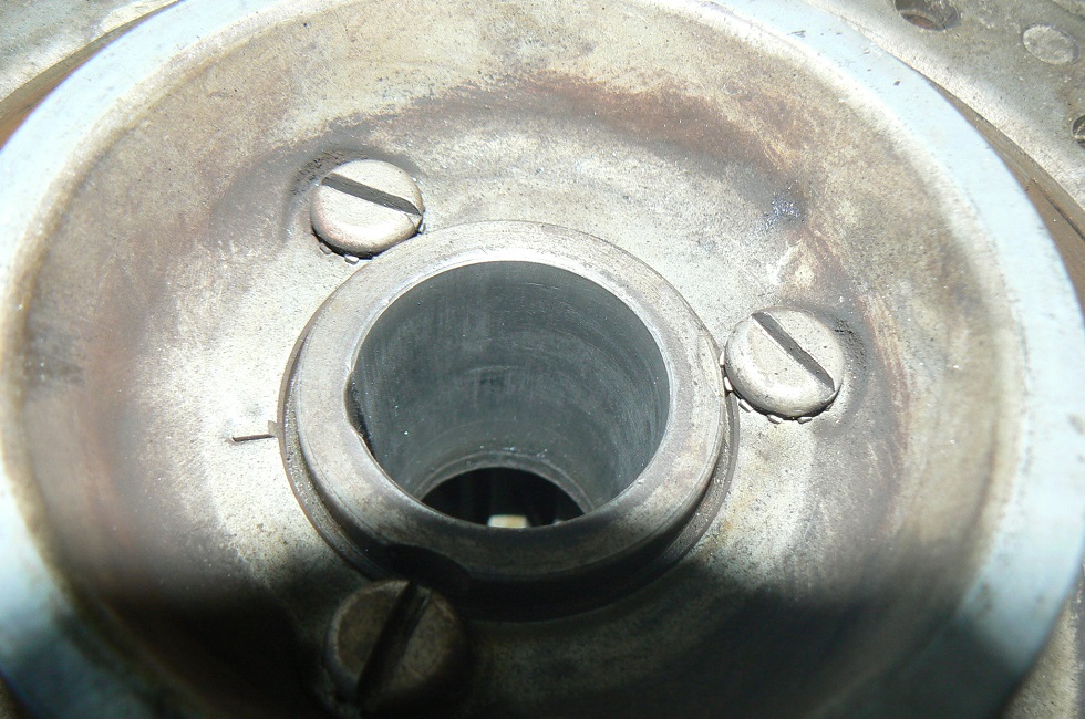

Wow thanks for all the help guys. Yeah I have to agree it's starting to look pretty bad. From what I can tell it looks like the '67 flywheel was a one year only deal, gee go figure, that's about par for the course with this thing! lol
Vintagerunner yep that's the one, problem is I can't get a real good look at the keyway to make sure it isn't in the same shape mine is. I'll have to try an contact them.

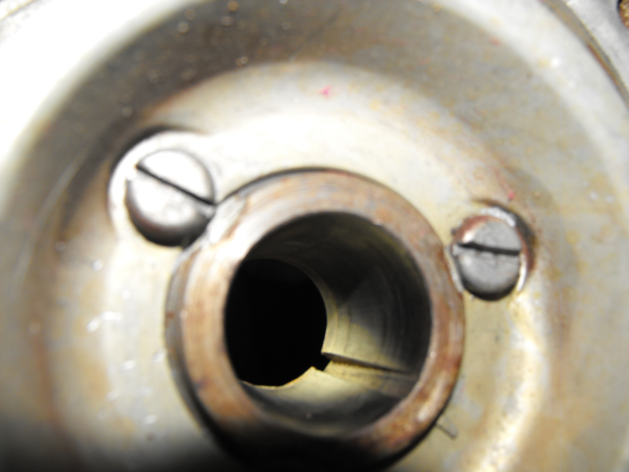

Bob....looked at the bluish green "evinrude" that turned out to be a Johnson....didn't know they made them in that color....model no. V4L-19M....looks like a 67 from a chart online....posting a pic to see if it looks like yours before I try to take it off...john
Re:'67 80 hp died again "Update" 11 years 3 weeks ago #116179
sorry...should be V4AL-19M

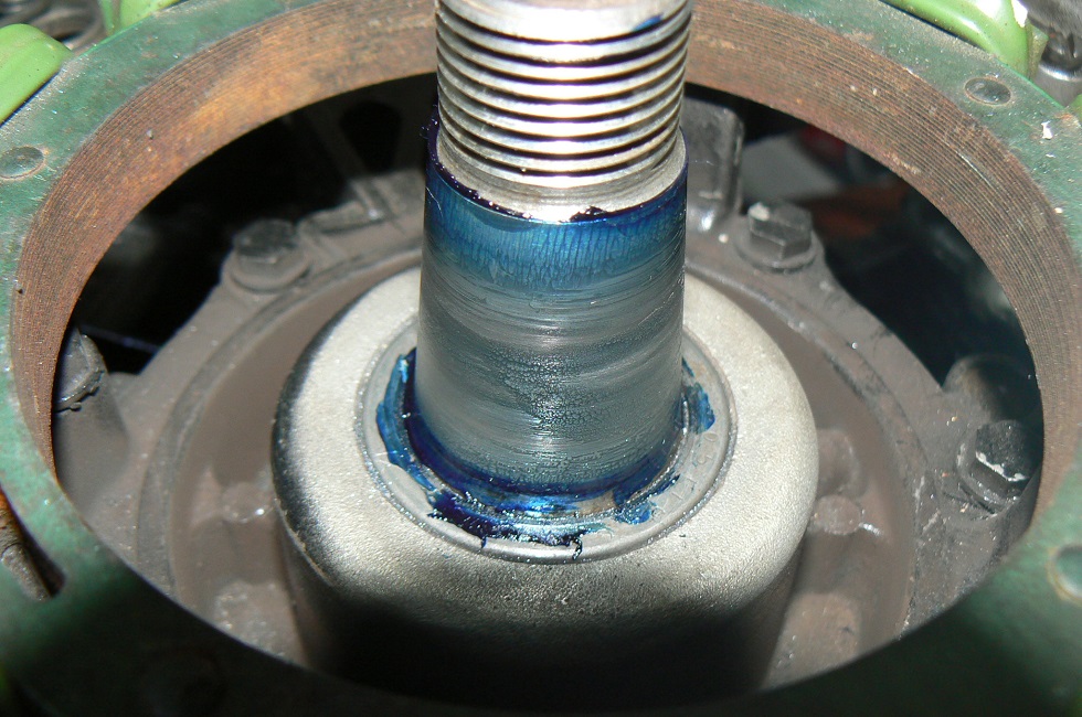

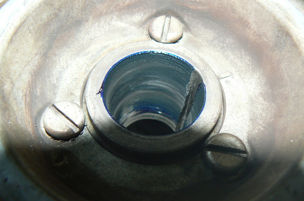

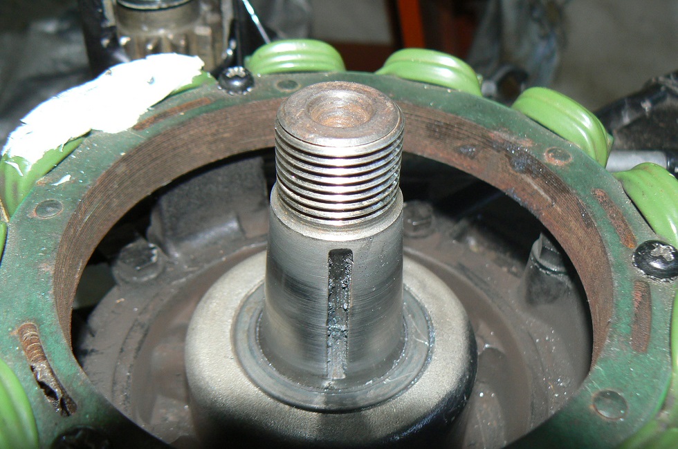

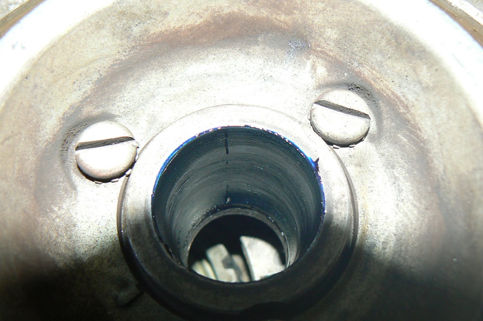

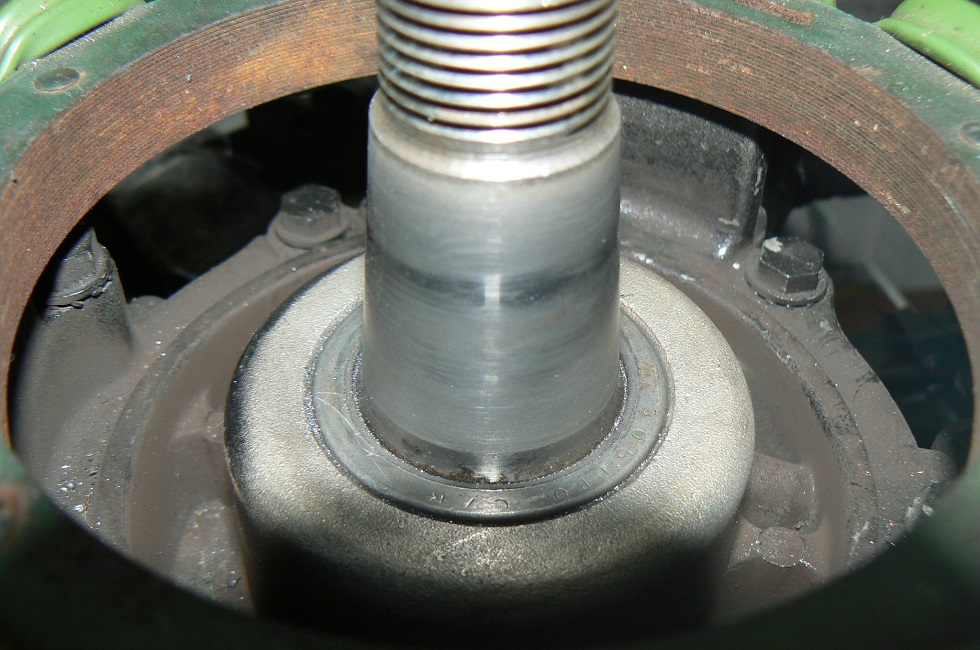

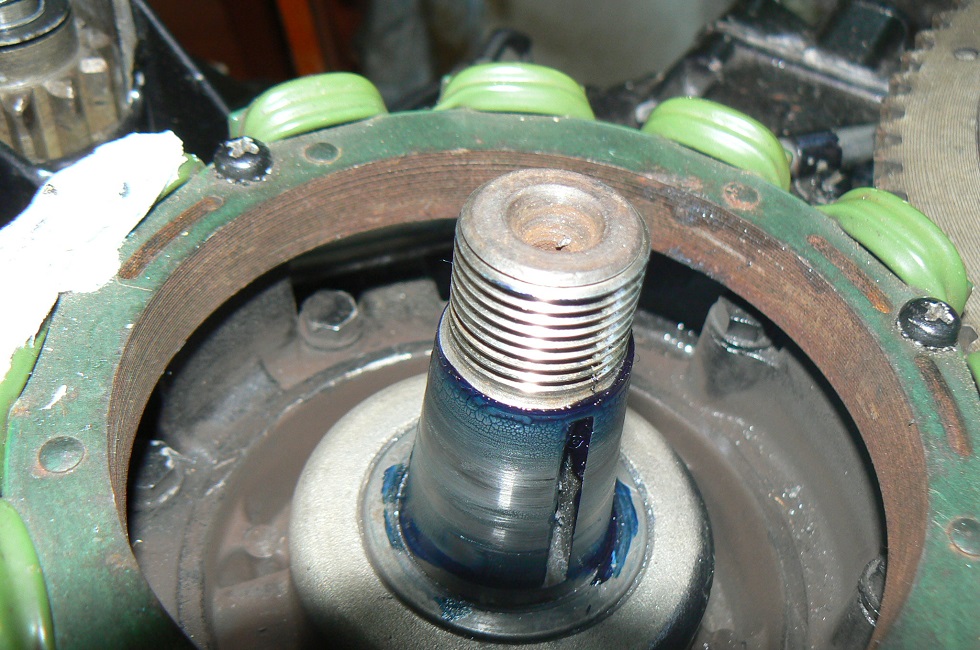

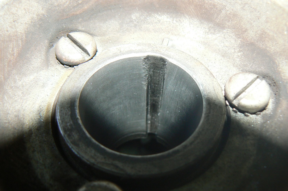

John, thanks yep right one but let's see what the general opinion is on the following pics before we do anything else.
So here are the after lapping and after bluing pics.
I don't think it looks that bad but I'm no expert. Thoughts anyone?
Re:'67 80 hp died again "Update" 11 years 3 weeks ago #116210
still not thrilled with the bottom end of the key way grove.. but thats just me.. looks damaged and widened from the pictures..
Re:'67 80 hp died again "Update" 11 years 3 weeks ago #116212
I gotta agree, damage to the keyway is not good, looks like you are only getting about 2/3 of the holding power.

Bob, crank looks usable to me but I would get a different flywheel, greg

Yeah, that keyway is really, really bad. Time for another flywheel!

bob...I think shes froze....was in with a pile of v4s we bought....I was more into the 75s....will be gone over the weekend....will check it out more Tuesday...john

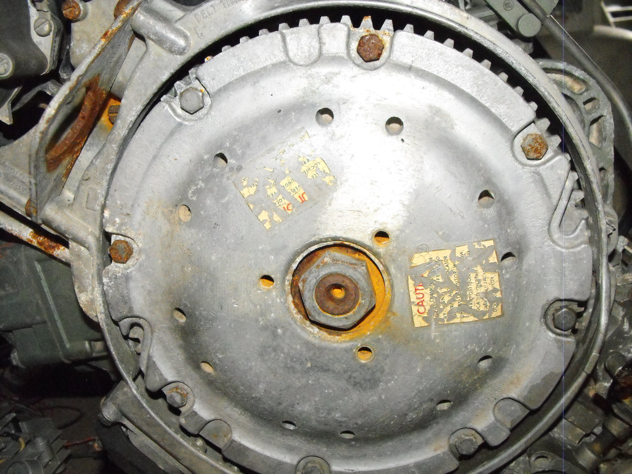

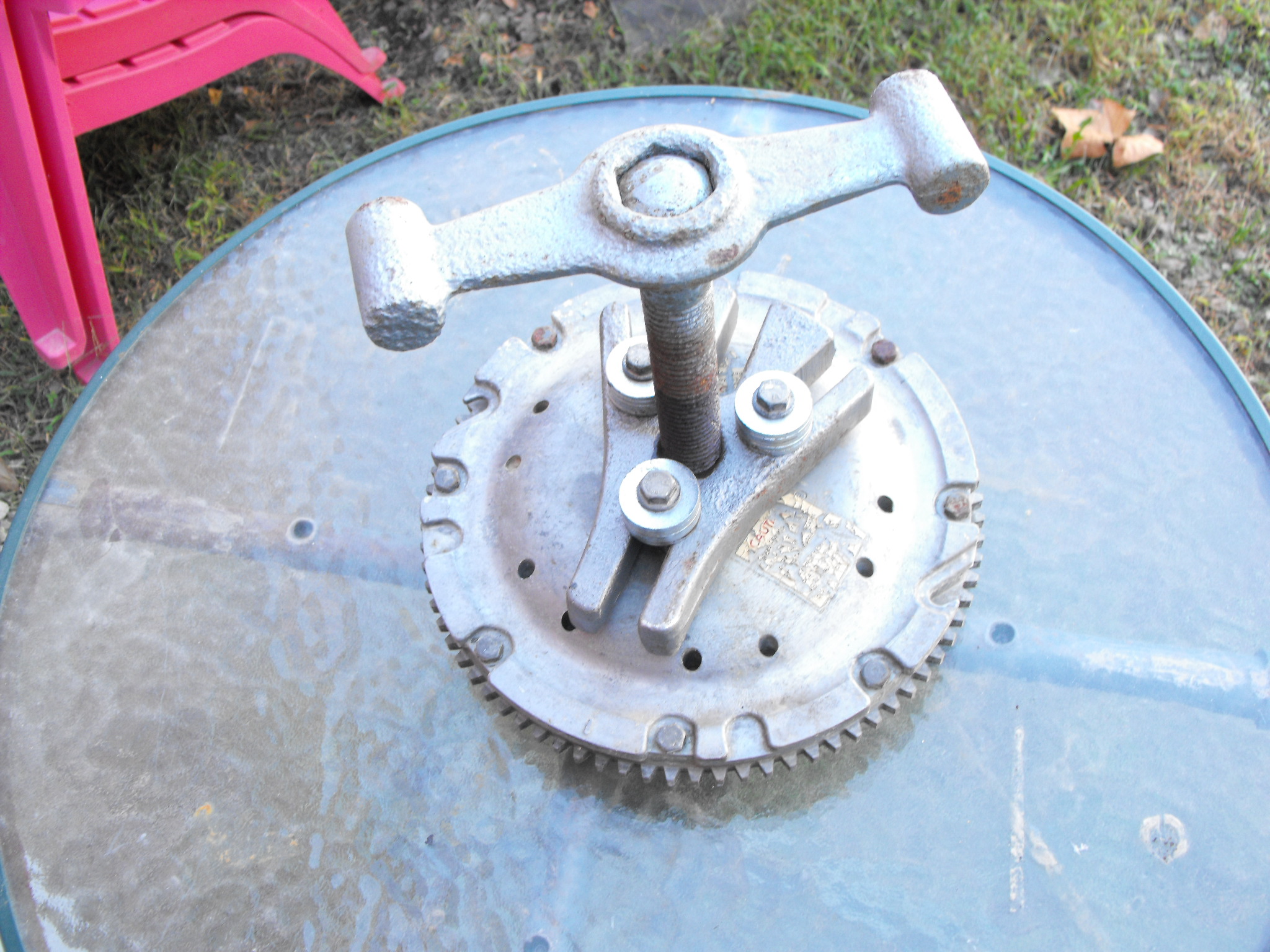

Re:'67 80 hp died again "Update" 11 years 3 weeks ago #116333
well popped right off!!!
Re:'67 80 hp died again "Update" 11 years 3 weeks ago #116334
wasn't as easy to take a pic of my hole as I thought it would be!!!

  • Karma: 59
  • Thank you received: 3
john, looks like a good one. just get a one price shipping box from the post office. greg
It's beautiful! :kiss:
Re:'67 80 hp died again 11 years 3 weeks ago #116348
We got the picture. Looks like a winner.
