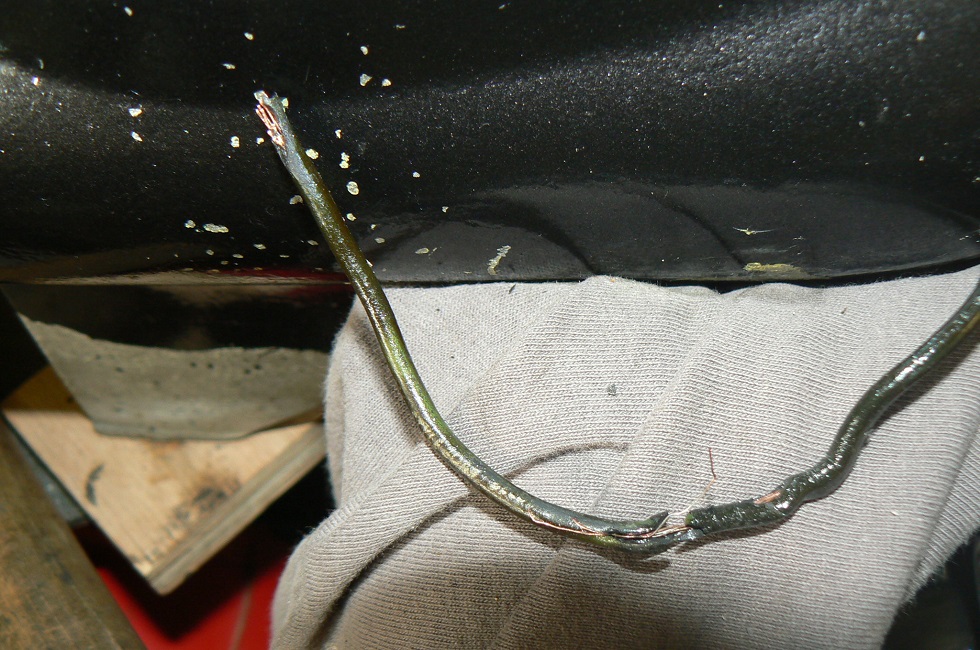

Thanks Ed. Well I pulled the outer exhaust housing and found a frayed wire for the forward gear. Tested it thinking I could have gotten lucky! Nope of course not! Had to drop the lower unit. Drained the gear oil and it was light gray, of course let's add that to the mix!

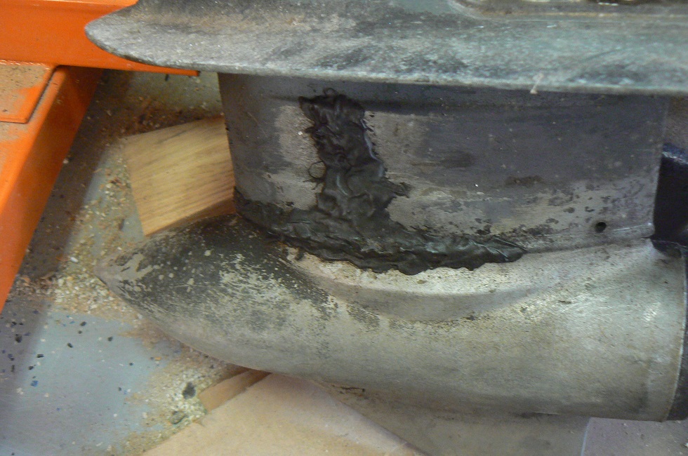

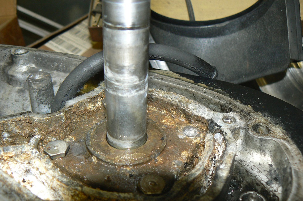

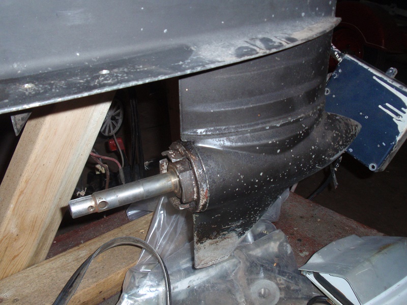

Well I got the prop off and put the lower unit up in the vice so I could start removing stuff. Bot the pump housing off and impellor. Looks like I need to get another one, has a slight set in it and it looks like there's a small chunk off one of the upper tips, about a 1/16" at best but who know where that ended up!!!!
Got to the drive shaft cover and started to remove the bolts and guess what, my luck strikes again!
Needless to say I stopped , got out the propane torch and started heating the lower pump area where the threads are. Well as bet I could anyway. Shot it with some PB Blaster and going to let it sit overnight, because if I don't I know I'll break the rest of them!
By the way, does that shaft look too scored up from the pump?

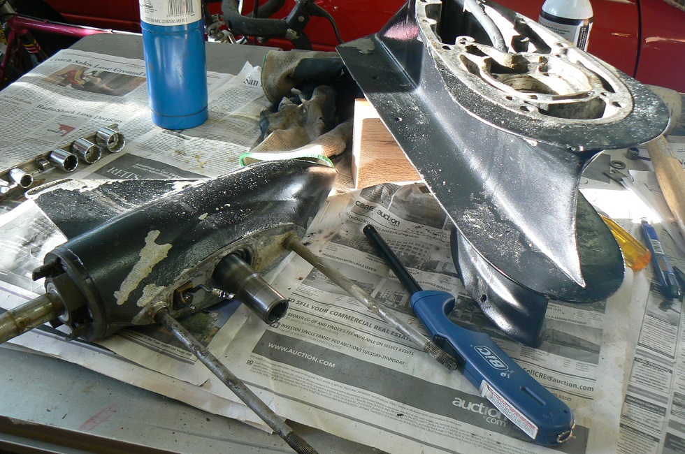

Anyway, just some update pics.

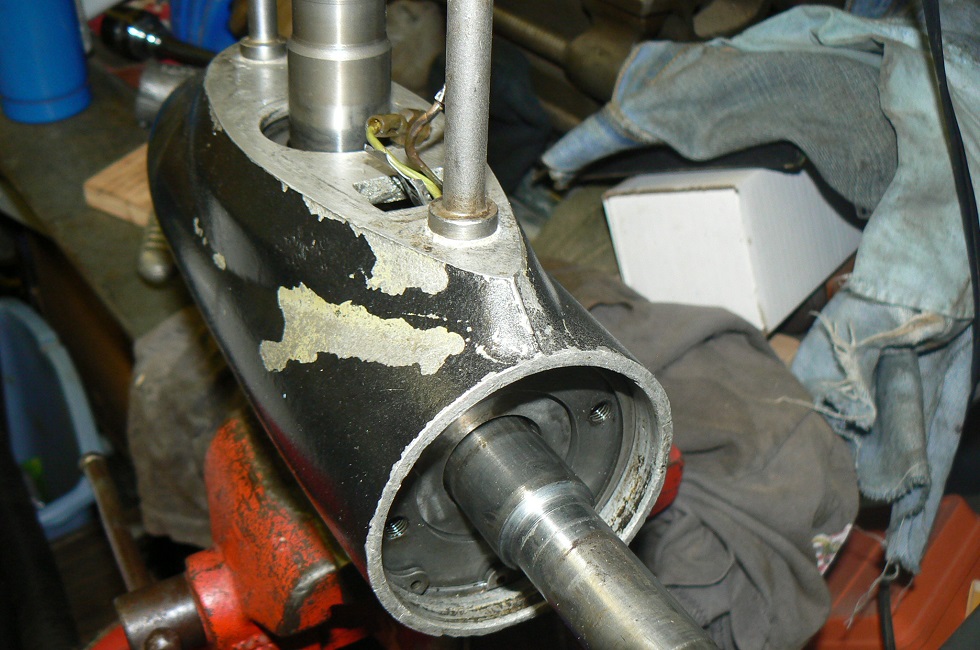

Here's the reason I can't just use the 75hp lower unit.
Well I did finally get the other three bolts out with no incident and the lower is apart.

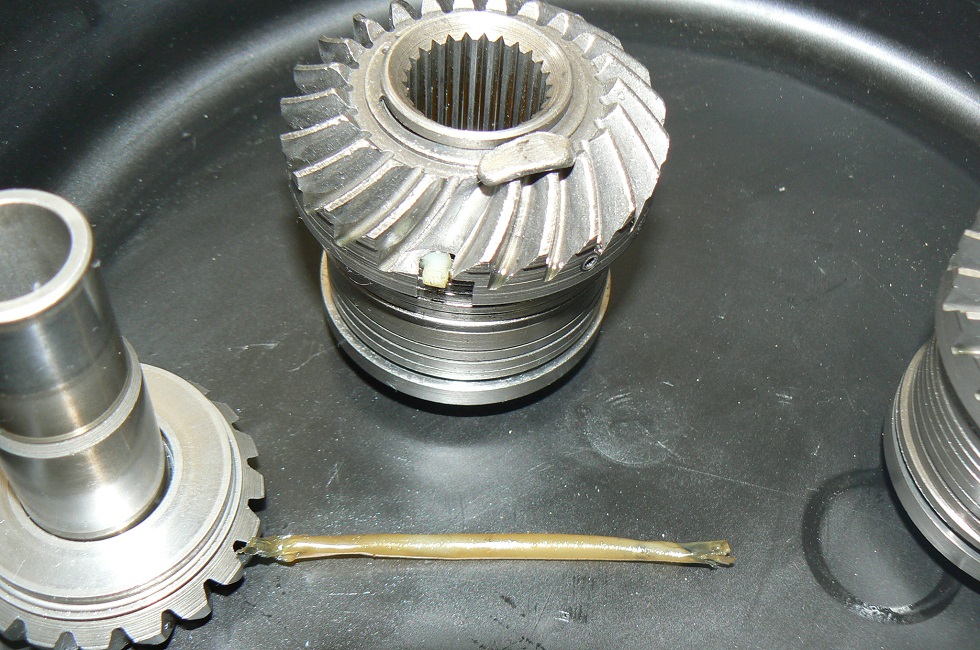

Found metal shavings on the drive shaft tip but it looked ok. Here's what I found on the coil wire retainer.
Yep those are shavings so not sure where they're coming from yet.

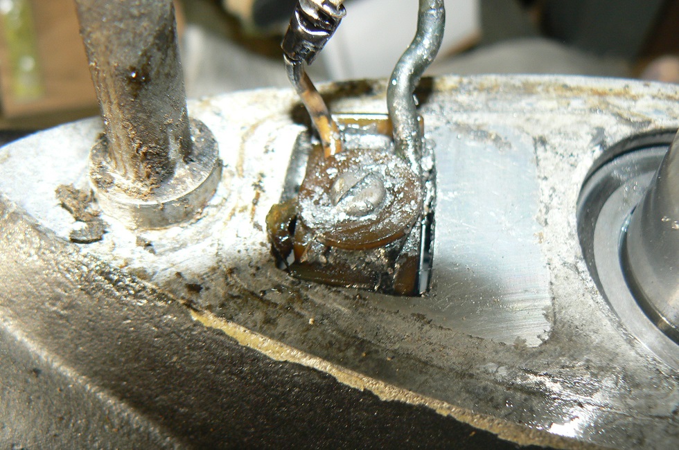

Gee I think this is the culprit for the forward shorting problem.
Slowly pulled it as I was trying to get it apart from the retainer and it came right out! You can see where it's frayed half way and it grounded to the case. Don't know how the hell I even had forward! Obviously it got away from the retainer and the shaft rubbed it. I'm hoping the coil is still good and I just need to reconnect the wire. I may just not bother with the 75hp wire and make a new one that's much stronger using this stuff.

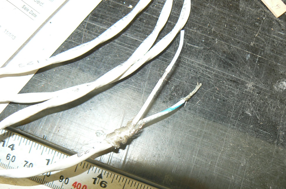

Shielded twisted pair 14 gauge, tinned Polyester coated, aircraft grade. Shouldn't have any problems with this stuff, other than it's a little stiffer than the original. I can reuse the old color sleeves and I think I'll be good to go.
Now I just have to pull the lower apart and be careful not to take my eye out with the retaining clip! lol. I will wear a face shield just in case. ;) The manual pages I found call for a removal tool for the forward coil but you can heat the house for a while and get it to knock loose with a board smacked on the side of the housing. Is this true? What have you guys used to get it out?

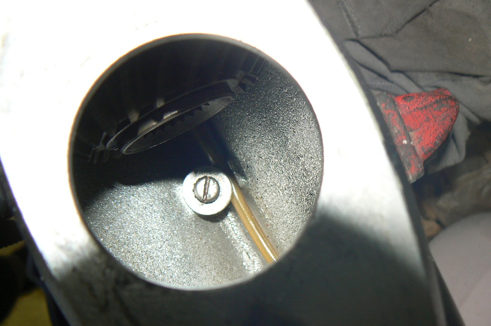

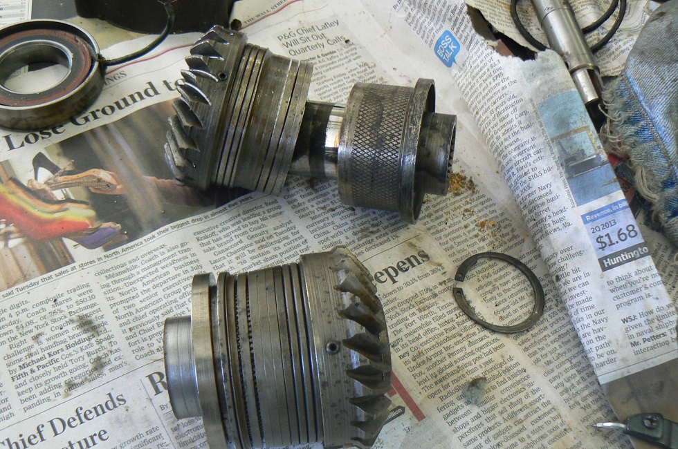

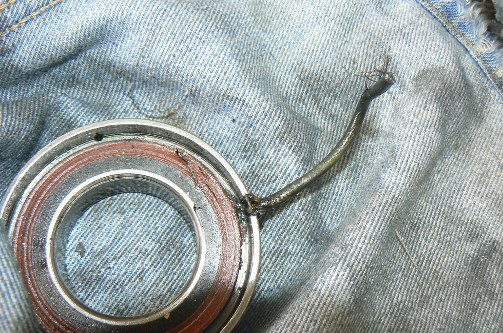

Well I was able to get it all apart and found this as I removed the forward gear.
Apparently that gear has been tumbling around in there for a while!
Got the coil housing out after heating the case as manual directed.
Actually checked good now but doesn't look like it will last long. So I decided to take the 75hp lower apart. Well attempt it anyway. Things were going to well for the day so apparently I needed more excitement and did this with the mallet, full swing at the lower unit!

Well put it on ice for about 15 minutes and went back at it. Unfortunately it still didn't want to pull apart so I hit it with the torch and PB Blaster and le tit sit overnight. We'll see if it worked in a few minutes.
Hey the manual calls for not reusing the nuts for the upper/lower unit. I see they're just nylon locknuts more or less. Can you just use the stainless style and not have to pay $10.99 per nut?

Bob,I reuse the nuts on my bolts. I just take a hammer and tap the top of the nut to squeeze out the plastic nylock very very slightly. I haven't ever had a problem doing this. Better use a pair of needle nose pliers so you don't mash that finger again :( I've done that way more times than I want to remember.

So I got the other lower apart finally, and yep a little water in there at some point so there was some rust keep it from just popping apart, among other things. The forward gear and spring look good but the spindle had some rust in the grooves so I rebuilt mine using the gear and clutch springs and the good spindle.
Took most of the day to get the forwards coil housing out. Had to heat the crap out of it, spray PB Blaster and let it sit. Then heat it again, smack the outside with the mallet, not my finger this time. ;) Still had to bang the housing down on a block of wood making sure to smack the opening evenly, many, many, many times. It did come out though and no worse for ware.
The reason the other coil shorted is because the wire and plastic sleeve came out of the groove in the bottom. the screw and washer that hold it half way came out and then it came out form under the steel protector. I'll take pictures once it's back in so you can see what it should look like.
I have to figure a way to get the coils housing back in though. I'll probably have to heat the housing up again and I'm thinking of using a 2 3/4" washer, with a notch for the wire, across the coil housing and using a 1 5/6" 1/2" drive socket with an extension on it and driving it back in that way. not sure how else to do it since I don't have a press or the installation tool they recommend. Have to keep even pressure across that thing so it goes in even.

SUCCESS!!!!!!!!!!!!
Thanks Cal it worked!!! I was able to get the coil back out finally. Made a make shift puller and it popped right out. Got the gear back in and the coil. Here's a picture of what the forward coil wire should look like.
[img] [img]http://www.fiberglassics.com/media/kunena/attachments/legacy/images/wire_holder.jpg
Yep if you don't have that washer and screw in there the wires is going to get into the gears and your done!
The lower is pretty much back together now, just waiting on the seals and "o" rings. A couple of the rings are on back order I guess.

Funny you should ask. MOST of the stuff showed up, unfortunately the damn O ring I need for the prop shaft cover didn't make it, it's on back order!!!!!!! I think I may be able to match it at the local hardware store, I have to check tomorrow. I was able to get it all back together except for that prop shaft cover. Was a heck of a time getting the 1/4" id fuel hose into the housing where the old wire cable went. Had to shave it some, freeze it then soap up the end to get it into the housing but that sucker isn't coming out or going to leak! ;)
I was able to fish the two wire cable through it then seal it up with seal all. It's just waiting for the cover and some oil and away we go!!!!!!!
Re:'67 80 hp died again "Update" 11 years 2 months ago #114307
Looks good Bob - nice job! Any bearing supply house will likely have an O ring for the bearing head. I would see if you can get a Silicone or Viton O ring. One from a hardware store may be what I call "mystery rubber"- by that, I mean that a lot of 'O' rings sold will not handle solvents and oils. Some 'Neoprene' rings will swell or rot in just a few months time.
