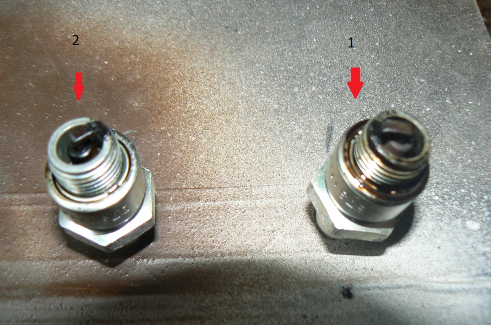

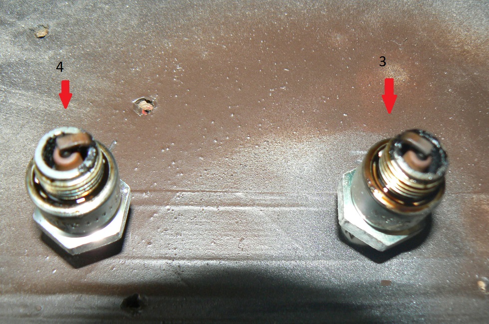

Well I took the cover off the motor today to remove the carb and I found the flywheel nut almost off!!!!! Well after checking to make sure I didn't shear a key again I tightened it back down. Removed the carb and the only thing funny I found was that the intake gasket was ripped through on bank 2 & 4 side. Carb looked fine inside, a couple of little pieces, like almost micro small but nothing glaring. Blew it all out with some air and put it back together. Have to order another intake gasket though. Thought I had one but can't seem to find it anywhere so order it is.
I took the plugs out though and this is what I found:
Unless I'm seeing things it looks like plug number 2 isn't firing, if so not very often. They also seem a little gunky and not sure why, I'm using 50 to 1 mix. Any ideas or comments?

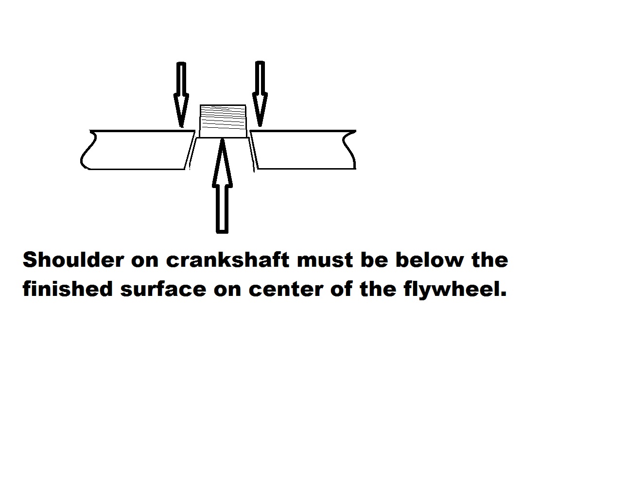

Bob, since this thing has spun so many times, the flywheel bushing may be damaged - or "wallowed" out. Just a couple thousandths of an inch can render it junk. Have you check that the shoulder on the crankshaft snout is below the finished area of the flywheel - where the nut tightens against? I have seen them where the crank shoulder is too near the top of the flywheel, and when the nut is tightened, the flywheel is brought down to the same level as the crank shoulder. This means the nut is tightened against the crank, but the force is not applied to the flywheel surface. When fully torqued, there must always be a gap between the top of the flywheel (where the nut is tightened against it) and the land of the crankshaft snout. If the flywheel drops onto the crank too far, either get another flywheel, or shim the nut with a hardened washer that will clear the land on the crank & allow the nut to clamp the force to the existing flywheel.
Also, you may want to use blue locktite (removable) on the flywheel nut, and us an air impact driver to tighten the nut. I had a chrysler that had this same problem you are having. So I used an air impact driver with 3/4 drive (like one for lug nuts on a wheel) and held the bastard on the flywheel nut till I thought she would bust off. It solved the problem. So now, I always use an air impact driver on outboard flywheel nuts.
I drew you a pic of the issue I talked about here and I'm attaching it here

Bruce thanks. I put the new key in the flywheel slot and it's tight at the deep section but probably a little loose at the very shallow part. Is that an issue in the shallow area? As far as I can tell the shaft is below the flywheel but I really need to check it again. I've lapped the flywheel to the shaft twice now but I don't think it made it too big since I didn't do it for any longer than maybe a minute both times. I'll have to check it tomorrow.

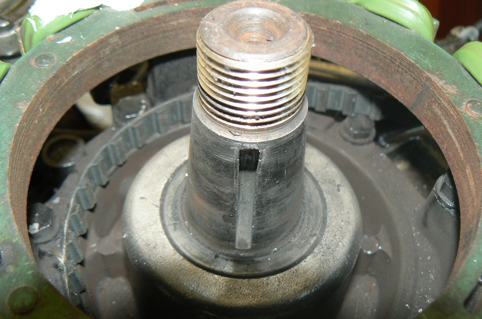

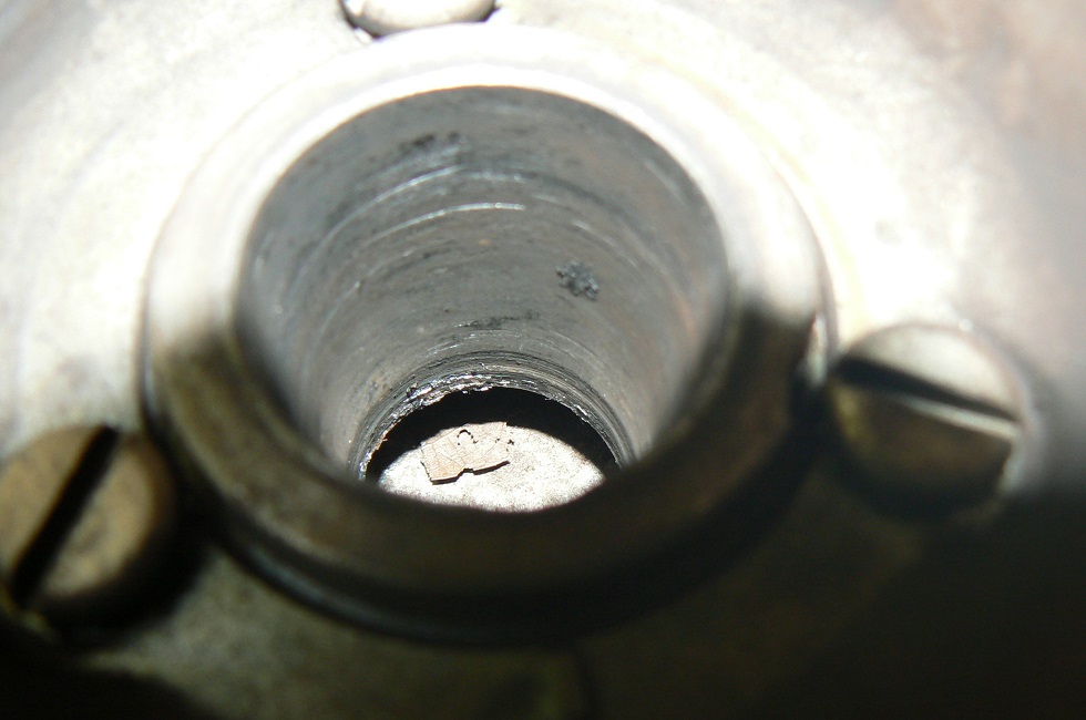

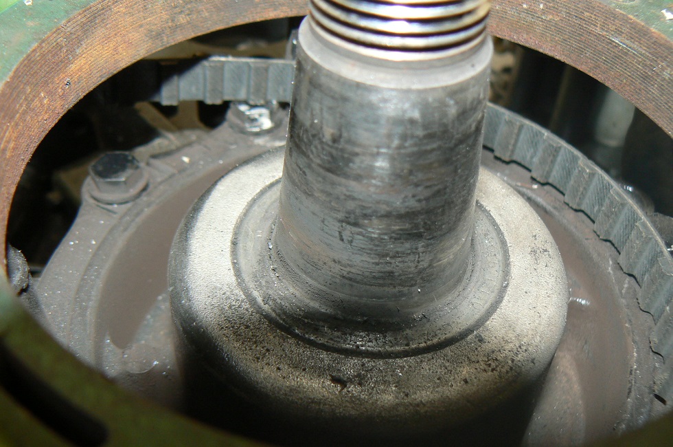

Re:'67 80 hp died again "Update" 11 years 1 month ago #116031
  • Waterwings
  • Waterwings's Avatar Topic Author
  • Posts: 4902
  • Karma: 107
  • Thank you received: 100

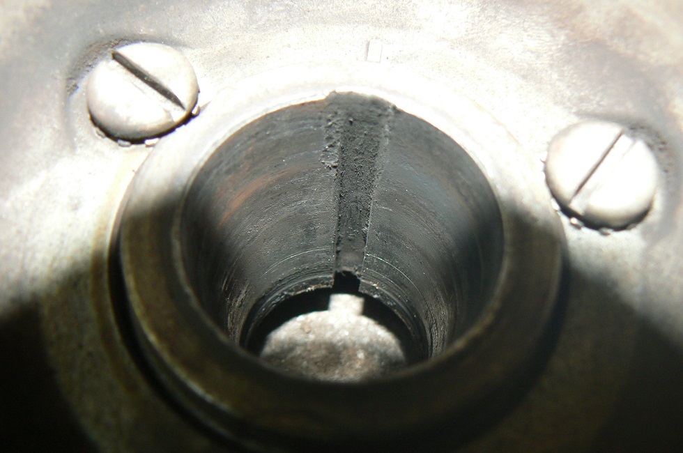

Well here's what the crankshaft and flywheel look like.
So it looks like the keyway has degraded a bit at the shallow end but I wouldn't figure that was enough to make the nut keep coming loose. The meaty end is dine and tight with a new key.
Re:'67 80 hp died again "Update" 11 years 1 month ago #116041
  • ed-mc
  • Posts: 1482
  • Karma: 235
  • Thank you received: 131
IMHO that flywheel has spun too many times and the taper and/or keyway are trashed.
I think you're gonna have more trouble with it unless it's replaced.
HTH.............ed
Re:'67 80 hp died again "Update" 11 years 1 month ago #116043
that flywheel doesnt look in the best of shape.. since you do keep having problems with it and its not a 1 time thing... myself i'd replace the flywheel... and use some Loctite on the threads,,
and i'd zap that flywheel nut with a air gun..
Re:'67 80 hp died again "Update" 11 years 1 month ago #116047
Hate to say this Bob but it does look like the female part is spun out, grooves and all. It doesn't look like you would have to replace the entire flywheel, just the part that screws onto it. Time to start searching :(
