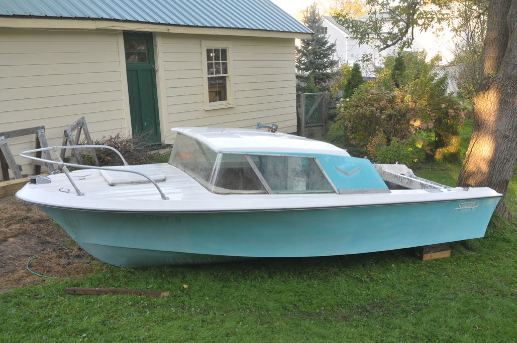

I have a 1960 Seabreeze Contessa (see photo - mine is MUCH better looking than the 1970 one pictured though.)
