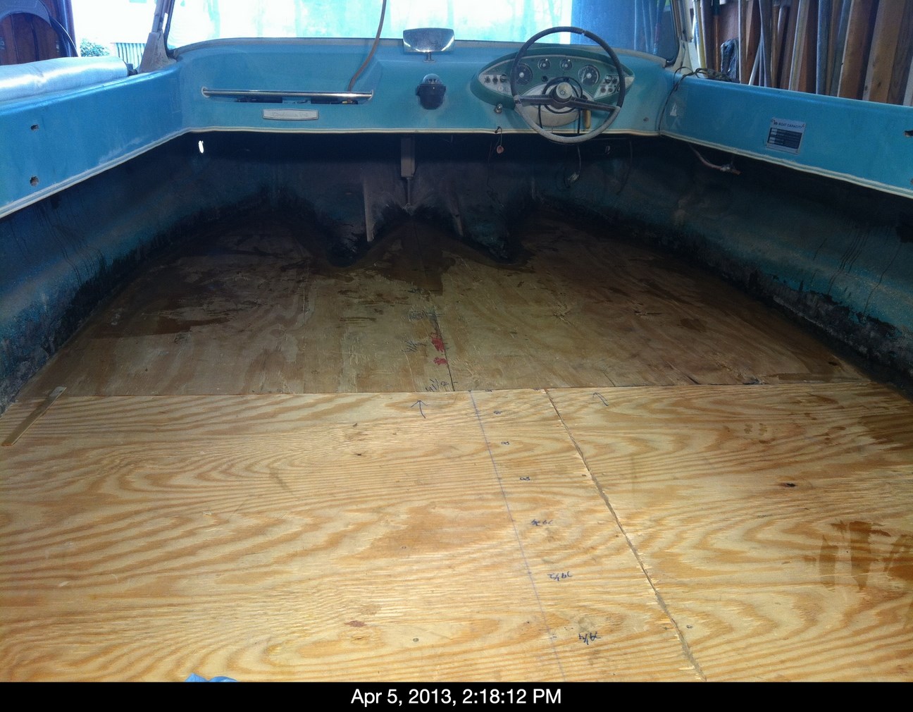

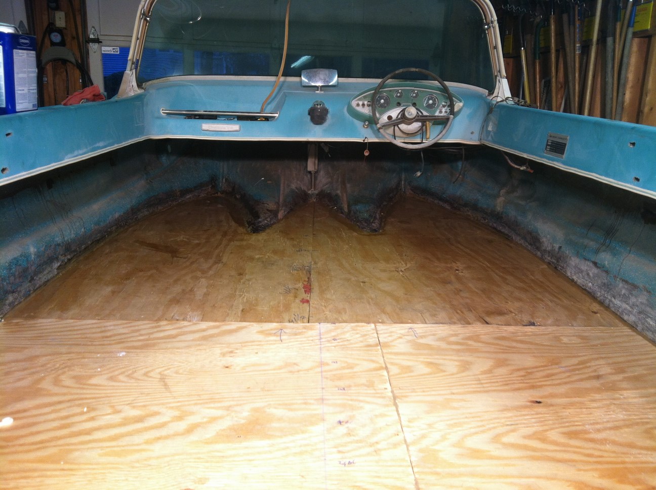

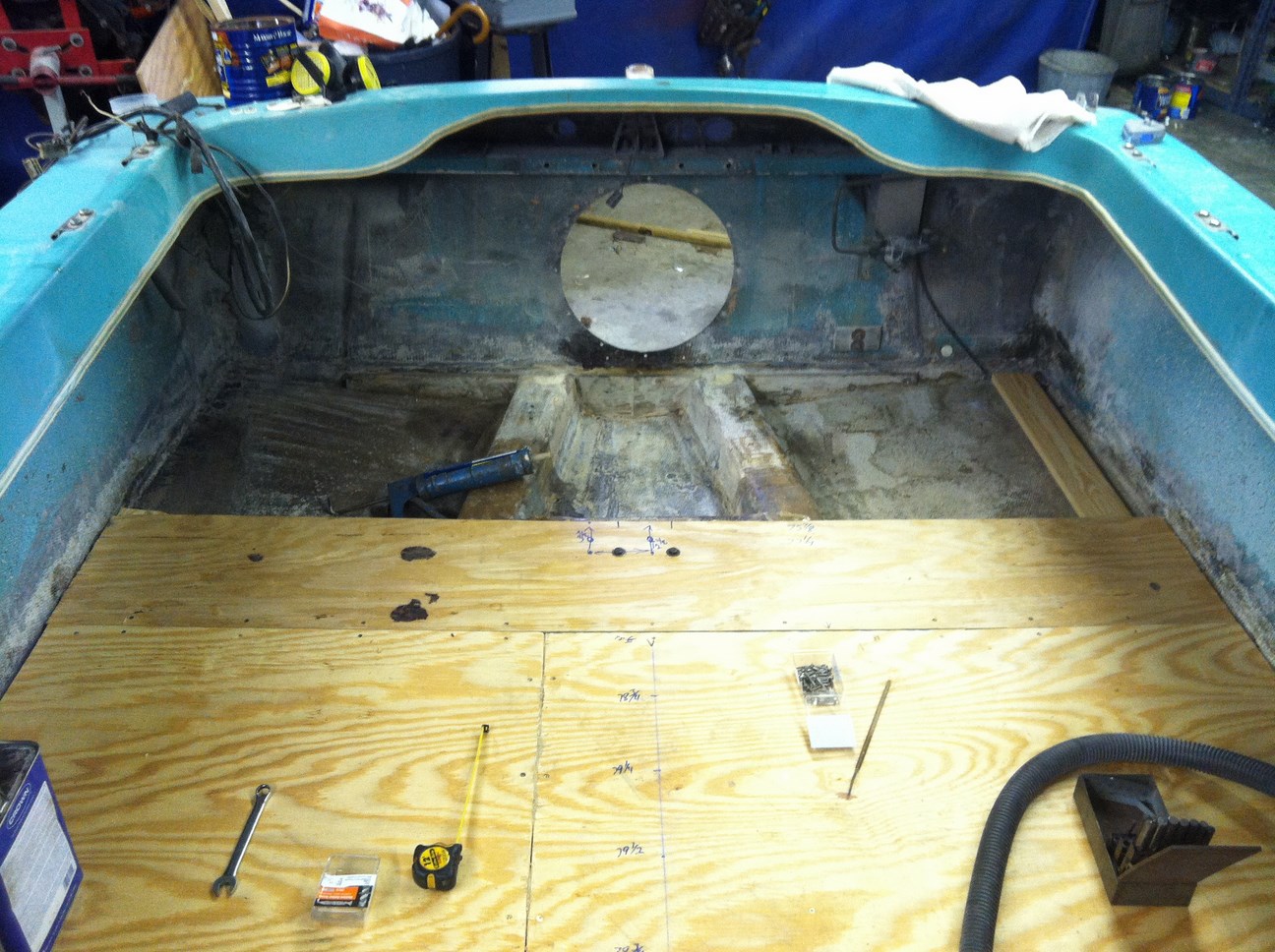

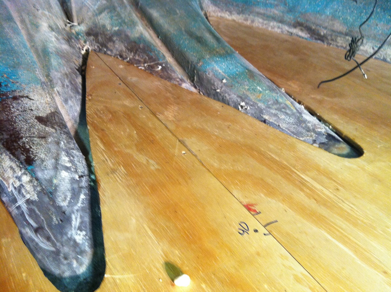

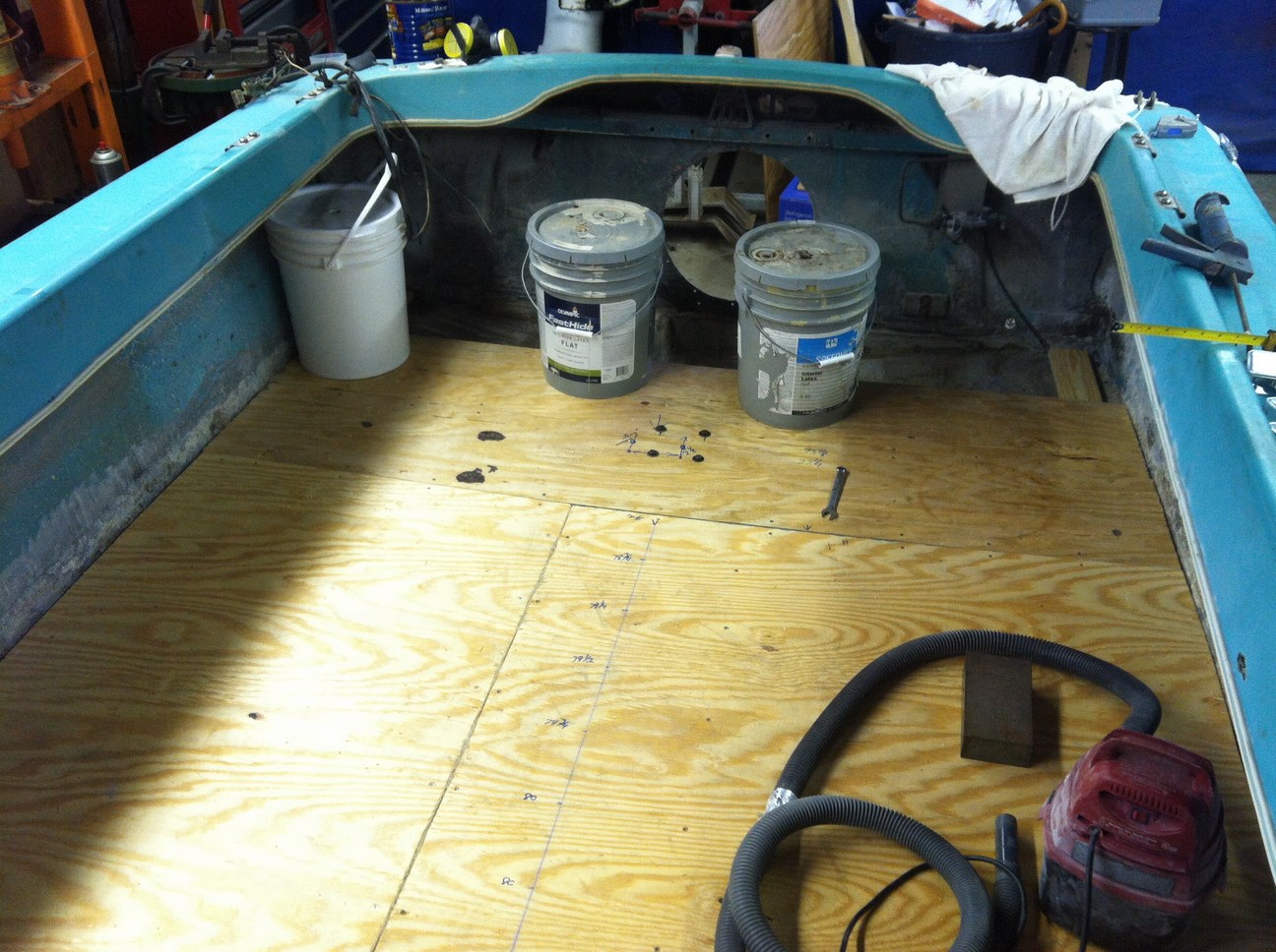

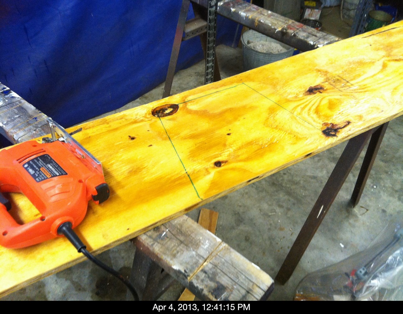

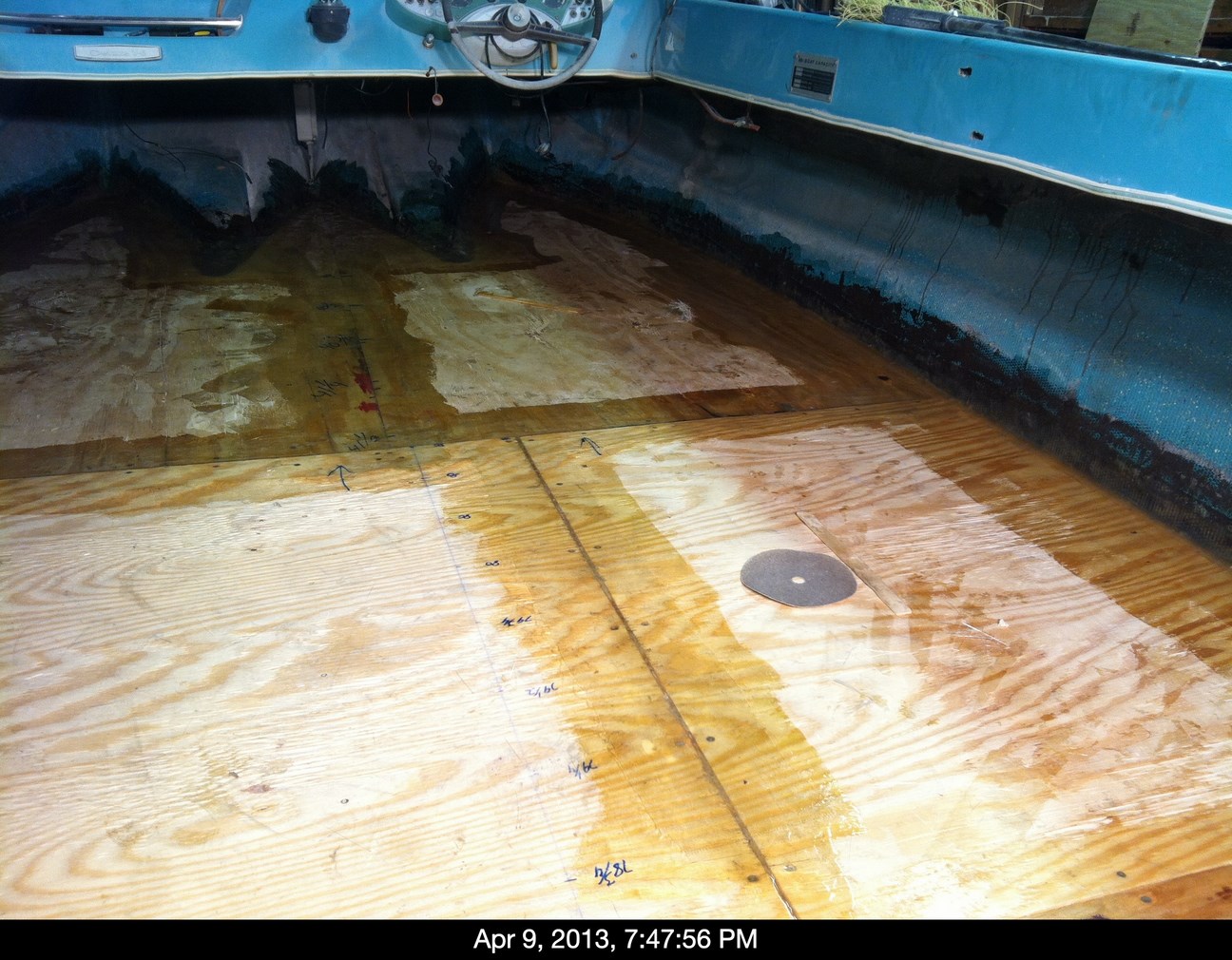

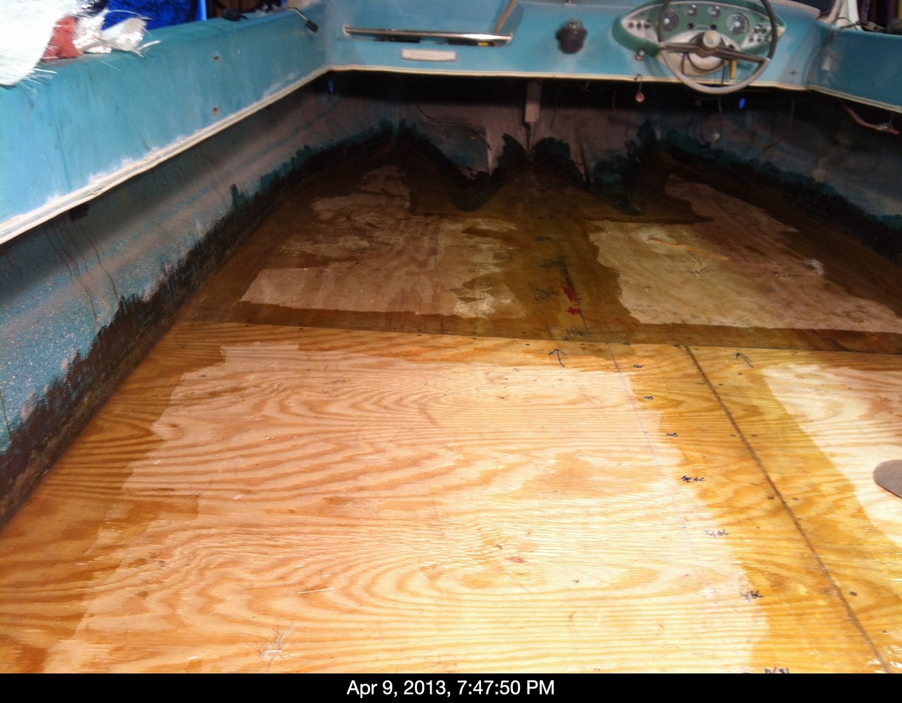

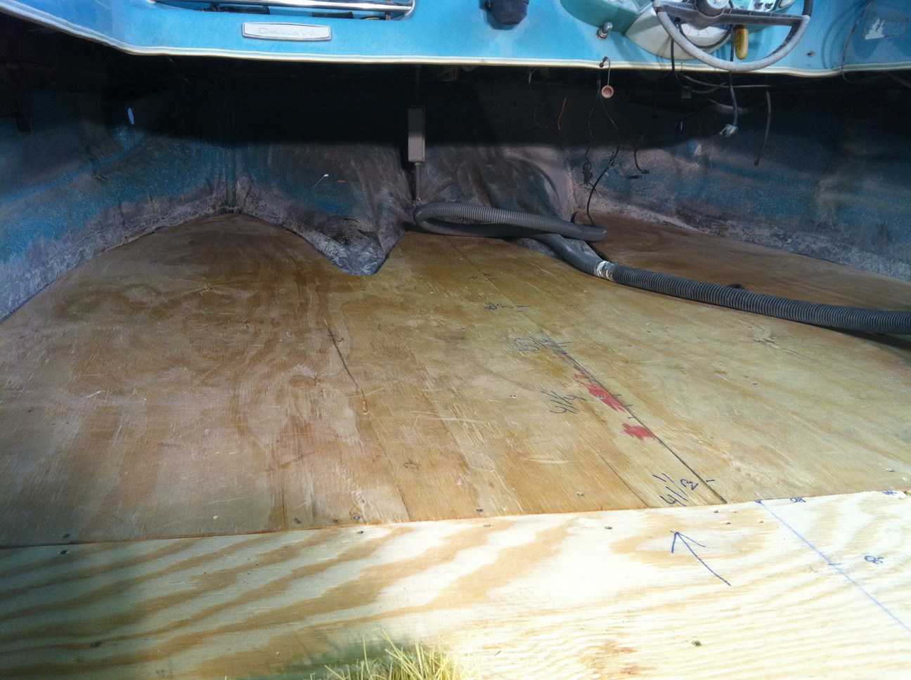

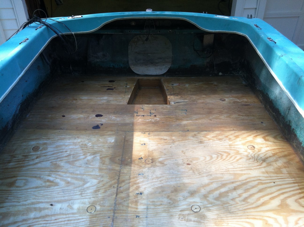

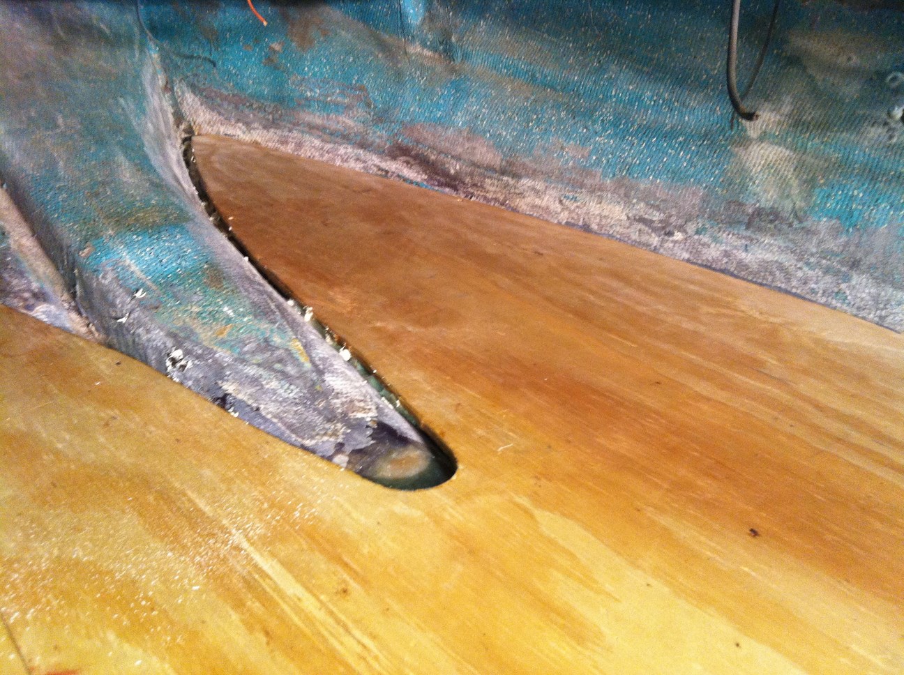

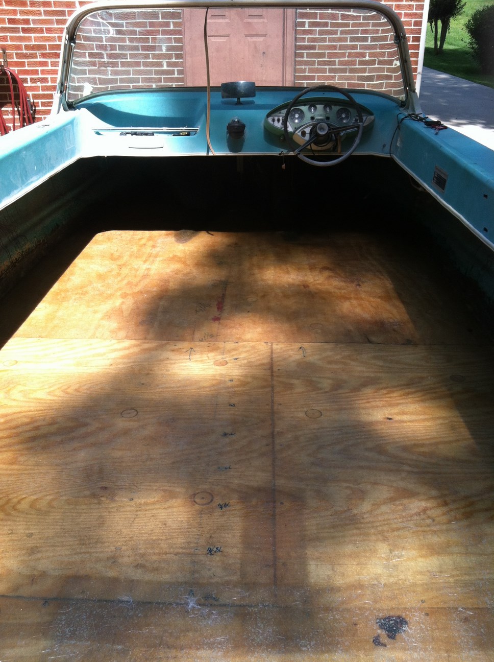

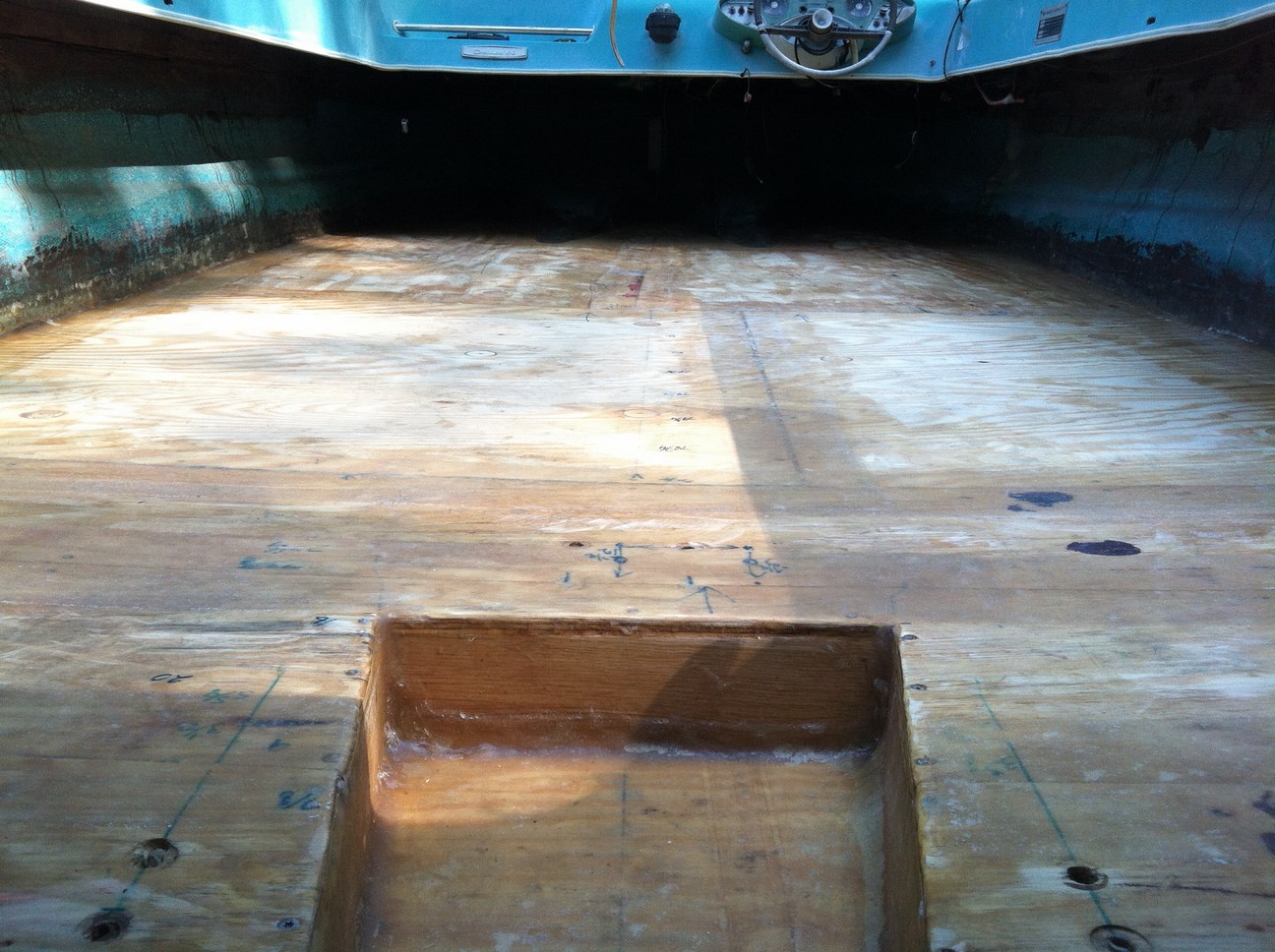

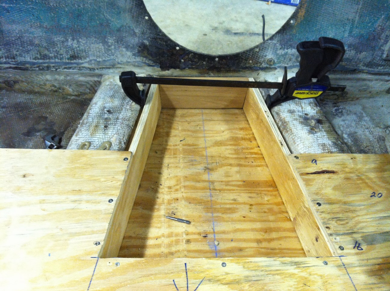

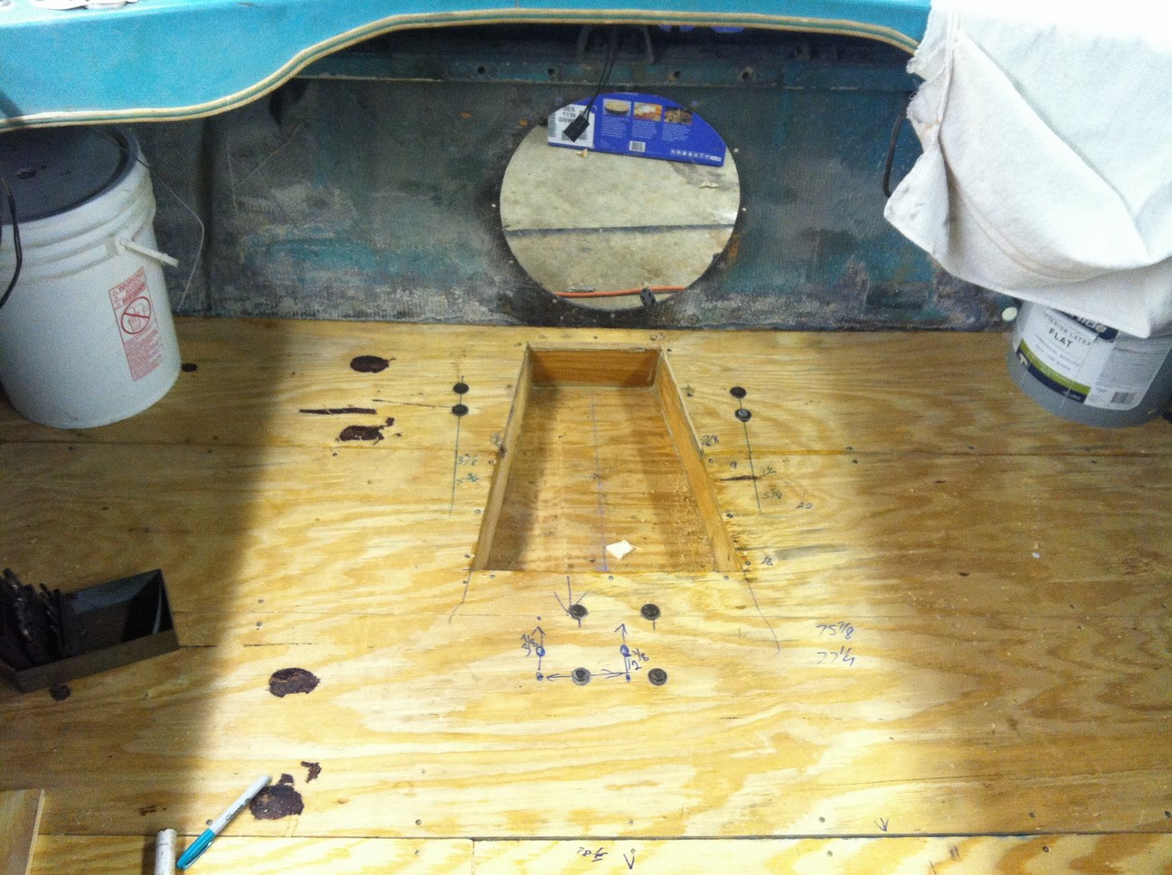

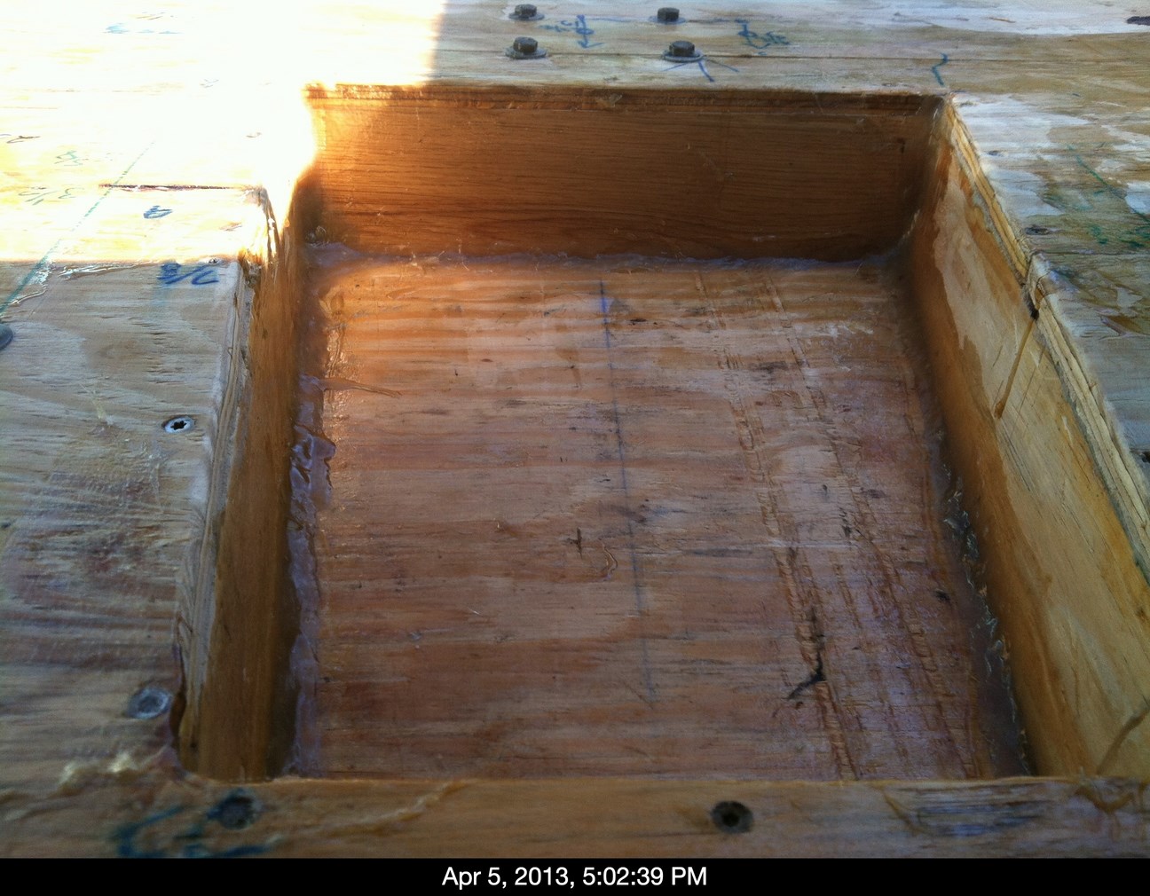

The deck installation continues....
My three helpers!

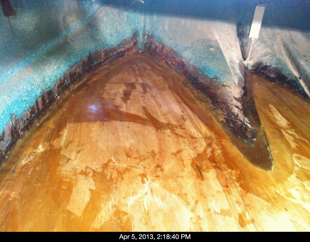

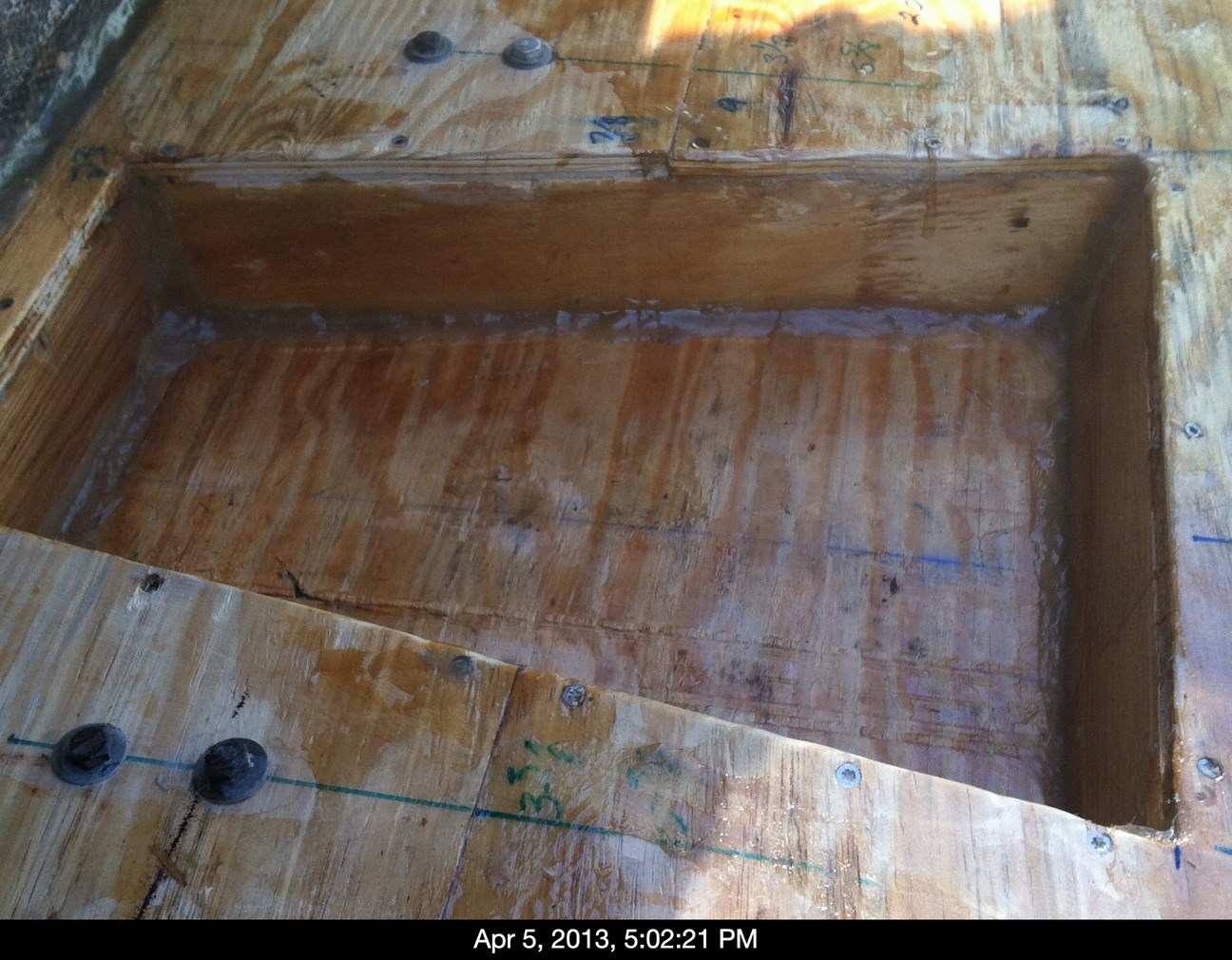

Pressing thinner bottom bilge piece into the PL Premium.
Test fitting bilge parts

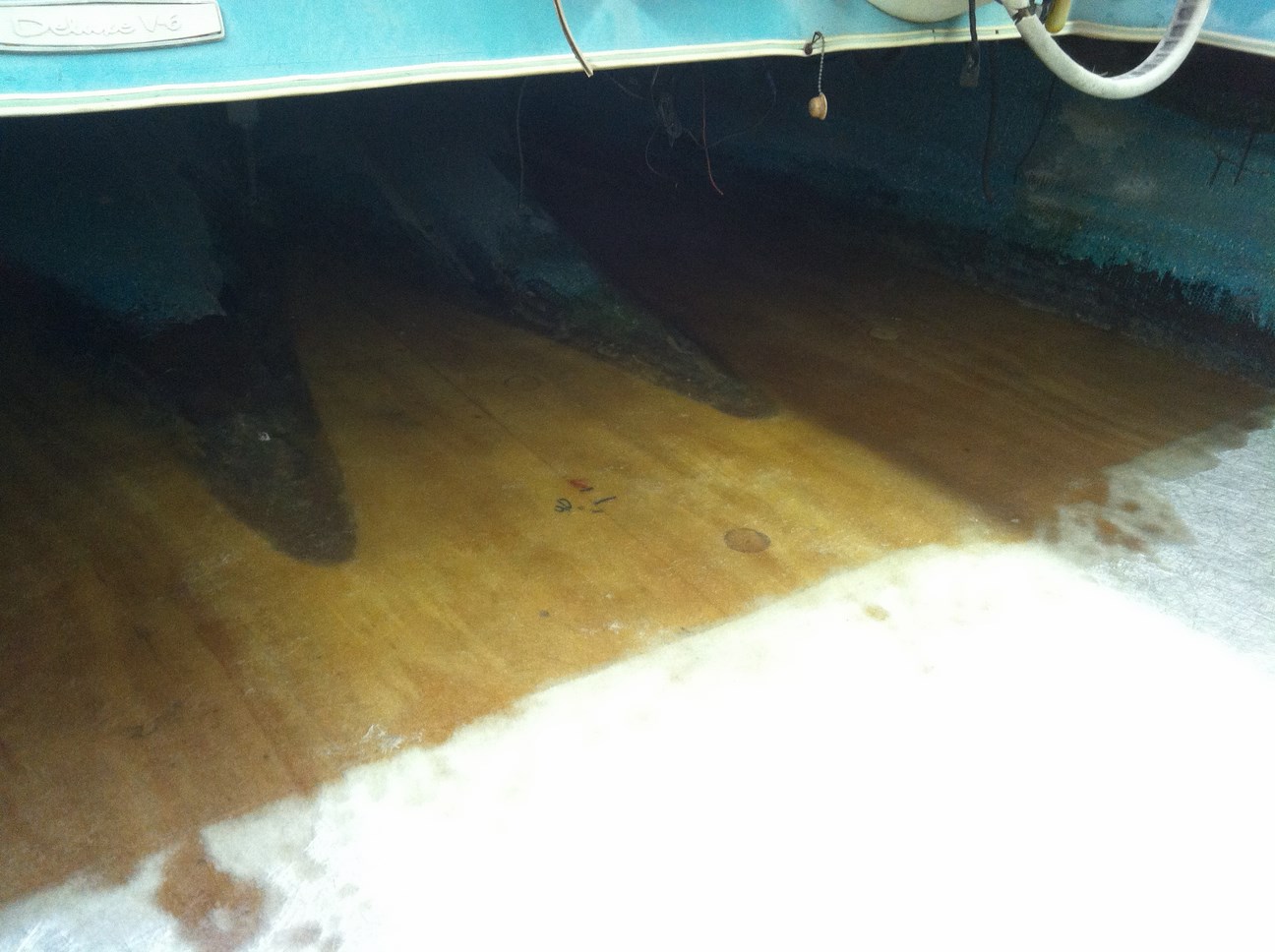

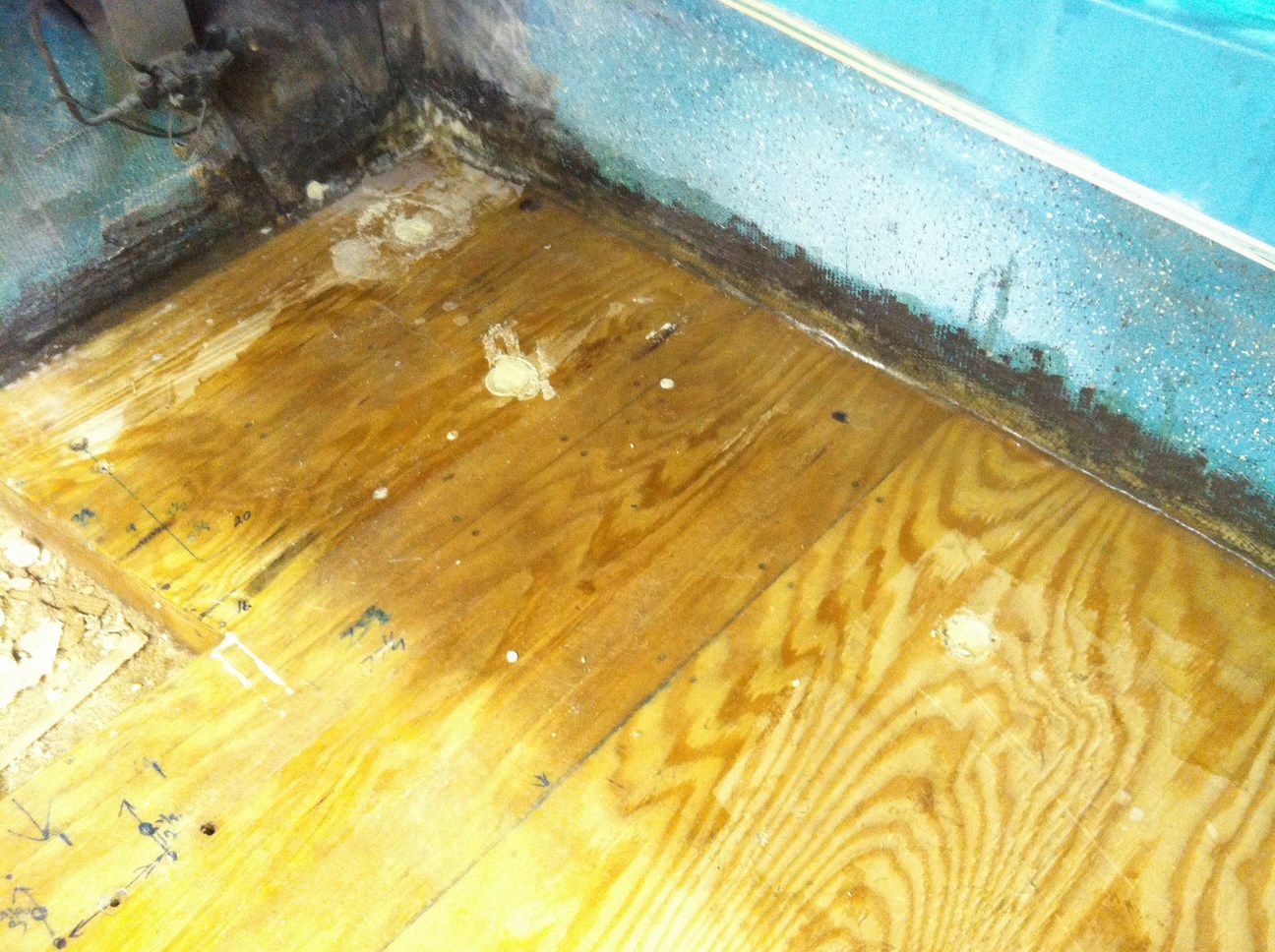

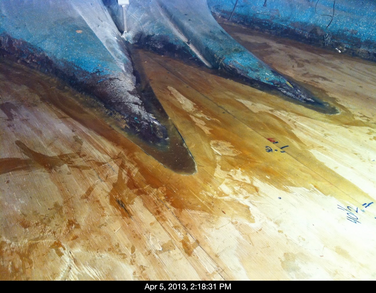

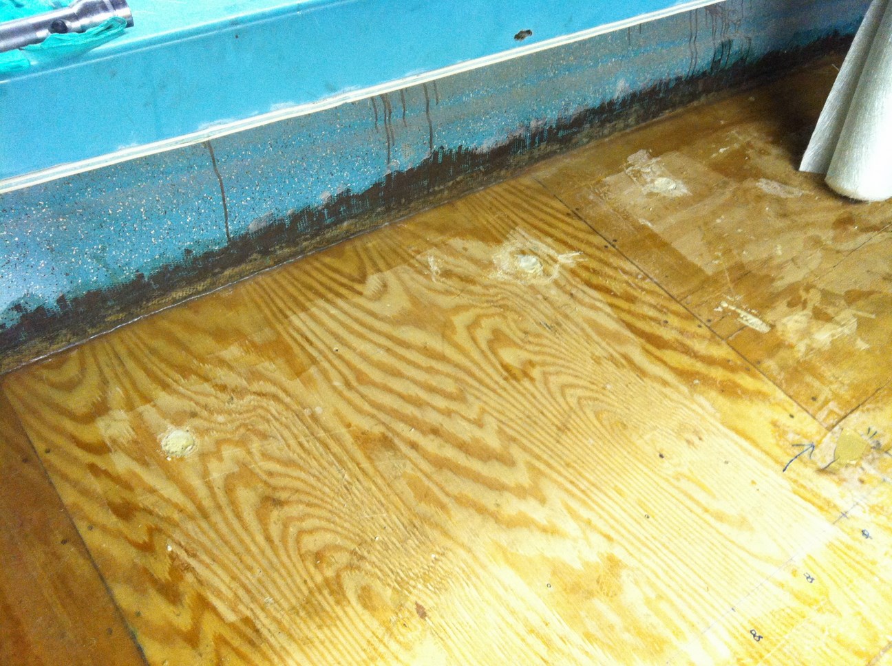

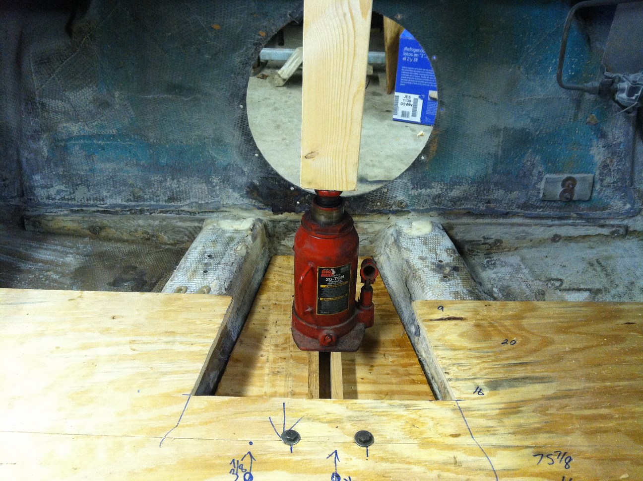

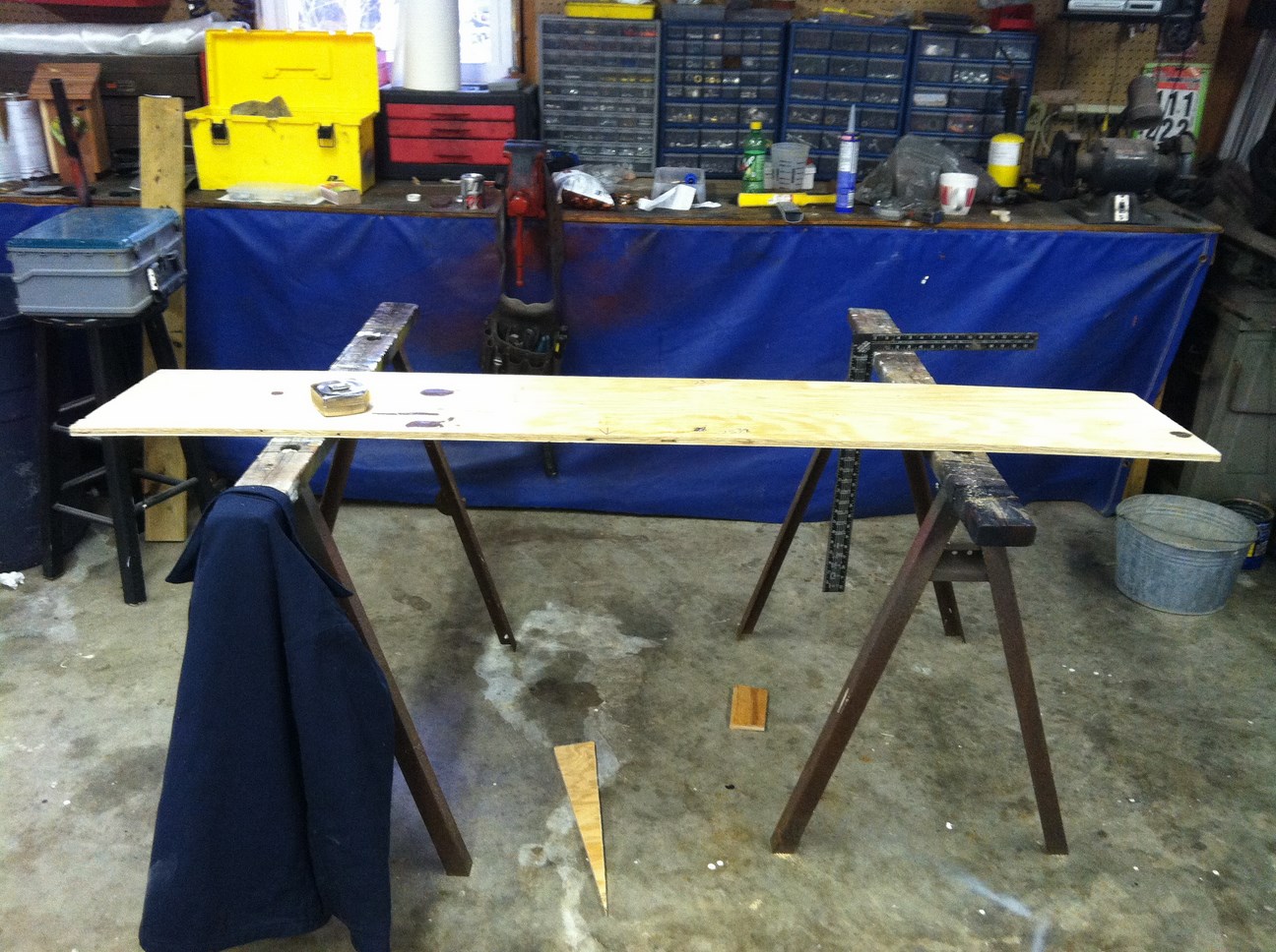

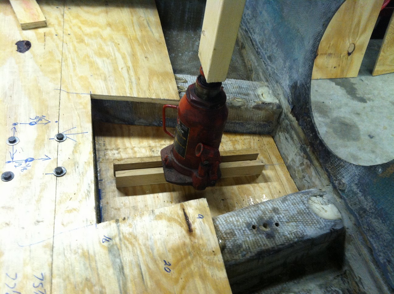

I took out the bilge pieces and waterproofed the edges and back sides. cut out the bilge opening, and re-assembled.
Notice I used the original engine mount locations to hold the deck in place till the PL Premium sets up. I used stainless steel screws and glue everywhere and married each deck piece together for strength.

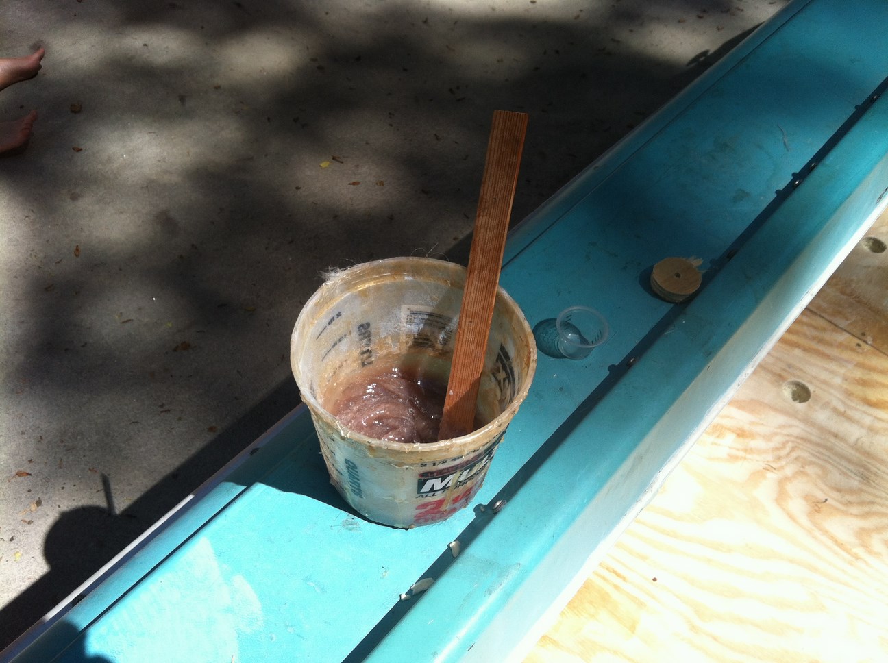

Cleaned the deck and started filling the gaps around the perimeter with PB and making filets.

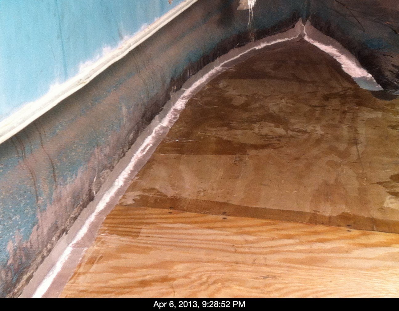

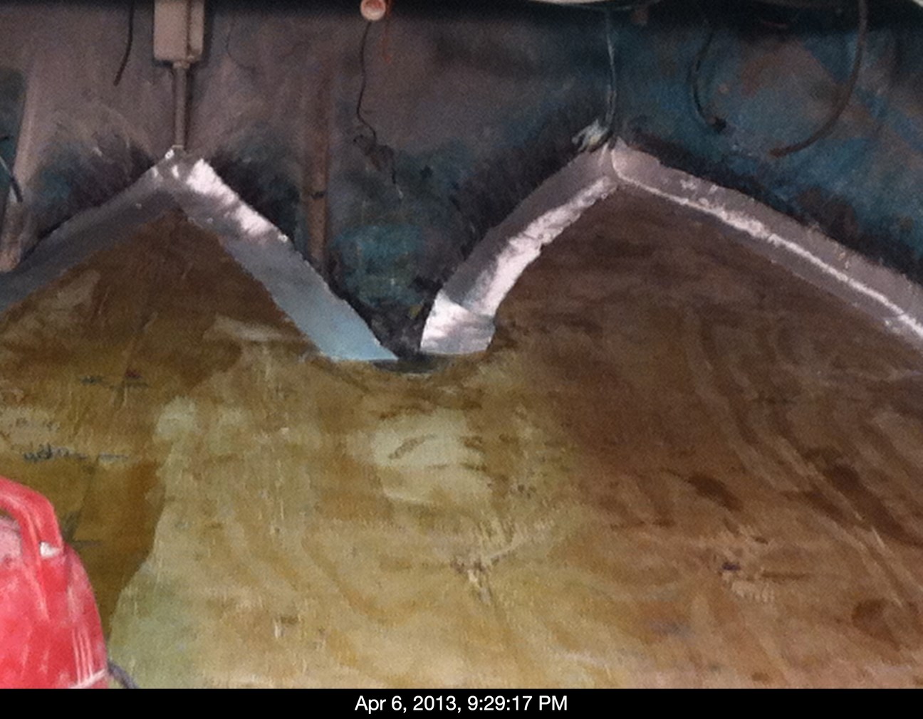

The work continues. These are photos of the fileting. I mixed up PB and used a big spoon (Don't tell Rosie!) apply it around all the edges and corners that are going to get glassed in. I filled all the gaps between the wood and hull also.

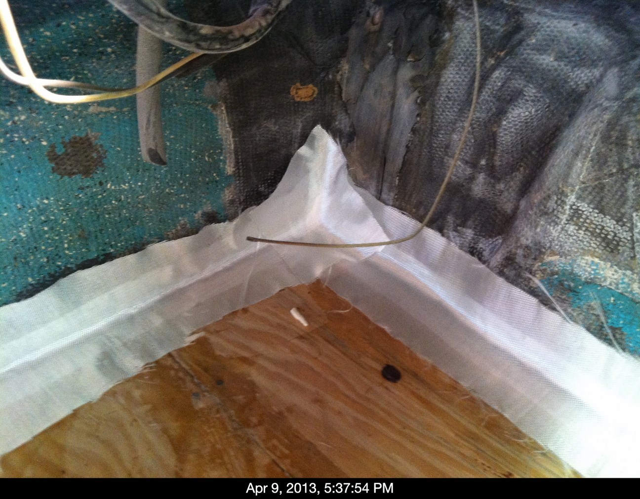

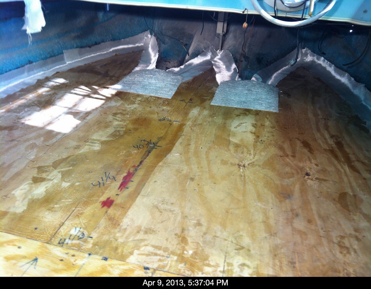

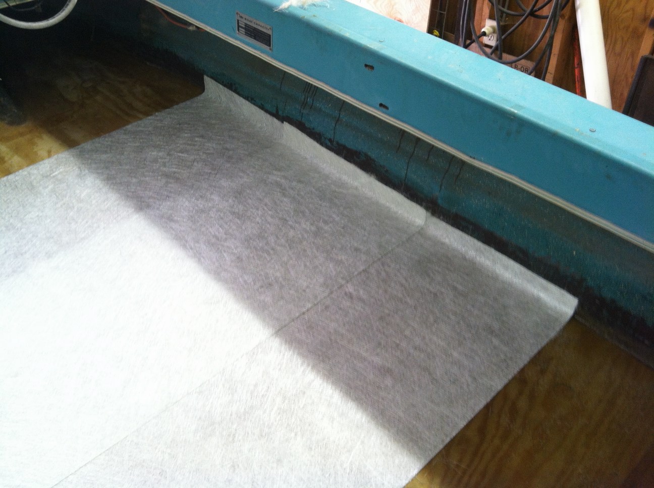

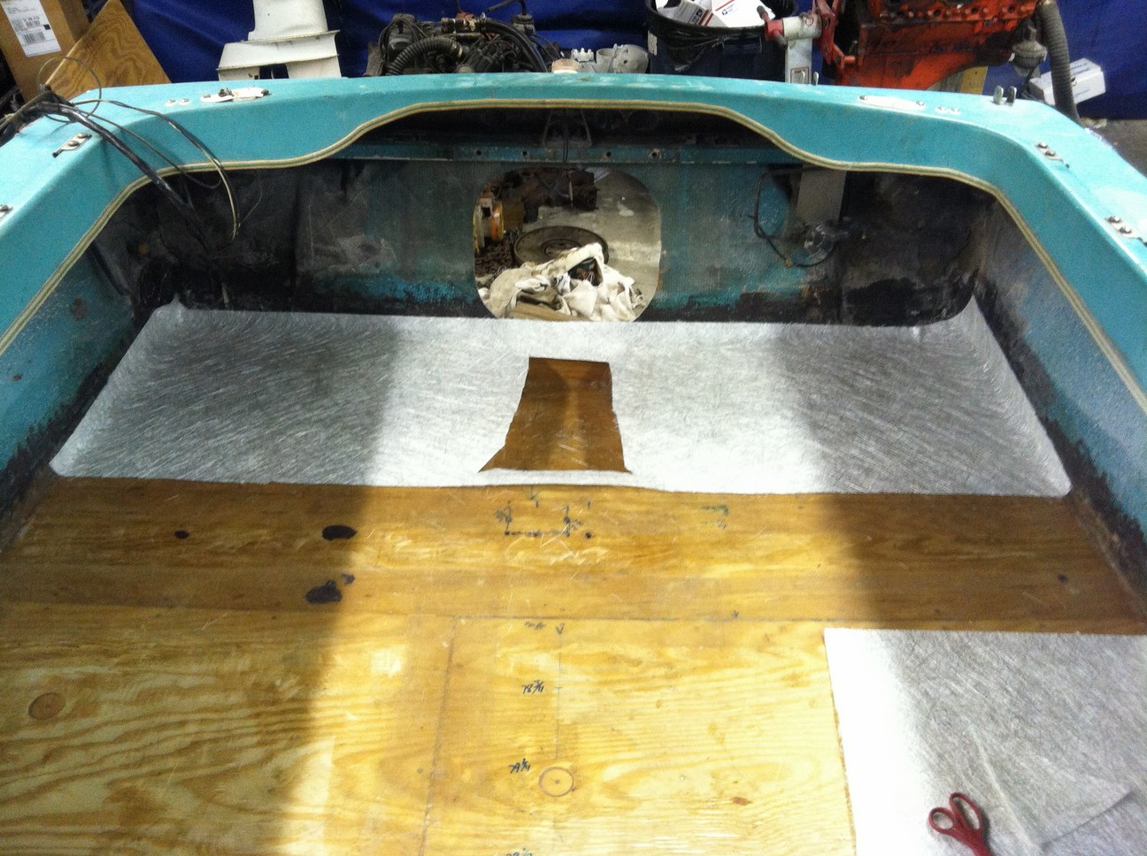

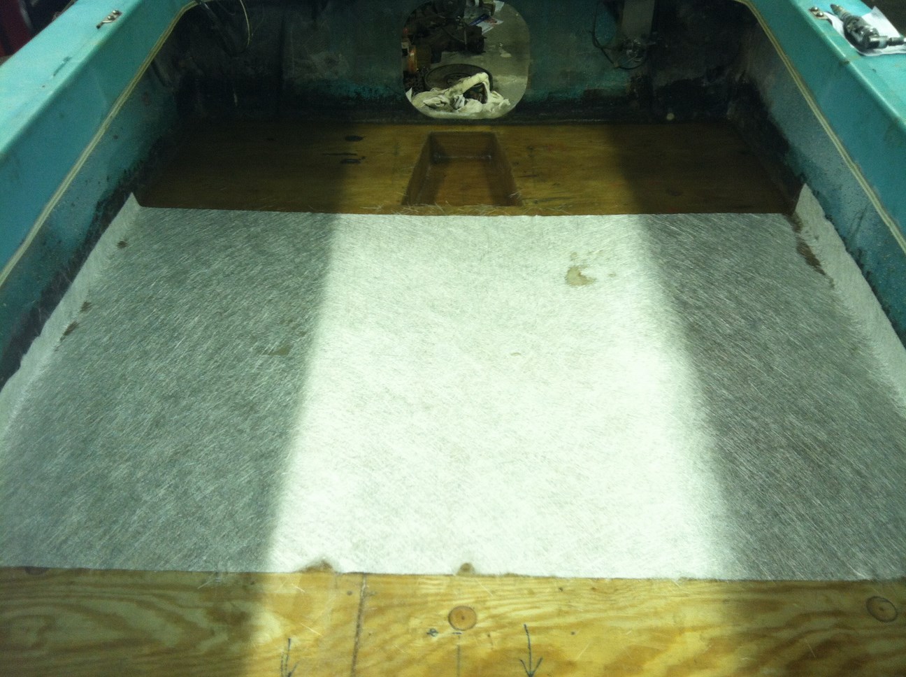

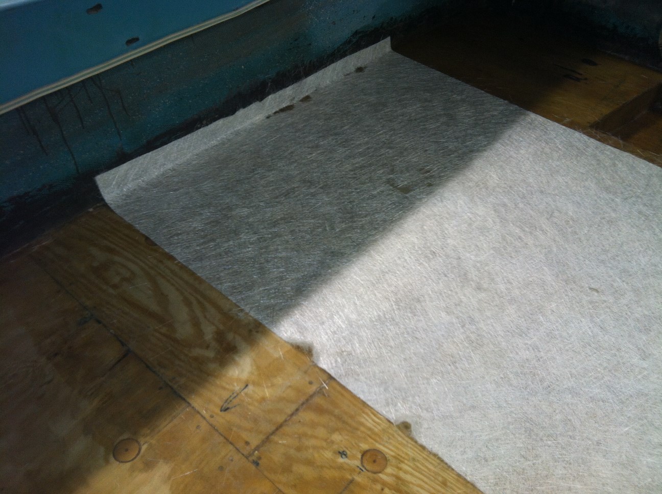

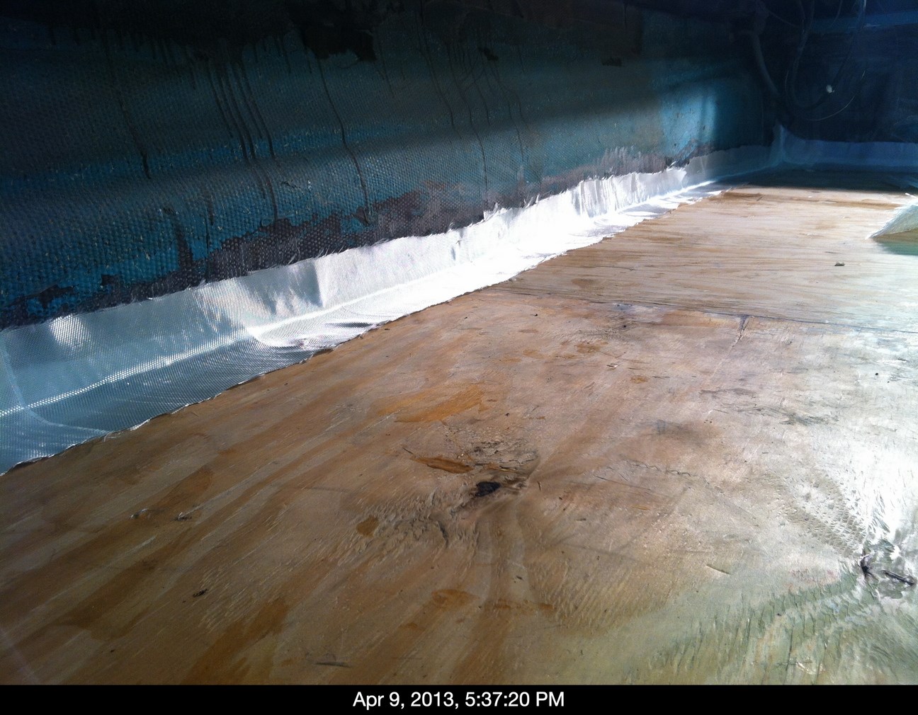

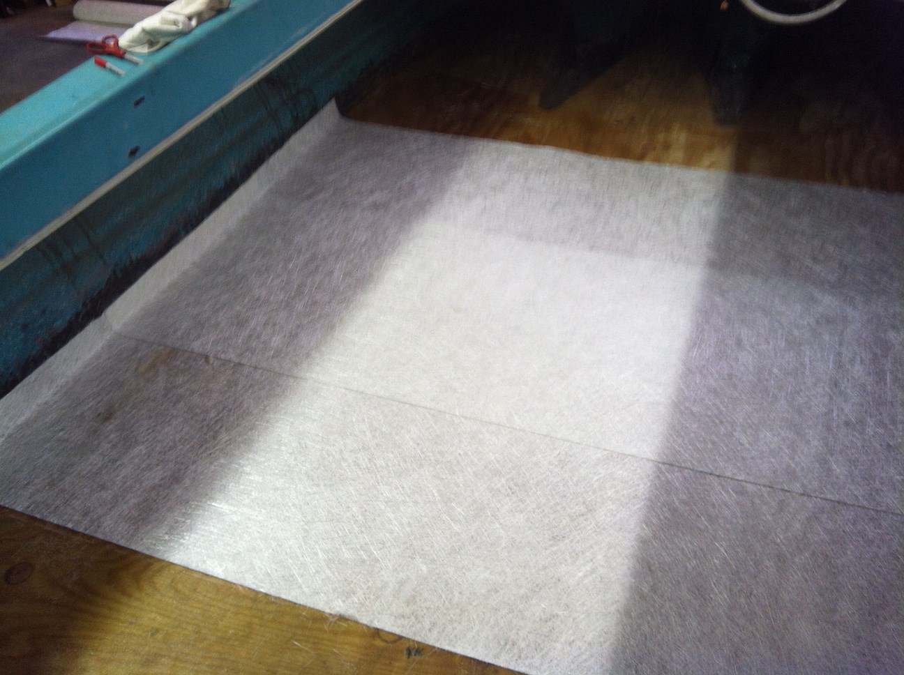

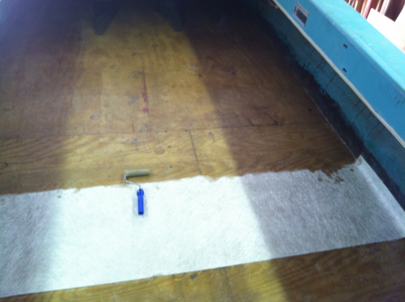

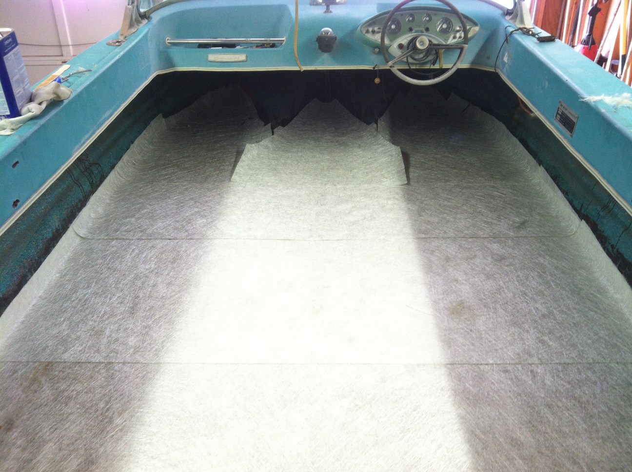

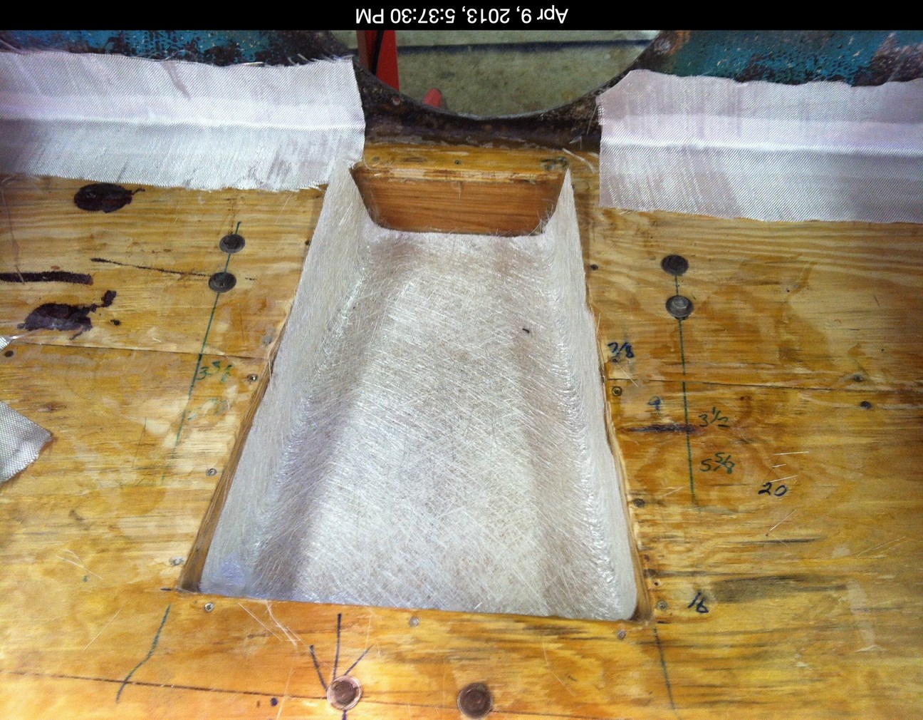

Tabbed the new deck with 2 layers of cloth, the first 4 inches wide and the second 6 inches wide. I put CSM over all the seams in the deck also.
Note: I sanded all the filets and seams prior to this.

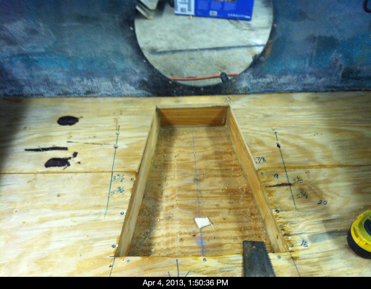

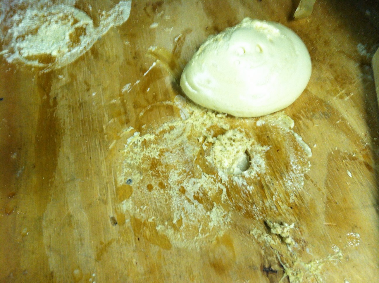

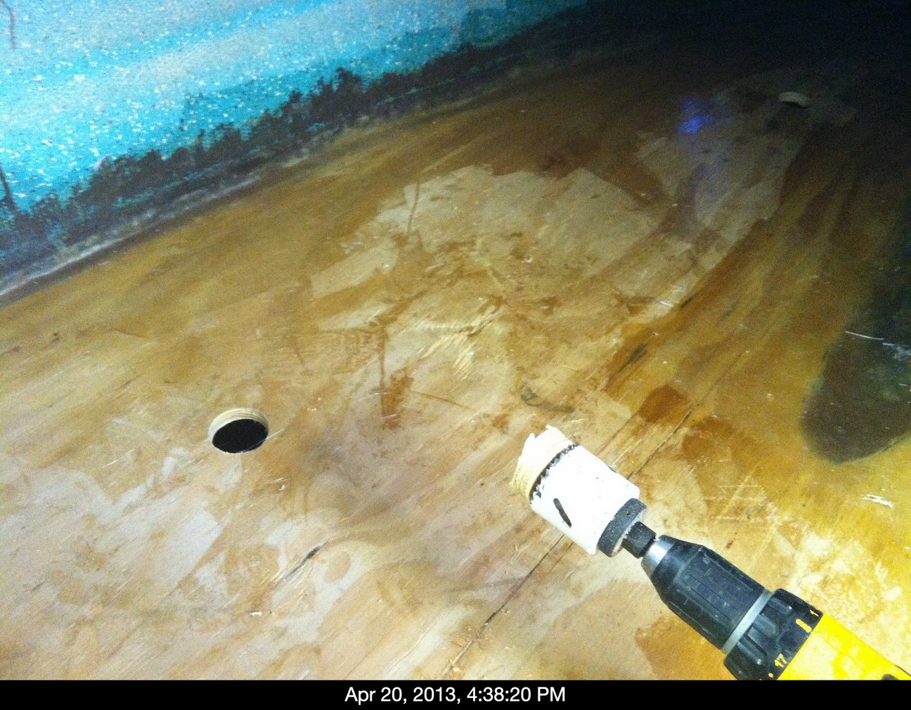

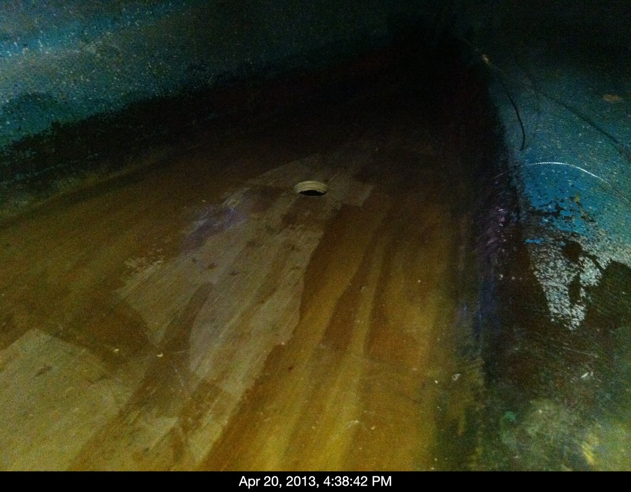

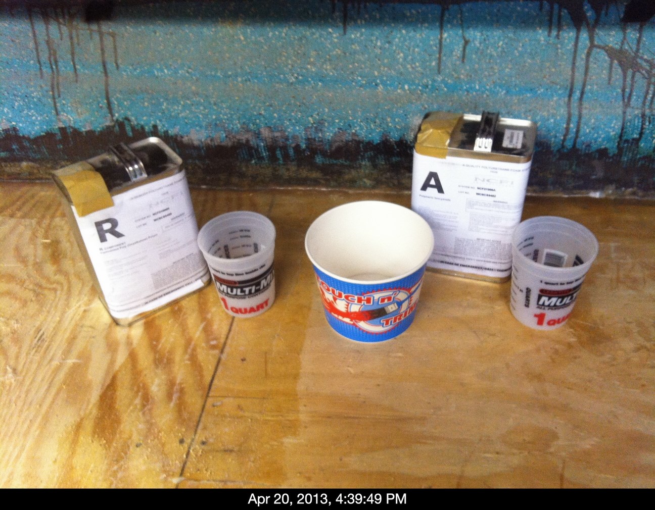

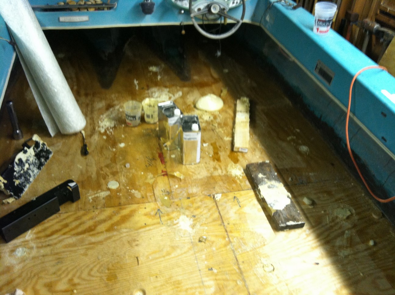

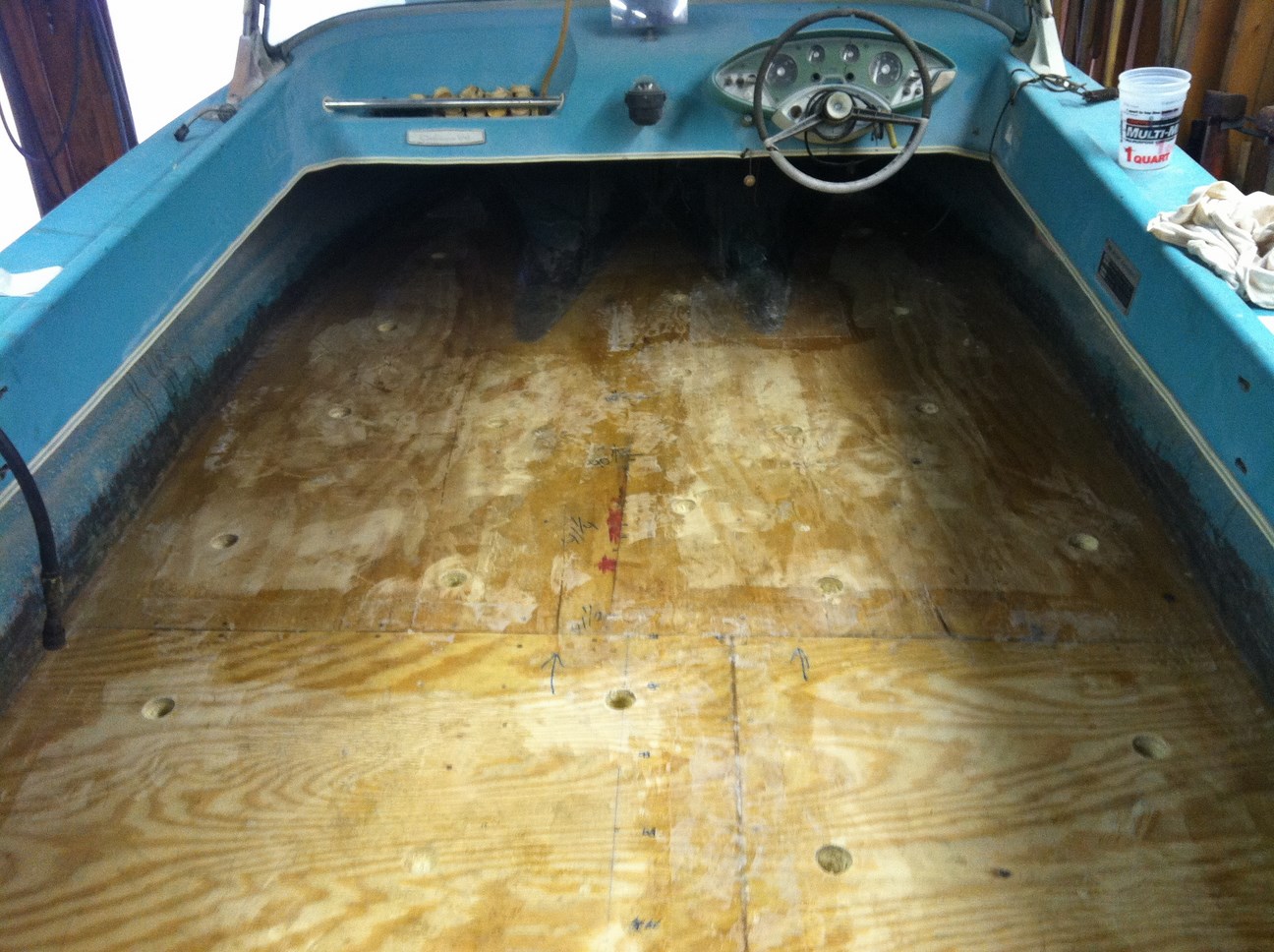

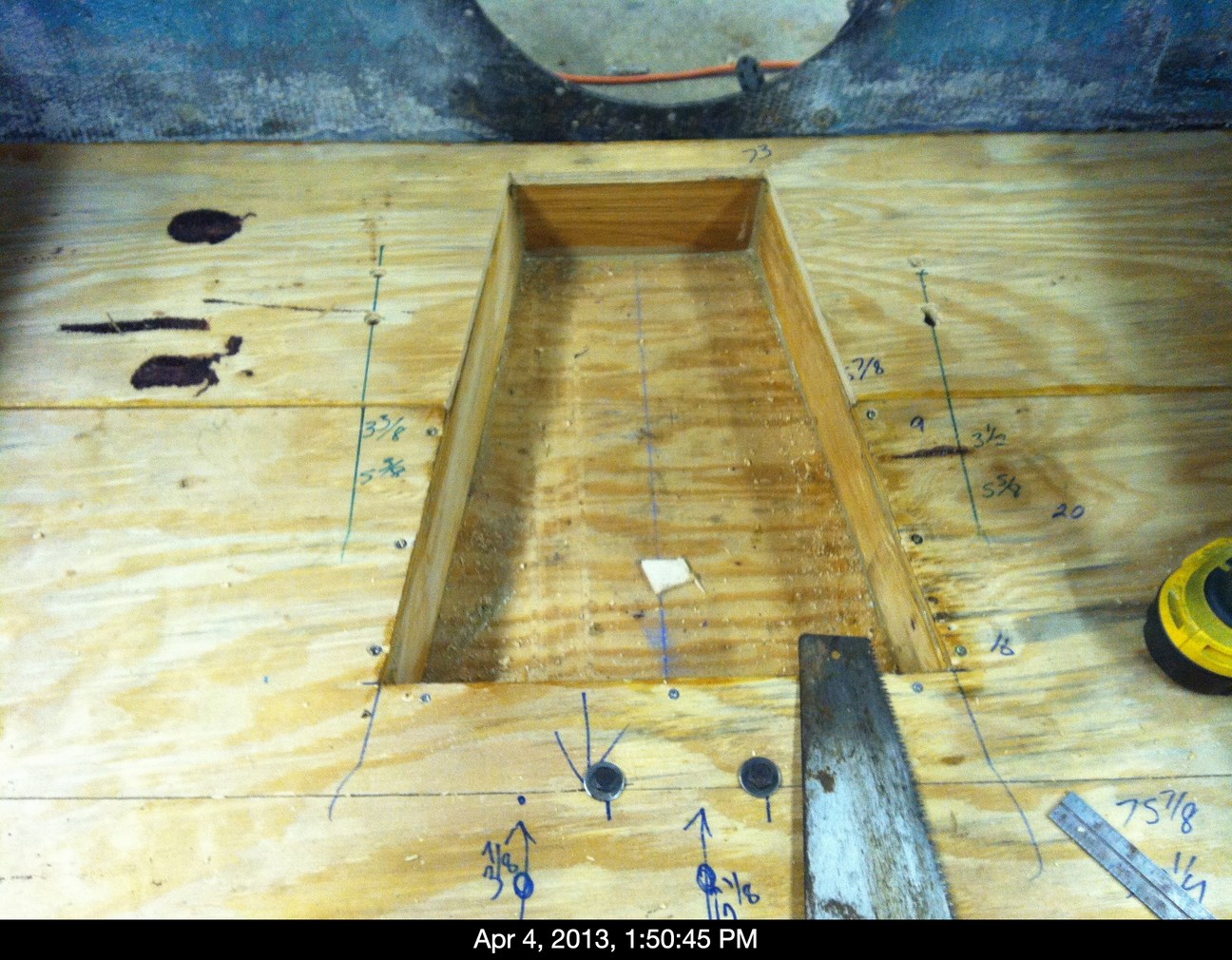

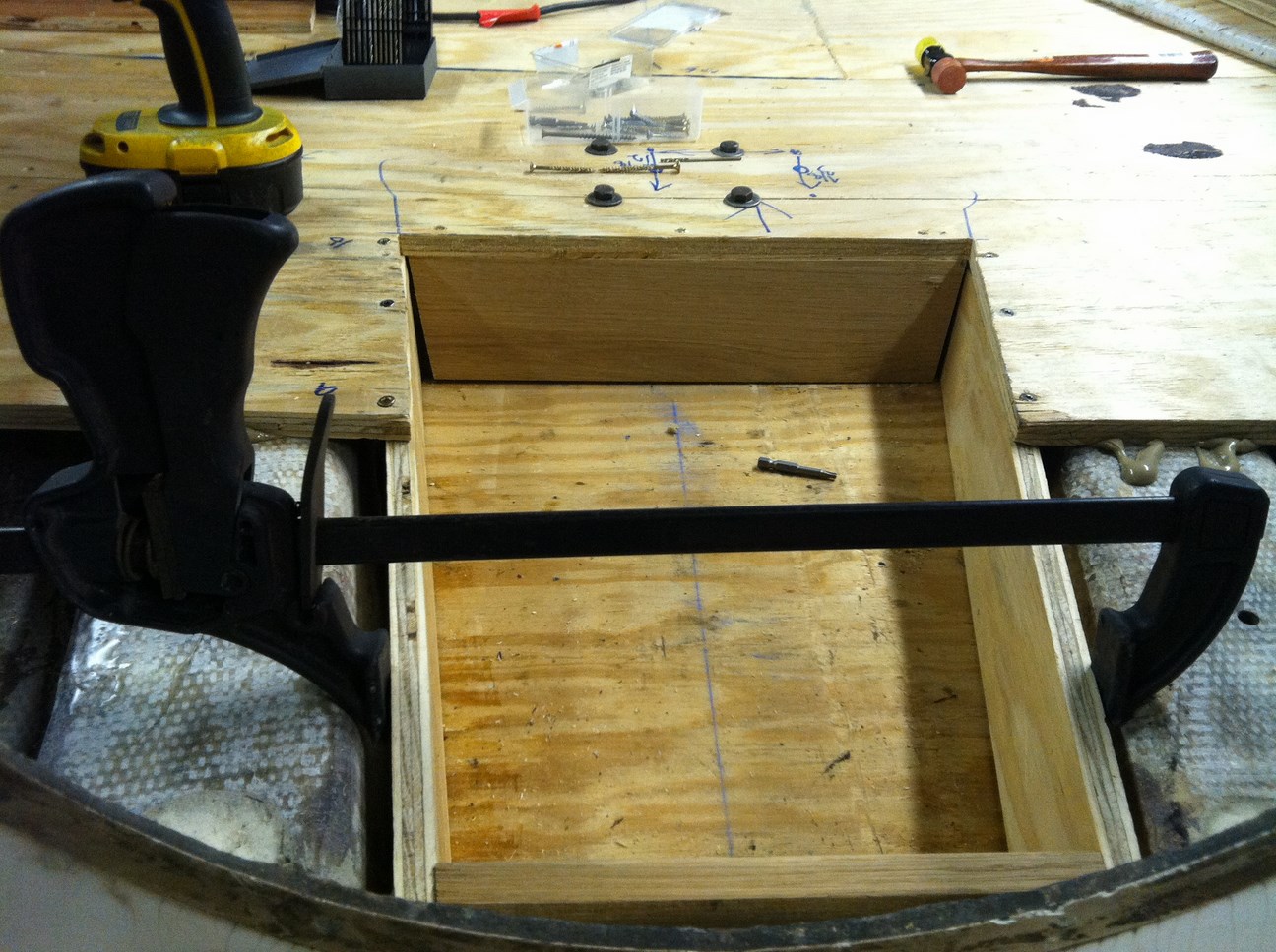

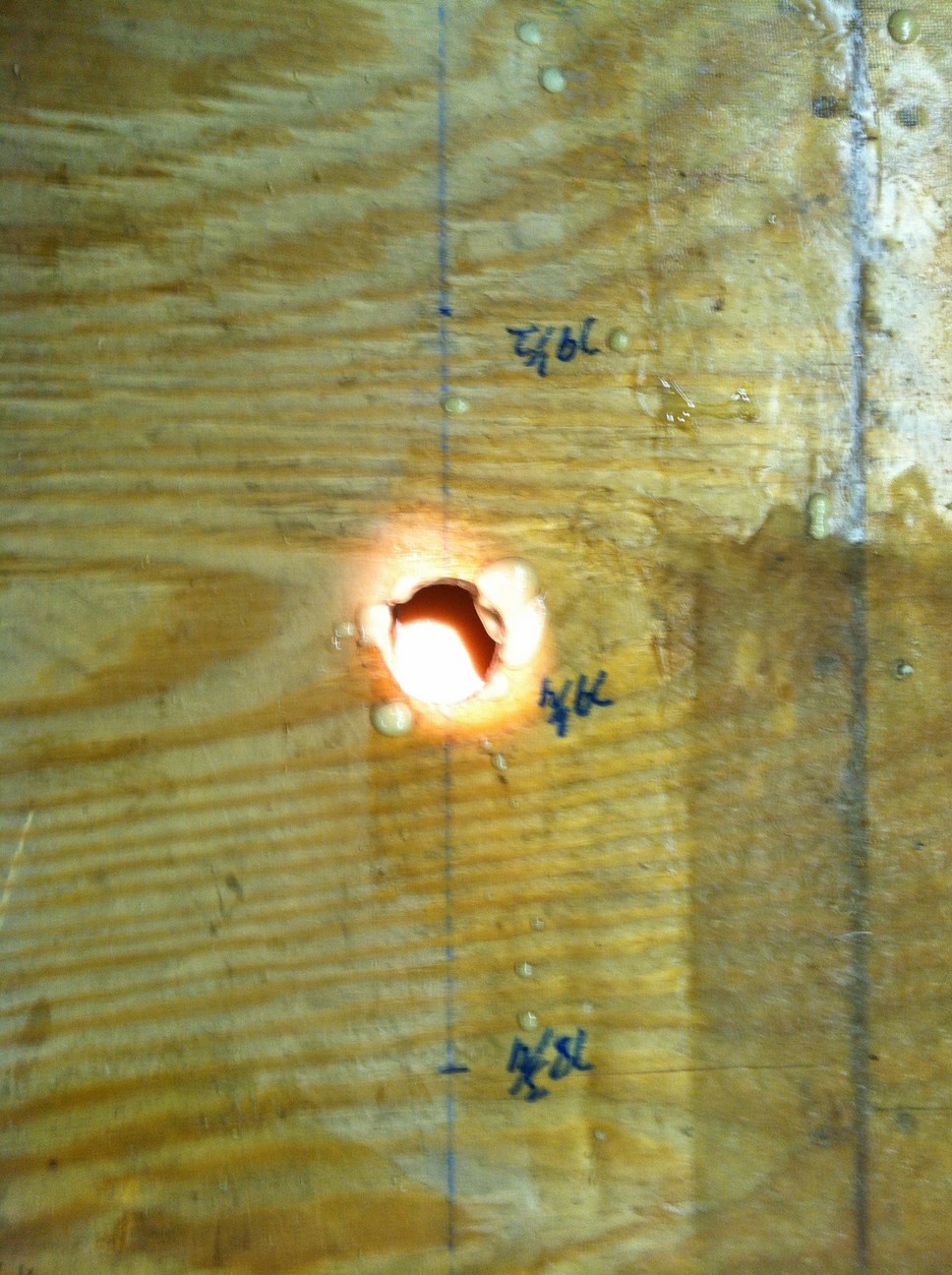

Time for some floatation foam. If you remember I removed half a ton of wet foam from this old girl. Well, that foam needs to be replaced for several reasons:
Floatation
Strength
Sound deadening
Everyone seems to have an opinion about how, when, and why concerning floatation foam. This is the way I choose to do it, whether it was right or wrong.
This is half of what I ended up using. It took 7 mixed gallons total.
Getting ready for mixing. I mixed 1 quart of each together at a time. Your mixing time varies depending on the temperature.

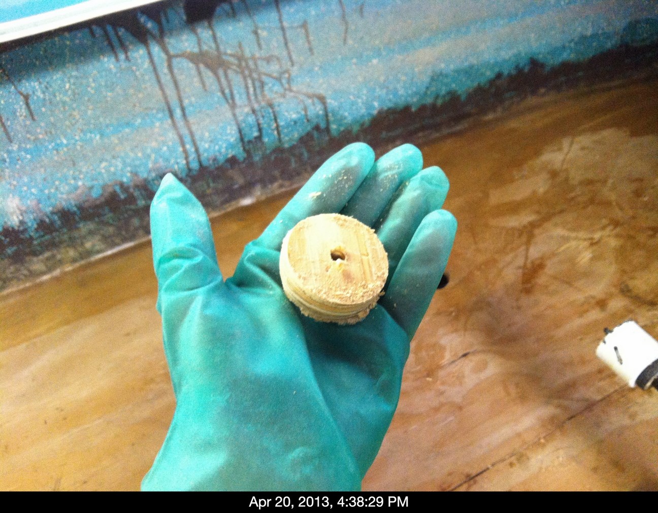

This is the hard part... boring holes in the deck I worked so hard on.
Keep these wood pucks for later!
I bored a total of 27 holes in the deck, plus a lot of small 1/2 inch holes around the perimeter to let air escape.
You can see the foam expanding...
I placed a board over the hole with a weight on it to prevent the foam from just coming out the hole I poured it into.
Its messy work and you can see it wants to stick to everything it touches.

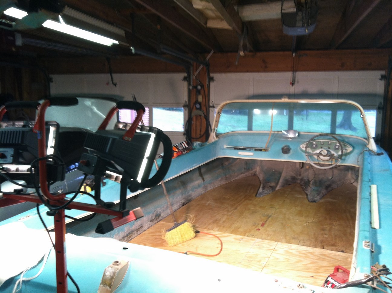

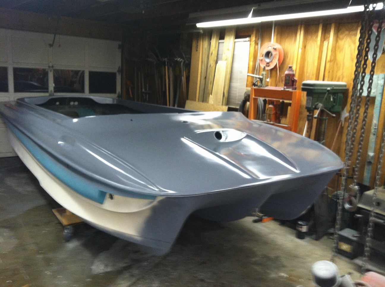

Right now the Deluxe is upside down and I'm doing an endless amount of body work to the hull. The topside is repaired and in primer. The 800 is completely rebuilt and awaiting installation. The engine is on the stand and I will start rebuilding it after the bottom is painted and flipped back over.

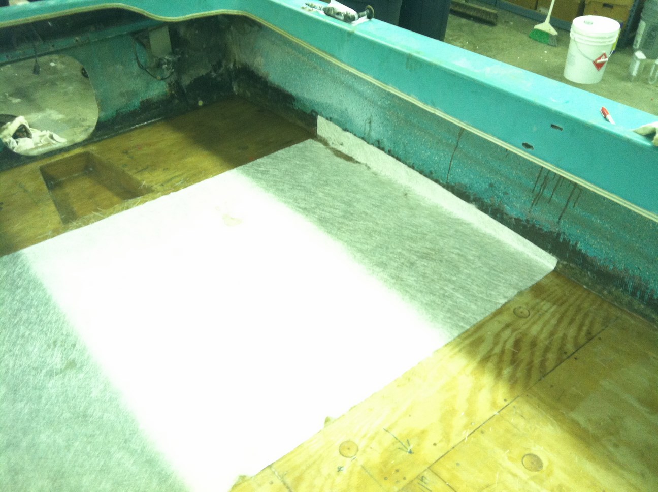

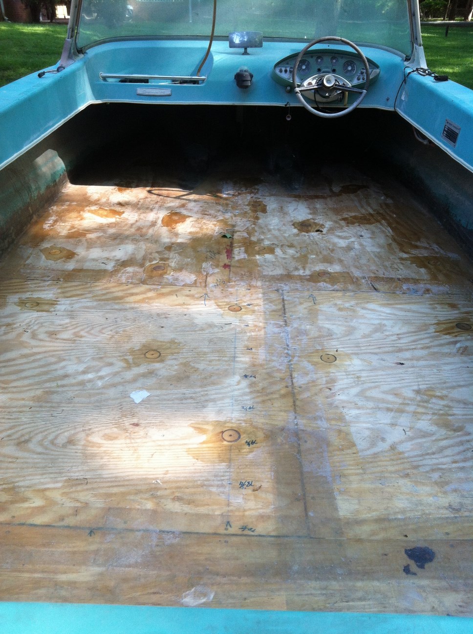

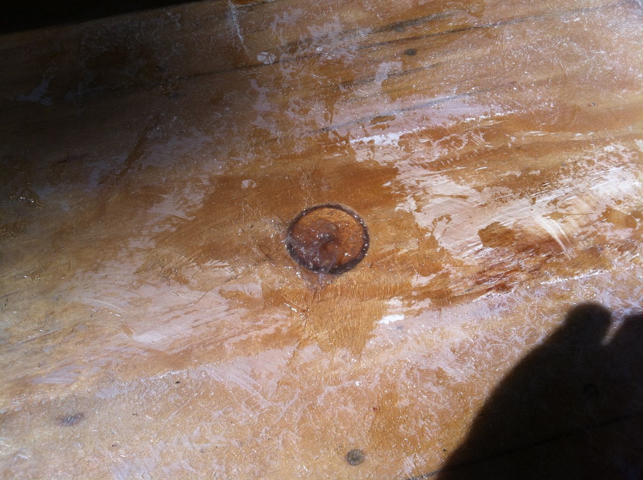

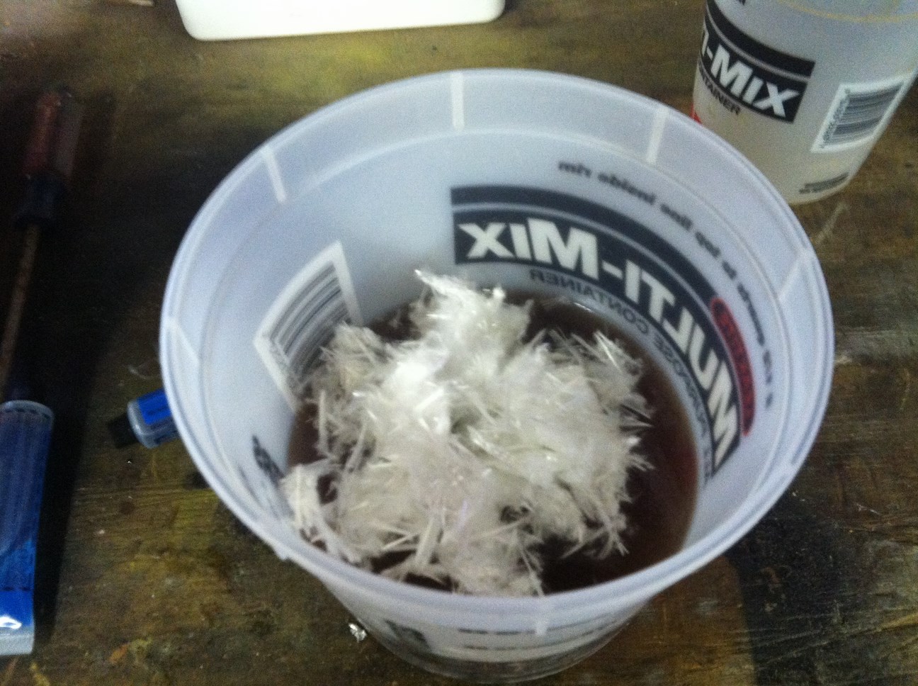

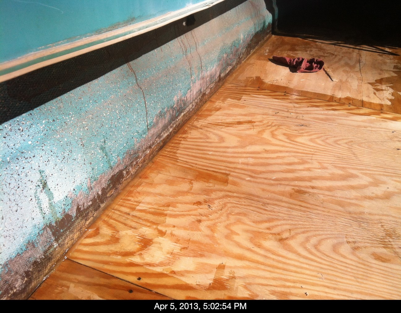

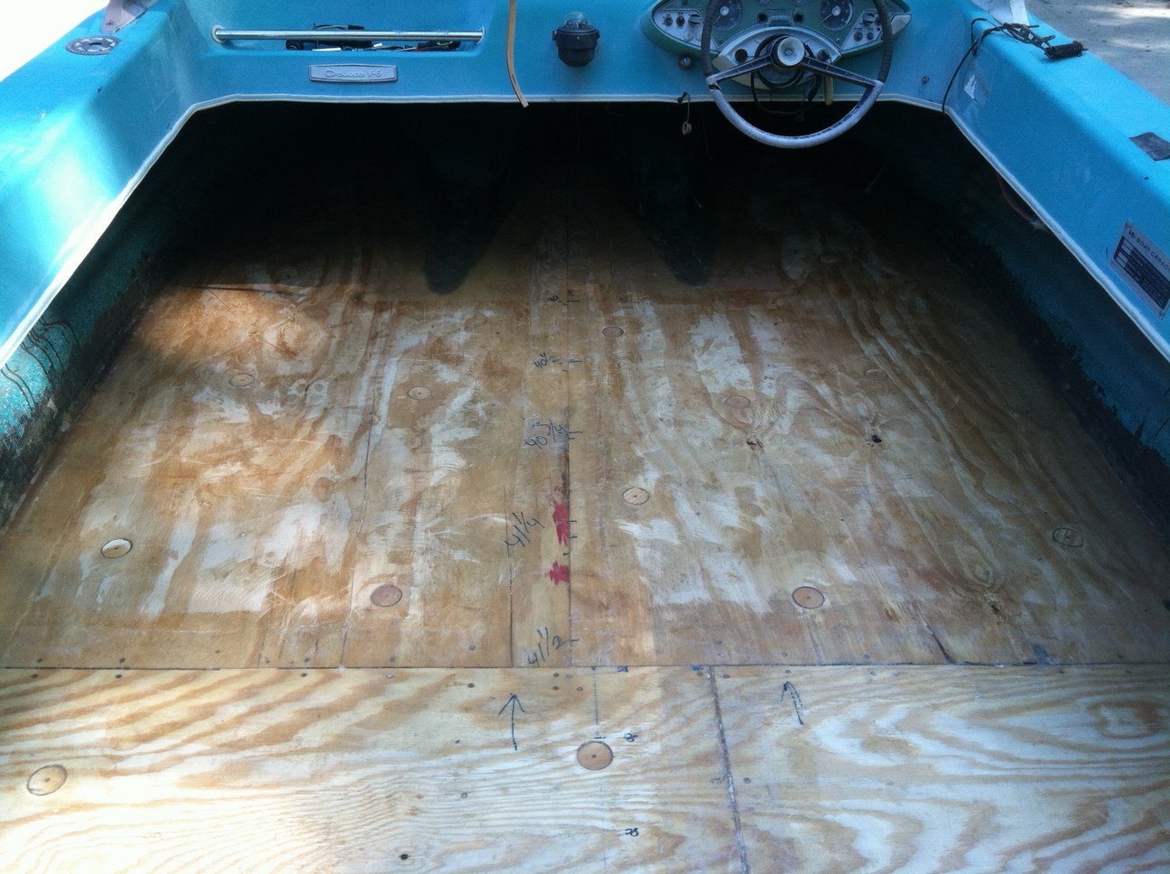

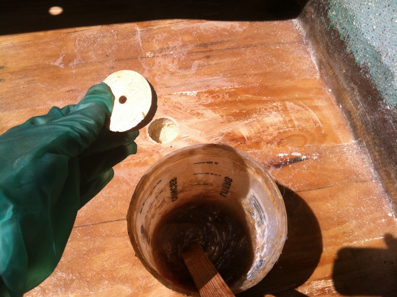

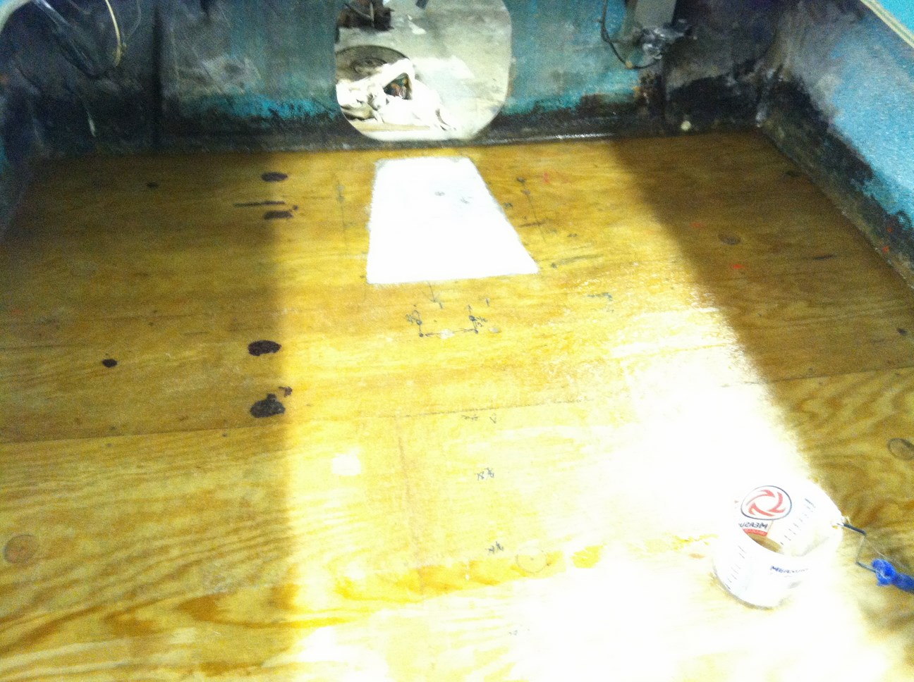

Time to plug all those holes in the deck and get ready for glassing the entire deck in.
I cleaned all the excess foam and opened the holes up a little so the plug would set in the opening.
Thickened resin ready to apply.
Wiped the deck with acetone and applied the PB to the plug.
All glued in.
I will sand these flat before glassing the deck.
After some sanding.

Sanded the deck, vacuumed, and wiped with acetone.
Re:1964 Johnson Deluxe Resto-Mod 12 years 8 months ago #89721
  • agleason
  • agleason's Avatar Topic Author
  • Posts: 327
  • Karma: 25
I laid down 2 layers of CSM overlapping 50% from back to front.
Saturated with polyester resin rolling the opposite direction, from front to back and out to the sides removing the air pockets.
Now I have something to work with! I wasn't sure I could save this old Deluxe. She was sooo bad and rotten. Until I could get a deck in her I just wasn't sure of anything.

Thanks for the encouragement. I'm getting closer to painting the bottom half. I ran out of primer this weekend so I have an excuse to take a break until another gallon arrives.
