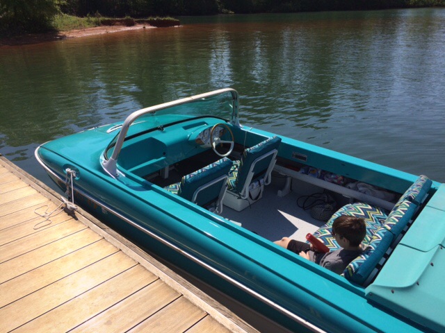

Re:1964 Johnson Deluxe Resto-Mod 11 years 1 month ago #115389
  • agleason
  • agleason's Avatar Topic Author
  • Posts: 327
  • Karma: 25

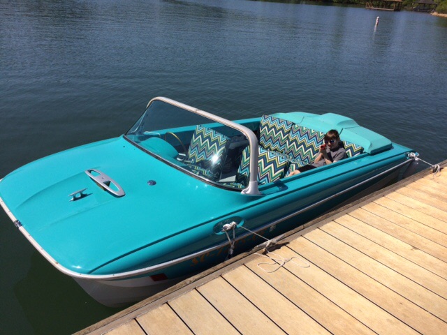

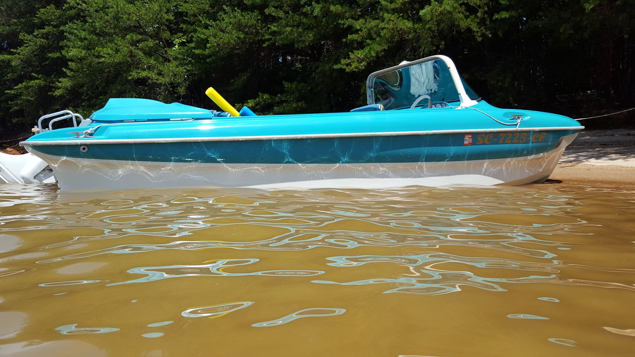

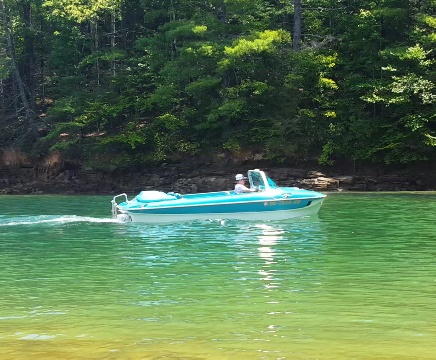

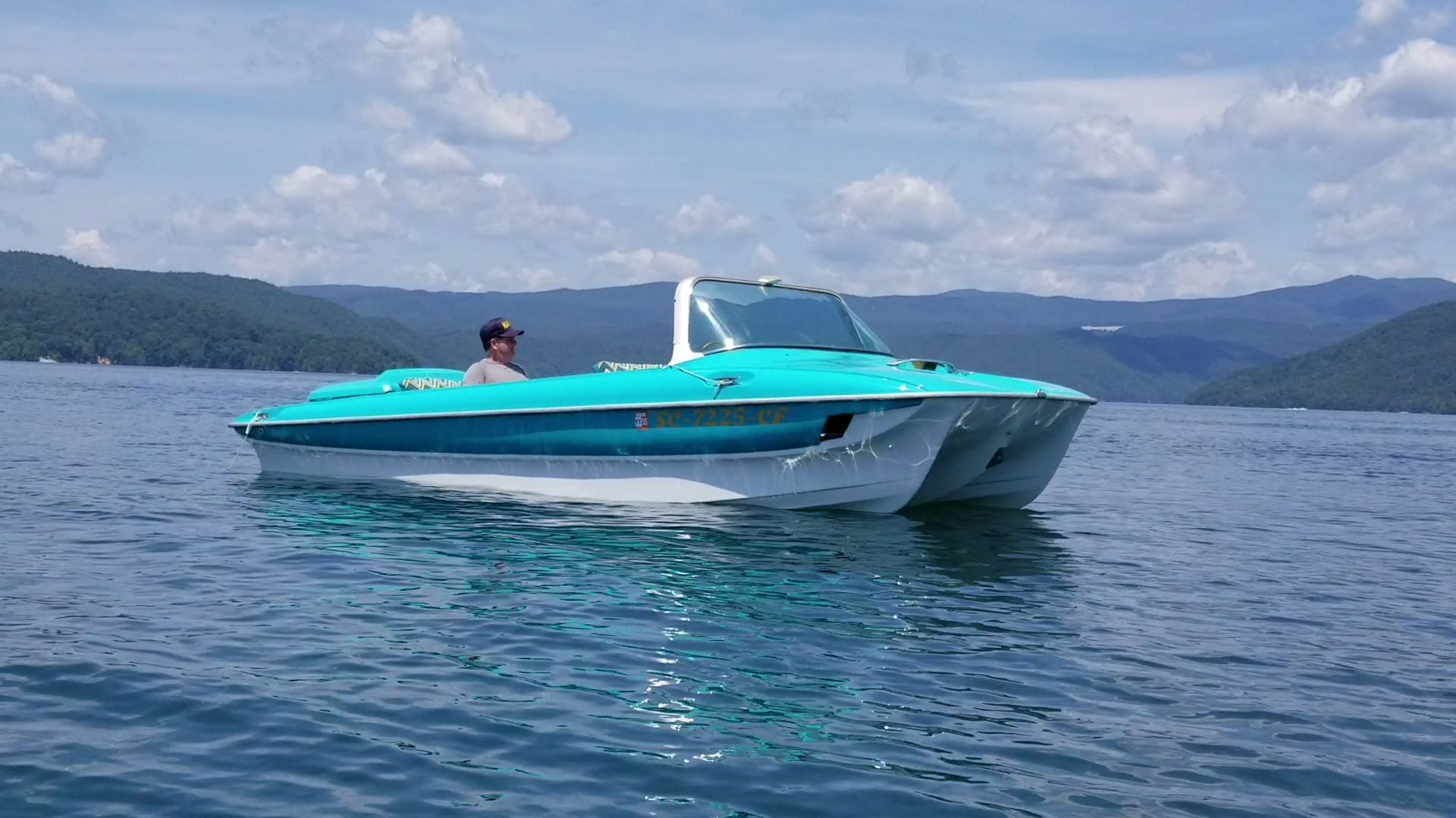

A few more pictures from the summer boating fun....
Re:1964 Johnson Deluxe Resto-Mod 11 years 1 month ago #115392

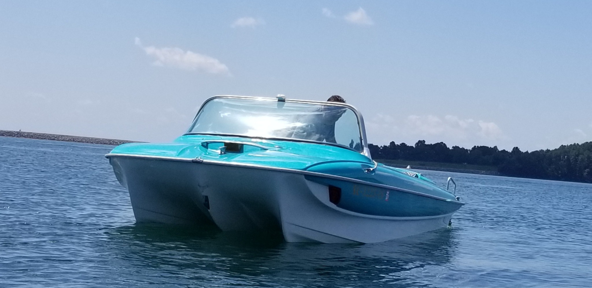

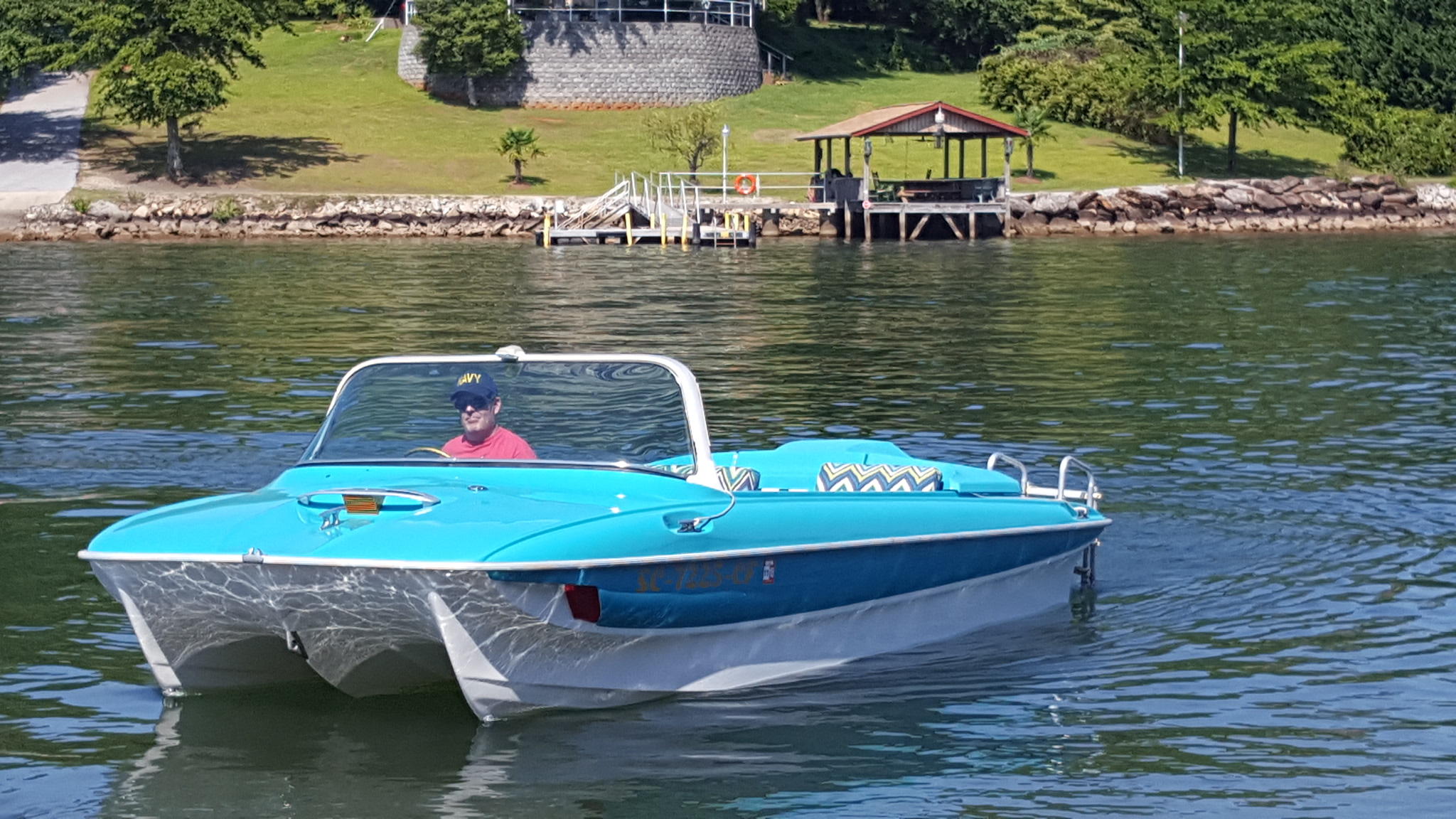

Re:1964 Johnson Deluxe Resto-Mod 10 years 3 months ago #125013
  • agleason
  • Posts: 327
  • Karma: 25

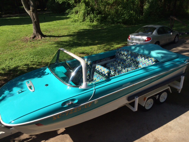

We have had another great summer on the lakes with our 1964 Johnson Deluxe. This old boat is AWESOME! She romps around the lake and you can't believe the attention she gets. It's hard to ski or swim for the people coming up to take pictures and ask questions about the old girl.
Here is a link to a video from today and a few pictures.
Re:1964 Johnson Deluxe Resto-Mod 10 years 3 months ago #125363

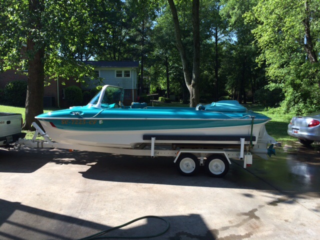

More pictures...
