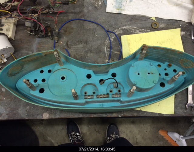

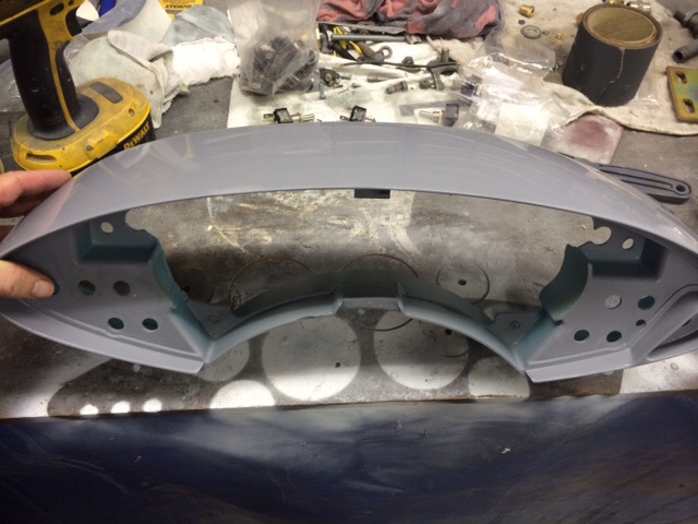

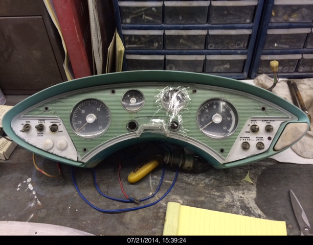

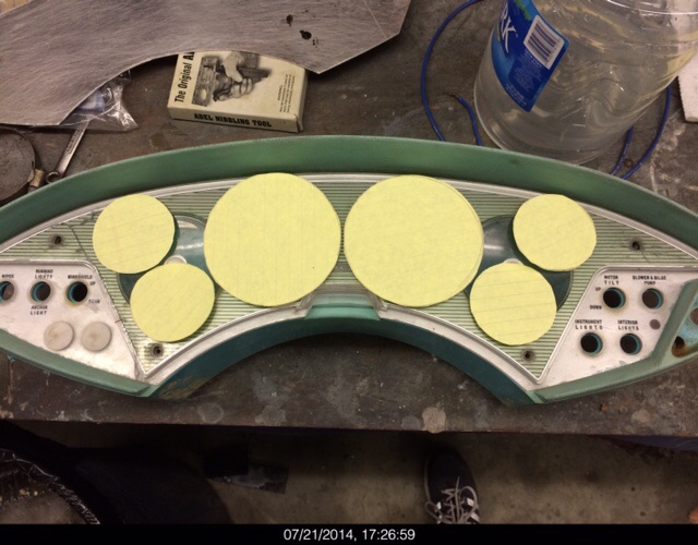

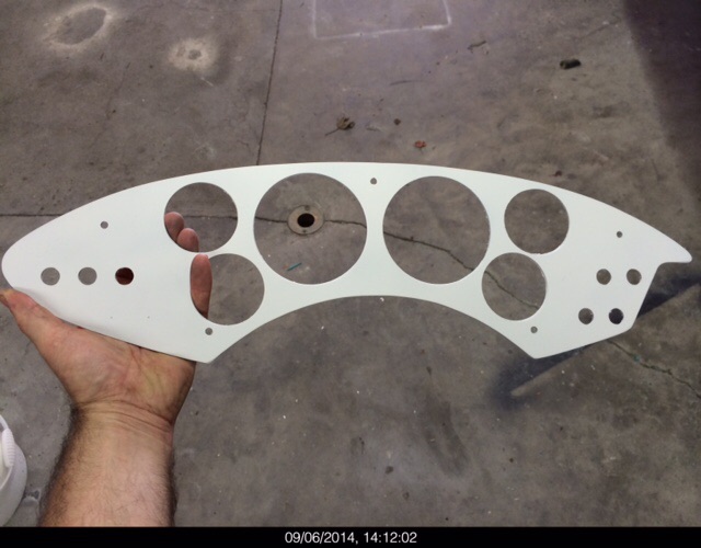

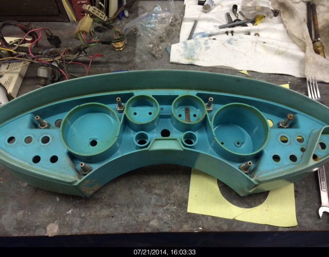

Time to sort out the instrument panel...
This is the original configuration, 4 gauges, 2 idiot lights, and a bunch of switch location.
Stripped clean, now I want to figure a way to install 6 modern gauges, keep all the switch locations, and not look like a hack job!
Back side of the panel.

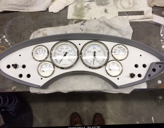

Proposed location for the new gauges.

What if you recreated the dash cluster out of wood or aluminum, or anything else for that matter? Just saying because there can't be that many originals out there.
-Brian
Re:1964 Johnson Deluxe Resto-Mod 11 years 9 months ago #105044
A piece of engine turned aluminum cut to fit area on gauge panel. Cover the entire elipse shape
Re:1964 Johnson Deluxe Resto-Mod 11 years 9 months ago #105045
  • agleason
  • agleason's Avatar Topic Author
  • Posts: 327
  • Karma: 25

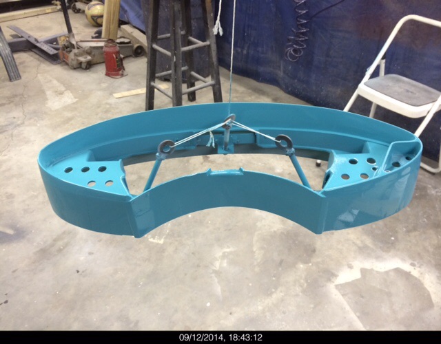

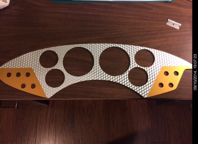

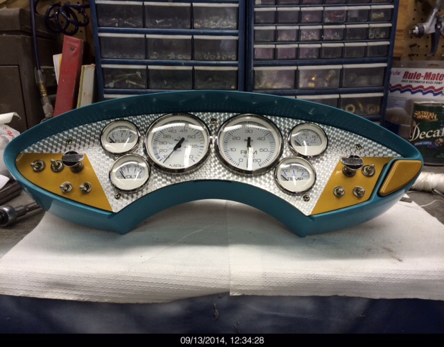

Great ideas! This what I came up with... A very tough piece of aluminum. It is in white primer at this point.
An I carefully opened the housing to make room for the gauges.
So far so good...
Re:1964 Johnson Deluxe Resto-Mod 11 years 9 months ago #105047
Looks good!

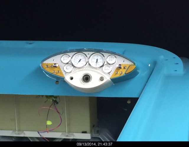

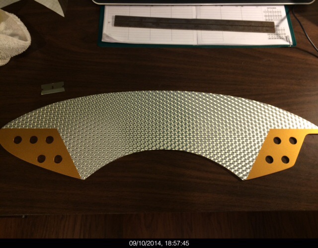

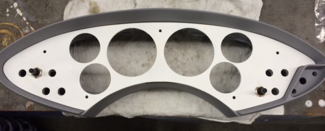

Thanks for the compliments guys... This panel is important to the entire project. It's where all eyes will go first, whether good or bad.
Test fitting the gauges... looks pretty good
I took a page from Jan Hadley's play book, the engine turn decal!
I wanted a contrast color for the switch locations though. The original panel did something similar.
The engine turn decal has to be lined up properly, the pattern has to be centered and straight... You would "see" it even if you didn't realize it.

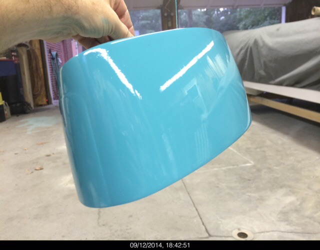

Painted the housing...
Looks pretty decent I think...
Re:1964 Johnson Deluxe Resto-Mod 11 years 9 months ago #105071
What's covering the switch areas that don't have the turning decal?
Re:1964 Johnson Deluxe Resto-Mod 11 years 9 months ago #105072
  • agleason
  • Posts: 327
  • Karma: 25
I painted that area with gold/bronze paint, then clear coated. I overlapped the decal about 1/8th of an inch with the clear to lock it down. No peeling!!

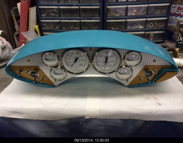

Omg, if this doesn't give you a hard-on, I don't know what will. I never imagined it would turn out like this! Very happy!
Before:
After:
Re:1964 Johnson Deluxe Resto-Mod 11 years 9 months ago #105093
  • Shelby18

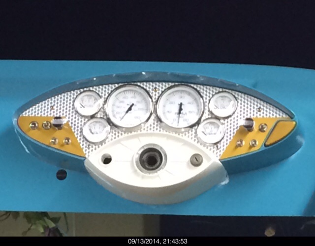

Test fitted dash to the Deluxe
Re:1964 Johnson Deluxe Resto-Mod 11 years 9 months ago #105522
Looks fantastic!

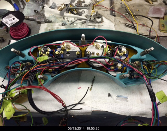

Wires wires wires!

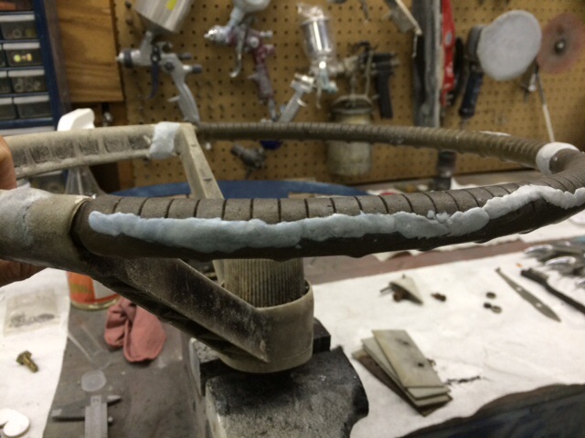

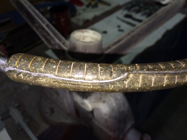

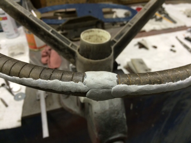

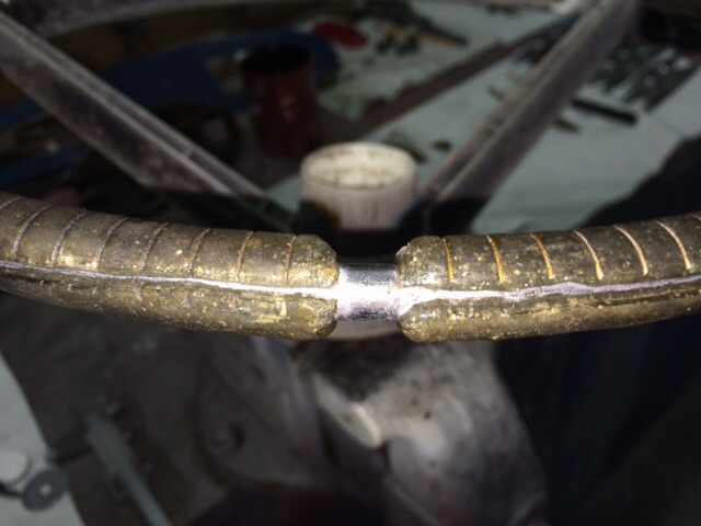

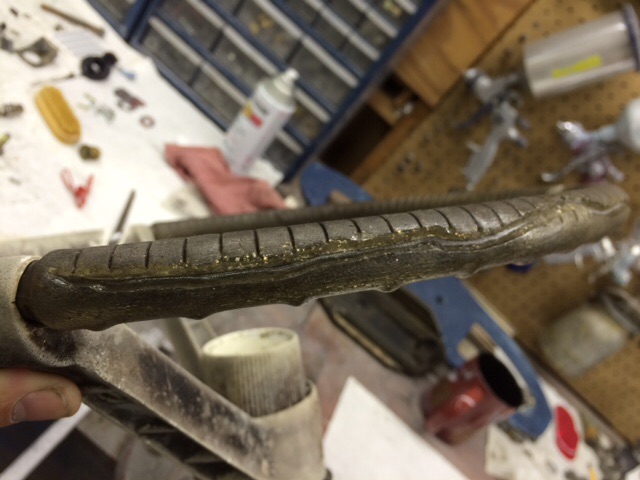

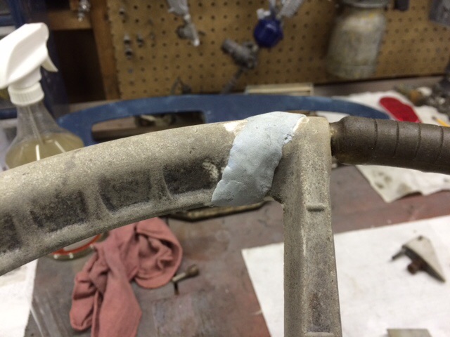

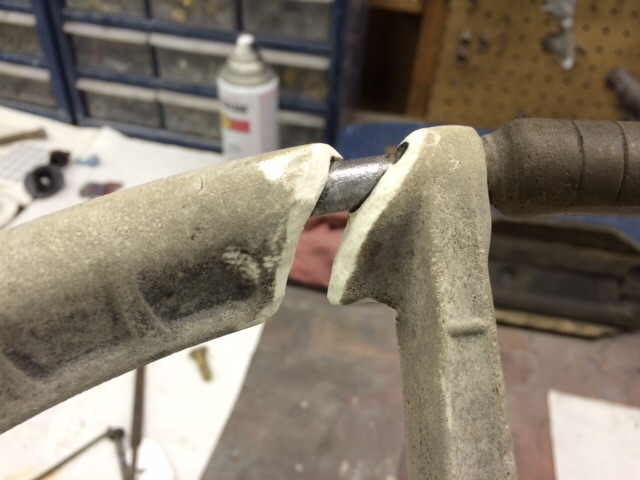

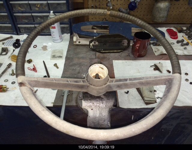

Cracked steering wheel...
I opened all the cracks up, cleaned the metal and treated the rust.
Re:1964 Johnson Deluxe Resto-Mod 11 years 9 months ago #105560

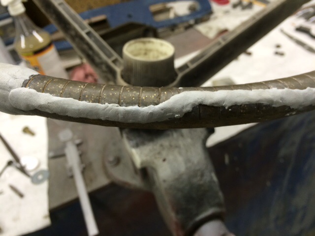

Im sure u gota game plan but thats one thing i have done for classic auto steering wheels...kitty hair works great or if someones tryin to save some money they have bondo hair at walmart for 12 a quart..i have been very impressed by that stuff..doing steering wheel grooves always sux no matter what lol
Re:1964 Johnson Deluxe Resto-Mod 11 years 8 months ago #105598
  • agleason
  • Posts: 327
  • Karma: 25
I used a 2 part epoxy putty, mixed and packed into the cracks...
