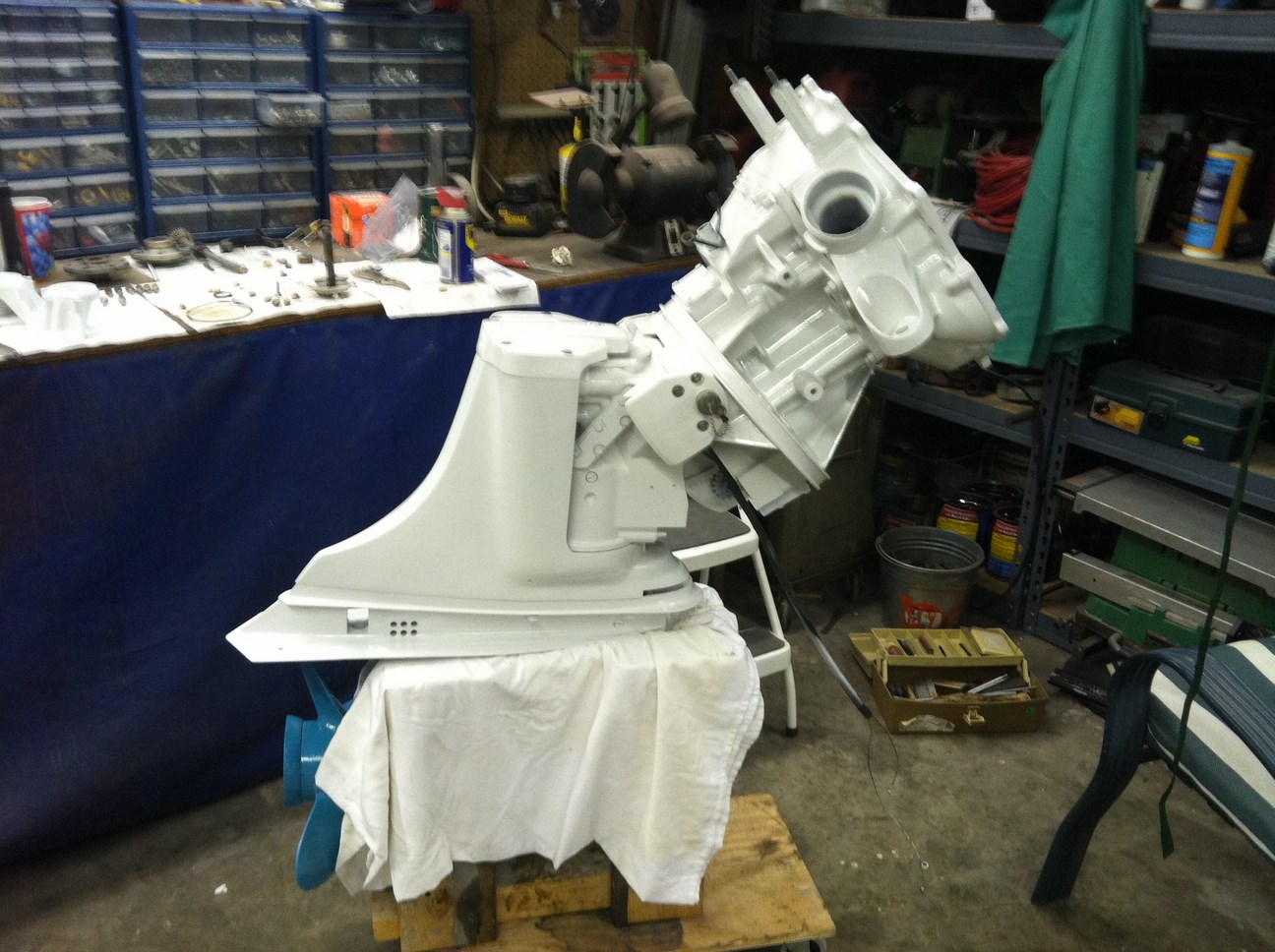

You have a high profile drive. Actually I believe that all the drives were high profile until the early 70s (but I could be wrong). What that means visually is that your exhaust shroud is about 4" taller. Internally there are obviously differences regarding shaft length but that is not the issue.
The issue is that your motor sits 4" higher from the bottom of the boat. This makes servicing the starter and such easier BUT it also means your transom cut out is 4" too high. All (or at least most)late model electric shifts were low profile and all 400/800 series were low profile.
Thanks for the heads up on the length! I thought the 800 was shorter but I didn't know the exact length. I'm willing to try anything, modify the deck, mounts and transom as needed. Its amazing what you can do with some wood and fiberglass! :lol:

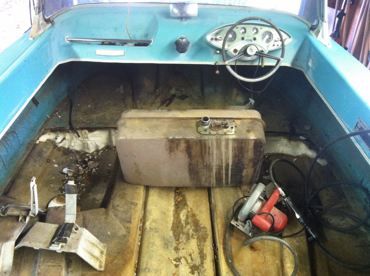

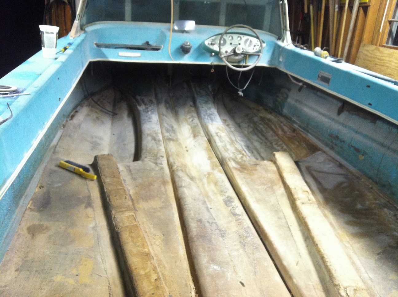

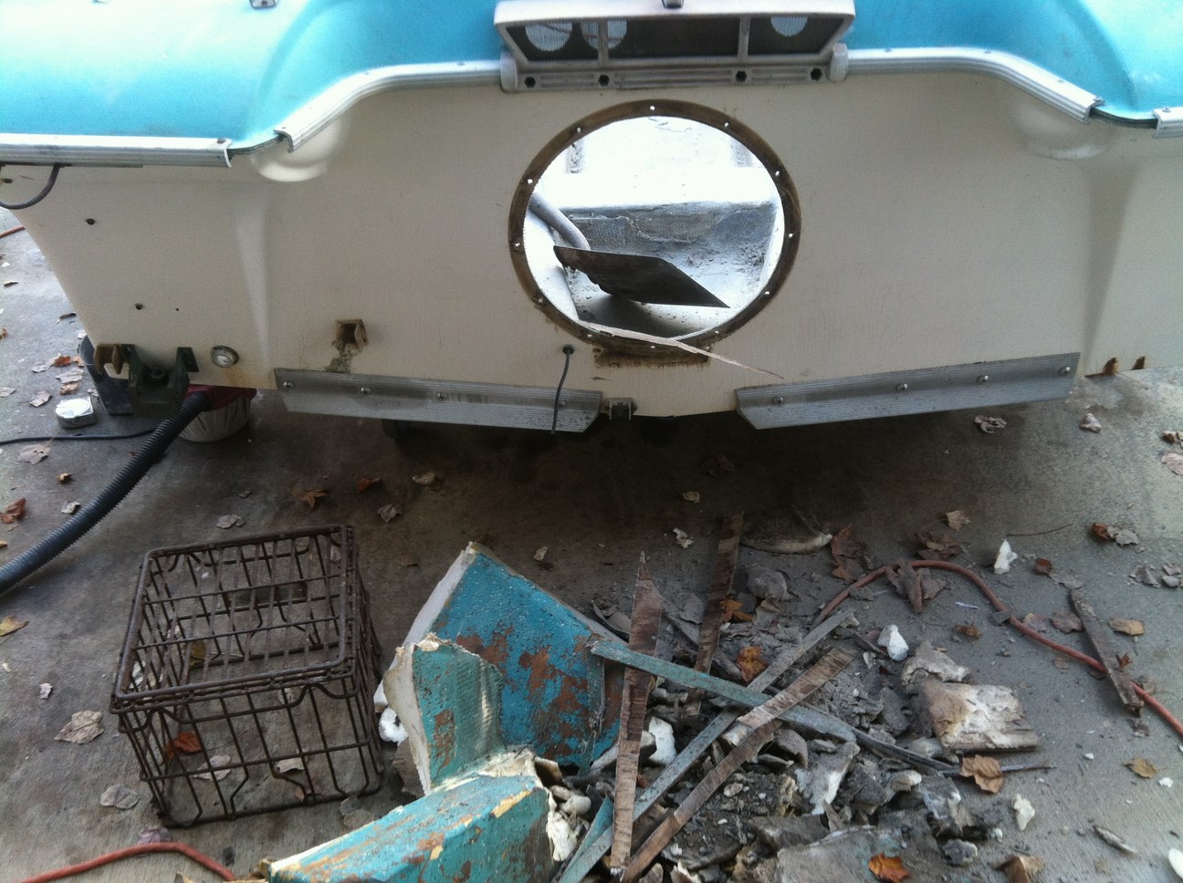

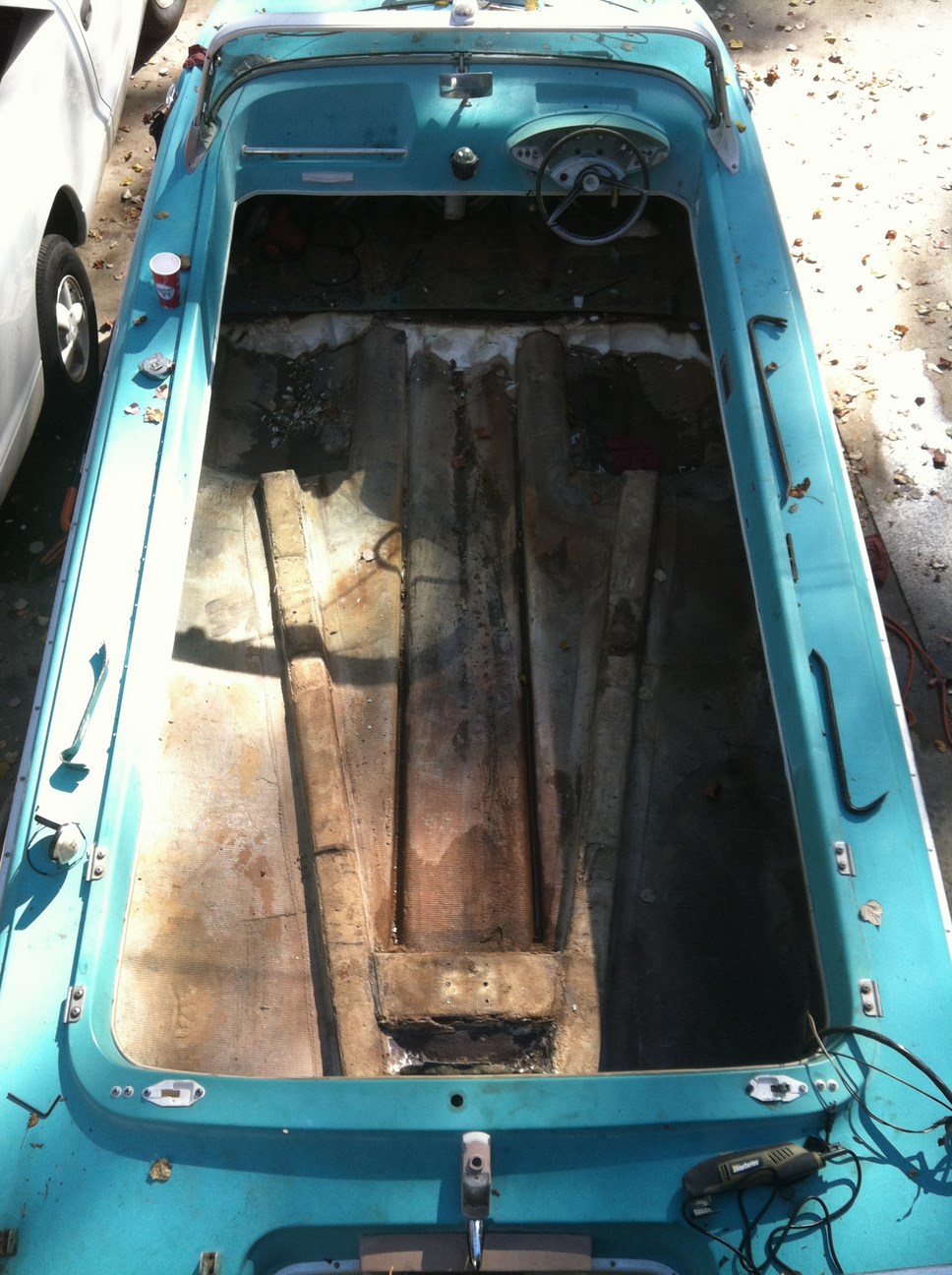

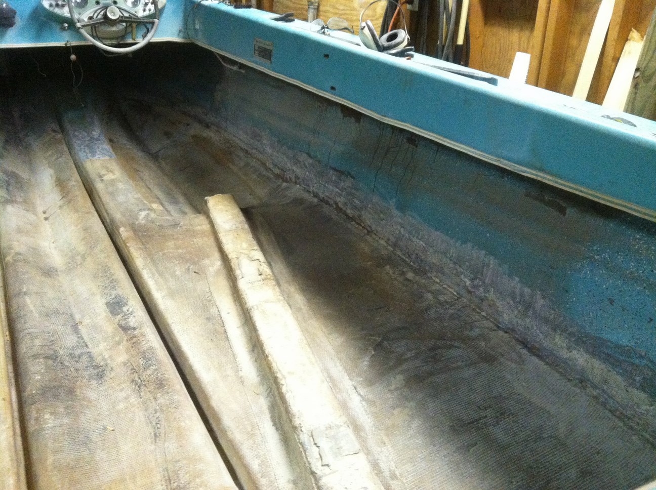

Back to work removing the rotten deck...
Clean her up some and letting it dry out.
Got the old fuel tank out of the way.
Hmmm, I wonder what I will find inside there?
Something tells me I better keep these for a template later...
The first wood I found that wasn't rotten. I've seen some people stop here and replace just the back 3/4 of the deck. Why would you do that???

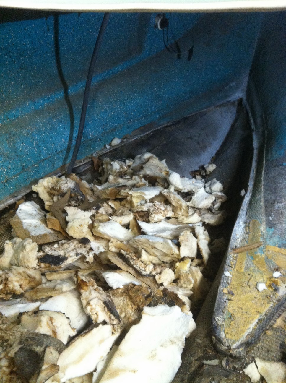

Cleaning out the port sponson.
Getting a little thin down there.

Getting all that old foam out the sponson was a chore!

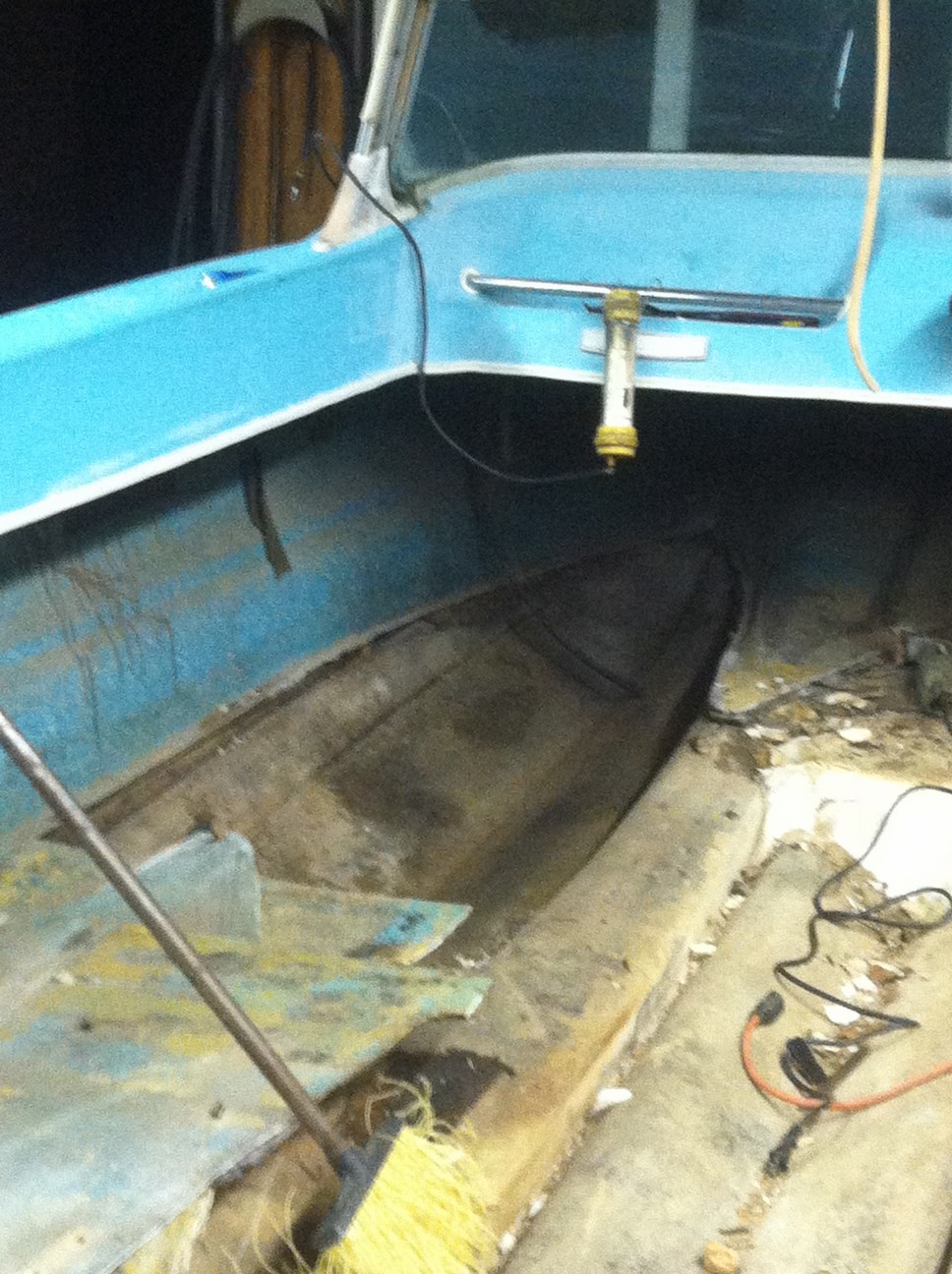

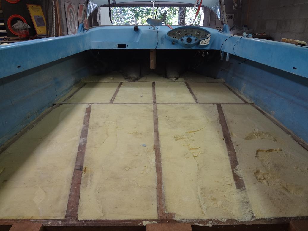

The foam and rotten deck removal continues!
Got her all cleaned out, now its time to start the grinding. Anyone who knows what this is can sympathize!

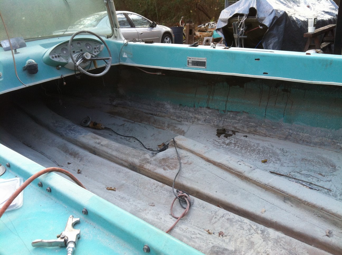

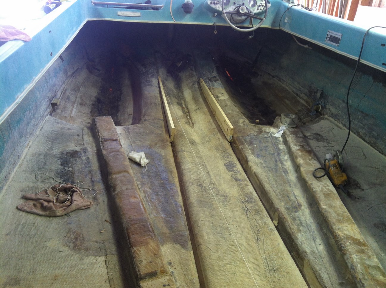

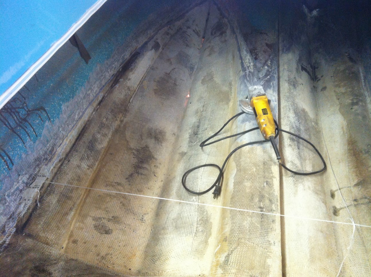

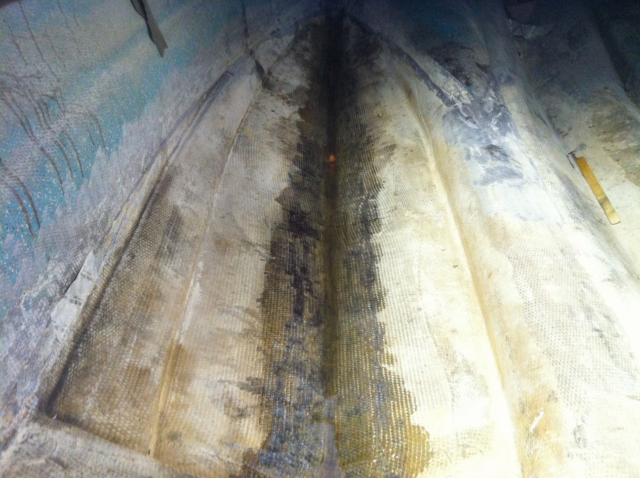

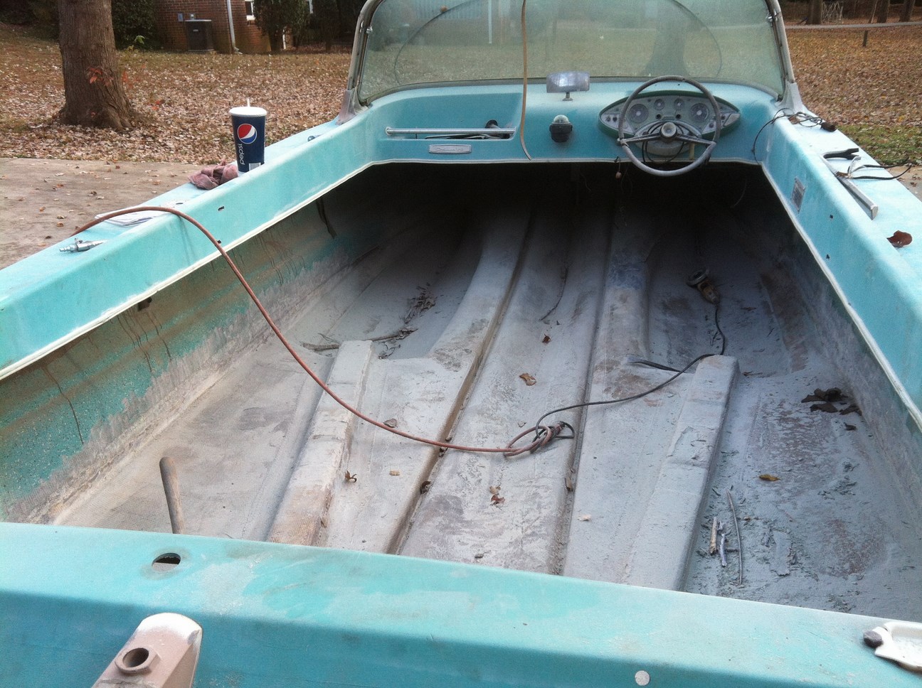

Grinding!!!!! I was so tired after spending an entire day in the boat with a 4 1/2 inch grinder. Full tyvex suit, respirator, ear muffs, and of course, eye protection.
This is the part where a lot of people quit on a boat and find something else to take apart. Not me, the constructive part is what I live for!

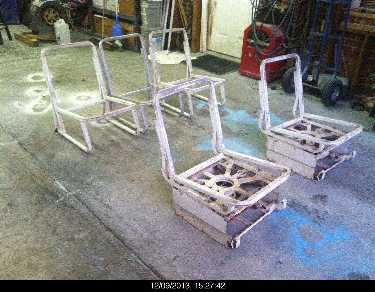

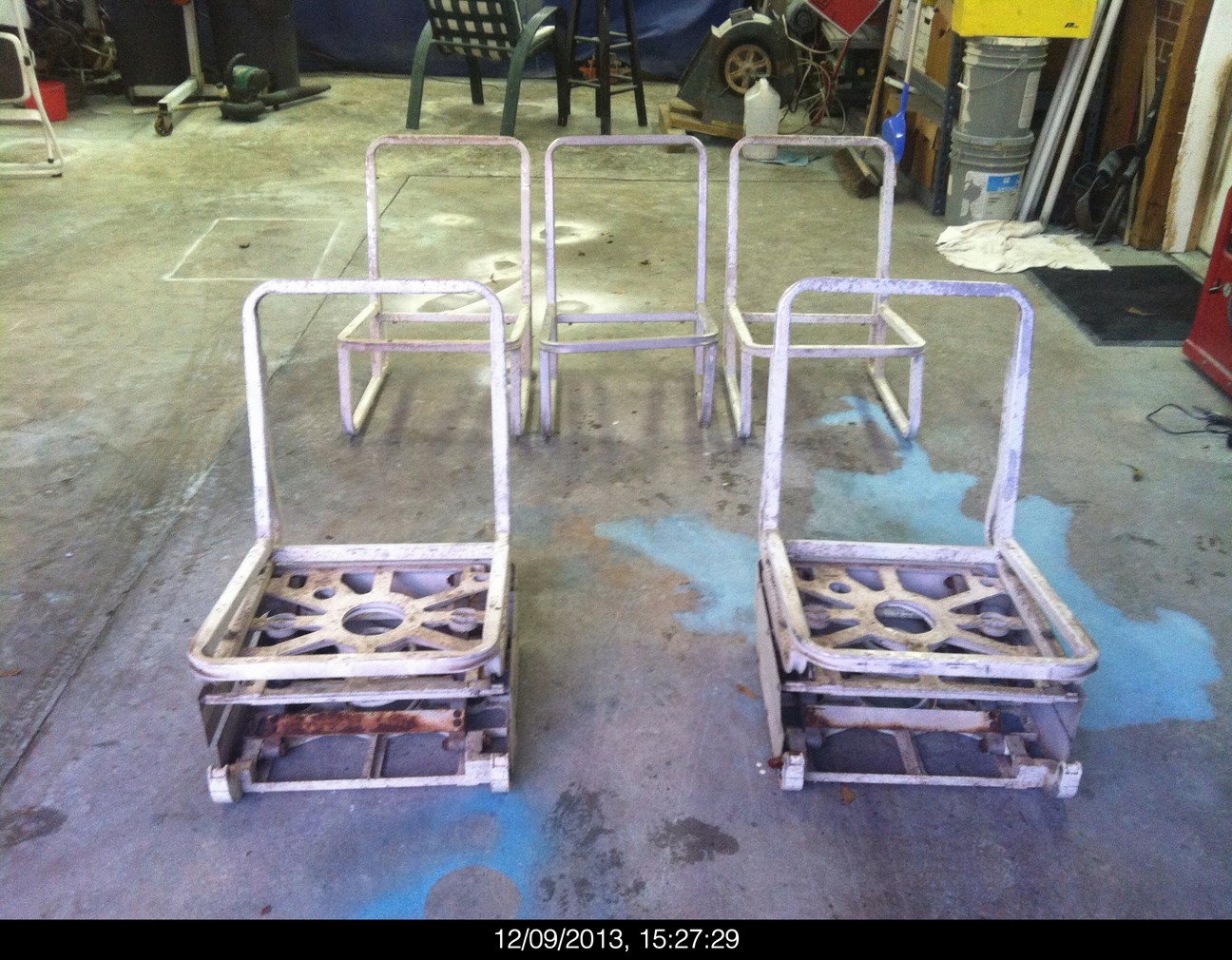

I can't remember if you have seats. I have a complete set of five original seat frames, no cushions, that the owner didn't want to use...cheap to good home.
I do need some seat frames, shoot me an email at This email address is being protected from spambots. You need JavaScript enabled to view it., if the price is right I will lay the cash in your hand next week!

Things I've learned so far:
1. Anything can look good in a picture.
2. You will spend as much time cleaning up as you will actually working on your boat! That dust is murder.
That being said, another day was spent with a shop vac and broom getting rid of the grinding dust.

SCORE!!!
A big special thanks to Jan Hadley @ Nautilus Restorations, he hooked me up with a set of seat frames today at a super awesome price!! Jan knew I needed these pretty bad and could have priced them high.
He offered them to me at a price I couldn't refuse and I brought them home today!
Thanks Jan!!

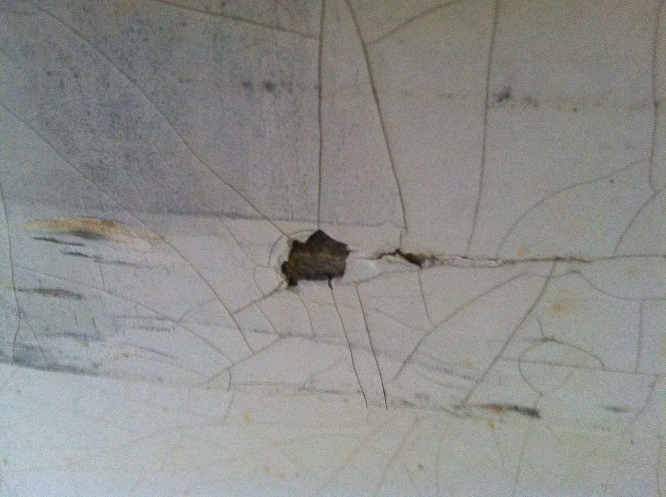

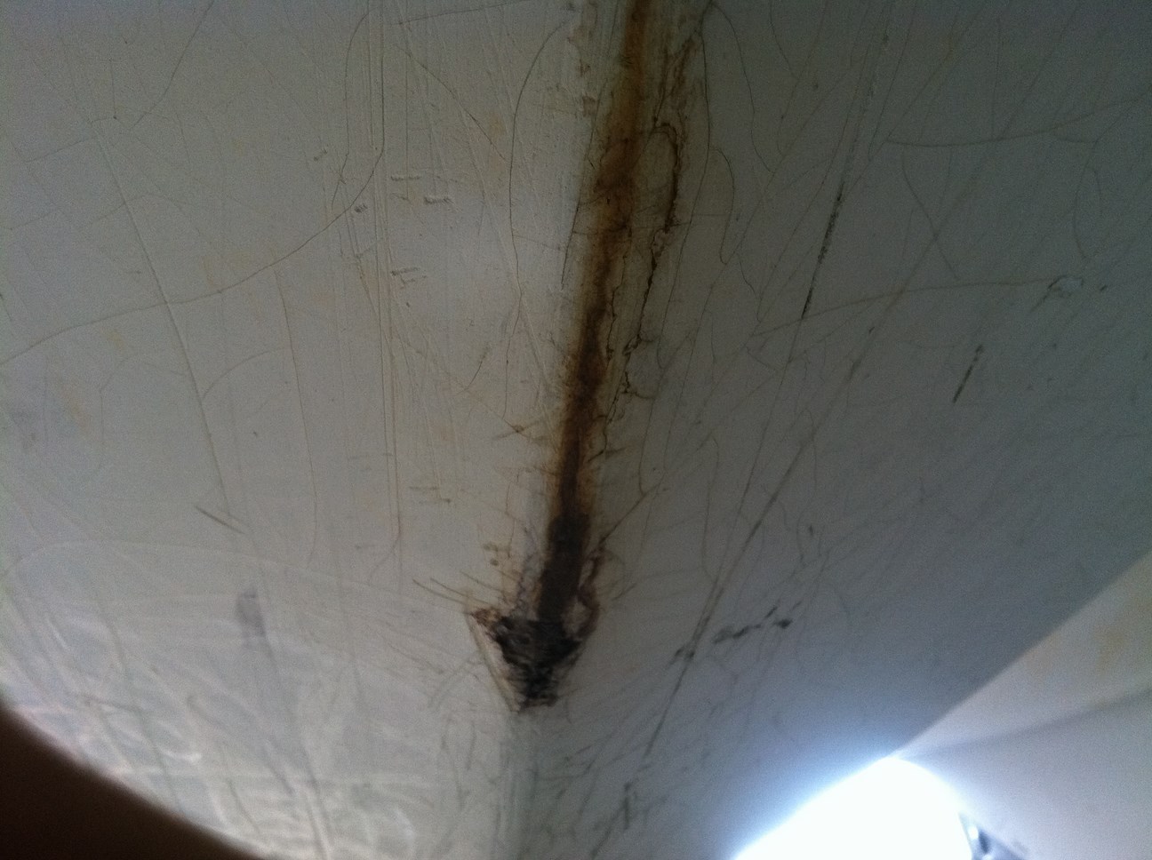

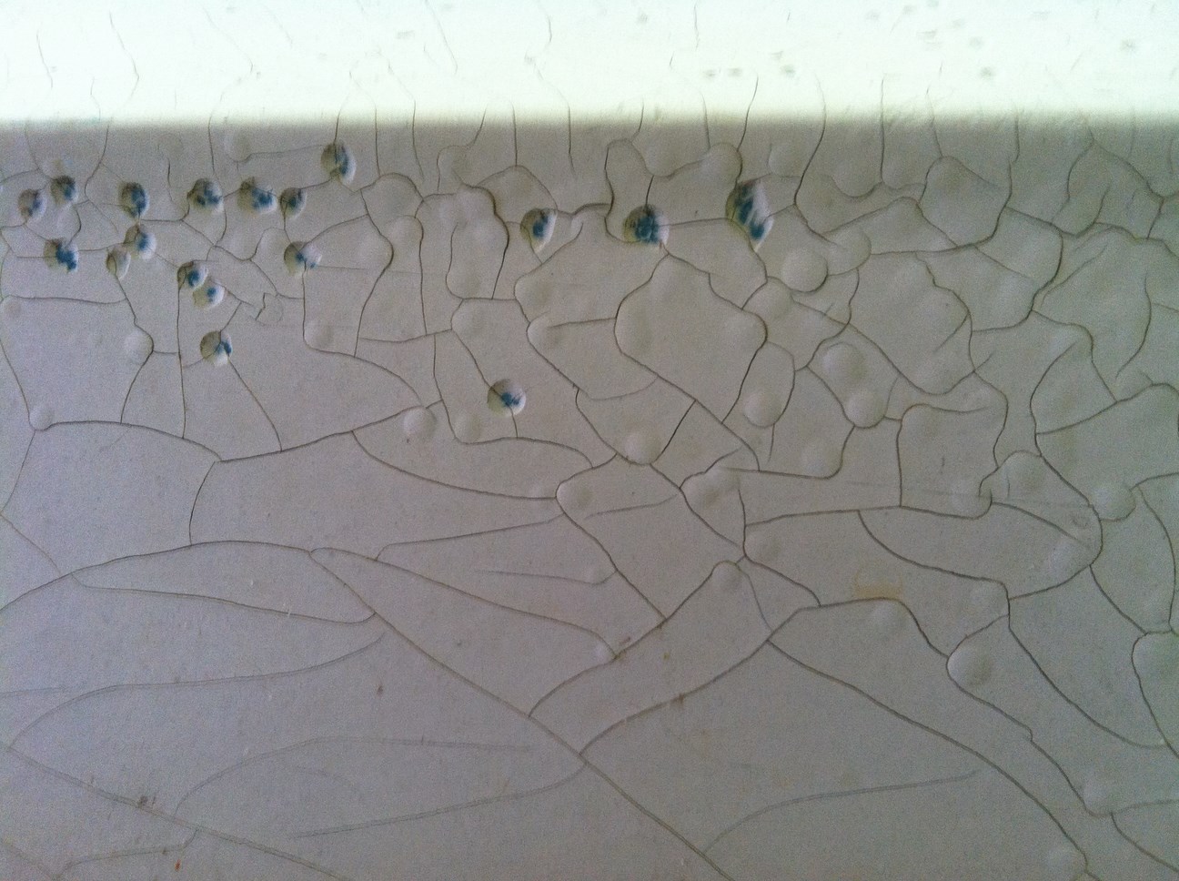

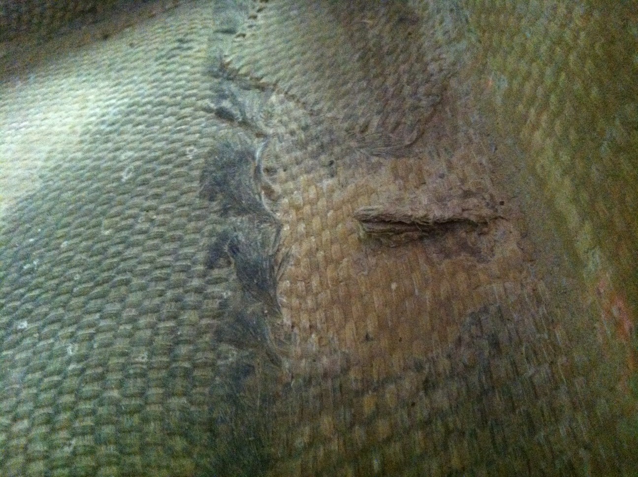

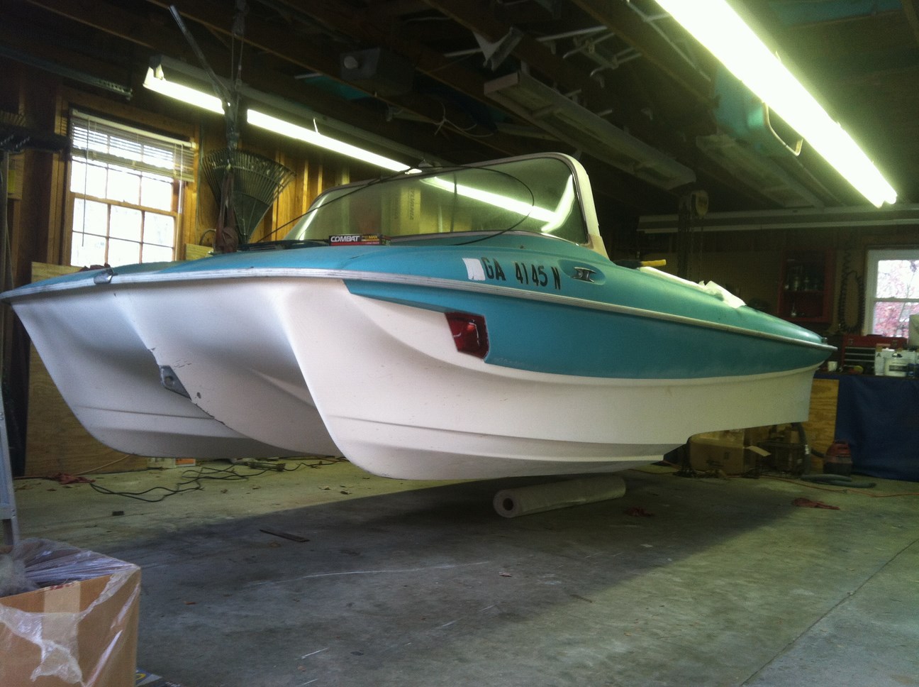

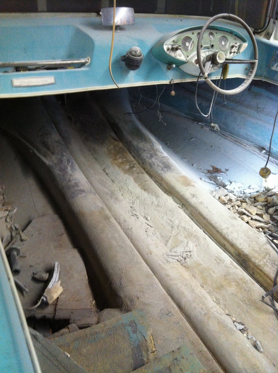

After I got the Deluxe cleaned out and up in the air, I gave the hull a good looking at. Time to access the damage and make the final decision. Give the old girl a heart, lung and kidney transplant or make this her autopsy!
I heard the words from that old Six Million Dollar Man show...
"We can rebuild him...We have the technology"

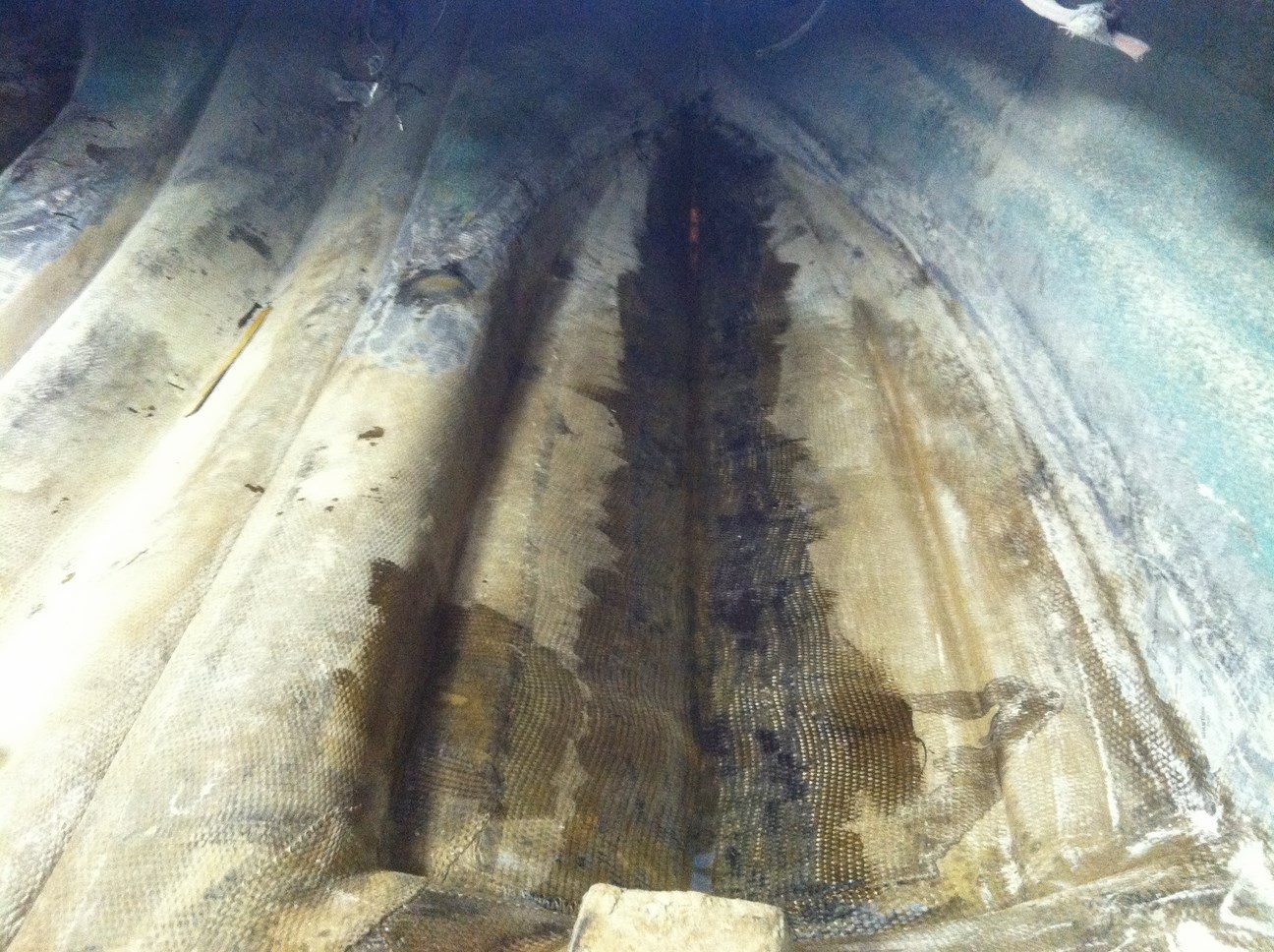

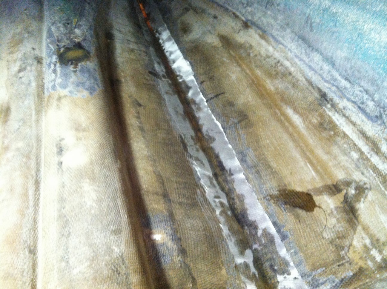

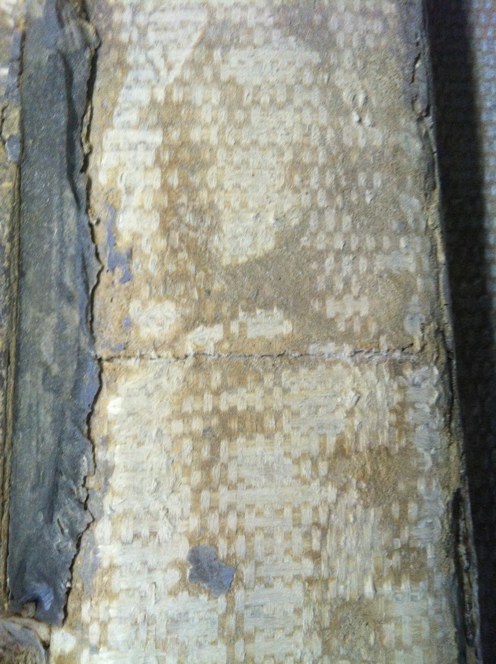

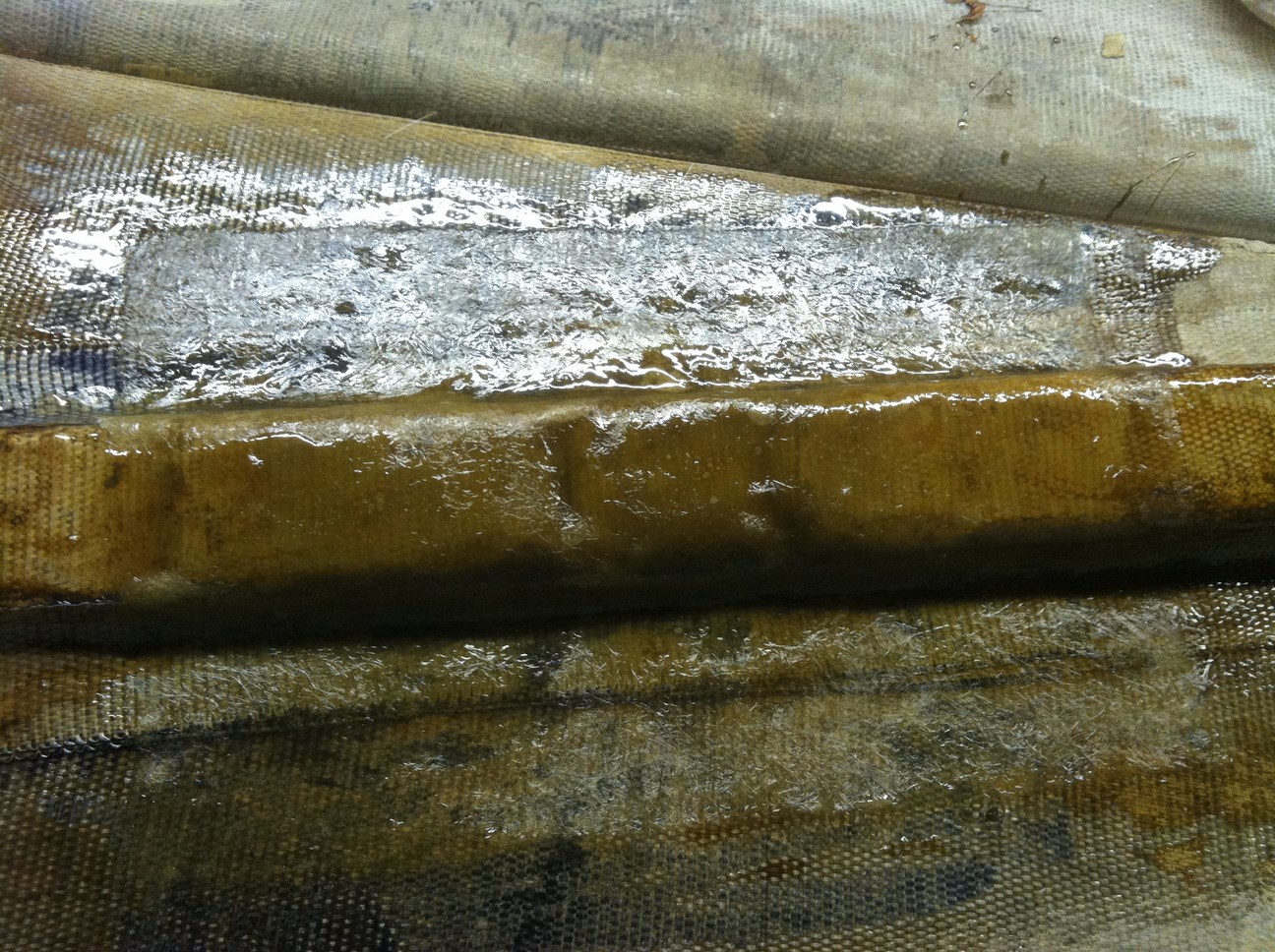

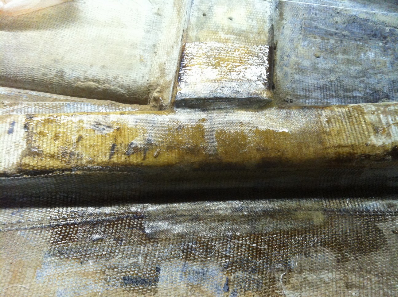

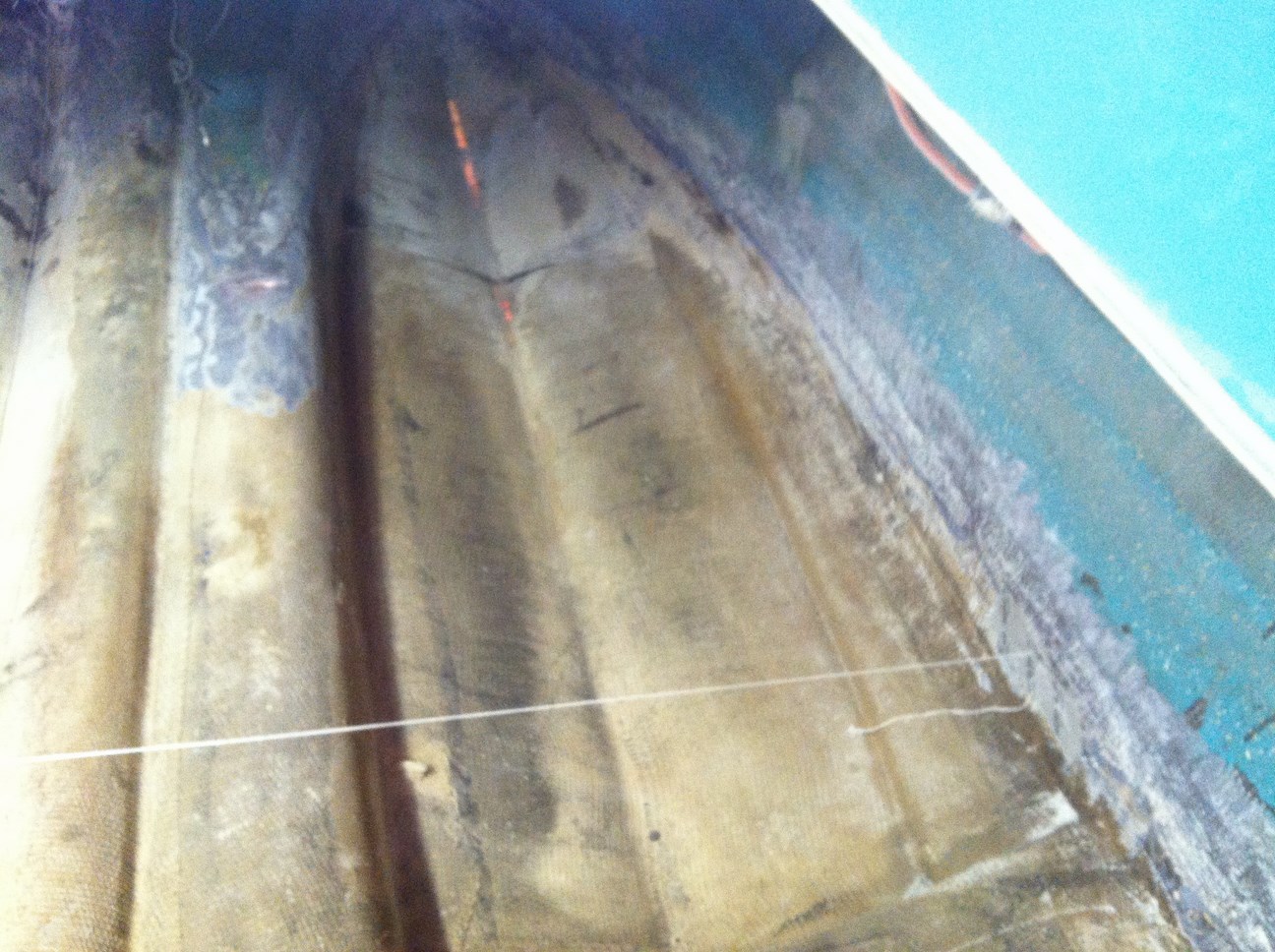

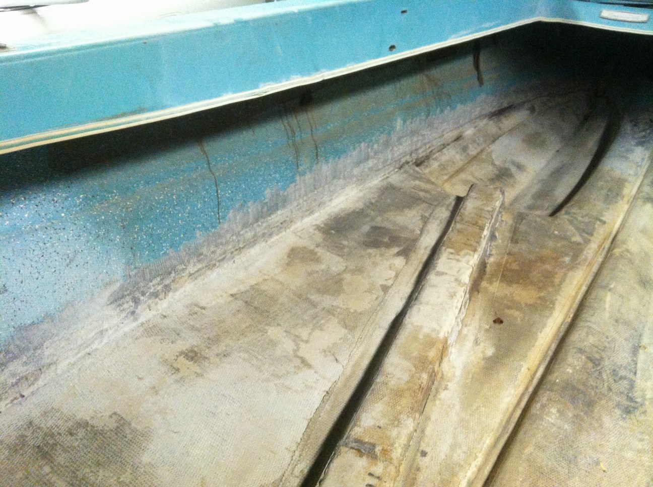

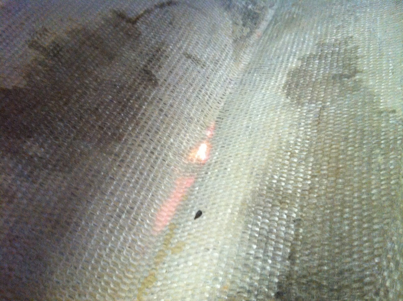

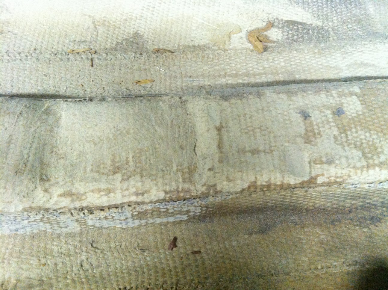

The stringers in a deluxe are fiberglass filled with foam. These will need some repair and reinforcing before anything else can happen...
Re:1964 Johnson Deluxe Resto-Mod 12 years 10 months ago #87402
  • agleason
  • agleason's Avatar Topic Author
  • Posts: 327
  • Karma: 25

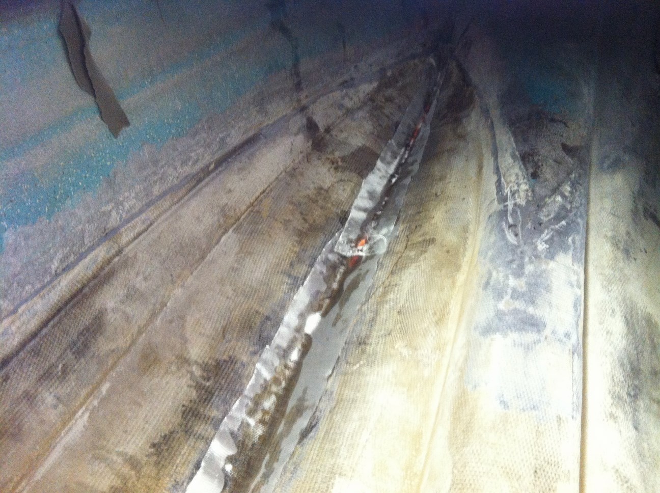

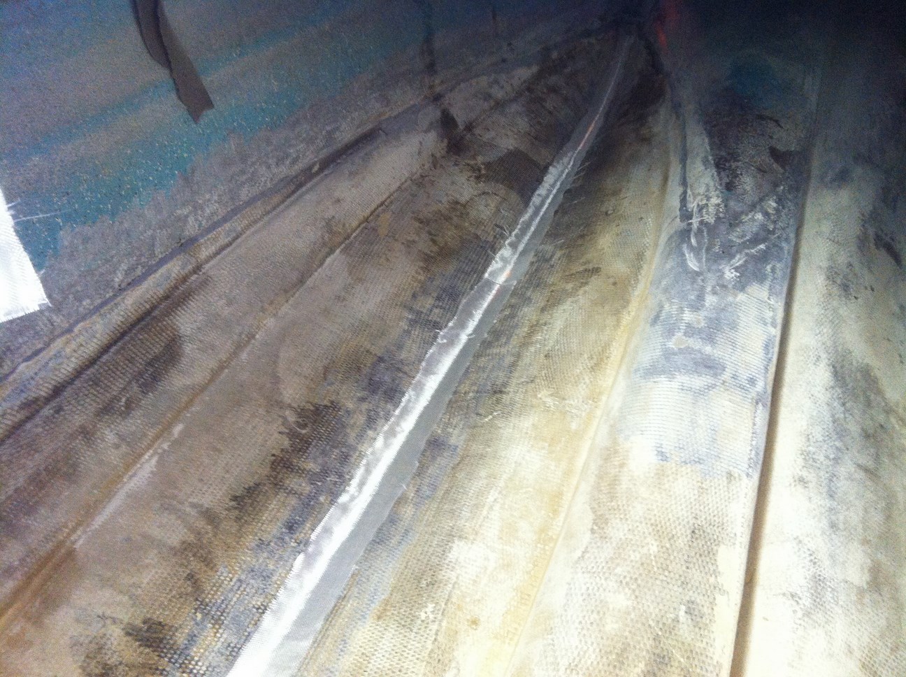

Patching up the stringers...

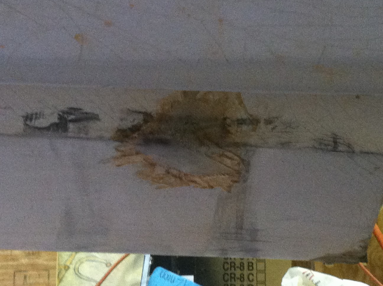

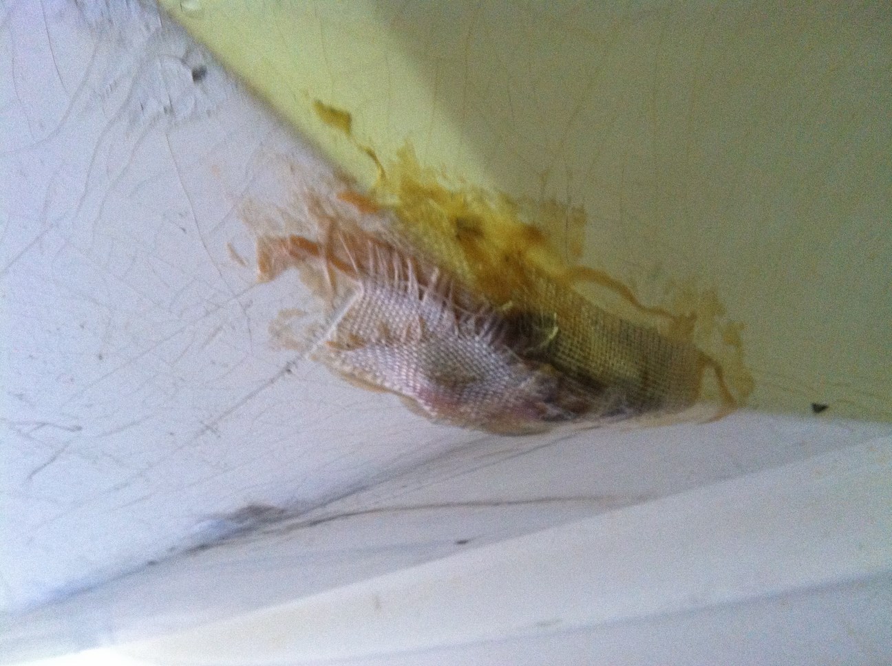

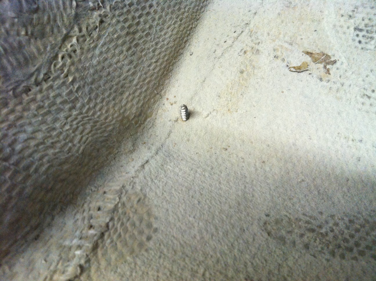

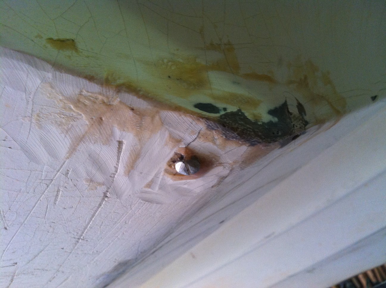

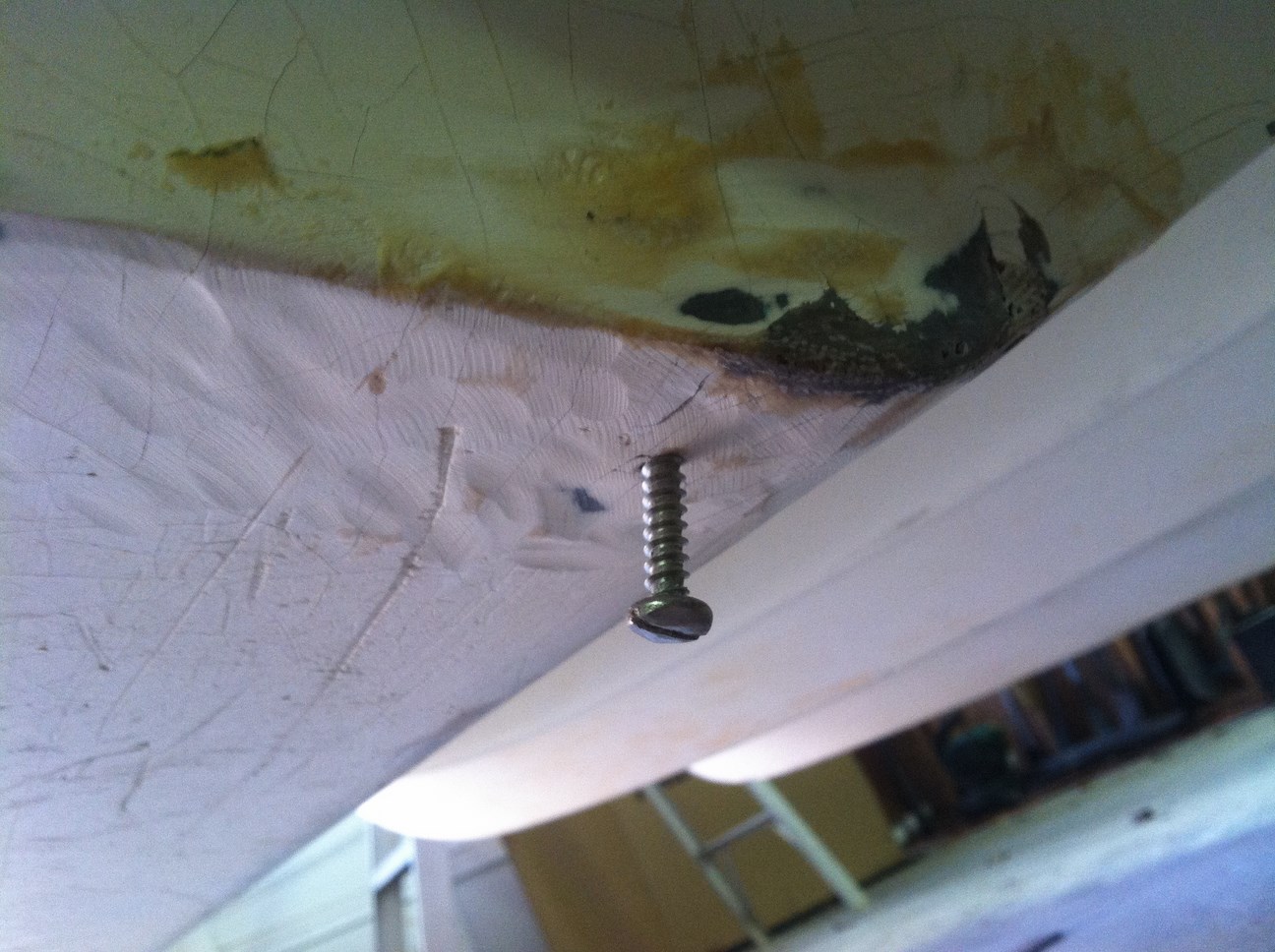

Check this out, I found 4 screws sticking up through the hull. These were covered by the scabs on the outside of the hull.
Anyone got any ideas why someone did this?

I can't say for sure but a good guess would be that your boat is haunted. The screws were probably put there to create a magnetic anomaly, generally thought to interfere with visits from those on the "other side." You should probably keep a Proton Pack with a Neutrino Wand handy...just in case. I hope this information proves to be helpful.
OK...So where are all the before/during/after gelcoat photos?
Lastly, you've got a deal on the engine/outdrive. I'll pick it up next week, bearing three gifts. If your US Comp order has arrived, I can save you a trip.
Mentor to the unenlightened!
"Success makes...
Re:1964 Johnson Deluxe Resto-Mod 12 years 10 months ago #87472
  • agleason
  • Posts: 327
  • Karma: 25
Maybe I should put those screws back in... or wear a tin foil hat when ever I'm in the Deluxe!
Re:1964 Johnson Deluxe Resto-Mod 12 years 10 months ago #87474
I don't thonk tin foil will affect a compass and I am sure the 4 stainless screws won't.
My depth perception isn't too good in those pictures but it looks to me like they are at low points. I suggest someone drilled the holes to drain water.
Re:1964 Johnson Deluxe Resto-Mod 12 years 10 months ago #87475
  • agleason
  • Posts: 327
  • Karma: 25
Their attempt to drain water failed miserably, considering the 1000 pounds of wet foam I pulled out. :S
Re:1964 Johnson Deluxe Resto-Mod 12 years 10 months ago #87509
They used them to hold the patch on in case the epoxy failed, or they were just dumb^$@*^&$.

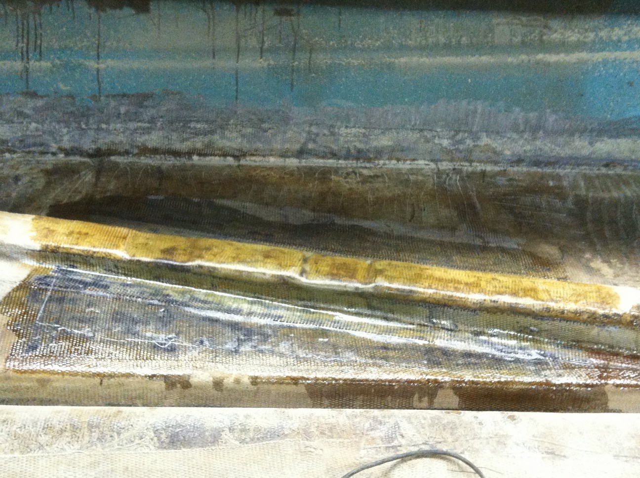

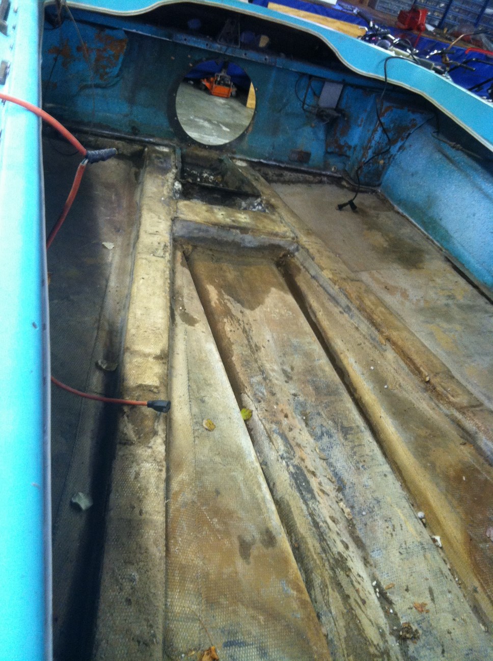

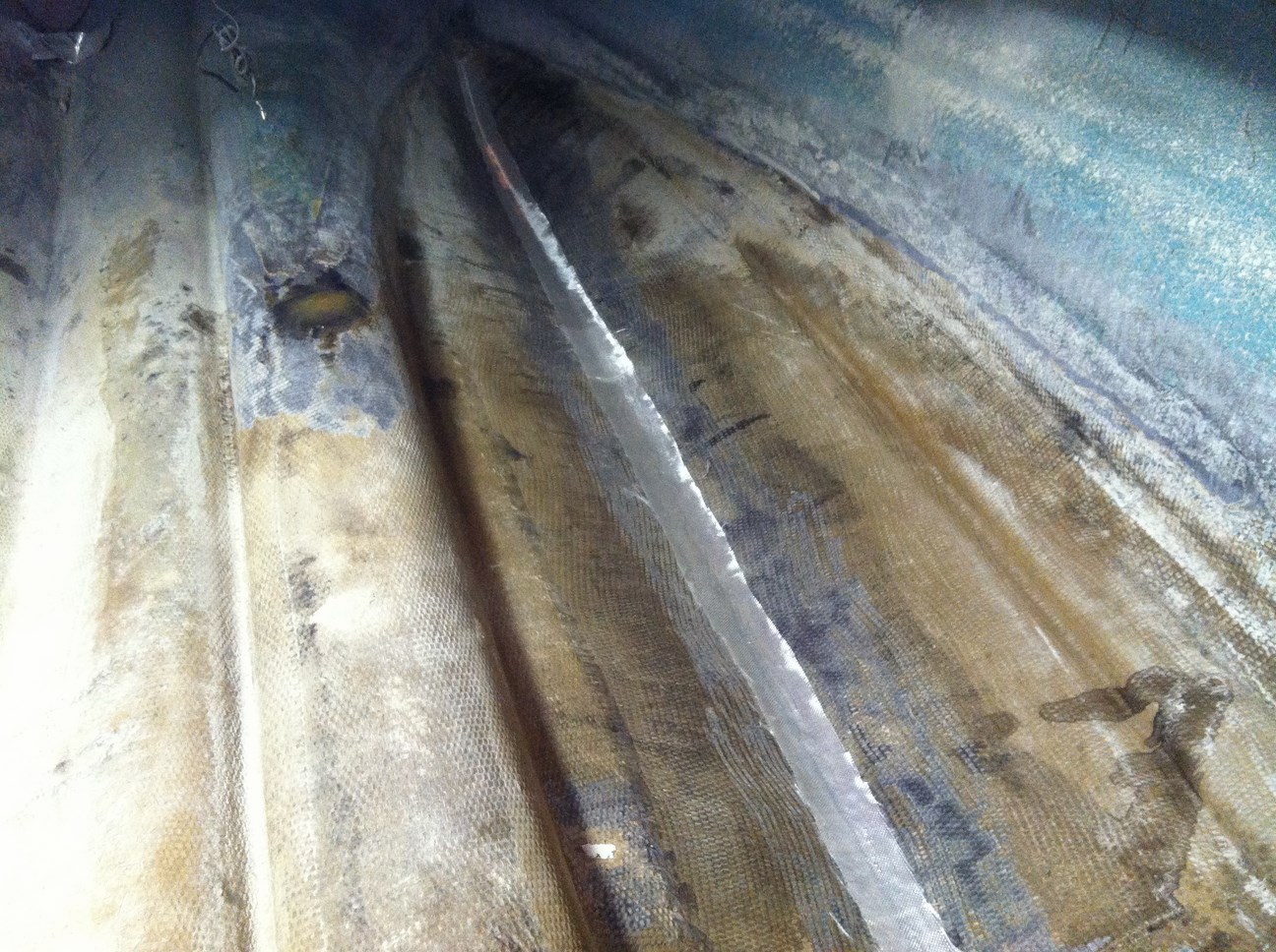

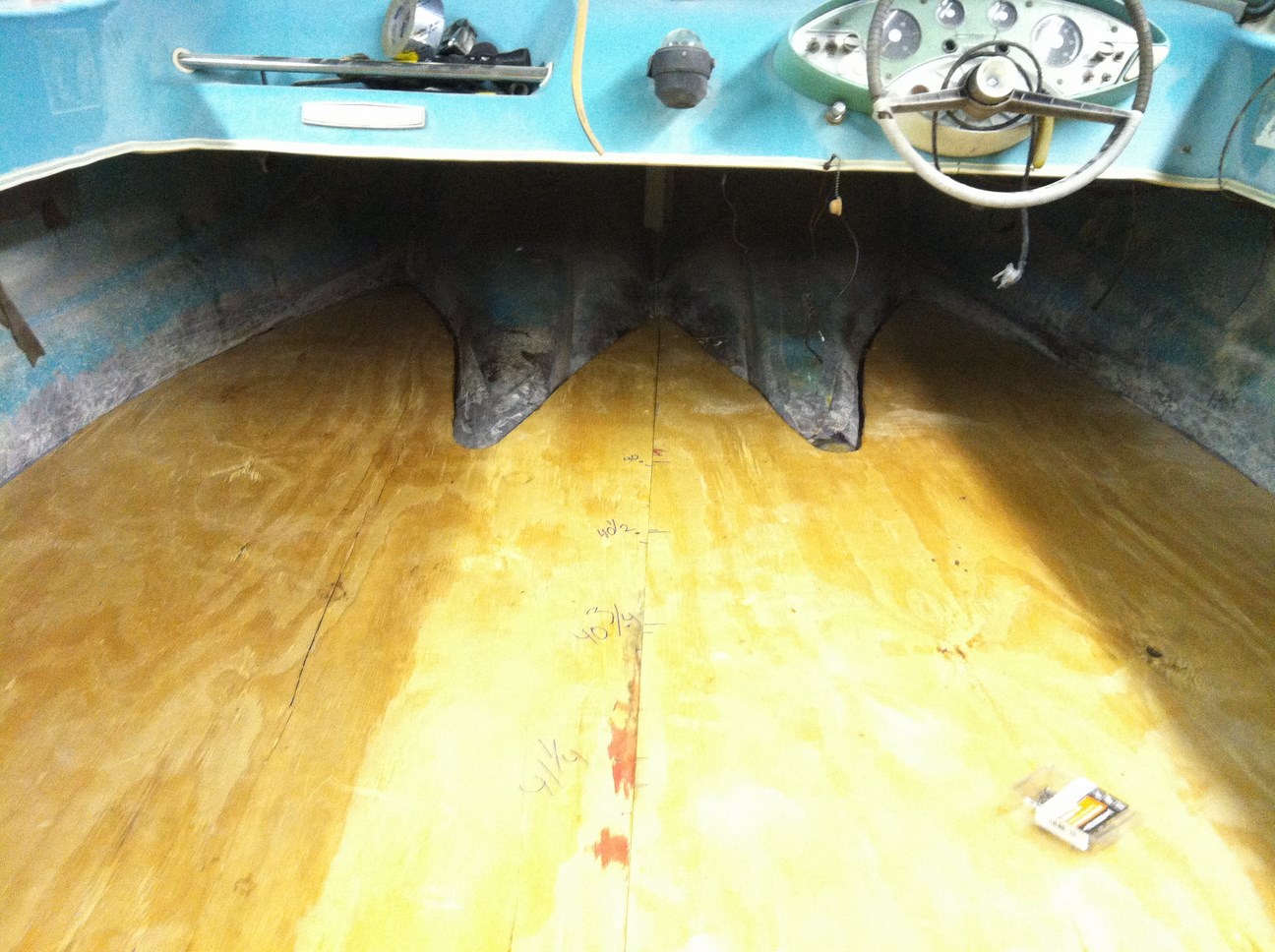

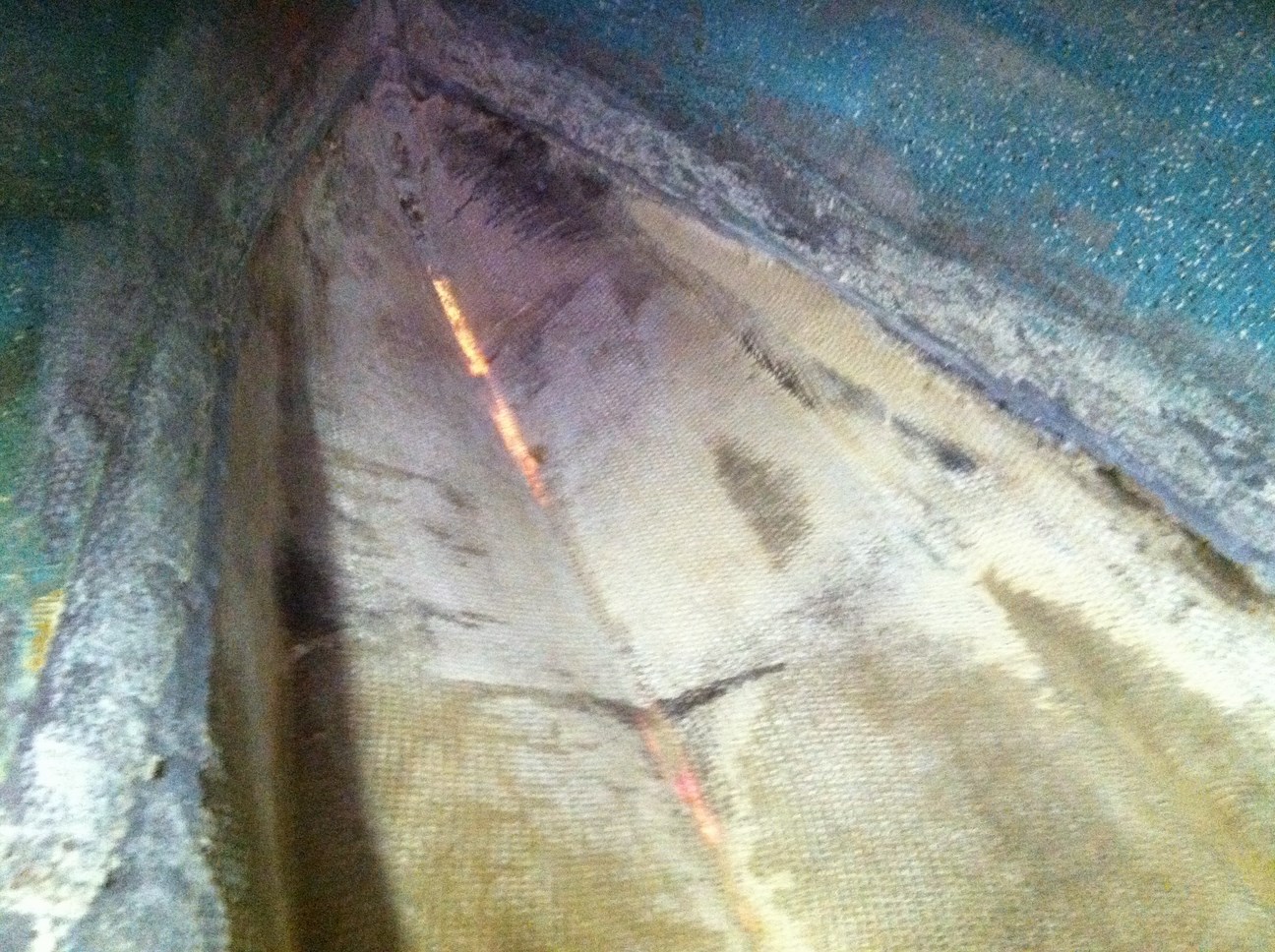

More pictures of inside the hull, planning to make some repairs before the deck is replaced.
Re:1964 Johnson Deluxe Resto-Mod 12 years 10 months ago #87526
  • agleason
  • Posts: 327
  • Karma: 25
Making a few repairs...

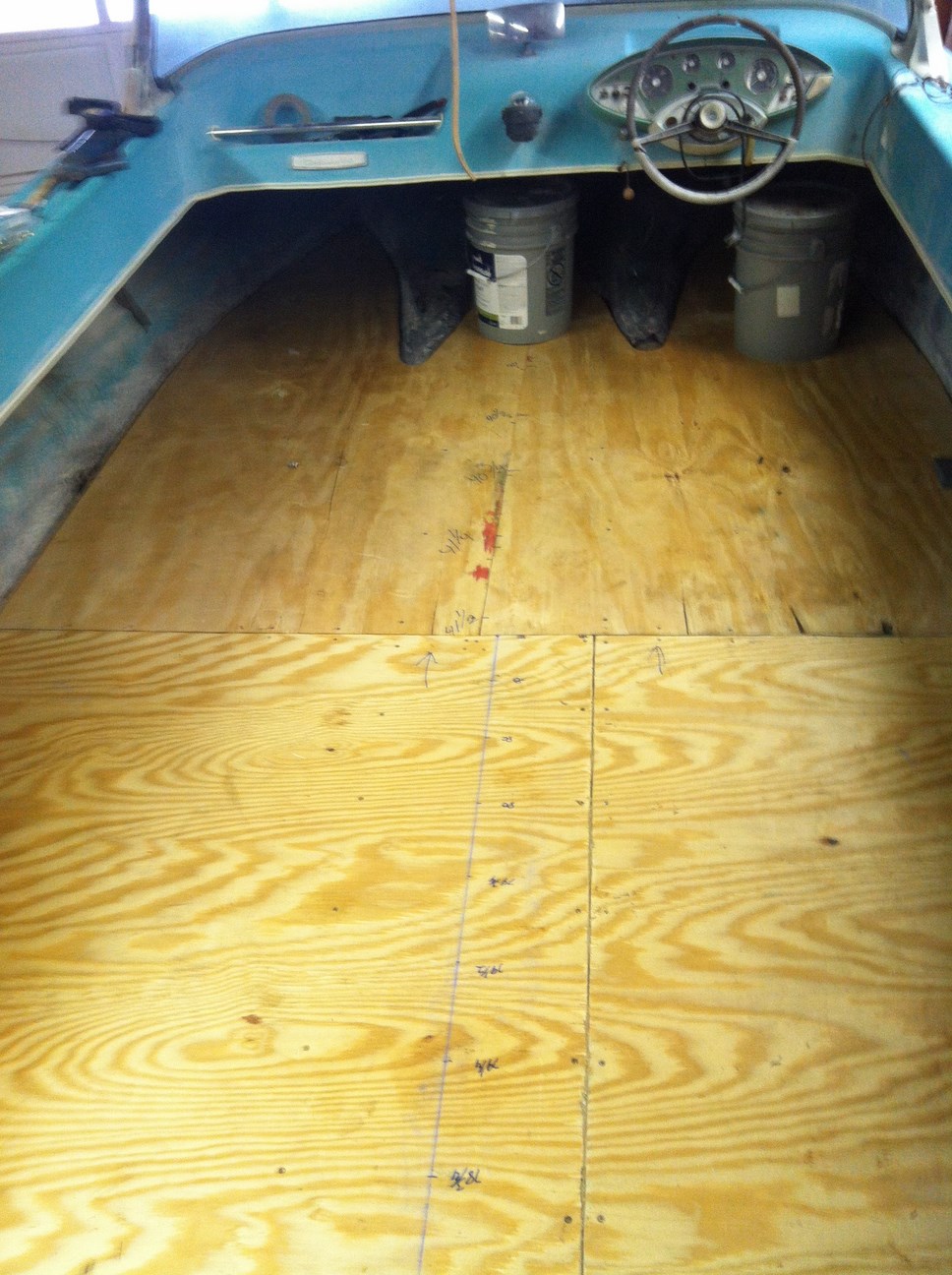

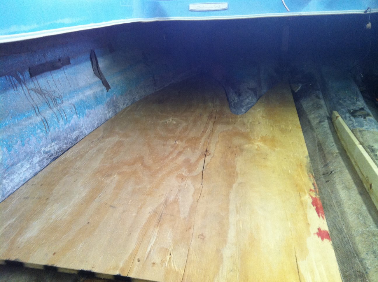

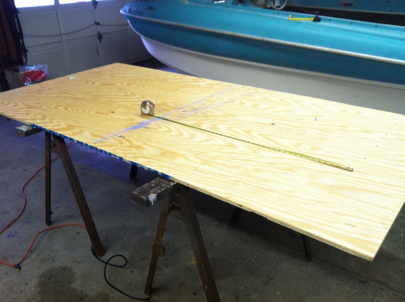

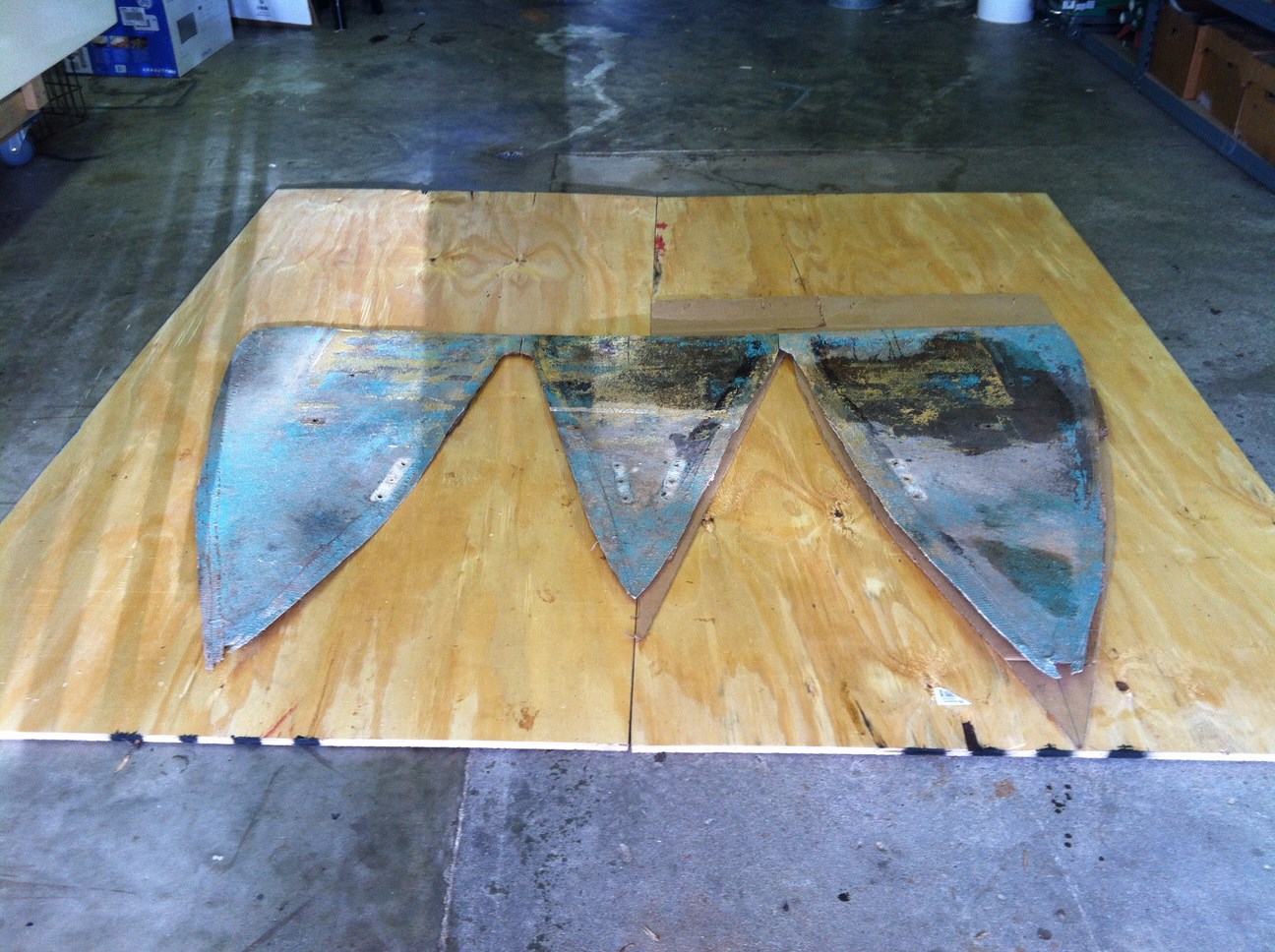

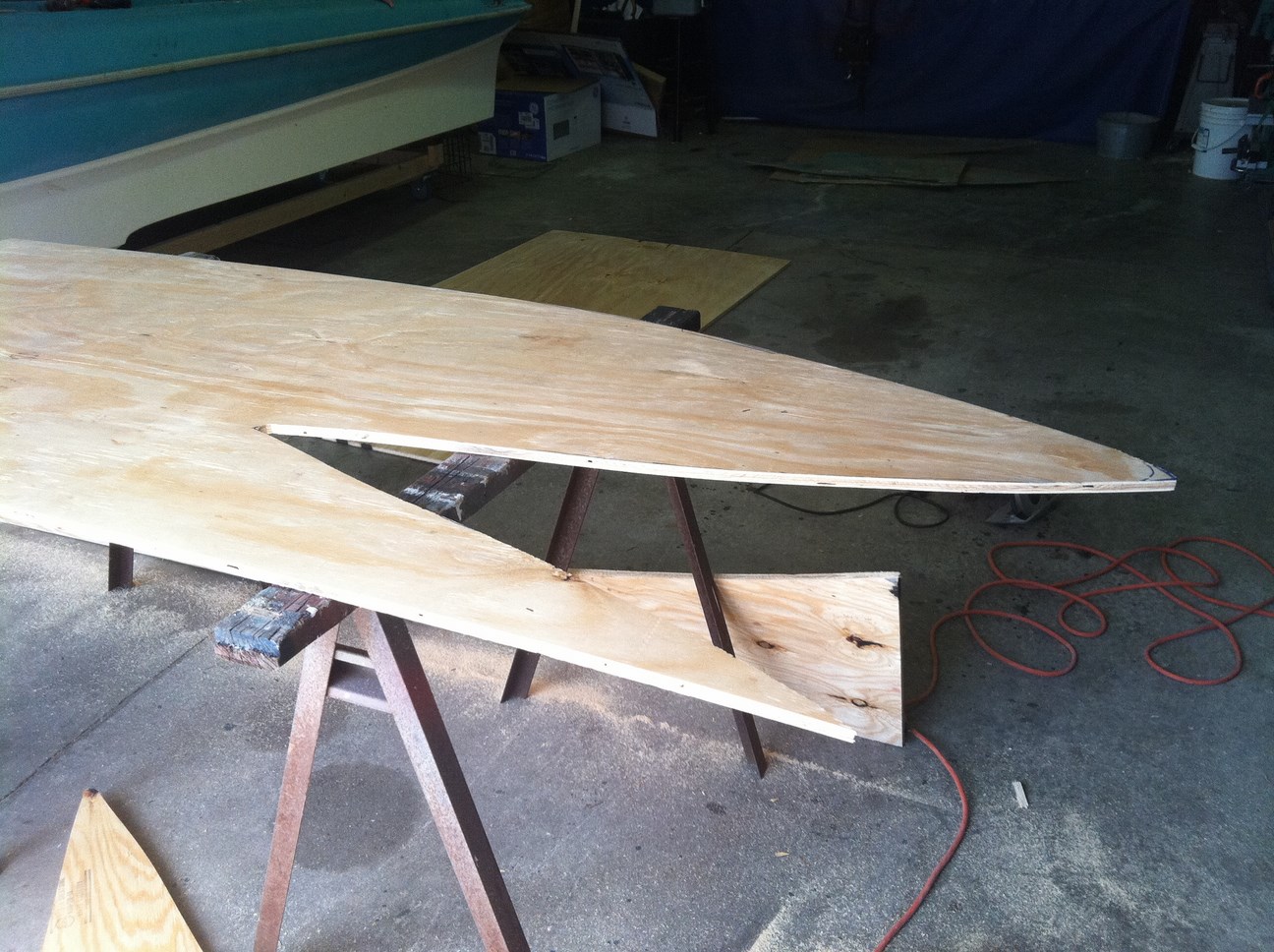

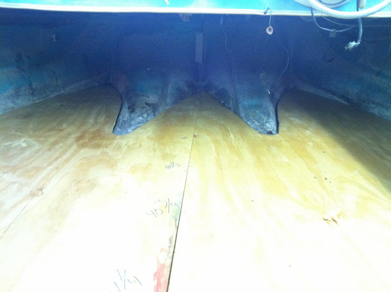

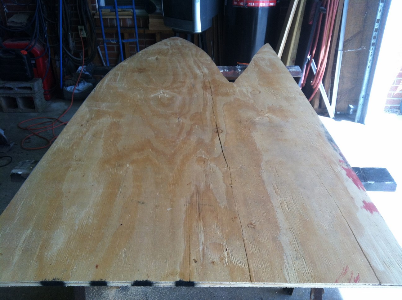

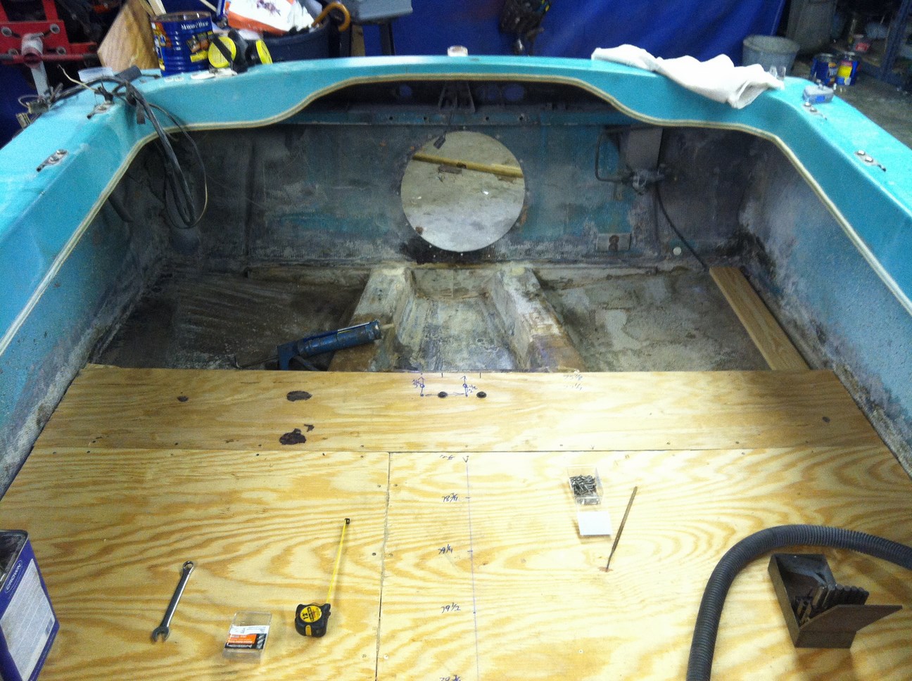

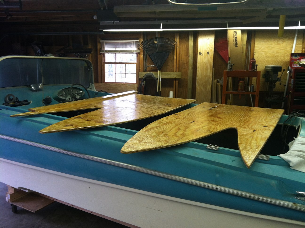

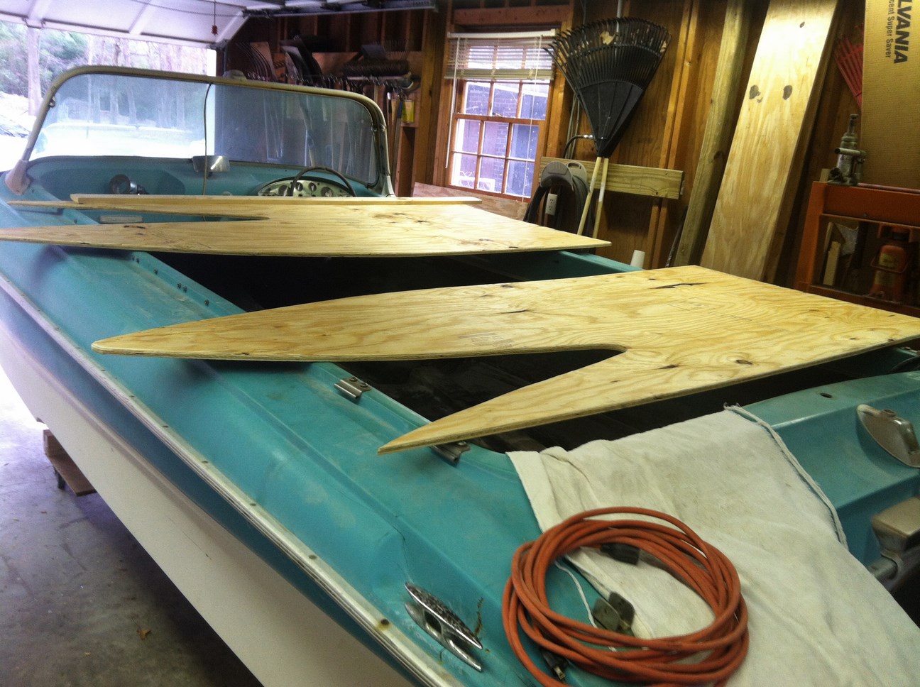

Time to start on the deck.
Re:1964 Johnson Deluxe Resto-Mod 12 years 10 months ago #87672

Re:1964 Johnson Deluxe Resto-Mod 12 years 10 months ago #87724
  • agleason
  • Posts: 327
  • Karma: 25
Photo update: Cutting out the deck and treating the bottom and edges with polyester resin. The deck is glued in with PL premium, stainless screws.
I have found that 5 gallon buckets full of water make good weights to hold things in place.
