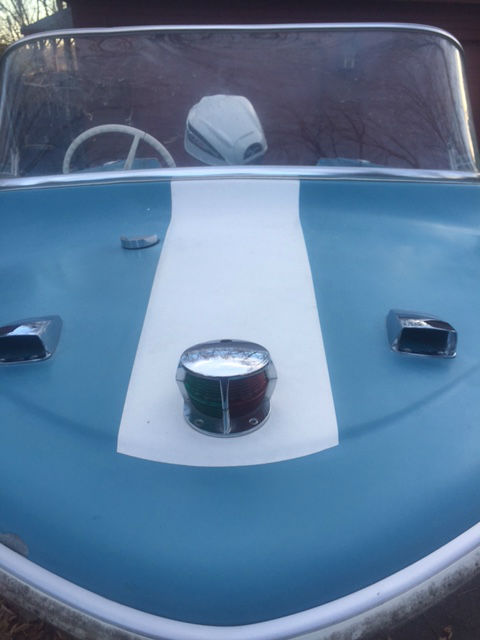

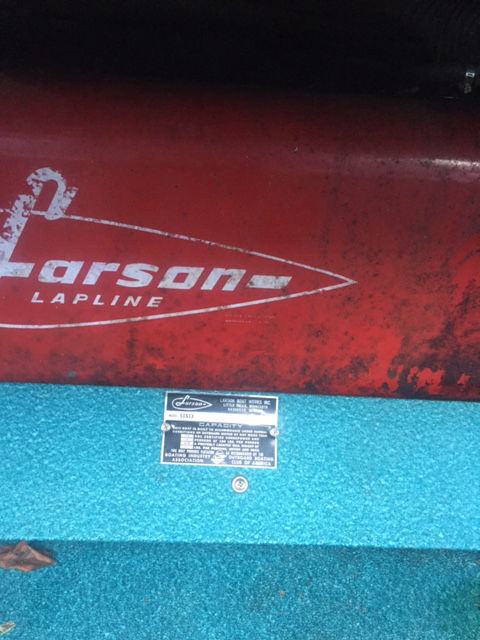

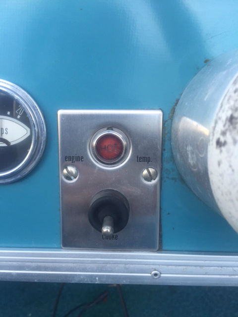

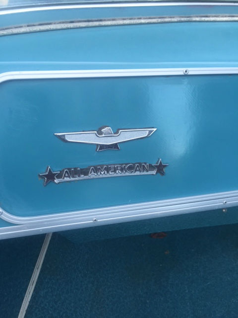

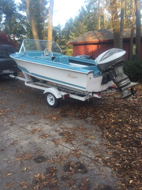

Picked this up today after a couple of weeks of trying to decide about a motor for my daughter's Steury restoration. I was able to hear it run, and overall it is in pretty decent shape. It is all original, even down to the Larson Lapline gas tank. The original plan was to take the motor off of the Larson for Alaina's Steury, but her boat is rated for 65hp (the Starflite is 75). Then the plan changed, and the purpose of the Larson was to be a "starter" boat for Alaina to learn to pilot, dock, trailer, etc without worrying about damaging her restored beauty. But now that it's home, I really like it! I think it has a lot more vintage style than the Steury does, and I certainly like the dash better. I don't think I can scrap this thing out! But, I can't redo BOTH boats. There just isn't enough time.
Alaina and I spent quite a bit of time talking and looking at both boats tonight, and she's thinking things over. We haven't invested any $$ into the Steury yet. It is well into the teardown, but not so much time that we couldn't jump ship ;)
We are supposed to have near 70 degree days this week here in WI, and I will drop it in the lake to see how it goes. We never had a chance to do that with the Steury.
Oh, and I got it for $300.
Any opinions?

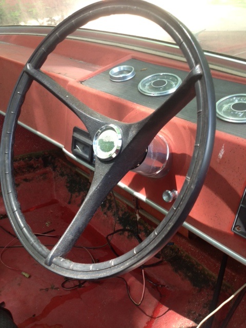

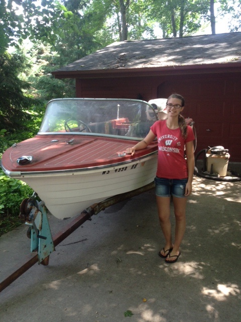

Some pictures of the Steury for comparison...

That Larson looks really nice. Great color combo!
Re:Larson Lapside All American 11 years 3 weeks ago #116759
IMHO do the Larson. Certainly looks like a clean and polish restoration from here. As long as the motor performs you've got a boat. Just goes to show that you don't have to spend big bucks to get into the wonderful world of boating. Not sure why folks find it necessary to buy a $100,000 Ski Nautique just to spend some time with family and friends on the water.

Hi Dave,
The Larson looks good and complete, sweet deal for 300.
If it runs as good as she looks (wishing you luck) I'd be teaching your daughter in this boat.

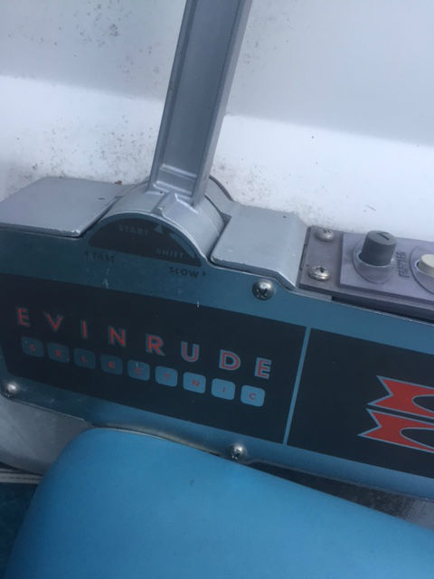

Nice looking Larson there,Drb. I think the Evinrude is a 1965 as I had the same engine on a Crestliner I had. I believe I'd go with the Larson over the Steury also.

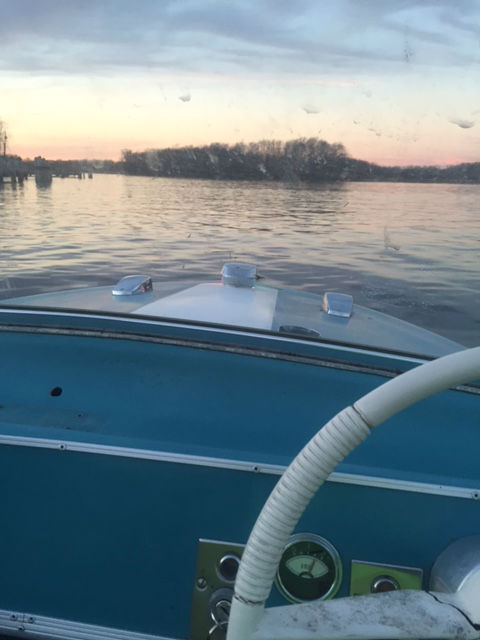

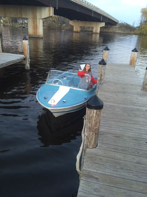

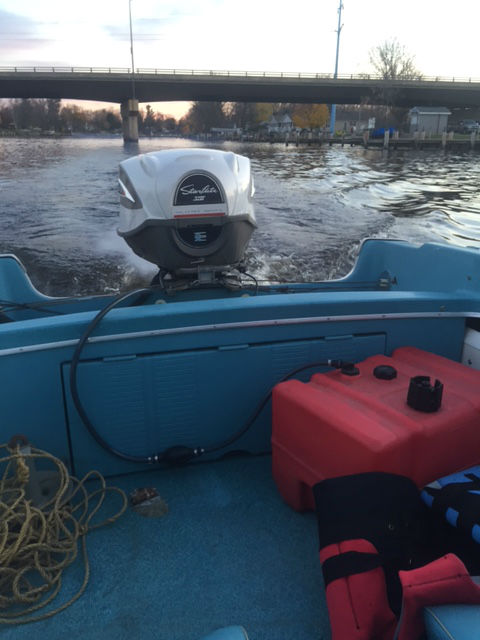

Well, we dropped it in the lake tonight...a bit of a rush due to Day Light Savings. I did notice before we left that the keel is pretty torn up from the trailer. After taking it off and putting it back on tonight I understand why!! The lake we went to is only 4 feet deep so I wasn't too worried if we sank:)
But, it floated just fin, sits nicely in the water, and I tell you what, that Evinrude started right up and purred like a new motor! The electric shift works perfectly, though it certainly takes some getting used to. I kept wanting to go in reverse but just kept going forward slower...I go the hang of it.
We got it up on plane without any issues, but since it was getting dark and it was the first time out, we headed back. Total of about 15 minutes on the water. I am so happy with the motor, and will patch the keel in early spring, then rework the trailer.

The smile says it all !!!!!

Beautiful find. Good choice. Ditch the steel fuel tank though, it will rust through and plug up your lines. IMHO. Congrats again.

If the tank is clean inside and the outside is also clean, why would it need replacing ? Just asking.

I used the plastic gas tank when we went out because I had fresh gas in it. The original tank stinks of bad gas, though I don't see any leaks. The metal tank I took out of the Streury was rusting along the seams on the outside, so I imaging some on the inside too. While I don't see any such issues with the Larson tank, I will take it out and drain it, then inspect it. There are ways to restore these tanks, and I may consider doing so over the winter, as it is cool that is is original with the logo and all. But in the end it isn't worth getting stranded for cosmetics. So, stay tuned...it may live again:)
Re:Larson Lapline All American 11 years 3 weeks ago #116889
The reason I would advise to not use the steel tank is because when they rust they are compromised. They lose their integrity, are weak in the rusted areas. I have posted two threads on this site. One was how to clean the inside of a steel tank using electrolysis. Took several days, inside looked like a silver whistle but when it was reinstalled rust still plugged up fuel filters and I needed a tow off the water. The second post was just about two weeks ago again with pictures showing what looked like minor rust along the seams, fuel ooozed out into the bilge and luckily I caught it by accident. The "fix" is coating the inside with chemical soup but IMHO being on the water with a "fixed" fuel tank is a recipe for disaster and possible fire. The fix might be good for cars, motorcycles etc. where you can walk away. On the water you don't have that option. Just because it looks cool and is original won't get you home. If you like the looks and originality you can have a new one made to the old specs and graphics are available.
Sorry for the rant but I caution you to err on the side of safety.

I like both. But it's really great that the Larson was good to go. She looks like a happy boater in that photo!

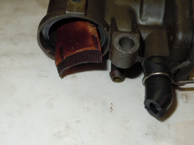

Forgive my ignorant question, but is there a true fuel filter on these outboards, or is the float bowl all that "protects" the carbs from sediment?

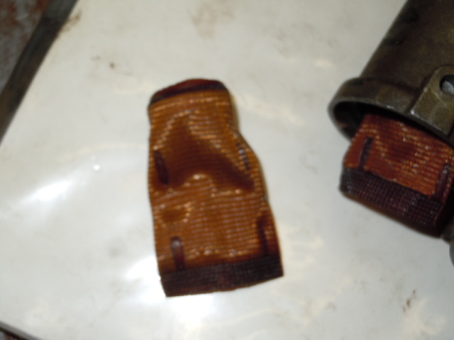

Actually, the fuel filter is inside the fuel bowl on the fuel pump. It's a little "sak" that pushes up inside the bowl mount.
Re:Larson Lapline All American 11 years 3 weeks ago #116944
Not an ignorant question at all...

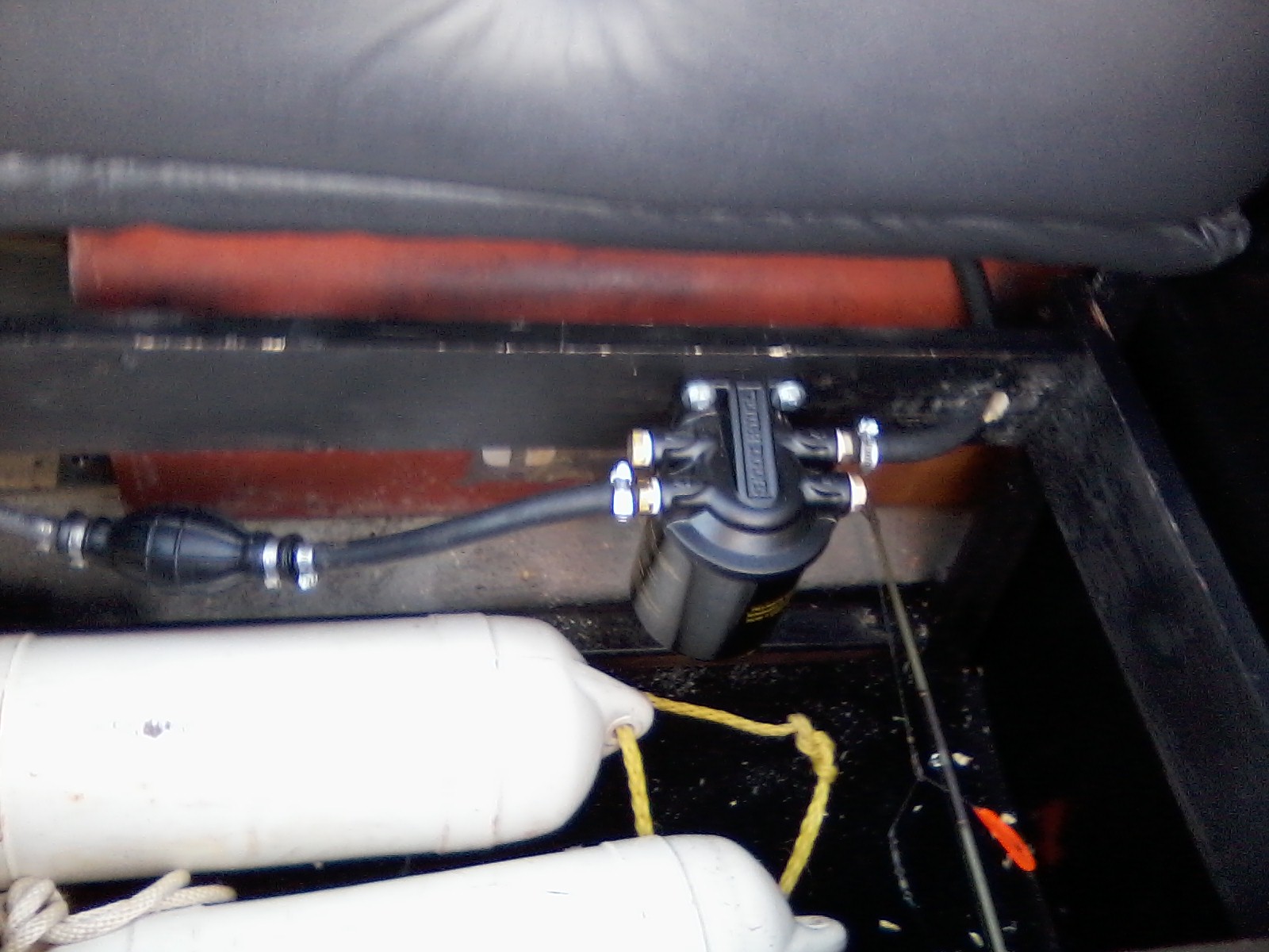

There is no "filter" per se. I forget which fuel pump you have but if it has a glass bowl hanging down on it there should be a plastic screen/bag that sorta cleans the fuel. If you have a flat fuel pump with a large black disk looking thing on it (large silver screw) there is a fine steel screen in there that can be cleaned. I always add an external fuel filter if I can just for good measure Here's a picture of mine. A fuel/water separator. This pic was taken long ago when I tried saving a steel tank...see background.

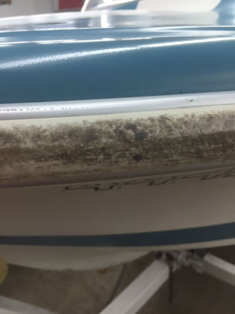

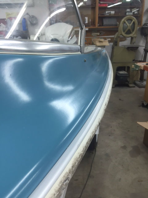

Some follow up...Larson Co. emailed me back the next day to confirm this is a 1966 All American. I spent some time (minimal) buffing the deck for some therapy. Nice shine for an old boat! I could probably do more if I had the desire, but this suits me fine for now...it's headed down to the barn for the winter anyway.
Does anyone have any tricks to whiten the rub rail?
I'm tempted to paint it...
Re:Larson Lapline All American 11 years 2 weeks ago #117096
Rub rail, I've had some luck with Mr. Clean magic eraser pads, soft scrub, sometimes just bleach. Is it weather checked or just dirty?

Just really dirty. Otherwise it's in good shape. I tried Magic Eraser....didn't do much. I'll try acetone...
Re:Larson Lapline All American 11 years 2 weeks ago #117137
Yeah acetone should work.
Re:Larson Lapline All American 11 years 1 week ago #117314
Lacquer thinner, and fine steel wool, like 0000. Acetone can affect the gel-coat.

Wizards finish-cut, or final-cut, To me it works great.

Try Mold Armor product on the stained rub rail. Removes mold and stains on most surfaces. We used it on the interior of our pontoon that was covered for two years and badly molded. Spray and leave on a few minutes, on the rub rail, wet a strip of towel and let it lay on the rail for 5 min. After removing the stain, treat with the sister product, mold preventor. We get ours at Menards but there are several similar marine proctucts. $6 a bottle, it does contain bleach so cover surfaces that might be affected by bleach.
