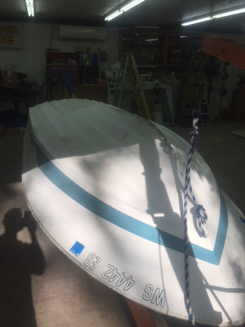

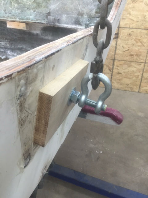

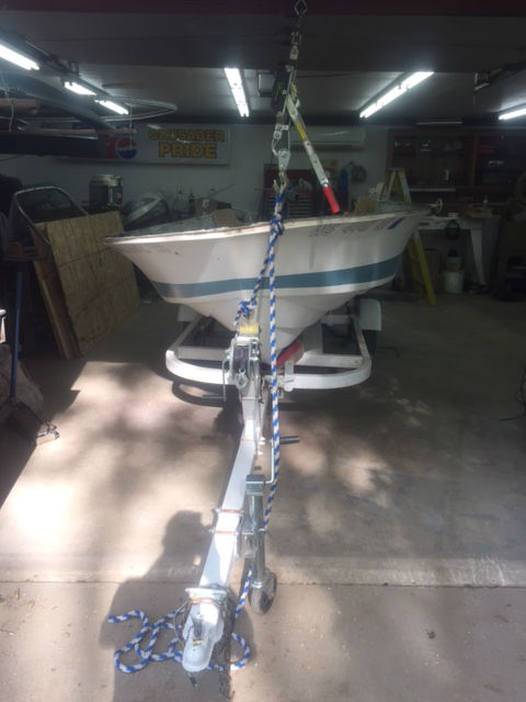

Well, I have to say that went a lot easier than I thought it might. Alaina and I were able to flip the hull on our own with no issues at all. I have a very solid rolling workbench that fits perfectly under the hull and makes it super easy to roll around. It is at the perfect height to work on the hull body work.

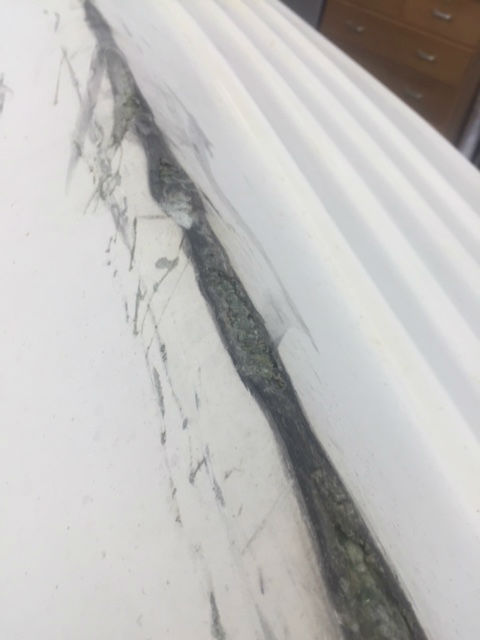

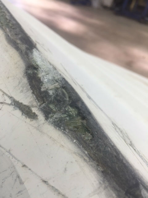

Now that the boat is flipped, we want to dig in and move along right away. I had gotten some advice long ago about fixing the keel while it was on the trailer by applying PB and reshaping. Is that the best way to do this now that it is in better positioning for repair?
I assume we need to grind out the previous repairs and fill them the same way?
I have quite a bit of experience with body work on steel and aluminum, but this is our first attempt at making a fiberglass hull look new again. I assume I can not use the same filler that I use for body work on cars. An favorites that I should look at for that kind of product?
My plan is to epoxy prime the hull once the repairs are done. Then sanding primer a few times until we are happy, and then seal with epoxy again before painting.
​Sound ok?

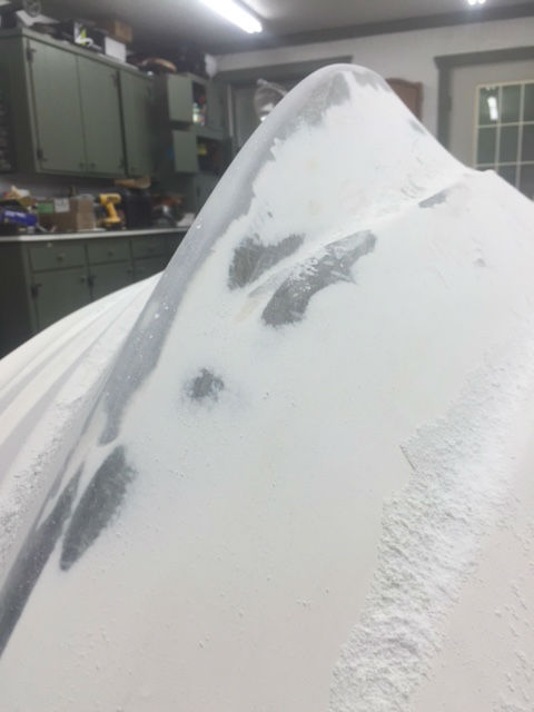

Making progress! We have most of the sanding done, and are going to start fairing this week. The keel repair turned out great. Hoping to prime/sand/paint in a week or two!

I will need to do this sanding to my Keel too and not sure what condition I will find it in. Did you have rotten wood that needed removed? Did you fill what looks like large opening from missing wood with Peanut butter with fiber fillers or ??? Can I assume if a person only has small areas to fill in where rotten wood is removed, it can be ok? At what percent of rotting wood would warrant cutting out the entire keel wood and replacing and re-glassing. Yours looks great. Hope mine does not have rot.

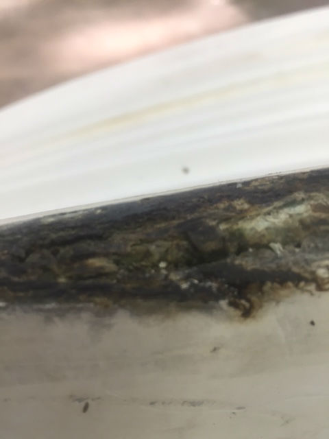

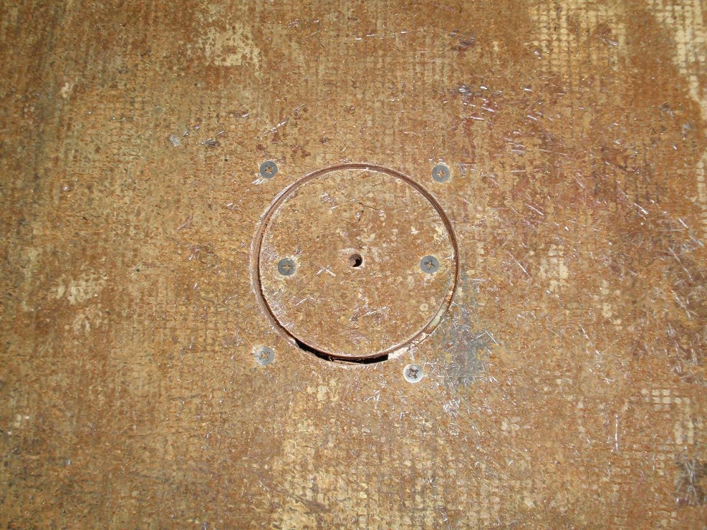

There was no wood on my keel. I know the pictures make it look like rotten wood, but it was really just dirty worn out fiberglass. We ground down the ugly areas (I didn't show those pictures) before we started the repair. I used the West System Epoxy with the 403 filler as it is their highest strength filler. The finished area was not really that deep, and I had spoken with their rep as to what to use, so that's how we did it!
This stuff is amazing, and you can hit it hard with a hammer...it's not going any where.
Once you grind down the keel to fresh clean glass, brush straight epoxy (no filler) on the area, wipe off the excess, and then apply the peaneu butter using the 403. Shape it close, come back the next day, and start sanding. The 403 is certainly hard to sand, but the nice part is it really lets you take your time with shaping. I am very confident in this repair. I can't wait to get some paint on it!

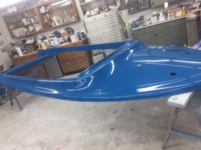

Progress!!!
Still need to do the stripes...
Re:Larson Lapline All American 10 years 1 month ago #128406
Beautiful!!!!!!!!!!!!!!

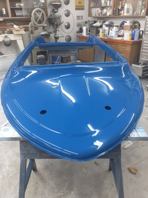

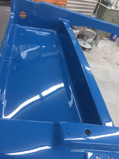

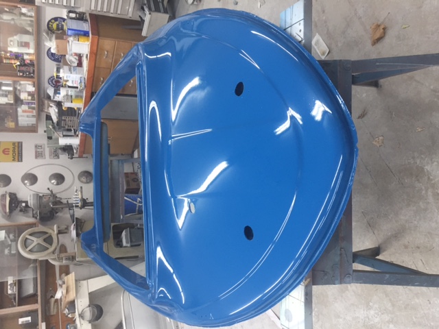

Well, we are done painting, at least the big stuff. I think the only thing left is the steering wheel, but even if that has to wait until spring, we are ok. Got the stripes done today. Bring on the cold.
Re:Larson Lapline All American 10 years 2 weeks ago #128770
Beautiful!

Looks very nice. What primer and paint did you use? How did you mix your paint (thinned? hardener?). Did you roll and tip, or spray? Did you paint while previous coat was tacky or did you let try and sand finer and finer sandpaper grit between coats? Sorry for all of the questions, but your results warrant copying the method.
I likely will have to practice both gelcoat process and paint process to see if I can handle either based on my skill development.
Dr.Go!
Re:Larson Lapline All American 10 years 1 week ago #128838
  • Drb007
  • Senior Boarder
  • Senior Boarder
  • Posts: 196
  • Karma: 4
I used PPG epoxy primer, them high build sanding primer (multiple coats) sanded to 400. Then a thinned coat of the epoxy primer used as my first coat of paint. We did 5 coats of the white on the hull, 4 coats of the blue on the deck. We used Nason paint with hardener. I'd have to look at the brand of the thinner, but it was very expensive. No sanding between coats. Wait for them to tack and then spray again. Not one run. This is some good paint.
We will wet sand and polish and it will look even better!
And everything was sprayed in the driveway on tarps inside a canvas "tent" to contain overspray.
Spraying is really not hard to do. Get a decent gun, and buy good paint!

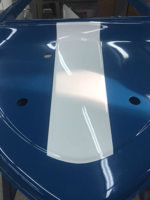

Spent quite a bit of time wet sanding tonight. Not a fun job, but really necessary to get a nice final finish. Plenty more to go.
For the seats, the upholstery plans keep falling through. We decided to go with a white seat since it is almost impossible to match the blue paint, and will use red piping. I found a guy on CL who wanted to trade my SeeRay project to redo the seats, but I think he is changing his mind. I went to a guy I've used in the past and he wanted over $2200 to do the 4 seats. Way over budget.
So, we are going to try using the SEM products. Look forward to those pictures when we get that done...
For now, check these out.

I still have some more sanding to do on a Shell Lake but I'm always afraid of rubbing through to primer

Yup, we have a variety of foam blocks that we choose from for the flat surfaces, but I've always preferred flat paper under fingers for inside and outside corners. I've never sanded through to primer using that method. The blocks are great for the flat areas, and we do use them there. And we've got spray bottles too...though we have been found to get distracted with water fights:)
It's tiring and you have to stay vigilant as you sand so you know where you are on depth. I sand until there are just a few shiny (low) spots left and then go to the buffer. That method has worked well for me to avoid burning through.
