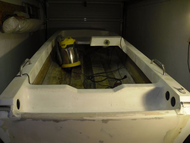

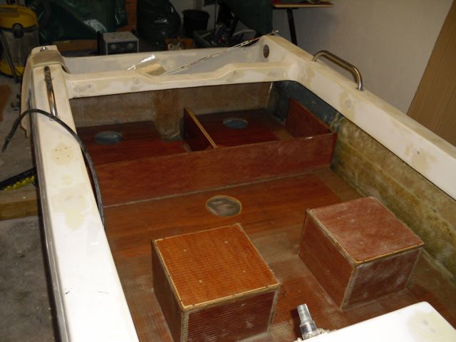

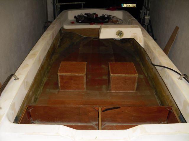

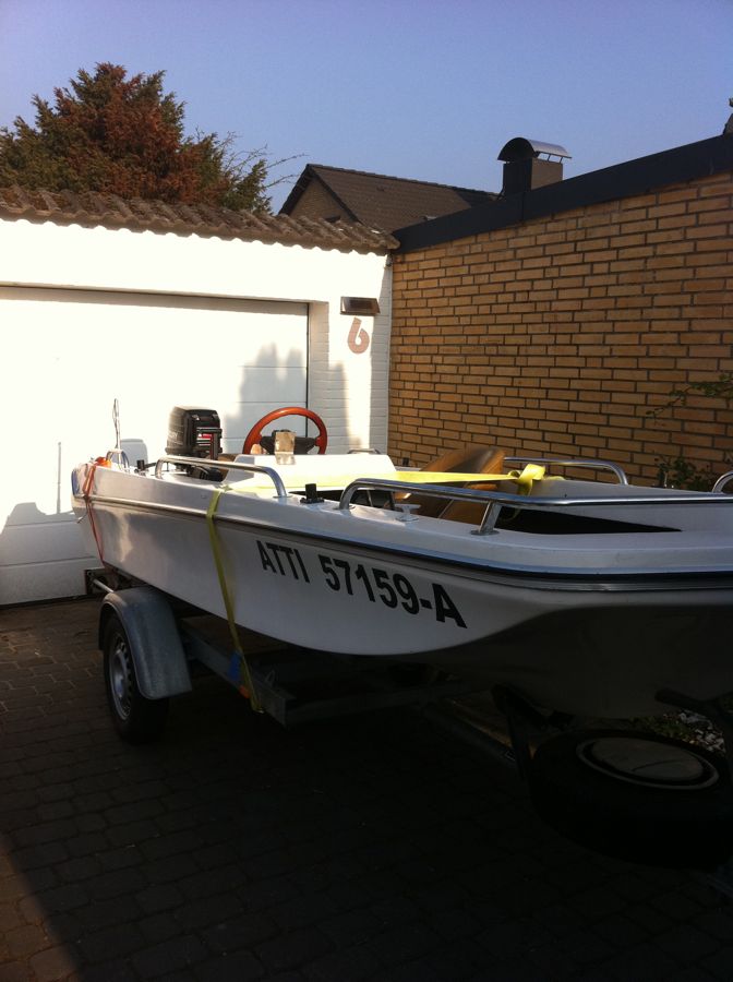

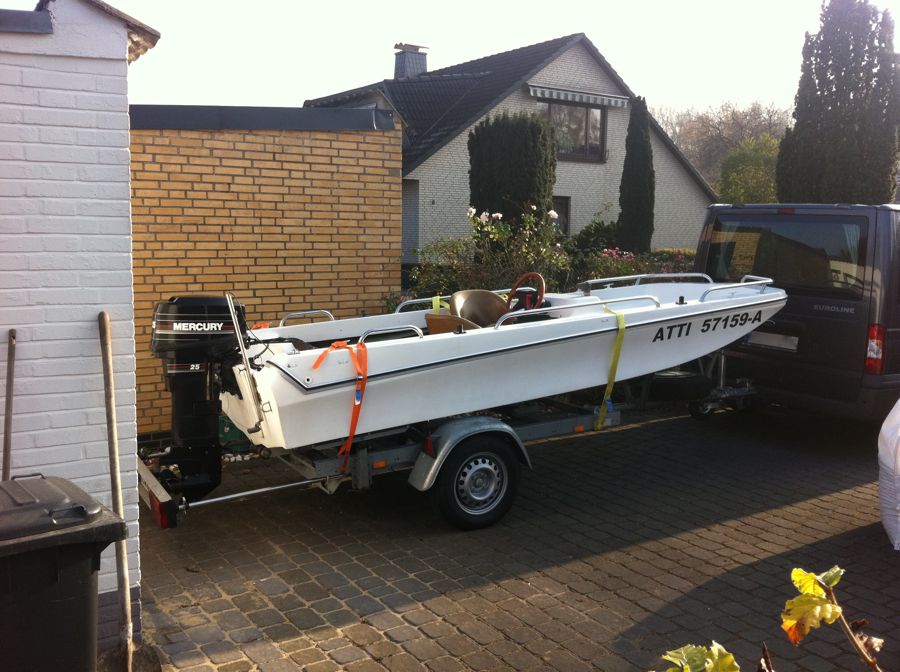

Hello everybody,
I just found this forum because it was suggested to me by Mr Rhude (user thompsonboat). Many thanks for that!
The reason why I'm here is, that I really try to identify my "new" boat. But let me say some words about me first. My name is Sebastian, I am 34 years old and come from the north of Germany (so please do not be too critical about my English). Some weeks ago I bought a nice motorboat but I don't know who was the manufacturer, I even can't find anything about it in the documents (there it says: manufacturer unknown).
But I just don't want to write about the boat, I will also show it to you. Some of the pictures were taken before I started to restore it this weekend and some while I was taking everything out that was rotten. You won't believe it but one of the former owners filled the hollow spaces of the bottom with installation / construction foam and then put a wooden floor over it. Everything got wet and became turf... They also seemed to have stiffen the transom with a cutting board. When filling the hollow spaces they also blocked the drain valve and the wooden panel inside the transom turned into turf as well. So I had to open the transom and will have to rebuild it.
I also took a look in the fiberclassic library as well and found the "Winner Tiki", this boat looks like the "big sister" to my one. It is a little bit too long, my boat is only around 13 ft. long.
I really would appreciate your help, best regards, Sebastian

You will find more pictures in my profil, I was not able to put more than one picture in my posting :unsure:
Have a nice day! Sebastian

thank you for your assistance with the pictures! I have change it and now everyone can see the pictures in my posting.
Of course I will post my restoration progress here in the forum! I did a lot of sanding last week B)

Thank you all for the warm welcome :)

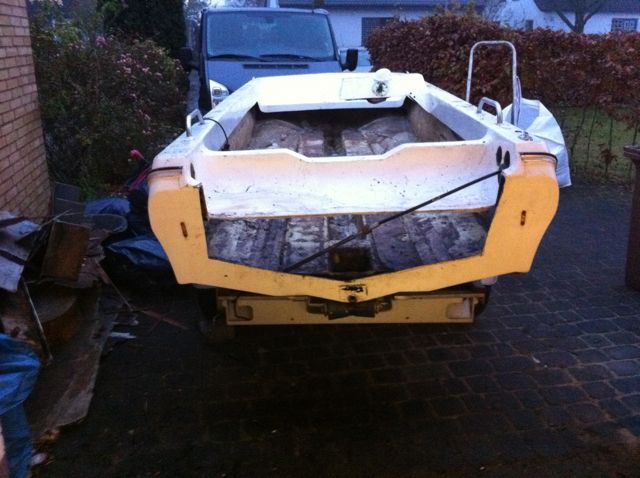

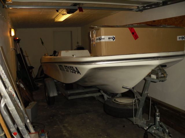

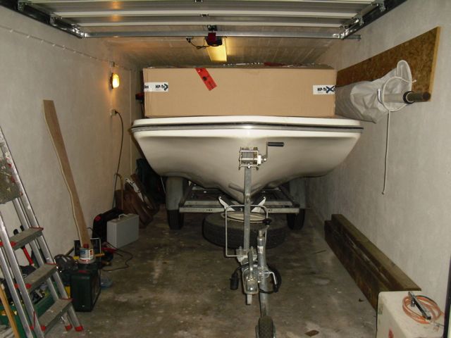

I tried to take some pictures from the bow of my boat. It is a little difficult, because it's dark outside when I go to work in the morning and dark again when I come back home. :(
But I think the pictures might help to identify my boat.
So if you have any idea, please don't hesitate to tell me :laugh:
Have a nice day, Sebastian

It sure looks like a Winner. Here is link from the iboats forum, perhaps you've seen this Tiki already:
forums.iboats.com/showthread.php?t=164481
Dean

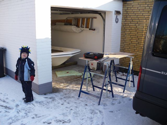

Yes, there is a lot of work to do on this boat. But I like it, it's a nice project for wintertime.
And I'm very happy to have my garage for that renovation.
I wonder, if I will ever have my car in there. ;)
For the last five years, when we did the renovation of our house, the garage was used as storage room for all our construction material and tools. In the autumn this year, I cleared up the garage to have my car in there in wintertime, but than this boat appeared :P
So there will be another winter of ice-scraping on the front window of my car. I'm glad, that my wife is so patient with me :laugh:

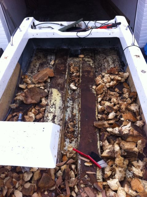

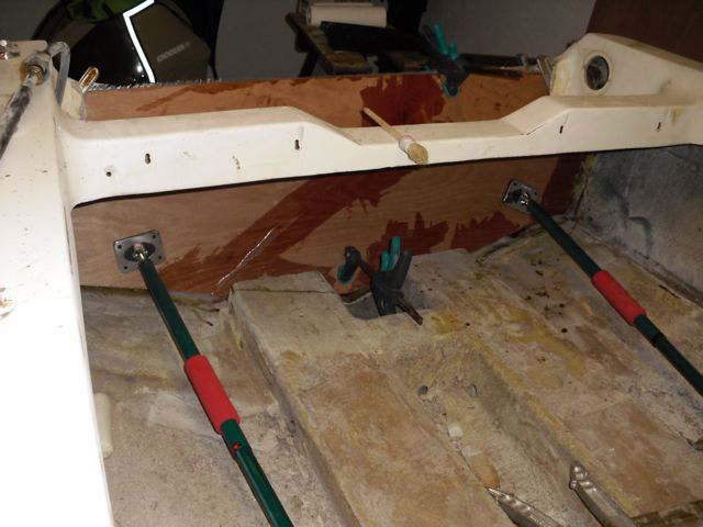

Just curious why you decided to cut the outer skin of the boat? This will be bit of a structural engineering situation when it's time to rebuild the transom. Typically you would remove the top cap of the boat or cut the gunwales in front of the splashwell to get to the transom and leave the outer skin intact. Not saying it can't and hasn't been done this way before, just makes it harder to ensure the structural integrity of the boat has not been compromised. The hull is now not a one piece molded constructed piece. Layering and blending the glass on the outside will take some effort.

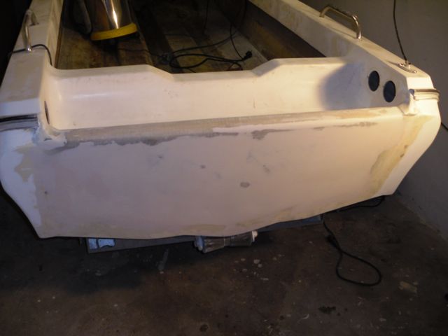

The only number on the boat is stamped into the gelcoat on the port side of the transom:
"PA / 35".
I have no idea what this could mean :unsure:
Sebastian

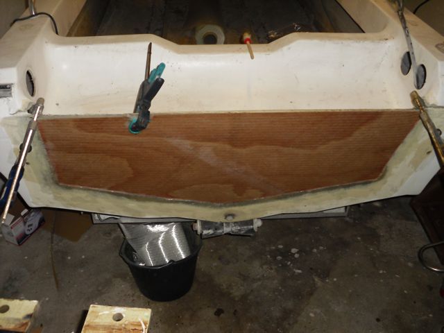

I know, that it is not the perfect way to rebuilt the transom, but the transom was repaired by somebody before, who did a really bad job :ohmy:
So this was the only way and I will have to rebuild the transom completely.
Wish me luck :laugh:
Sebastian

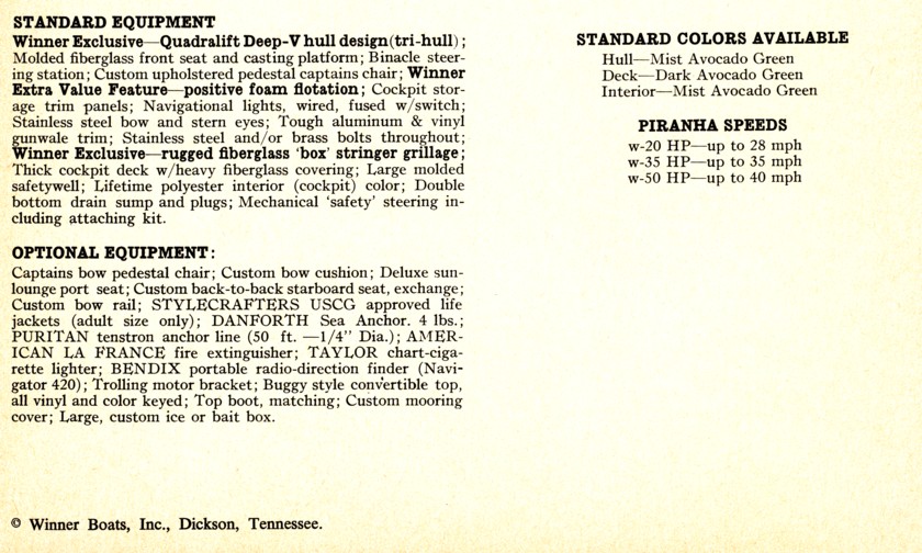

Hi Sebastian,
Here is some catalog information on your boat. The first is from the 1969 catalog. Notice that the length is gunwale length. The centerline length is 13'9". The next two scans are from the 1970 and 1971 catalogs. I hope that this information will help.

This is all I can say! I'm really happy! Now my boat has a history and a name! There is a "Winner Piranha 2" in my garage!
Now it is not an "unknown" boat anymore! Thanks to all of you again!

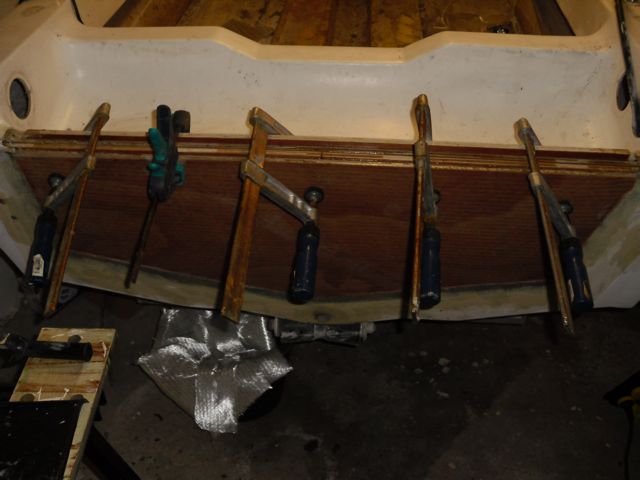

Re:Is this a "Winner"? 14 years 9 months ago #52127
  • ton_sohn
  • ton_sohn's Avatar Topic Author
  • Posts: 38
  • Karma: 3

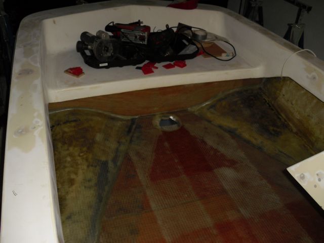

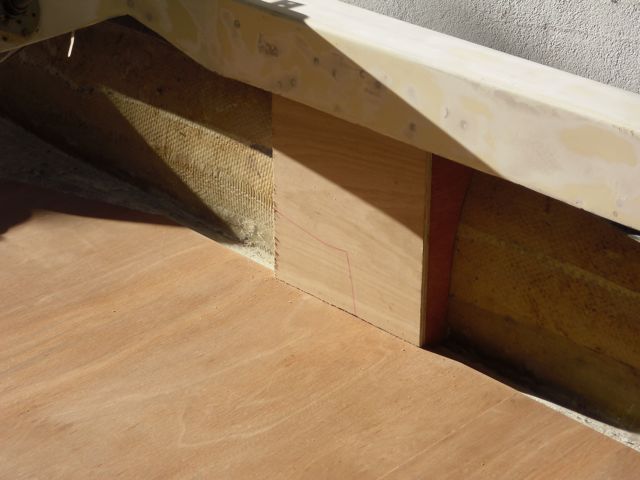

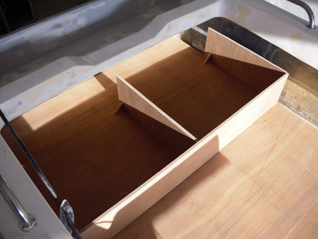

The first layer of wood and fiberglass are placed. The new transom is "growing" :laugh:
Tomorrow I will built in the next layer. Finally there will be four layers of wood and fiberglass.
I worked with fiberglass and epoxy for the first time and I must say, I'm very pleased with my work! ;)
Have a nice day!
Sebastian

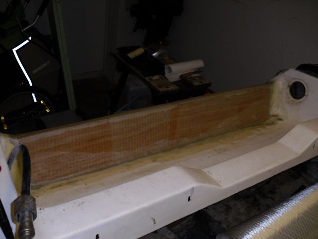

Re:Is this a "Winner"? 14 years 9 months ago #52465
  • ton_sohn
  • Posts: 38
  • Karma: 3

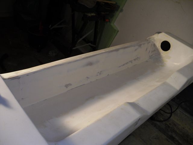

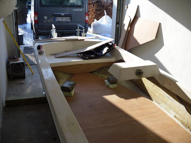

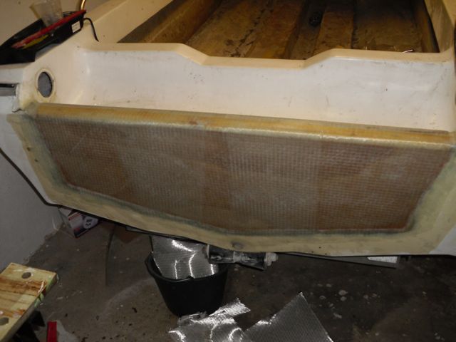

The basic construction of the transom is finished, four layers of wood and fiberglass are now in the boat. There will be a wooden strip on top of the transom to have a perfect edge....
Help, my english is not good enough to explain want I want to say, I'll better show you pictures... :silly:
Tomorrow I will finish the last layers of fiberglass on the inside and outside of the transom.
I'll will keep you informed B) Have a nice day!
Sebastian
Re:Is this a "Winner"? 14 years 9 months ago #52471
No worries Sebastian, we're following your English just fine! I believe you are referring to a "cap" on the transom? Looking great buddy, keep the pics and progress reports coming please. ;)

The evening is gone and it was quite successful!
The transom is covered with three more layers of fiberglass, I think there have to be two layers more, to have a plane transom again.
But I will not conceal that I have totally miscalculated with my amount of resin.
3 pounds resin are gone and I must buy more resin tomorrow :dry:

Now here are two new pictures :)
At the moment I have to wait for new resin. I hope it will arrive before Christmas, so I can continue my restoration after the Christmas holidays.
By the way, it's always good to have an educated wife... :laugh:
She told me, that kilogram and pound are not the same :angry:
I wrote, that I used 3 pounds resin, but it was 3 kilogram, so nearly 6.6 pounds!

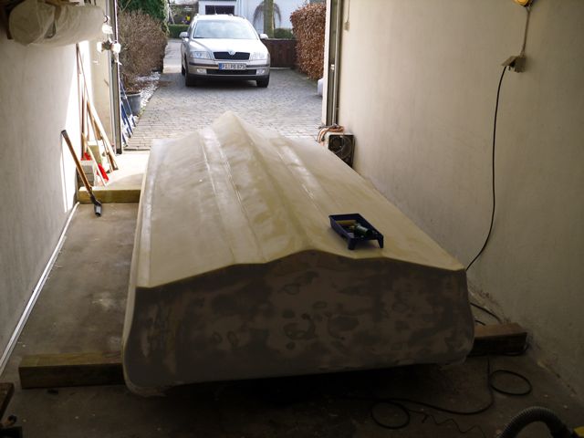

Re:Is this a "Winner"? 14 years 8 months ago #54831
  • ton_sohn
  • Posts: 38
  • Karma: 3
Happy new year everybody!!!
I'm back again :laugh:
And I was not lazy during the last month...
The transom is now ready, soft and clean like the skin of a new born baby :)
It was a lot of work, and right now I really don't want to use my sander anymore.
How here are some brand new pictures!
Have a nice day!
Sebastian

Re:Is this a "Winner"? 14 years 8 months ago #55395
  • ton_sohn
  • Posts: 38
  • Karma: 3

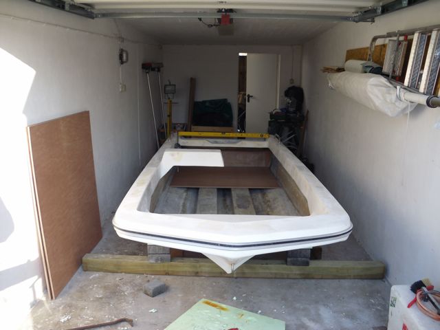

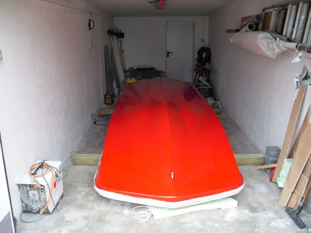

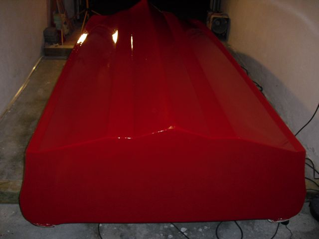

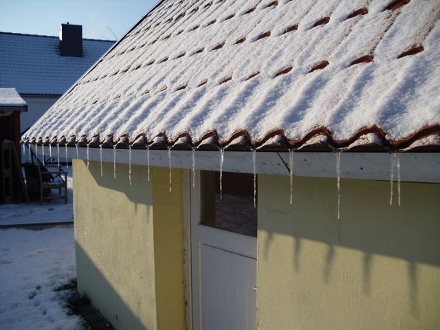

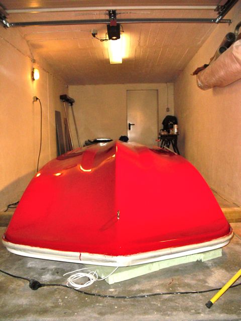

The last week we had temperatures around 11ºF!!! And the forecast for the next two weeks is the same :ohmy:
So working on the boat is nearly impossible :(
But I do my very best! I took the boat from the trailer and flipped it. Right now the complete hull is sanded and tomorrow I will flip it again and start preparing the new floor.
I will post some new pictures this weekend.
I hope the temperatures will rise soon, so I can start laminating the floor.
Of course I could heat my garage, but at the moment the temperatures are far to low, the heating will be too expensive to reach a proper temperature for laminating.
So I have to wait...

Baby it's cold outside :P
But it was a beautiful winter-day with my son! We prepared most of the plywood for the floor and some other parts, e.g. a little box for the switch panel.
And our seats arrived. I found them in the netherlands and I like the colors very much.
Oh, I forgot to tell you, that the boat will be "firefighter-red", so my little son won his battle ;)
Now here are todays pictures!

Now another weekend is over and I think, I did quite well!
Saturday night was my night :lol:
My wife was tired and went to bed very early and I decided to be a good husband and not going to disturb her by snoring next to her... ;)
So I went into my garage! It was a long and successful night, now my winner has a new floor and all the lamination work is done.
The bilge was painted twice before I laminated the new floor over it. The new floor has four water-save hatches, so if there will be water or moisture in the bilge, it will be no problem to remove it.
Next step is sanding the laminated floor, before painting it with anti-slip-deckspaint.
I'll keep you informed :)

Sorry boys for being so slow :(
But there are a lot of other things to do at the moment, so the progress on the boat is not as fast as it could be.
Status quo:
The complete inside of the boat is laminated and painted twice with gray bilge-paint.
No pictures from this part, because I was too fast flipping the boat, I forgot to take pictures from the inside, sorry!
Then the hull was finally filled and sanded.
At the moment the hull is painted the first time with a 2 component paint (Polyurethan).
Today I will apply the second layer.
To be continued...
Sebastian

Hi Dean,
I use a roller (I don't know, if this is the correct word, but I'm sure, you know what I mean ;) ) to apply the paint and a brush to make a perfect finish without bubbles. It works very well.
Your right, the color looks a little bit orange on the picture, but like my four-year-old son would say, it is "firefighter-car-red" :laugh:
Today I applied the last layer paint on the hull, I will take some pictures later.
Have a nice day!
Sebastian

Hi Mark,
I see, it's called "roll and tip method" in english :)
With my paint this method works perfectly! I did the painting alone. As you guessed, I rolled a section and then tipped it softly with the brush.
But I think, very important for a good result is the temperature. At the moment we have temperatures here in Germany that are on the lower edge of the working-temperature of my paint. That means, that the reaction of the two components is quite slow and I have enough time for both working-steps (rolling and tipping).
I guess in the summertime with high temperatures, you need help by a another person, tipping right beside you.
Phew, I hope you understood everything. But this forum is always a good english-lesson for me ;)
Sebastian

Yeah, this color rocks :lol:
I really like it!!! Thanks to my little son, who really forced me to paint the boat in "firefighter-red-color".
Here are some brand-new pictures.
