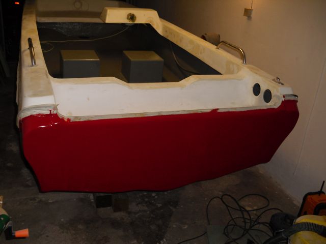

Re:Is this a "Winner"? 14 years 6 months ago #58021
Thats some fantastic work!! Congrats!
For those of us who are from a car resto back ground, can you explain what "Roll and Tip" is? Or did I miss it in this thread?
Re:Is this a "Winner"? 14 years 6 months ago #58022
  • ton_sohn
  • ton_sohn's Avatar Topic Author
  • Posts: 38
  • Karma: 3
Ok, I'll try to explain it...
Be patient with me and my english ;)
When you apply 2-component-Polyurethan paint with a roller, it will not "flow" to a perfect shining layer by itself. After rolling there are remaining bubbles which have to be "eliminated", otherwise the surface will look like the skin of an orange.
So you take a soft brush and just gently tip or wipe over the rolled paint.
Because of the fast reaction of the paint-components you have to do this either in sections or with a second person tipping right after your rolling. If you are too slow, the brush will stick to the paint.
Now I will leave my sofa and go over to my garage and practice my "roll and tip" skills :laugh:
Sebastian

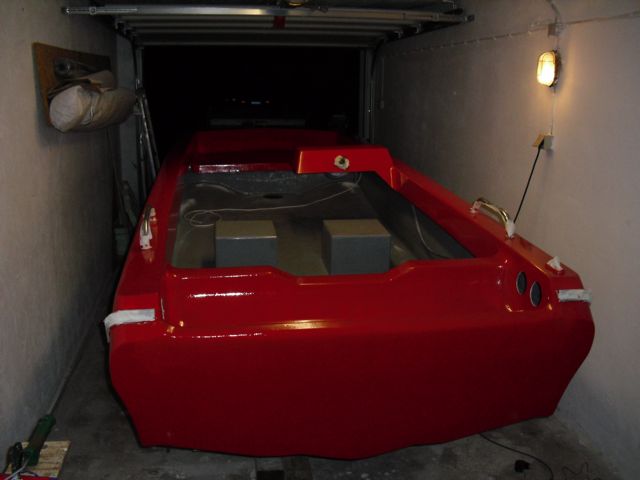

Re:Is this a "Winner"? 14 years 6 months ago #58065
  • ton_sohn
  • Posts: 38
  • Karma: 3

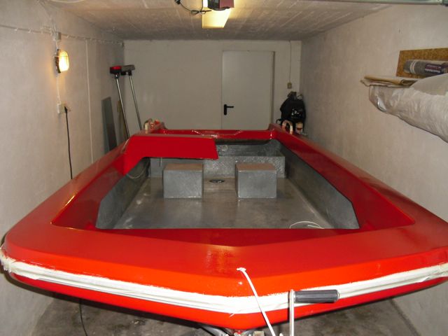

Lady in red... :laugh:
Last night was a successful night! Here are the pictures, I will go to bed now, I'm tired and happy!
Have a nice day! Sebastian

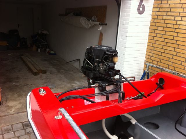

The end is near ;)
Next weekend I will be on the water with my boat. That's the plan...
To be honest, I'm not sure, if I will manage it to finish all the little things that are left and have to be done. Wish me luck!!!

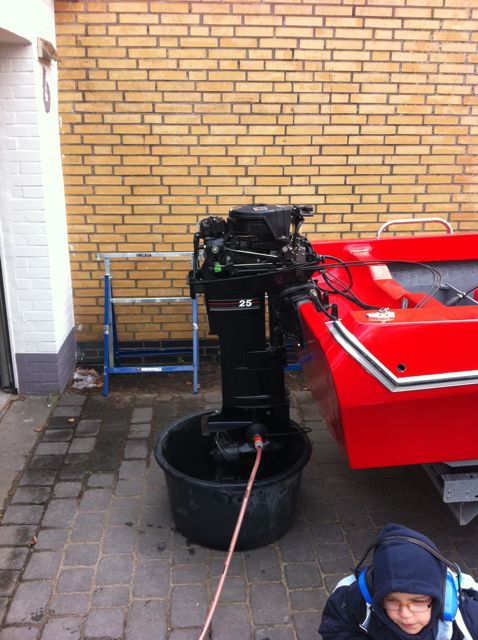

The Mercury is back on the boat (and running!), the Teleflex and the shifting-box as well.
I still have to finish the electrical instalation (light / fishfinder / GPS / bilge-pump) and finally rhe seats.
Maybe I can show you some "water pictures" next weekend. I'm a little nervous... ;)

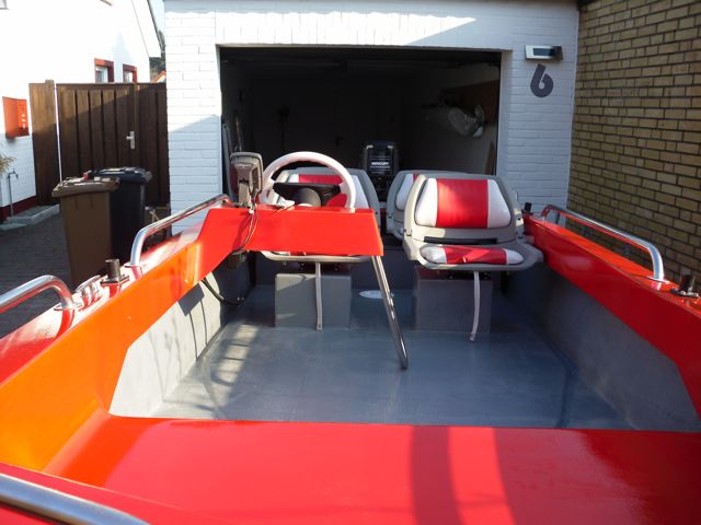

Re:Is this a "Winner"? 14 years 5 months ago #58950
  • ton_sohn
  • Posts: 38
  • Karma: 3
Ok, you want some more? No problem!
You want more?
Something like this
:laugh:

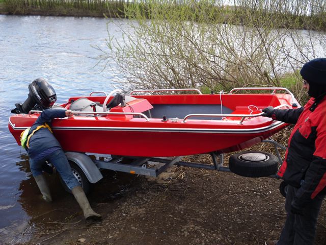

YES! The Winner Piranha 2 is back in the water and it runs perfectly. I love this boat!
With the 25 hp Mercury it runs over 40 kilometers per hour (so nearly 25 mph).
And it runs perfectly soft through rough water.
Have a nice day and happy Easter!
Sebastian

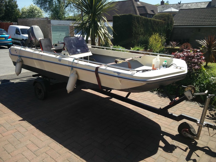

Is this a "Winner"? 7 years 4 months ago #139765
Hi Sebastian. Are you still using your Winner?
I have just bought one myself, a Google search led me to this site and your boat!
