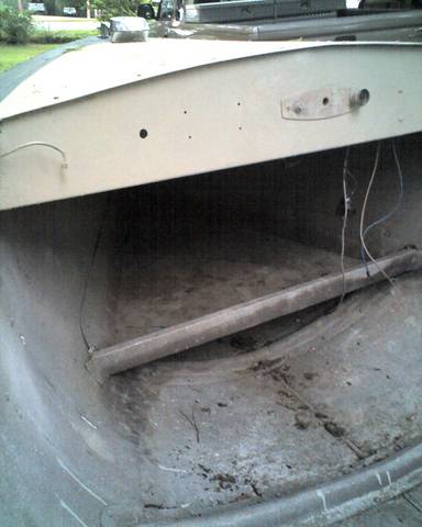

52 Duracraft Sportsman restoration. 14 years 5 months ago #60570

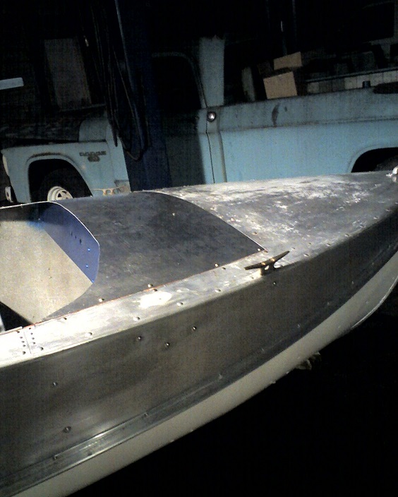

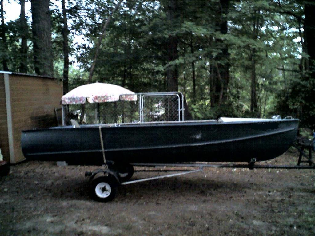

What I have discovered from looking this boat over, is that the bow enclosure has been cut and the dash moved forward, it had a curved windshield at one time and a steering wheel. There are also brackets for a seat back up front and loops riveted to the vertical panels of both bench seats, two front and rear of each seat. Maybe to attach a cushion?

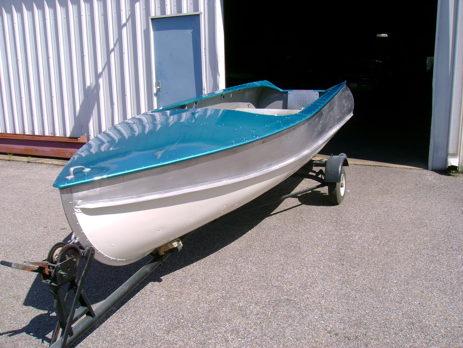

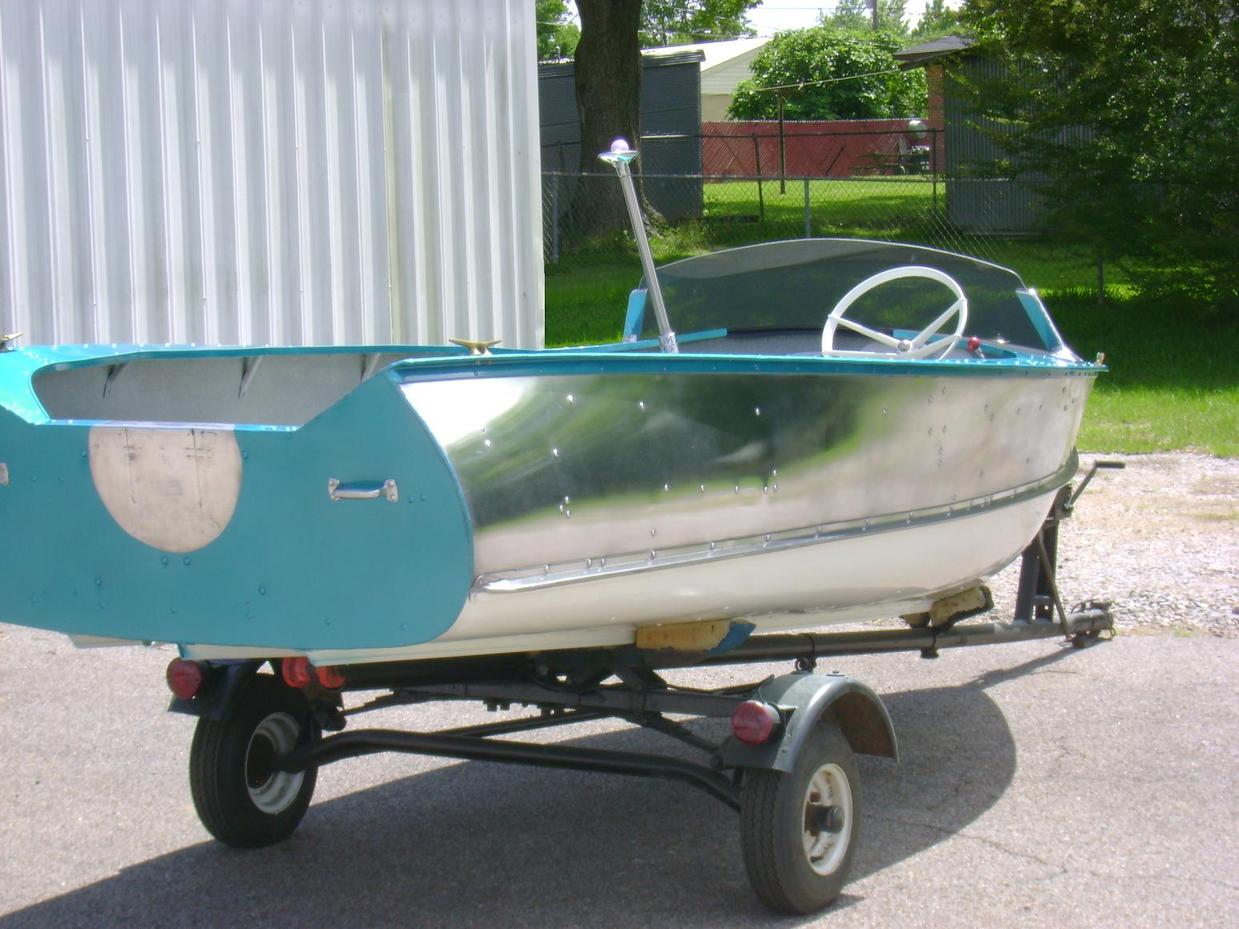

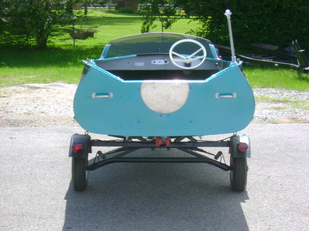

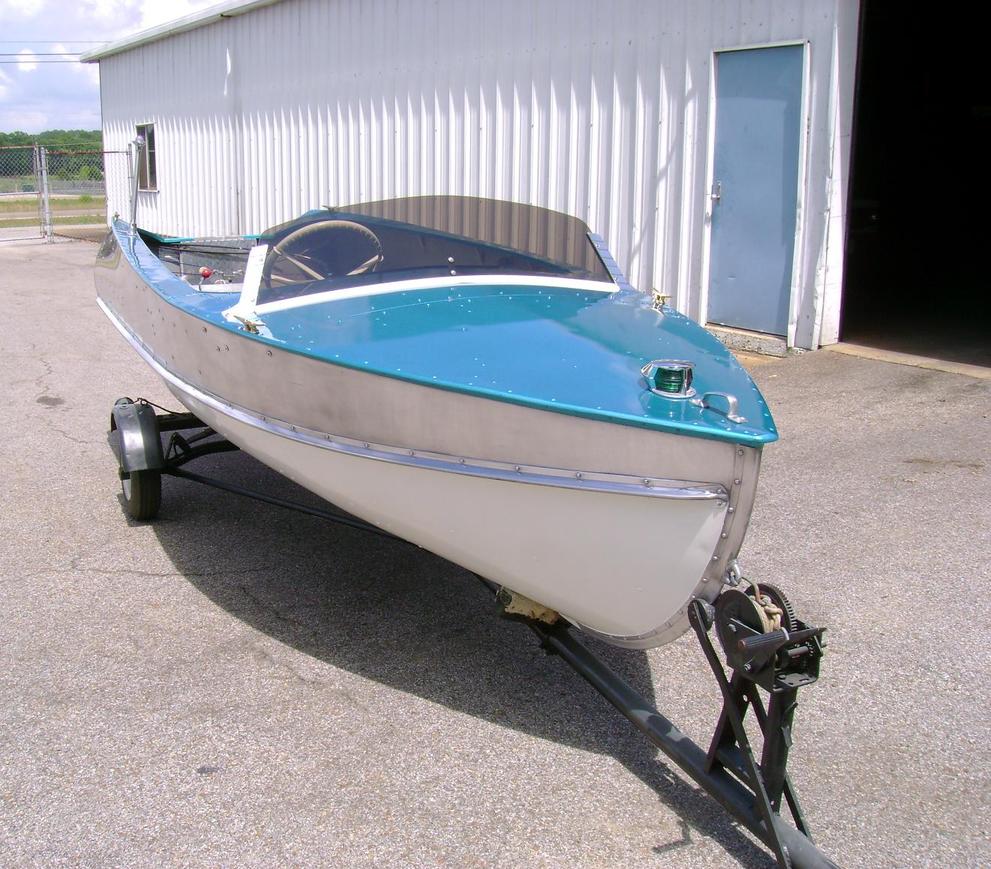

52 Duracraft Sportsman restoration. 13 years 8 months ago #74089

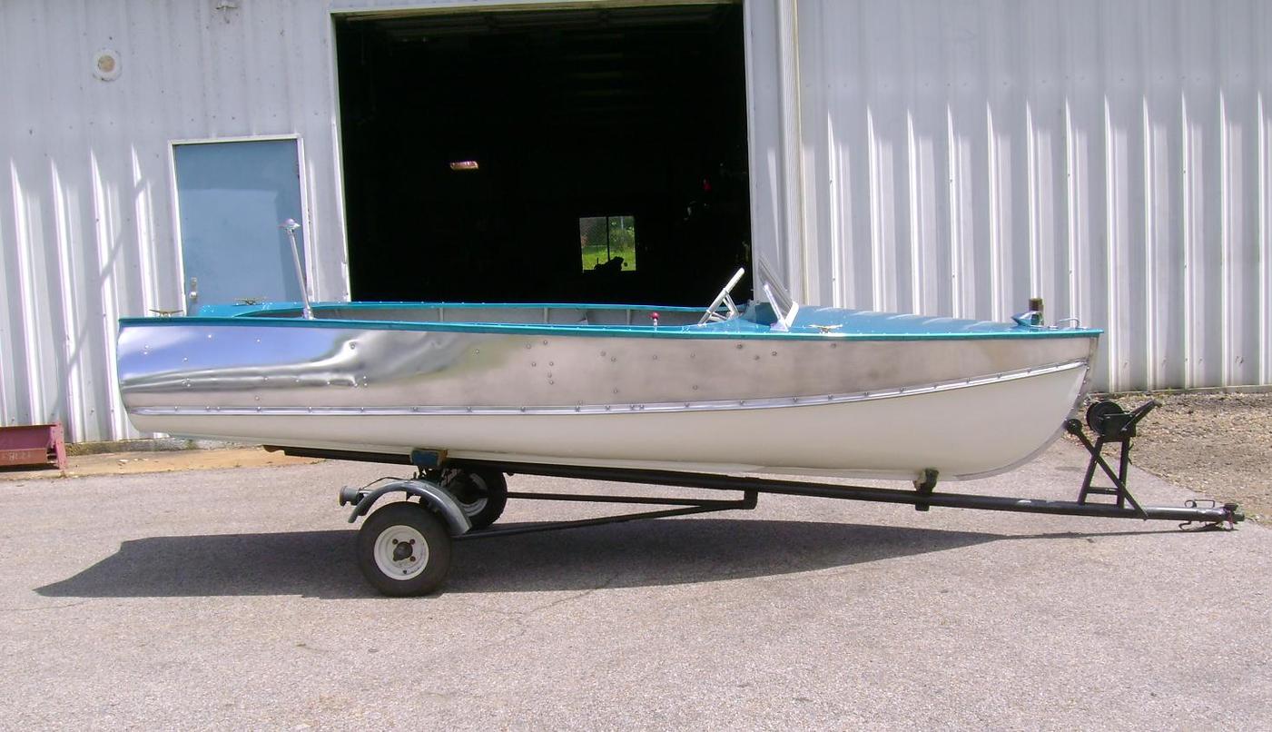

I did finally find out that it is a 52/53 Duracraft Sportsman. Here are a few pictures of how it looks today. It's come a long way, but there is still a ton left to do.

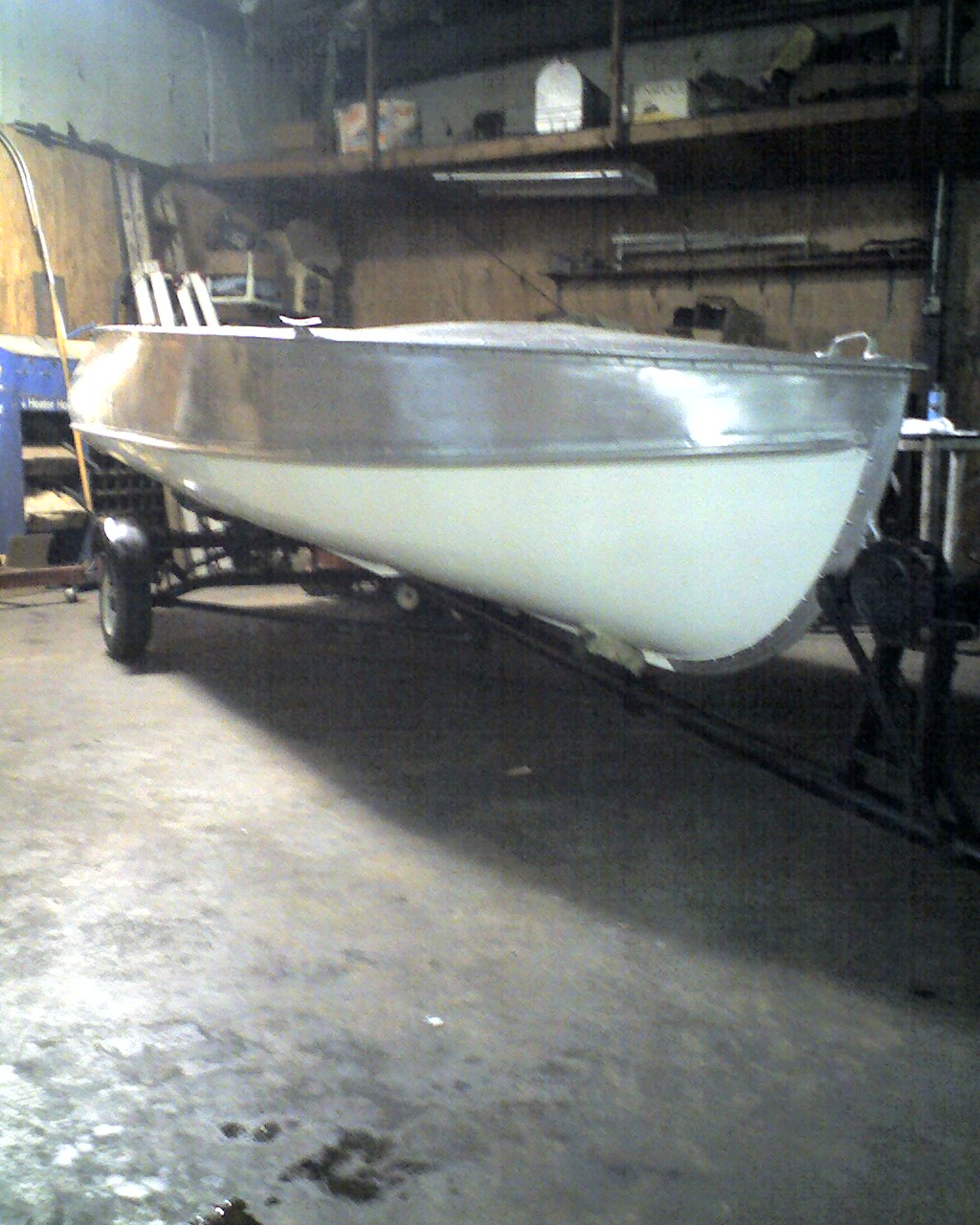

52 Duracraft Sportsman restoration. 13 years 5 months ago #76776

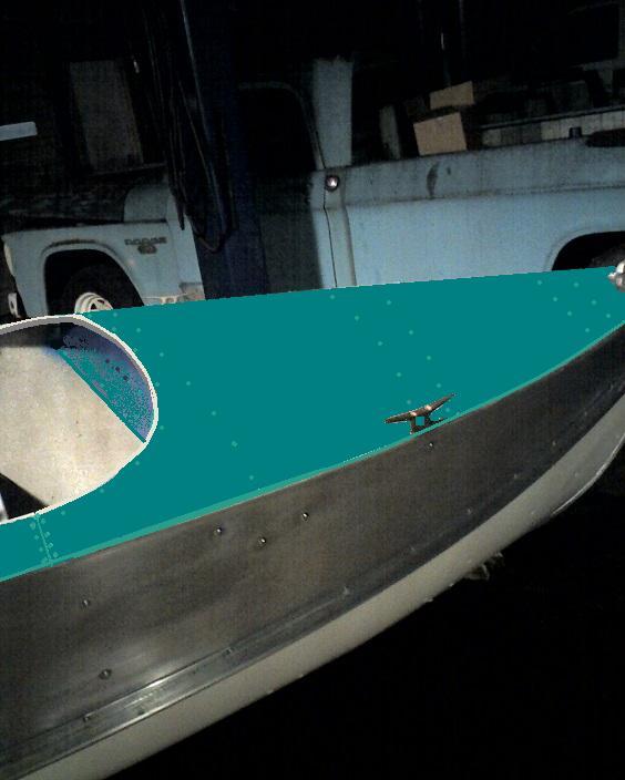

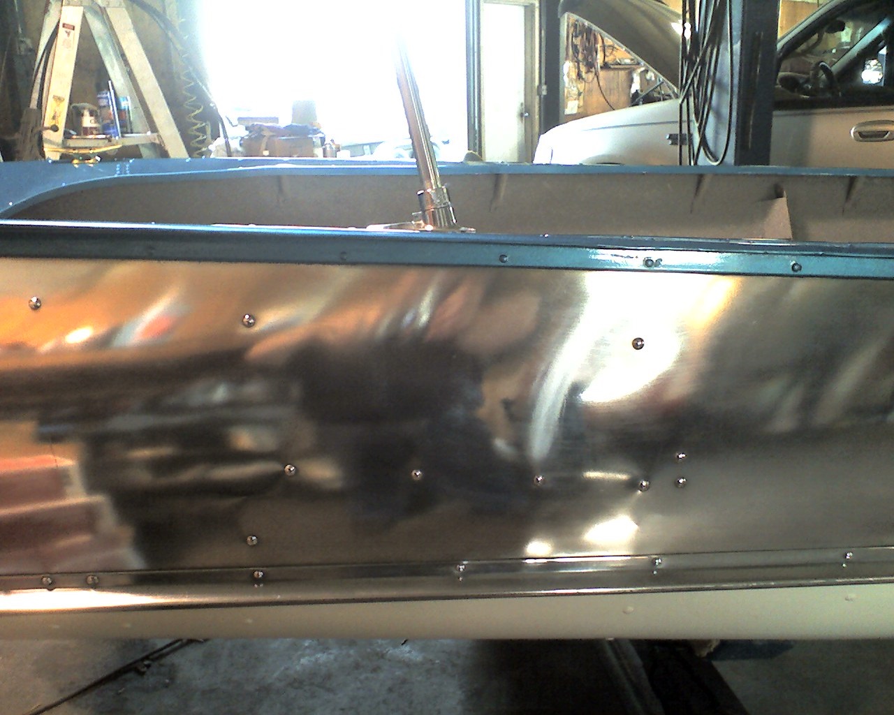

A lot of paint stripper! LOL On the sides that I plan to polish, I went an extra step with more stripper and a scotch brite pad to get all the fine paint film off. It polishes up nice with just mothers aluminum polish. When it is all done I figure on putting on some shark hide to seal and protect the shine.

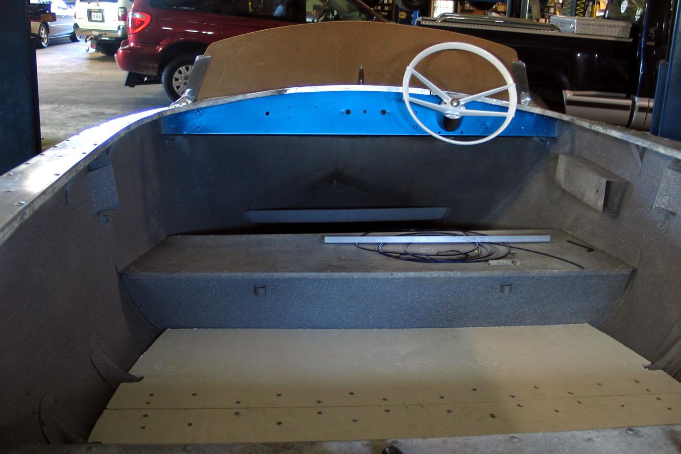

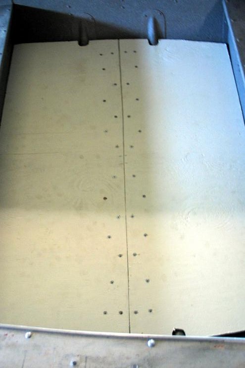

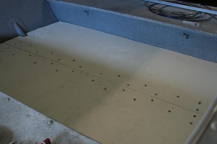

Okay, time for a little update and a few pictures. I stay busy with other projects too, especially this time of year, but I have been working on my little Jewel. I found some windshield brackets on ebay that suited me well and they look like they were meant to be on the boat (at least to me anyway) payed too much for them, but not as much as the guy did for the next set that came up LOL so I guess I really did okay. I've got them mounted and a pattern board cut for the plexiglass windshield.
I've also been working on a floor in the mid section between the two bench seats. I wont be putting one up front because you can't stand there anyway and I like the extra leg room, as for the rear, I'm not sure what I'm going to do back there, but I'm not thinking floor as much as I am brackets to hold the fuel cell and the battery in place. I plan to cover the floor with a tight loop carpet, gray in color to match the inside paint. [img]http://www.fiberglassics.com /media/kunena/attachments/legacy/images/Boat_25_Apr_2013____3.JPG

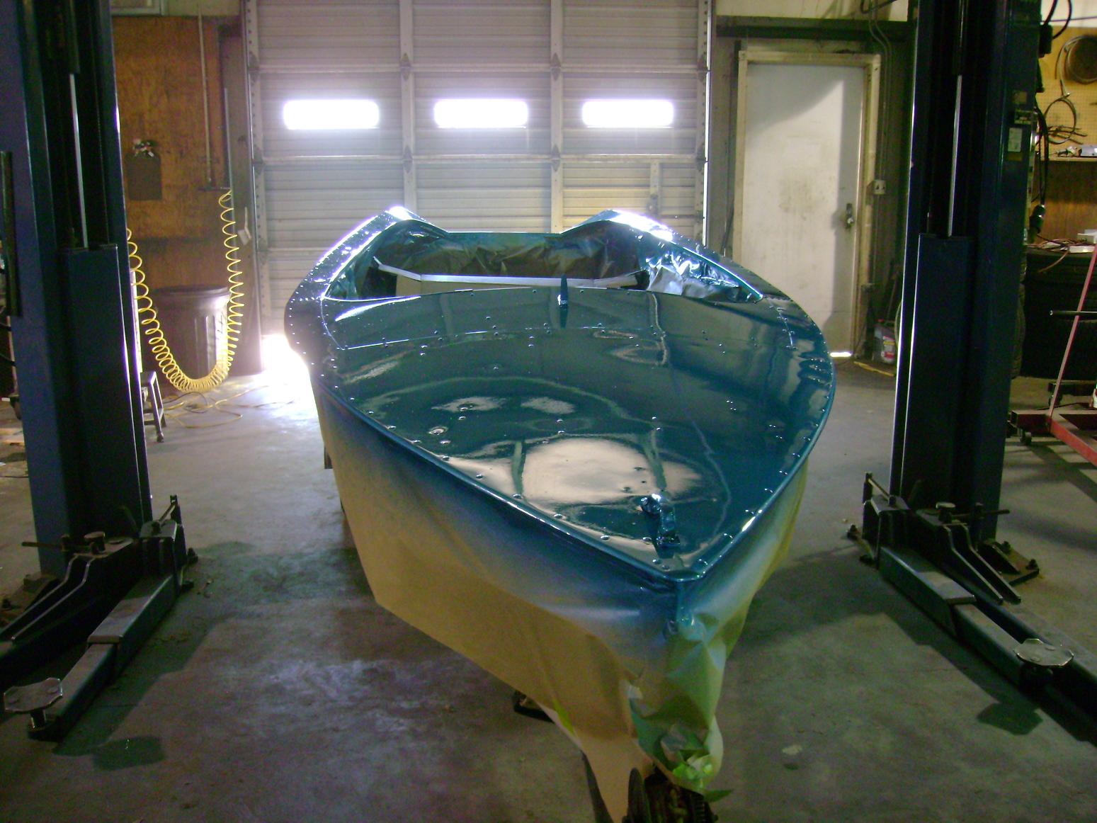

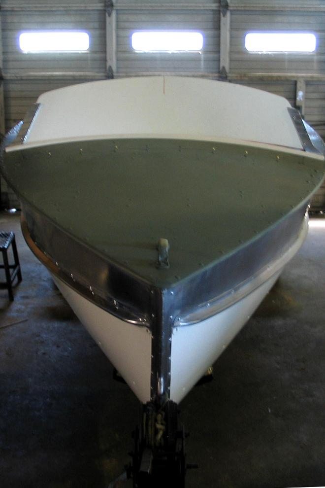

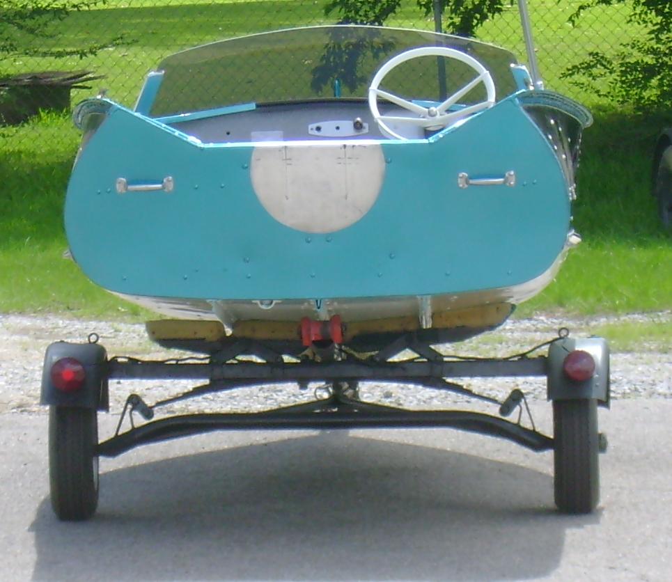

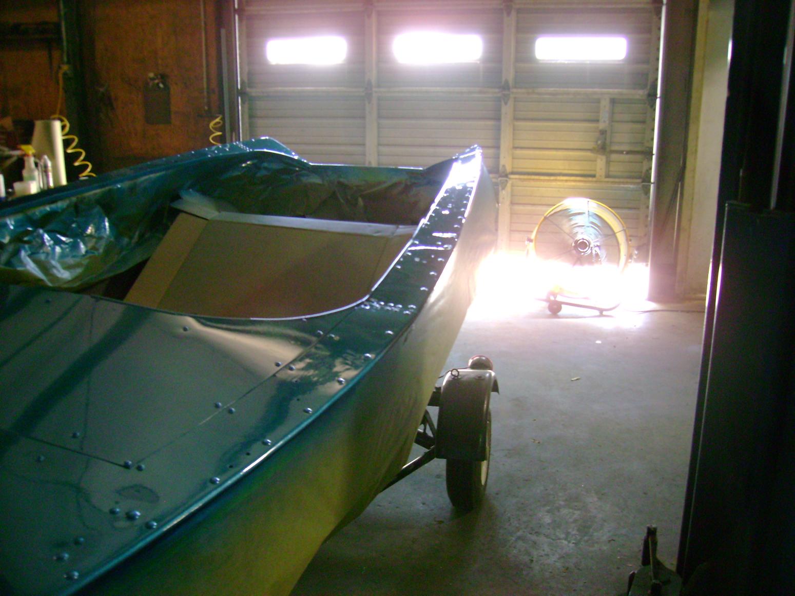

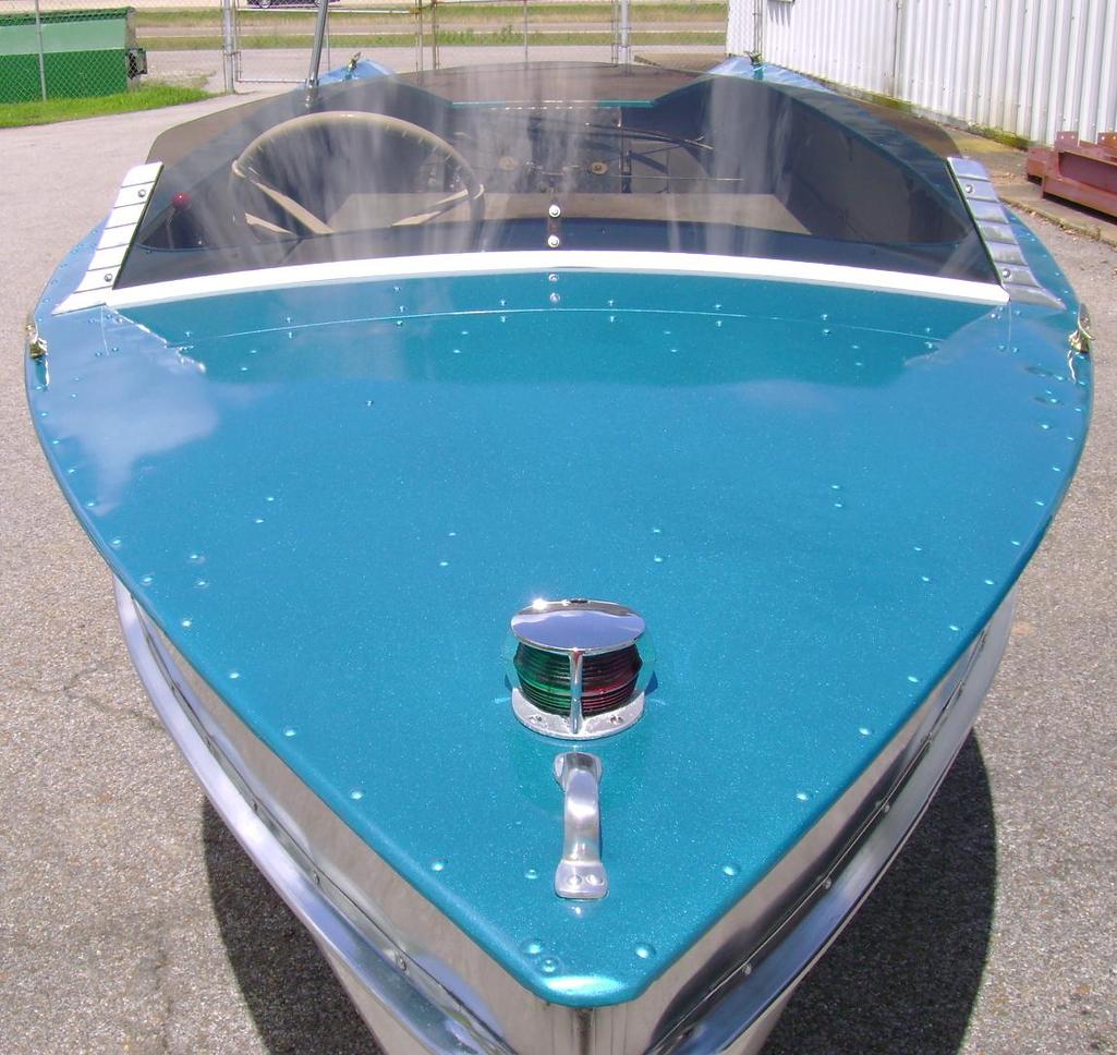

52 Duracraft Sportsman restoration. 13 years 5 months ago #77136

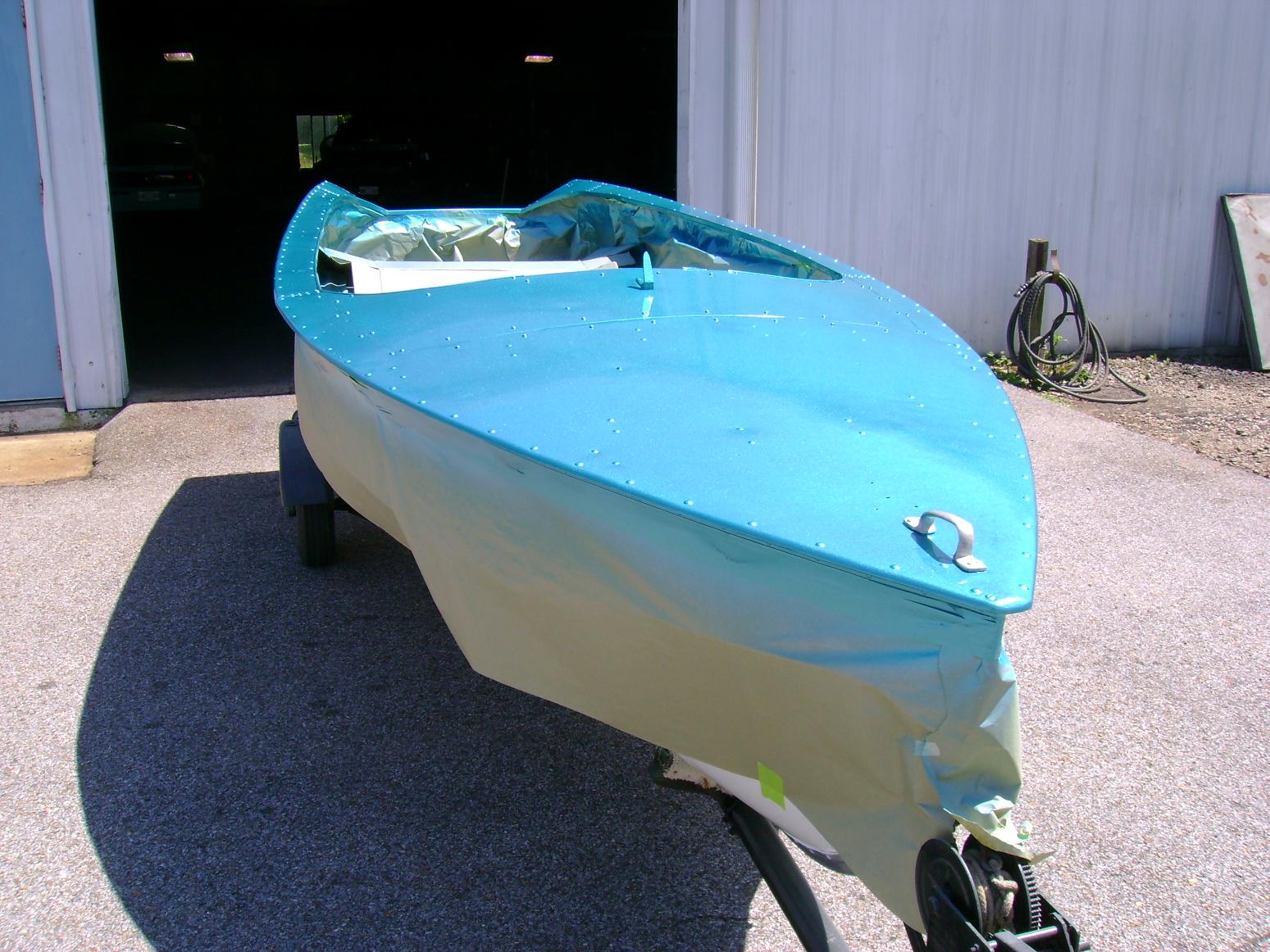

Put on a little paint this weekend!!

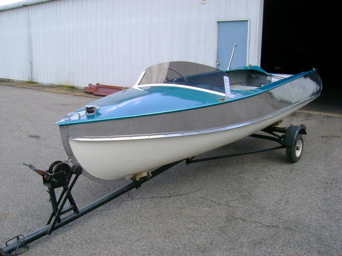

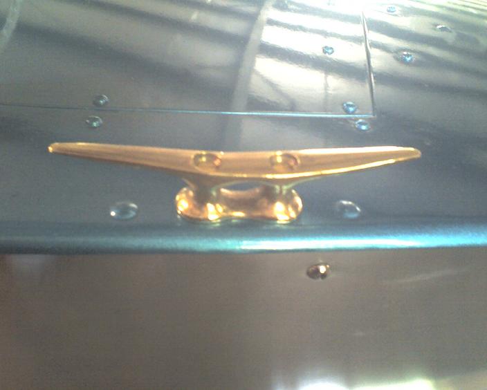

Re:52 Duracraft Sportsman restoration. 13 years 5 months ago #77464

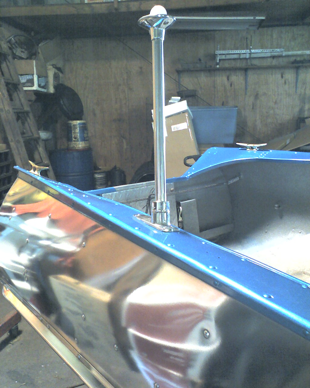

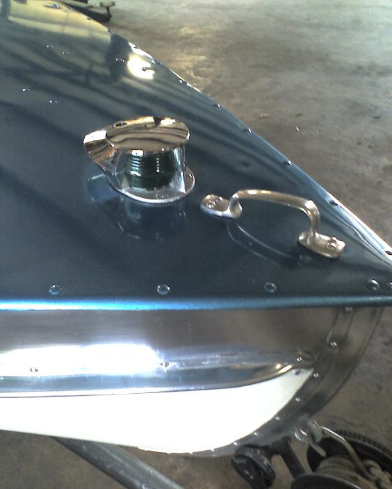

Been doing a little polishing
Installed my "jetson" stern light.

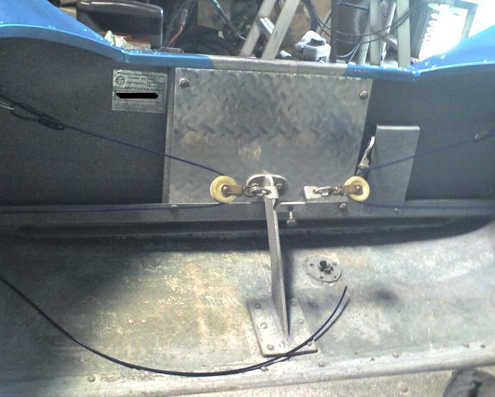

Re:52 Duracraft Sportsman restoration. 13 years 4 months ago #77818
steering installed
Installed some hardware
looking for the wooden flag rod that goes in the hole on the bow light, any of you guys have a lead?

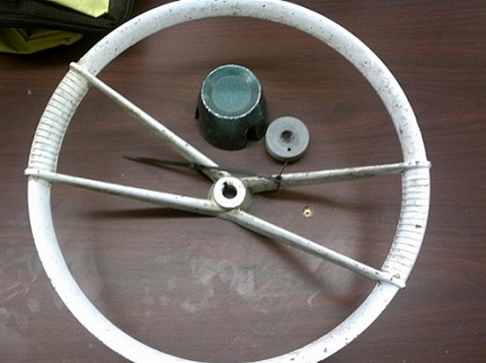

Re:52 Duracraft Sportsman restoration. 13 years 4 months ago #77892

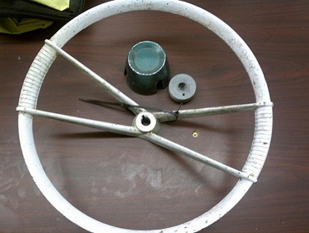

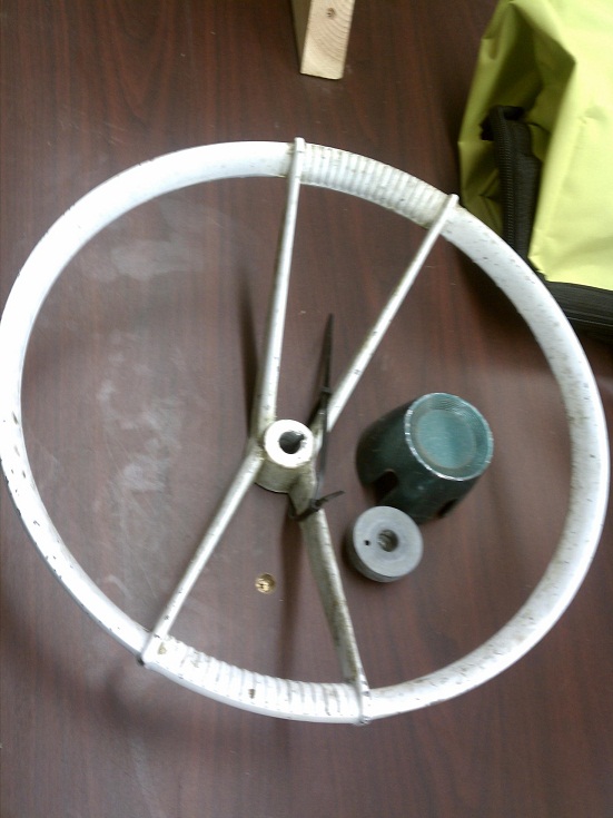

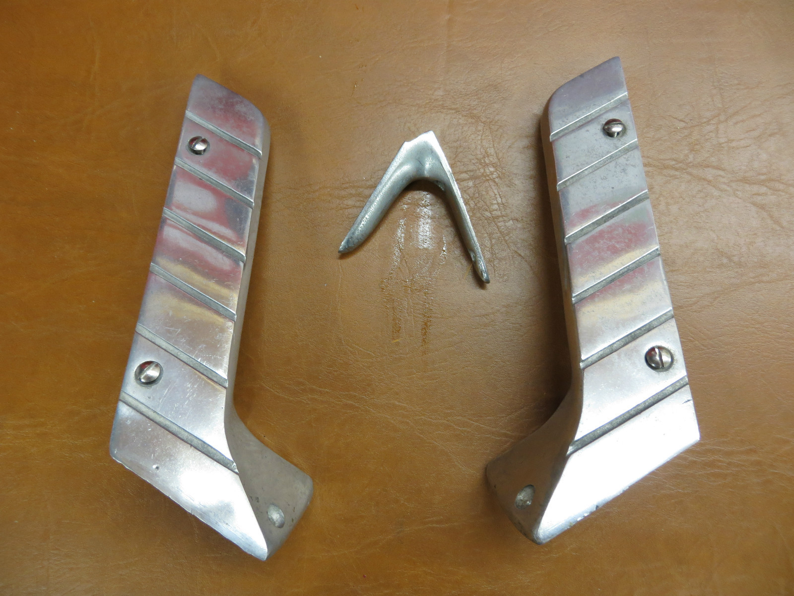

Hey Y'all, I'm looking for the chrome center cap that goes on my steering wheel I've researched and found that it is a Nautalloy Steering Wheel from 1959. I knew it was not original to the boat, although it was part of the purchase deal. I do like it better than the original for a couple of reasons, one, it just plain looks better and two, I'm a big guy and the way it mounts gives me more room under the steering wheel. Anyway, I would love to find an original center cap for it. Here's a couple pictures.
Maybe someone has seen or has one for sale.

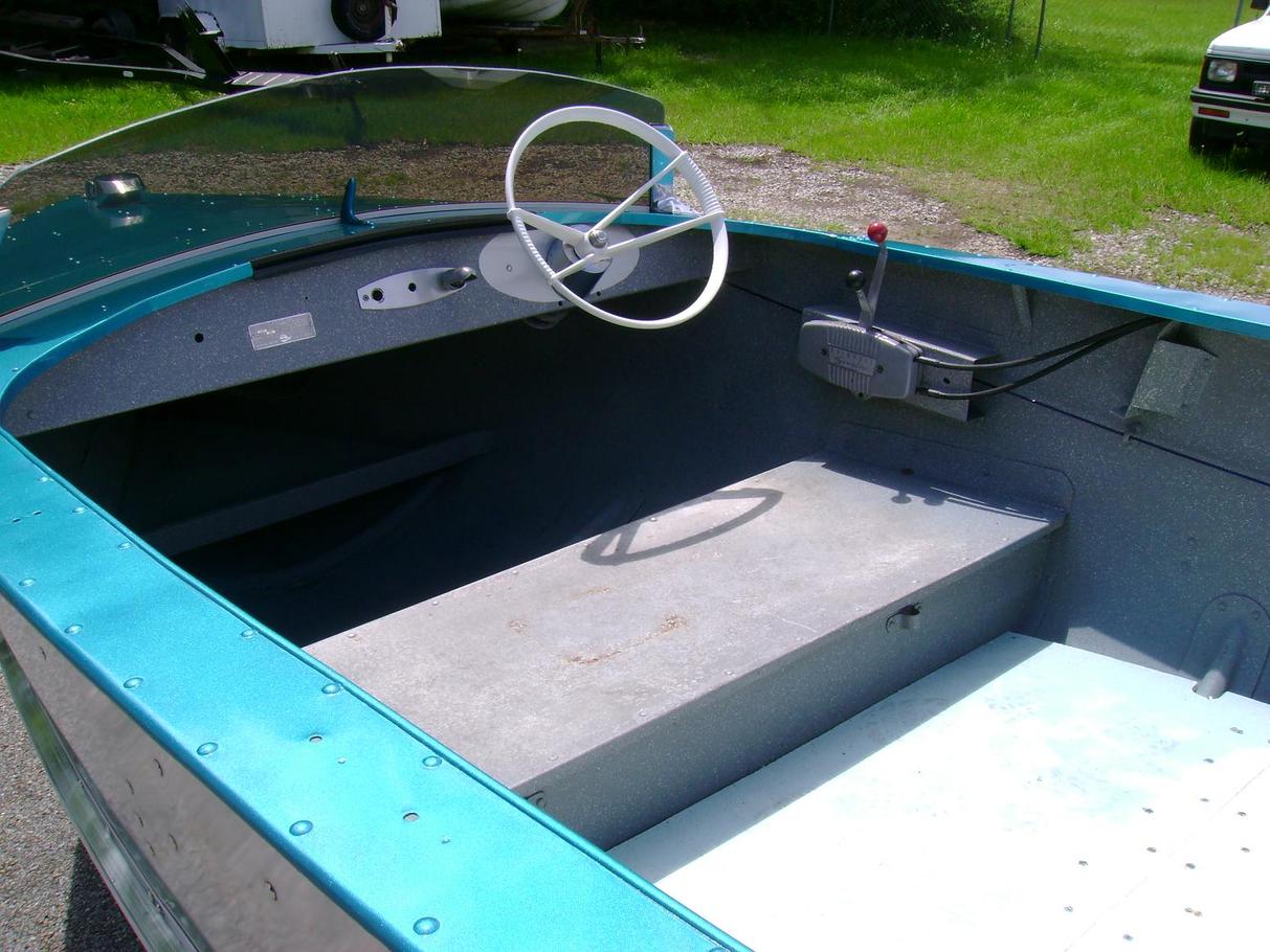

Re:52 Duracraft Sportsman restoration. 13 years 4 months ago #78254

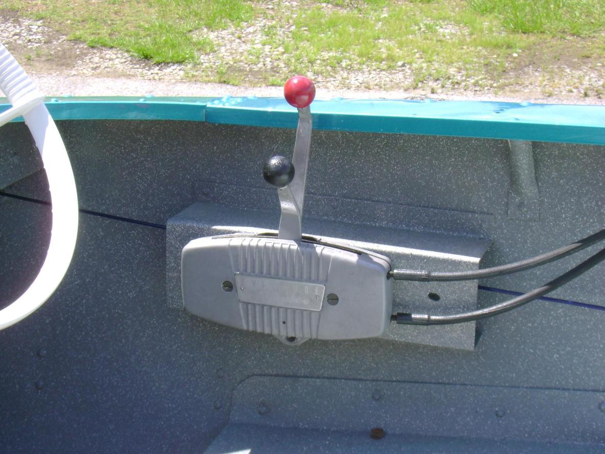

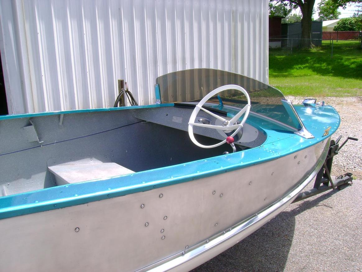

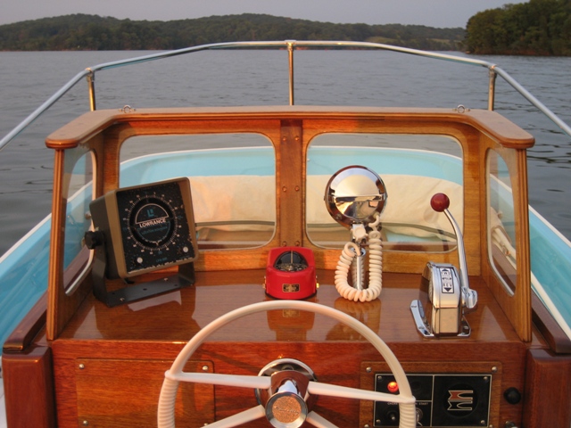

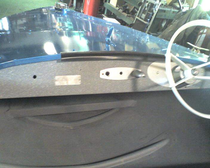

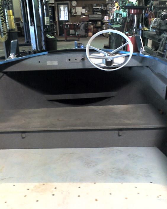

My windshield got finished Friday! If you remember, I made a patten from a piece of flexible wall board. I sent that pattern to a glass co. in town and they cut and finished the edges using my pattern. I was going to do this myself, but they did it for $58.85. I could not even get a scrap piece of 1/4 tented plexiglass for that, so it was the best thing to do. Here's how it turned out.
Okay, I'm sure some of you noticed that RED knob, and yes I now have my controls reworked and installed. I took the little simplex apart and bead blasted the housing (after taping up the name plate) and shifter handles, painted the knobs and just put clear on the housing. Then lubed everything up good and put it all back together. Works as smooth as a new one, cables and all!
I also took these shots because I just thought it was a neat angle. One shot really shows the inward rake of the gunnels towards the inside as it gets close to the transom. That's one reason why I like this little boat so much, and why, even though I need another boat like the proverbial hole in the head, I'd love to add a Feather Craft to my fleet.
Re:52 Duracraft Sportsman restoration. 13 years 4 months ago #78258
  • Neil
  • Neil's Avatar
  • Posts: 1997
  • Karma: 65
Is this the one?
Trouble loading.
I do believe I have your wheel and center cap.
Neil and Mary Ousnamer
Re:52 Duracraft Sportsman restoration. 13 years 4 months ago #78259
Neil wrote:
Is this the one?
Trouble loading.
Cool. Yea, it is a little tricky, lol :) you wanting to sell it?

Try this again.
www.fiberglassics.com/media/kunena/attachments/legacy/images/2-20130602-3.jpeg [/img]
Can you open this link casey?
This pic upload is beating me up today. I have done it a thousand times, but not this time.
Wheel is not for sale. Just need an adress to send it to. I would be honored to contribute to your project. Looking beautiful.

Yep, that is it! Wow, that is mighty nice for you to do that for me. At least let me mail you a check back for the cost of mailing. I'll email you with my mailing address. Let me know for sure that you received it.

I got a nice gift in the mail today! Gonna look great on the wheel. Trying to decide if I'm going to paint it to match the boat or have it refinished.

Re:52 Duracraft Sportsman restoration. 13 years 2 months ago #80545
Thanks! Imitation is the truest form of flattery LOL :P It's a Diahatsu single stage color with larger metallic flakes than it originally called for, I think it's bright peacock metallic. I had originally picked a nissan color, but they could not mix it in anything but base coat clear coat. I like using BC CC but I did not want to do all the extra painting so they scanned it and came up with the Diahatsu color. I'm on vacation this coming week and the actual code is at work. I'll be glad to give you the paint code, but it will be in a week before I can.
Re:52 Duracraft Sportsman restoration. 13 years 2 months ago #80553
No rush at all....I need to get my motor and steering squared away before I even fathom painting.
Re:52 Duracraft Sportsman restoration. 13 years 2 months ago #82102
garzilla wrote:
Beautiful boat! What color is that?
My wife LOVES it, so I'm gonna have to copy you..lol.
DAIHATSU PEACOCK BLUE METALIC with larger metallic than the formula called for (because it's a boat of coarse) this is a single stage catalyst paint. I originally picked out a NISSAN color that was almost identical but I decided against BC/CC due to the extra time involved in the paint process (I actually like the looks of a BC/CC better) so they had to color match it to find a single stage formula. I can always scuff it and apply a clear coat later for more depth if I decide to.
