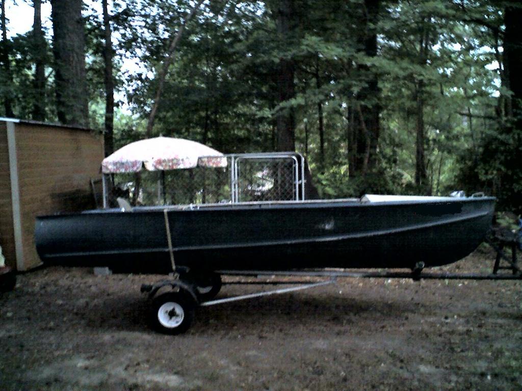

UPDATE: I found the make, model and year built.
I purchased this about a week ago and plan on restoring it. I'd like to know what Co. made it and maybe eventually at least a year range it was manufactured. Most accounts have already agreed that it is older than the 60's, but honestly I don't know. I do know that I have searched the internet and most of the common sites that deal with old or classic aluminum boats and haven't found anything that has a transom set up like this one, but plenty of similar bows. Anyway, here are the pictures, see what you can do with it.

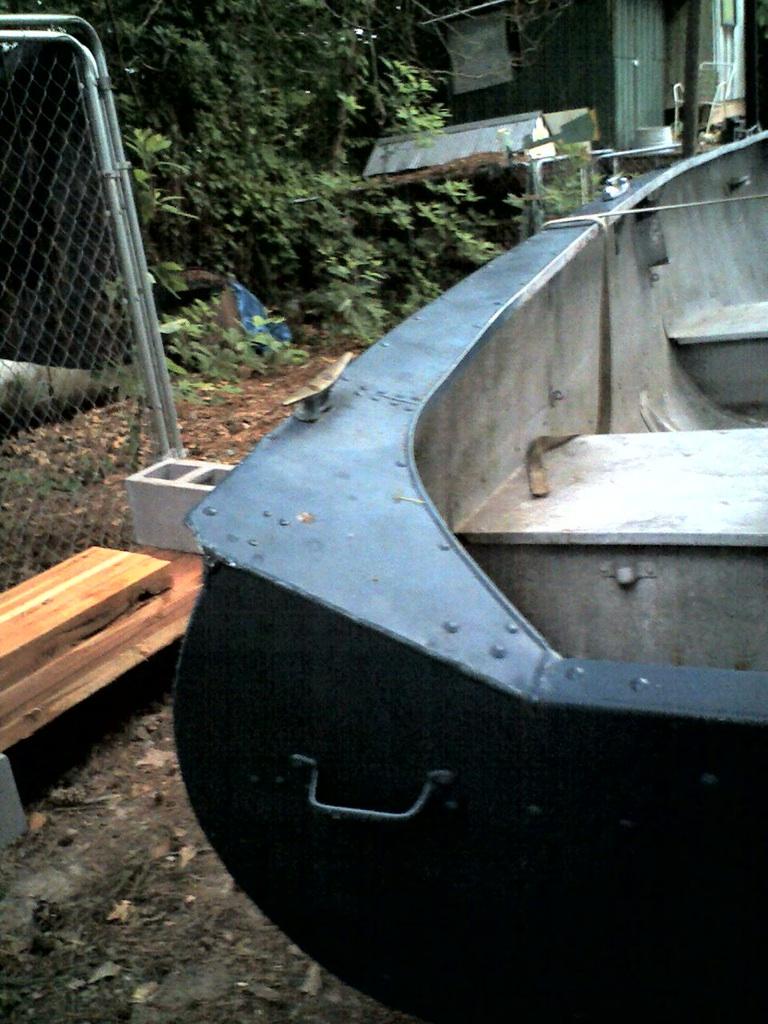

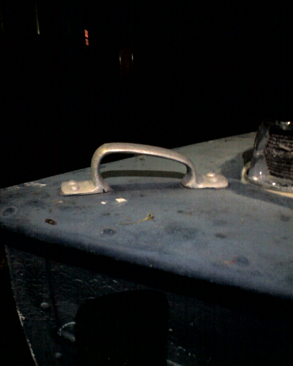

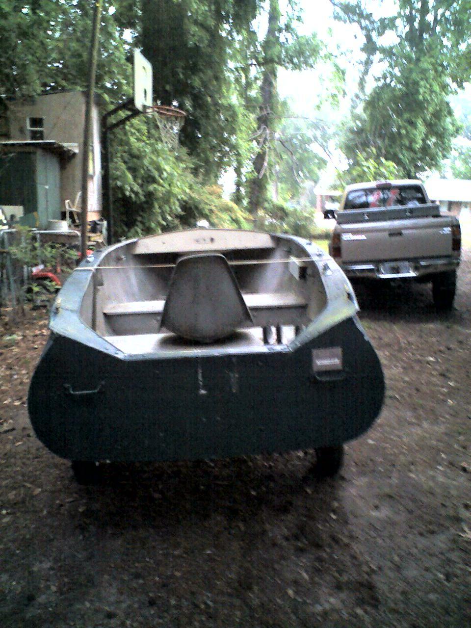

adding more pictures.
52 Duracraft Sportsman restoration. 14 years 5 months ago #60569
sorry for this, couldn't figure out any other way

What I have discovered from looking this boat over, is that the bow enclosure has been cut and the dash moved forward, it had a curved windshield at one time and a steering wheel. There are also brackets for a seat back up front and loops riveted to the vertical panels of both bench seats, two front and rear of each seat. Maybe to attach a cushion?

Re:Old tinny, anyone know who made it? 14 years 5 months ago #60579
The transom lines look sort of like Aerocraft, but I really have no clue. Good looking boat, though.
