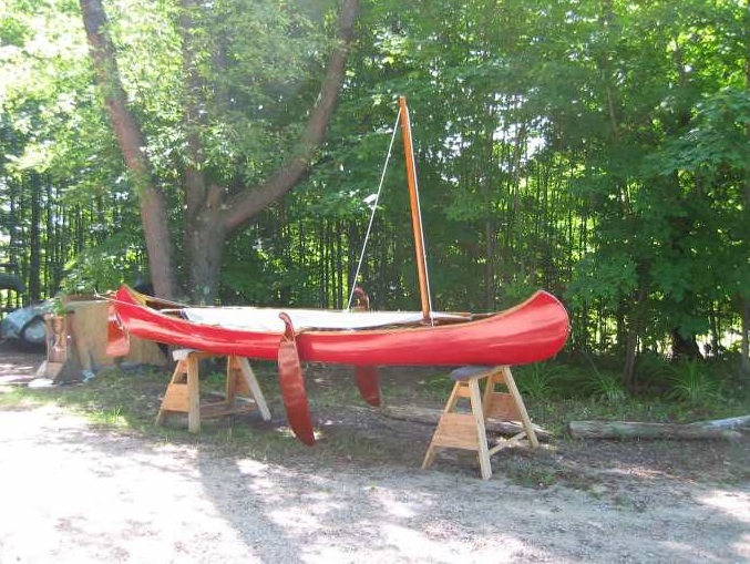

Here's my 1945 Yankee. Good luck with your project!
Great to be on board.
Rick

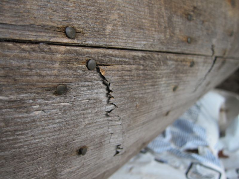

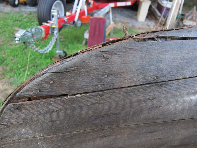

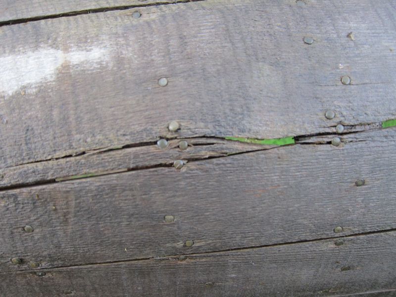

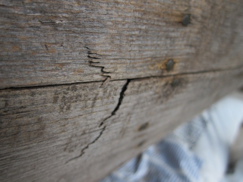

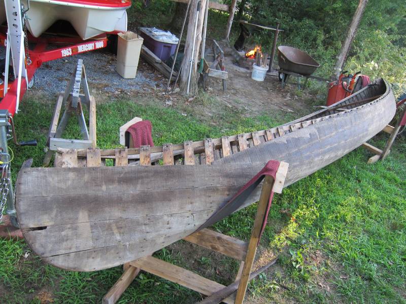

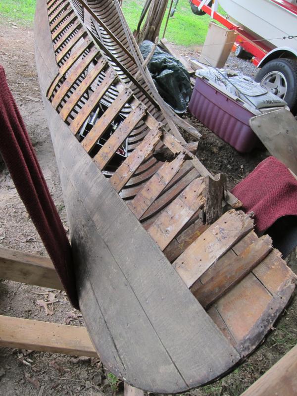

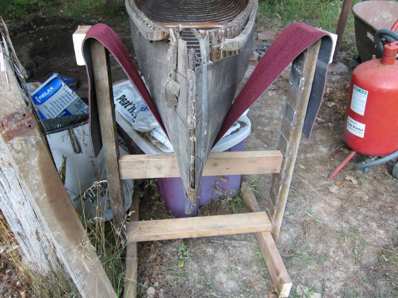

Scarfing planks? 13 years 11 months ago #65839

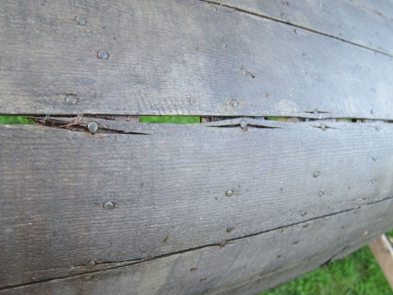

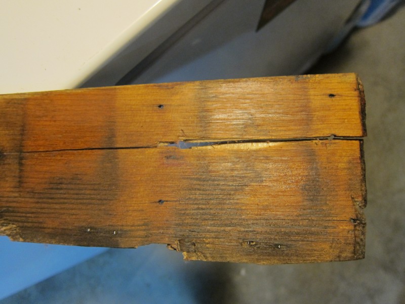

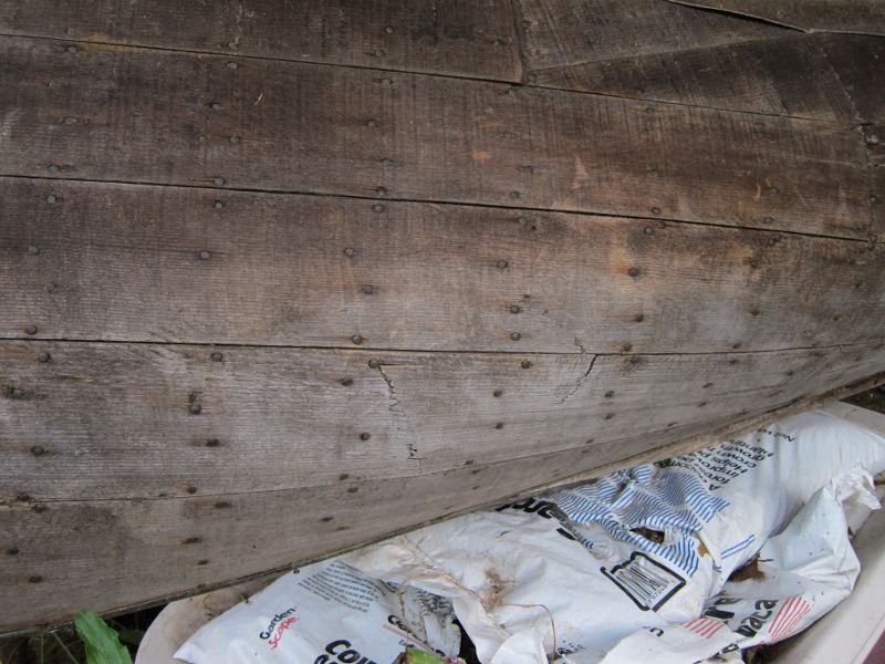

I've got cracks in a couple planks (canoe length planks) from where a tree came through my garage and attacked this canoe stored in the rafters back in the ice storm of January '98. The canoe didn't get hurt as badly as my garage, but the cracks seen here are outside the canoe right where there is that broken rib. It's amazing really it did not get damaged worse.
So now I have a couple questions. First, my build sheet says the planks are spruce, but weren't they mostly (always?) cedar? I've emailed a few folks who would know, and posted the same question over on the WCHA, but am not getting any responses.
Secondly, can I scarf in replacement plank pieces here? I hope so, as getting a couple canoe lengths of whatever this wood is would be tough.
Thanks for any help!
Frank
Overview of cracks
Crack from the front
Crack from the rear
Re:1946 16' Old Town Canoe 13 years 11 months ago #65859
  • Shelby18
  • Shelby18's Avatar
  • Posts: 436
  • Karma: 18
Try this guy Scott Barkdoll he restored my Old Town. Tell him I sent you, and am still loving my canoe. Here is his email address: This email address is being protected from spambots. You need JavaScript enabled to view it.
And here is his website www.skywoodscanoes.com/
All the best...
Rick

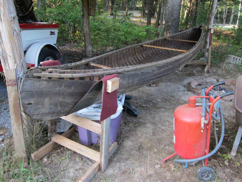

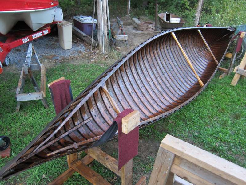

Re:1946 16' Old Town Canoe 13 years 11 months ago #65906

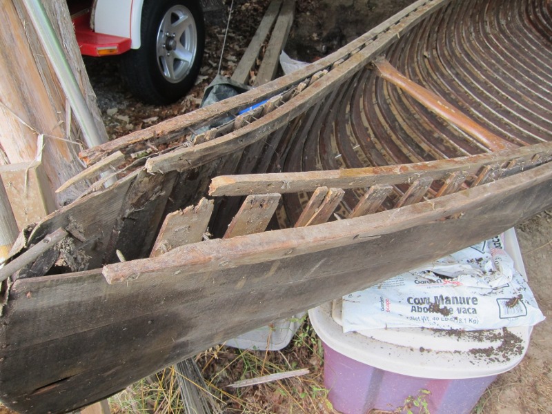

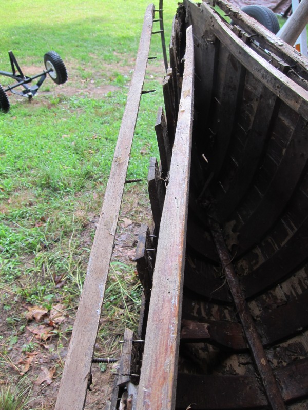

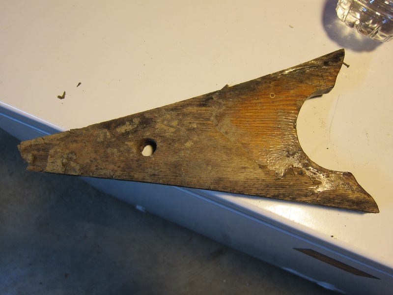

Here's where I got last night.
Sure looks like spruce planking to me!
As you can see, I could not get all the screws out of the outwale. I think this whole ash outwale will be replaced.
This stern deck looks like white oak.
More to come!
Frank

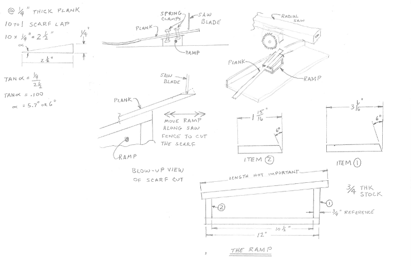

Here is a way I learned to scarf planks. Hope this jpg attaches
Have to resize it... I'll try again later
Thanks for resizing it Frank !
I learned this from a guy who was scarfing lap strakes for his Lyman. It's a crude sketch, but get's the point across.... I hope ?
Re:1946 16' Old Town Canoe 13 years 11 months ago #66054
Chuck, I'll be scarfin to beat the band! Ribs too. Stems for sure. You could always email me a "big" jpg. frank dot alguire at gmail dot com. Thanks!
Frank

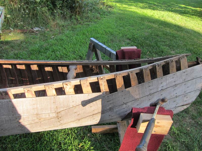

Re:1946 16' Old Town Canoe 13 years 11 months ago #66147
Made canoe cradles today, plus a couple heavy duty nesting sawhorses for other projects. Fixed up some old broken down sawhorses too!
Frank
Re:1946 16' Old Town Canoe 13 years 11 months ago #66153
Nice, now that is all going to be real handy Frank.
Re:1946 16' Old Town Canoe 13 years 11 months ago #66370

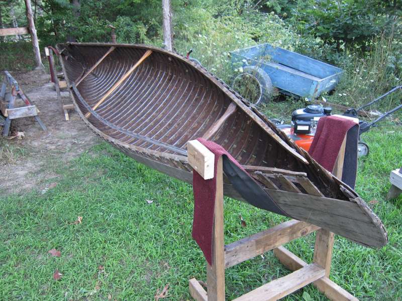

So working between my new cradles and old newly-stabilized sawhorses, I removed both bands, removed pieces of the mostly disintegrated keel and both outwales. Going was tough because this canoe had been fiberglassed 40 years ago. All the screw slots were full of resin and there were staples holding the 'glass on. One outwale broke in the middle at an existing split when it came off, and the other is not in very good shape. A number of my ribs are bad where they meet the gunnel. All the fiberglass is now off, except for one side that will get done later. Dinner called and then the mosquitoes came out. Took a couple of planks off too. Saved all the hardware I could, and all of the keel screws & little cupped washers. Lot of work here, but I'm taking it one step at a time and am not in a rush.
Can anyone tell me what end is the bow? Would it be the end with the thwart close (couple feet maybe) or far away (like maybe 4')? Both ends have the hull # in the stem.
Thanks for all the help and advice folks. I sure do appreciate it!
Frank

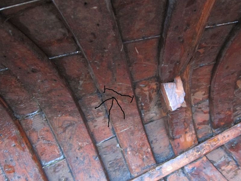

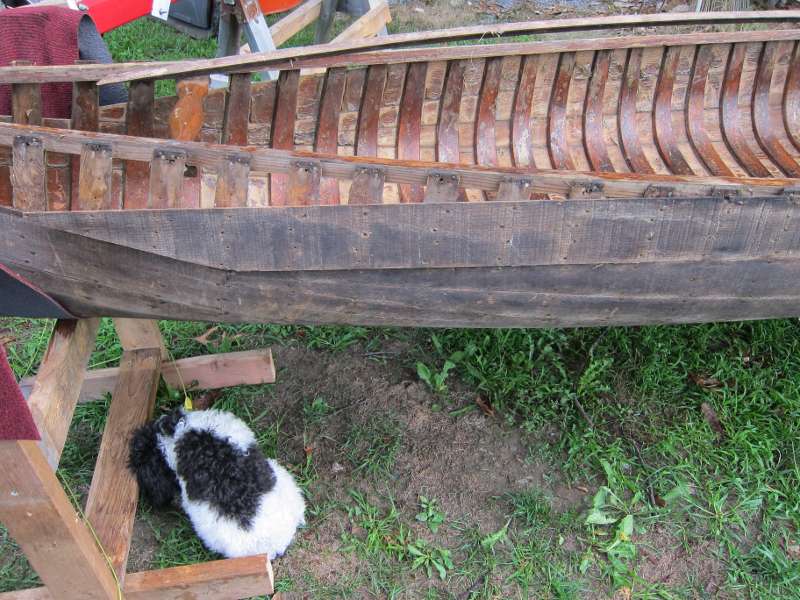

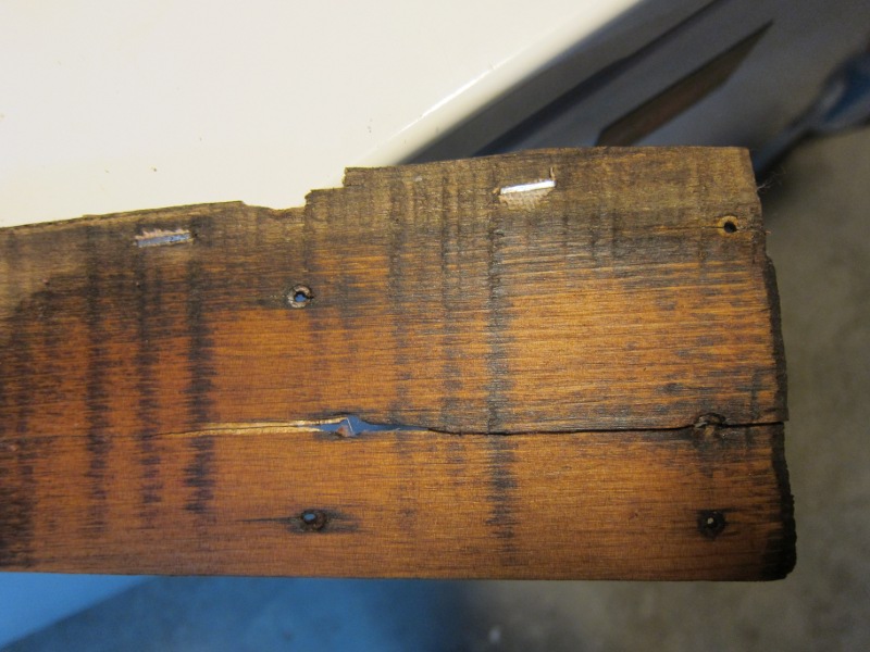

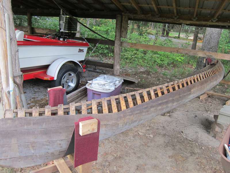

Re:1946 16' Old Town Canoe 13 years 11 months ago #66469

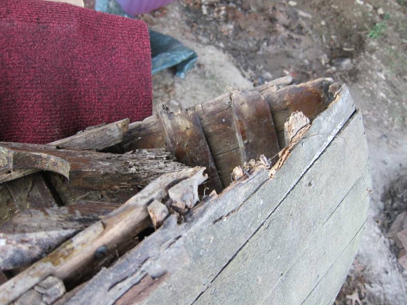

Okay, here's where I'm at. I washed the interior last night with a big stiff brush and Murphy's wood soap. Still pulling a few staples as well as working on getting some planks out of the way for rib scarfing, and general plank replacement. Got a couple questions.
First - I can't find eastern white cedar around here anywhere except growing trees (I have a bunch on my property). Looks like about all that is available is western red cedar in bundles for siding ($130 for 10 of them 12' long), and 1 X dimensional stuff nominally 6" wide up to 12' long. Guess I could use either of them for planks and ribs?
Second - I have planks that look like they're pulling apart from the nails. See pics below. I need to replace those don't I?
A couple of the pics here show two cracked ribs inside and the cracks on the planks outside. This is from the ice storm of '98 up on the Canadian border in NY when a big tree came down through our garage roof and hit the canoe. I had built a storage rack for it up high enough so I could get under it without hitting my head. Really, the canoe didn't get too damaged. That gives you an idea of how long I've been carting this thing around too! We've moved three times since then.
Thanks again for all the help folks.
Frank
Washed
Splits
Ribs cracked inside
Outside cracked ribs plank damage
Plank removal with my helper...

Re:1946 16' Old Town Canoe 13 years 11 months ago #66497
Stripped the top planks off one side tonight ("B" side) to get at the tops of the ribs. I think a lot of the tops need to have new material scarfed in. I have a good friend coming over maybe Sunday to help me with an inventory. He's done two of these kind of canoes, in much worse beginning condition. I'm labeling the ribs and planks as they come off.
Frank
Re:1946 16' Old Town Canoe 13 years 11 months ago #66501
Just curious. How are you getting the nails out with out hurting the planks? Its got to be mighty tedious work.
