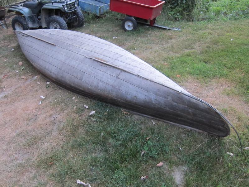

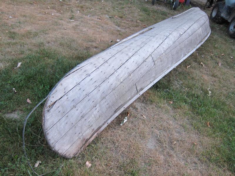

Scarfing planks? 14 years 3 months ago #65839
I've got cracks in a couple planks (canoe length planks) from where a tree came through my garage and attacked this canoe stored in the rafters back in the ice storm of January '98. The canoe didn't get hurt as badly as my garage, but the cracks seen here are outside the canoe right where there is that broken rib. It's amazing really it did not get damaged worse.
So now I have a couple questions. First, my build sheet says the planks are spruce, but weren't they mostly (always?) cedar? I've emailed a few folks who would know, and posted the same question over on the WCHA, but am not getting any responses.
Secondly, can I scarf in replacement plank pieces here? I hope so, as getting a couple canoe lengths of whatever this wood is would be tough.
Thanks for any help!

Re:1946 16' Old Town Canoe 14 years 3 months ago #65859
  • Shelby18
  • Shelby18's Avatar
  • Posts: 436
  • Karma: 18
Try this guy Scott Barkdoll he restored my Old Town. Tell him I sent you, and am still loving my canoe. Here is his email address: This email address is being protected from spambots. You need JavaScript enabled to view it.
And here is his website www.skywoodscanoes.com/
All the best...
