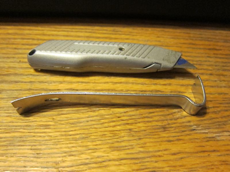

Just curious. How are you getting the nails out with out hurting the planks? Its got to be mighty tedious work.
1963 Starcraft 14' Ranger
Re:1946 16' Old Town Canoe 14 years 3 months ago #66503
It is tedious, but relaxing at the same time. Plus it's not greasy. And I'm not doing it for anybody else. It's fun.
Mostly, I use a small quality nail puller, get behind the plank just enough to push the head of the nail out a bit, get the flat end corner of the puller in under it to raise it enough to get the other end with the leveraged puller under it, then rotate it to get the nail out as painlessly as I can (I show it here in relation to a standard box cutter). It really can't be rushed, and trust me, it doesn't always work. In those cases, and in the case of most everything I've removed, new planks will need to be made I think. This canoe was very well made, I'll tell you that!

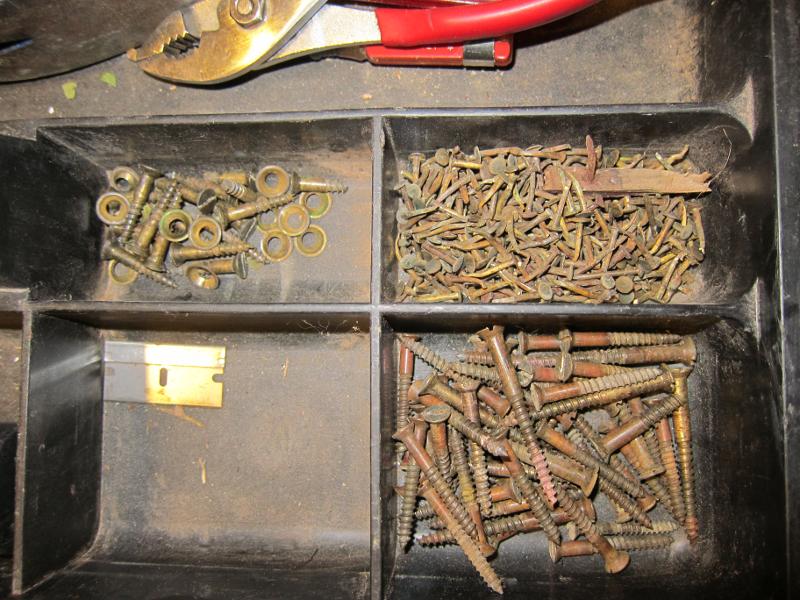

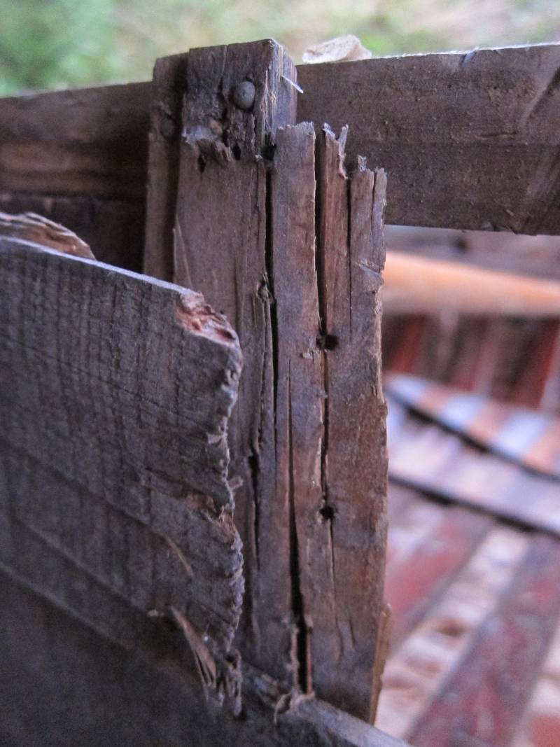

Also pictured here are the first of the two stems that I've uncovered enough to determine position of a scarf joint, and a pic of the hardware I've already collected. Lots of small nails as well as highly sought after cup washers and screws that held the keel on from the inside.

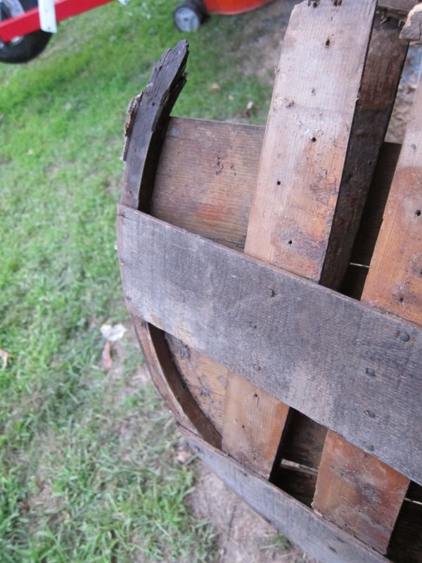

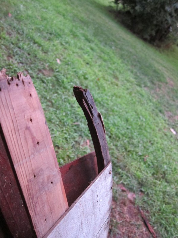

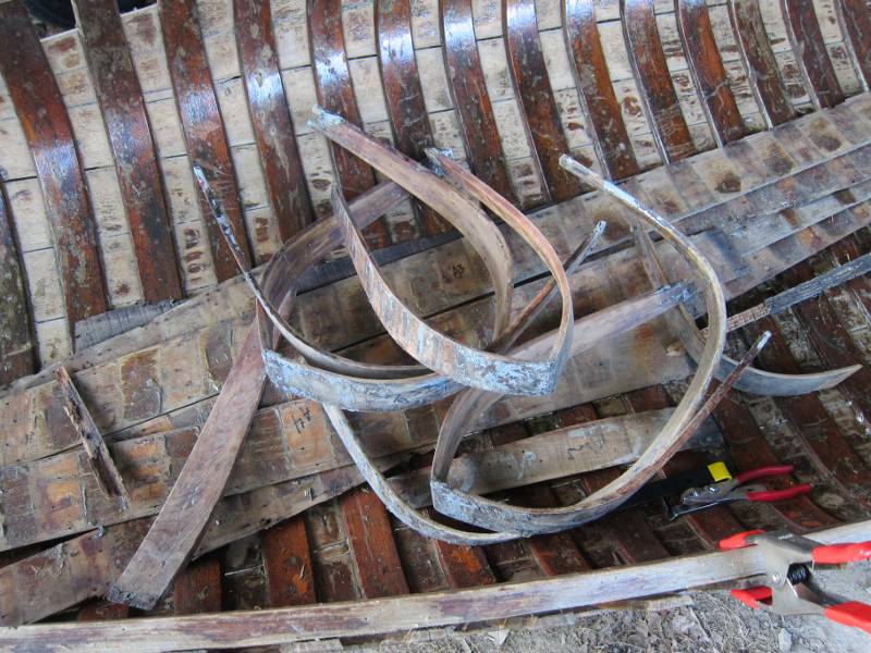

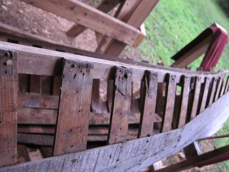

Re:1946 16' Old Town Canoe 14 years 3 months ago #66634
From last night. Now I have one side with planks stripped from the top of the ribs, on to the next side.
More to come.
Frank

Re:1946 16' Old Town Canoe 14 years 3 months ago #66669
Thanks Rick! That is the same thing my son Max said earlier today. Can't help it, I'm a photo nut...
Frank
Re:1946 16' Old Town Canoe 14 years 3 months ago #66683
Frank I would frame that middle one. It will be nice to have it to look back on when its done.
Re:1946 16' Old Town Canoe 14 years 3 months ago #66685
  • Shelby18
  • Shelby18's Avatar
  • Posts: 436
  • Karma: 18
+1 that was my favorite also.
Great to be on board.
Rick
