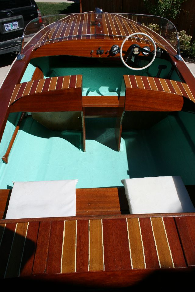

Hello all,
I'm looking for a couple things for my '57 Crosby and was hoping somone might be able to point me in the right direction. I'm looking for the step pads (4). They don't have to be original although that would be fantastic. Reproductions or just something that works would be fine. I'm also looking for the window moulding at the base.
Thanks for any help.

Thanks gentleman, for the welcome and the quick response. Here's the story on my boat: My dad, who's now 70, bought it when he was 15 with money he earned delivering papers in '57. I grew up on that boat cruising lakes and rivers in Illinois and Wisonsin. It sat in a garage with a cover from '84 to 2000 until it came into my hands about 5 years ago. She now resides in Bend, Oregon, where my own kids now enjoy it on the many lakes in the area. It's all orginal except the windshield and the motor (and a fresh coat of interior paint color matched to the original). I have never touched the wood as far as restoration.
I'll wait for the experts to point the way on my needs.

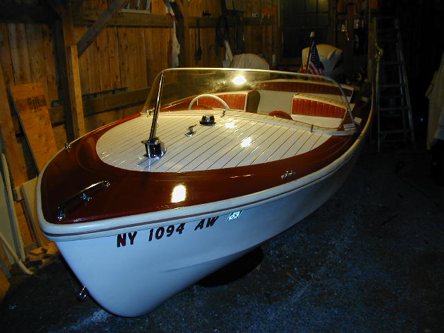

Great story and background on the boat. Sounds a lot like mine, in my avatar, 1960 Wagemaker Clipper. I would say if there isn't any cracking or peeling of the Varnish, maybe a sanding on the surface and another coat or two of fresh varnish, for UV protection, and you should be fine, unless you've already done that. I had a hard time finding new step pads so I just scrubbed mine up and put them back on, small cracks and all. Someone should jump in with info soon. It may be a day or two but be patient.

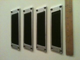

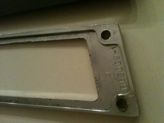

Hi Brian(s),
My Fish'n'Ski has only 3 step pads on her. Two smaller ones (8-3/4") up by the bench seat and 1 single larger one (11-1/4") in the rear. Any rationale as to why there isn't a 4th? My boat has the original gel coat with no evidence of patched holes where the 4th step pad may have been.

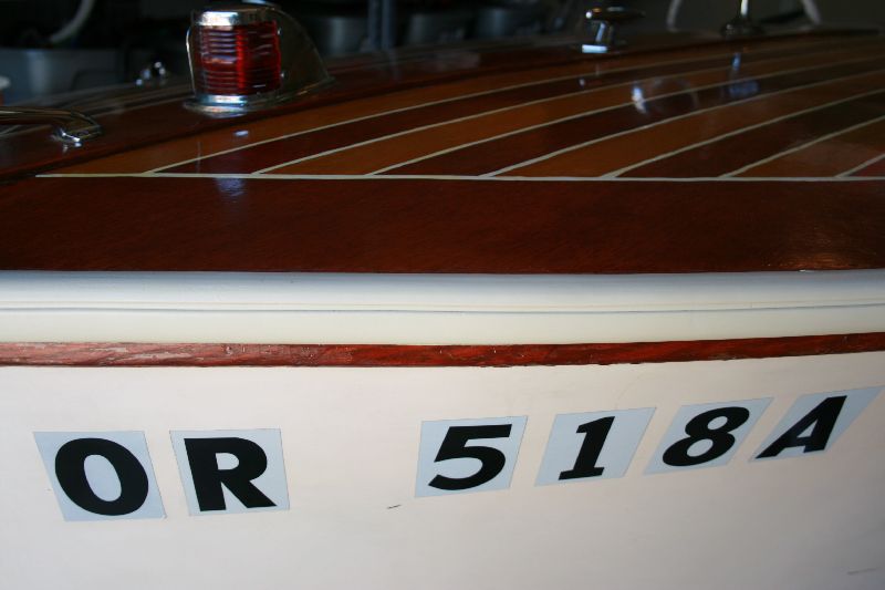

Here is a pic of the rubrail. Seems to be the same size as yours (about 2 1/4" from top to bottom). It looks to be in better shape than it is. Last year I sanded, spray painted, then put a clear coat over it to get some more life out it.

The 4 pad surrounds I have look identical to shipsters, and the part number is identical EXCEPT FOR THE LAST DIGIT. Mine end in 7, shipsters in 9. My surrounds measure 3" wide and 8.75" long on the long side. Will try to post a photo with my wife's Kodak digital, always a challenge. If you want them they're yours, no charge. I suggest rechroming them though. Two really need it, and two should have it so they all match. These came off a Crosby Seaquin and my Crosby Ranger. The Ranger is being redone, but as a work boat. No need to retain originality on that project. I just want big, open, and sea worthy.
And the rail does look right; die # 187-1.

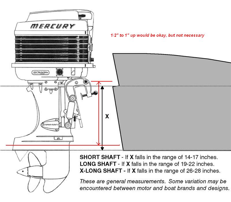

In the meantime, here's a pic Scott (Chinewalker) did to help explain how to measure for correct motor length;

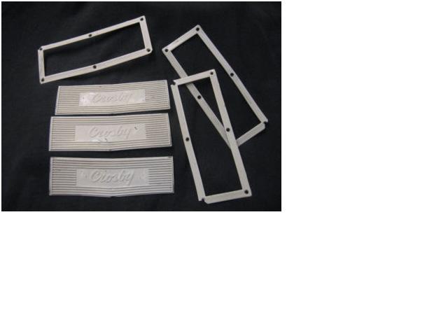

I don't remember if you found all the pads & frames you were looking for. :unsure: Found these today:
Just 3, but..
Crosby steps
Good luck...........

Yes, I saw those over the weekend. They're on my watch list, although I'm not sure what I'm going to do with 3. If I bid on them (most likely against a FB member), it'd just be for the rubber pads. They're rare. Those are the original plastic surrounds that break pretty easily. Does anyone know of anyone who could take one of those pads and reproduce it? Then we could bunch made for the Crosby crew here on the site. Or, does anyone know how hard it is to make a mould of it at home...like the ingredients of both the mould and the rubber for the pad? Do you need a chemistry degree and lab?
Brian
